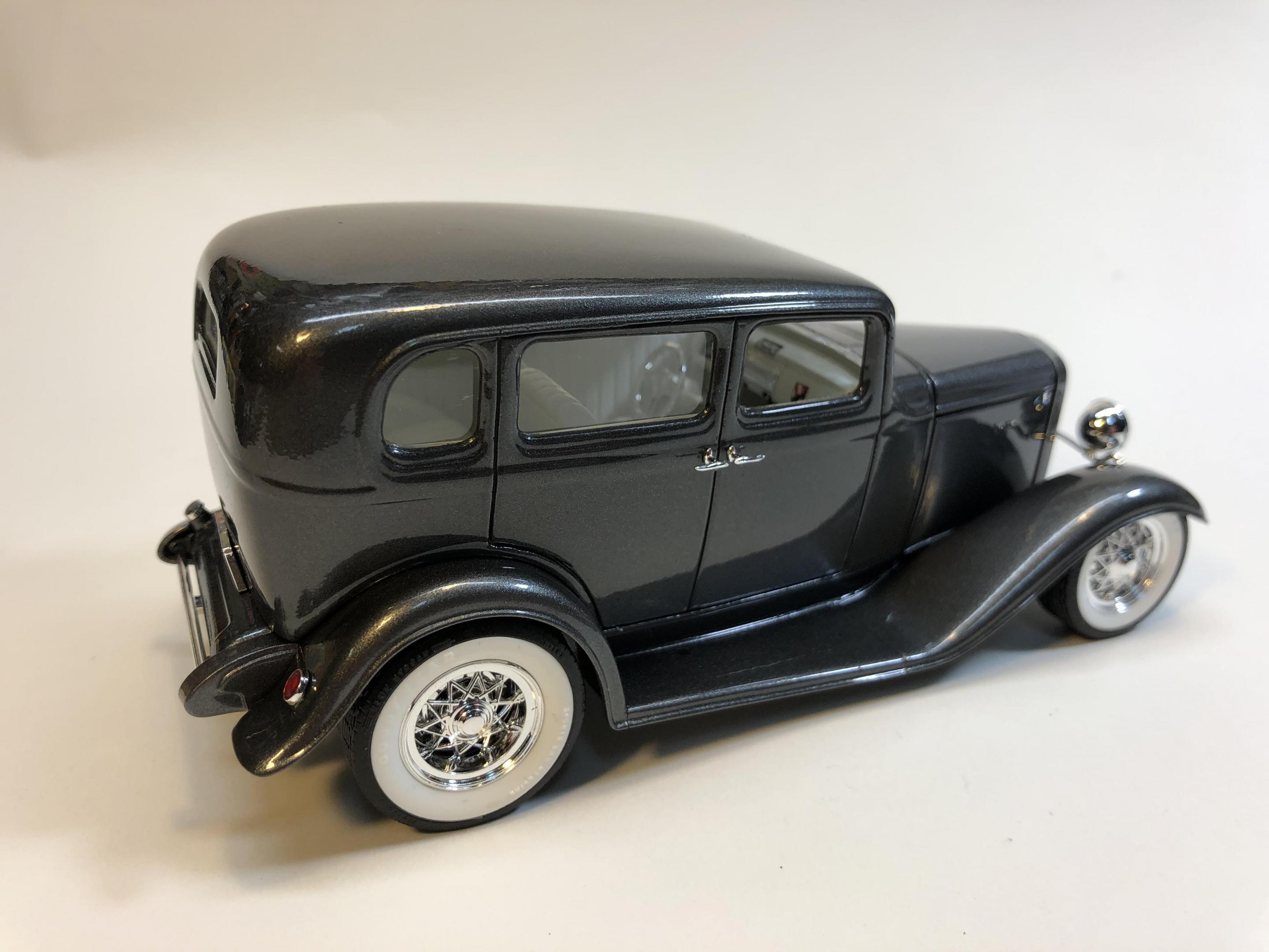

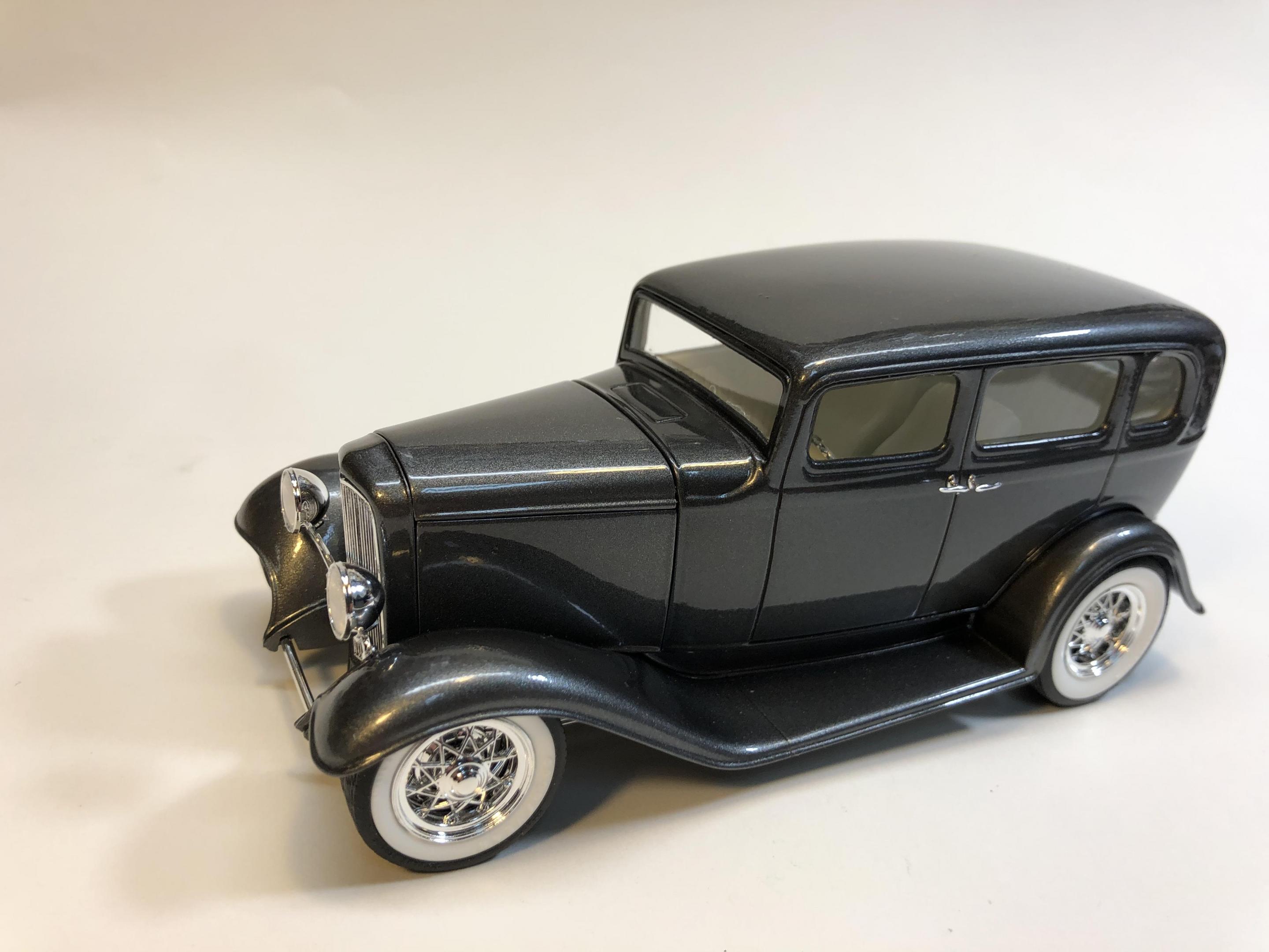

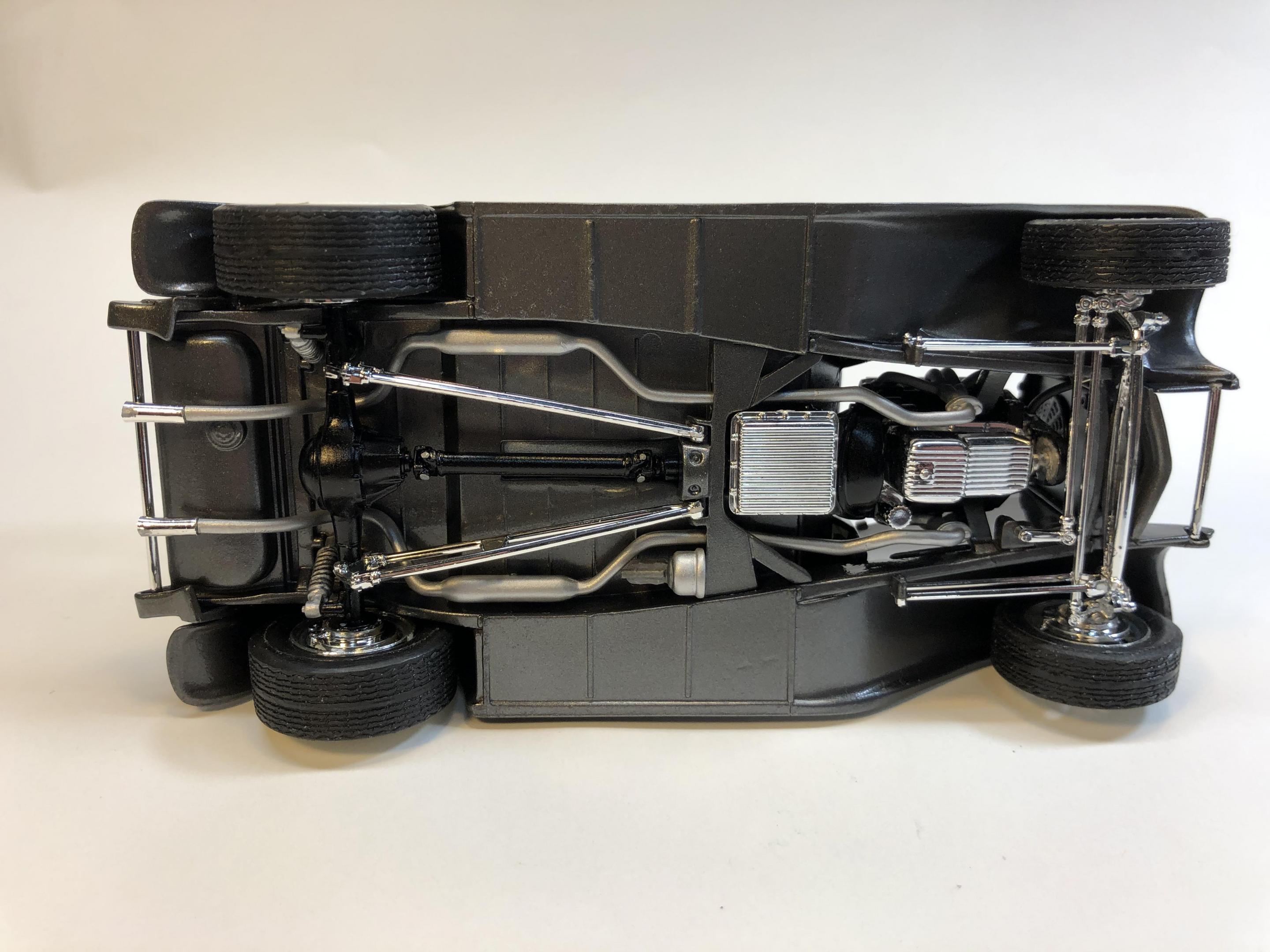

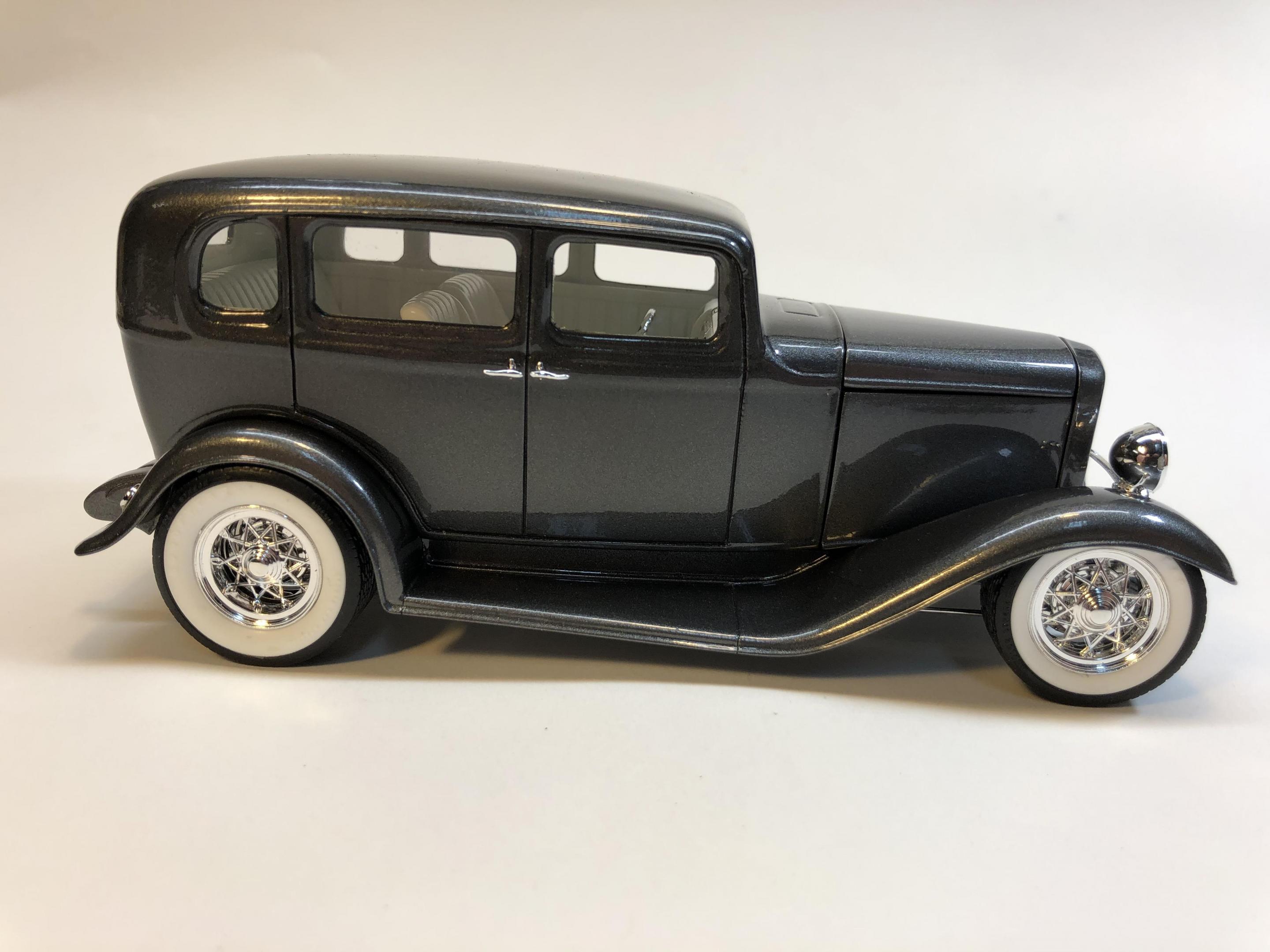

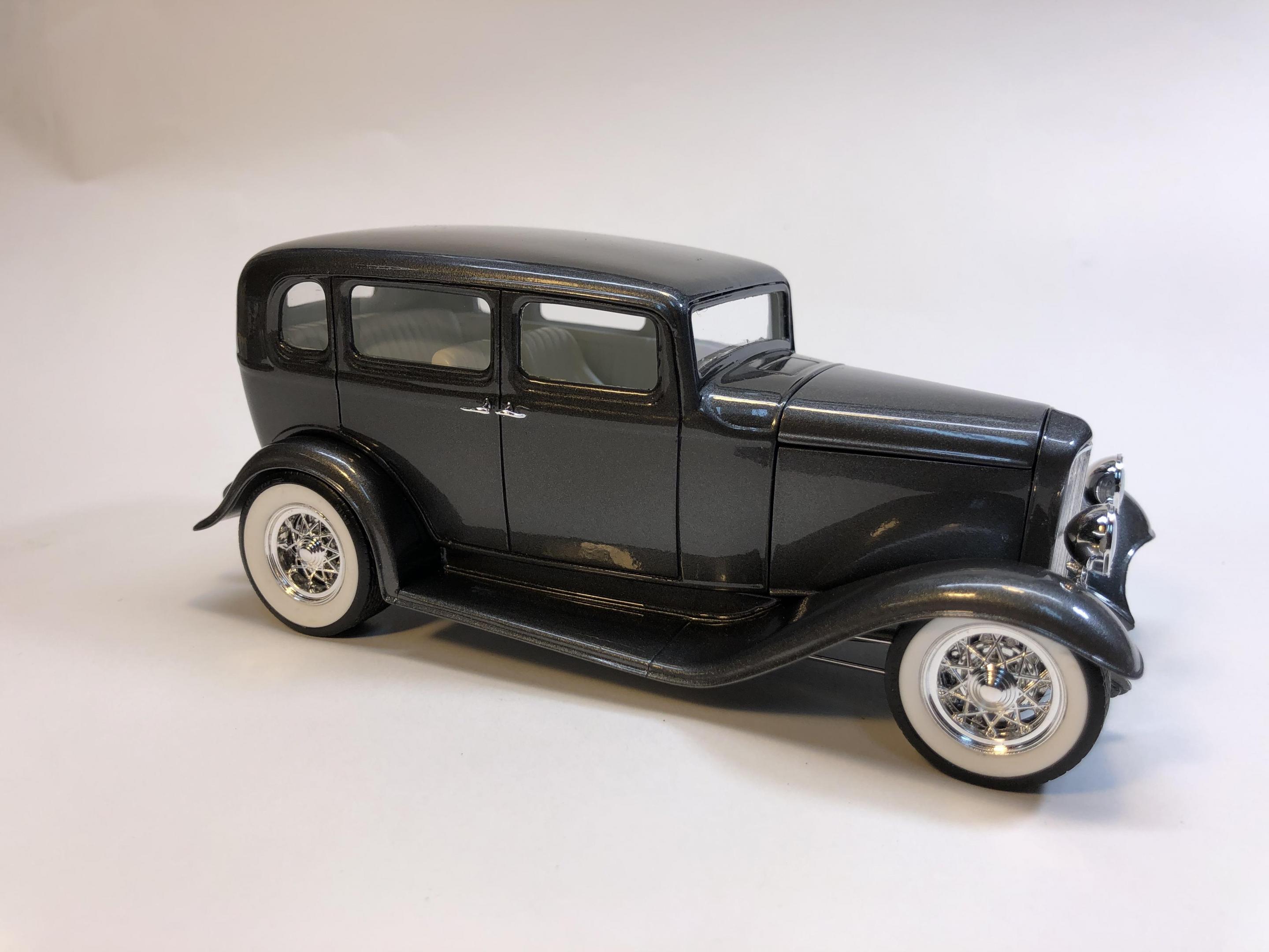

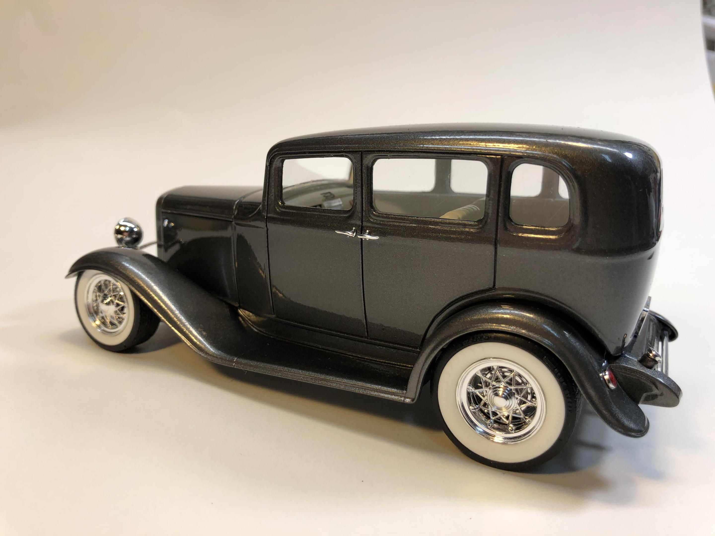

Rocking Rodney Rat Posted February 18, 2020 Posted February 18, 2020 I finally finished this one up, kind of a long road with a few setbacks and screwups on my part. The body is a resin item from Ed Fluck at Drag City casting. The master was skillfully put together by our very own (and a friend of mine) A. Dennis Lacy. The concept is a fairly modern street rod with the ubiquitous SBC (from the Revell '30 Model A kit) with an auto tranny, smooth hood sides, a filled roof, smooth running boards with bobbed rear fenders (compliments of Norm Veber at Replicas and Miniatures of Maryland). '40 dash from the Revell 5ive window coupe, seats from the Speedwagon, most of the parts are straight out of the Revell '32 series of kits. Wheels are from the Revell '32 sedan and tires are from Modelhaus. Paint is decanted Testors One Hit Graphite Dust shot through an airbrush (my first attempt at using the device I bought about five years ago, I'm learning!!?!?!?). Clear overcoat is Minwax Polyurethane airbrushed on. It makes for a fairly smooth finish if one can keep the bugs out of it and refrain from dropping the body on the floor..... -RRR
espo Posted February 18, 2020 Posted February 18, 2020 I like the way this body style looks. The paint really picks up the reflections from around it. Great looking chassis and engine.

Rocking Rodney Rat Posted February 18, 2020 Author Posted February 18, 2020 5 hours ago, Claude Thibodeau said: Hi! Very nice result. Classy looking, and the detailing is great. About your Minwax clear: how many coats would you say you used? Medium or heavy? Via your air-brush, or is-it a spray-can? Just curious... CT Claude: This is what I used: https://www.ebay.com/itm/NEW-MINWAX-QUART-CLEAR-GLOSS-OIL-BASED-FAST-DRY-POLYURETHANE-8995789/402003791161?epid=19016387928&hash=item5d994b0d39:g:rAEAAOSwhkRWgux7 it came recommended by one of the guys in our local club. It's the first time I have used it, but I will use it on all shiny paint jobs going forward. I shot it through my airbrush, no thinning needed. A quart will probably go bad before you can use it all up. Application recommendations are one light coat and one (sorta) heavy. I shot two coats with about ten minutes in between. It's "self leveling" which I think is a euphemism for "it runs"...I attached the body to a bent up coat hanger (sometimes more successfully than others, see above) and then I move the part having been clear coated all around, so any potential runs are smoothed out and prevented. This gives a really nice shine even without buffing and polishing (which I never do). It seems to dry to a very hard surface. -RRR

Claude Thibodeau Posted February 19, 2020 Posted February 19, 2020 6 hours ago, Rocking Rodney Rat said: Claude: This is what I used: https://www.ebay.com/itm/NEW-MINWAX-QUART-CLEAR-GLOSS-OIL-BASED-FAST-DRY-POLYURETHANE-8995789/402003791161?epid=19016387928&hash=item5d994b0d39:g:rAEAAOSwhkRWgux7 it came recommended by one of the guys in our local club. It's the first time I have used it, but I will use it on all shiny paint jobs going forward. I shot it through my airbrush, no thinning needed. A quart will probably go bad before you can use it all up. Application recommendations are one light coat and one (sorta) heavy. I shot two coats with about ten minutes in between. It's "self leveling" which I think is a euphemism for "it runs"...I attached the body to a bent up coat hanger (sometimes more successfully than others, see above) and then I move the part having been clear coated all around, so any potential runs are smoothed out and prevented. This gives a really nice shine even without buffing and polishing (which I never do). It seems to dry to a very hard surface. -RRR Hi! Thank you for the clear infos. Much appreciated! Since you say this particular car was NOT polished, I can see the "natural" gloss of this clear is very good. It reminds me of what you get from House of Kolor Show Clear, a 2-part catalized urethane you may be familiar with. It flows superbly, but once dried hard, is difficult to polish on a styrene car body without causing some damage to the body. That is why I might try your Minwax. I wondered about the type and number of coats you apllied, since I could see a smidge of "peel" in the reflexion on the passenger side running borad. This usually happen when you obtain very high gloss at application from heavy wet coats. Super nice then... but once evaporated and dried, the clear then gets a fair share of orange peel. Nothing a good rubbing won't dispose of, but some work nonetheless! Regards, CT

Plowboy Posted February 19, 2020 Posted February 19, 2020 So clean and classy! I typically don't like the chrome Kelsey-Hayes wire wheels. But, with this model and the wide whites, they're perfect! Nice work!

Alan Barton Posted February 20, 2020 Posted February 20, 2020 Wow, a really stunning build and you have achieved a beautiful balance. For someone who fears final assembly (apparently!) you have done a superb job of getting that undercarriage looking clean and symmetrical. I think the high gloss clear is a great idea because I always find that no matter how careful I am polishing vintage bodies, I always seem to get a rub through. The multiple window mouldings and body swage lines just about guarantee it! This is a credit to you, and Dennis for his fine mastering. Cheers Alan
