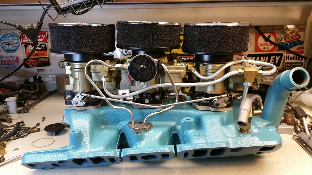

StevenGuthmiller Posted August 11, 2020 Author Posted August 11, 2020 (edited) I appreciate that guys! On 8/9/2020 at 7:07 PM, 1972coronet said: Speaking of oil pans --- is it just me , or does that stock 'pan look like a modified-sump version of the stock one ? I'm citing the emulated welding laps around its perimetre and across its sump . I really couldn't tell you John. This is the oil pan supplied in the AMT '62 Catalina kit. That engine is a 421, so possibly unique to the 421 HO? If that's the case, I guess this becomes a 421 instead of the intended 389. In the end, it would make sense anyway as I opted to use the exhaust headers from the 421 versus using the 389 manifolds supplied in the Revell '66 GTO kit. The intake is now finished for all intensive purposes. I still might add a dab or 2 of grime, and of course the air cleaners will be added at the time of final engine assembly. Steve Edited August 11, 2020 by StevenGuthmiller
1972coronet Posted August 11, 2020 Posted August 11, 2020 1 hour ago, StevenGuthmiller said: This is the oil pan supplied in the AMT '62 Catalina kit. That engine is a 421, so possibly unique to the 421 HO? If that's the case, I guess this becomes a 421 instead of the intended 389. In the end, it would make sense anyway as I opted to use the exhaust headers from the 421 versus using the 389 manifolds supplied in the Revell '66 GTO kit That makes sense , as that engine represents the Super Duty 421 . 389-400-421-428-455 are the same block --- I'm sure that some Pontiac specialist will correct my potentially-errorneous information --- for all intents and purposes ( or maybe the 389 is a shorter-deck ? Nothing noticeable in-scale ) .

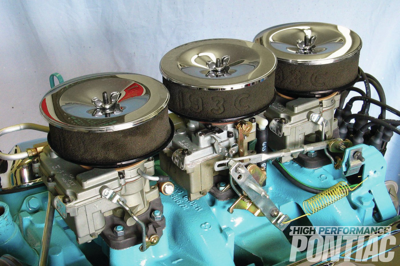

randyc Posted August 11, 2020 Posted August 11, 2020 That is a beautiful linkage you have built. And maybe I'm missing something, but where is the rod to the first carb? It seems to be sitting out there alone on the linkage side. And that spring is just masterful.
StevenGuthmiller Posted August 11, 2020 Author Posted August 11, 2020 (edited) 33 minutes ago, randyc said: That is a beautiful linkage you have built. And maybe I'm missing something, but where is the rod to the first carb? It seems to be sitting out there alone on the linkage side. And that spring is just masterful. I used photos of an actual set up to build this intake and tried to keep it as close as I could. Things are not proportioned exactly as they should be, but according to my research photos, there is no linkage to the front carb on the left side. It appears that there is linkage between the front and rear carb on the bottom of the right side, which I represented on the model. Steve Edited August 11, 2020 by StevenGuthmiller
randyc Posted August 11, 2020 Posted August 11, 2020 Aha! I wondered if it would be over there but it disappeared in the fuel lines when I was looking. I had a guy I used to clean cars for had a 62 GP with the tri power setup, 4 spd, 8 lug wheels. Such a sweet car - he never drove it. I turned it sideways just messing once though.
