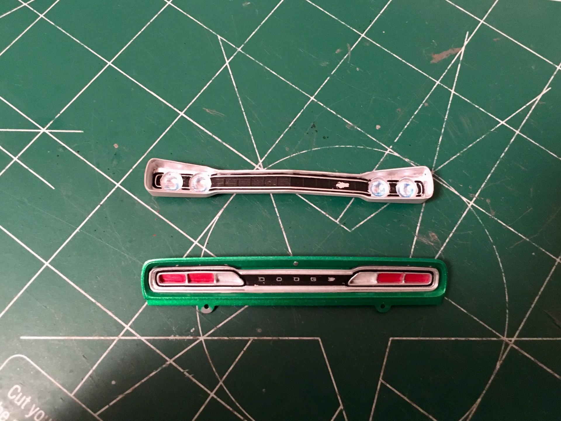

Brutalform Posted March 28, 2020 Posted March 28, 2020 (edited) This can be done a few ways, but the best imo, is using Vallejo Air acrylic paint. The good thing about it is, if you mess up, you can just wash it off, and start over, as the paint is water based. After it has dried, you can use a Tamiya swab, or tooth pick, to remove paint from the high points to add detail. The only thing is though, I’d recommend giving your work a mist of dull cote, or flat clear, to seal it, as the acrylic paint will want to easily get scratched, or marred, and try to flake off. You can do this same technique with a flat black spray paint, but you would need to wipe the areas you want exposed before the paint dries. I’ve also used Tamiya Panel Line Accent, which is an enamel base. This stuff will flow very well with capillary action. You might want to do a few applications using this technique though. The superbee parts are done with Vallejo paint, and the thunderbolt items are done with panel line accent. Edited March 28, 2020 by Brutalform 1

StevenGuthmiller Posted April 5, 2024 Posted April 5, 2024 1 hour ago, deuces wild said: Hey guys... Can I use Testors acrylic black and thin it water or Windex or maybe a combination of both thinners???... I'm still learning about this stuff.... Testors is all I have on hand...? You can use basically anything. This is Testors flat black enamel thinned with mineral spirits. Steve 1
