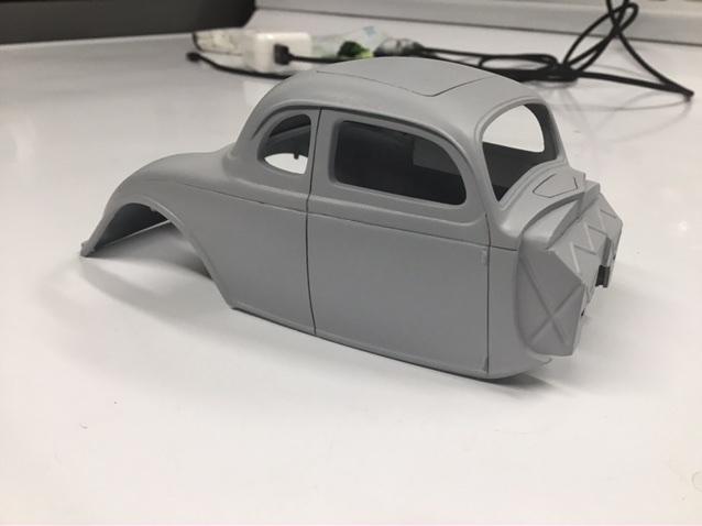

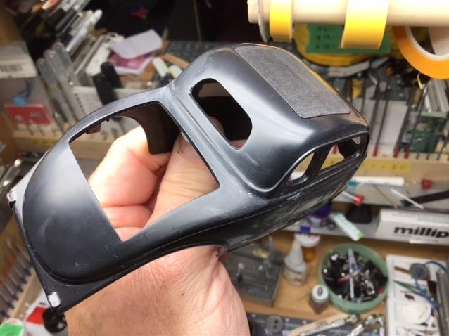

NOBLNG Posted April 2, 2020 Posted April 2, 2020 (edited) This is going to be a time filler build in between other stuff. From what I’ve read on here and what I’ve seen so far, it is a horrible kit. That said, I am going to try some body work and some modifications I haven’t attempted before. If I mess it up beyond repair, no biggie! I started by glueing the roof on which doesn’t fit well at all. I made some sprue-glue up and pasted it on the seams. I will attempt to file it closer to the proper shape when dry. Edited April 2, 2020 by NOBLNG 2
Belugawrx Posted April 2, 2020 Posted April 2, 2020 (edited) I see some sanding in your near future? good luck Whenever I see this era car, I am reminded of my squandered youth at the local dirt track..Merrittville Speedway Do you have a vision for this one..? Keep it going! Edited April 2, 2020 by Belugawrx

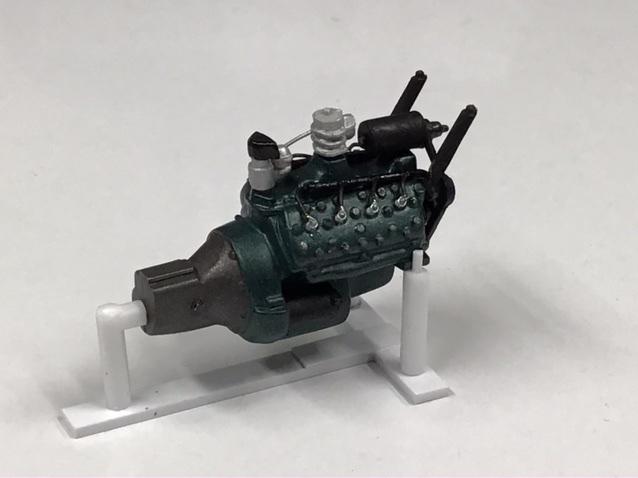

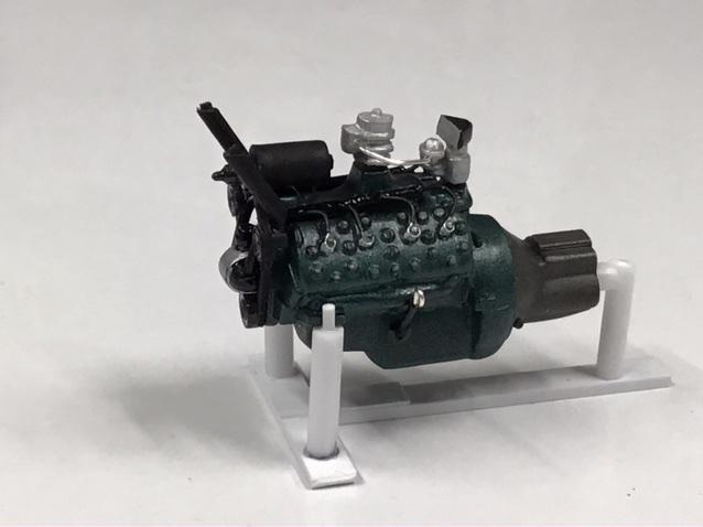

NOBLNG Posted April 11, 2020 Author Posted April 11, 2020 (edited) The body is still in the dehydrator. I will let that sprue glue dry real good before trying to sand it. In the meantime I painted and wired the engine. I also added a dipstick. Edited April 11, 2020 by NOBLNG 1

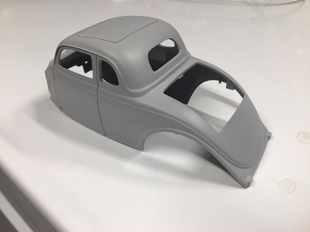

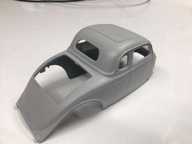

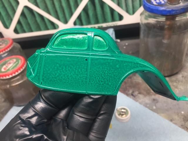

NOBLNG Posted September 30, 2020 Author Posted September 30, 2020 I’ve been fiddling with this one again while the charger dries. The body is sanded pretty much to shape and primed. I tried to paint it with Wicked Colors acrylic, but it just didn’t want to go on smooth, so into the purple pond it went. I tried some spoon tests later, but I didn’t get any results that gave me any confidence in it. Too bad since I have a few bottles of it and they have some very nice colors.

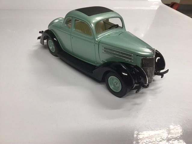

NOBLNG Posted October 1, 2020 Author Posted October 1, 2020 So I decided to try this Tamiya TS-60 pearl green that I had sitting on the shelf. i decanted it, sprayed it through my airbrush and it went on absolutely beautifully. I think it would have sprayed just as nice right from the can, but i was worried about getting to heavy of a coat in the wheels. 1
David G. Posted October 1, 2020 Posted October 1, 2020 Looks great so far! I like your detailing on the interior. David G. 1
espo Posted October 1, 2020 Posted October 1, 2020 I have used the Tamiya TS-60 Pearl Green also and used the spray can with great results. Your body work on the roof to body joint is as if there never was a problem. 1

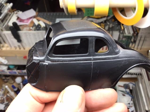

NOBLNG Posted October 1, 2020 Author Posted October 1, 2020 (edited) 2 hours ago, espo said: I have used the Tamiya TS-60 Pearl Green also and used the spray can with great results. Your body work on the roof to body joint is as if there never was a problem. The pearl green covered the red-oxide primer in pretty much the first coat. The roof joint success I attribute to the “sprue glue” that I made up using sprue from the same kit. There were a few pinholes after shaping that I used tamiya putty on. The instructions show the roof going on as one of the last steps...how the heck could that ever be made to look good? Edited October 1, 2020 by NOBLNG
espo Posted October 1, 2020 Posted October 1, 2020 3 hours ago, NOBLNG said: The pearl green covered the red-oxide primer in pretty much the first coat. The roof joint success I attribute to the “sprue glue” that I made up using sprue from the same kit. There were a few pinholes after shaping that I used tamiya putty on. The instructions show the roof going on as one of the last steps...how the heck could that ever be made to look good? It can't, even in the best of circumstances. This is a great kit until it comes to this. never understood what they were thinking here. rcomstanses
OldNYJim Posted October 2, 2020 Posted October 2, 2020 Oh man, good choice with that Tamiya pearl - looks amazing! 1

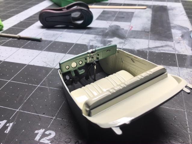

NOBLNG Posted October 2, 2020 Author Posted October 2, 2020 (edited) Getting nearly done. I separated the steering column from the steering box so that I could install the upper section and steering wheel in the interior before adding it to the body. There is a small gap at the steering box, but it really isn’t visible so I won’t worry about it.? The instructions show a gas cap on both tail light mounts. On the real car the filler is on the driver’s side, and the passenger side is actually a step pad for entering the rumble seat. I also made all new glass for it (except for the rear window) from .020 polyester sheet, as none of the two sets provided were close to fitting properly. Edited October 2, 2020 by NOBLNG 1
misterNNL Posted October 2, 2020 Posted October 2, 2020 I'll admit I looked at the sprue putty body work and grimaced a little wondering how it was going to going to look. A couple frames later you gave us a primer photo and it was great! Nice save on that technique. 1
NOBLNG Posted October 2, 2020 Author Posted October 2, 2020 (edited) On 10/2/2020 at 4:40 PM, misterNNL said: I'll admit I looked at the sprue putty body work and grimaced a little wondering how it was going to going to look. A couple frames later you gave us a primer photo and it was great! Nice save on that technique. The biggest reason I went with the sprue glue, was that the fit was so poor that I wanted a structural fix. I figured that regular putty would stand a good chance of cracking later. I also reinforced the joint below the side windows with some thin styrene sheet. Once the sprue shmoo is built up enough and completely dry, it is styrene, and just a matter of carefully filing it to shape.? Edited October 3, 2020 by NOBLNG

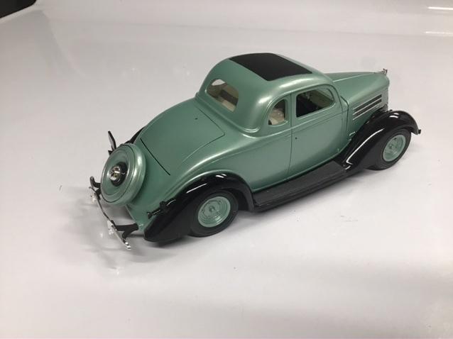

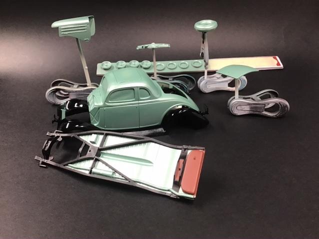

NOBLNG Posted October 4, 2020 Author Posted October 4, 2020 (edited) I’m calling this one done. I used epoxy to mount the headlight buckets since they seem to need to lean out a bit to clear the hood. The mounts molded to the fenders should have been slightly farther apart? I also made some taillight lens from clear red sprue because there were none in the kit. Under glass pics: http://www.modelcarsmag.com/forums/topic/156196-amt-‘36-ford/ Edited October 4, 2020 by NOBLNG 1
thatz4u Posted October 4, 2020 Posted October 4, 2020 Greg, nice work, color looks right for the car..
Kit Basher Posted December 26, 2020 Posted December 26, 2020 Very impressive work on the roof, the finished product looks great! For future reference on that Wicked paint, that's what it looks like if you put it on too wet. It's a peculiar paint, in that it has to be applied in multiple light coats until you get full coverage.
