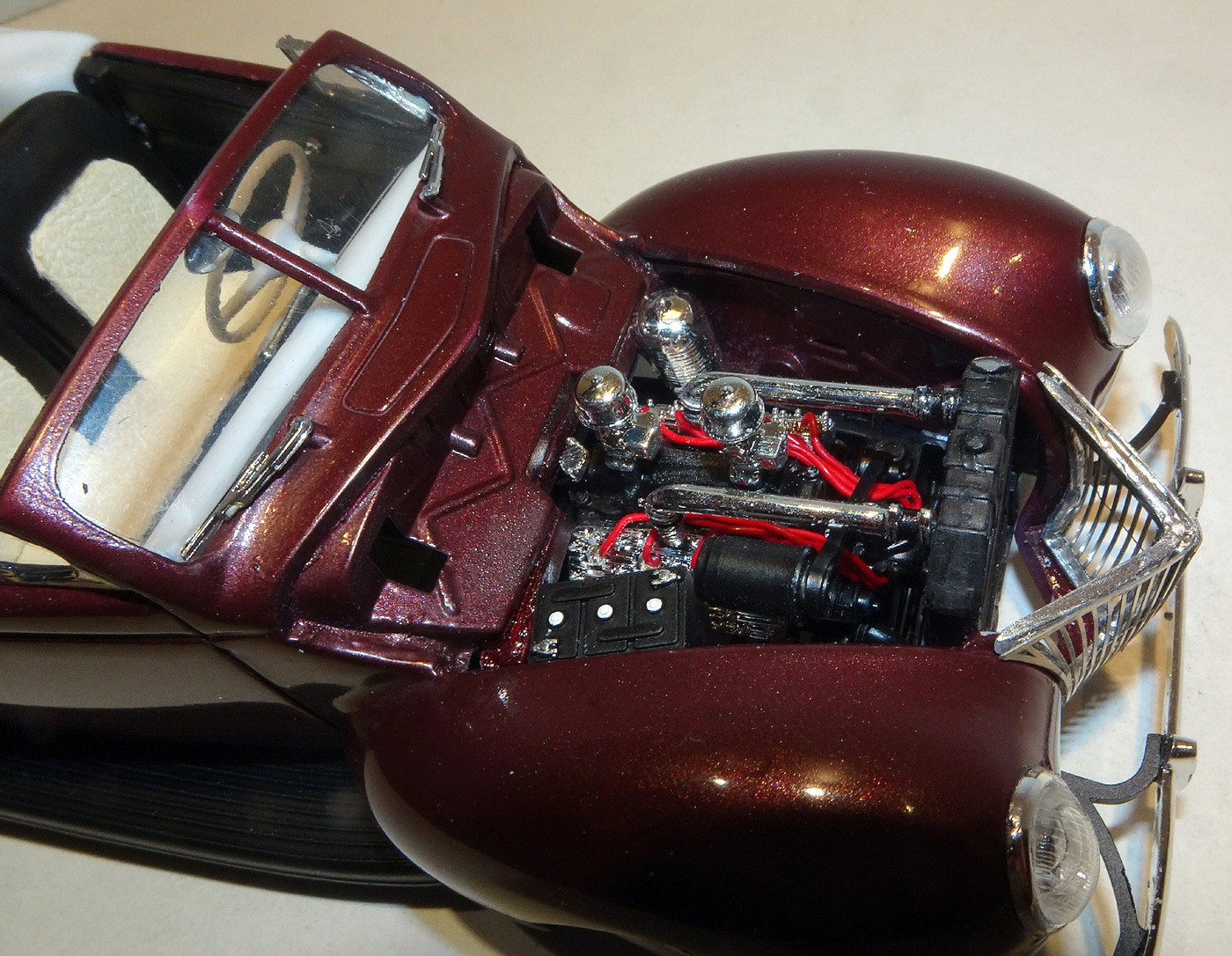

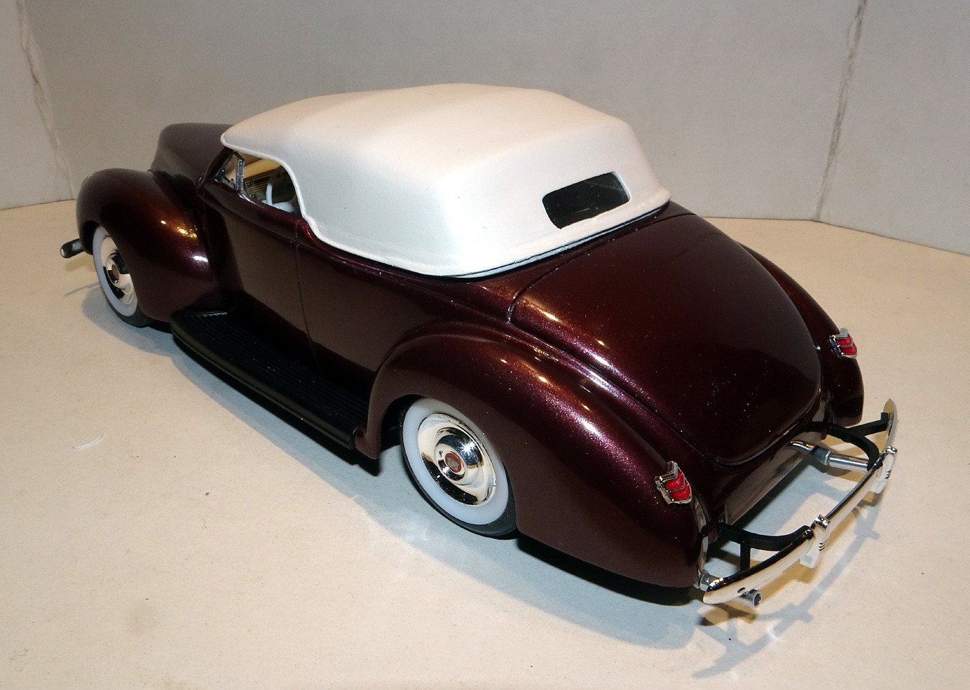

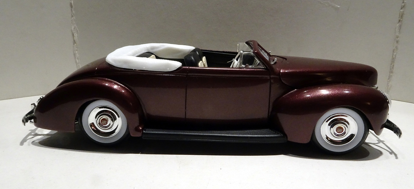

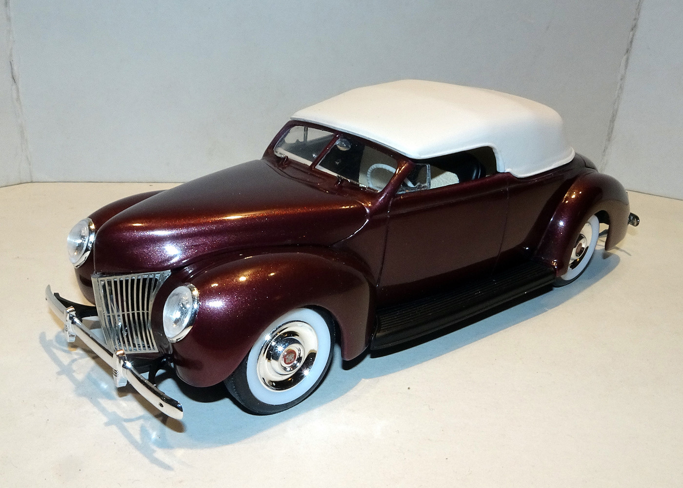

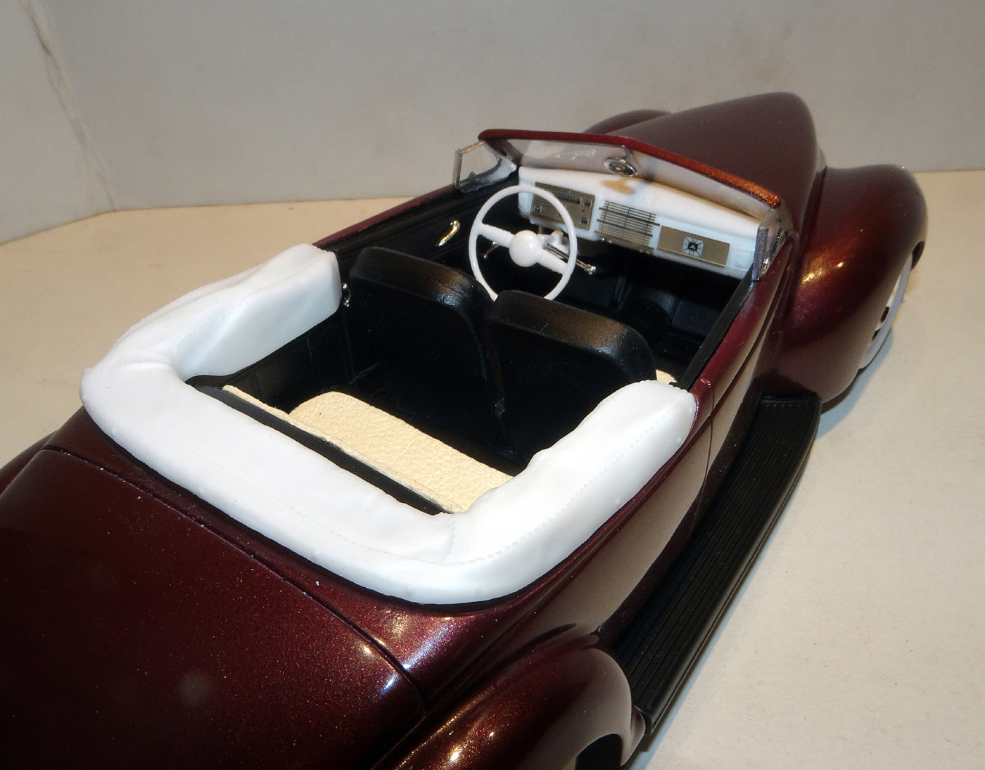

Phildaupho Posted June 21, 2020 Posted June 21, 2020 (edited) BODY - 1940 Standard front fenders and hood - Hood nosed and sectioned a scale 4 inches Model Car Garage ’39 Grill with ’40 Ford vertical center trim - ’37 Ford headlights - Body channelled a scale 4 inches then a 4 inch strip sectioned from bottom of body sides - Cowl sides sectioned a scale 4 inches below the belt-line - Rear fenders molded higher on the body - Body decked and shaved - Windshield frame and roof chopped a scale 4 inches - Wheelwells radiused INTERIOR - Sectioned scale 4 inches - Real white leather on seats - Model Car Garage photo-etch dashboard details RUNNING GEAR - Dropped front axle - Flattened rear cross-member - Stock rear end - Drum brakes - Tube shocks - C’d frame at rear - Wheels, white wall tires and Cadillac hubcaps from Revell ’49 Merc ENGINE - Flathead with kit chrome hop up parts - Dual exhausts with aluminum tips PAINT - Model Master Burgundy Red Metallic Enamel Edited June 21, 2020 by Phildaupho

Misha Posted June 21, 2020 Posted June 21, 2020 Nice work Phil! Really like the look of the body mods with the 37 headlights. The P/E grill is perfect, especially on the shot with the hood up. Congrats on a fine build! Cheers Misha

Phildaupho Posted June 21, 2020 Author Posted June 21, 2020 14 hours ago, Plowboy said: Nice looking '40 Phil! You don't see the the convertibles done very often. It's cool to see one done as a custom. Nice work! Thanks Roger 14 hours ago, mr moto said: I just love this and thanks for giving full details. Thanks Manuel. Because I almost always make modifications to models I keep a list as I go 14 hours ago, stitchdup said: sweet Thanks Leslie 13 hours ago, Misha said: Nice work Phil! Really like the look of the body mods with the 37 headlights. The P/E grill is perfect, especially on the shot with the hood up. Congrats on a fine build! Cheers Misha Thanks Misha. Originally I was going to use the '39 headlights from the AMT Sedan but the '37's are so much nicer. I have always been impressed with the photo-etch details from Model Car Garage. They can add so much realism to a model. 12 hours ago, Spottedlaurel said: That sounds like a lot of work, it's come out really well. Thanks Nigel. I thought it was going to more work than it actually was and I am pleased how it turned out. 7 hours ago, ChrisR said: Looks great! Thanks Chris 5 hours ago, PappyD340 said: Extremely nice, well done! Thanks Larry 1 hour ago, Dave Darby said: That's tasty! I'd say you nailed it. Thanks Dave 1 hour ago, espo said: Your list of modifications and extra parts used really helps understand what all went into this build. This is beautifully done as seen at first glance, but without the information provided it would be hard to fully appreciate what all you have done. Thanks David - I really like this format of listing the details which was used by the Rodder's Journal for a number of years.

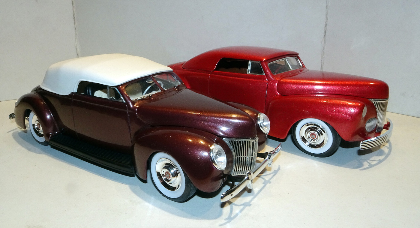

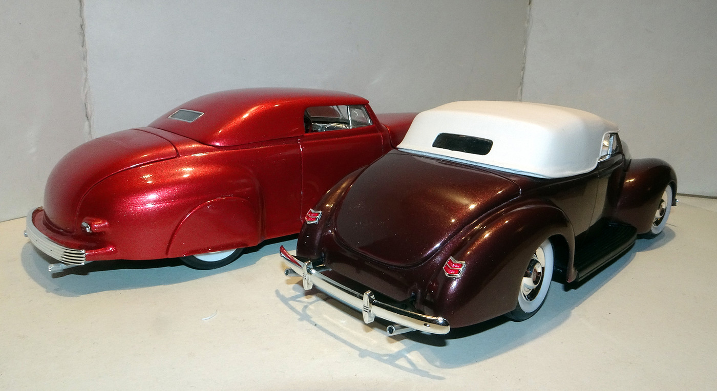

Phildaupho Posted June 22, 2020 Author Posted June 22, 2020 4 hours ago, hedotwo said: Lots of work went into this one! Looks super! Thanks Rich - Here is the 40 with another early style custom - this one a channeled 41 with a chopped hardtop
thatz4u Posted June 22, 2020 Posted June 22, 2020 nice old schooler, where did you get the "Carson" uptop???
Phildaupho Posted June 22, 2020 Author Posted June 22, 2020 33 minutes ago, thatz4u said: nice old schooler, where did you get the "Carson" uptop??? Thanks Al - The "Carson" uptop is actually the kit convertible soft-top that I chopped below the rear window and smoothed out a bit.
