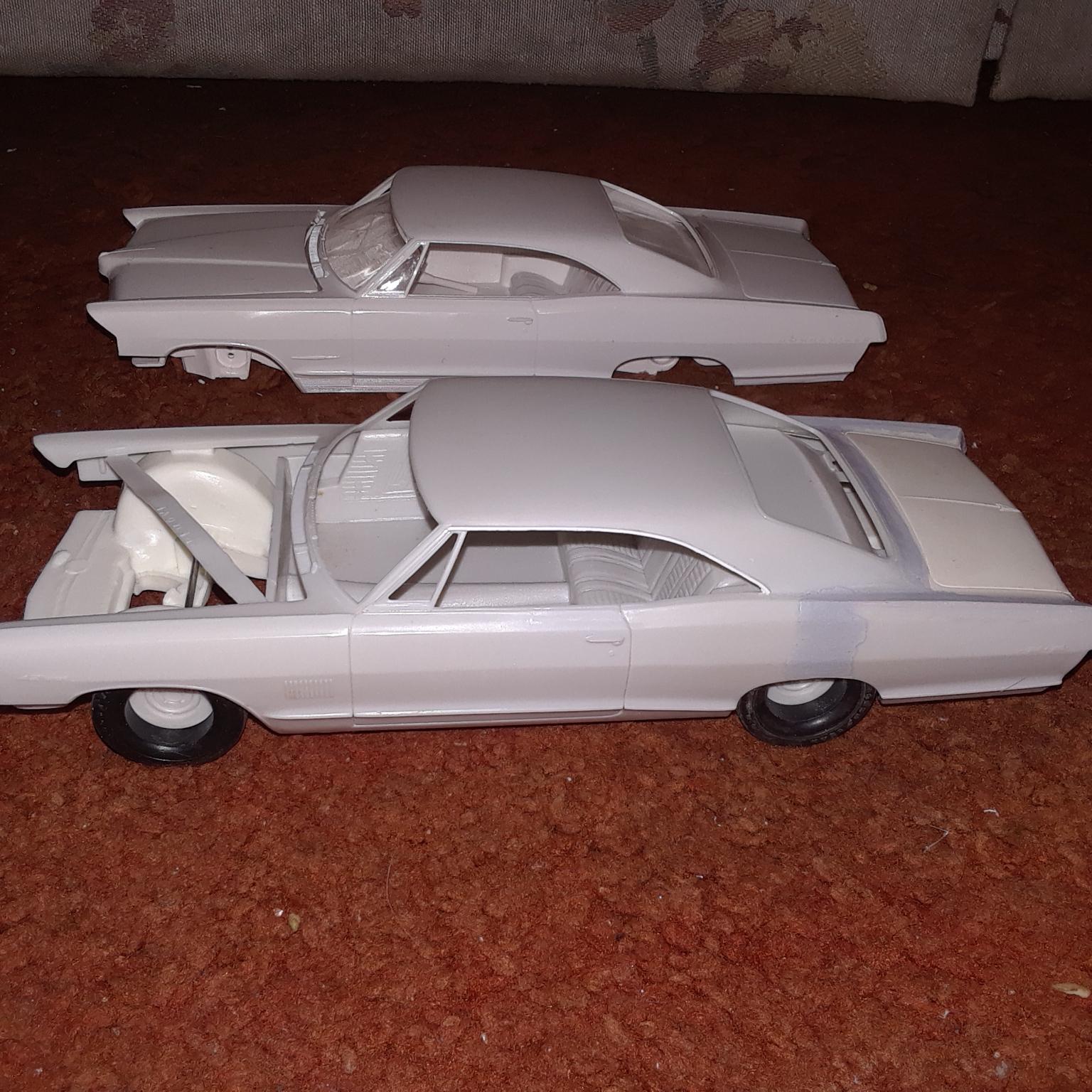

The design of the tool would make changing that side window opening pretty tough, if not impossible.  I know, you shouldn't have to do it, but it really isn't tough to fix.  No material needs to be added to the roof other than some strip styrene (.020" square IIRC) after filing off the original drip rail and fixing the opening based on a template of the other side.  I did two of them a while back, one custom Bonneville and one corrected (shortened) 2+2.  Still need to get to the stock Bonneville.

What I did first was to remove the existing drip rail on the driver's side.  I took off only the horizontal part from the top of the vent window all the way back to the quarter panel.  I left the vertical section at the front of the vent window.  Sand the area smooth afterwards.
I then made a template of the passenger side window opening, and transferred it to the other side.  The driver's side opening is then opened up to match the other side (as I recall, a small amount of material is removed, rough location of the work is just above the door seam).  You could replace the drip rail and then rework that area).  In fact, I may have done the second one that way.
For the drip rail, start with a full piece of strip styrene (or a partial piece that is longer than needed).  I started attaching it at the rear and worked forward, using CA glue and only attaching where necessary.  I bent the strip as I went, if I didn't like what I saw I would undo the previous step and do it over.  After the strip is in place, and you like the way it sits, you can then attach it fully.  I trimmed off the overhang at the front after everything was in place.  If I remember, I'll post a picture of one of them later today.
Stock Bonneville (top), corrected/shortened 2+2 (bottom).  Still need to recut the rear wheel openings on the 2+2.
I've never seen anyone correct the asymmetrical drivers side window opening on one of these '65 Pontiacs.  Very impressive and the replacement styrene strip looks like it would be easier to foil than the original trim molded into the model.

Mark,
Thanks for the detailed information and photo.  As I recall, the Bonneville had a 124" wheelbase, and the GP/Catalina had a 121" wheelbase, and the conversion to a 2+2 kit didn't correct for that.  You did a great job on the window area.  It looks like you removed the quarter panel to shorten it.  Did you also shorten the area between the trunk and rear window?  I think the 2+2 kit had fender skirts, but that wasn't a standard feature on that car.  I wonder if the interior pattern was changed from the Bonneville.
The 2+2 conversion/correction involves shortening the body through the quarter panels.  The vertical cut is made at the high point of the arc at the top of the quarter panel, on my car you can see where the primer is dabbed over the bodywork done at the join.  The tulip panel (between the base of the rear window and the top of the trunk opening) is not shortened.  The difference in length at the back is all in the trunk lid; the Bonneville and Catalina have different trunk lids.
I cut the trunk lid area out of the Bonneville "2+2" and substituted the trunk lid area from a Grand Prix body.  The GP kit body is very minutely wider than the Bonneville body (1:1 should be the same width).   The GP taillight panel is taller than the Bonneville's (again, shouldn't be) so the GP trunk lid doesn't wrap down at the rear as much as it should.  That all has to be fixed, but I figured that was easier than trying to shorten the Bonneville deck lid and recut the panel lines.
Step one was to lay out the cuts.  The cut across the body (between the rear window opening and deck lid line) was made as close to the latter as possible.  The deck lid area was not cut out first, the quarter panels were cut loose and shortened first.  Care must be taken to keep the body side creases straight, you don't want the quarter panels drooping or rising up towards the back.  As you can see, the rear wheel openings are dealt with later.
Once the quarters are shortened, lined up, and reattached, the GP deck lid is trimmed and fitted.  You do need to use the Bonneville rear bumper to help line things up.  I used a junk one so as not to have to handle the good one and mess up the plating.
Once everything is squared up and reattached, you will be left with a gap between the trunk lid and the top of the Bonneville taillight panel.  I added pieces in to fill the gap.  The 2+2 emblem on the deck lid was lost in the process.  Unfortunately MCG never offered a photoetch set for the 2+2.
If you do the measurements and cuts correctly, the GP chassis will fit and is correct for the wheelbase and length of the 2+2.  I'm still hashing over what to do to the 2+2 kit's taillight panel.  The kit piece is just the Bonneville unit minus the lettering.  The taillights should be shorter, and Pontiac lettering added.  A MCG photoetch set for a GTO or Firebird can probably supply the lettering.  As for wheels, the 2+2 will likely get the set of dog dish caps that I bought from Fireball with the idea of using them for a GTO.  This thing is finally taking shape, it has been in the planning ever since the 2+2 kit was released.
