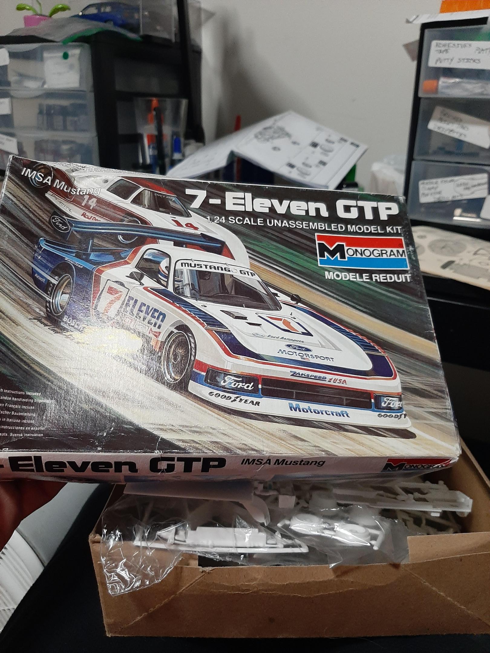

disconovaman Posted January 18, 2021 Author Posted January 18, 2021 On 1/18/2021 at 3:39 PM, Fat Brian said: I spent $60 on the black Mustang before realizing it had a different body than what I wanted, $40 on the Mustang GTP for the 4 cyl engine, then another $25 to get the right kit with the body I wanted Expand Well that's good to know I'm not the only one spending money for this CBR. I don't know why I needed a new kit Why couldn't I just pull from my stock pile and be happy? nope not me! One of our club members joined the group for this Challenge... ChineseRandy he wants to join with the IMSA Mustang so that should be interesting lol And as for your car Snake, I know you always seem to find the deals!

Fat Brian Posted January 18, 2021 Posted January 18, 2021 On 1/18/2021 at 6:46 PM, disconovaman said: Well that's good to know I'm not the only one spending money for this CBR. I don't know why I needed a new kit Why couldn't I just pull from my stock pile and be happy? nope not me! One of our club members joined the group for this Challenge... ChineseRandy he wants to join with the IMSA Mustang so that should be interesting lol And as for your car Snake, I know you always seem to find the deals! Expand That's the kit I bought to borrow the engine from, I'm probably gonna throw the v8 from the kit I'm building in it if I ever build it. I started to do a 71-73 Mustang from the MPC/AMT that's been out recently I have laying around but after looking it over I'd want to replace so much of the chassis it really didn't fit the spirit of the challenge in my mind.

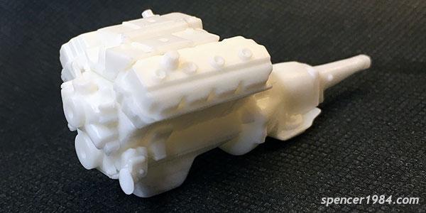

spencer1984 Posted January 19, 2021 Posted January 19, 2021 Wow, awesome progress guys! Also, Snake - "Stupidbird" has become one of my new favorite car names ? Looks like I have to make up some miles, so I better start getting some horsepower pulled together. 1964 was the first year for Chrysler's new 426 Hemi, and it proved its power and reliability right out of the gate by taking the top three spots at that year's Daytona 500. Comparing an AMT '64 Petty Belvedere engine to the one in the Lindberg Dodge, the biggest visual differences are the intake and oil pan. I kept the cross-ram intake (lousy fit and all), but modified the oil pan to a deep sump style.

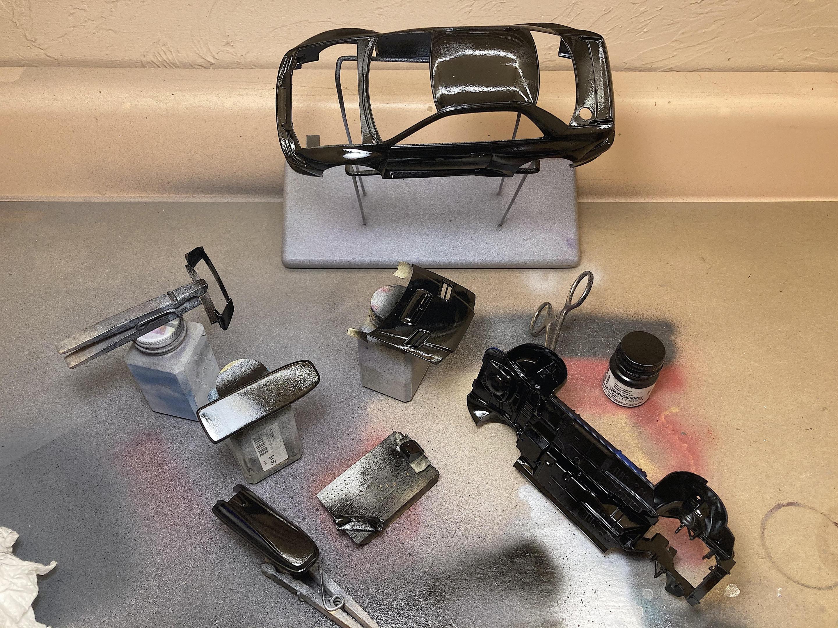

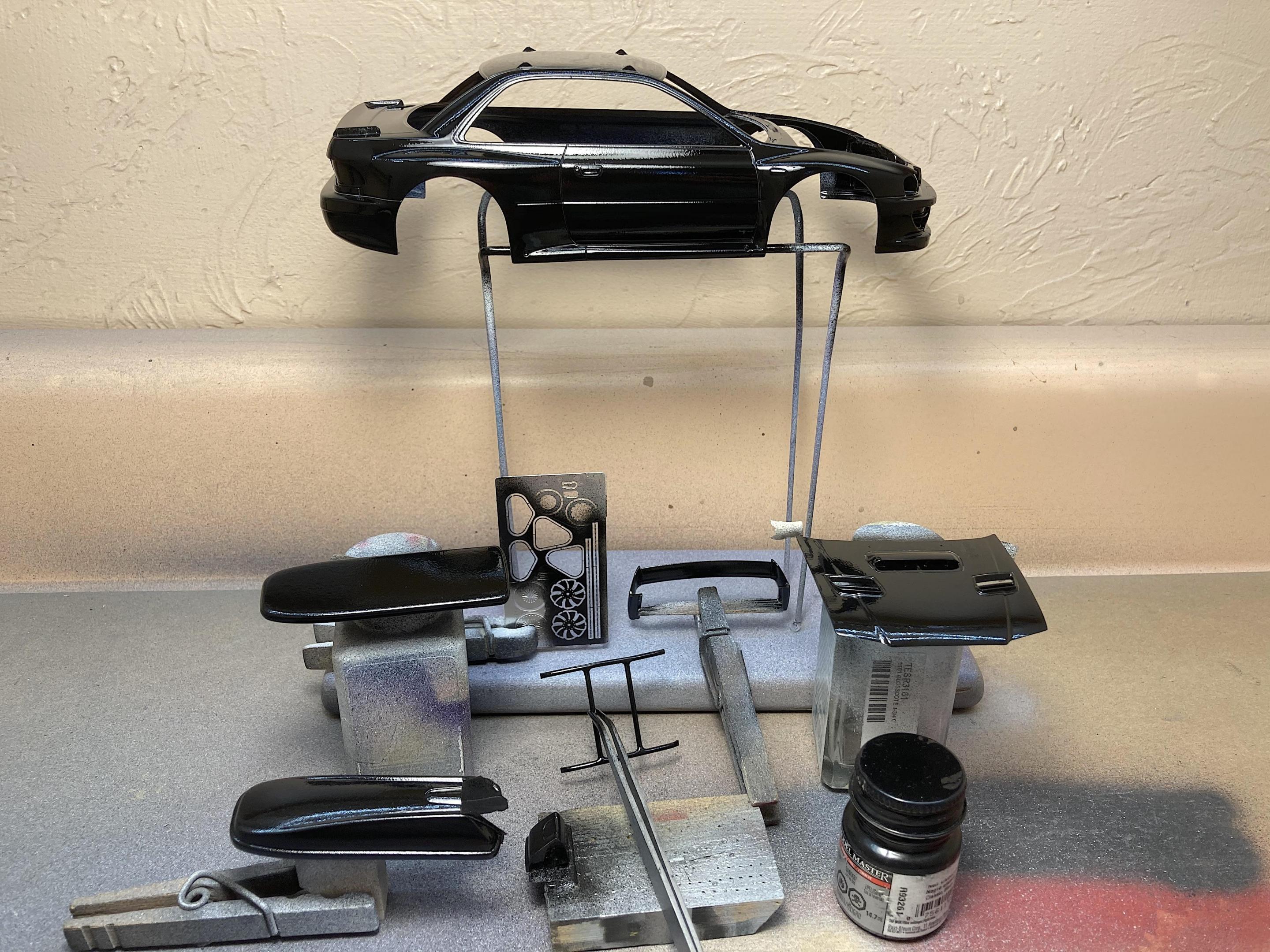

89AKurt Posted January 19, 2021 Posted January 19, 2021 #11 checking in. Covered up the beautiful mica blue. Debating on a coat of clear pearl, or Dullcote. The wheels will be aluminum.

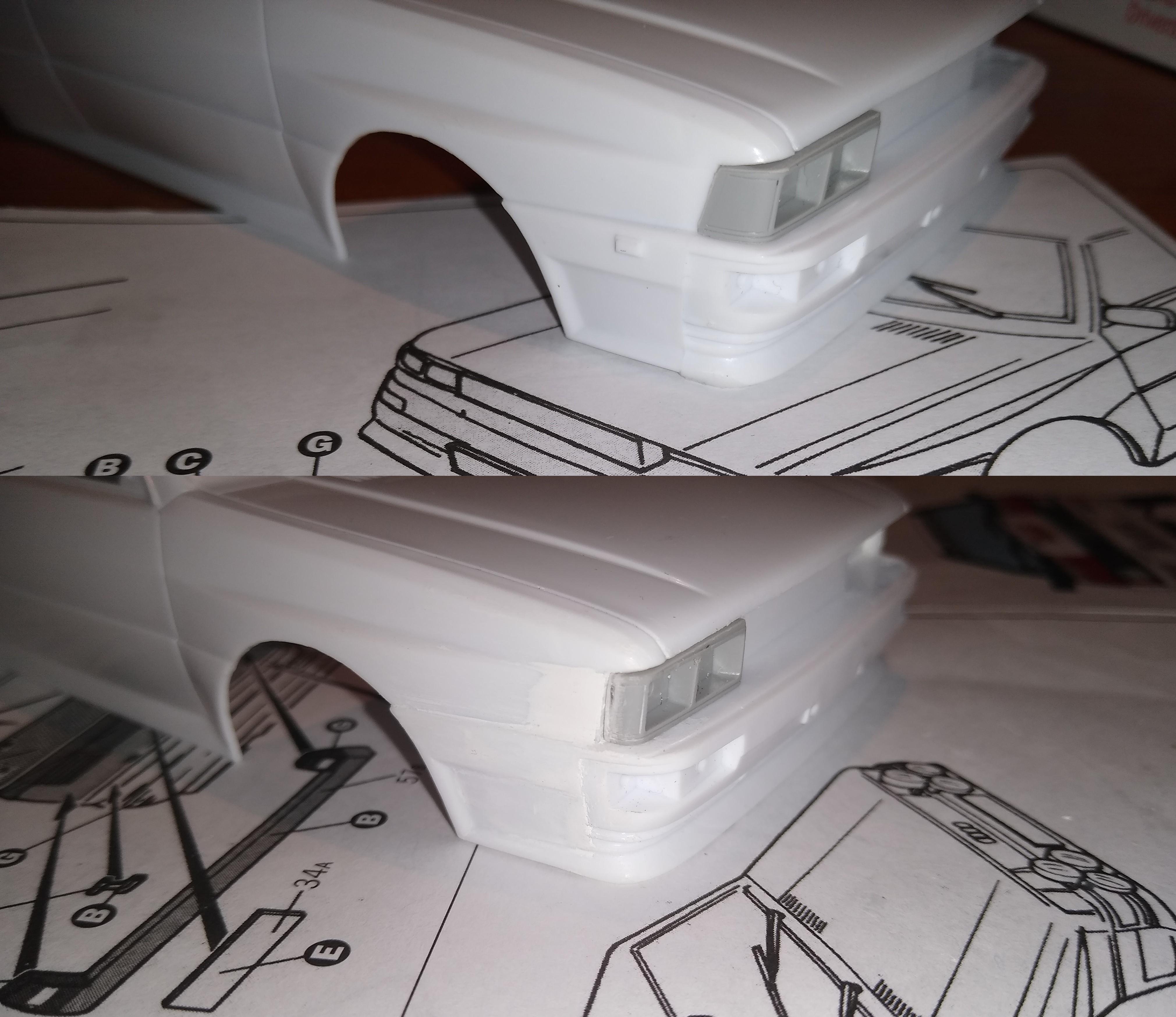

Pete75 Posted January 20, 2021 Posted January 20, 2021 #5 - Audi Quattro Made some adjustments to the front end for the sake of faithfulness rather than the brief per se. The kit indicators are too fat and the bumper recess is set too far rearwards, so I cut down the light units and filled the recess/grooves with plasticard, which was then shaved & sanded back. The remaining gaps were filled with Milliput: Also had fun building a central console to go under the dash (omitted in the kit). The holes have been drilled ready for some photo-etch toggle switches and cable for a CB radio handset; breaker breaker watch out for them smokeys! ?

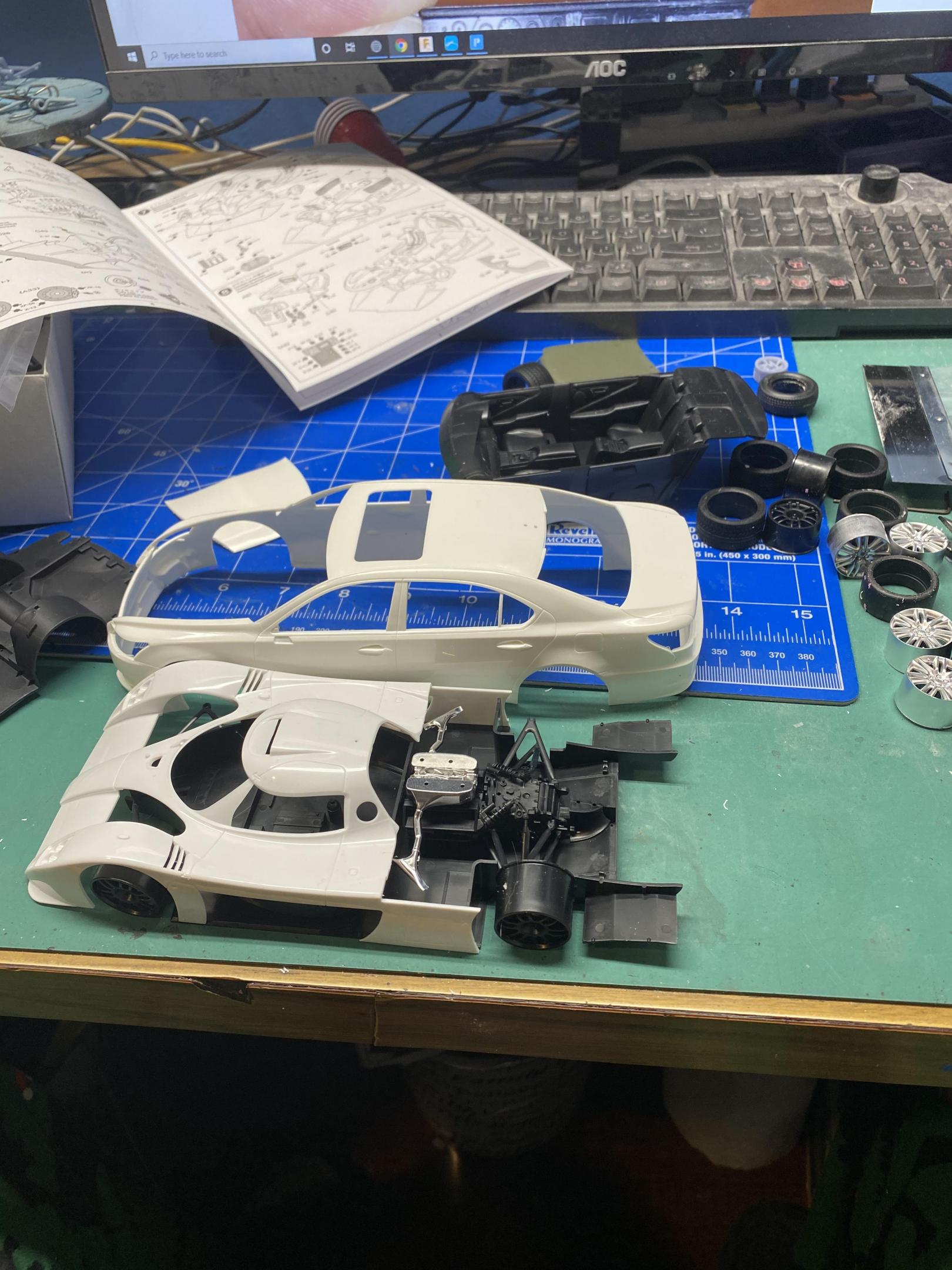

Northwindcustoms Posted January 20, 2021 Posted January 20, 2021 A update I got some time to work on this build I cut the hood out of the Lexus . I am coming to the first of many roadblocks on this build I chose the L version of this in hopes that I could mid engine it but I am running in to a air flow issue for this racing engine behind the seats. I have come up with a couple of options use the mono seat out of the race car and extend that chassis . Not really what I want to accomplish with this build. I can front mount the engine and use a torque tube to the trans axle and would have a full interior this way but would have to re work all the turbo parts . This way would look really stealth but would be hard to show off what I did . Or the third option cut everything in to pieces and hope it all turns out the way It looks in my head . This is the way I am leaning

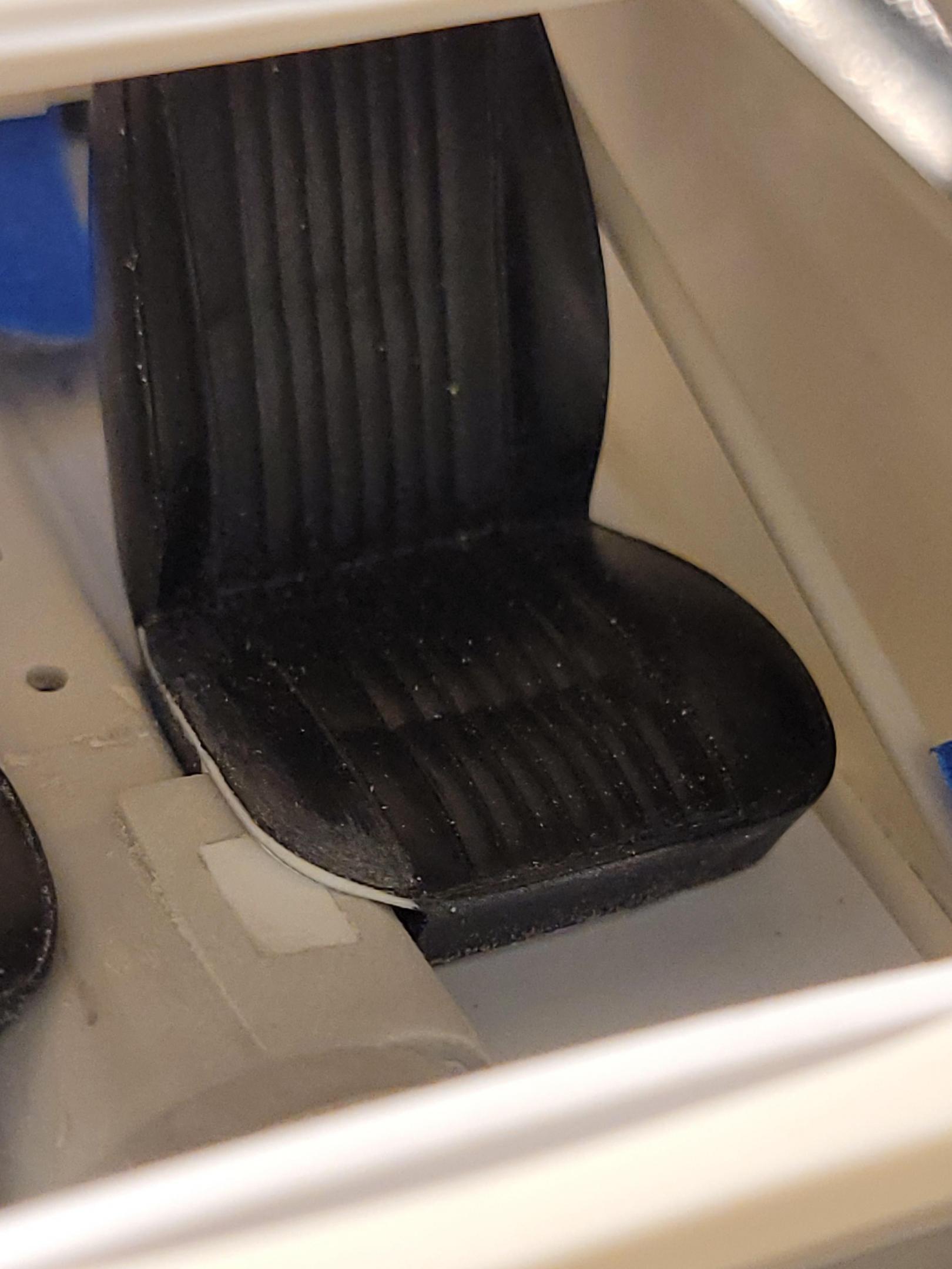

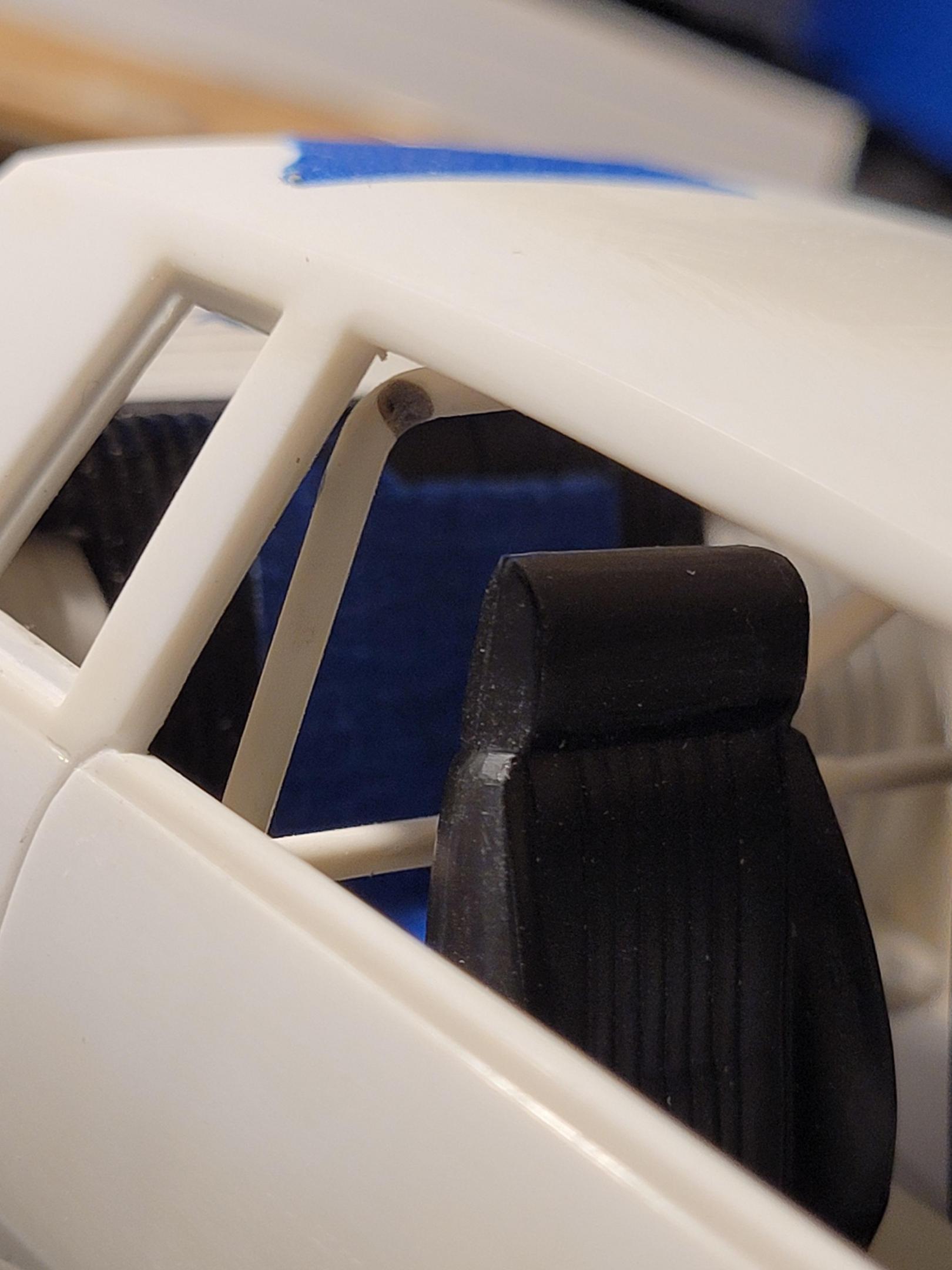

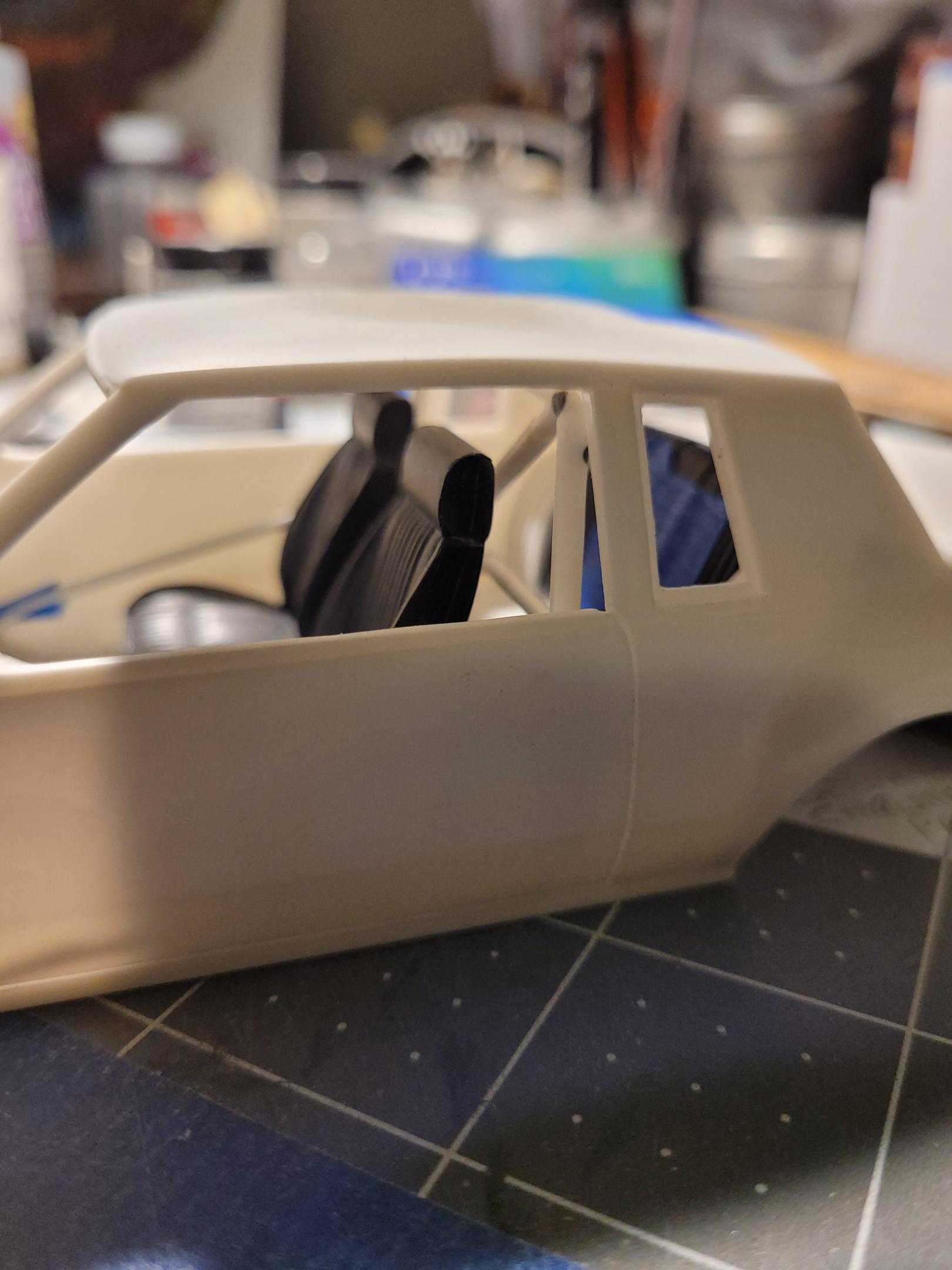

Pat Minarick Posted January 20, 2021 Posted January 20, 2021 Got the roll bar built and hidden pretty good. Still need to add rear downbars.

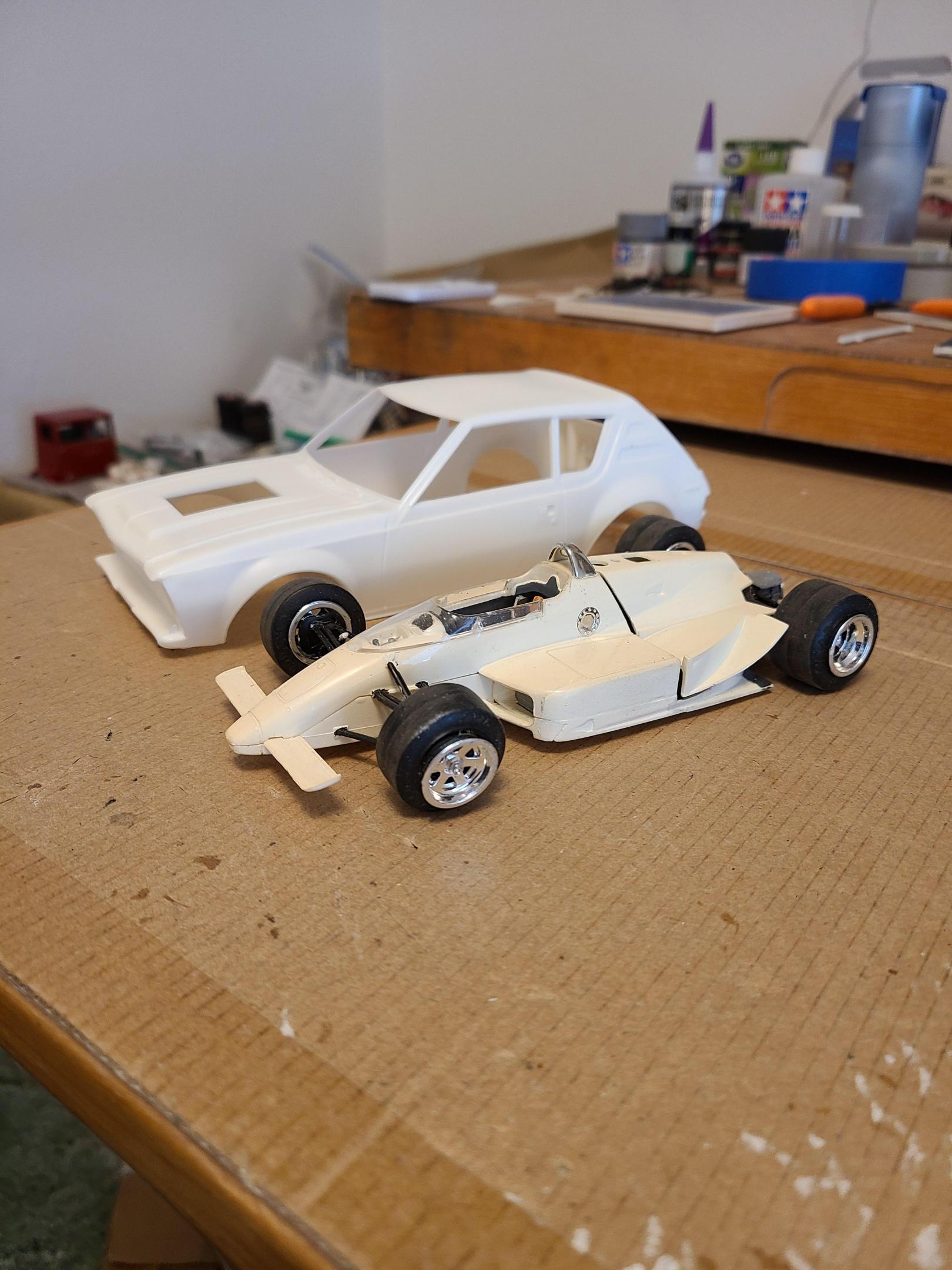

Sam I Am Posted January 20, 2021 Posted January 20, 2021 Ok, I have the rest of my parts in. I did some trading for a complete kit and extra decals, etc. I even ended up with an old build-up that is great for mock ups. So I will be changing out the Mustang body for this. I was looking through the stash for an unrelated build and came across this basic builder Gremlin....the perfect disguise!

89AKurt Posted January 21, 2021 Posted January 21, 2021 On 1/20/2021 at 5:11 AM, Northwindcustoms said: A update I got some time to work on this build I cut the hood out of the Lexus . I am coming to the first of many roadblocks on this build I chose the L version of this in hopes that I could mid engine it but I am running in to a air flow issue for this racing engine behind the seats. I have come up with a couple of options use the mono seat out of the race car and extend that chassis . Not really what I want to accomplish with this build. I can front mount the engine and use a torque tube to the trans axle and would have a full interior this way but would have to re work all the turbo parts . This way would look really stealth but would be hard to show off what I did . Or the third option cut everything in to pieces and hope it all turns out the way It looks in my head . This is the way I am leaning Expand Looks like that engine package would fill the rear seat area without much effort. The front half of the interior with a firewall/window, back windows can be rolled down according to temperature. I would draw out both cars on sketch paper, basic blocks, floor plan and elevations (I draw house blueprints), then hold up to a window like it's a light table, and see how everything meshes. I have the major components that required scratch-building done, started painting the chassis. Going with murdered out black look. Screwed up the paint a little, might just give it a patina look, with rust decals from the '29 Model A Roadster kit, a different sort of camouflage than what the factory does for test mules.
Lunajammer Posted January 21, 2021 Posted January 21, 2021 On 1/20/2021 at 5:11 AM, Northwindcustoms said: A update I got some time to work on this build I cut the hood out of the Lexus . I am coming to the first of many roadblocks on this build I chose the L version of this in hopes that I could mid engine it but I am running in to a air flow issue for this racing engine behind the seats. I have come up with a couple of options use the mono seat out of the race car and extend that chassis . Not really what I want to accomplish with this build. I can front mount the engine and use a torque tube to the trans axle and would have a full interior this way but would have to re work all the turbo parts . This way would look really stealth but would be hard to show off what I did . Or the third option cut everything in to pieces and hope it all turns out the way It looks in my head . This is the way I am leaning Expand Your heart's in the right place, but don't let it give you a heart attack that tosses out the fun along with an unfinished build. I did this Cruiser for the CB a couple years ago with the body on an Audi R8 Chassis. I'm sure a serious car guy could pick it apart, but I stayed centered by sacrificing technicalities for fun. Of course it's never won anything either, but winning isn't everything (says losers ?).
