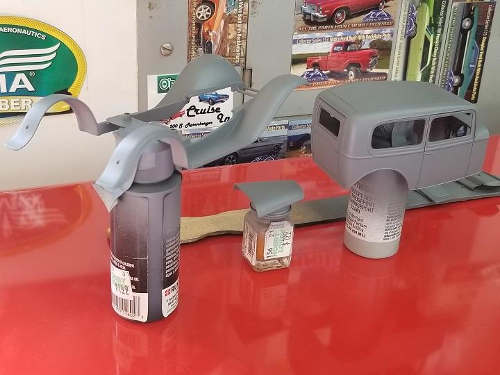

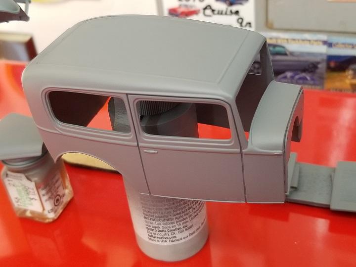

Zippi Posted October 12, 2021 Author Posted October 12, 2021 Ok....finally got the 32 Sedan in primer. Looks like rain for the next few days so not sure when I'll get the top coat on.

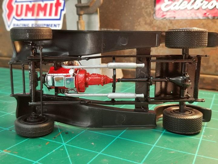

Alan Barton Posted October 12, 2021 Posted October 12, 2021 (edited) You are doing well with this sedan Bob. If you want to get it lower I would look at bending a piece of K&S aluminium tubing to the shape you want and then inserting the MPC plastic axle ends into it - that should get you lower without having to buy another kit. I don't think it is as easy as ranking model companies in order of quality. I have built hot rods from every company imaginable and some are good, some are not so good. Quality is a tough value to describe. Early Revell hot rods had some of the finest detailed parts ever put in a kit but pity help anyone who tried to assemble them! Tamiya produce superb kits with outstanding engineering but I have exactly one in my collection because they don't do the cars I love, and they don't do engines. Monogram do terrific hot rods but some people don't like 1/24th and the Beachboys 3 window coupe was an eyesore! AMT really kicked off the whole hot rod thing but their 34 Tudor was drawn up by someone who was legally blind. The Switchers kit wasn't MPC's finest hour but if you ever get the chance to build an AMT 28 Tudor, actually designed by MPC, it is one of the most delicately yet accurately presented hot rod kits of all time. And some times, with the best model kit in the history of model kits, you personally will screw up and not get the result you planned for! It's just the way it goes. Never be afraid to ask the guys on this forum for tips and tricks about any kit you are looking at buying - the knowledge pool on this board is amazing! Keep up the good work! Cheers Alan Edited October 12, 2021 by alan barton 1

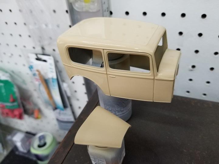

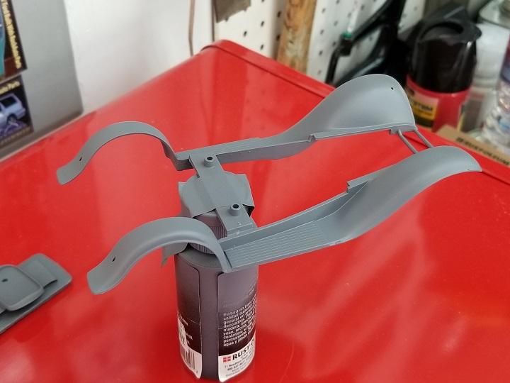

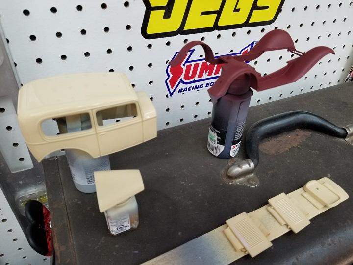

Zippi Posted October 14, 2021 Author Posted October 14, 2021 Ok....the humidity got down below 70% so I got the airbrush out. Started with the fenders and shot some Anita's Burgundy and it came out great. After cleaning out the airbrush I started painting the body parts and after a second coat I knew something wasn't right. The paint looked spotty so I stopped. I used the same process and all parts had the same primer. I ditched Anita's Vanilla Cream paint. I have another color that's a little darker so I'll give that a shot.
Zippi Posted October 14, 2021 Author Posted October 14, 2021 (edited) Didn't see it in the primer so I'm assuming it's the paint. Looks like lepros ☺ Edited October 14, 2021 by Zippi
TooOld Posted October 14, 2021 Posted October 14, 2021 16 minutes ago, Zippi said: Didn't see it in the primer so I'm assuming it's the paint. Looks like lepros ☺ Too bad about those spots . I had something similar happen when somebody sprayed air freshener in through a doorway , never saw it until I started painting .
Can-Con Posted October 14, 2021 Posted October 14, 2021 That's not all that bad Bob. Just give it a good scrub with Comet or something similar, maybe a going over with some 3600 grit wet sandpaper and give it a nice couple mist coats followed by a couple wet coats, letting dry between coats, of cores, and I think you'll be pleasantly surprised with how it turns out.
Zippi Posted October 14, 2021 Author Posted October 14, 2021 (edited) Ok fella's, dodged a bullet on this one. I let the acrylic paint dry for about 45 min then I went of it with 2000 grit, cleaned it off, airbrushed a little darker color. It's still a little wet. Once it cures out it will look fine. I like it. Edited October 14, 2021 by Zippi
Zippi Posted October 14, 2021 Author Posted October 14, 2021 Thanks Steve and Carl. I need to let the paint cure for 24 hrs the clear coat, wet sand, and polish.
