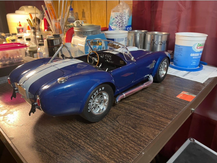

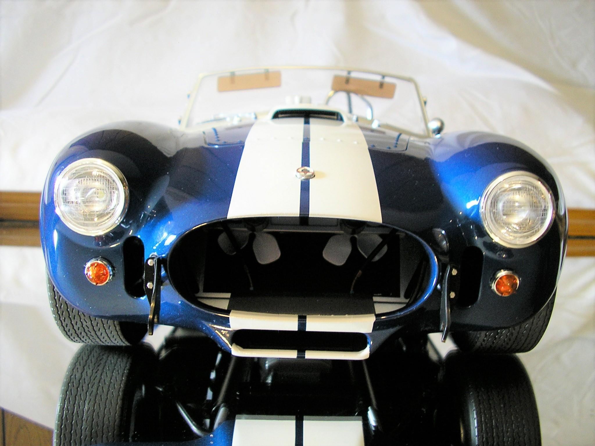

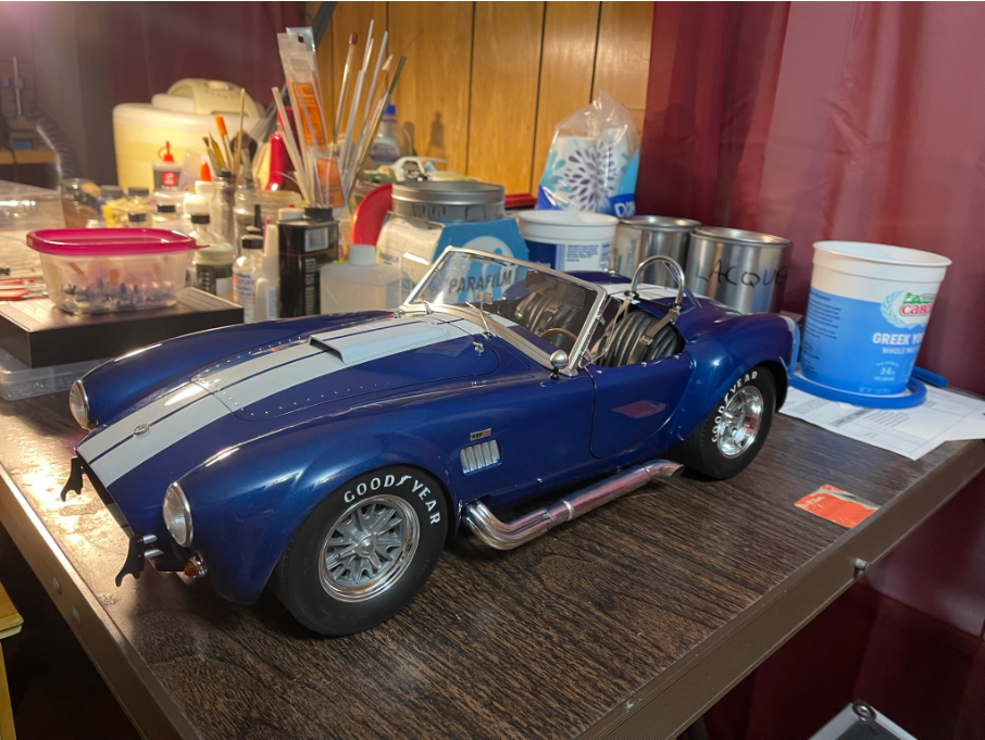

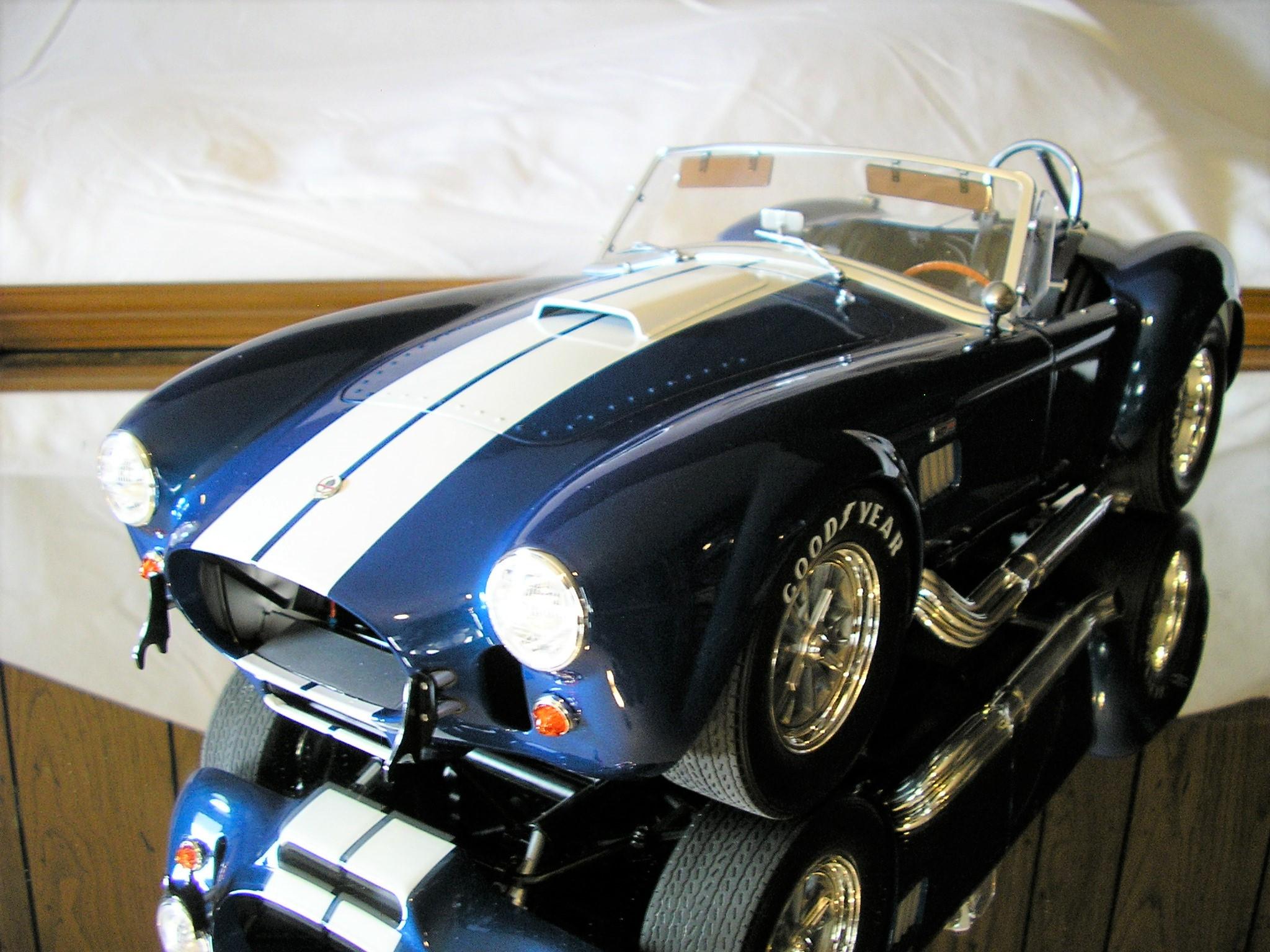

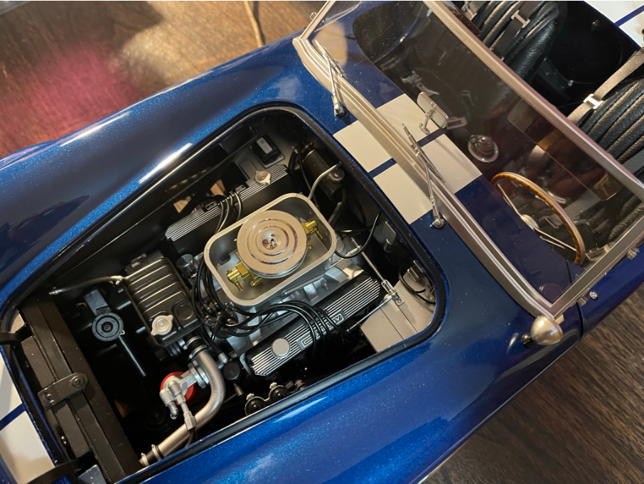

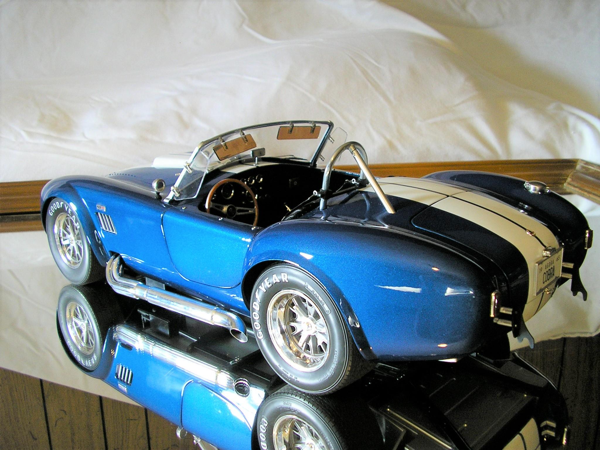

MrObsessive Posted December 5, 2021 Posted December 5, 2021 (edited) I've had this finished for a bit, but due to its size and the kind of lights I have, it's difficult for me to get halfway decent pics as opposed to my little "studio" setup I have for the much smaller stuff. Anyway, here are some pics of what she looks like now. As I've mentioned before in other threads, kits like this are not for the beginner at all and dare I say, they're geared more to the advanced builder as there are certain skills you'll need to deal with different assembly issues. Screw together construction notwithstanding...........there were steps that were particularly difficult to get done. While the sun was shining bright in the room, I figured I'd better take advantage of the morning sun and grab a few pics. Here are a few just as it was pretty much done on my work table.......... My attempt as some "beauty" shots. OK.............now it's back to "normal" in building the 1/24-1/25 cars! I do have parts now coming in for Agora's 1/8 1961 Jaguar E-Type convertible, but I need a break from the big scales for a bit and it'll probably be some time before I get started on that. Thanks for looking! Edited December 5, 2021 by MrObsessive 6
cobraman Posted December 5, 2021 Posted December 5, 2021 Looks great ! Can you share what it was that was the most problematic with the assembly ? Thanks
MrObsessive Posted December 6, 2021 Author Posted December 6, 2021 5 hours ago, cobraman said: Looks great ! Can you share what it was that was the most problematic with the assembly ? Thanks At some point, you'll need to attach the coupling that connects the two steering rods. Just like in the actual car, you have a "middle" connection that attaches the two. They don't mention this in the instructions until after the fact, but you'll want to make sure that the pin is threaded and partially through before going any further. I don't remember which step it was, but that's one of the pitfalls if you want the steering to function with the steering wheel. Keeping the coupling between the headers was tricky. You'll definitely want to have some needle nose pliers at the ready. Another is the electrics. LOTS of wiring to deal with that have to be tucked inside the transmission tunnel, and this is where you have to check, check, and double check to make sure you don't have any trapped/pinched wires when it comes time to mate the chassis to the body. Any packaging you'll get when it comes to the body parts, I strongly suggest you keep and not throw out. In my case, since this was a partwork, you can literally have items sitting for months before you use/attach them. One example was the hood. That was the first thing they sent, but it would be about six/seven months before I attached it to the hinges and body. You're going to be turning this thing upside down............a LOT. They sent the body in the 11th pack encased in two styrofoam halves. I recommend you keep those as you'll need them to rest the body on to keep the windshield frame intact as you build up the chassis and undersides. The frame is solid metal, but the weight of the body along with any movement in the wrong direction could break it. There are some other foibles too during the construction........I recommend following the instructions to a T! Any missed steps can have you taking things apart all over again as certain things cannot be attached/placed after a certain point. If you run into trouble, drop me a line and I'll try to help where I can. 1 1
