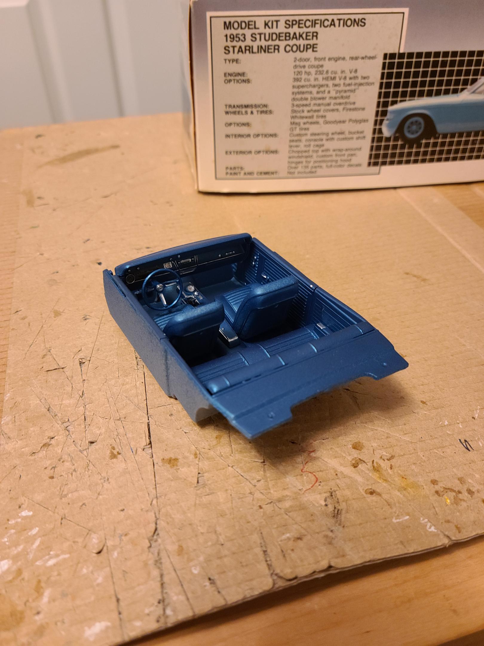

Lots of great work going on here. Both finished as well as progress.
I finally have an update. The interior is wrapped up. I need to polish the glass and hope the glue marks are not visible or I will need replacements.
Bmf is my nemesis. I need to foil four projects that are stalled because of that.

Nice interior and good looking shade of. blue!

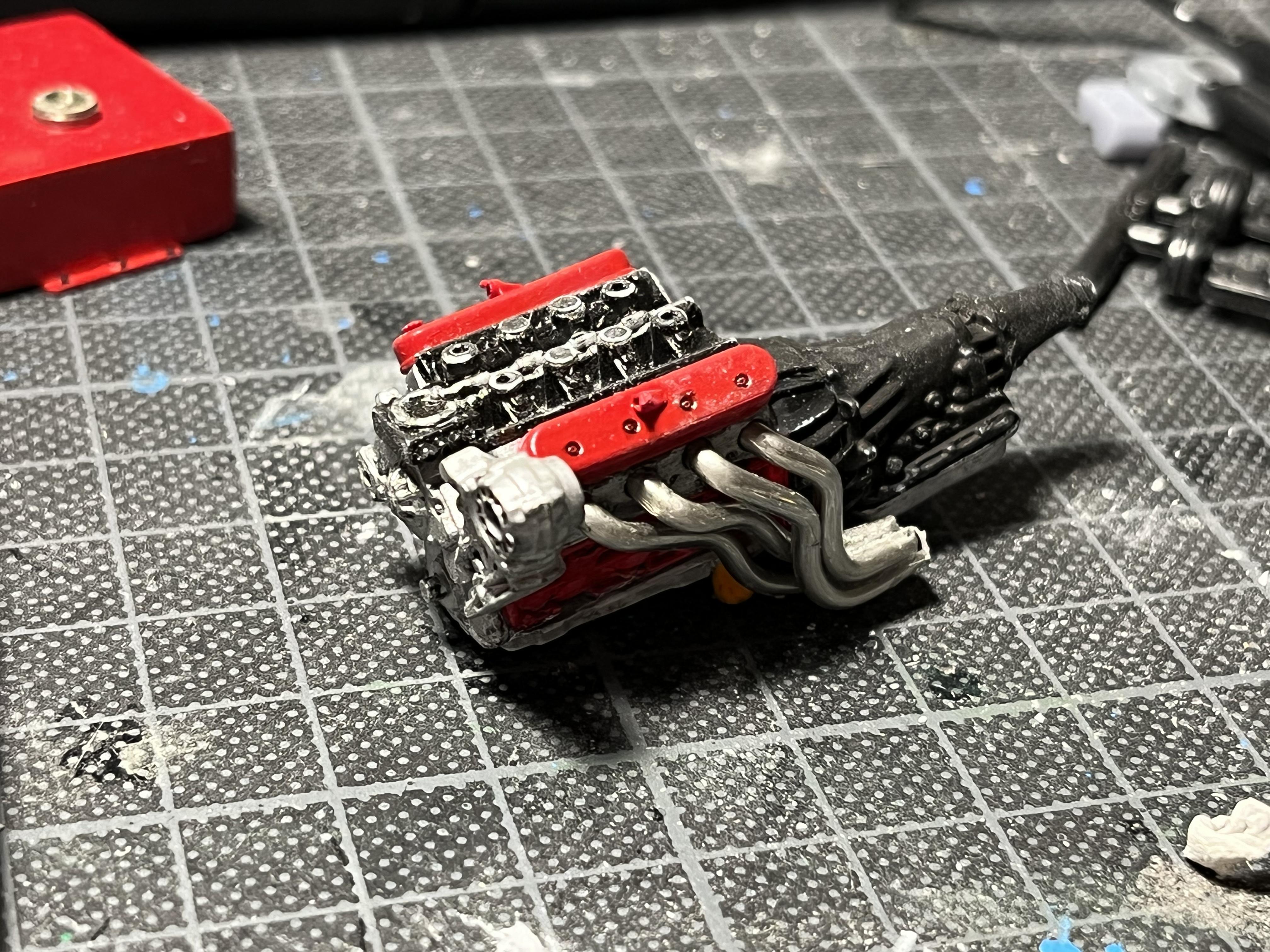

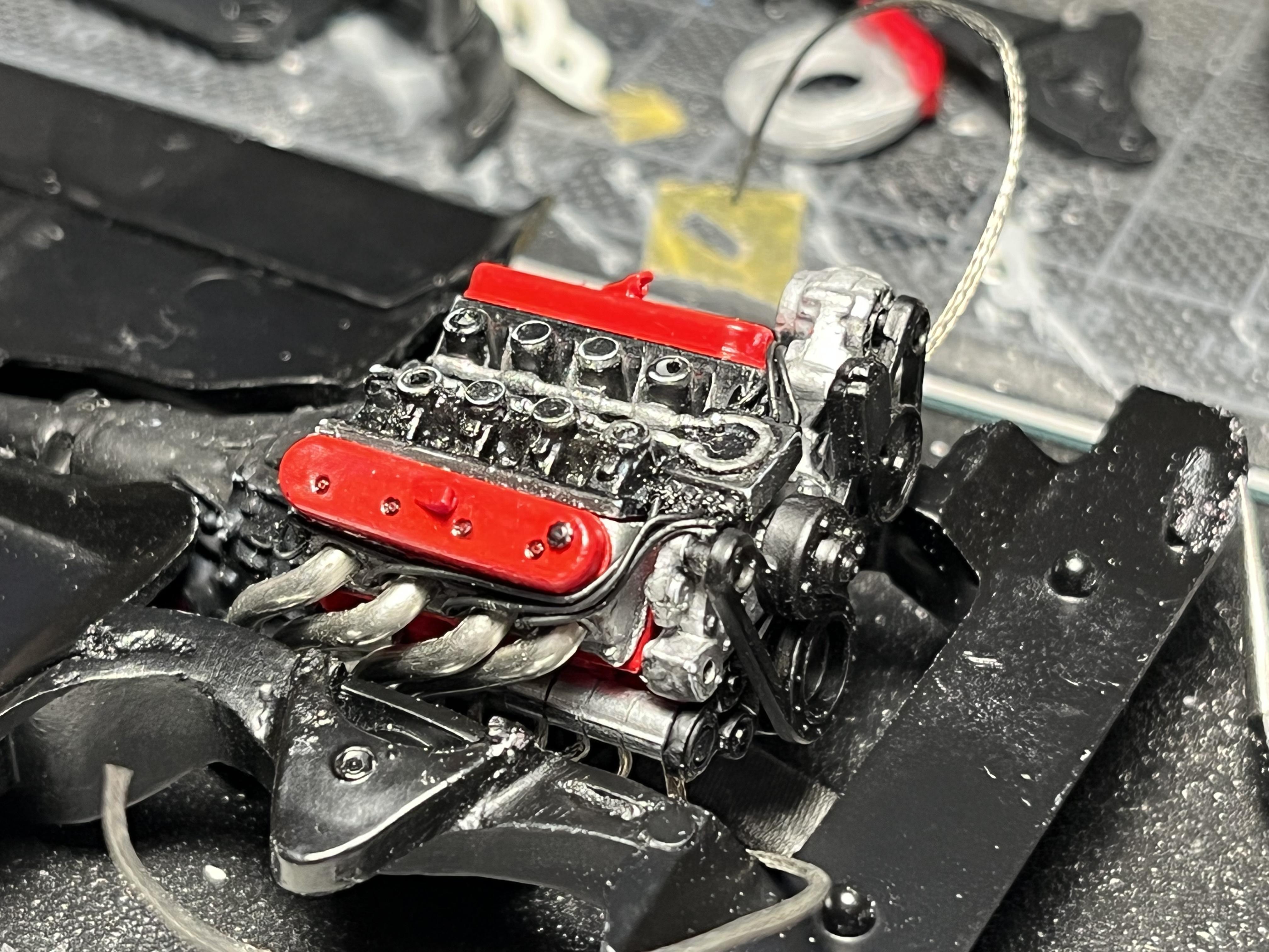

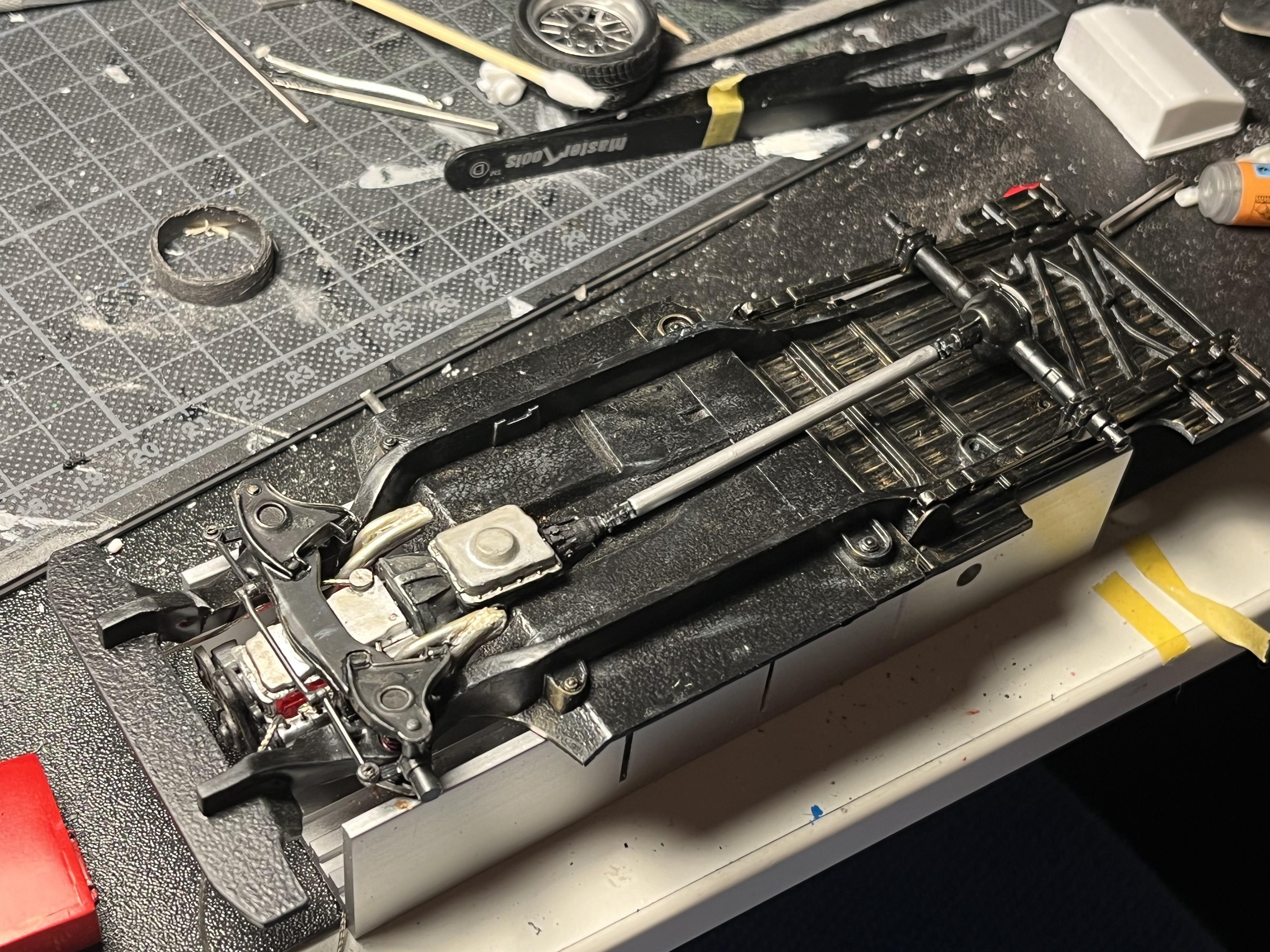

Some progress to #1 the 1987 All new GM 1500. So tonight the LSX454 got some headers. Still need some finishing touches as paint and weathering. Also the wheels have been chosen, at last! They need to be stripped and then painted but at least hey have been turned down to fit within the Pegasus sleves. The offsets shown here is probably what will end up on the truck. Ride hight is good maybe 1mm lower in the rear.

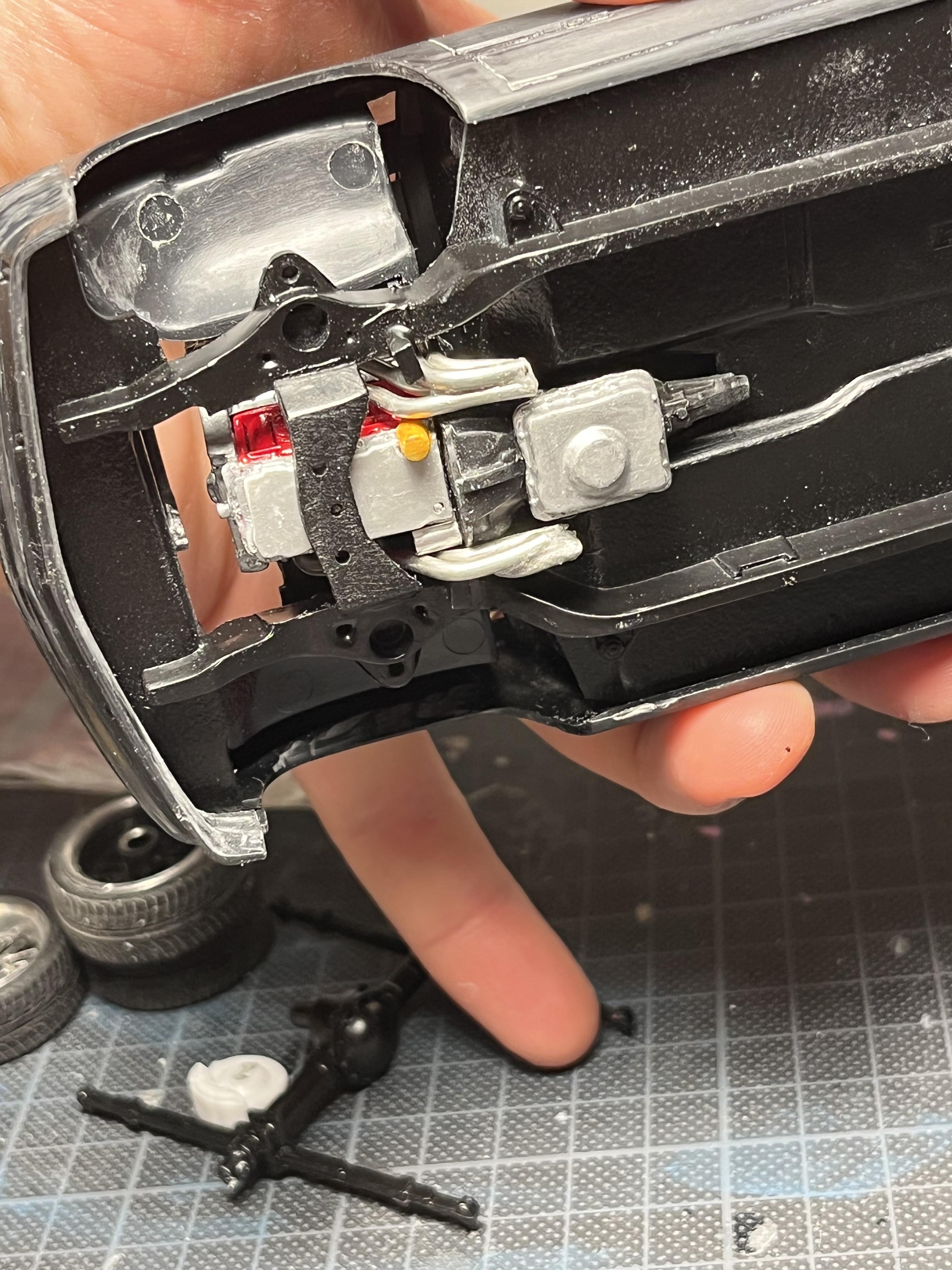

Some more progress, engine have gotten some ignition wires and a home made drysump pump. It felt like I had to do it since the corvette oil pan without the “bat” piece is so shallow. And I guess it did’t hurt since it’s suppose to be a high HP natural aspirated Engine made for street, strip and I guess track use. So next up is the other pieces of this oiling system. I have also started to look where to go with the exhaust and extra fuel tank.

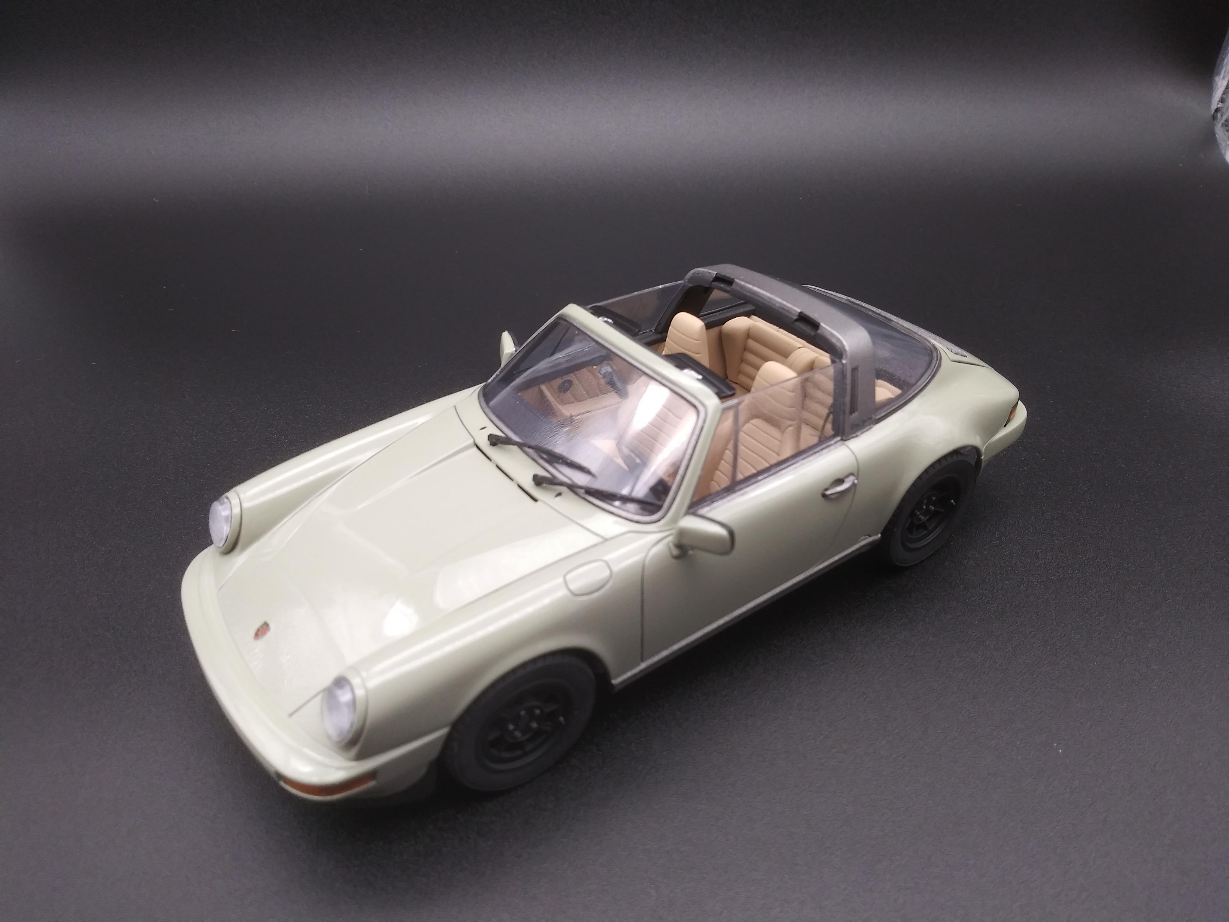

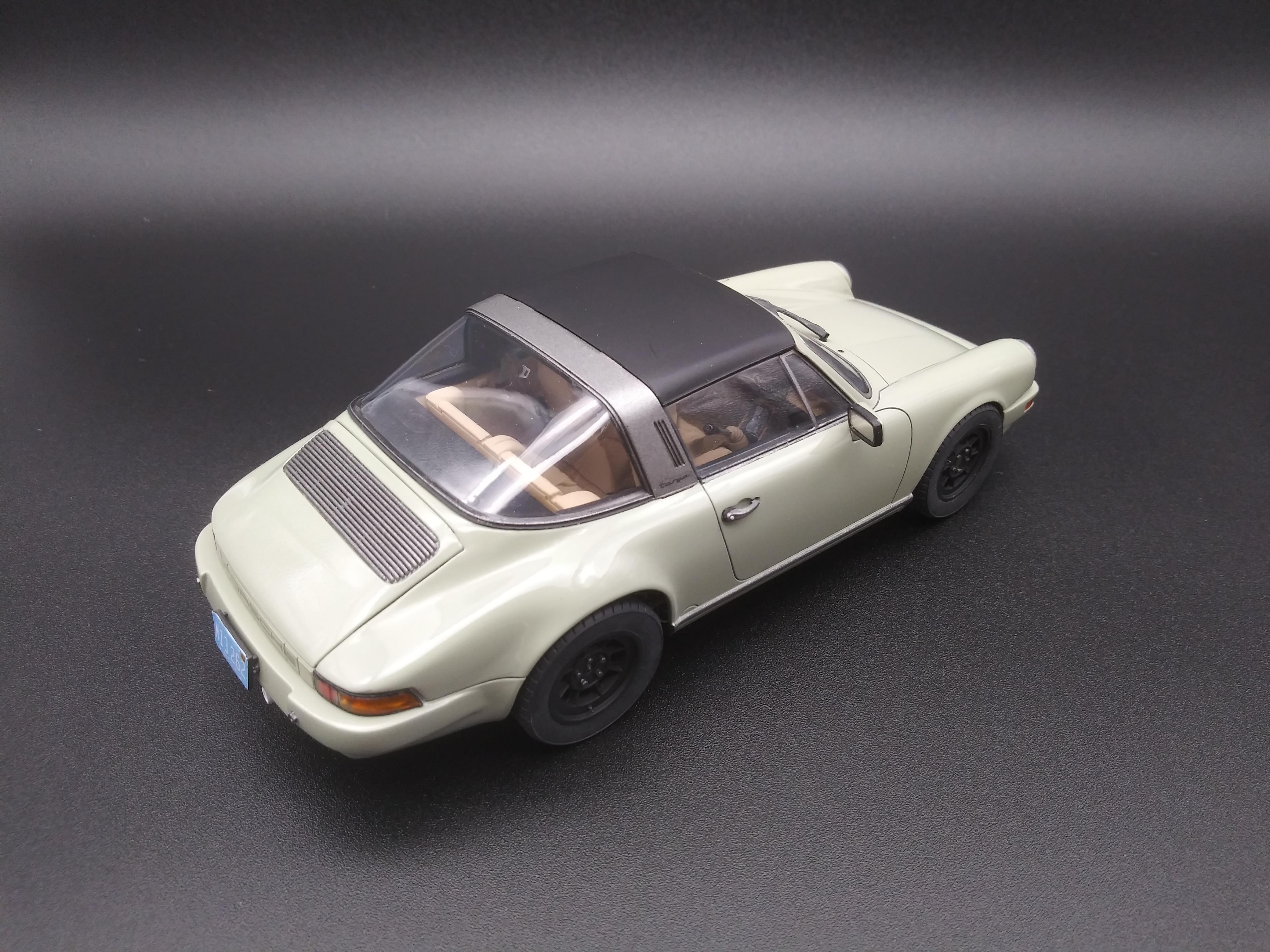

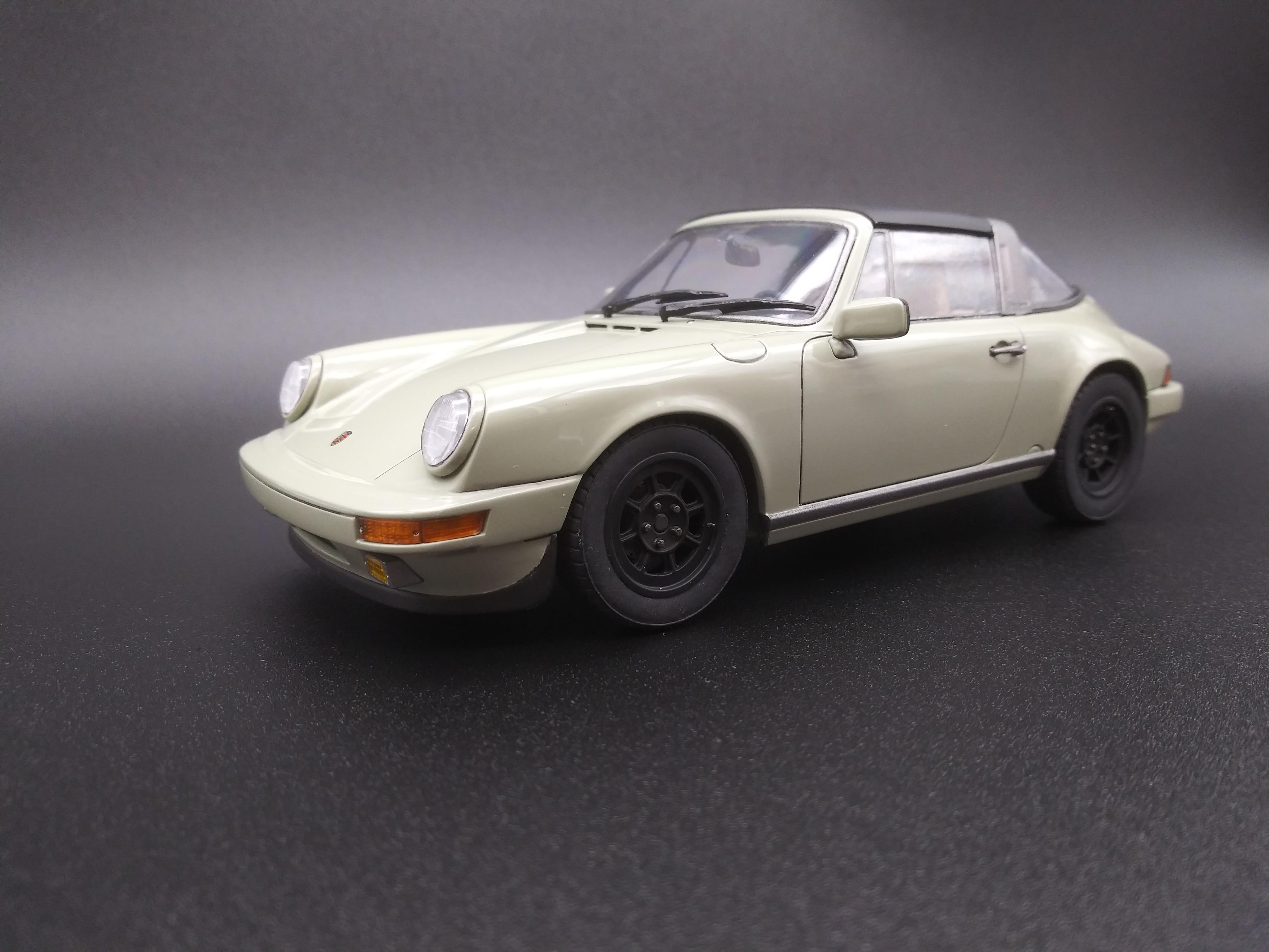

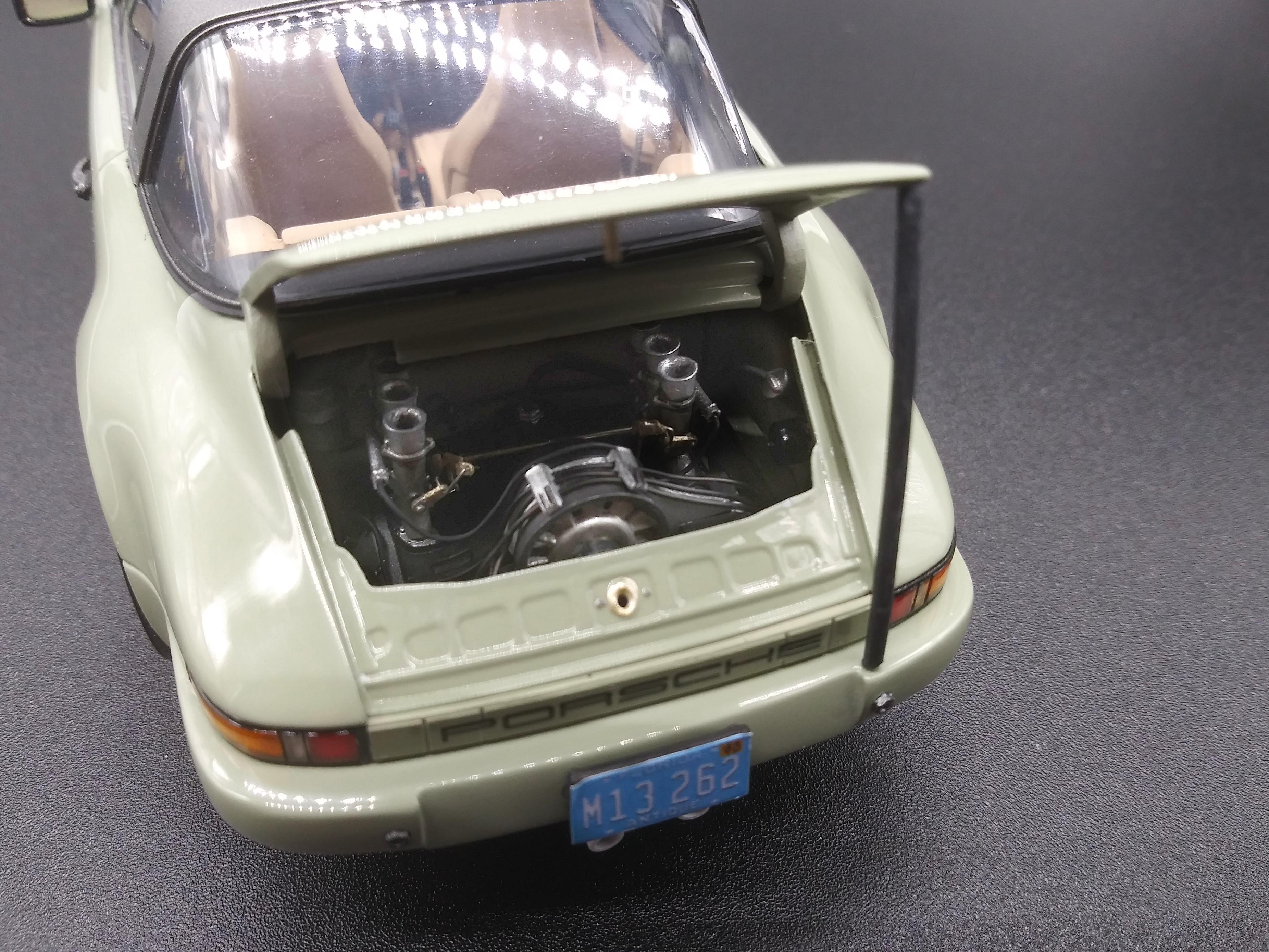

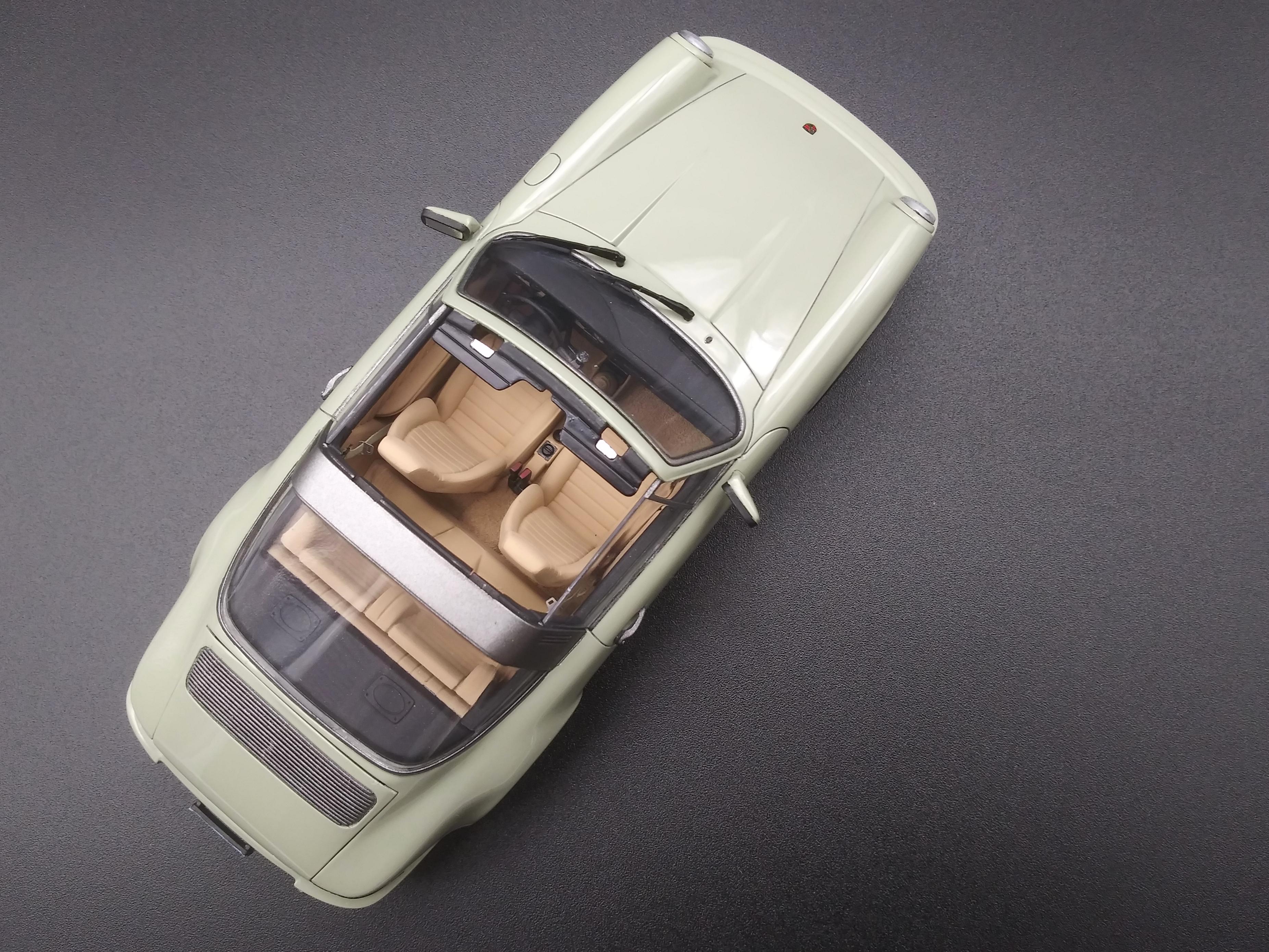

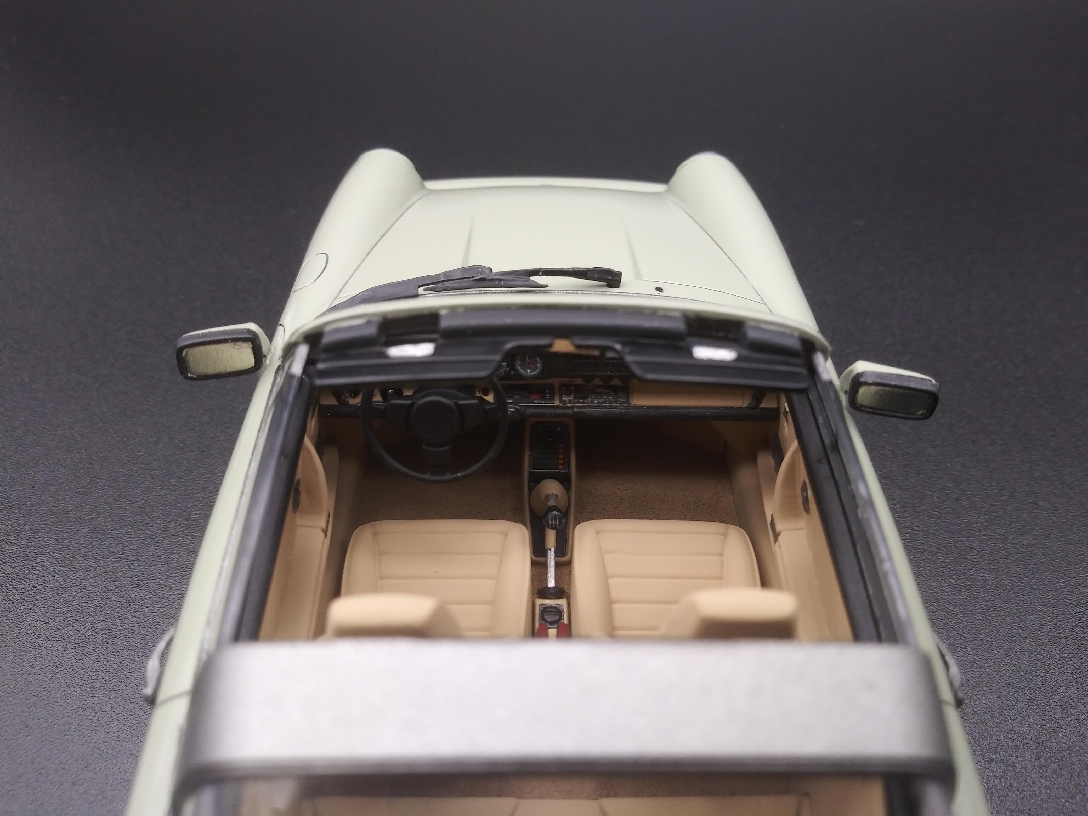

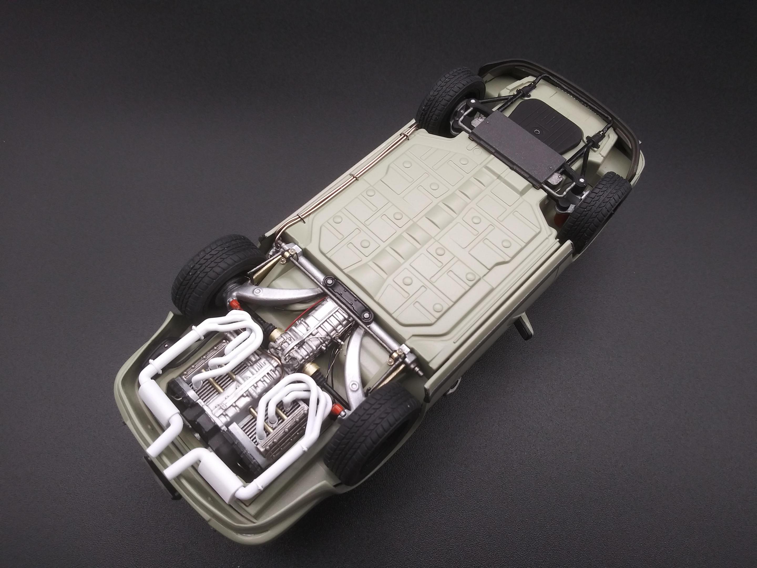

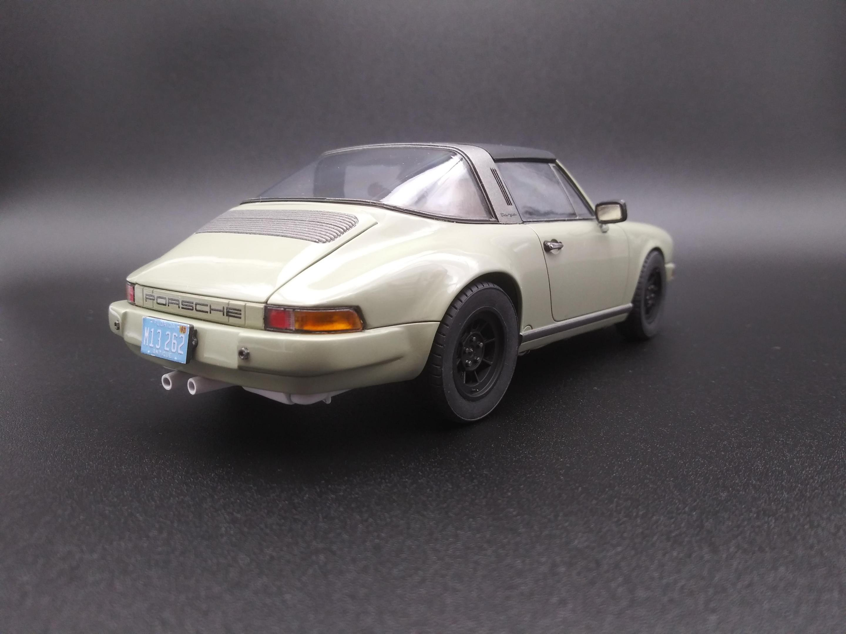

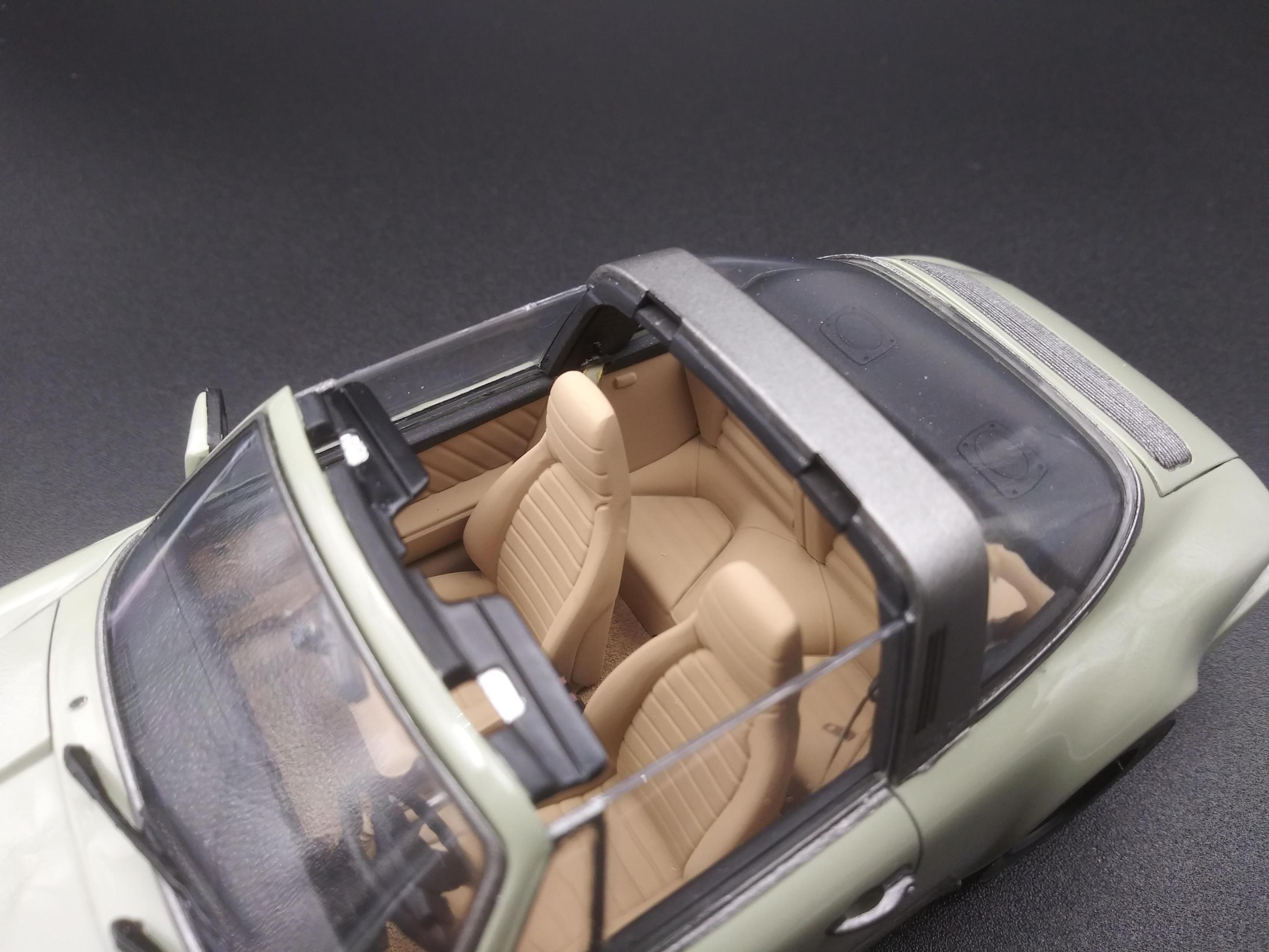

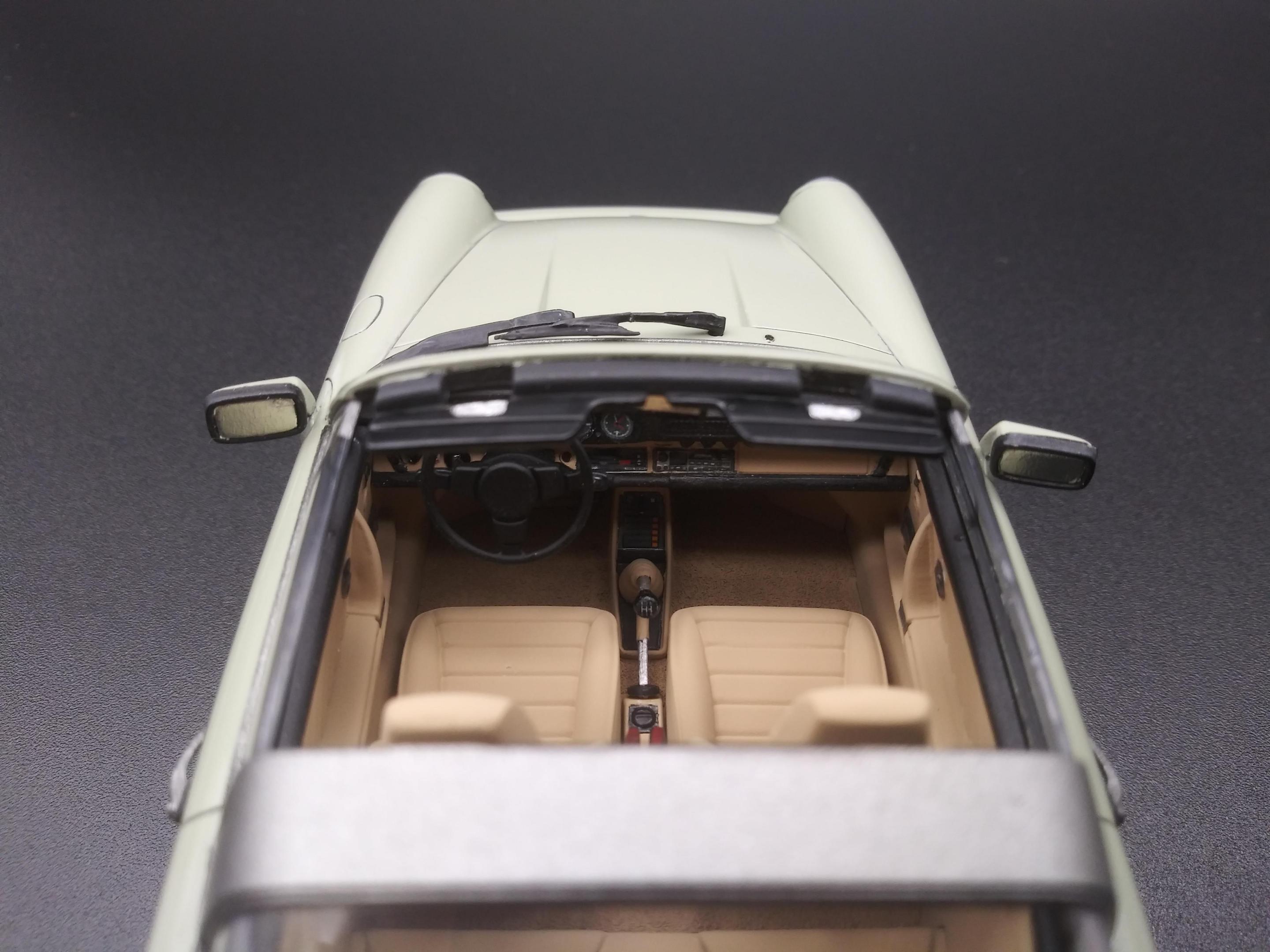

1980 Porsche 911 Targa Carrera Targa Outlaw
After a four-month build, I’m pleased to add my 911 to the completed Cannonball builds.
The goal of the car was to make an outlaw 911 that retained the refinement of a Porsche, but still held some “grit” of a purpose-built Cannonball entrant. Initially, the idea was a simple straight from the box build with modified colors. But, as the build progressed, I wanted to make a full outlaw. So, the body was simplified with the removal of bumper trim and rear bumperettes. The body itself received a non-factory muted green color (Tamiya grey-green) with metallic grey and matte black trim and accents.
The interior received a two-tone black and tan color scheme to compliment the exterior. Seat belts were added with 3D-printed seat belt guides and anchors securing them.
The engine is where the greatest modifications took place. The exhaust and ITBs were designed in Fusion360 (as were all 3D-printed parts) and printed. The exhaust itself is tubular and removes the heater core for greater performance. The intake is composed of six individual throttle bodies with fuel injection. Furthermore, an oil cooler was placed in the front bumper and fully plumbed into the engine. Additionally, clutch linkage was added underneath. Printed oil tank, oil thermostat and clutch linkage were made. Ignition wires, throttle linkage, fuel lines and oil lines complete the engine.
Finally, the wheels were modeled on the classic Campognolo wheels and printed to fit the kit tires.
Specs:
Kit: Revell Porsche 911 Targa 3.2 Carrera Targa
Exterior Paint: Tamiya Grey-Green, metallic grey and matte black
Aftermarket: various wires and photo etch from Detail Master and Gofer racing, Evergreen and Plastruct plastic stock, BMF decal paper
3D Print: wheels and valve stems, oil tank and thermostat, clutch linkage, ITBs and linkage, full exhaust, ignition coil, fuel filter
Thank you for looking and critiques are always welcome!

That is so nice, I wish I could build so cleanly.
Expand
Great color choice! Very impressive work and excellent example of what a cannonball run entry would look like. And the color reminds me of an early V.W. I like it...

Needed to do some adjustments to fit the grill as intended. So I also opened up the grill area to give it some more detail. I also think I will use a AMTcorvette radiator in the back but some more mods will be needed since It interferes with the engine at the moment. More on that later.

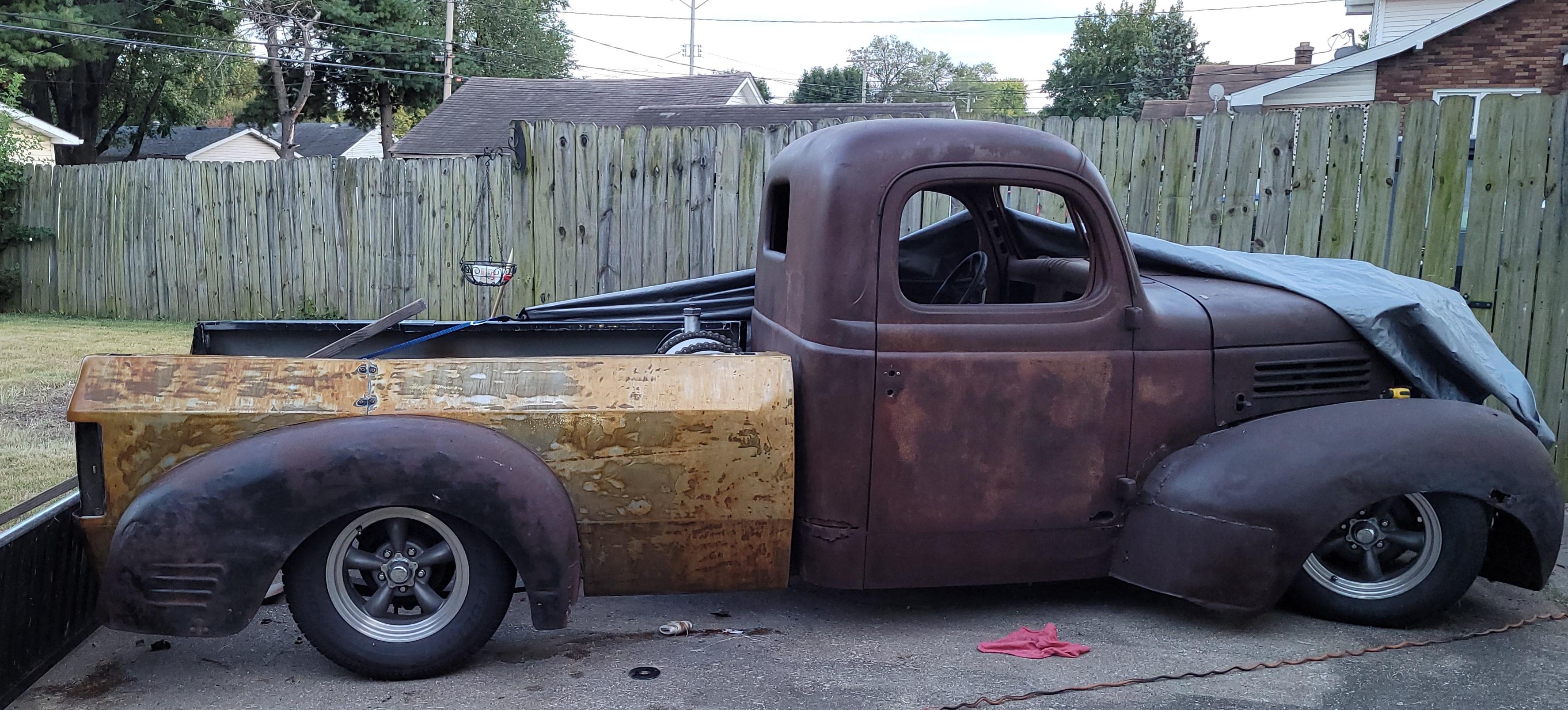

I've been trying to keep an eye on everyone's builds and still plan on finishing mine. Still been busy working on my full scale truck and doing some weathering on it now. A little peroxide , salt and vinegar. 20221010_182024.jpg.ff941bd439649e1e6d8e2be7e2a74ac9.jpg
