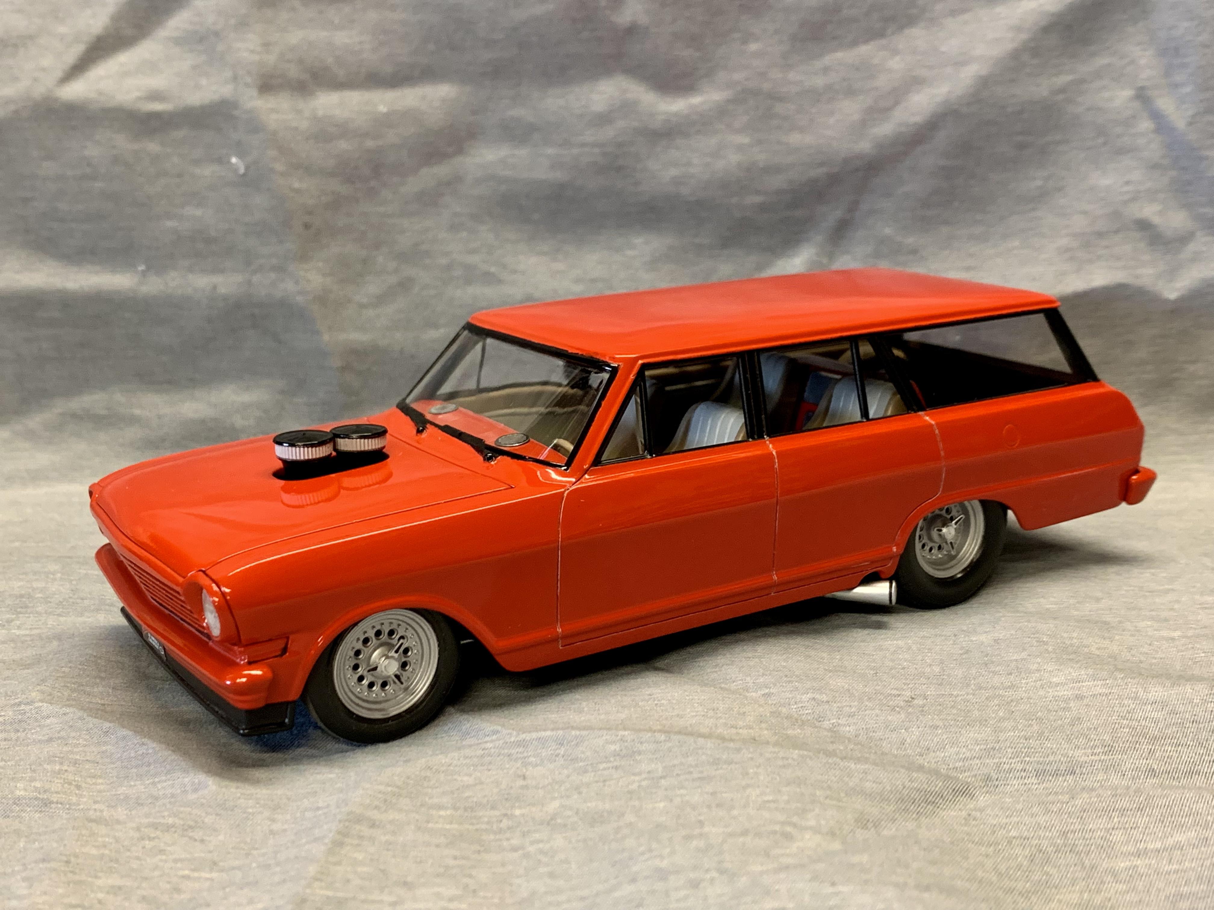

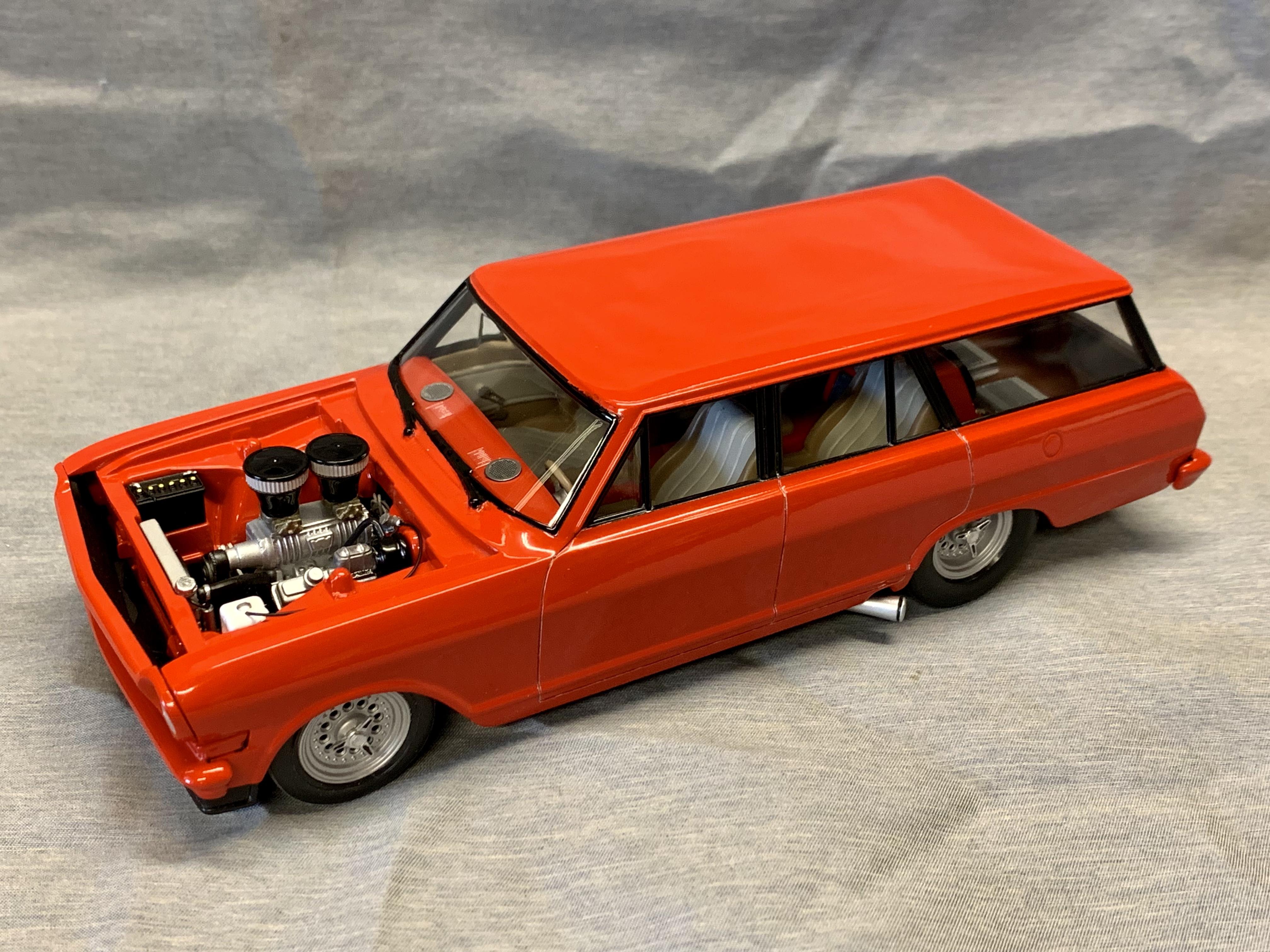

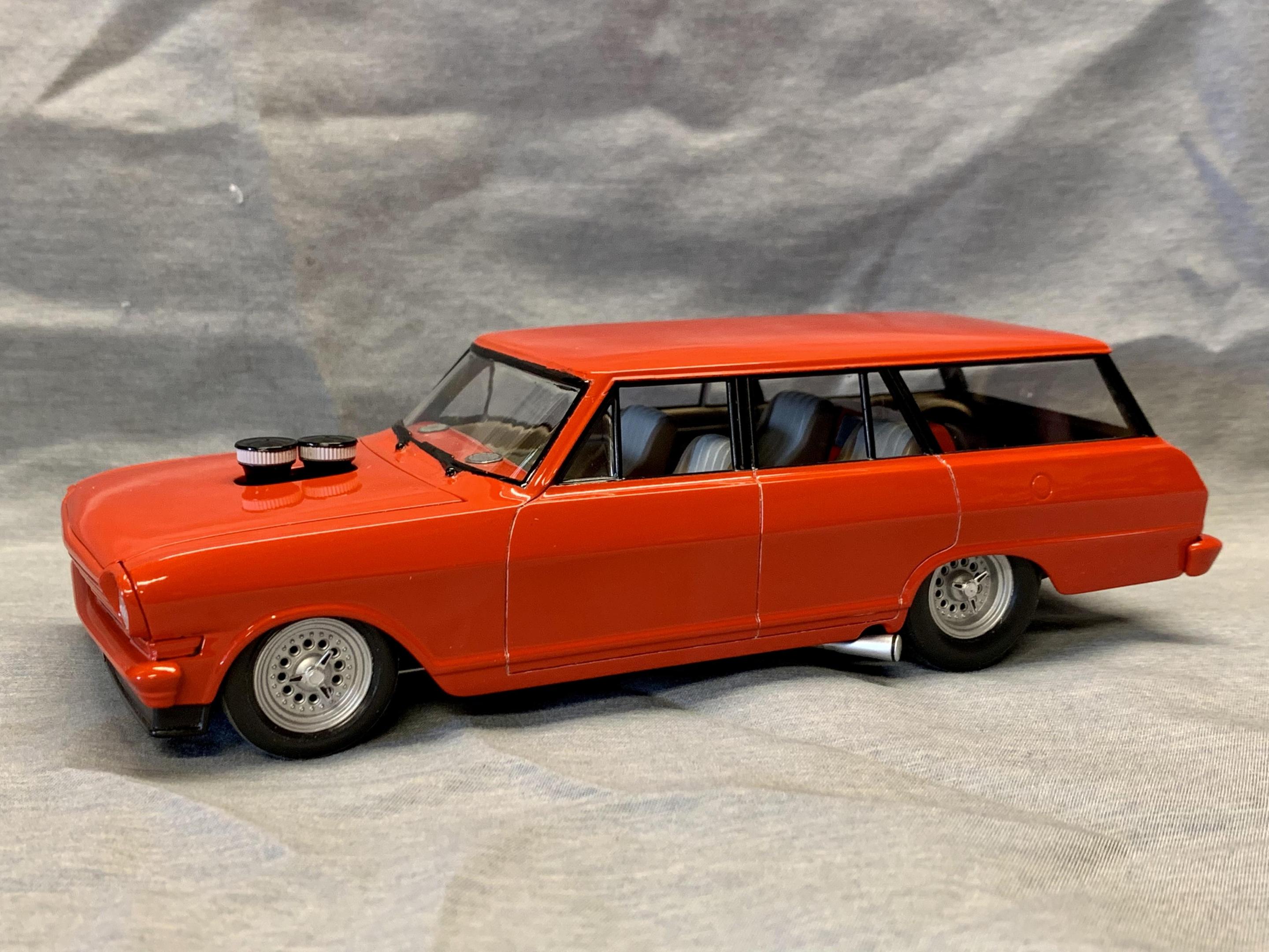

Starting with AMT’s 1963 Nova Wagon “Craftsman” low detail curbside kit, the original plan was to put a motor in it, set a lowered & raked stance and put some big & little rubber with American 5-spokes. It was supposed to be a simple project as a breather between heavier projects and then it snowballed into what you see here, set into motion by a simple wheel change! Born in 1979, this is the predominant build style I grew up with at car shows in the 80’s and early 90’s, the Smooth Billet era. Now in my early 40’s, over the last couple of years I’ve developed a nostalgia towards the style and decided I needed to “bring billet back” in scale.

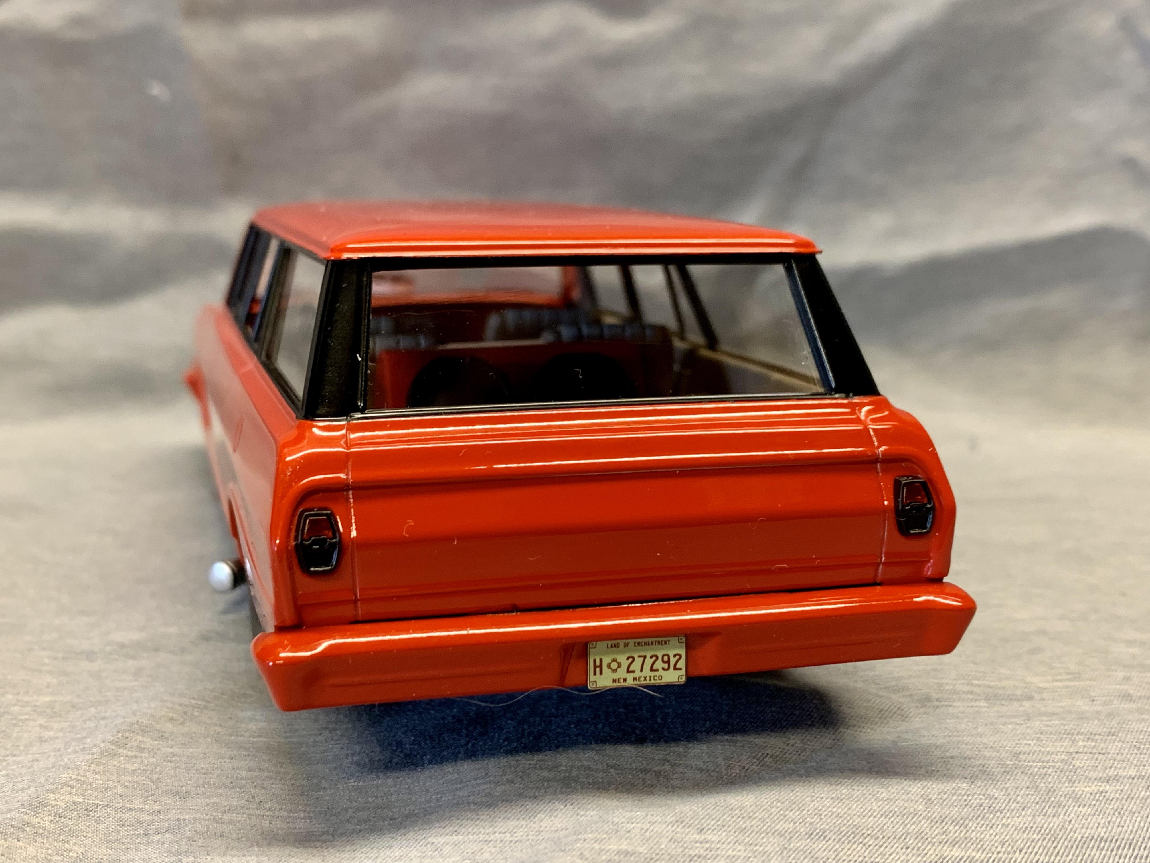

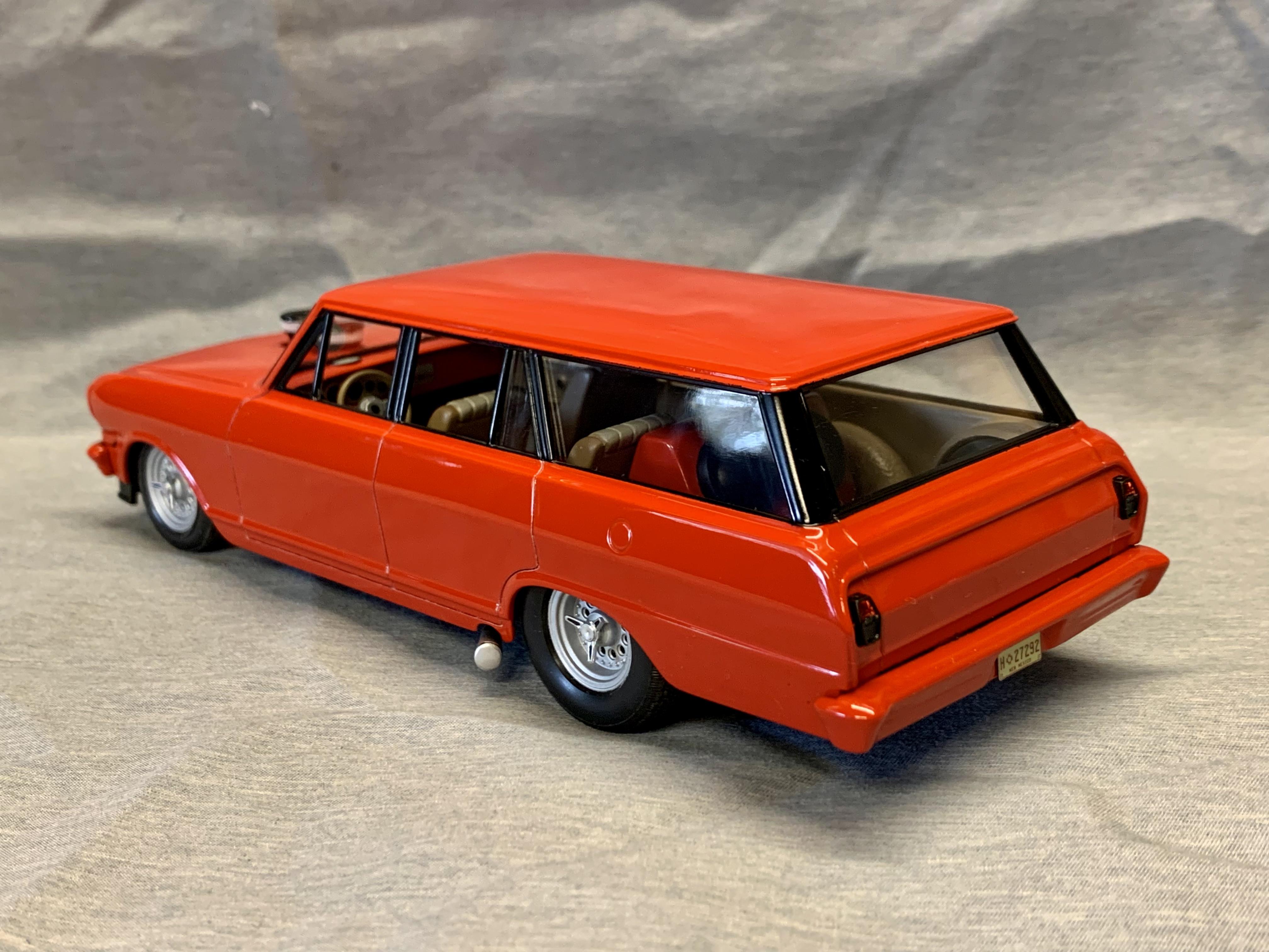

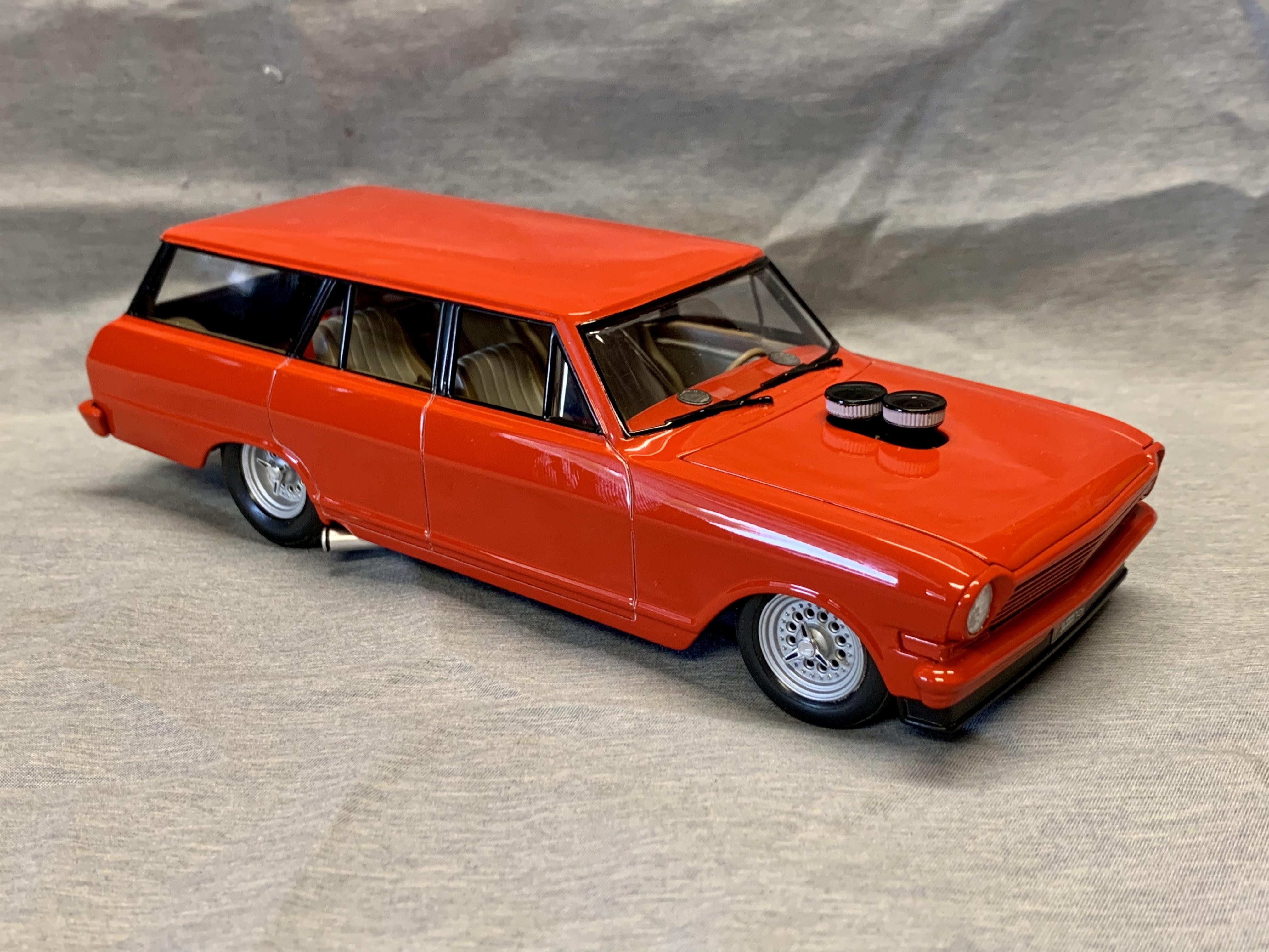

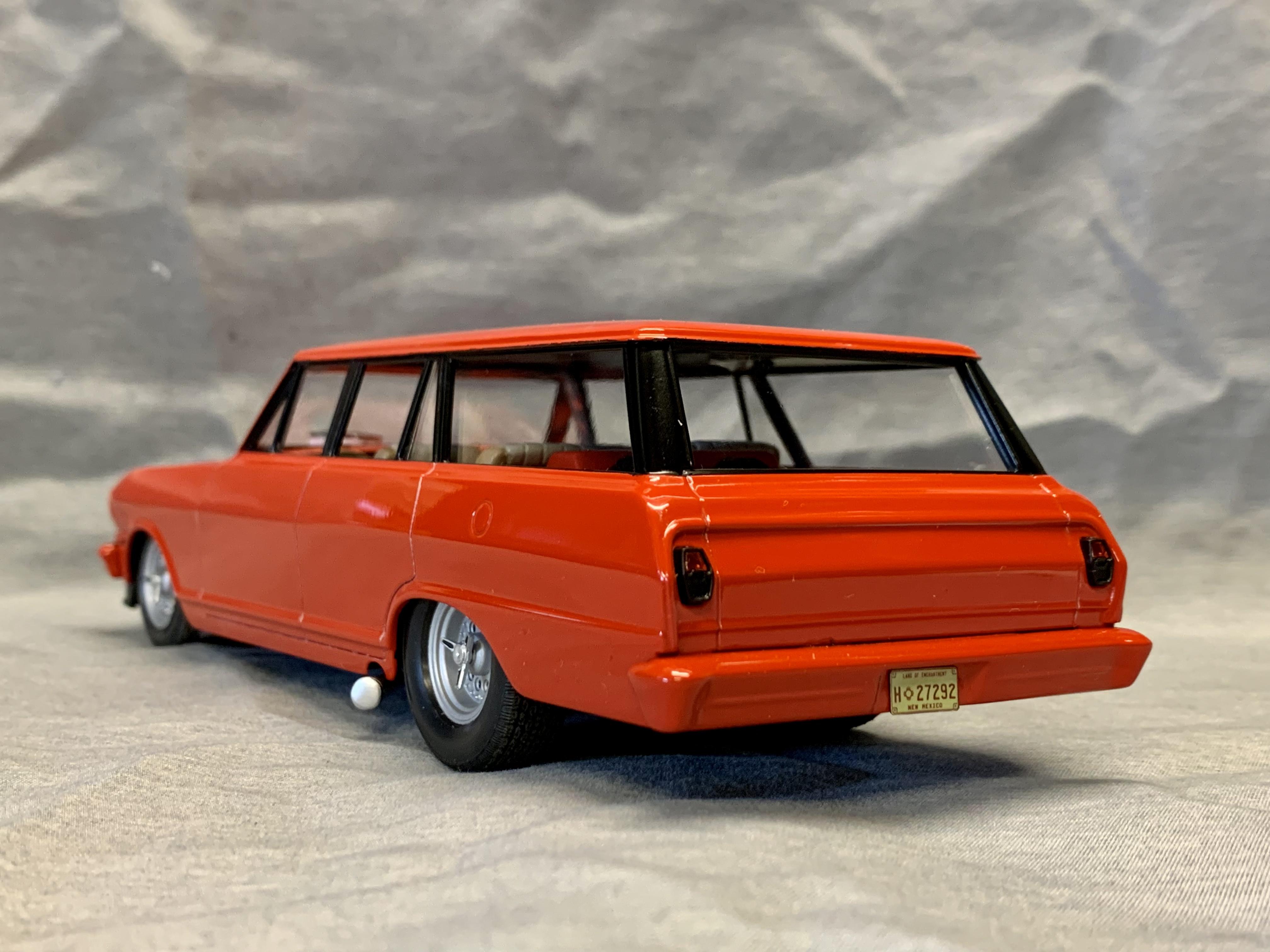

- AMT ‘63 Nova Wagon body with all side trim deleted, bumpers and grill chrome stripped and oval hole cut in hood for air filters to poke through. Front fender depressions filled. Scratch built air dam.

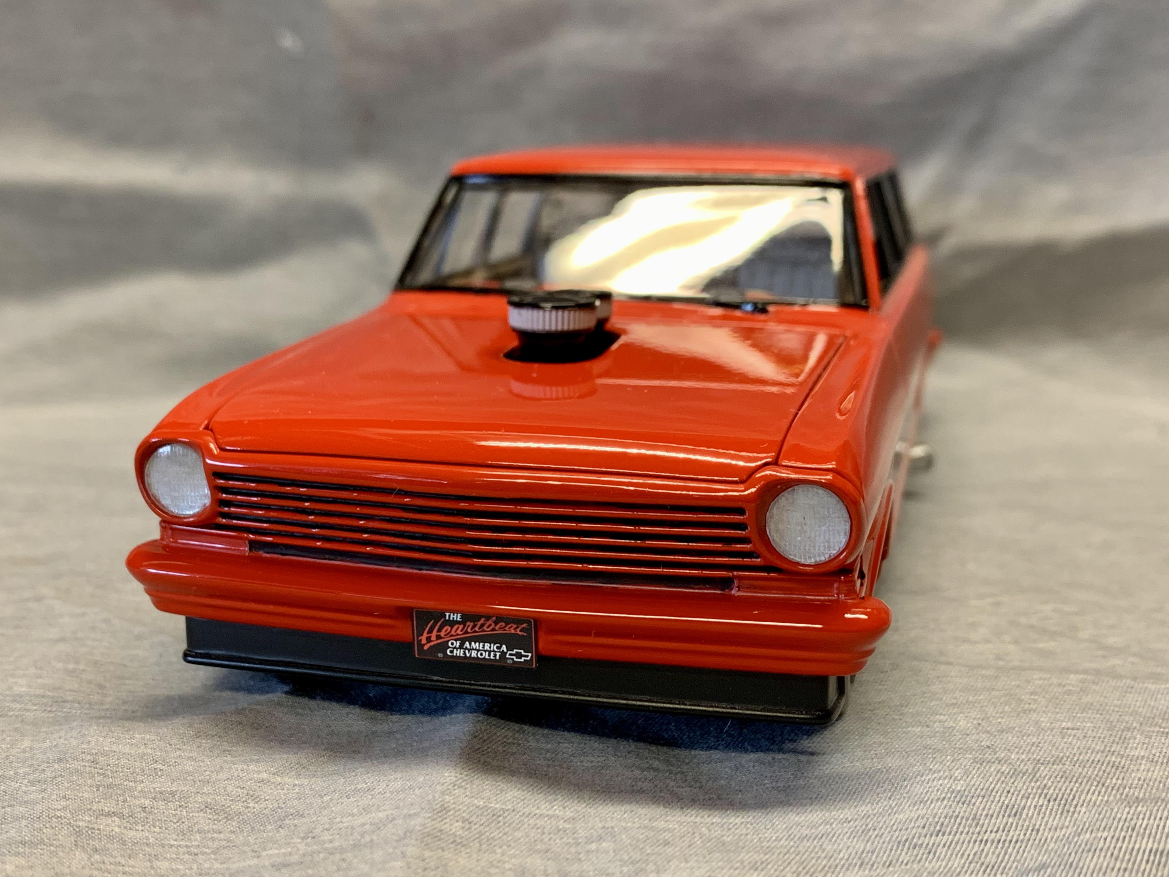

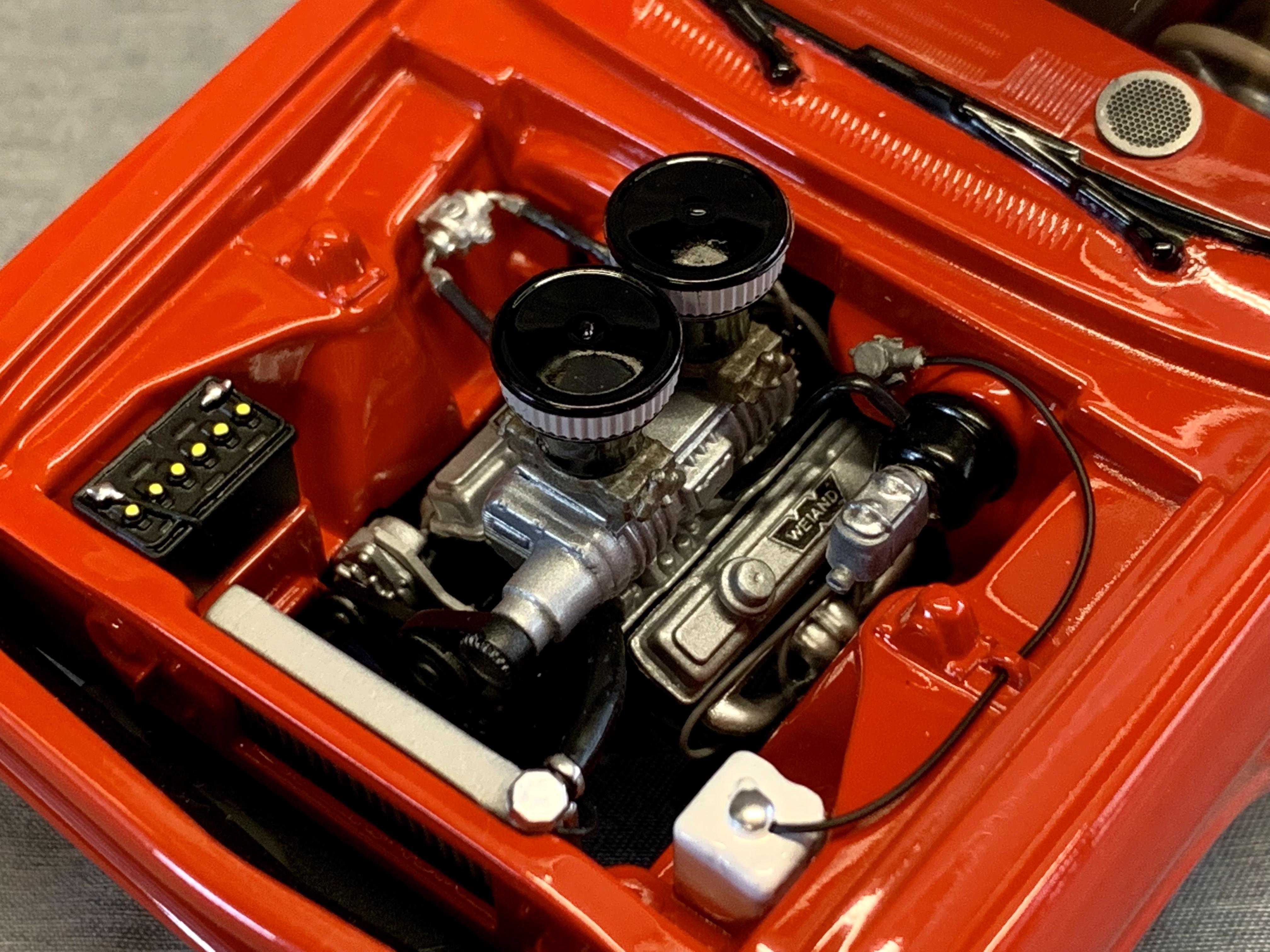

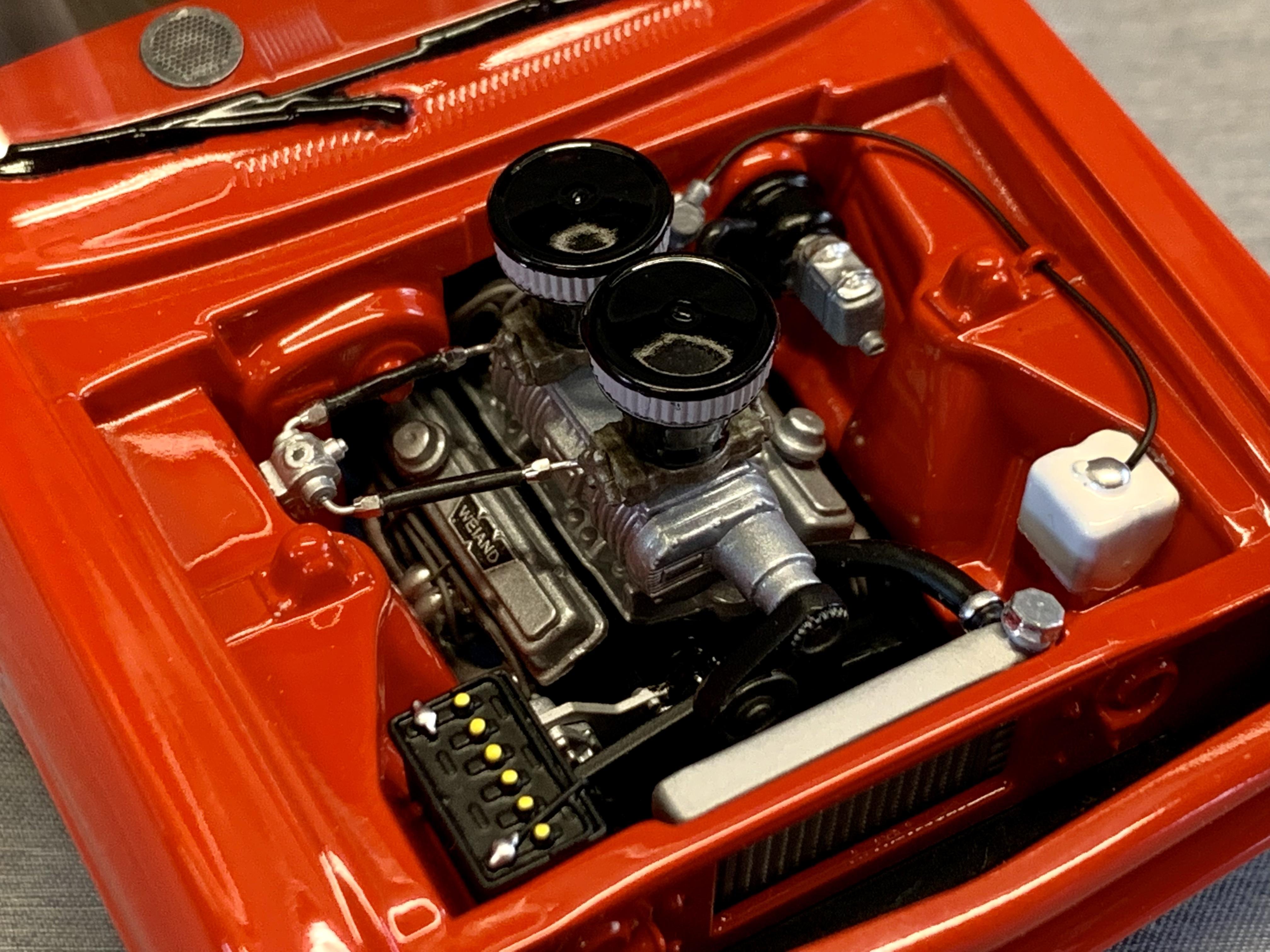

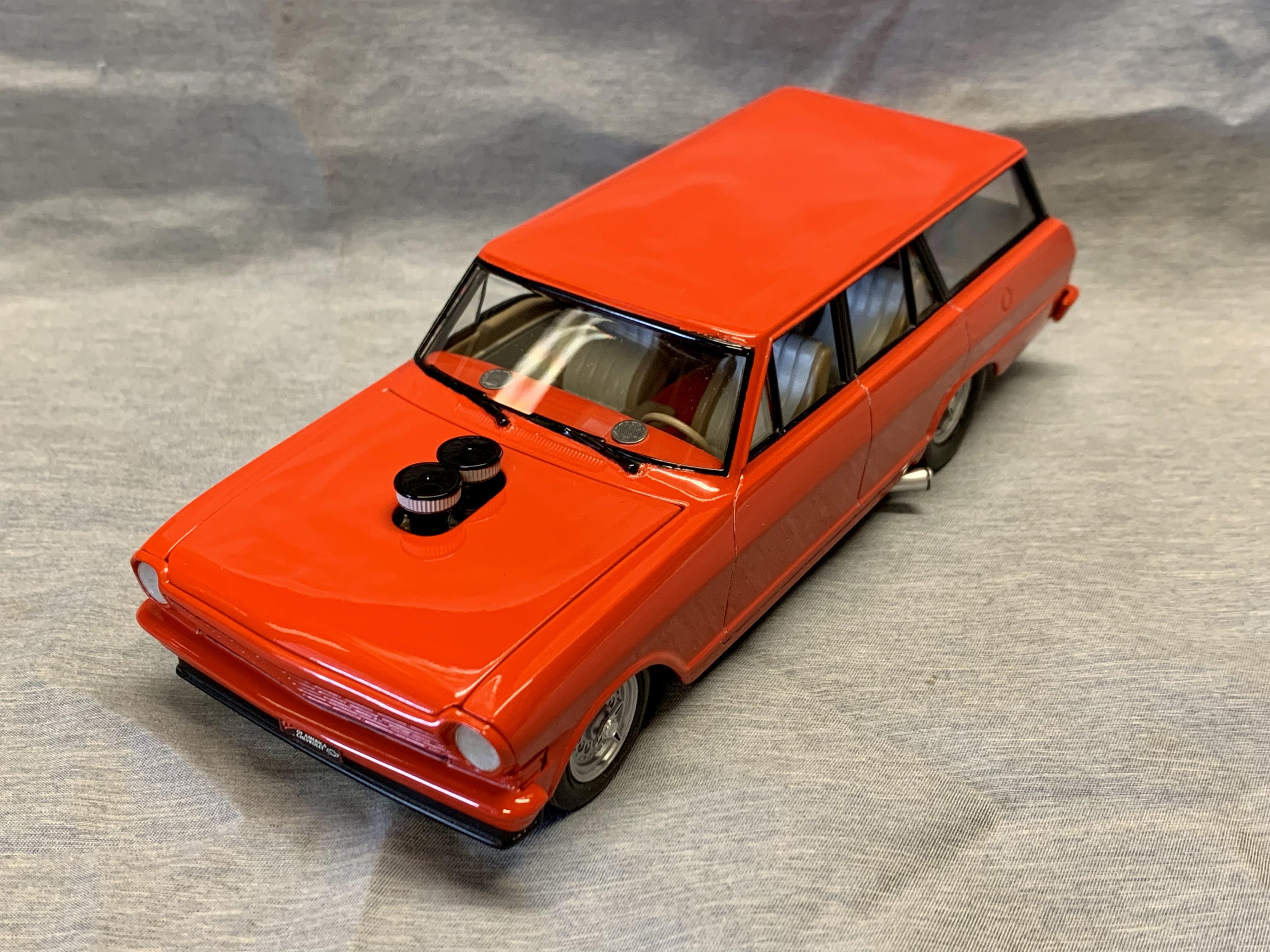

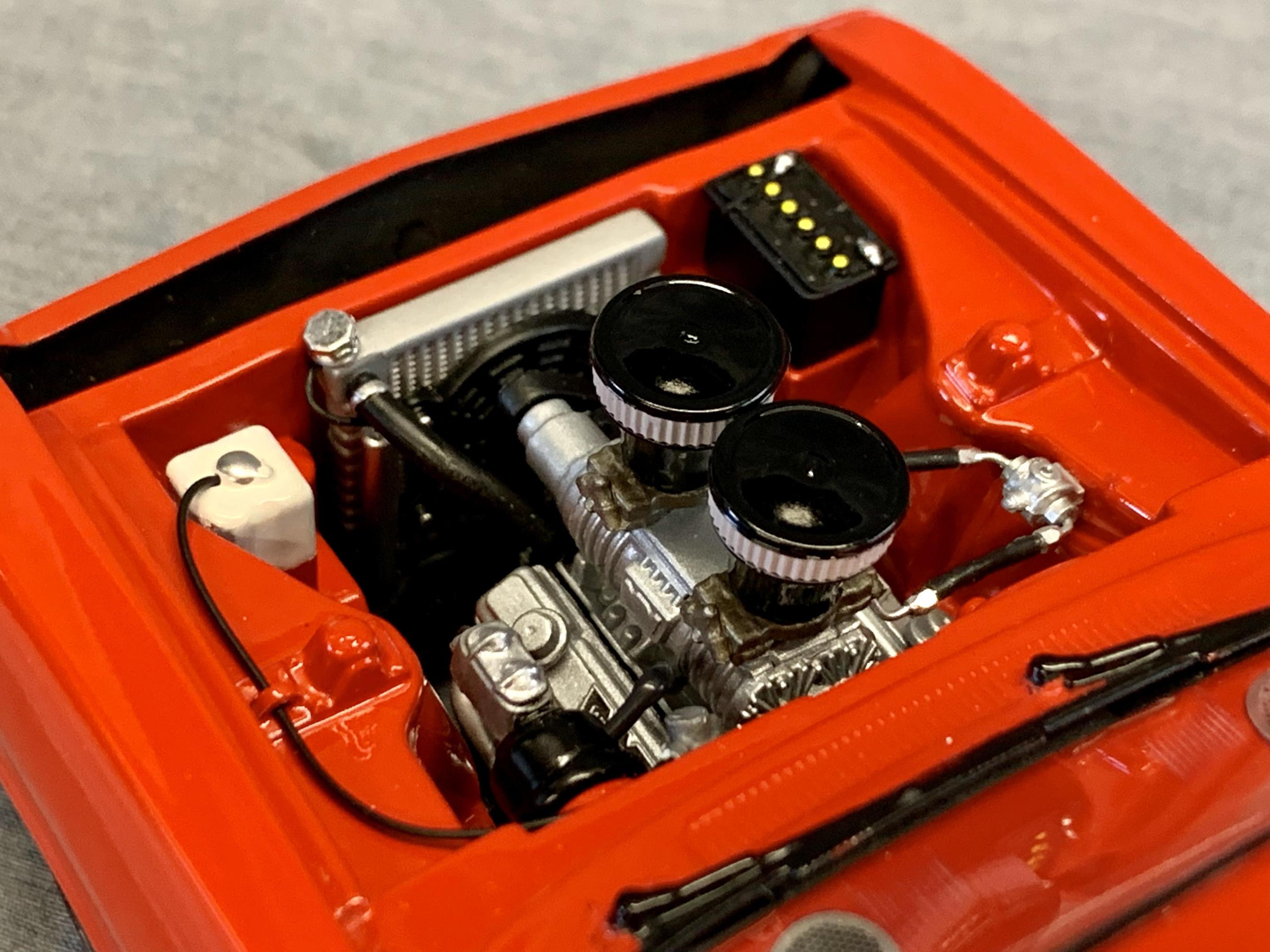

- Under hood detail added including brake booster/master cylinder from Revell ‘32 Ford series with vacuum hose to engine, windshield wiper motor with washer fluid line to reservoir, fuel pressure regulator with Detail Master plumbing, battery from full-detail Customizing release of Nova Wagon. Radiator heavily modified from Revell ‘90 Mustang LX with scratch built overflow tank and electric fan from Revell ‘32 Ford series.
- Revell ‘29 Roadster Chevy block, auto trans, heads, timing cover, belt drive and alternator. Revell Stacy David ‘32 Roadster Weiand supercharger, dual Holley carbs, tall air filters and blower belt drive. AMT ‘66 Nova Pro Street Weiand valve covers with breathers added. Revell ‘37 Ford Sedan block hugger headers. Revell ‘67 Chevelle Pro Street exhaust pipes and Supertrapp mufflers. Detail Master wired distributor and wire dividers.

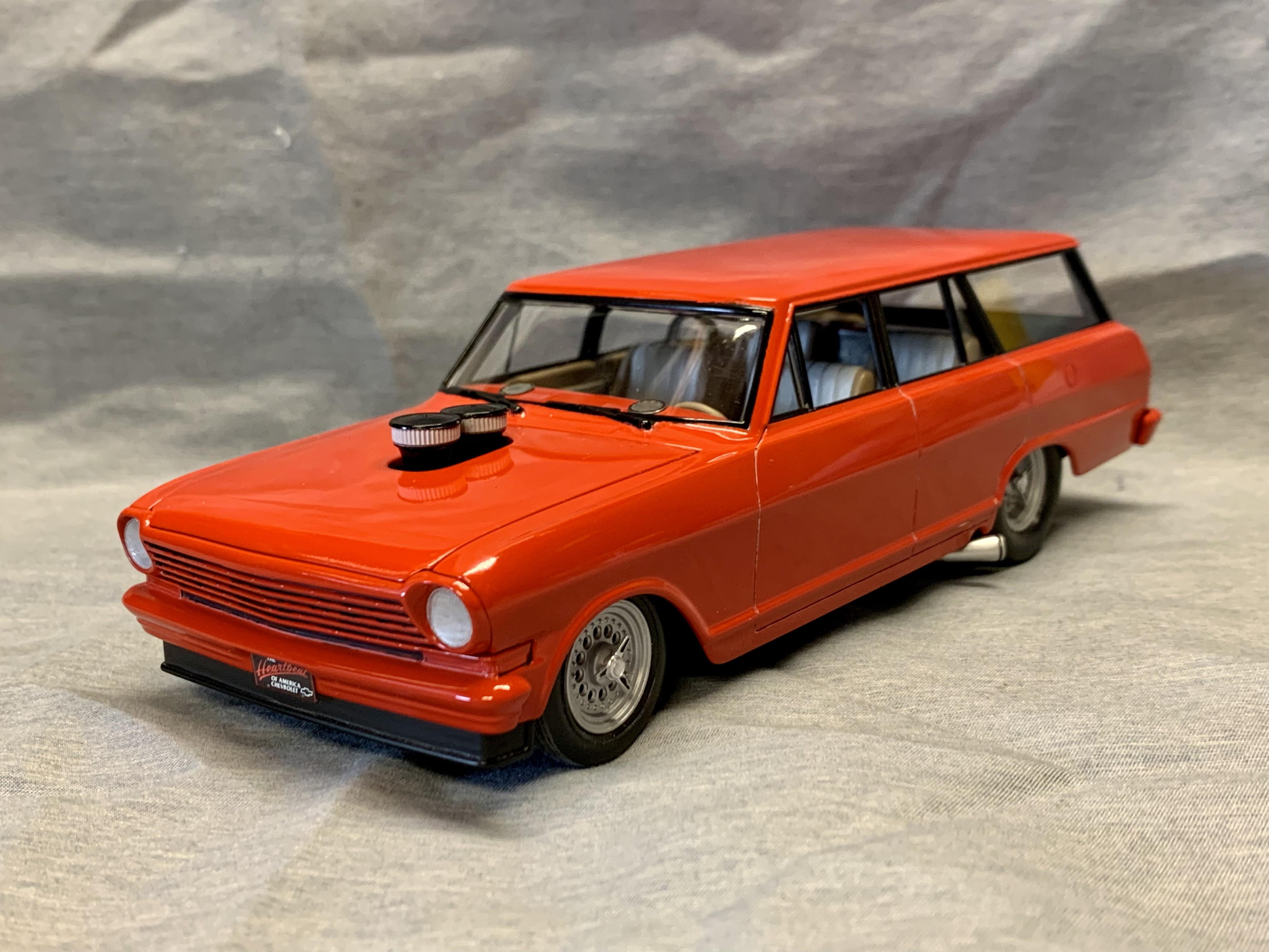

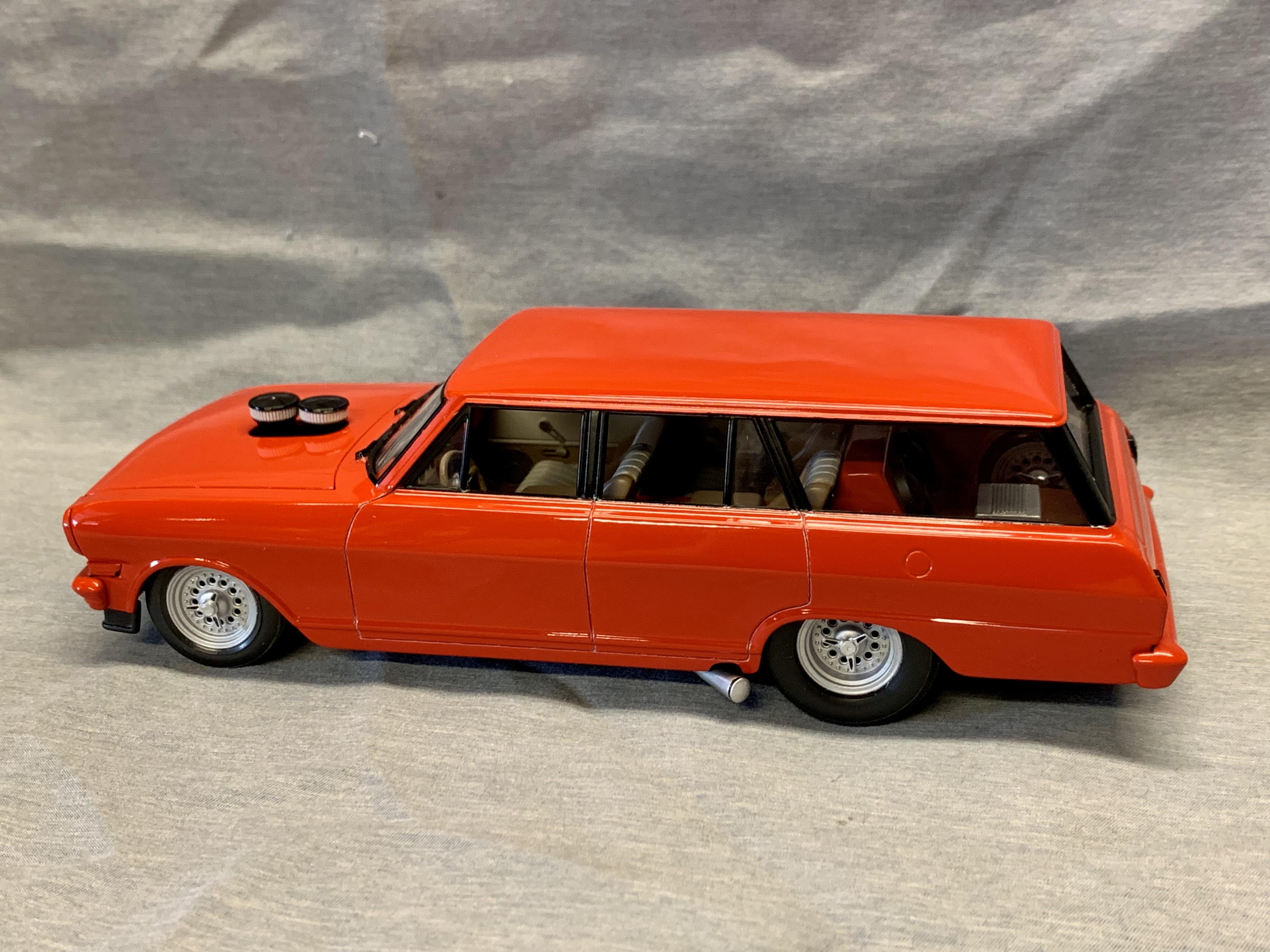

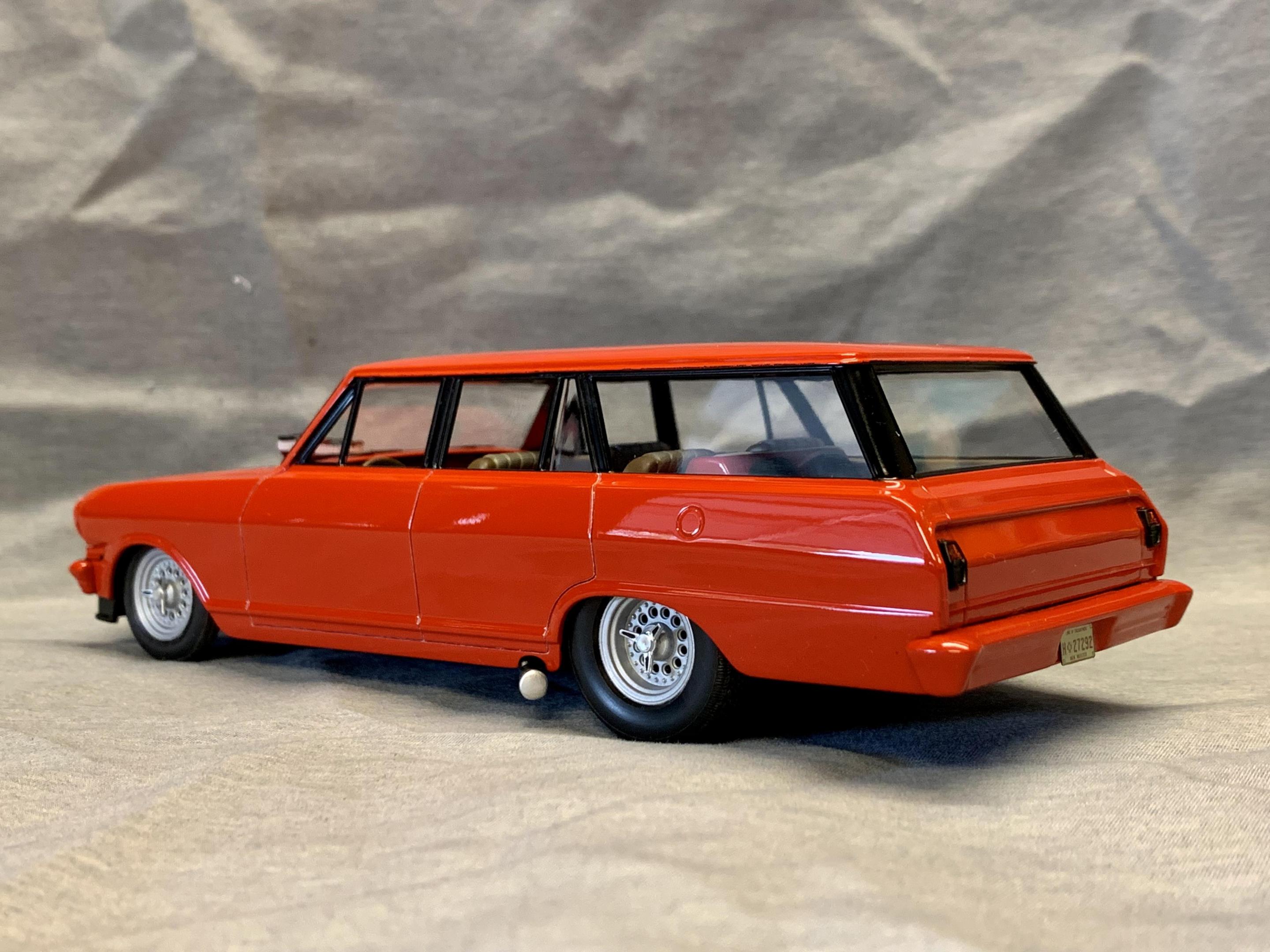

- Revell ZZ Top Eliminator Coupe wheels. Revell ‘40 Ford street rod rear tires. Revell ‘67 Chevelle Pro Street skinny front tires.

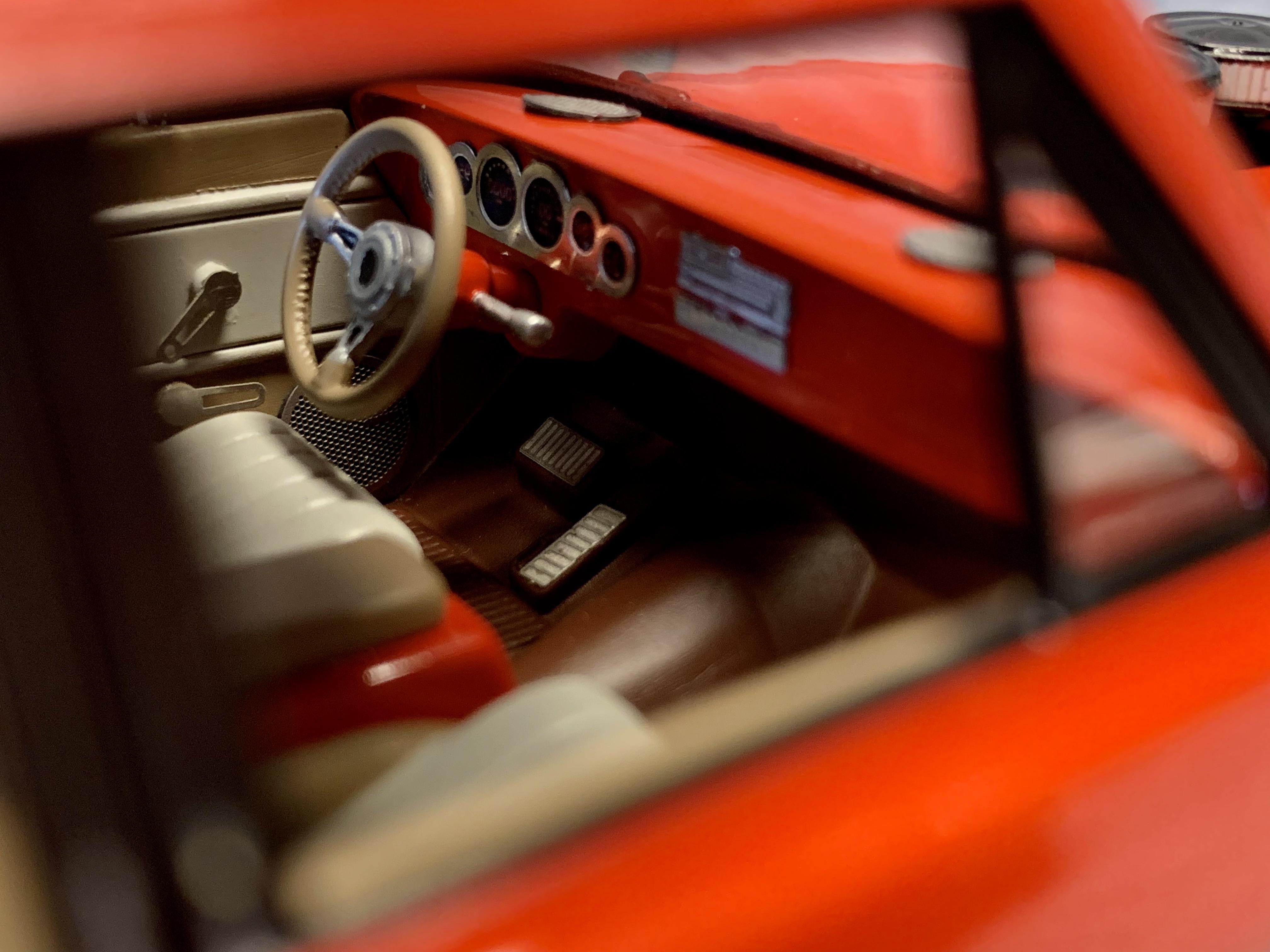

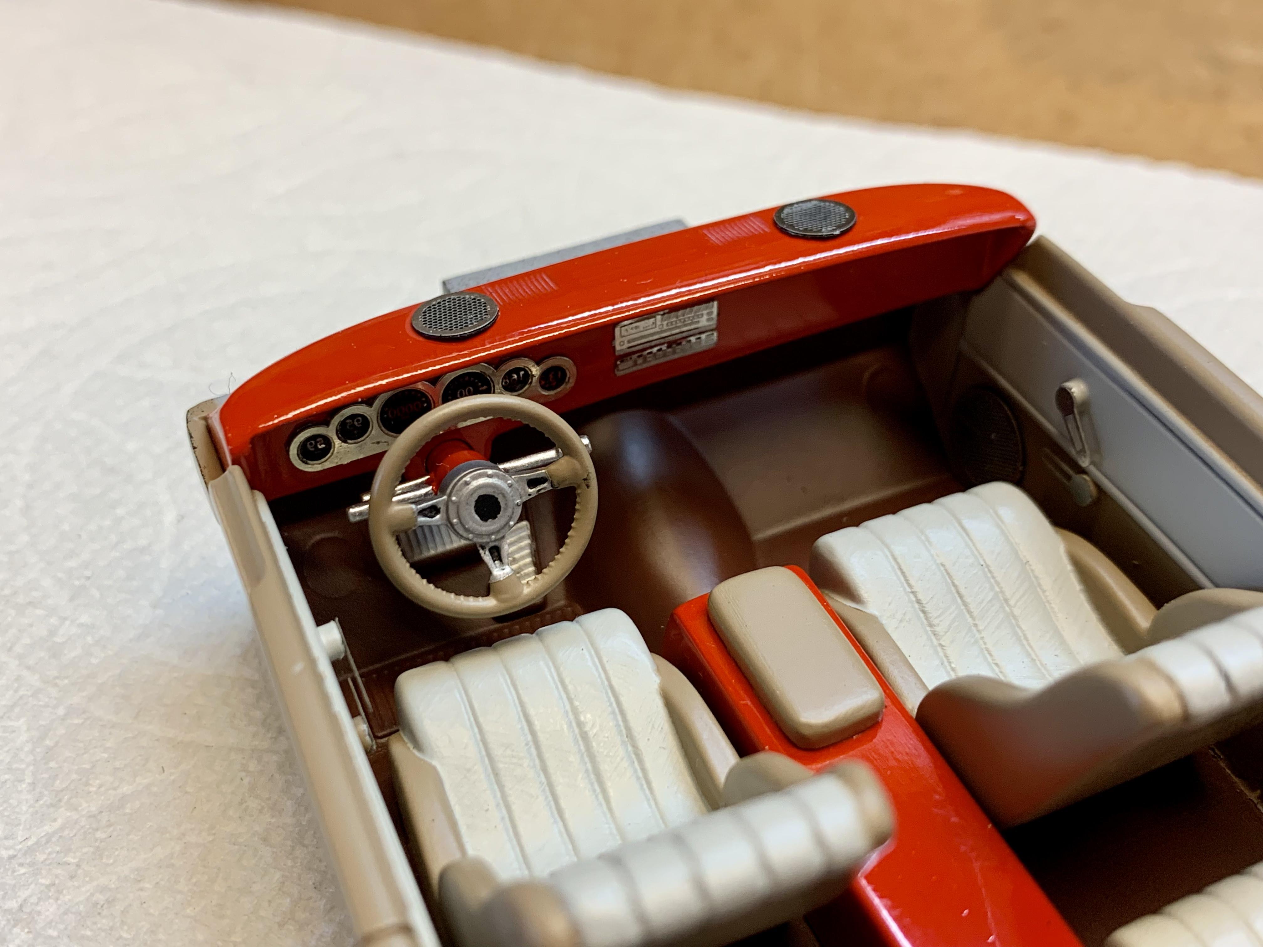

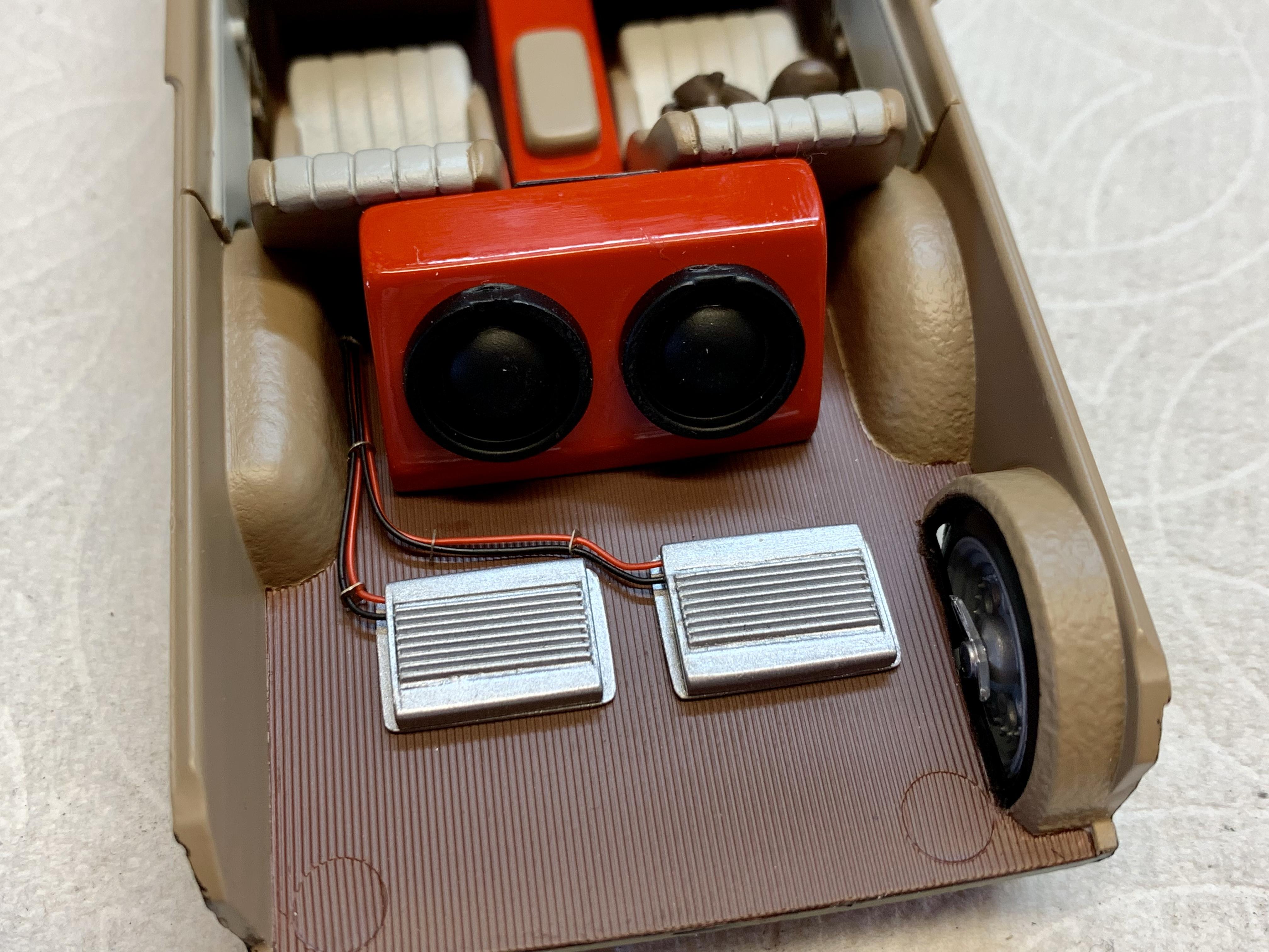

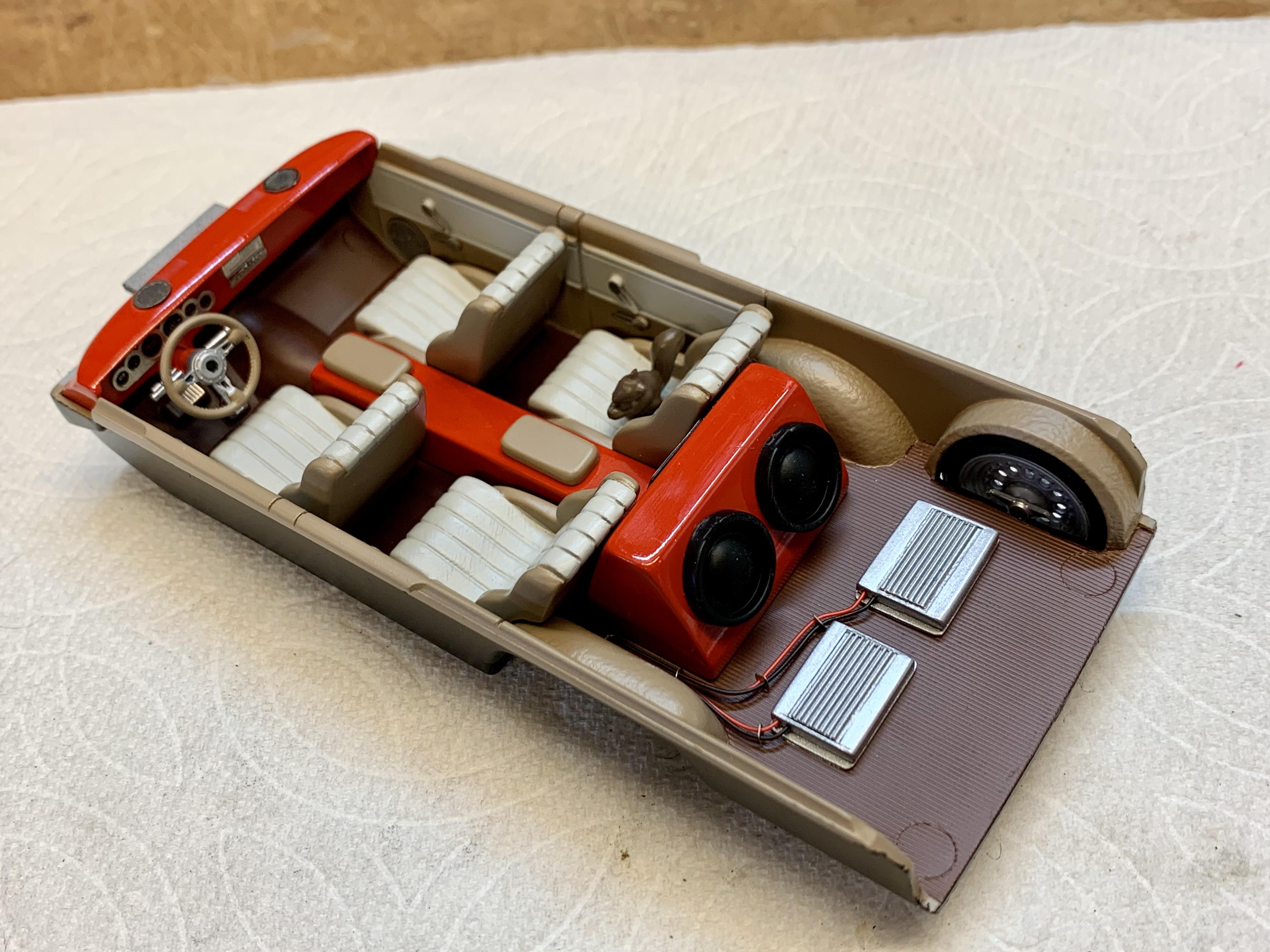

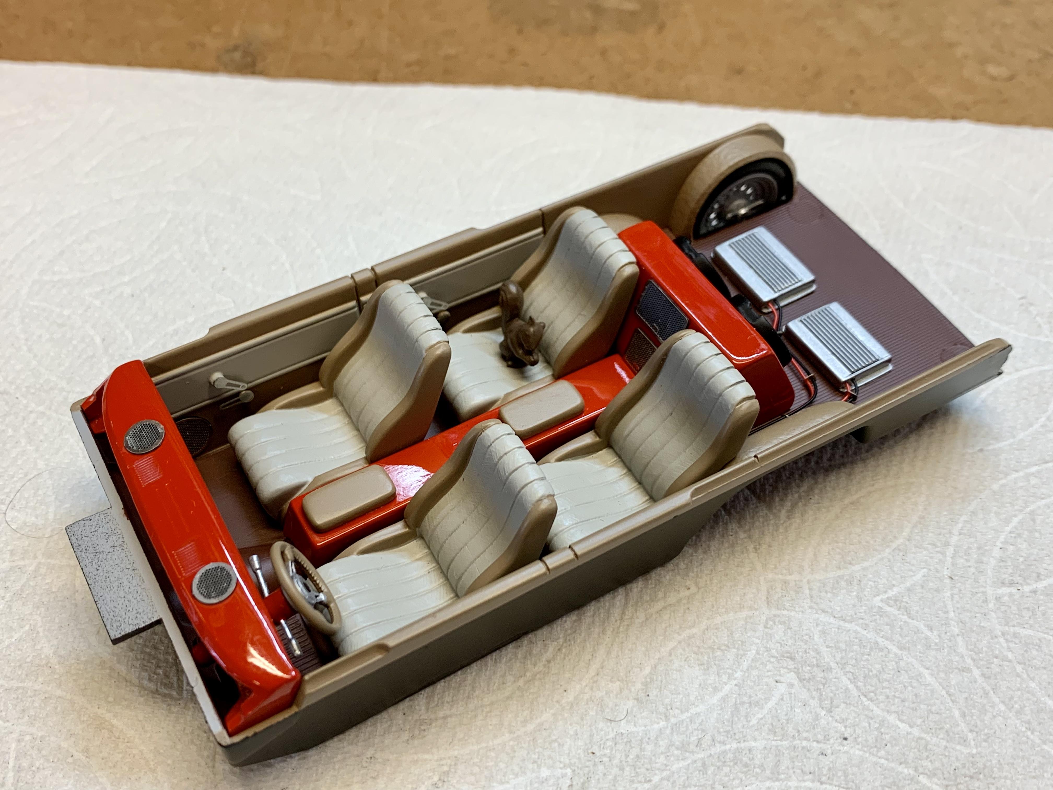

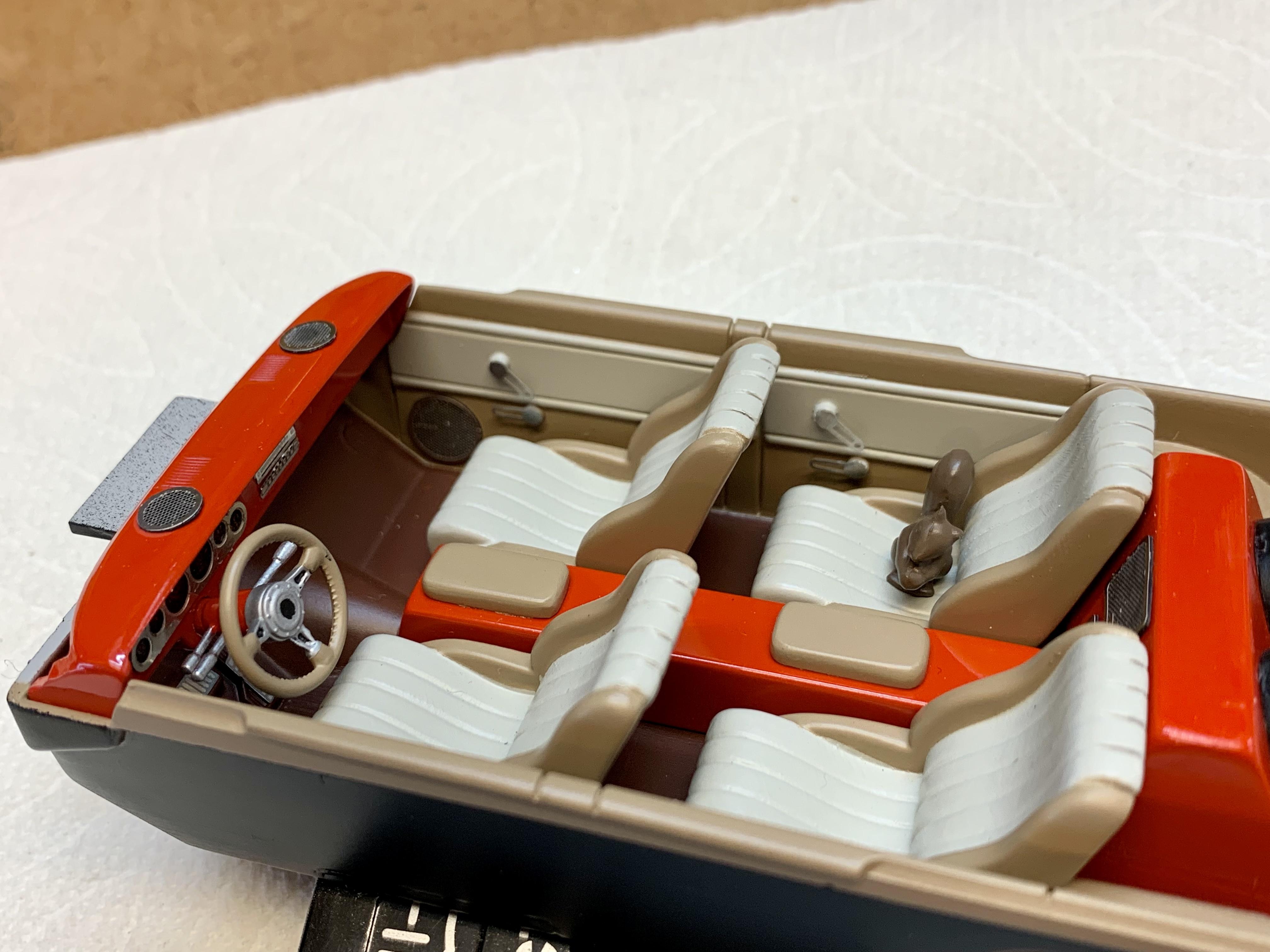

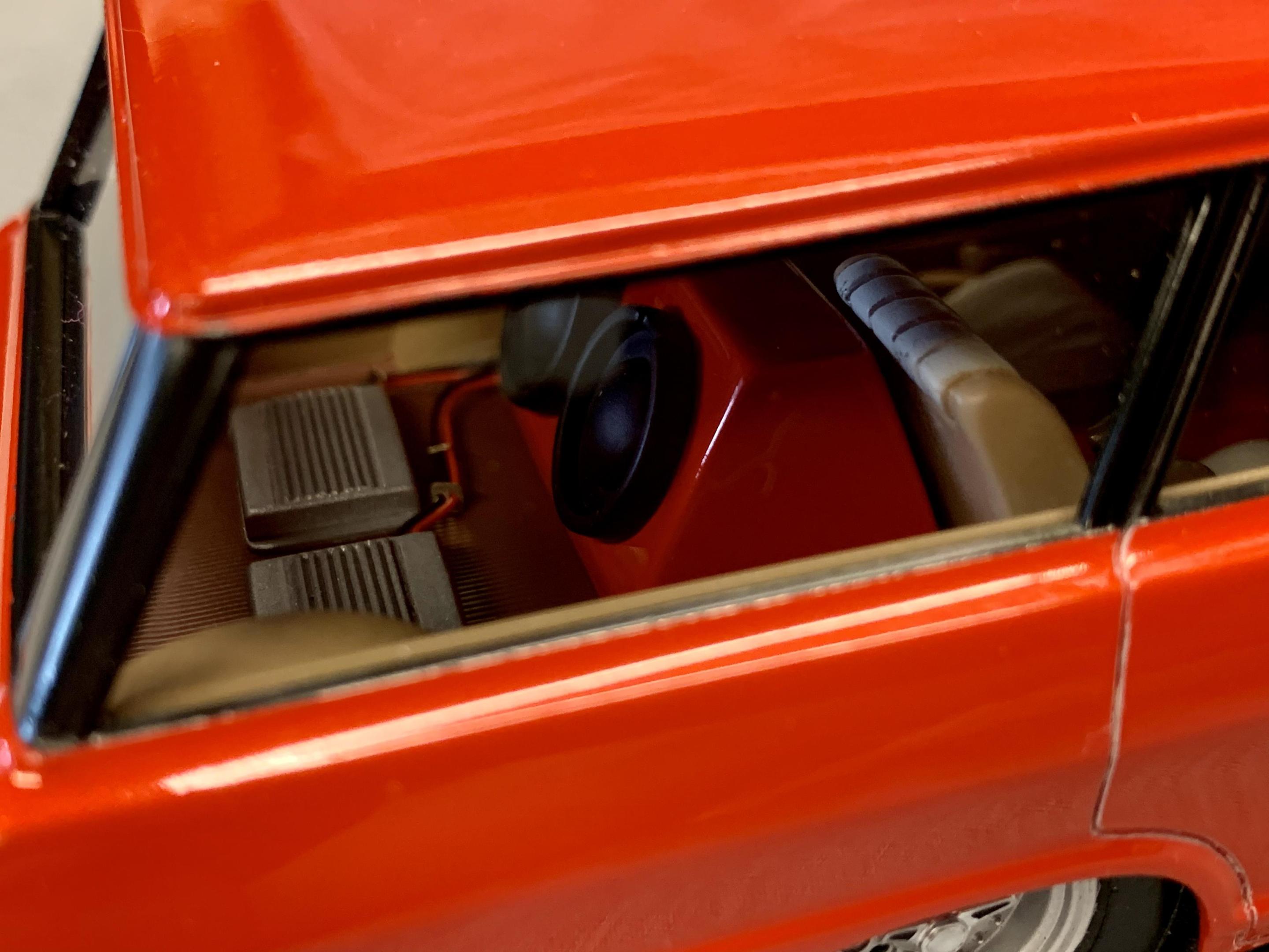

- Interior HEAVILY modified. Molded-in front bench seat cut out and floor filled in its place. Entire face of dashboard cut out and replaced with flat panel. Sides panels smoothed, door lines cut and raised detail panels scratch built. Two pairs of buckets seats fit from Revell Dan Fink ‘32 Speedwagon Woodie. Revell ‘37 Ford Sedan tilt column. Revell ZZ Top Eliminator Coupe steering wheel. Center console, subwoofer box, subwoofer faces and amplifiers scratch built. Detail Master dash panel with digital gauges, stereo head unit and graphic equalizer, door handles, pedal pads and speaker grills. Spare tire cover opened and matching spare wheel added. Squirrel stuffed animal from kit.
- Tamiya TS92 Pure Red over their fine gray primer with their gloss clear on top. Polished and waxed with Adam’s products. Interior colors: Tamiya AS15 Tan, AS16 Light Gray and TS62 NATO Brown.

Beautiful looking build. Almost a shame the interior is hidden away inside. Paint finish is smooth as glass, and I like the black trim around the windows. Got a lot of good ideas for future projects watching your build.

WOWSER....that is straight up one good looking ride.  Great detail work and the business end is killer.  That red looks really deep.  Great Job.

Dennis, This is by far the best chevy ll wagon I'v seen. The engine is perfect for what should be in a 1.1 car like this. Thanks for not putting a LS or shoe horning a big block in there. Drips old school. Great job on the engine bay details to! The paint work looks flawless. Wheels and tires fit real nice and the car sits as it should for a street machine. But that interior work you did really is something special! This was a pleasure to watch you build also. Outstanding work!

Two amps, two 12” subs, 4 speakers, and 2 tweeters in the dash... you could open the doors, walk back a couple hundred feet, and still hear the music clearly. Excellent scratch building and the body colored bumpers and grille for sure give it that early 90’s look.
