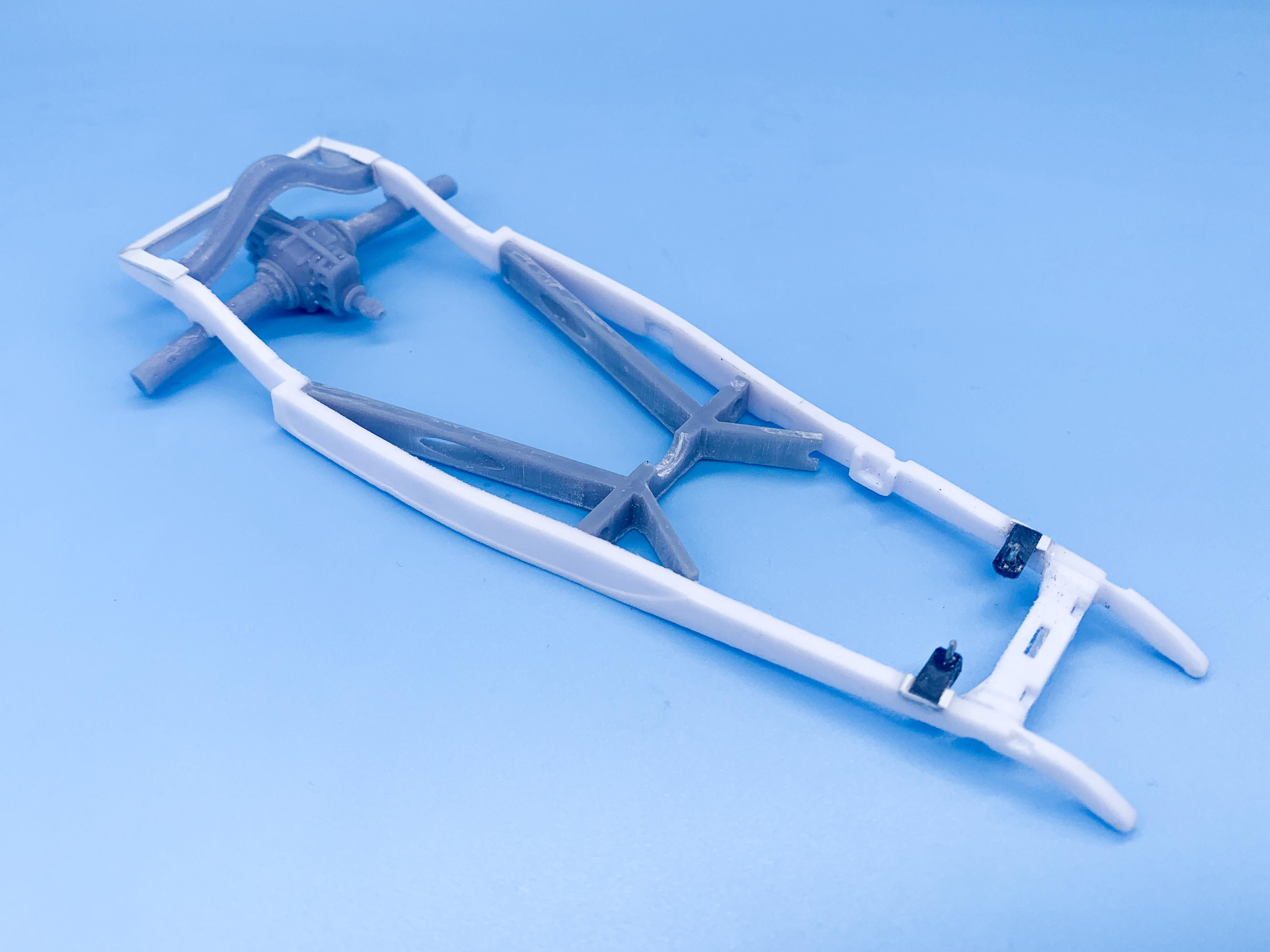

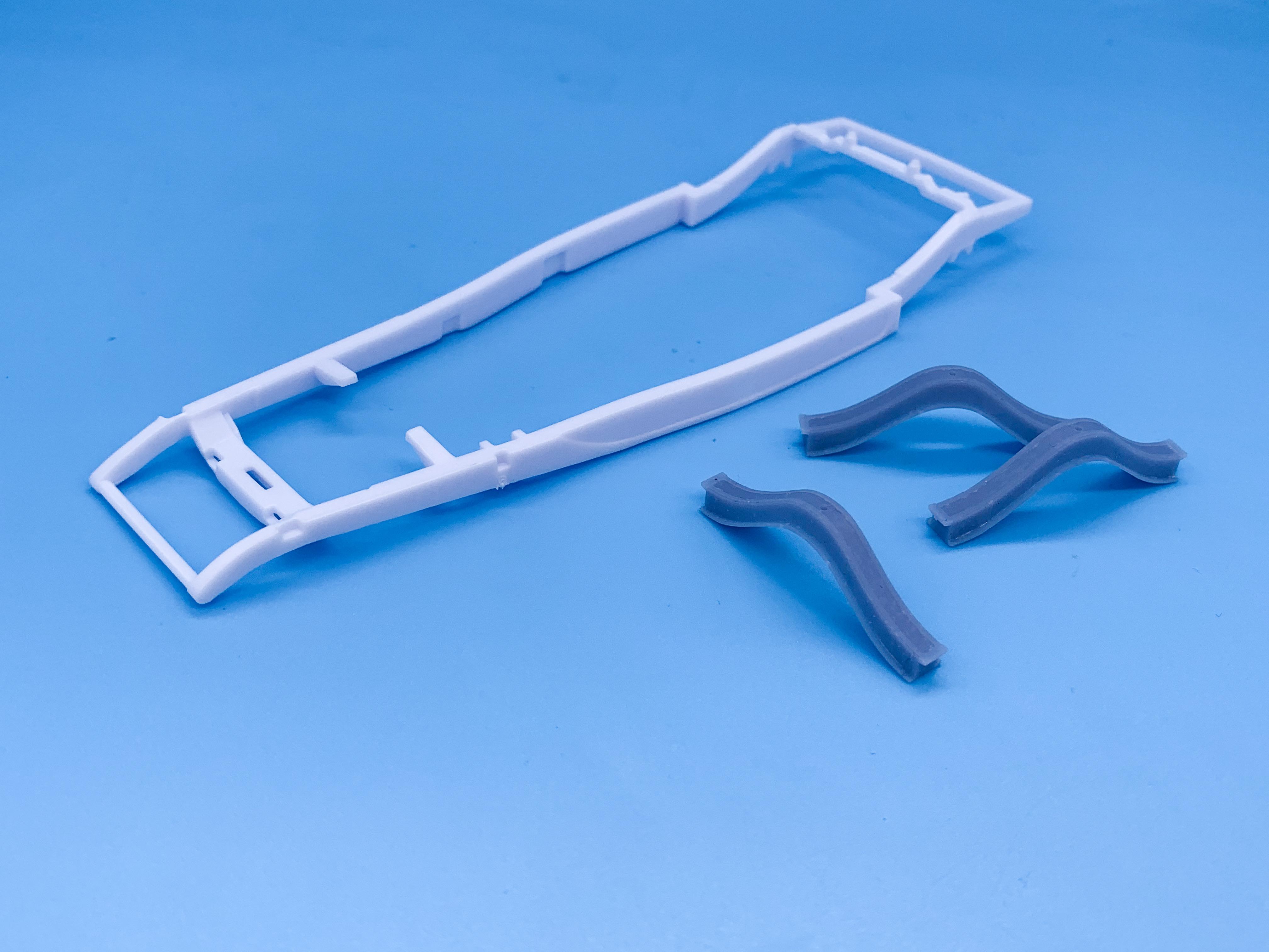

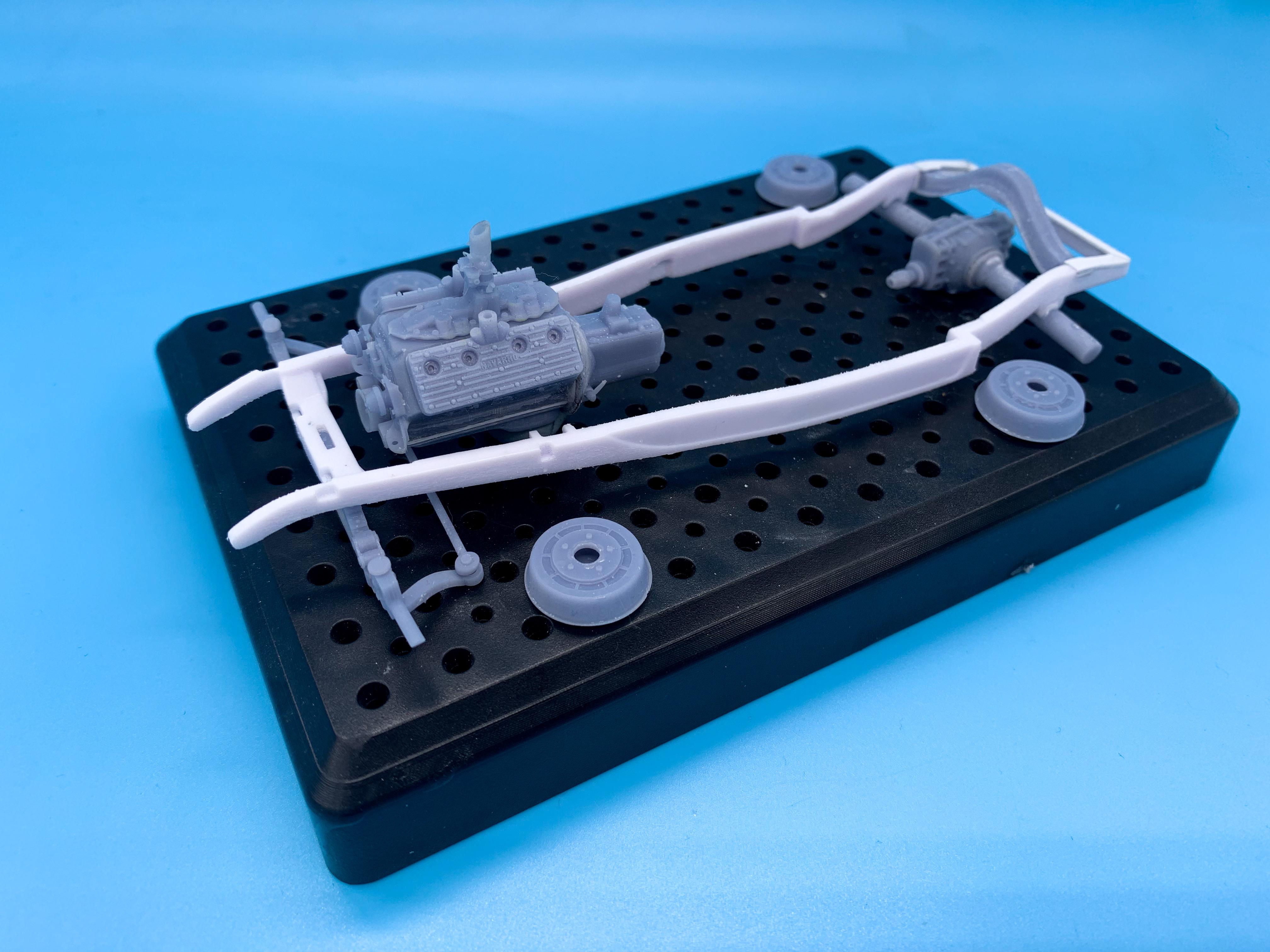

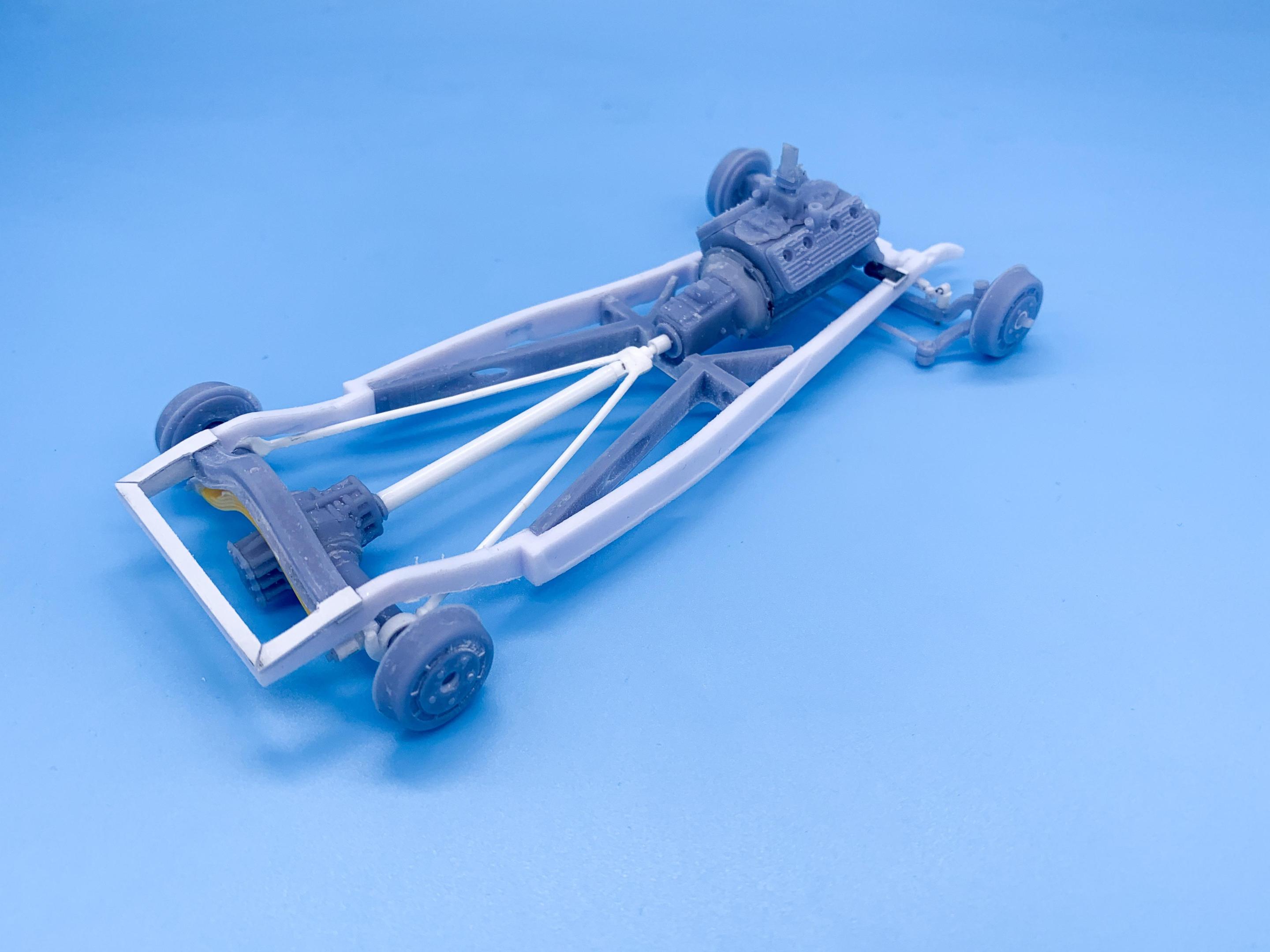

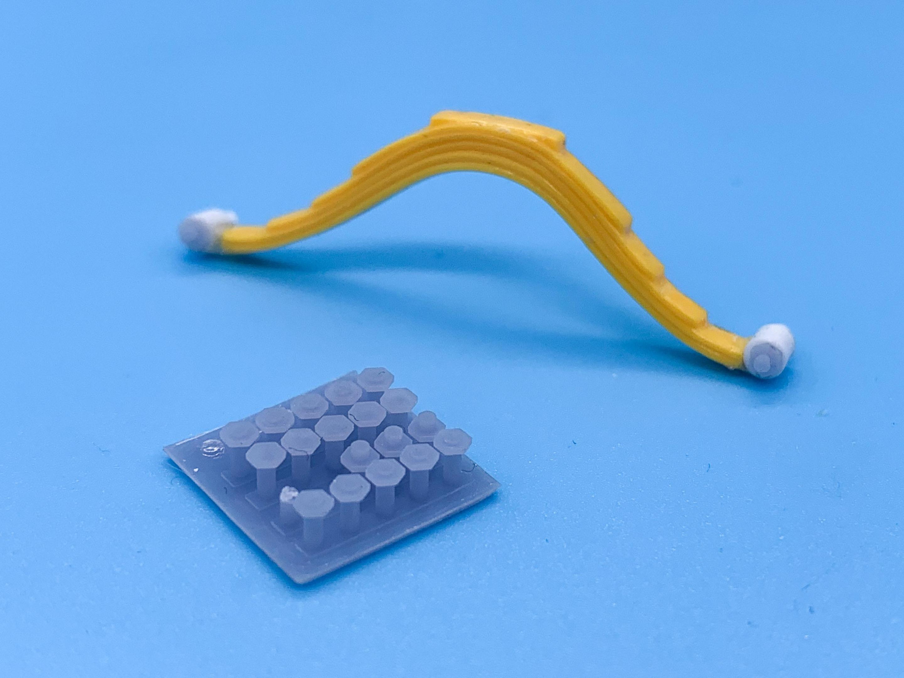

Started off with the frame…I’m actually going to use the one from the 29/30 Revell kits - but modified for a leaf spring.  I didn’t have a spare Revell Model A frame to steal the crucial spring arch from, so I drew one up in CAD and printed a few:

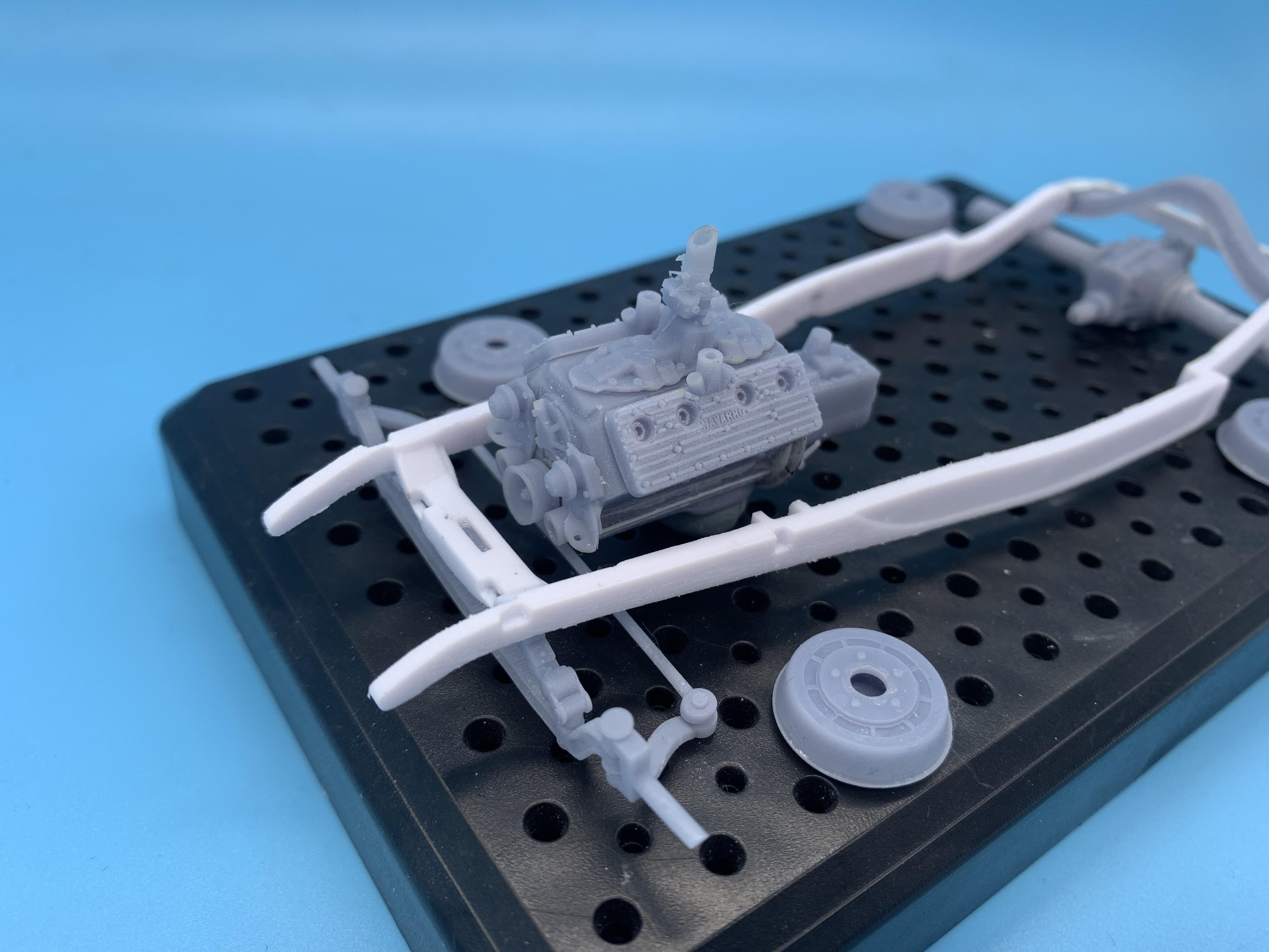

Whilst I was printing stuff, I printed a Matty’s Custom Scale Flathead
Check out the detail on those heads!  Gorgeous!
I know I said no flashy stuff on this build…but those heads are SO nicely done…

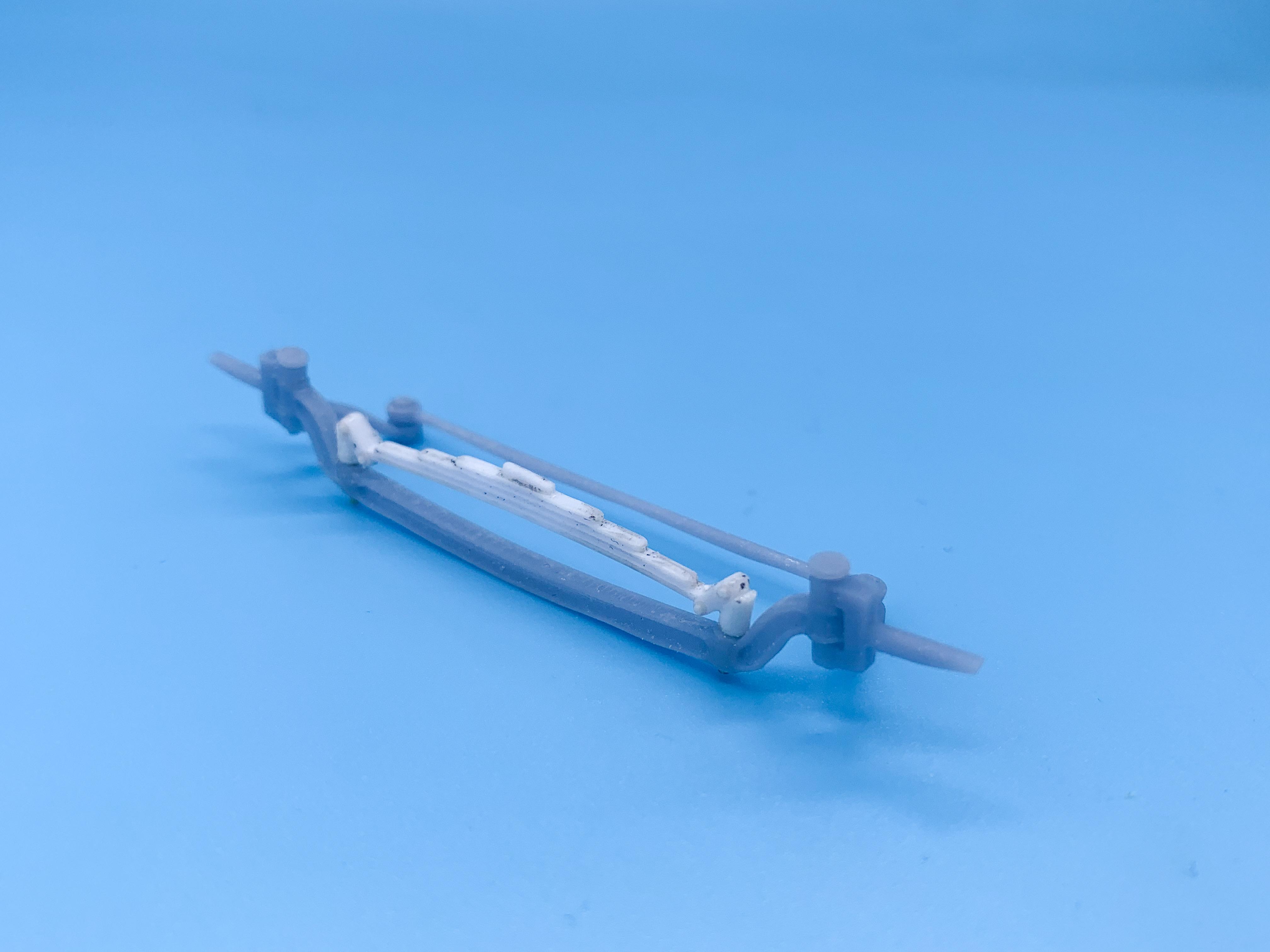

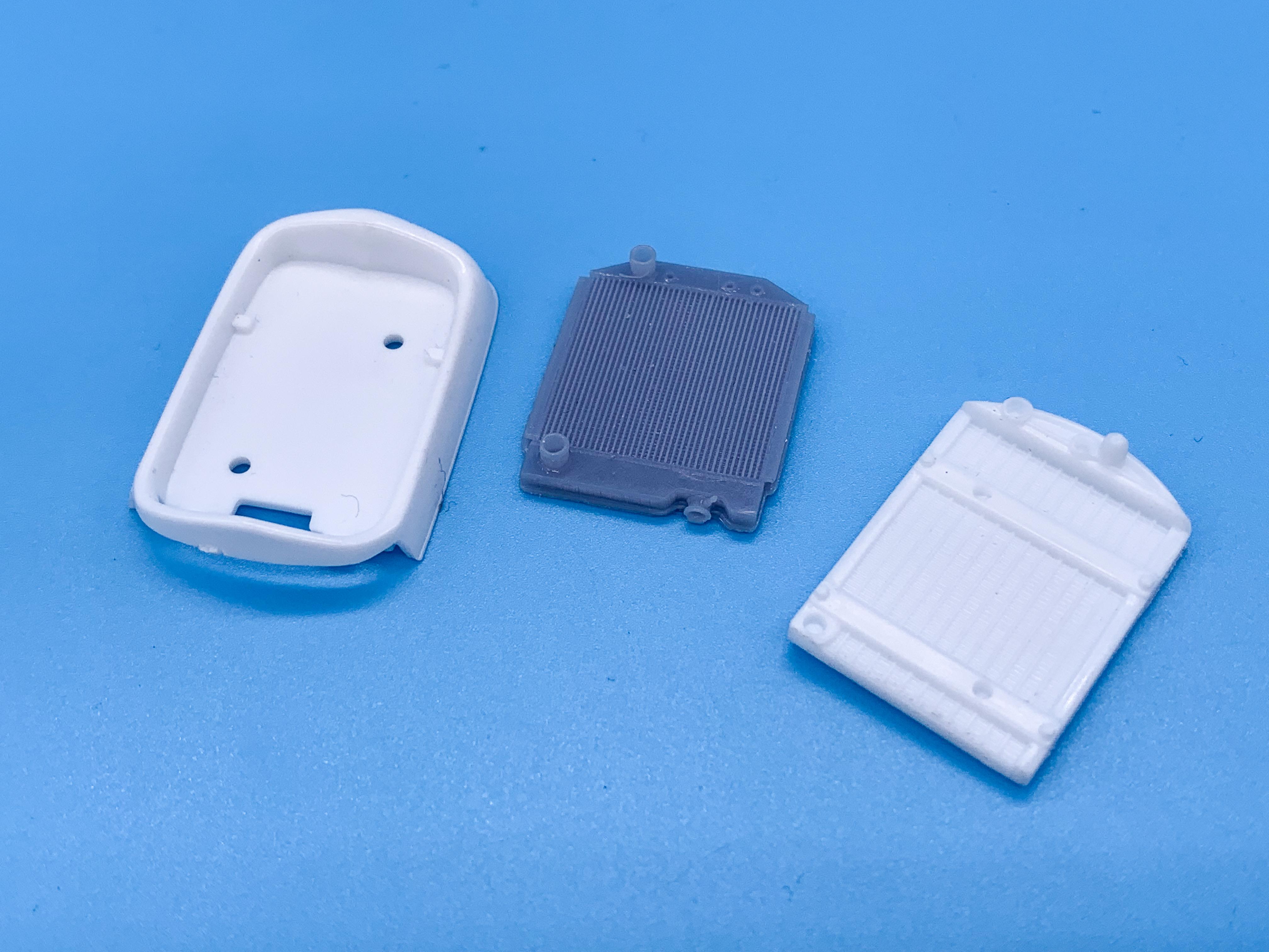

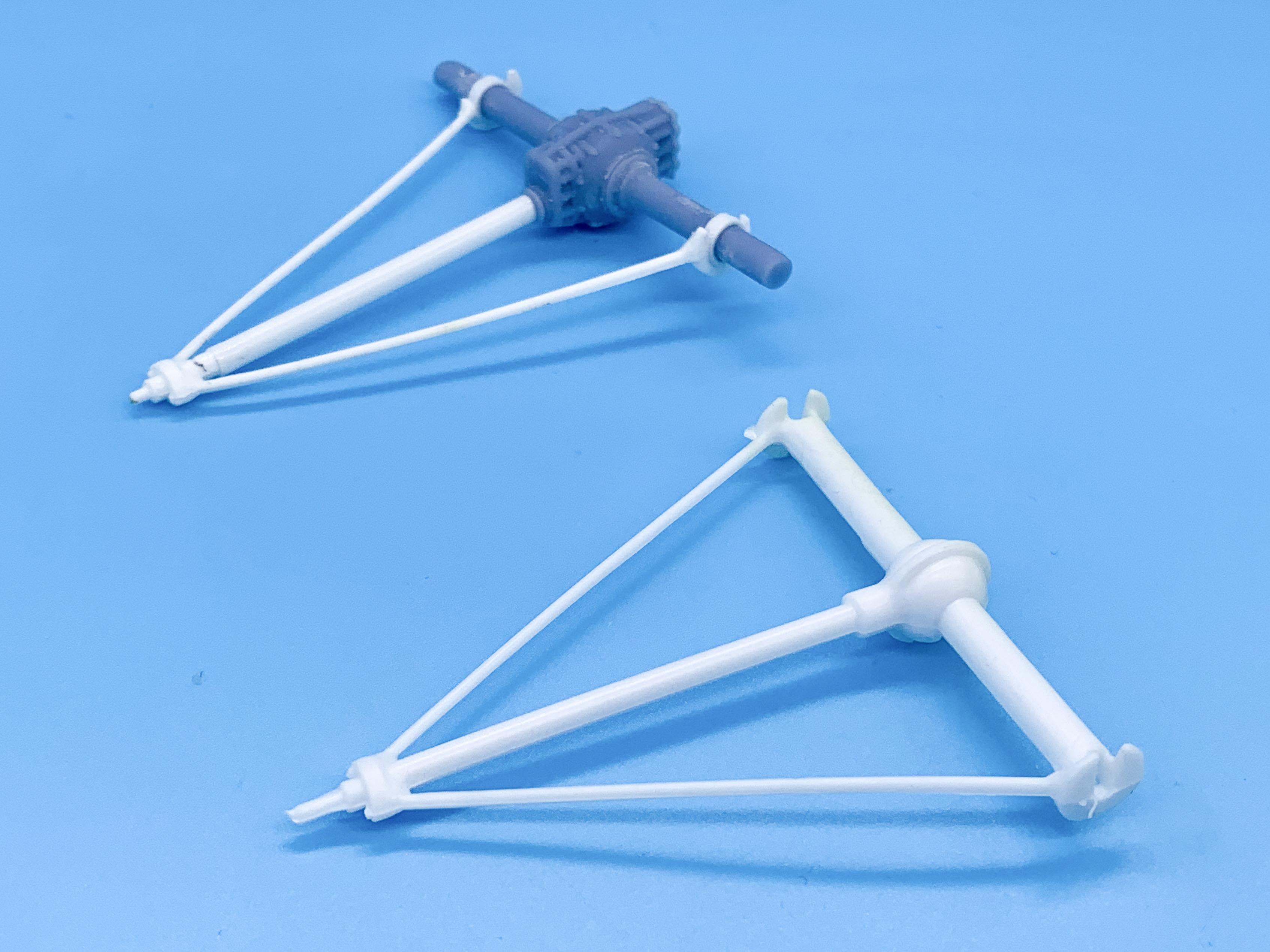

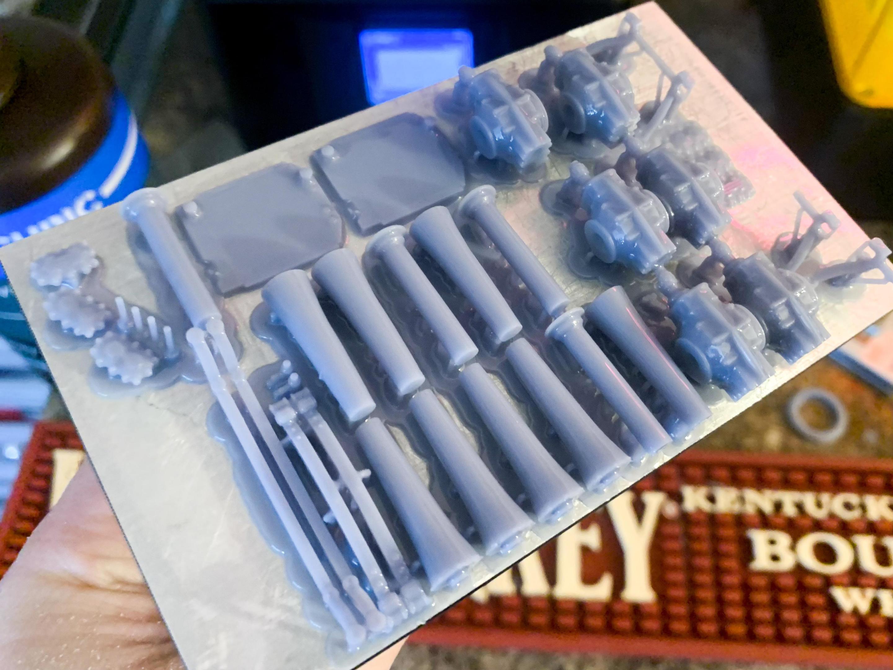

Next batch of parts was front and rear axles and some radiators for this and future projects:
I really didn’t NEED to print any radiators, I’ve got a bunch of the kit ones, but I had the file sitting there and space on my print plate - they’re nicely done though!

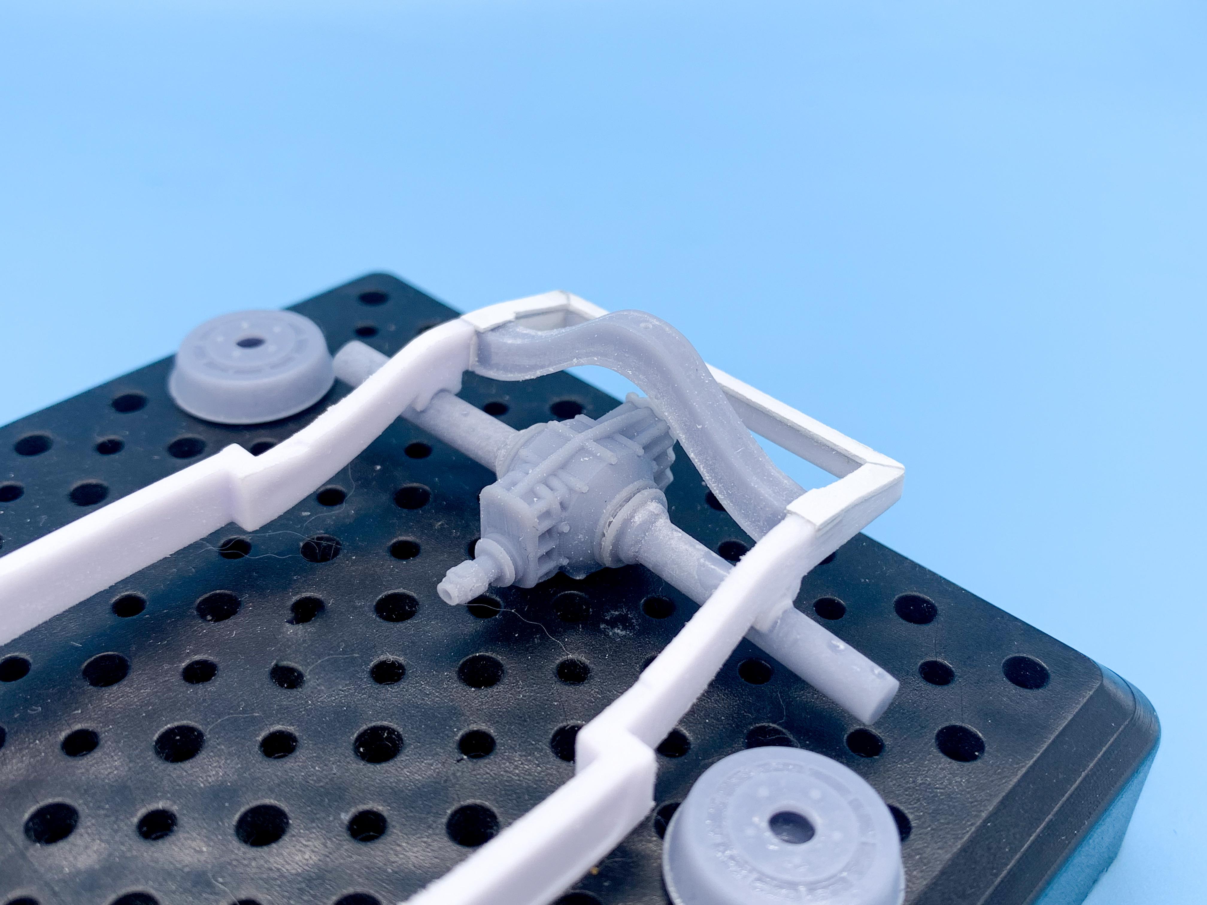

Rear axle mocked up with Elmer’s:
I didn’t wanna run disk brakes on this car, and the GORGEOUS finned parts you find in the Revell Model A kits were a bit too fancy for what I had in mind, so I printed some simpler drums:
And once I mocked up the 3D printed axle…

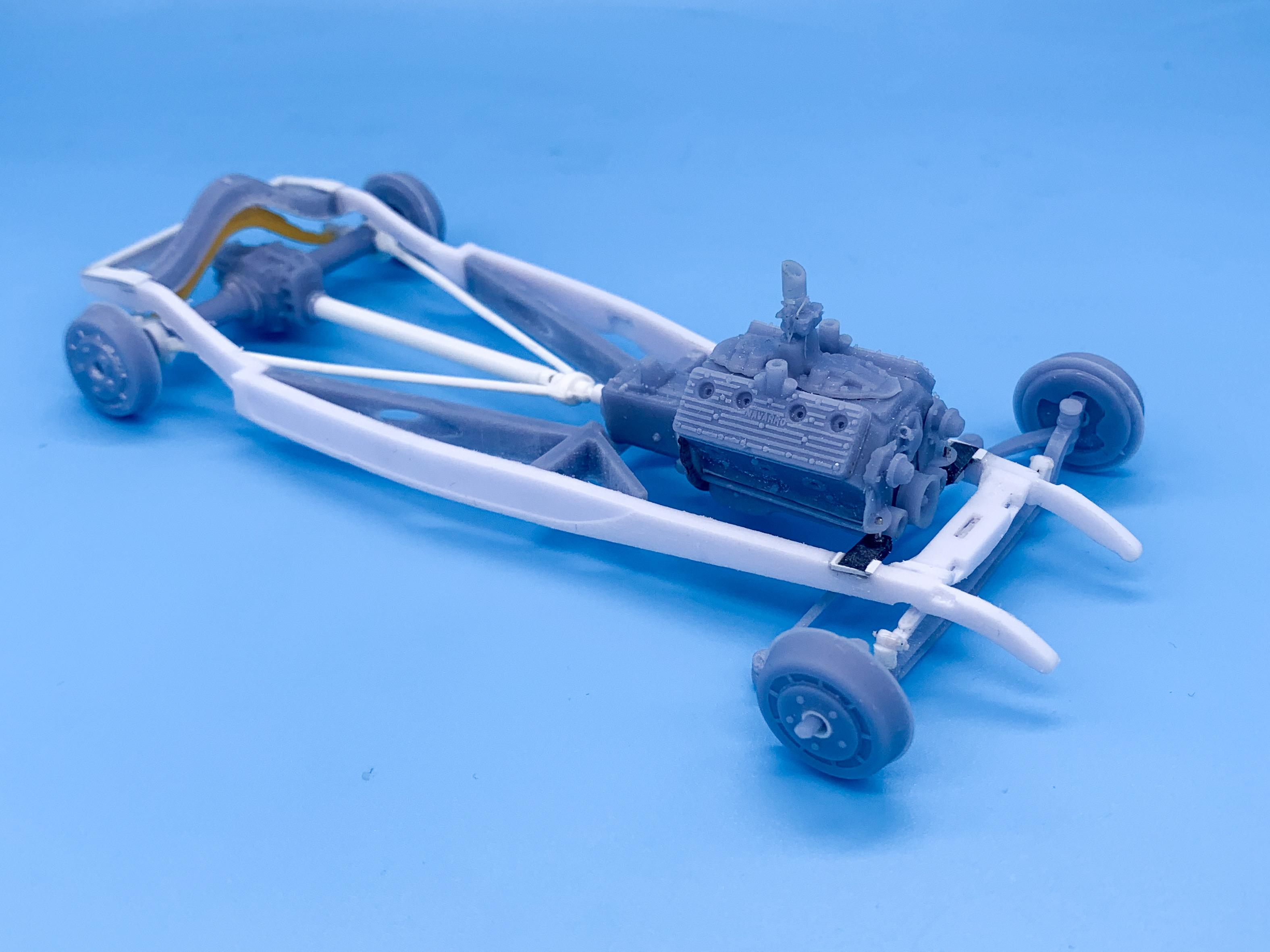

…we’ve got a decent start on a chassis:
I was really trying NOT to 3D print every single little thing on this build, especially as I have another complex build like that on the bench already…but in my defense the donor kit was missing a couple of parts and the rest needed backdating anyway ?
Thanks for looking…more soon!

I notice on your front axle the spring shackles are angled as if there is no weight on the front axle. The picture I've added here shows the angle of the spring shackle that has weight on it. The weighted front end's shackle leans downward from the spring perch to the spring eye. The only way it could be like yours is if the front of the car was jacked up off the ground by the frame and the axle was hanging freely...

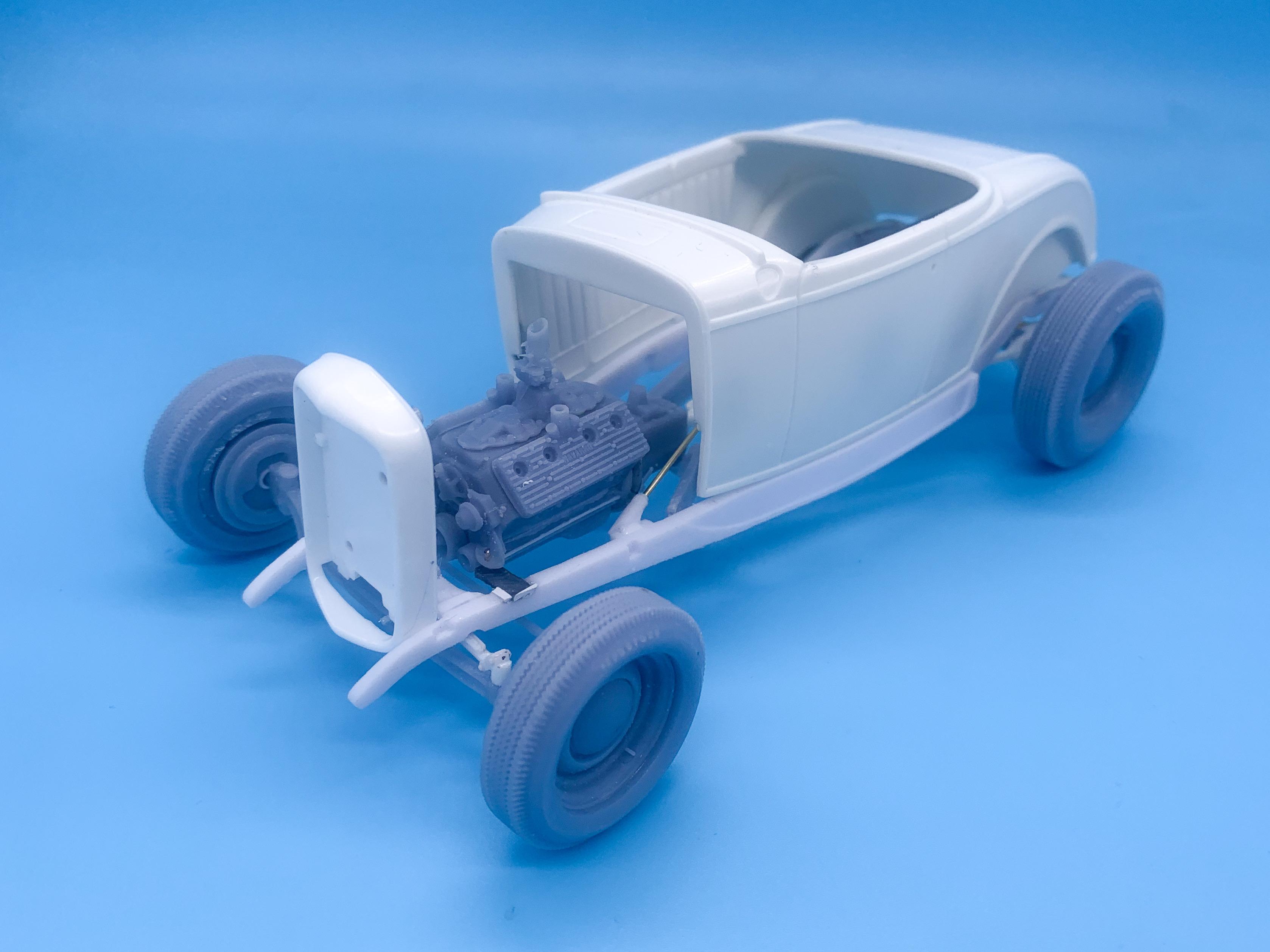

As much as I love these Revell deuces, one thing that has always bothered me was the incorrect rear wheel well portions (on the roadster and 5 window versions of the kit). I tried to scratch up some modified masters to cast more correct replacements years ago, but never crossed the finish line.
^^ a not-so-visible body line Revell missed on a steel '32 roadster and 5 window body, likely more correct for a fibreglass body
I suppose with 3D printing (which I really have to get into one day), replicating this body panel becomes less of a challenge.
Good spot!  Thank you!!!  I couldn’t tell what was bugging me about that front end…you helped me figure it out without having to exert any brainpower ?

Thanks for the tip on those rear wheel-wells…I should look and see how visible they’ll be on the finished build - I never knew about that issue - appreciate you bringing it up!  As for the crossmember…
I couldn’t bring myself to pick up a Revell 40 kit to get the crossmember, only to modify it beyond recognition to get what I had in my head…so I just drew what I had in my head in CAD.  My idea for this build was to simplify and cleanup as much as I can and really boil this build down into a really nice clean flowing design, but not in the street rod sense…just a SUPER cleaned up traditional-inspired build.  Not lacking in detail, or something that wouldn’t be feasible in the real world (hopefully), but super tidy.
So, here’s my simple crossmember design:
And installed in the frame:
I’ve got a more detailed version that I’ll mess with for some future builds, but this was a good test and perfect for what I was going for on this one…
Back on the suspension; here’s my solution to the implausible spring…ended up using a slightly modified kit part from something or other…I also moved the crossmember on the kit frame up a couple of scale inches to drop the nose down somewhat - it won’t be super low but I was trying to stay fairly traditional and close to a ‘standard’ setup
Not much progress for an entire Sunday and most of this evening…but I can get into some bigger projects now these are done - need to either design and print or modify a rear spring and get this thing on it’s wheels.
Thanks for looking - more soon, soon as I’ve done more!

Tonight’s project was modifying some parts box early-Ford kit suspension pieces to finish up the rear end assembly:
Plus, a parts box rear spring modified to suit:
Starting to get somewhere now…
I’m sacrificing a little scale fidelity on the rear end for having good strong attachment points when I come to assemble this thing - the resin tires I’ve got are relatively heavy and most of this assembly will be hidden once the body’s on and the exhausts are in place so I’m sacrificing a little detail for not having too delicate of a build by the end…
Another mock-up to see if we’re still copacetic…needed some fine tuning but it’s starting to look like a hot rod!
Next job is finishing up the front end properly…more soon, soon as I’ve done more!

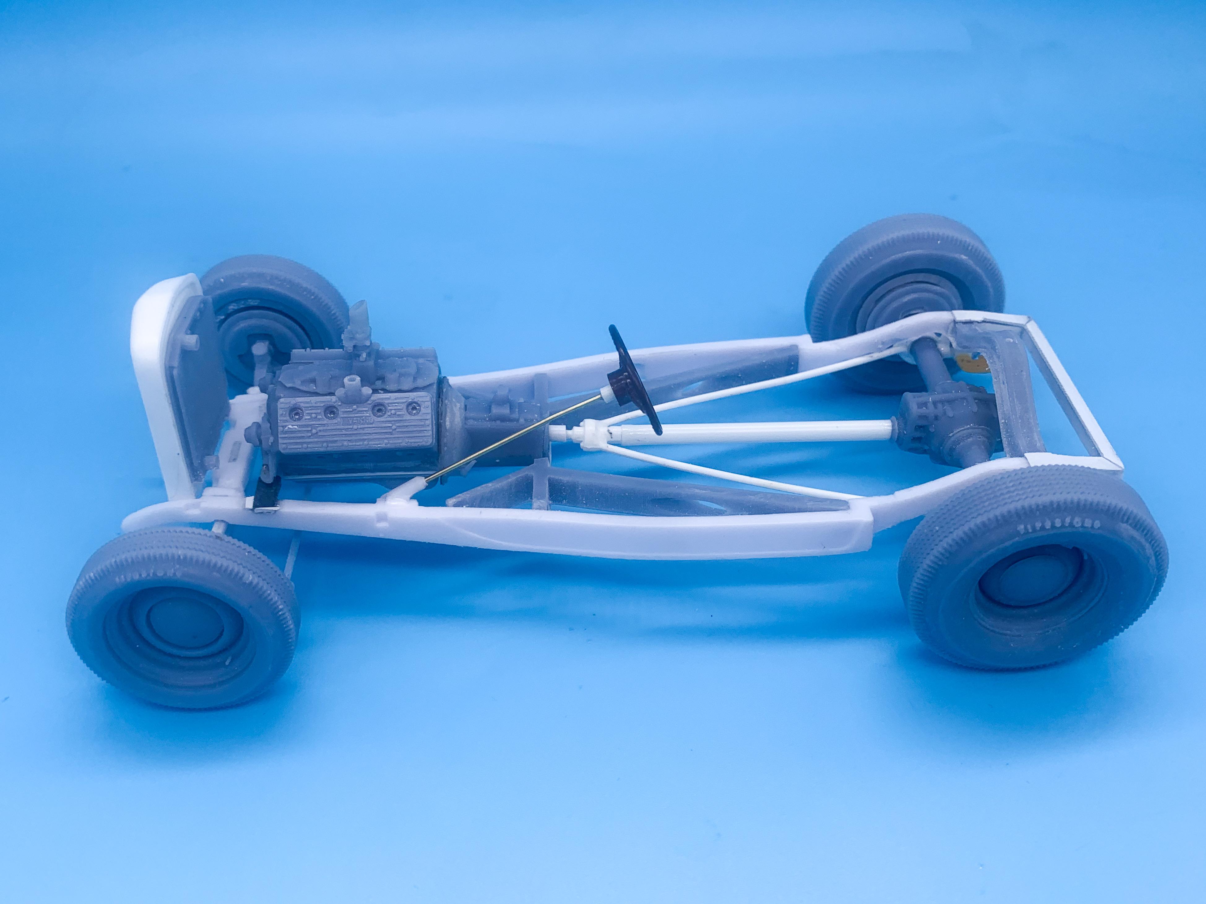

A little progress tonight - got far enough along for a mock-up with wheels and tires to see how it’ll look!
Still need to make some proper wheel backs - it’s just poster-tacked and Elmer’d together right now but good enough for a quick mock-up…
Not perfect, but not TOO far off - looks like an old hot rod! ?
These wheels and tires are a really nicely done design that isn’t on the market yet but they will be soon-ish…someone else’s design that they kindly allowed me early access to so I could mess with them a little.  I’ll post details on them once they’re out there to buy…
Not a big update, but it was fun seeing it on it’s wheels properly for the first time!  Still need to work on linkages for the front axle, finish up the steering and then next major project is the floor.
Thanks for looking, more soon!

This is looking great Chris. Really like how you extended the steering column for mockup purposes so you can see where the steering wheel ends up.
The tires look really good. It's hard to tell from the angles but they are big n' little's, no?
In my opinion the offset on the front wheels looks a little deep, but could be a camera trick or something.
I'm very interested in the wheels/tires as they are right up my alley as far as build style.
