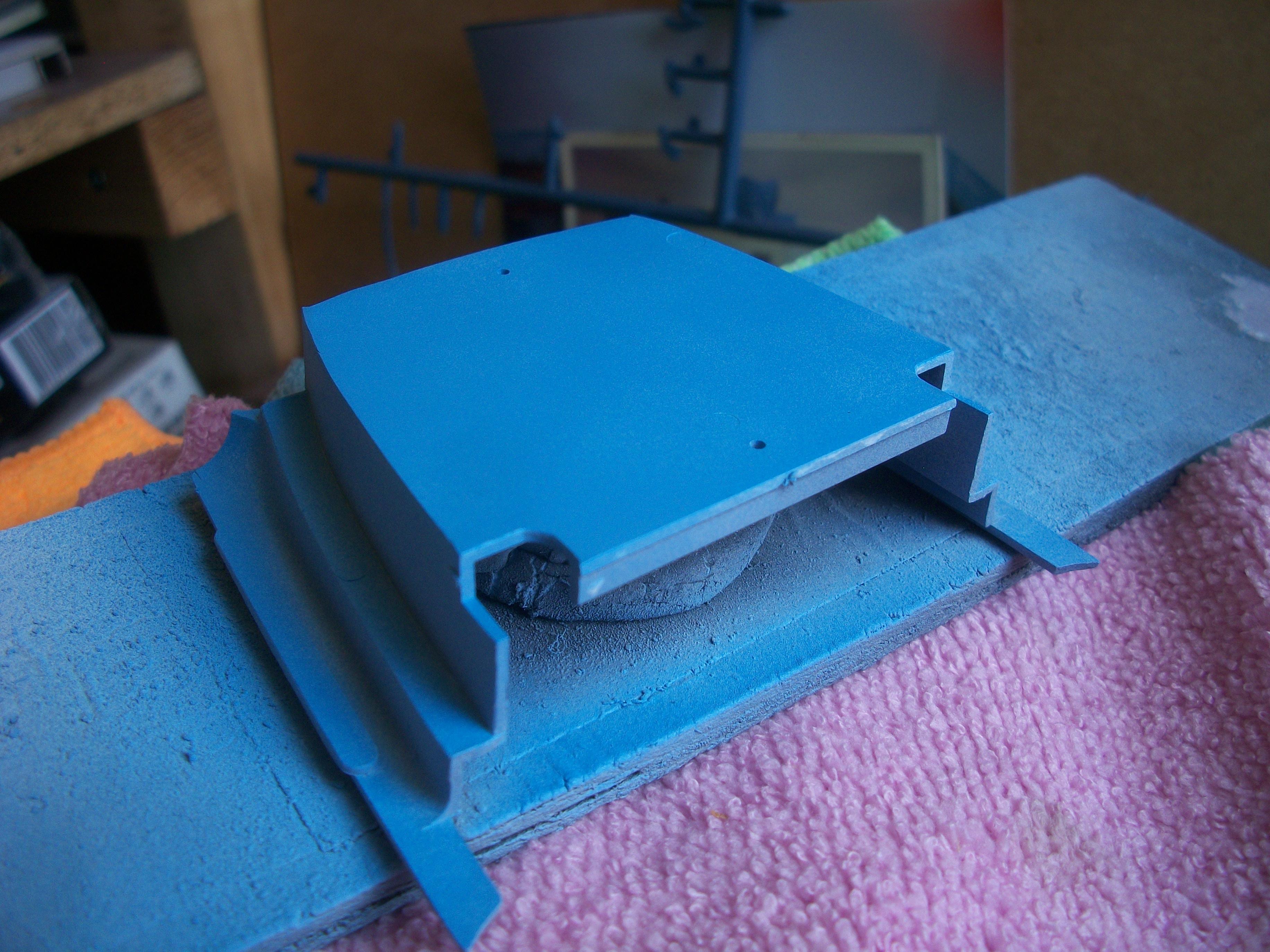

Joe Lange Posted June 17, 2023 Posted June 17, 2023 On 6/16/2023 at 8:03 PM, Anglia105E said: Thanks a lot Joe . . . Certainly, the more modern paints are not the same as the older versions. Someone suggested that the Rust-oleum Spa Blue Gloss might even have a primer already as part of it's formula, and consequently if the Spa Blue Gloss was then applied over the Plastic Primer White, this ' might ' cause an unusual reaction ? (That's not what it says on the tin ! ) I thought about the Tamiya TS-10 French Blue and the TS-23 Light Blue, but cannot find a supplier for those paints. Also not sure about acrylics. Some WIP pics will be posted soon ! David Expand I have a real problem with these 'Hi-Tech', "PRIMER & PAINT in ONE!" paints. To me, it's a modern term for;.... Yea, I'm lazy! I definitely would not spray a 'paint & primer' paint over a piece you have just primed already. That being said, I see Rust-oleum has 2 Spa Blue gloss sprays. One is their '2x' paint & primer, the other is their 'Painter's Touch', which has no mention of primer in the paint. I would feel safer with the 2nd and use a thin coat of light gray rust-oleum primer, with lots of cure time, for both. I would test it under the hood, oops...sorry, bonnet first.
Anglia105E Posted June 17, 2023 Author Posted June 17, 2023 On 6/17/2023 at 6:45 PM, Joe Lange said: I have a real problem with these 'Hi-Tech', "PRIMER & PAINT in ONE!" paints. To me, it's a modern term for;.... Yea, I'm lazy! I definitely would not spray a 'paint & primer' paint over a piece you have just primed already. That being said, I see Rust-oleum has 2 Spa Blue gloss sprays. One is their '2x' paint & primer, the other is their 'Painter's Touch', which has no mention of primer in the paint. I would feel safer with the 2nd and use a thin coat of light gray rust-oleum primer, with lots of cure time, for both. I would test it under the hood, oops...sorry, bonnet first. Expand Oh I see . . . That's okay then Joe, because my can says ' Painter's Touch ', so no primer in there presumably. The Spa Blue Gloss over the Plastic Primer White seems to be stable after 4 days since application, and it hasn't eaten the 60 year old plastic ! The surface for this test is the underside of the engine bay, which will have a further week of curing to be safe. David 1
Dave G. Posted June 17, 2023 Posted June 17, 2023 (edited) I mentioned way back in the thread ( I think it was this thread on Rustoleum) that I decant 2X and Painters Touch, thin a little extra with lacquer thinner and spray it via airbrush over Stynylrez primer. The results are equal to that of having sprayed the Old Model Master Enamels or the square bottle Testors thinned with Lacquer thinner which is kind of the old time standard. But it's all airbrush work. There isn't a thing wrong with PT or 2X if done right. It comes out great. Non the less, I see that Amazon UK sells airbrush sets. Just sayin. I know that seems daunting to some folks but some of us have been painting spray cans or airbrush for 60 years and you find ways to solve problems is best I can say. That said, I've spent now about 8-10 years to get acrylics to performs as I want them to. So I don't use many solvent paints these days. I wish you the best in your endeavors however you go ! Just keep at it. Edited June 17, 2023 by Dave G.
Anglia105E Posted June 17, 2023 Author Posted June 17, 2023 On 6/17/2023 at 8:41 PM, Dave G. said: I mentioned way back in the thread ( I think it was this thread on Rustoleum) that I decant 2X and Painters Touch, thin a little extra with lacquer thinner and spray it via airbrush over Stynylrez primer. The results are equal to that of having sprayed the Old Model Master Enamels or the square bottle Testors thinned with Lacquer thinner which is kind of the old time standard. But it's all airbrush work. There isn't a thing wrong with PT or 2X if done right. It comes out great. Non the less, I see that Amazon UK sells airbrush sets. Just sayin. I know that seems daunting to some folks but some of us have been painting spray cans or airbrush for 60 years and you find ways to solve problems is best I can say. That said, I've spent now about 8-10 years to get acrylics to performs as I want them to. So I don't use many solvent paints these days. I wish you the best in your endeavors however you go ! Just keep at it. Expand Many thanks for your input and words of encouragement David . . . Next week I shall be testing Tamiya lacquer paints from spray can, which will be my first experience with these products. It will be interesting to see how the Tamiya compares with the Rust-oleum. David

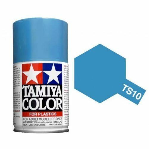

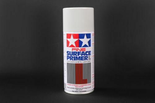

Anglia105E Posted June 17, 2023 Author Posted June 17, 2023 Just ordered these two products from Ebay . . . Tamiya TS-10 French Blue and Fine Surface Primer White. Testing of the Tamiya paint products is scheduled for next week . . . Watch this space ! David 1
Dave G. Posted June 17, 2023 Posted June 17, 2023 On 6/17/2023 at 9:25 PM, Anglia105E said: Just ordered these two products from Ebay . . . Tamiya TS-10 French Blue and Fine Surface Primer White. Testing of the Tamiya paint products is scheduled for next week . . . Watch this space ! David Expand You'll like it, looks like a decent match as well. If it's warm and humid wait for a cooler and or dryer day for the color.
Anglia105E Posted June 17, 2023 Author Posted June 17, 2023 On 6/17/2023 at 9:56 PM, Dave G. said: You'll like it, looks like a decent match as well. If it's warm and humid wait for a cooler and or dryer day for the color. Expand Cheers and thanks David, David
bobthehobbyguy Posted June 18, 2023 Posted June 18, 2023 On 6/17/2023 at 9:25 PM, Anglia105E said: Just ordered these two products from Ebay . . . Tamiya TS-10 French Blue and Fine Surface Primer White. Testing of the Tamiya paint products is scheduled for next week . . . Watch this space ! David Expand Smart move. Don't think you will regret it.

Anglia105E Posted July 5, 2023 Author Posted July 5, 2023 On 7/5/2023 at 3:57 PM, ctruss53 said: "acrylic" No, automotive paints are not usually acrylic. They are almost always a lacquer of some sort. And because of this I don't like using the term acrylic unless a paint is truly water-based. Expand Thanks Chad . . . So, at the risk of sounding stupid . . . Would the Tamiya paint products such as Tamiya TS-10 French Blue be ' Lacquer ', or alternatively would they be ' Acrylic Laquer ' ? ( and does it matter? ). Having applied the Tamiya paints to my 60 year old Frog model car kit styrene, I haven't noticed any unpleasant or alarming chemical reactions going on . . . What a relief ! David
ctruss53 Posted July 5, 2023 Posted July 5, 2023 (edited) On 7/5/2023 at 4:41 PM, Anglia105E said: Thanks Chad . . . So, at the risk of sounding stupid . . . Would the Tamiya paint products such as Tamiya TS-10 French Blue be ' Lacquer ', or alternatively would they be ' Acrylic Laquer ' ? ( and does it matter? ). Having applied the Tamiya paints to my 60 year old Frog model car kit styrene, I haven't noticed any unpleasant or alarming chemical reactions going on . . . What a relief ! David Expand There are no stupid questions. Tamiya TS spray paints and primers are lacquers. They might throw around the term acrylic, but they are lacquers. Having said that Tamiya primers and TS series spray paints are designed specifically for use on plastic model kits. They will work with your classic model kit, I have no doubts. Tamiya products are the most stable, easiest to use products. I have never had any issues with their products. This post is not sponsored by Tamiya. I only know that they are the most versatile products. They just work. Always. Edited July 5, 2023 by ctruss53
Anglia105E Posted July 5, 2023 Author Posted July 5, 2023 On 7/5/2023 at 4:47 PM, ctruss53 said: There are no stupid questions. Tamiya TS spray paints and primers are lacquers. They might throw around the term acrylic, but they are lacquers. Having said that Tamiya primers and TS series spray paints are designed specifically for use on plastic model kits. They will work with your classic model kit, I have no doubts. Tamiya products are the most stable, easiest to use products. I have never had any issues with their products. This post is not sponsored by Tamiya. I only know that they are the most versatile products. They just work. Always. Expand Okay Chad . . . and I agree completely with you. Why during the past 7 years of building and painting scale model cars I haven't once looked at trying Tamiya paint products, I do not know . . . I am already aware how good the Tamiya kits are, having built the Morgan and the Jaguar MK 2, so I really should have tried out Tamiya paints long before now. Anyway, I do like them and within a day or so I shall be using Tamiya Polishing Compound on the Cortina. I shall have to go gently with the Coarse grade of the compounds, because I don't want to go down to primer on this car. I have only applied two coats of the French Blue, and quite thin coats at that. I did use Coarse, then Fine, and then Finish on my Rolls-Royce Silver Cloud, but I did see the underlying primer coat appear during the application of the Coarse grade, which forced me to start the paint procedure from scratch. That was two applications of each grade of compound. David
ctruss53 Posted July 5, 2023 Posted July 5, 2023 On 7/5/2023 at 5:05 PM, Anglia105E said: Okay Chad . . . and I agree completely with you. Why during the past 7 years of building and painting scale model cars I haven't once looked at trying Tamiya paint products, I do not know . . . I am already aware how good the Tamiya kits are, having built the Morgan and the Jaguar MK 2, so I really should have tried out Tamiya paints long before now. Anyway, I do like them and within a day or so I shall be using Tamiya Polishing Compound on the Cortina. I shall have to go gently with the Coarse grade of the compounds, because I don't want to go down to primer on this car. I have only applied two coats of the French Blue, and quite thin coats at that. I did use Coarse, then Fine, and then Finish on my Rolls-Royce Silver Cloud, but I did see the underlying primer coat appear during the application of the Coarse grade, which forced me to start the paint procedure from scratch. That was two applications of each grade of compound. David Expand Yeah, Tamiya products just work. Their only problem is they have a somewhat limited selection of colors compared to other brands. I'm not sure what your second paragraph is asking, but I will answer what I think you are asking. Compounds meaning how you polish out the paint? With Tamiya paints I always apply a clearcoat. I prefer the Mr Super Clear Gloss UV Cut from Mr Hobby, but Tamiya makes a good TS series gloss clear as well. Apply your primer in light coats. 2-3 coats. 3-4 minutes between coats. Just enough to get even coverage. Then a few hours later you can apply your Tamiya color coats. Again, apply the paint light. Keep the spray can moving and apply the paint light. 2-4 coats of paint should do it. Wait 5-7 minutes between coats. Apply as little paint as possible until you get even color. Then let the paint cure for at least a day. I like to wait 2 or 3 days, but you can apply clear as soon as a day later. Then with clear, build it up light like the paint. Apply 2-3 very light coats. 5-7 minutes between these light coats of clear. Just build it up and coat as evenly as possible. But then once you have the clear foundation built up a bit, then apply 1-2 wet coats. Not so wet the paint runs, but slow down a little and apply the paint a little heavier so it is visibly wet and smooth. And wait 10-12 minutes between these wet coats. Then once you have applied the clear, let your model sit for a week before you polish it out. The longer you let it sit, the harder the finish will be. Then to polish it out start with 3000 grit and wet sand it. Use lots of water and do not use force. Sand very lightly and let the paper do the work. Then use 8000 grit. Again, use lots of water, and very little pressure. Let the paper do the work. Then use a rubbing compound or a scratch remover. This might also translate to a medium model polishing compound. Maybe the coarse stuff. I'm not sure. This might be worth testing on a spare part. Then use a polishing compound. This might translate to medium or fine modeling compound. Again, I am not sure. But this is the last step before wax, so maybe this would be the fine compound. And again at all steps, don't apply much pressure. Let the paper or compound do the work. NOTE: This is how I do it. Other people will have different techniques. But this process works consistently for me.
Anglia105E Posted July 5, 2023 Author Posted July 5, 2023 On 7/5/2023 at 5:31 PM, ctruss53 said: Yeah, Tamiya products just work. Their only problem is they have a somewhat limited selection of colors compared to other brands. I'm not sure what your second paragraph is asking, but I will answer what I think you are asking. Compounds meaning how you polish out the paint? With Tamiya paints I always apply a clearcoat. I prefer the Mr Super Clear Gloss UV Cut from Mr Hobby, but Tamiya makes a good TS series gloss clear as well. Apply your primer in light coats. 2-3 coats. 3-4 minutes between coats. Just enough to get even coverage. Then a few hours later you can apply your Tamiya color coats. Again, apply the paint light. Keep the spray can moving and apply the paint light. 2-4 coats of paint should do it. Wait 5-7 minutes between coats. Apply as little paint as possible until you get even color. Then let the paint cure for at least a day. I like to wait 2 or 3 days, but you can apply clear as soon as a day later. Then with clear, build it up light like the paint. Apply 2-3 very light coats. 5-7 minutes between these light coats of clear. Just build it up and coat as evenly as possible. But then once you have the clear foundation built up a bit, then apply 1-2 wet coats. Not so wet the paint runs, but slow down a little and apply the paint a little heavier so it is visibly wet and smooth. And wait 10-12 minutes between these wet coats. Then once you have applied the clear, let your model sit for a week before you polish it out. The longer you let it sit, the harder the finish will be. Then to polish it out start with 3000 grit and wet sand it. Use lots of water and do not use force. Sand very lightly and let the paper do the work. Then use 8000 grit. Again, use lots of water, and very little pressure. Let the paper do the work. Then use a rubbing compound or a scratch remover. This might also translate to a medium model polishing compound. Maybe the coarse stuff. I'm not sure. This might be worth testing on a spare part. Then use a polishing compound. This might translate to medium or fine modeling compound. Again, I am not sure. But this is the last step before wax, so maybe this would be the fine compound. And again at all steps, don't apply much pressure. Let the paper or compound do the work. NOTE: This is how I do it. Other people will have different techniques. But this process works consistently for me. Expand Your clear and concise information is much appreciated . . . Plenty for me to think about and I feel more confident about the procedure. David 1
