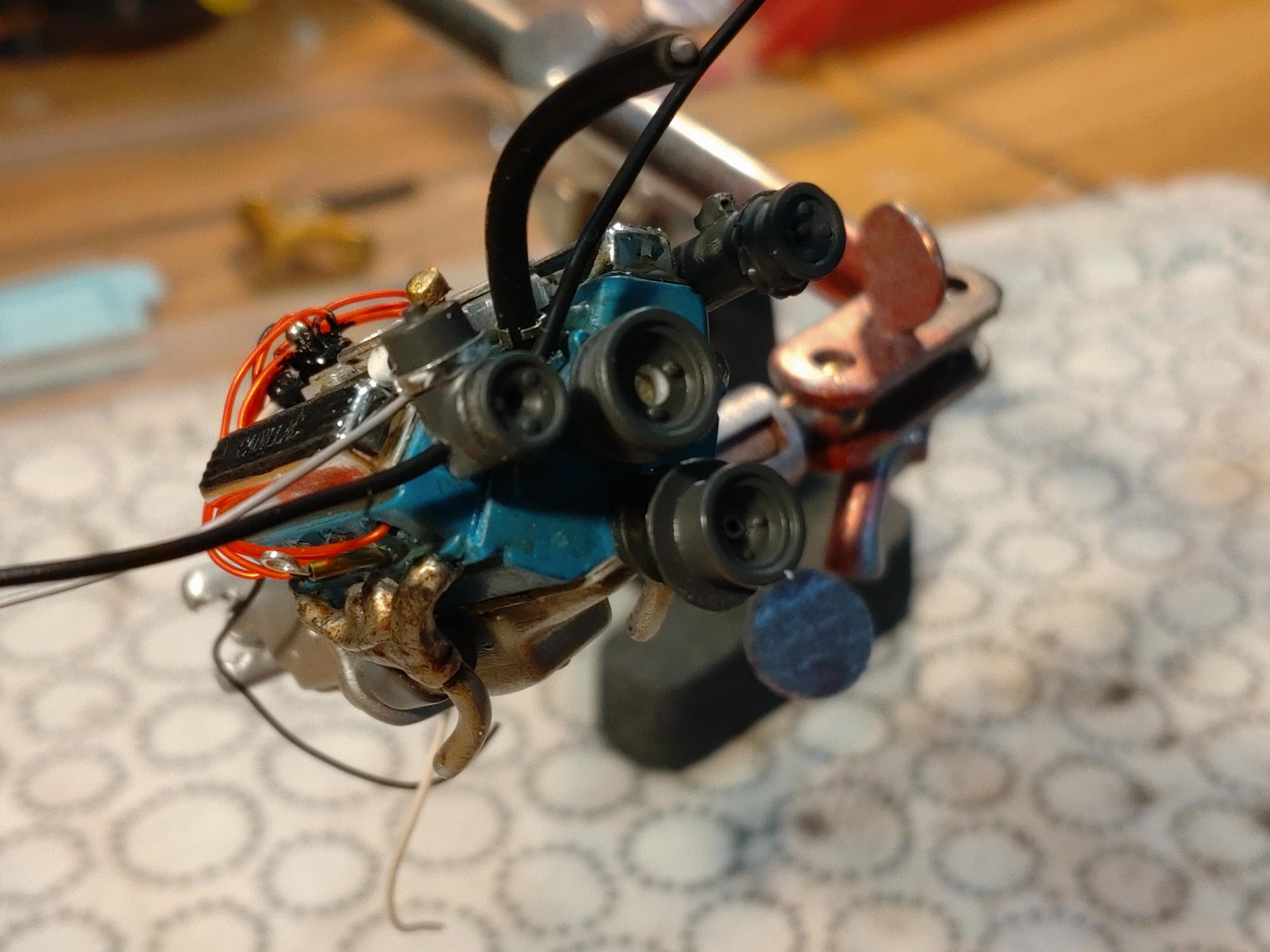

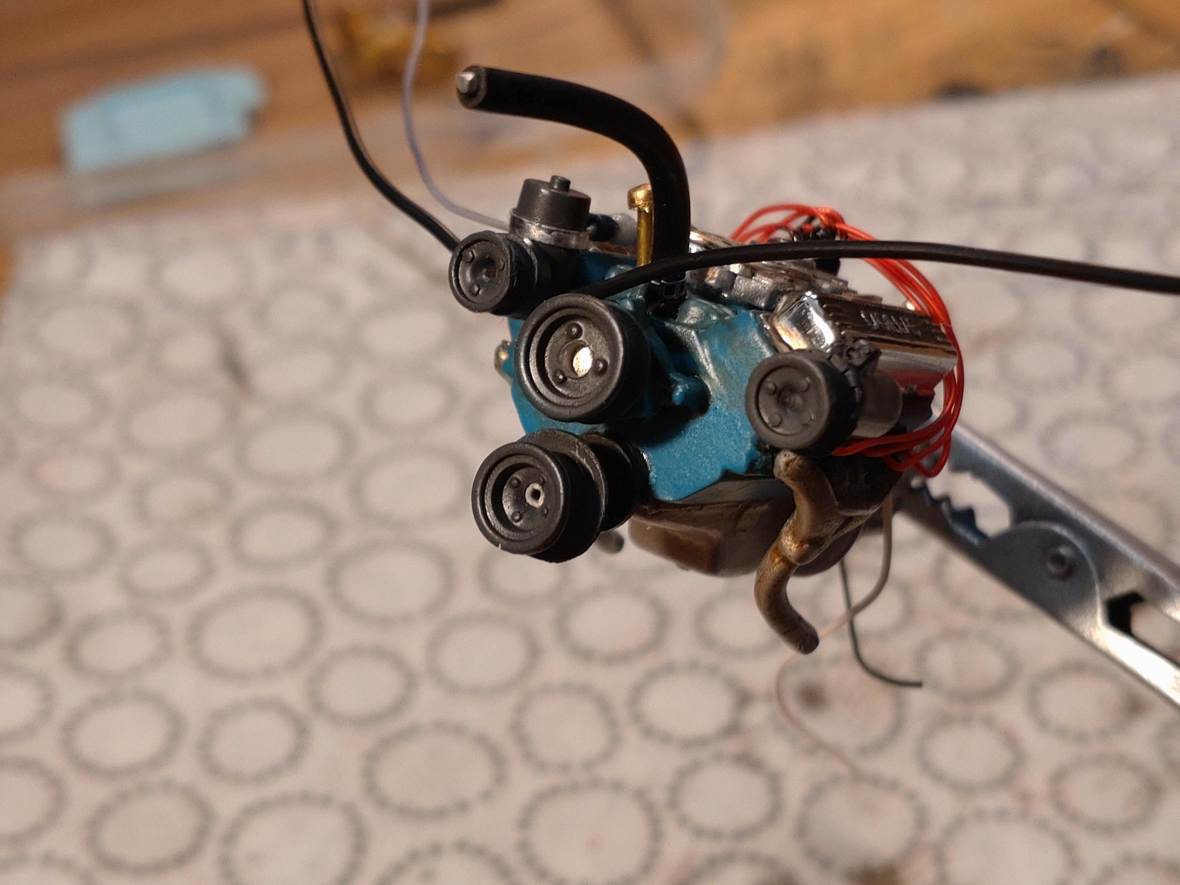

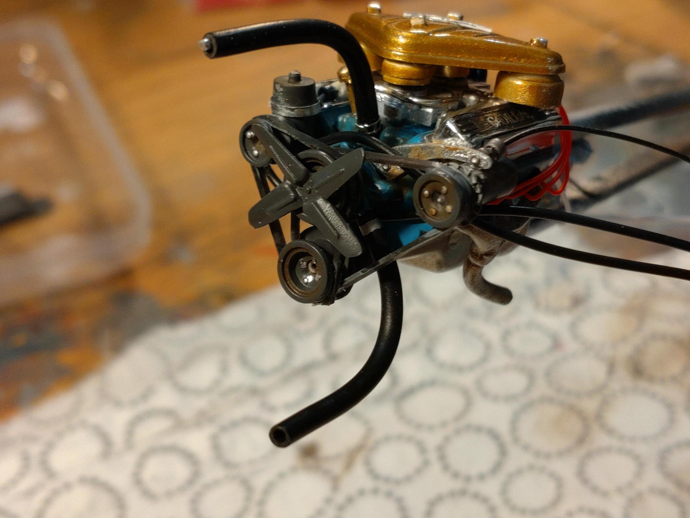

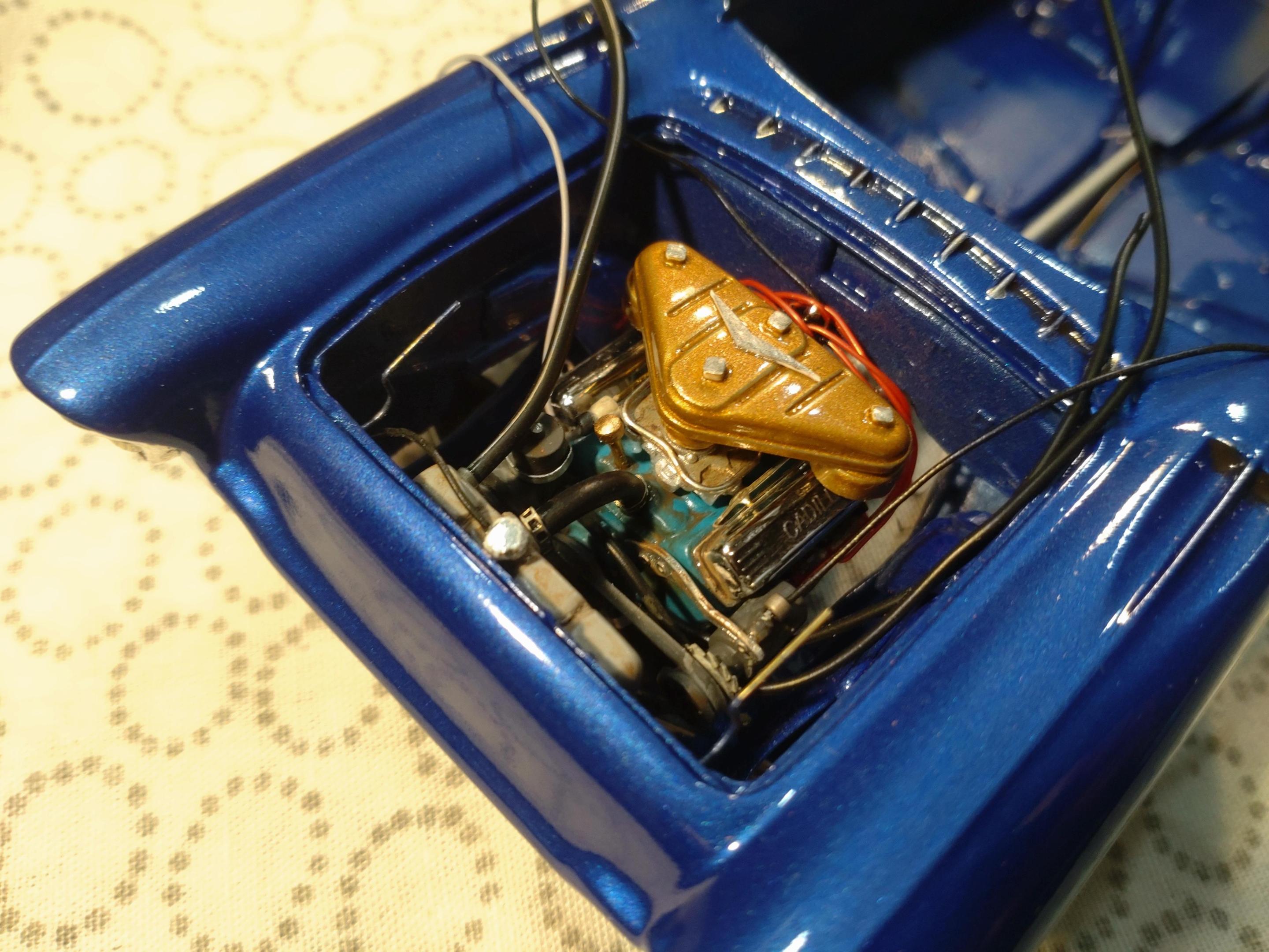

So I´m just about finished with the engine now. The pulley wheels, alternator and the power steering pump are all connected to the block with brass pins. They can take a rough handling and pull from the belts without bending off.
Before I attached the belts I fabricated a mount for the alternator and added micro hex nuts. The parts received a bit of patina.

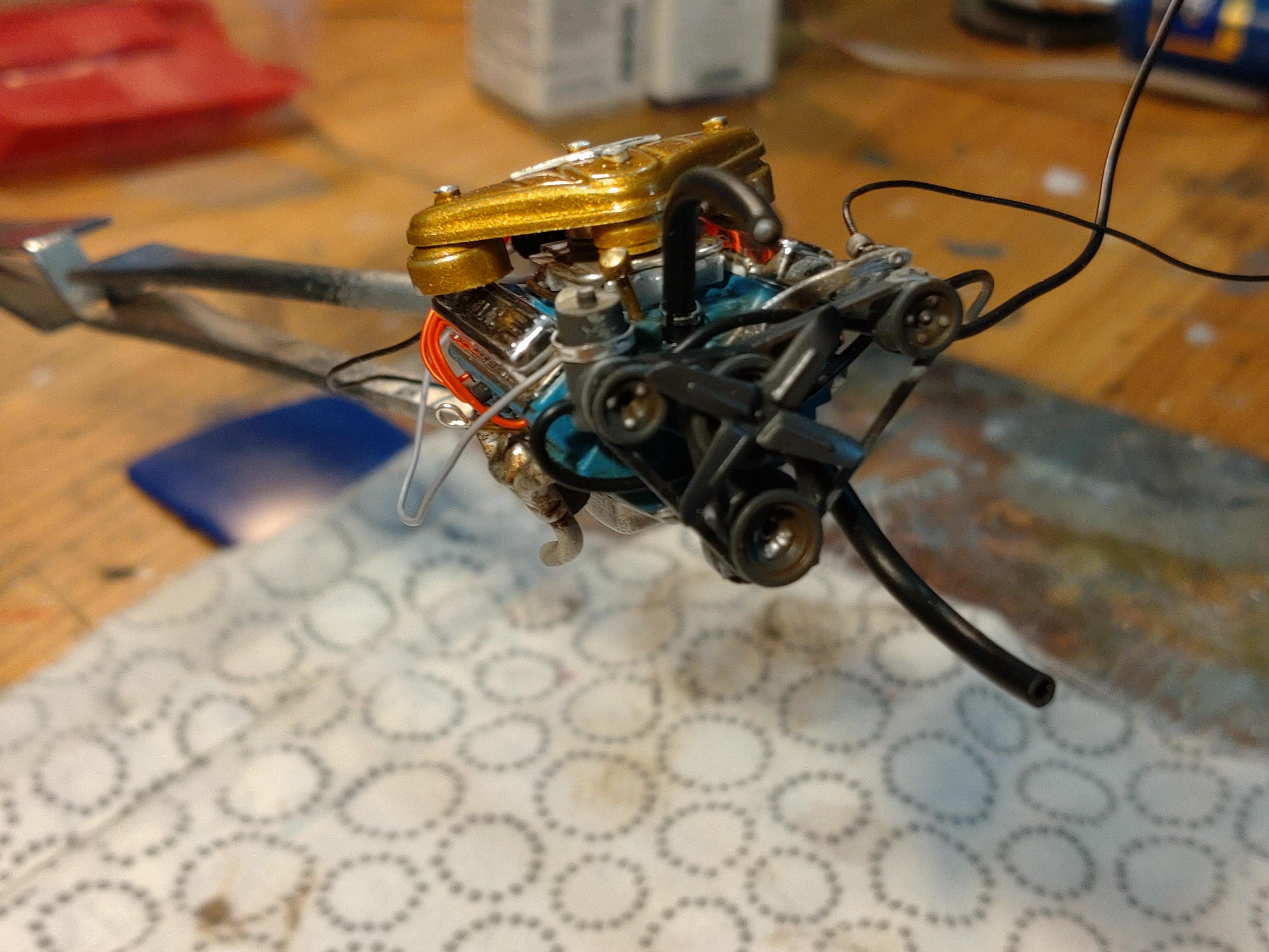

Belts and fan attached...

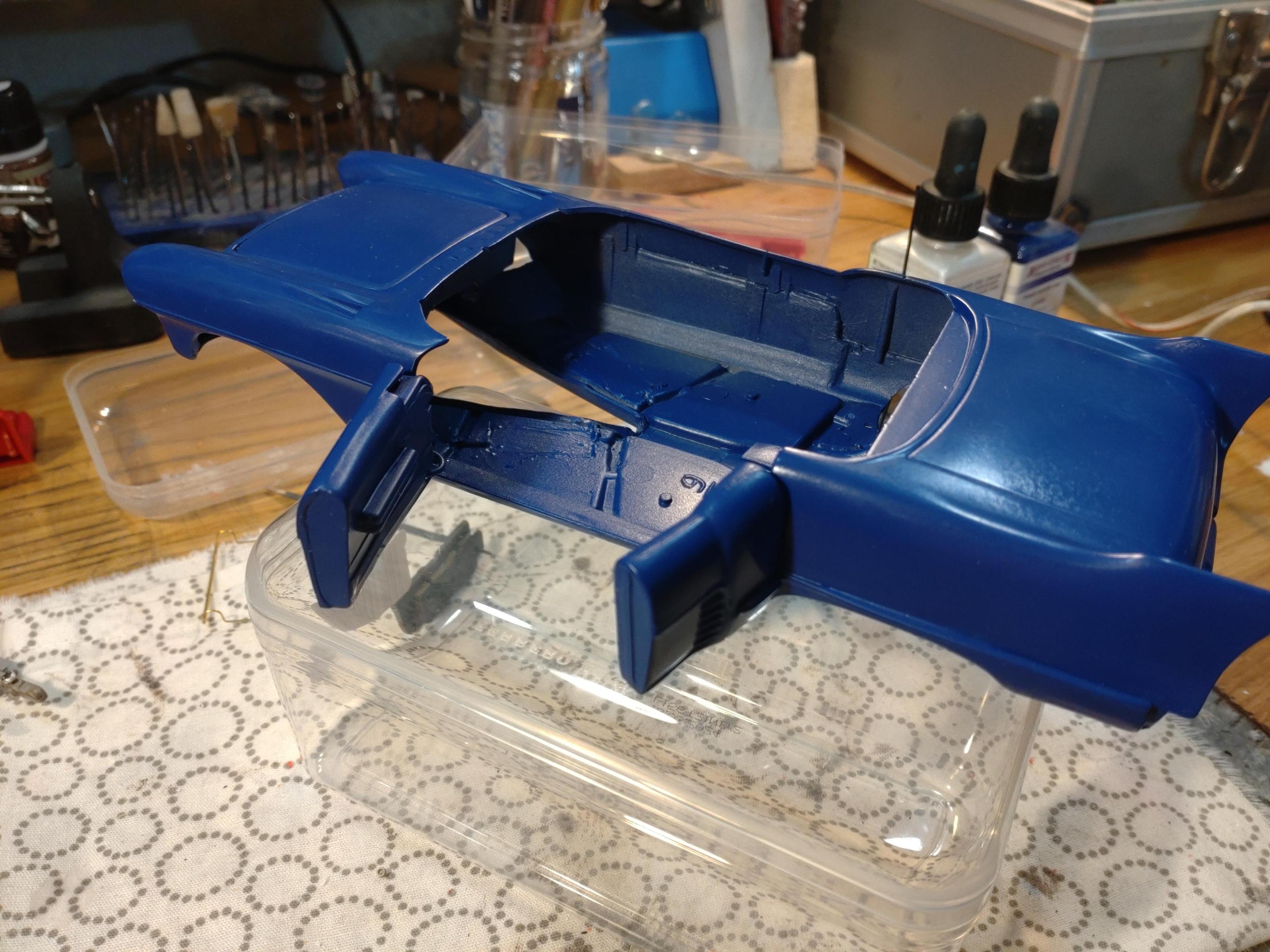

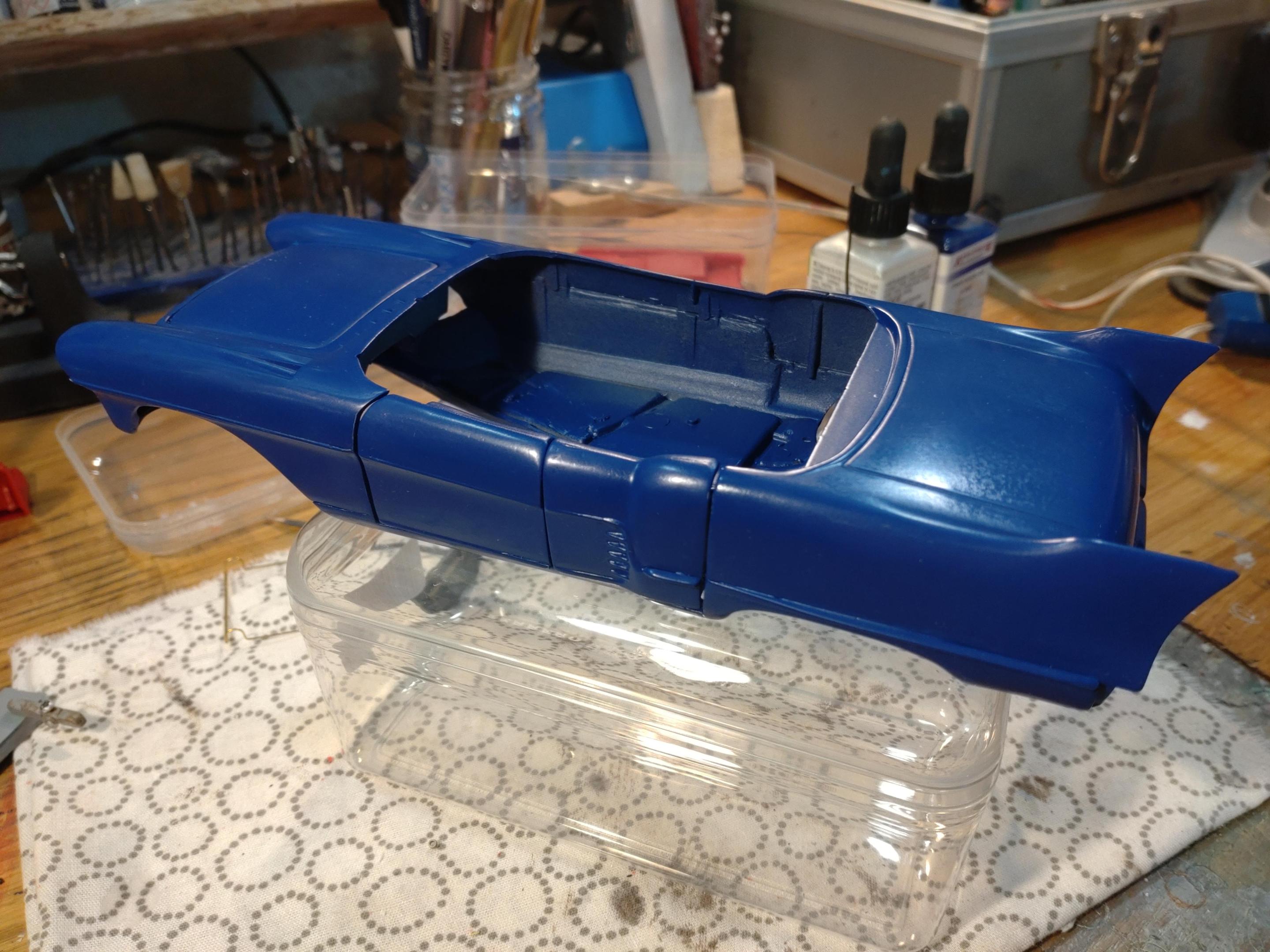

The body is spayed with a blue base coat. This gives an approximate impression of the body color. This model will end up with a metallic blue finish. The surface is smoothend with 6000 grit and ready for the final paint job.

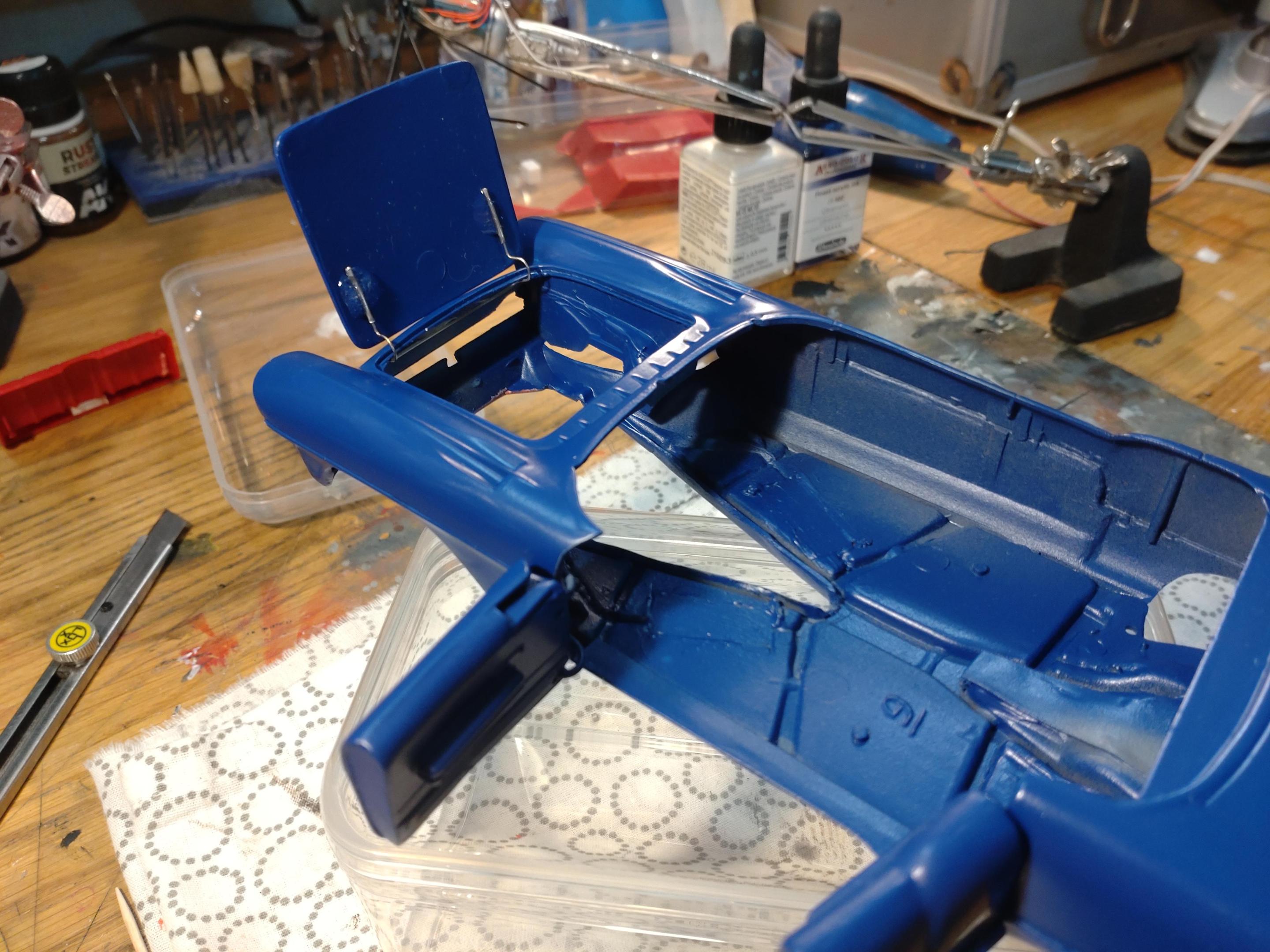

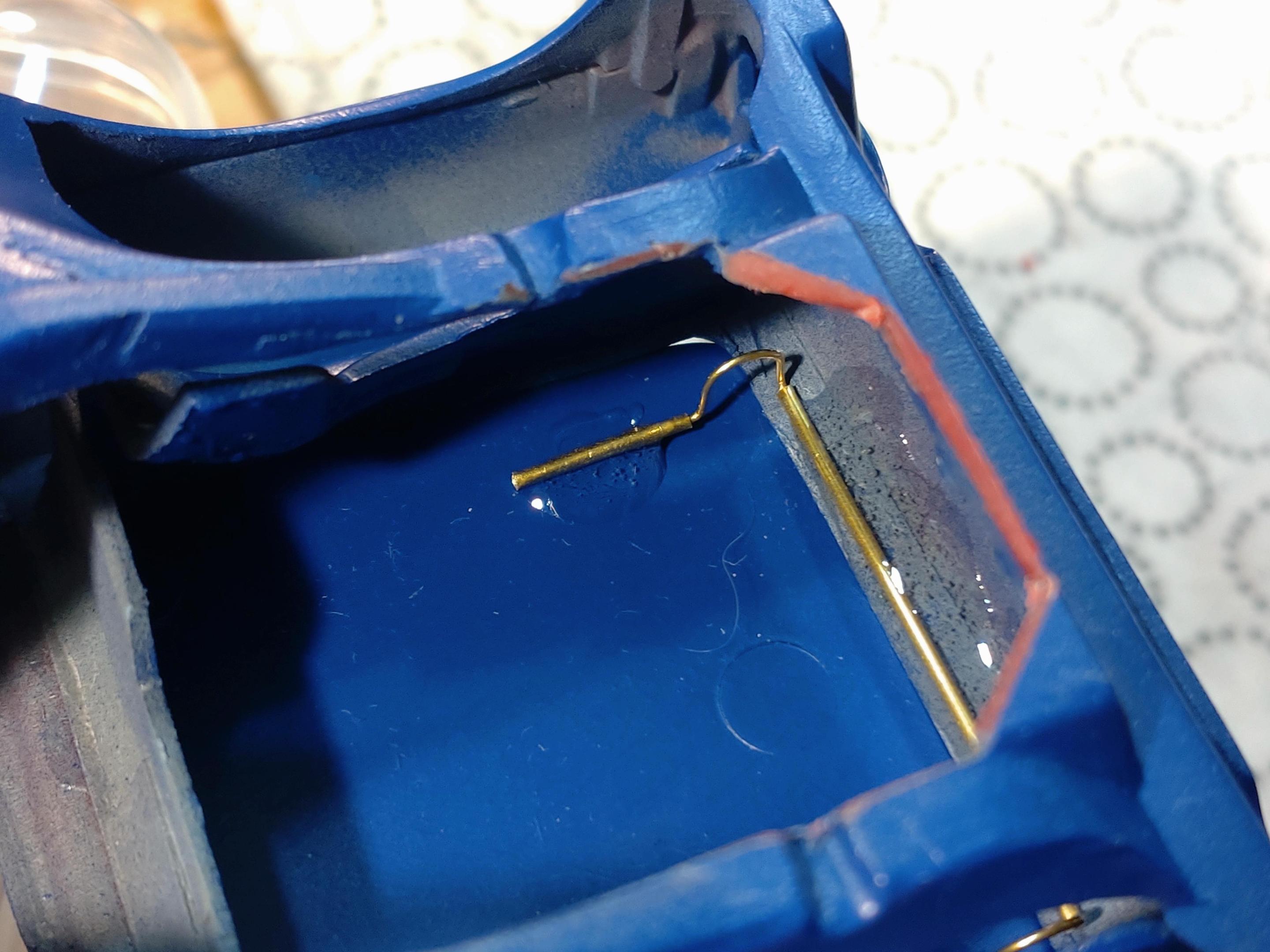

It was time to take care of the bonnet. I wanted to try something new about the hinges. Until now I have always been bending them out of 1mm brass wire and connecting them to the kit parts with 3mm styrene tubing. for this bonnet I tried out 0.5mm brass rod in a 1mm brass tubing. I think I will stick to 1mm hinges for doors, since they have to stay in shape and should not sag. But the bonnet has no weight to hold. And the much thinner rods look much more elegant. So this is the hinge glued to the inside of the engine bay.
And tipped open looks quite fine to me. I will file off excess epoxy glue and spray the rods blue. The hood will receive a silencing mat at the end.

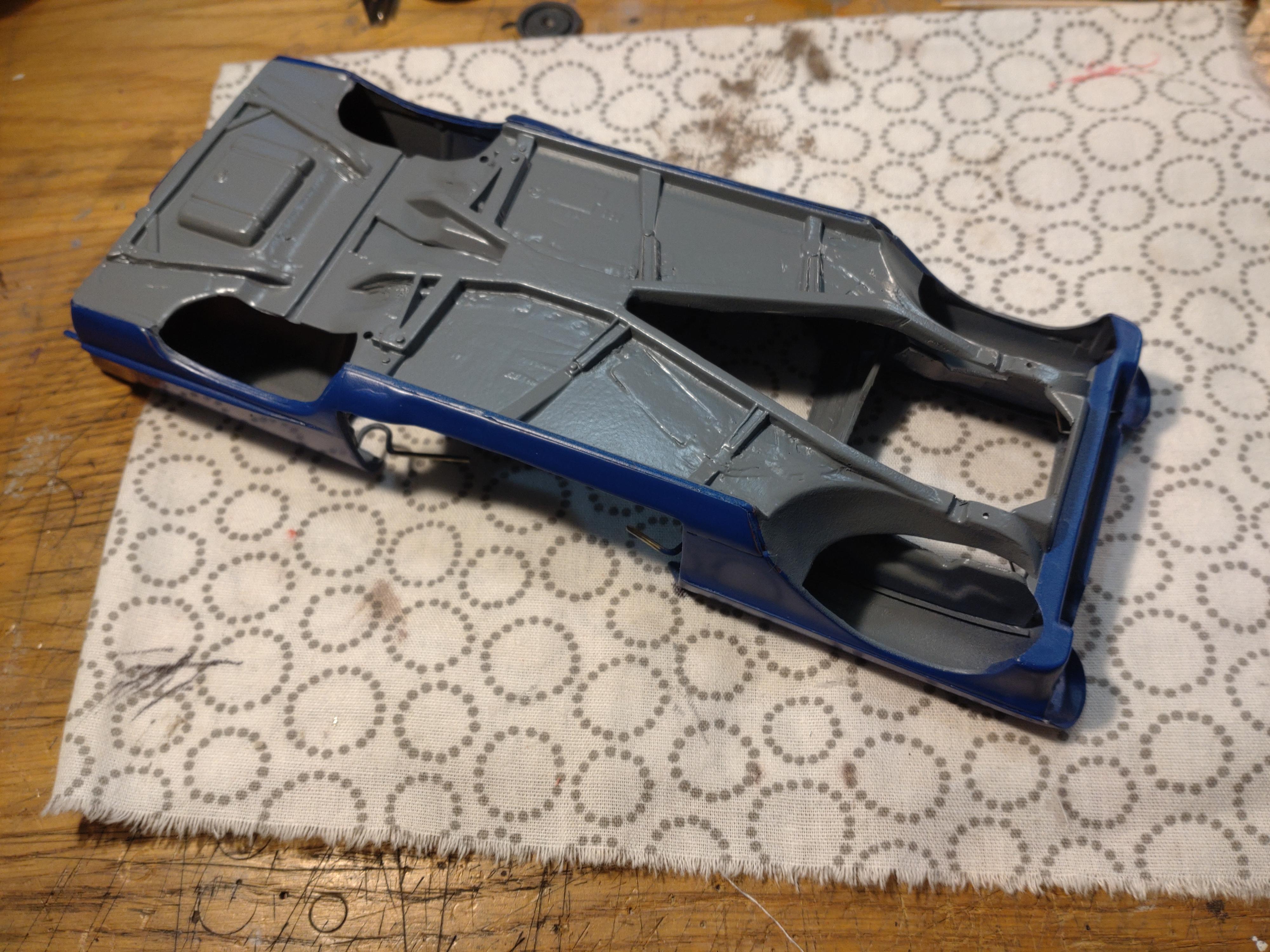

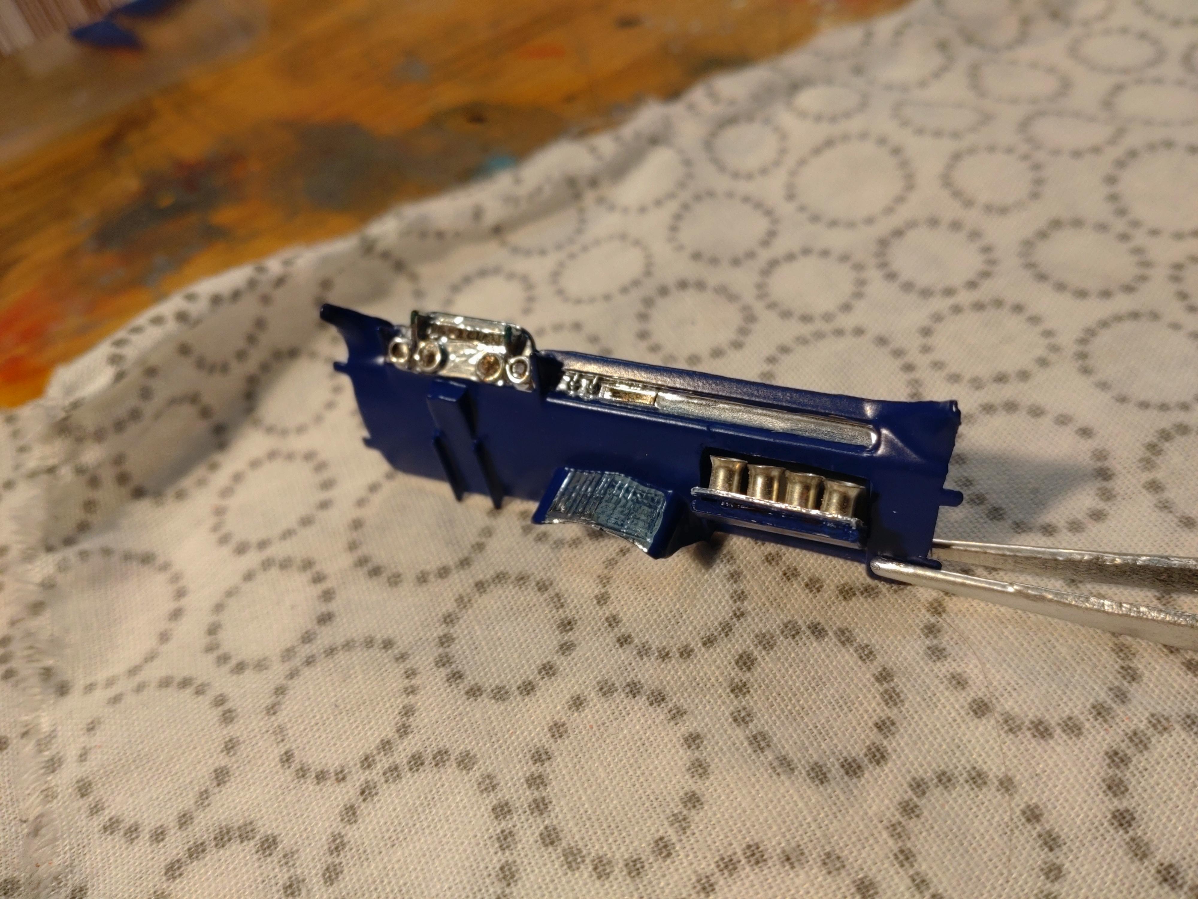

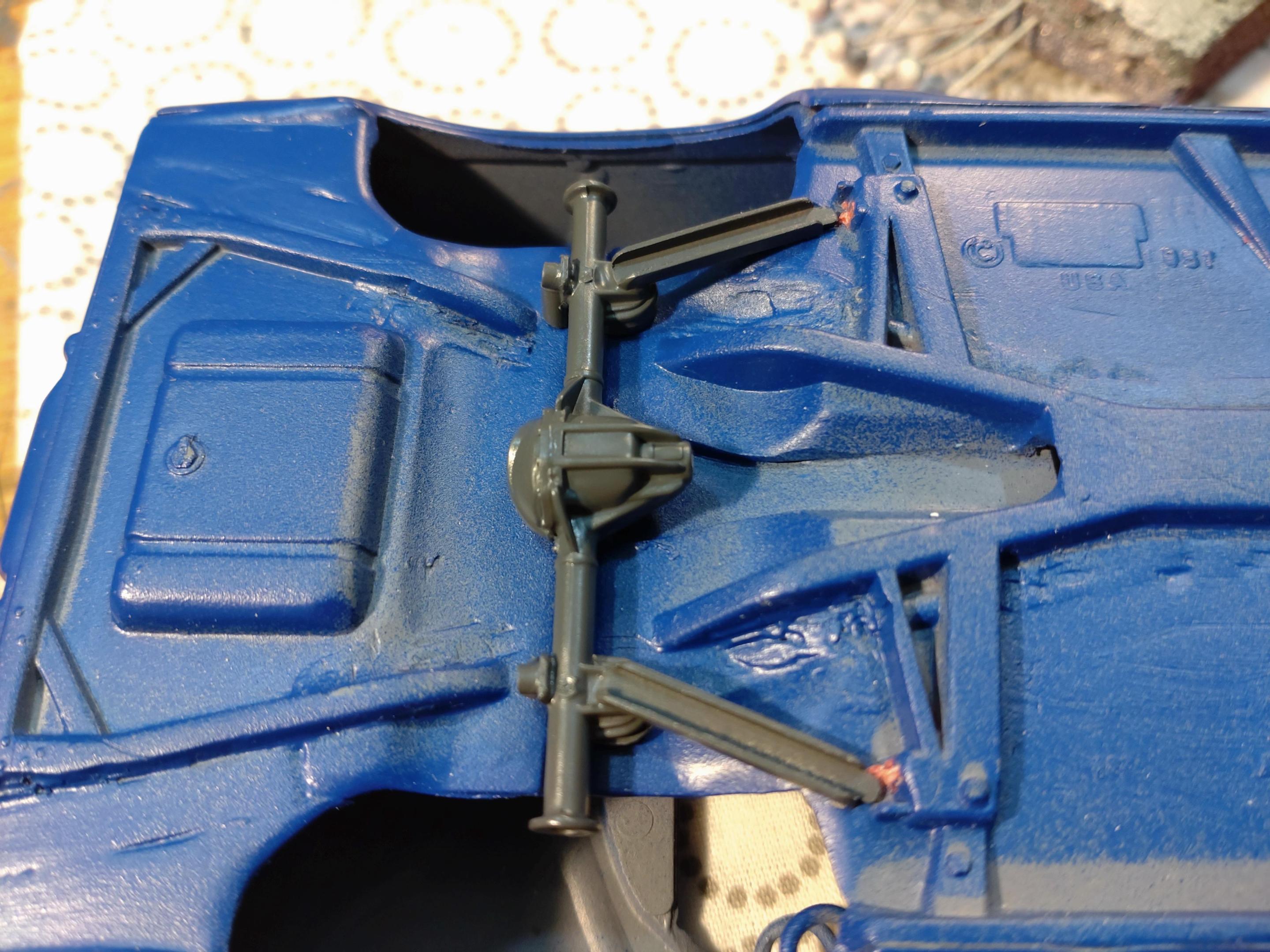

I will not be satisfied with the kit parts for the front and rear suspension. They look more like they fit to Fred Flintstones vehicle. But I was able to work the front part and add some details for more realism. After cutting away enough to match it to the engine, I found the right spot for later assembly and prepared the part with pins. This will also make the final connection to the frame bomb proof.
Next I added the details with styrene sheet and tubes and 0.4mm wire. Spray painted in dark grey and touching up with patina.

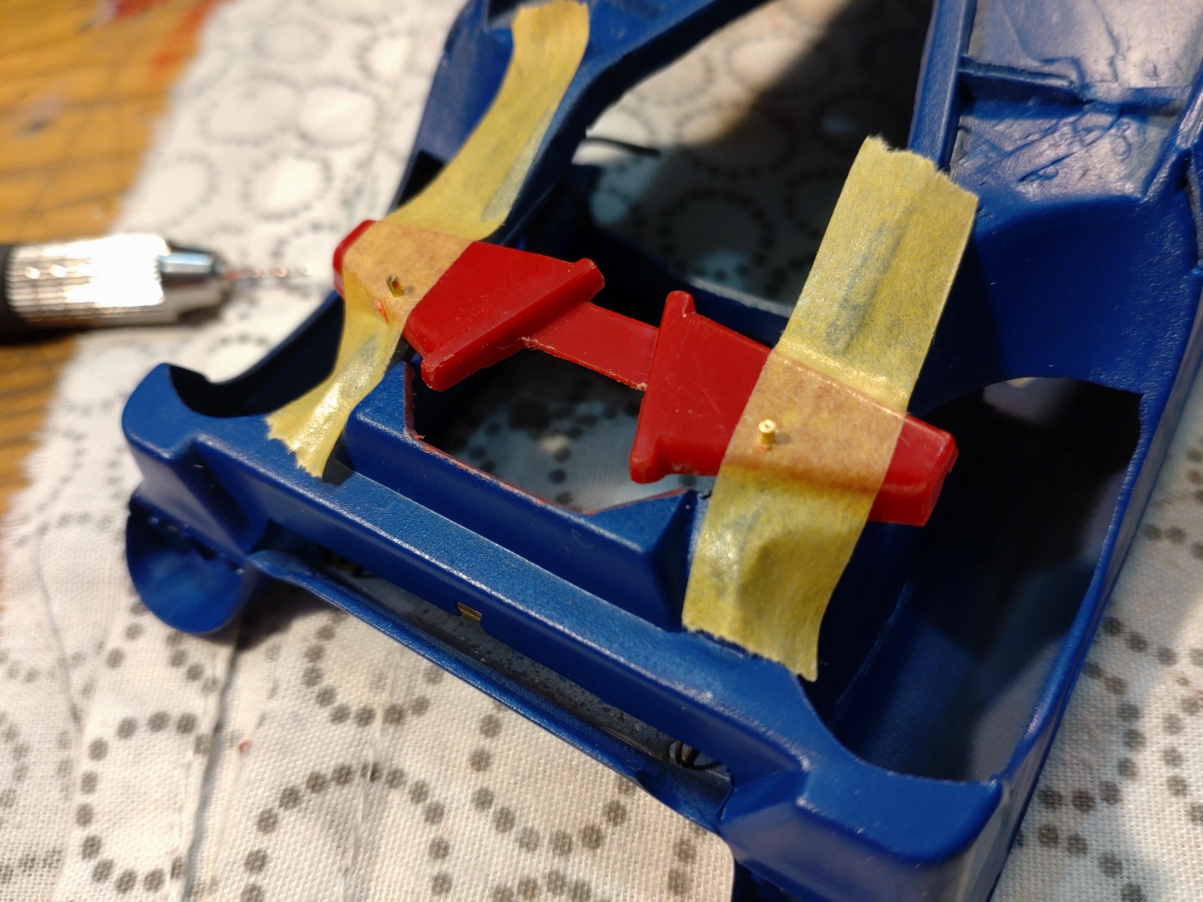

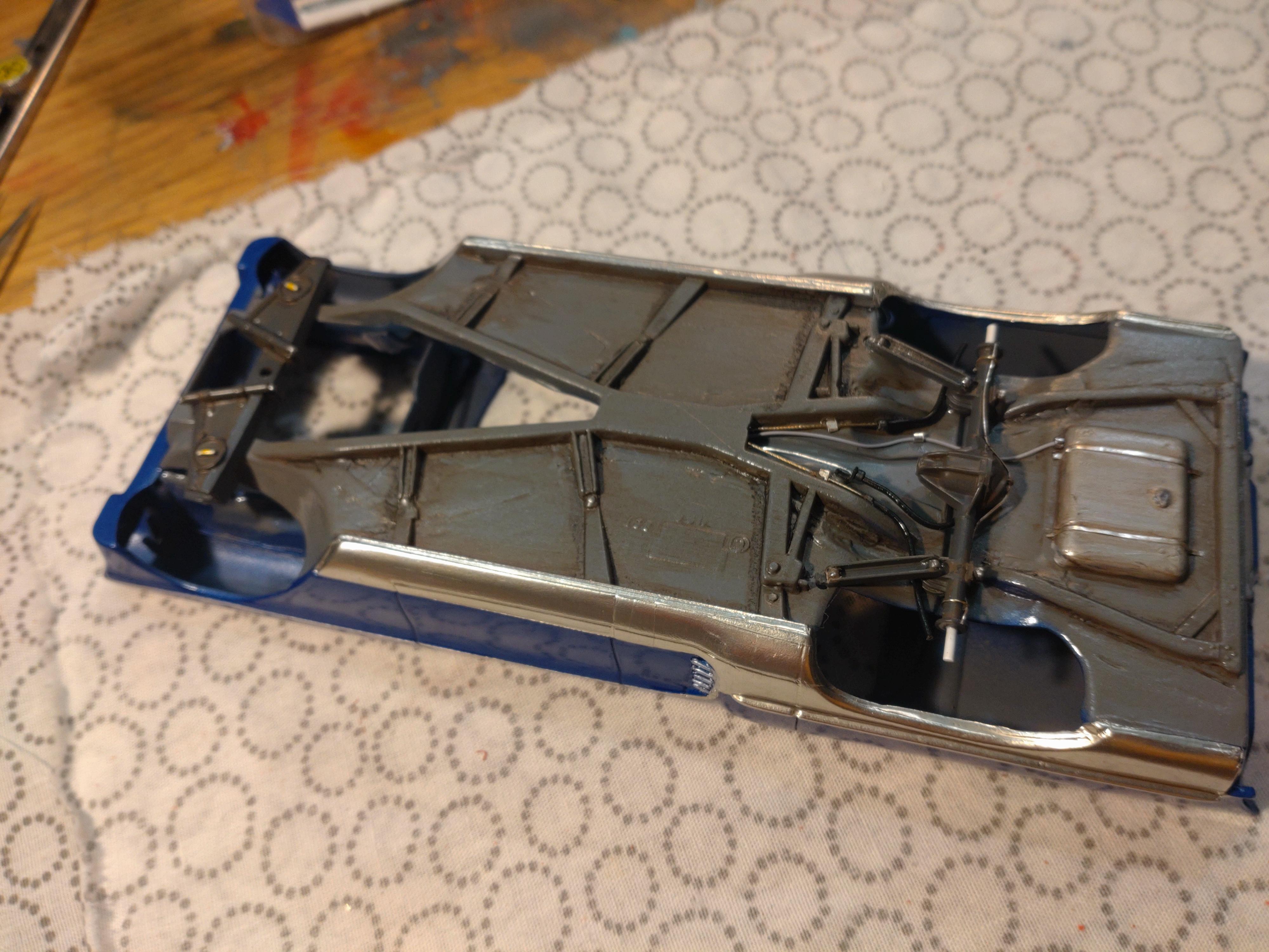

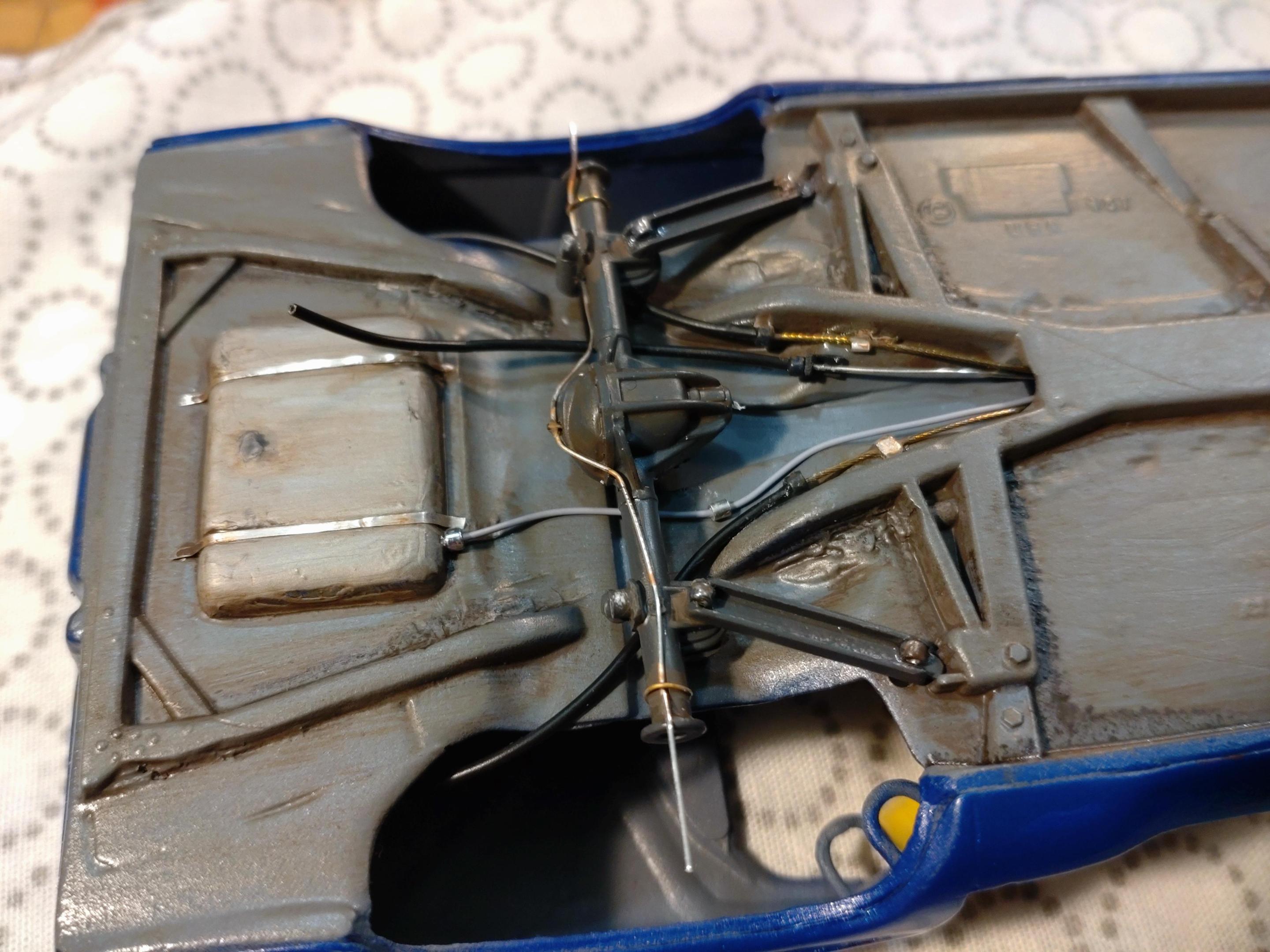

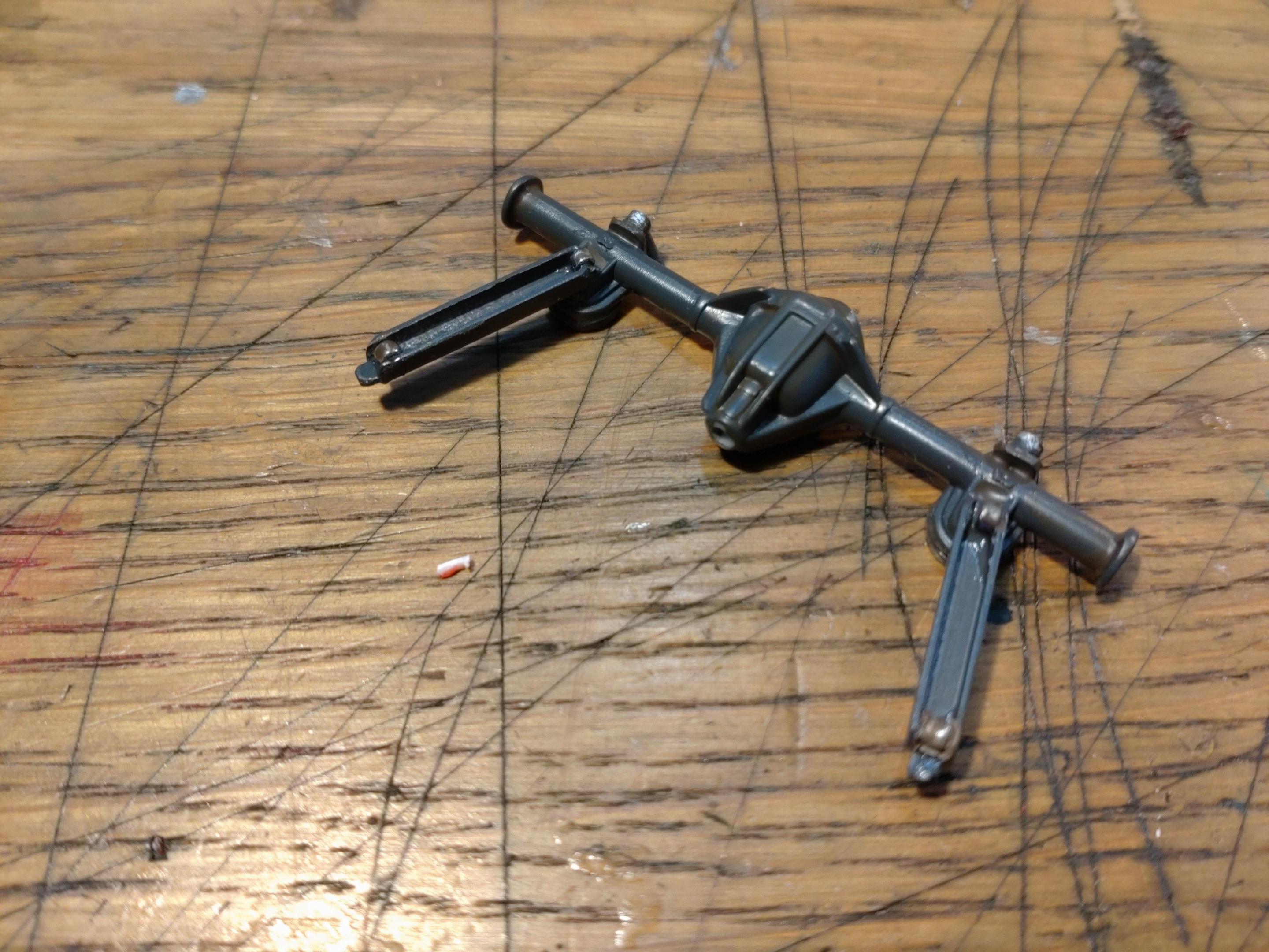

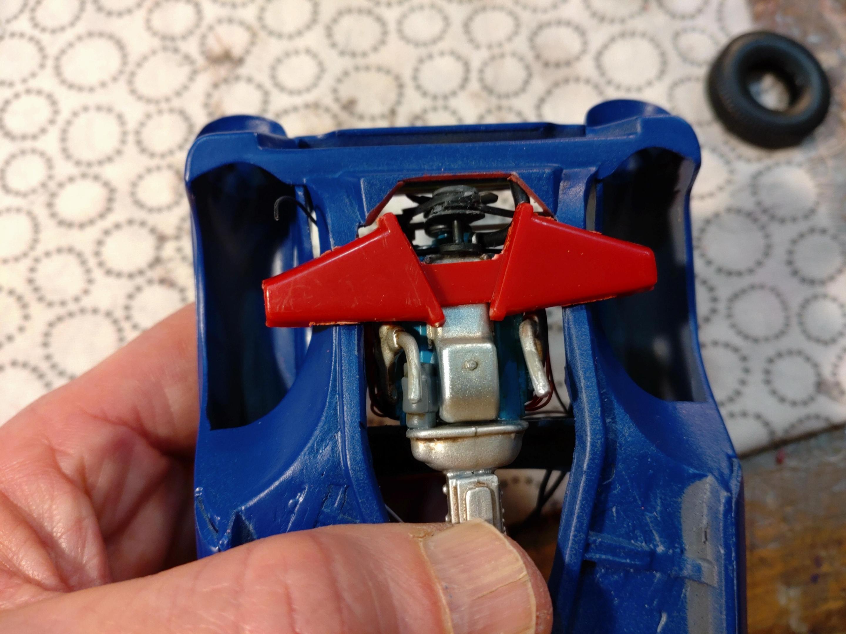

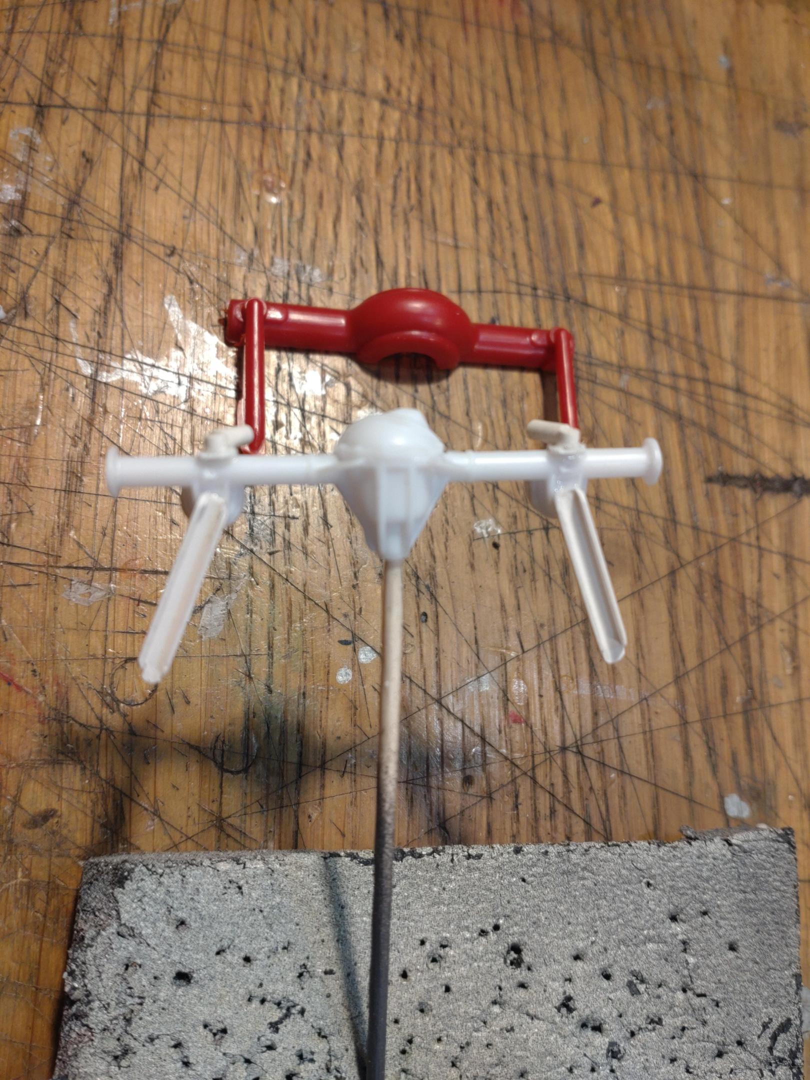

The kit rear axle and differential just don´t look correct to me. I found a axle in my boxes and fabricated the missing parts with styrene profiles. In the back you can see the red kit axle....
Next I added a few details and patina. The undercarriage isn´t deep enough for shock absorbers, so I had to fake it with short stumps. But this is a big improvement from the kit setup.
Now the undercarriage has its final color. I must wait with the exhaust system until the engine and the suspension system are attached. I haven´t decided yet to paint the body next or finish the interior first.?
That is not an alternator.  It's a generator.  I don't know if alternators were used on any cars of that vintage.  I know "picky, picky, picky". :)
But seriously that is a very interesting project (not one I would attempt).  It is looking pretty darn good so far.

@ peteski Peter: I´m grateful for every science because I am not a mechanic. Thanks!? I check that a generator produces DC, whereas an alternator goes AC. I just have to learn how to make the difference?. I guess it has to do with the production year and I have noticed that they look different?

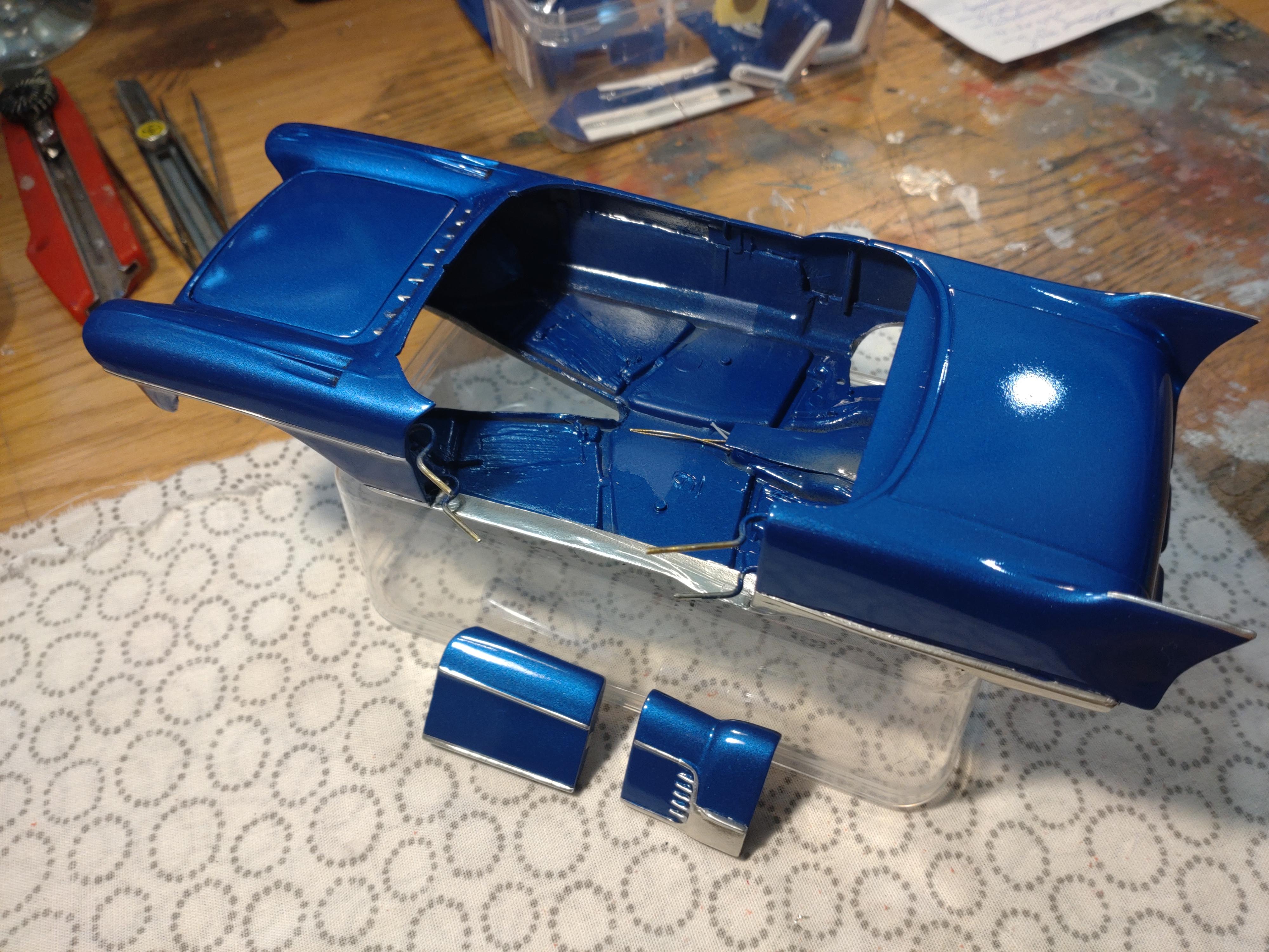

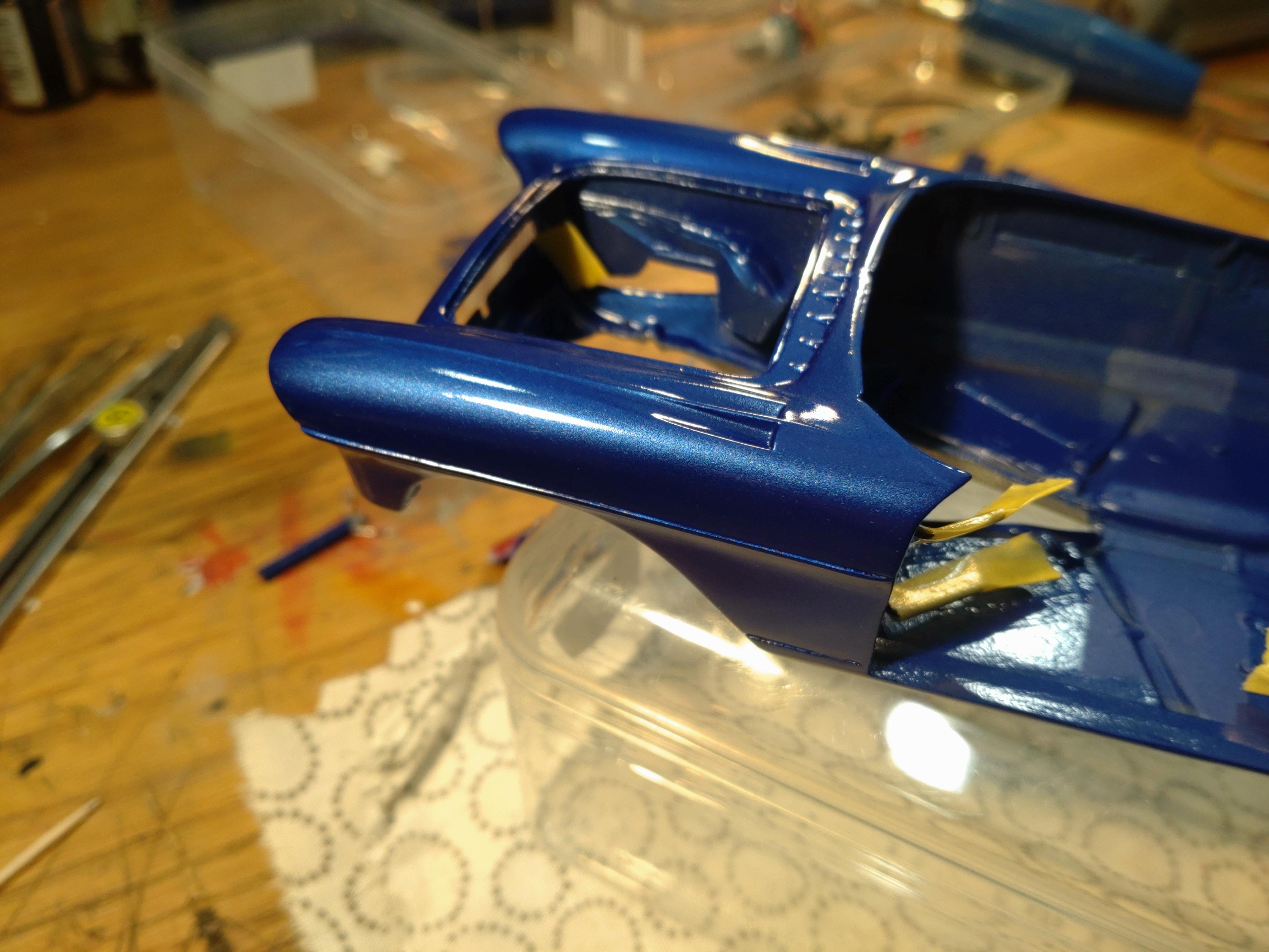

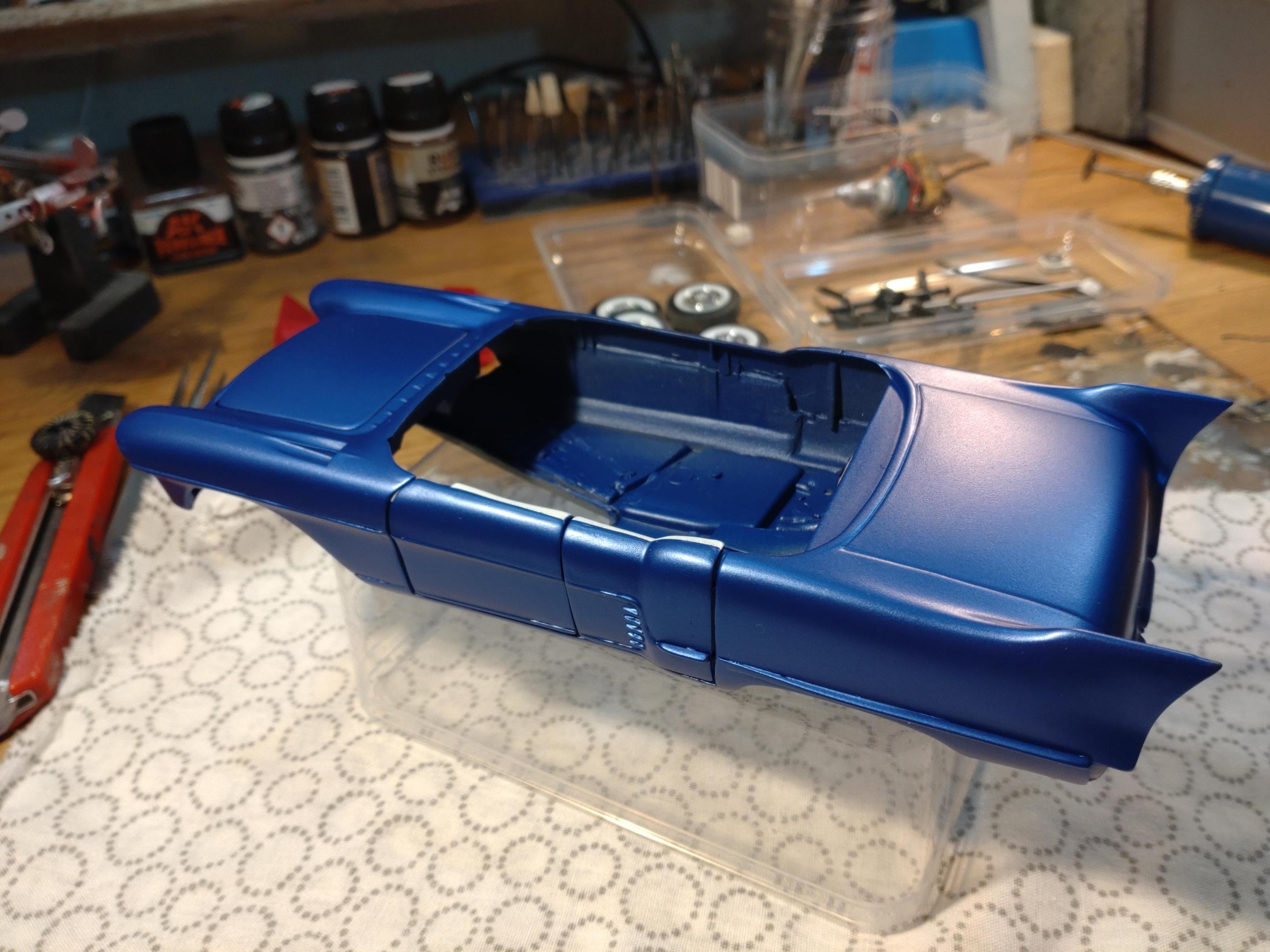

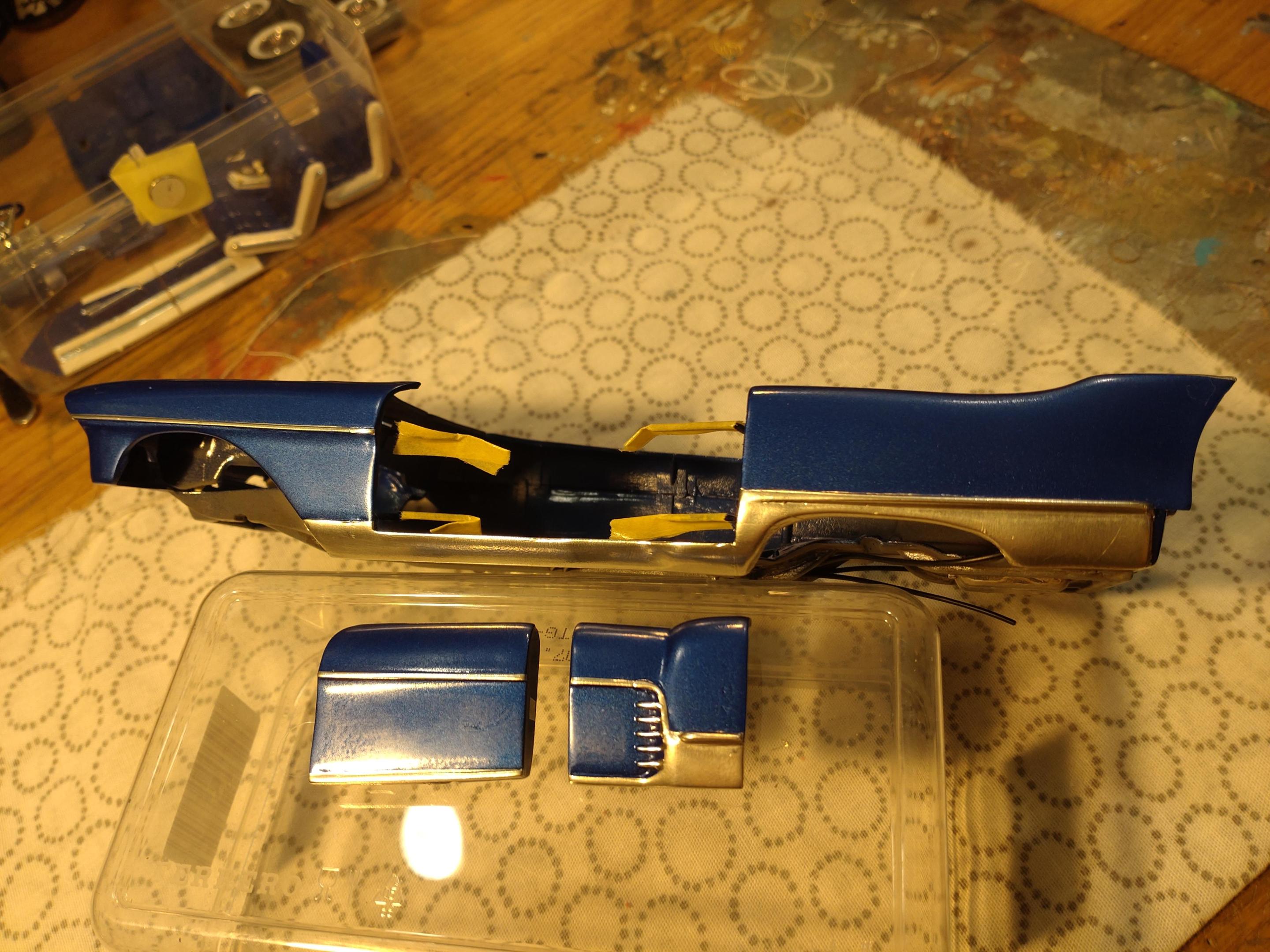

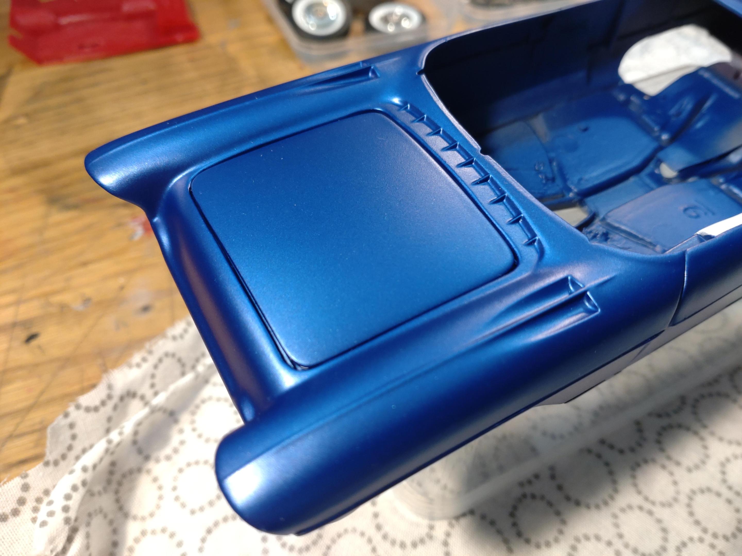

I have sprayed the body with the final color. I did a lot of paper and canvas art during the last decades and my favorite airbrush paint is definitely Schmincke AERO COLOR. It is fine enough to pass though a 0.15 mm nozzle, but still has a dense pigmentation and high opacity. It is easy to mix, especially in small amounts, and I cherish the brilliance when mixing the paint with the metallic fluid. In my case I wanted a bright untramarine and added a 50% part of metallic fluid. With the metallic fluid you must use a bigger nozzle though. I best choice is a DeVilbiss Sprite Major. It´s a double action with 0.25mm nozzle and a bigger paint cup. I prefer 40 - 50 psi air pressure.
The surface is flat, so of course it needs a clear coat. I prefer AK gloss varnish. This first coat will be smoothend with grit 6000 later for the final sealing.

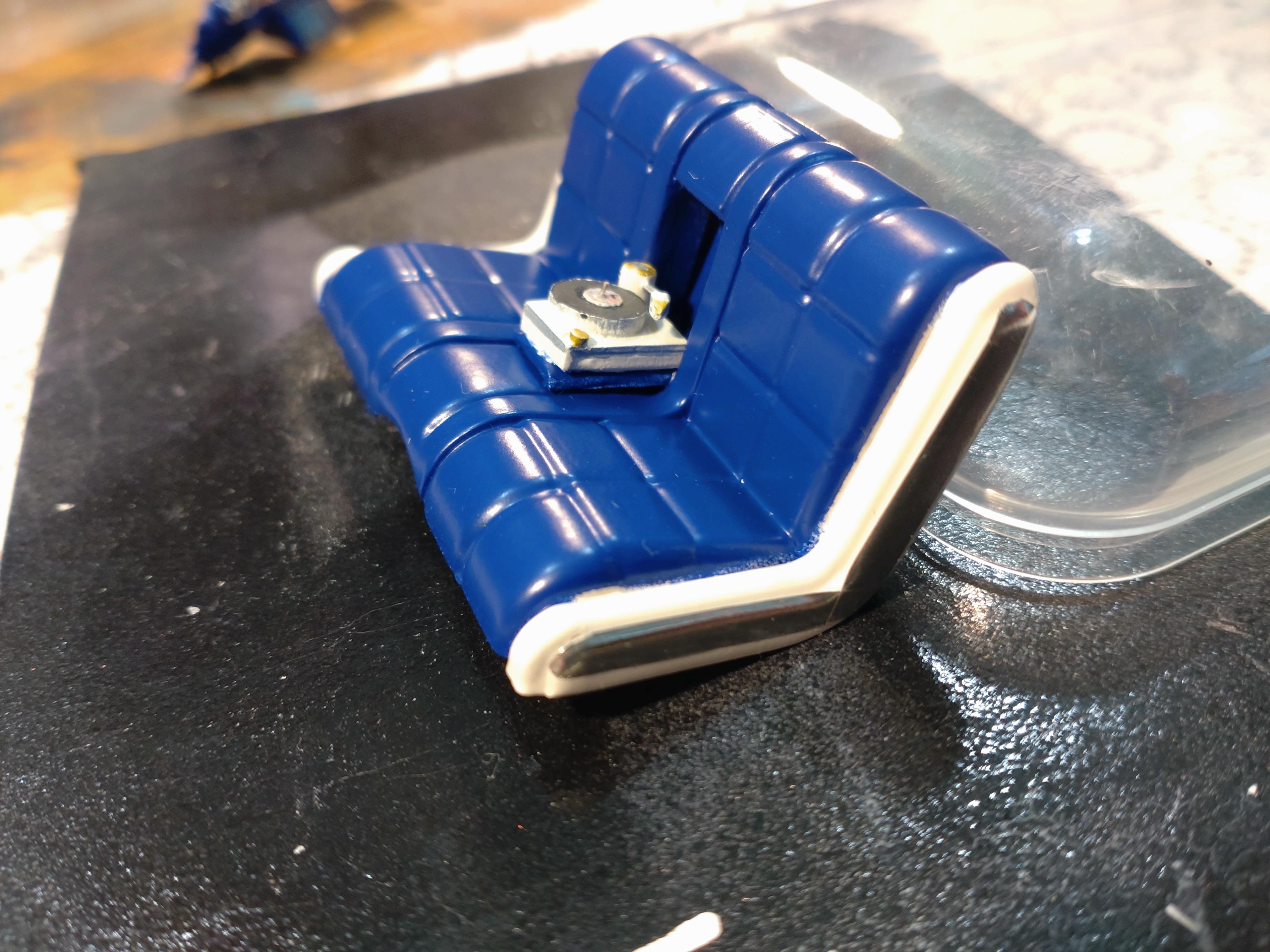

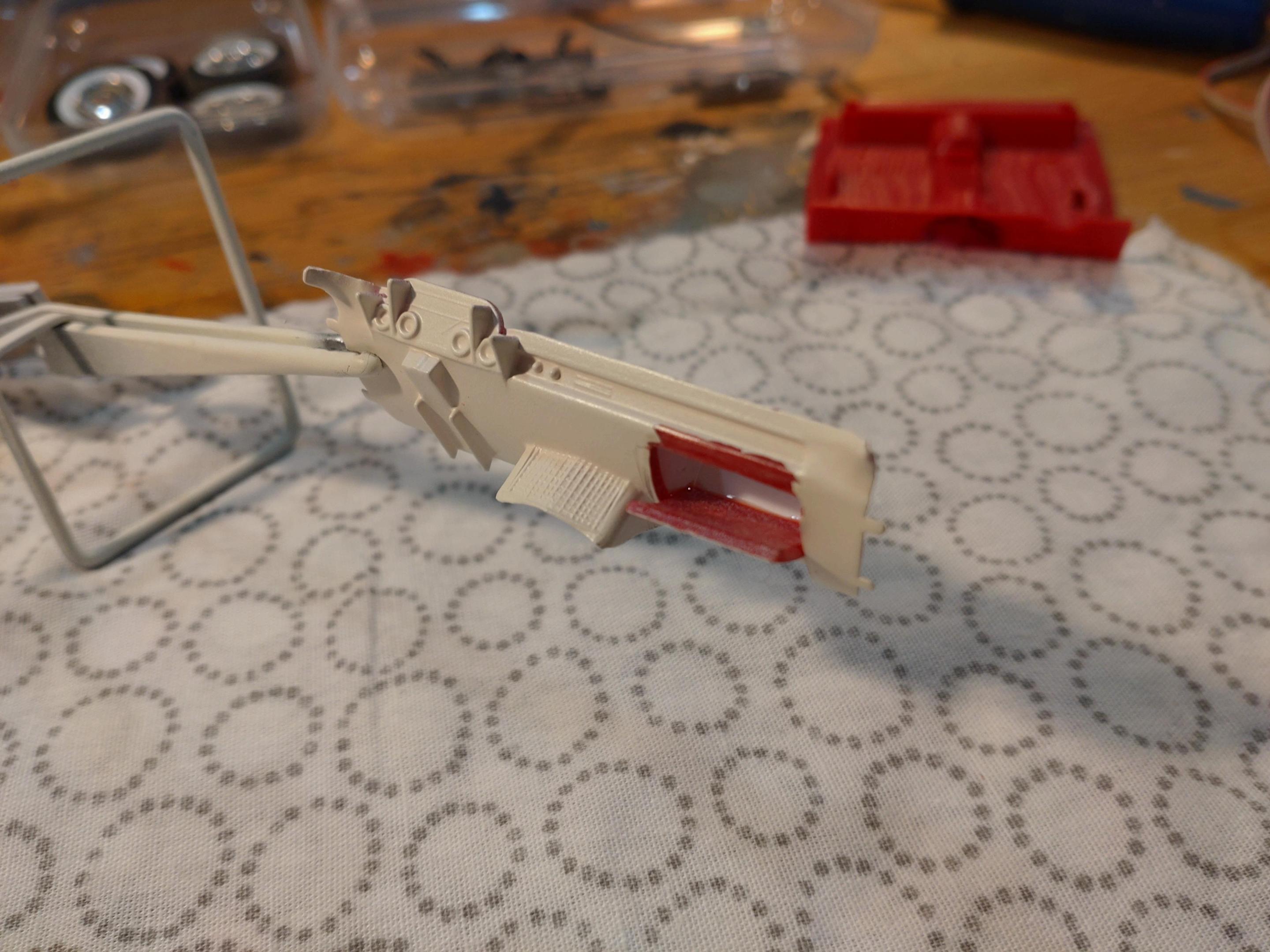

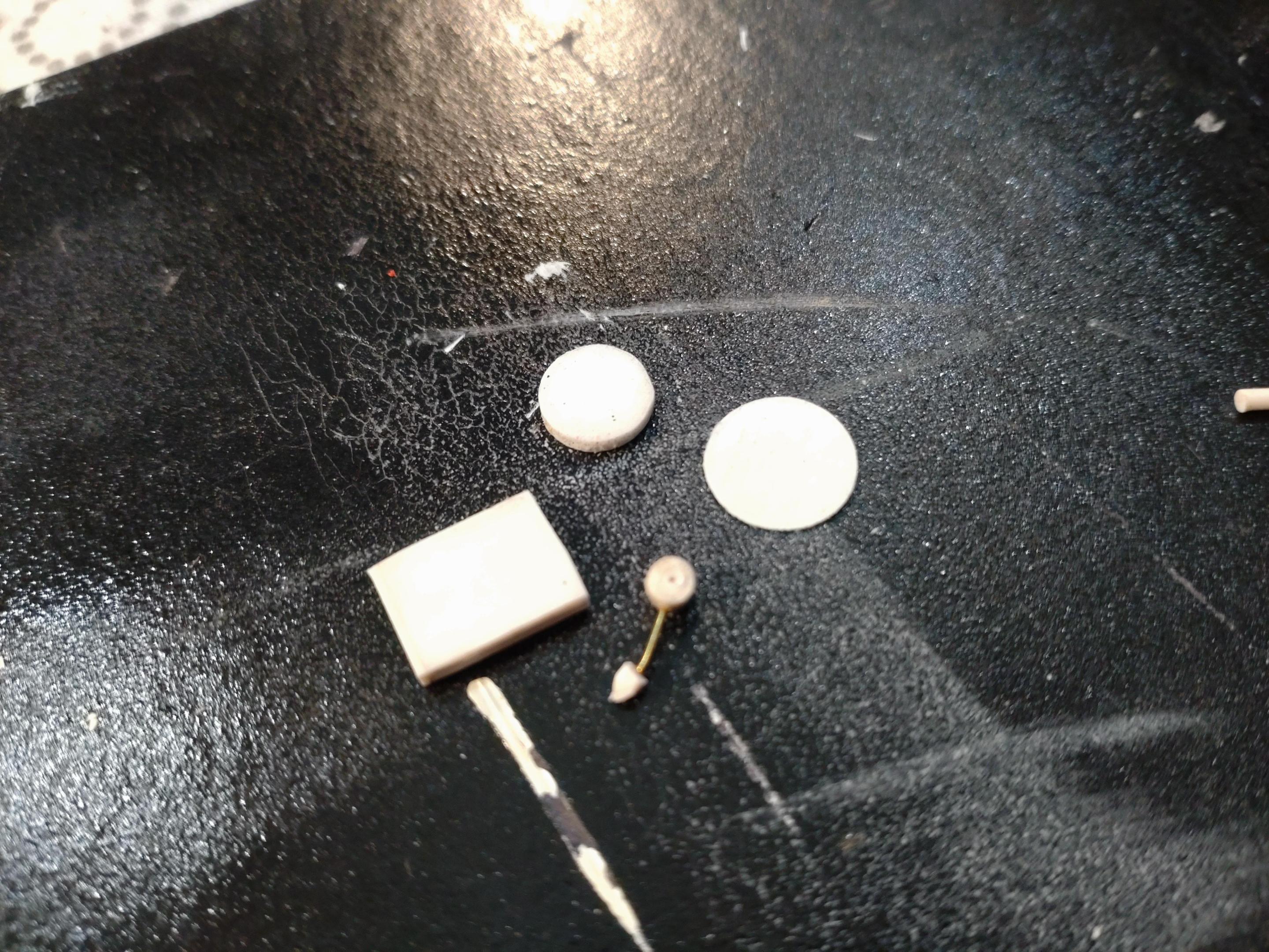

On an old image I saw that the Brougham could be ordered with a record player on / in the middle arm rest. So why not try that? Here are the parts for the record player fabricated from styrene and a piece of wire.

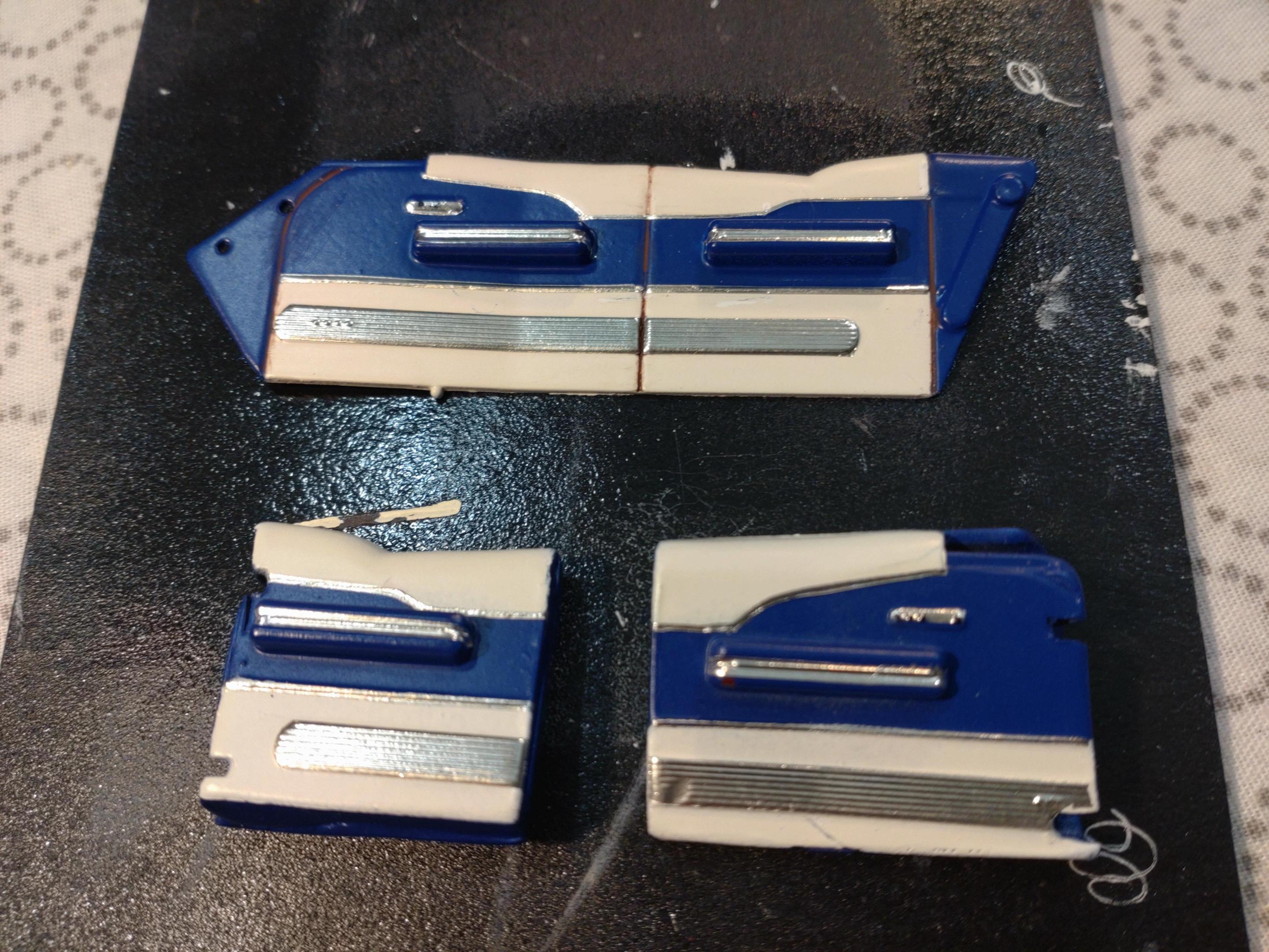

I will skip the intermediate steps for the interior and just show the door panels and the bench, with record player.

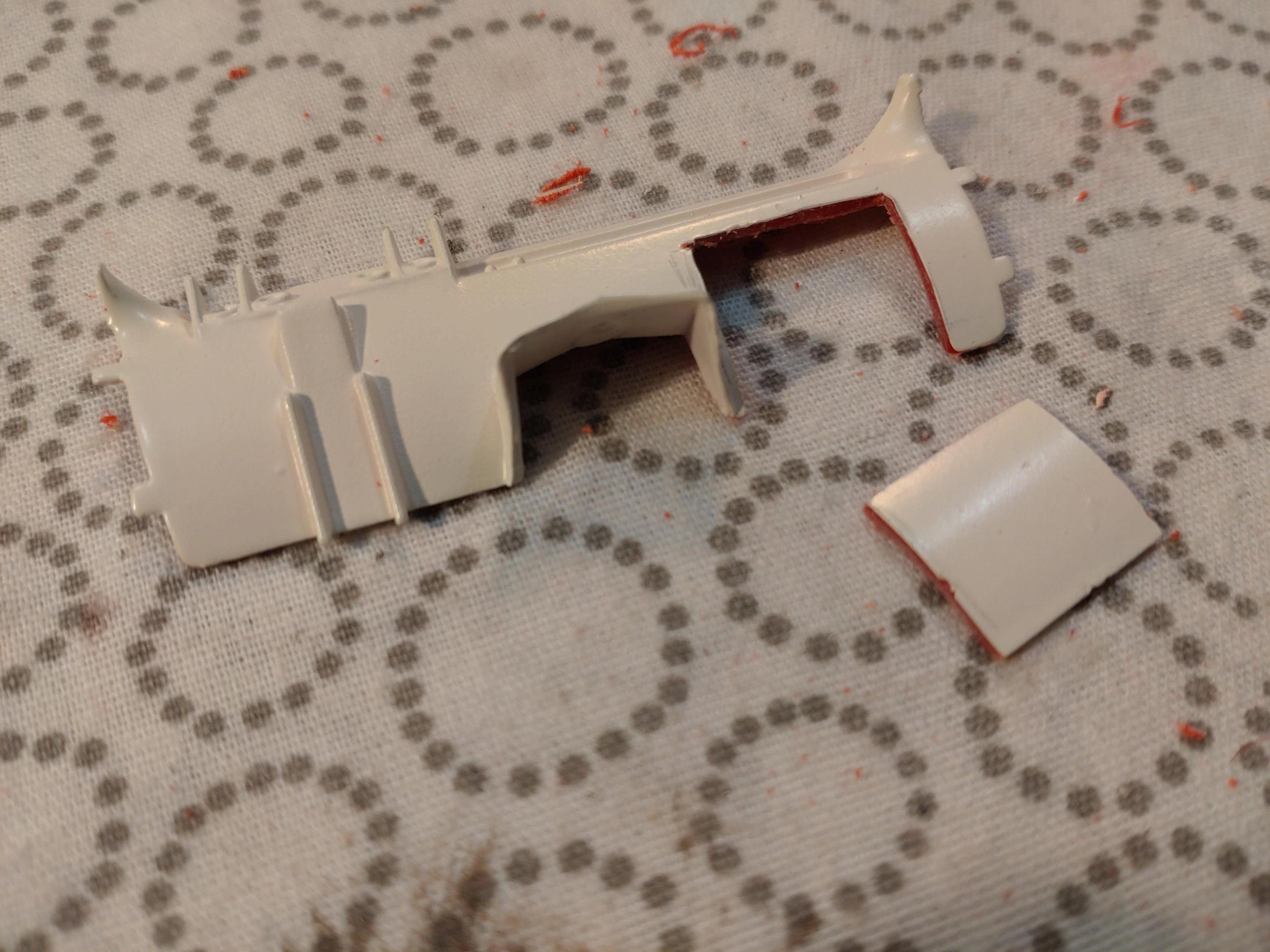

Another very exiting luxury accessory was a "bar" for the glove compartment. I started this detail by cutting the compartment lid open first.
Then fitting the lid to the dash in the open mode before moving on to the dashboard details.

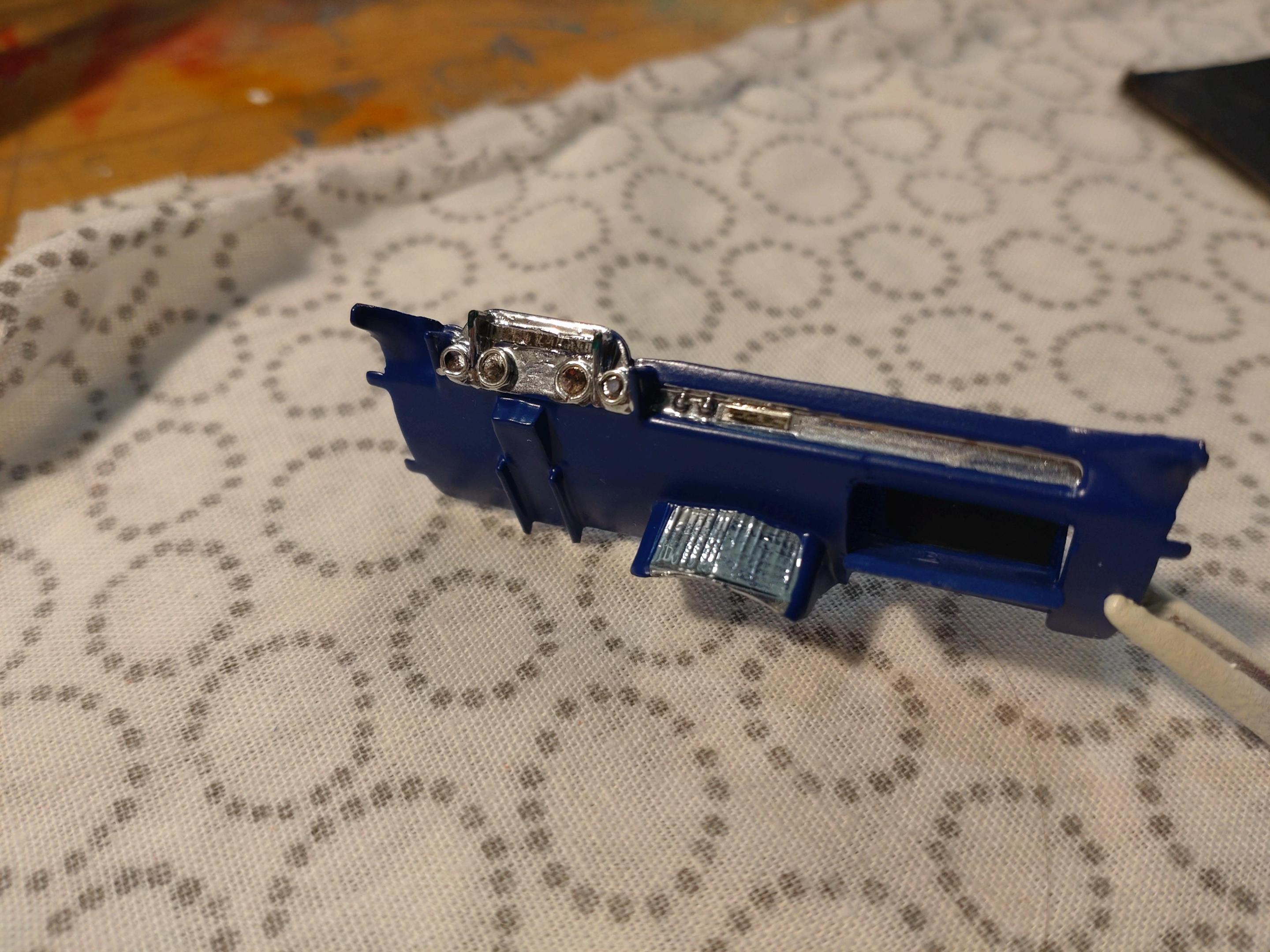

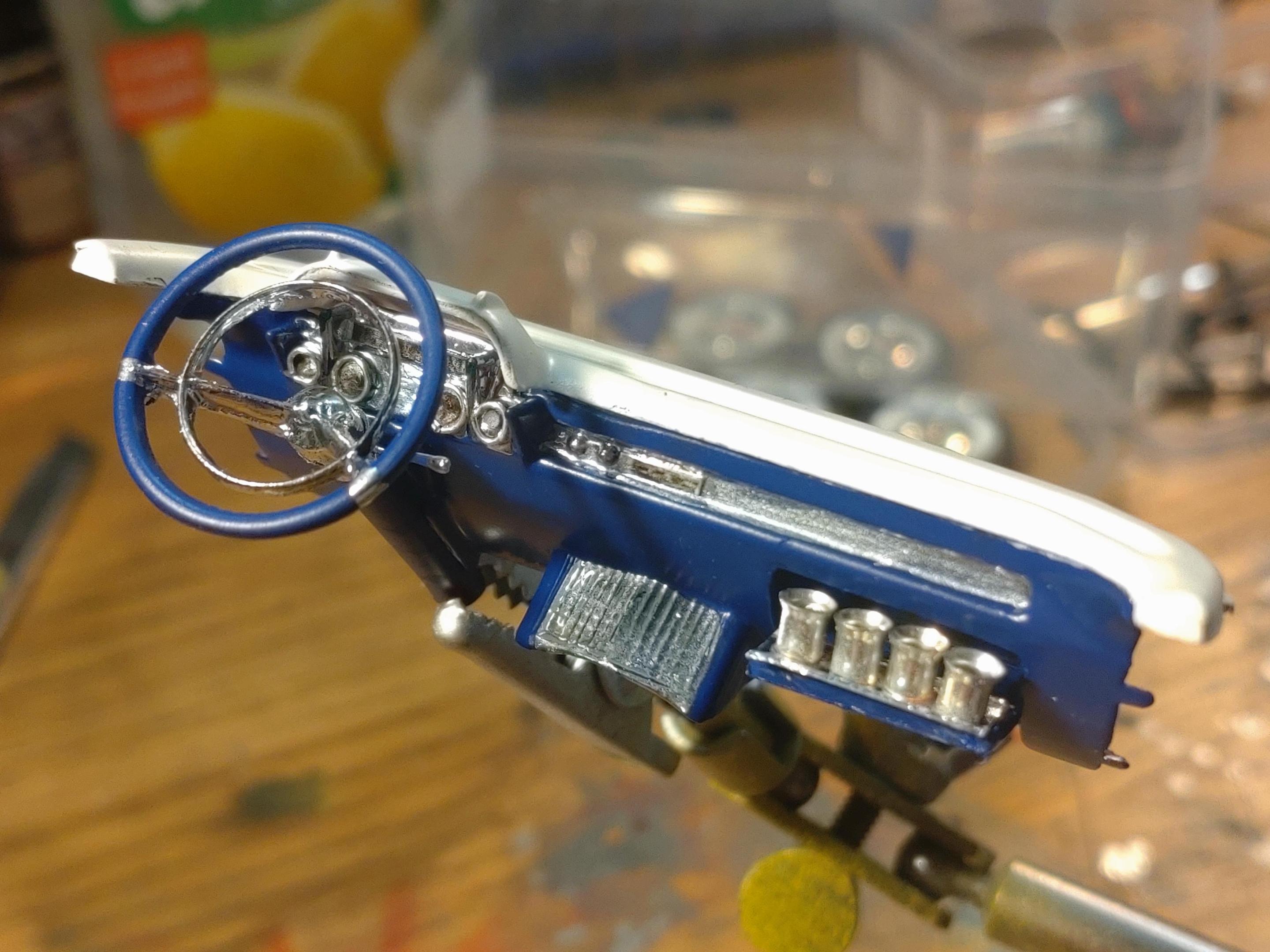

Of course this kit contains no decals. The gauges and the speed meter are images from the net reduced in size and printed on glossy photo paper, the same with the radio. The trim rings are 0.4mm silver plated wire. The chrome is Molotow pen applied with a hair brush.
Now comes the bar... My best wish was getting VERY tiny tubes for 6 shot cups. Alas, the smallest I could get a hand on would make for say, 4 slightly bigger cups. These are set on a small tray covered with BMF. I will get the dashboard finished in the next step.

I'm also glad that you took my comment as educational (as intended by me).  To further explain, yes generators produce DC voltage while alternators internally produce a multi-phase AC voltage, but they also contain a "diode pack" rectifier which converts the AC voltage to DC which then is output to the electrical circuitry in the car.  Alternators replaced generators because they are lighter than generators, and they are also more efficient, producing more power (amperage) than generators did.  Visually alternators are shorter than generators, and they are also have larger diameter than generators.

Getting the paint job done always feels like a big step to me. Usually I don´t work on the "big groups" engine, body, interior and undercarriage parallel, but since the body and undercarriage on this kit are one piece, I had to adapt my building logistics. It seems I´m working on every corner of this kit at the same time.
After applying the BMF the body received a final coat of AK gloss varnish and a soft polish. There isn´t that much chrome trim on the Brogham, but it does ad up to big areas. Here before the sealing....
And after...

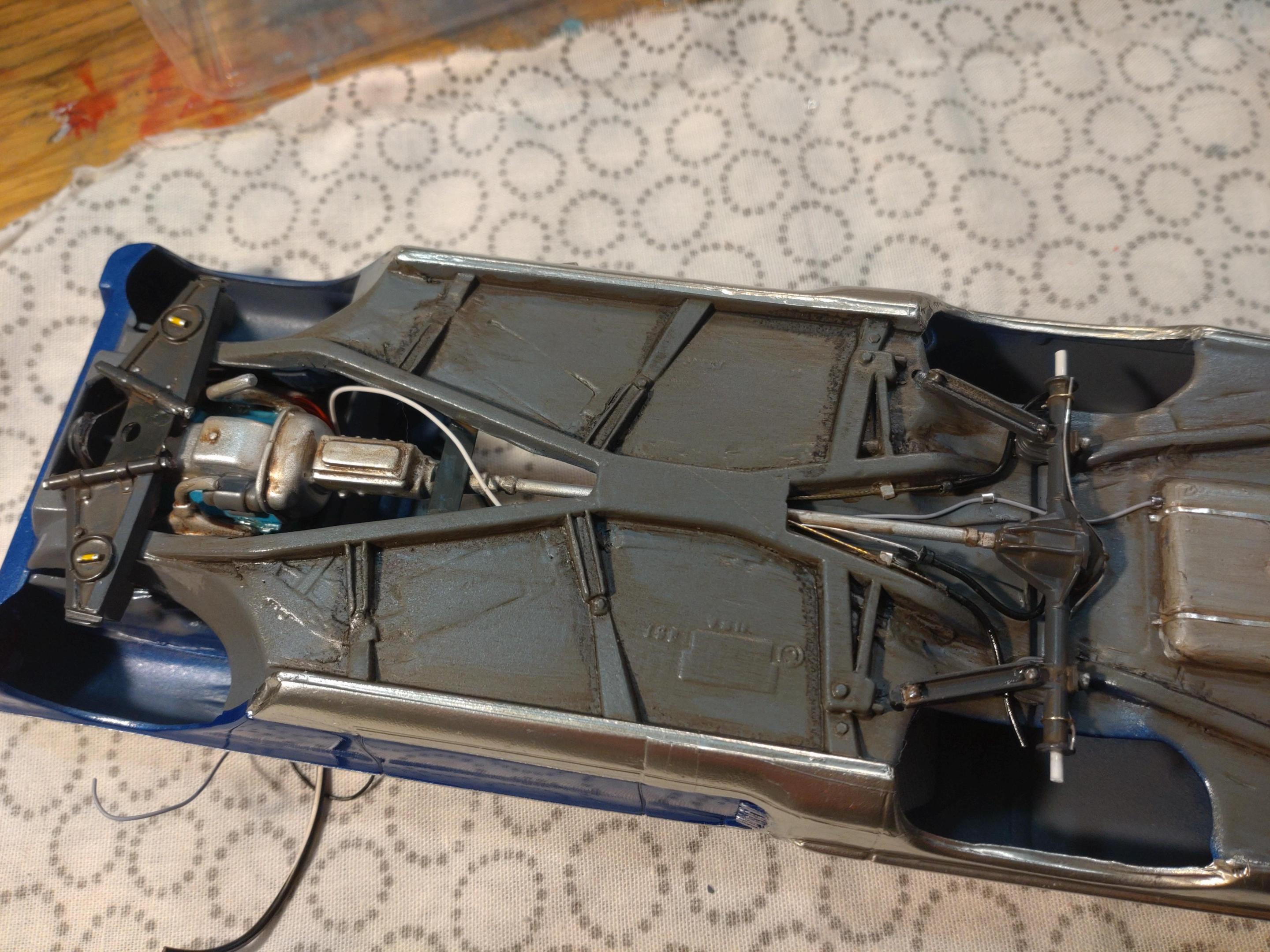

The undercarriage is just about finished too, except for the wheels. Which will be attached almost last.
The rear axle with little left to do.
Front and rear axles finished before the engine gets connected.DSC_1739.thumb.JPG.6d6e0feb208d0f126aa12e62f255f098.JPG
Getting the engine into the bay was a bit messy. It sure was a good decision that I used pins to hold the front suspension in place. Since nothing of this is OOB but more or less scrap, it took some grinding and filing until the engine and the radiator fit snug and were low enough in the bay to let the bonnet close. After getting the engine secured I cut and attached the engine mounts and glued the drive.DSC_1743.thumb.JPG.5966c4871b10f070a59cf0c254d6bda6.JPG

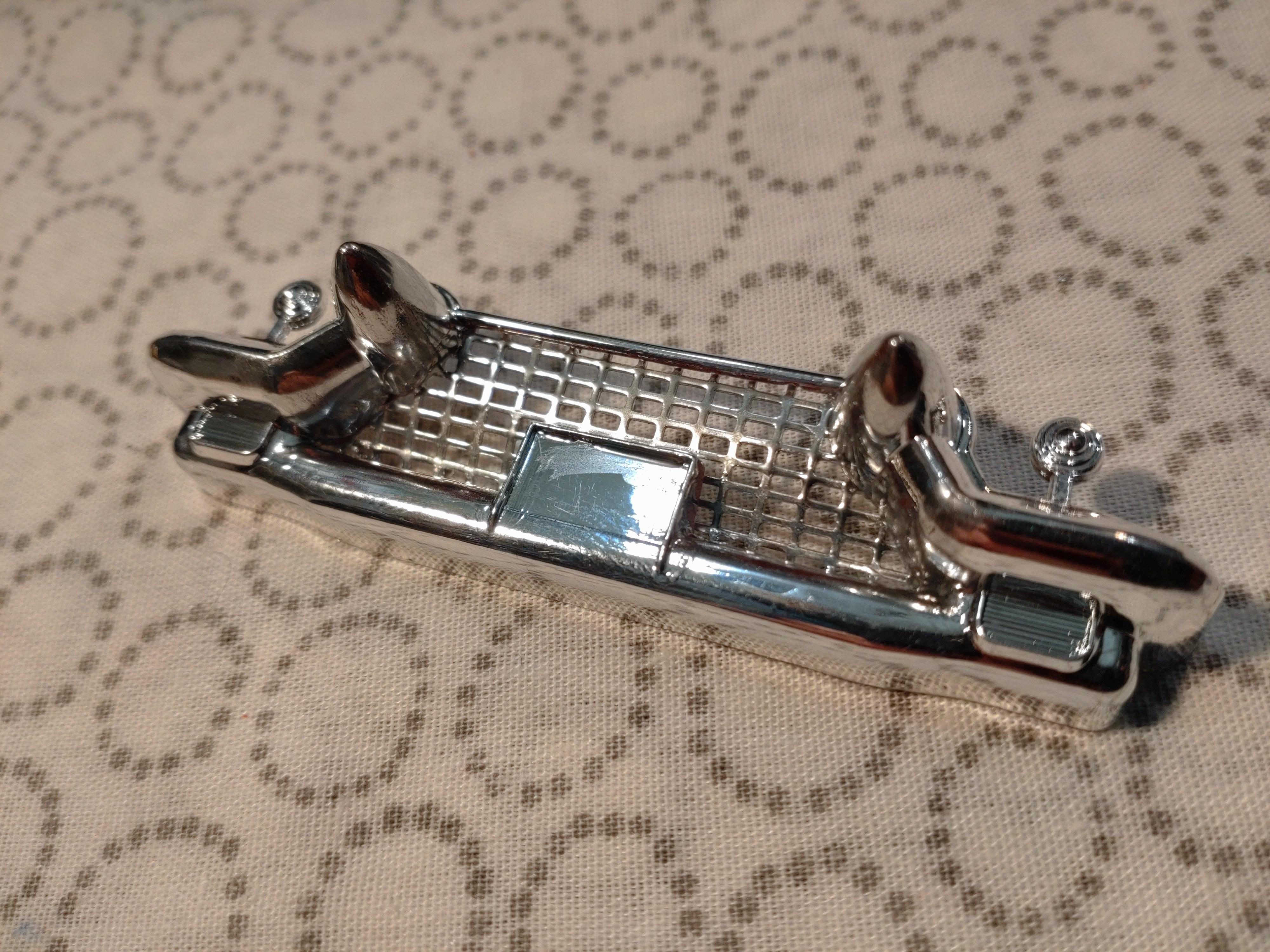

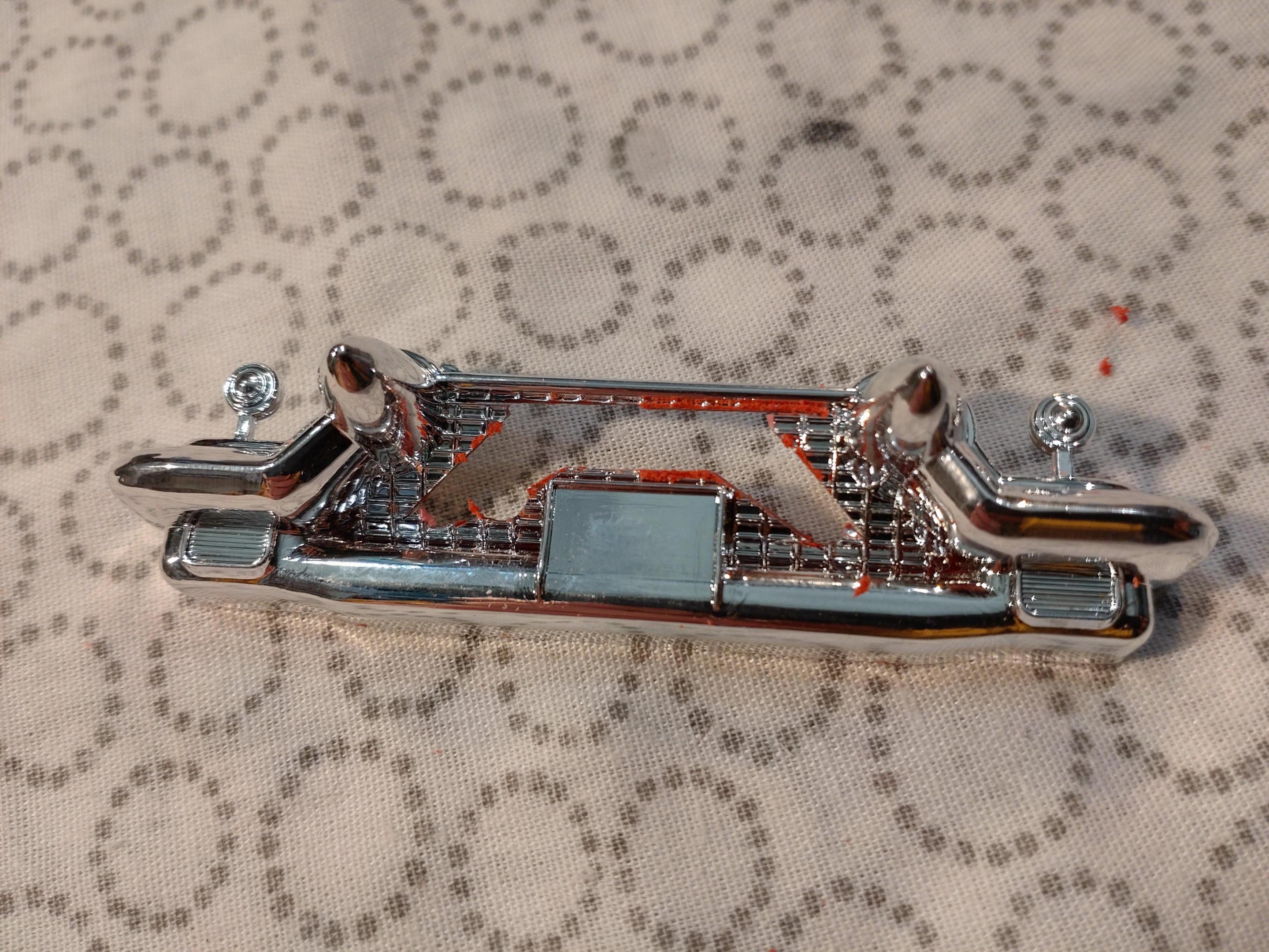

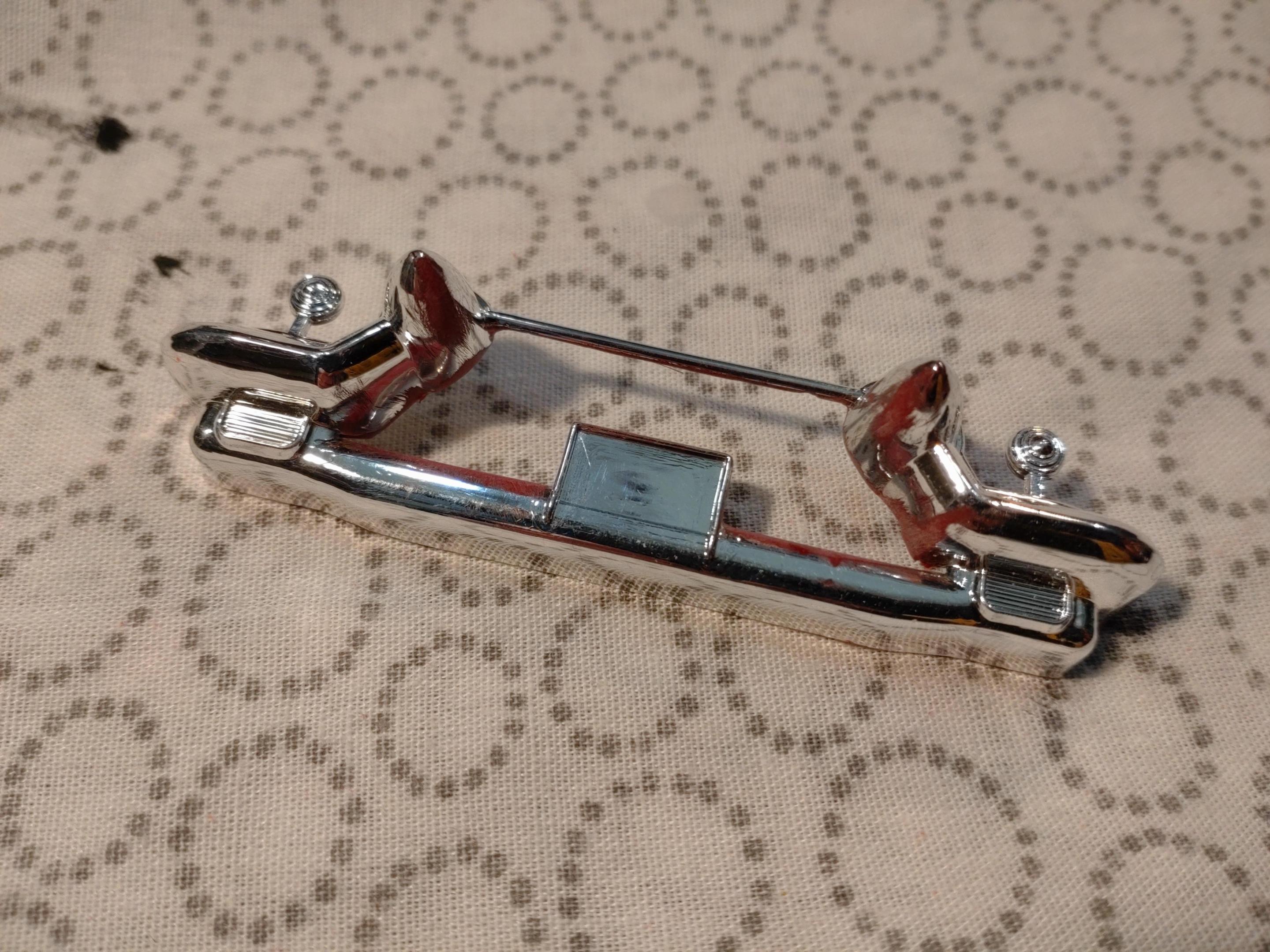

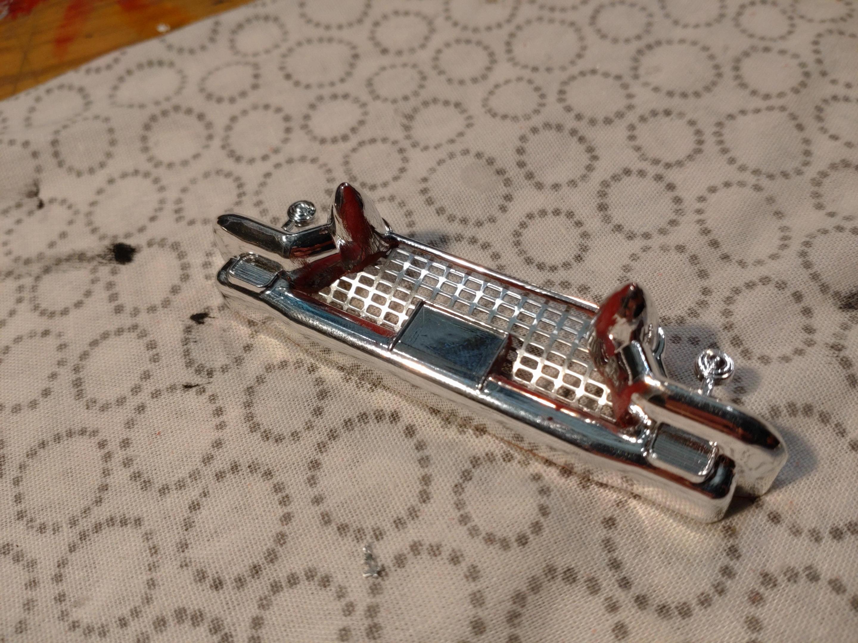

The front bumper was i bit too crude for my choice. I opened the grill and replaced it with a sheet metal grid structure. Here the step by step. First I cut a large area open and then grinded as much as possible with a micro drill. Next step was filing removing the last bit with diamond files and sanding up to grit 1200.
The chrome is Molotow applied with a soft brush. In the meantime I have removed the vents and painted the bumper tips flat anthracite.

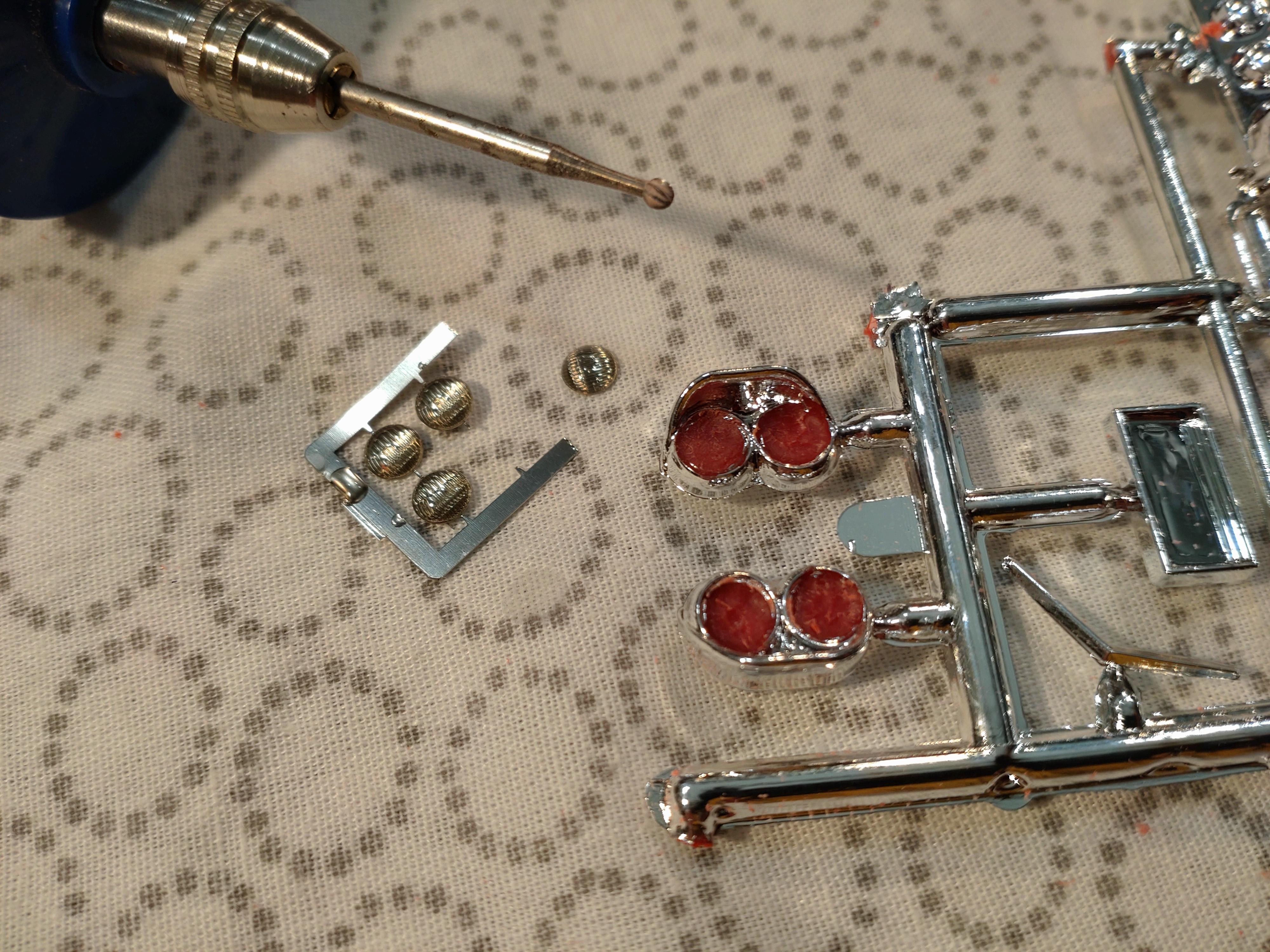

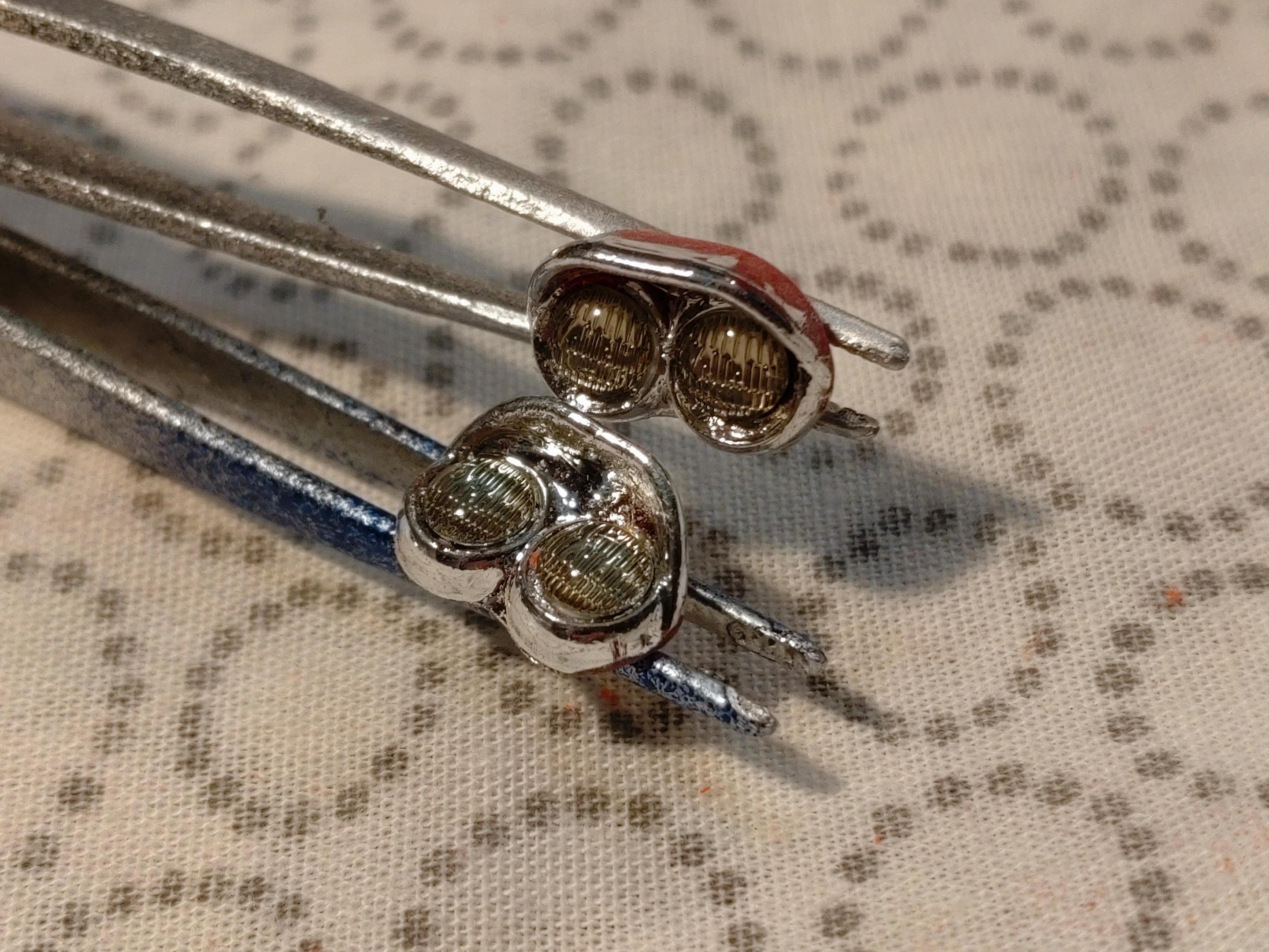

The headlights are getting customized with "lenses". I grinded off the lights and applied headlights by Scale Production.
The engine bay still looks a bit empty.

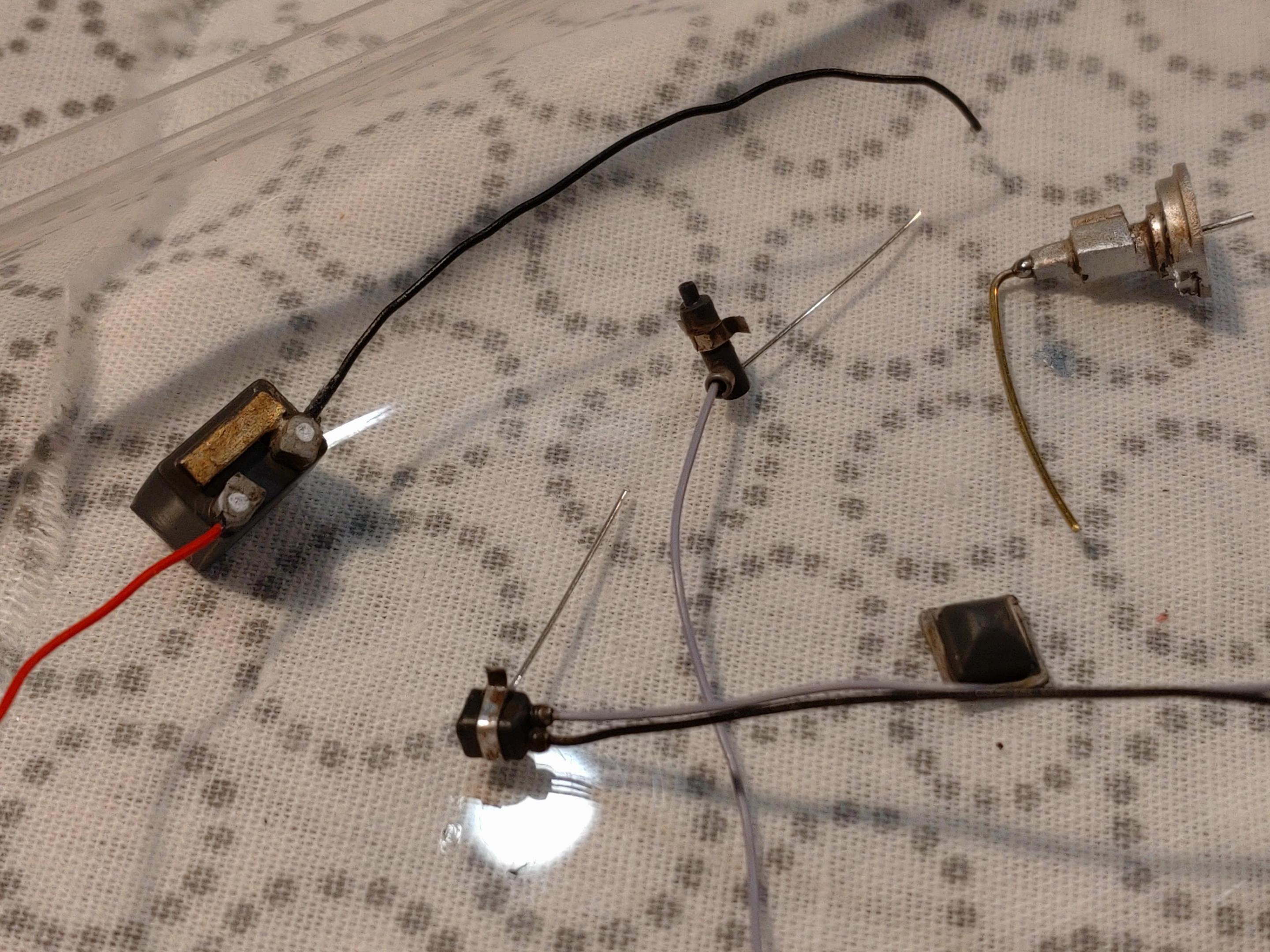

Here are the parts that will enhance the bay: brake booster, battery, coil, relays. All hand made from scratch with styrene, wire and thin sheet metal. As you can see, I like to use pins for these parts. It makes them secure right from the start and I can´t pull them off again by mistake while connecting the lines.
The dashboard is finished too.

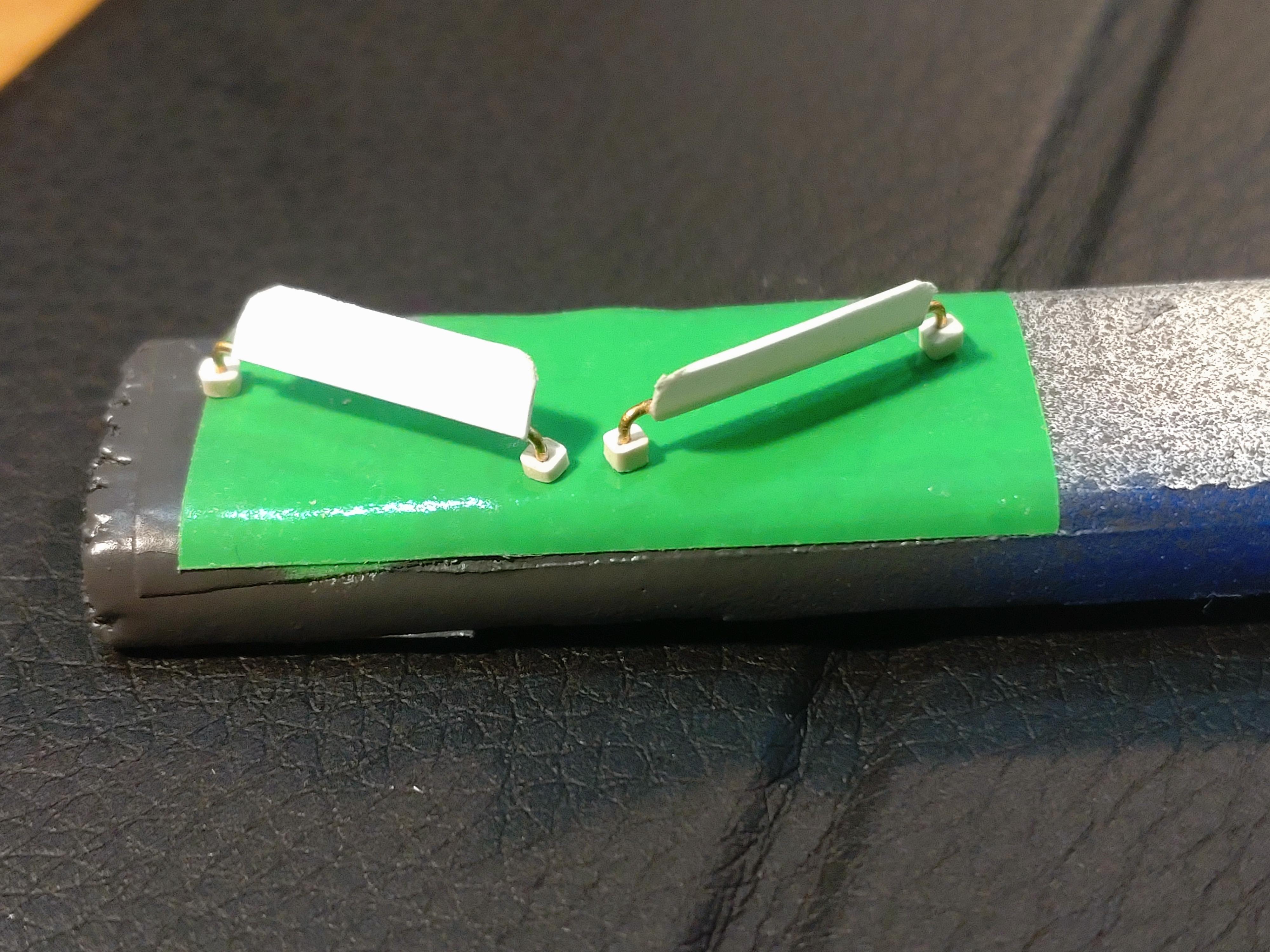

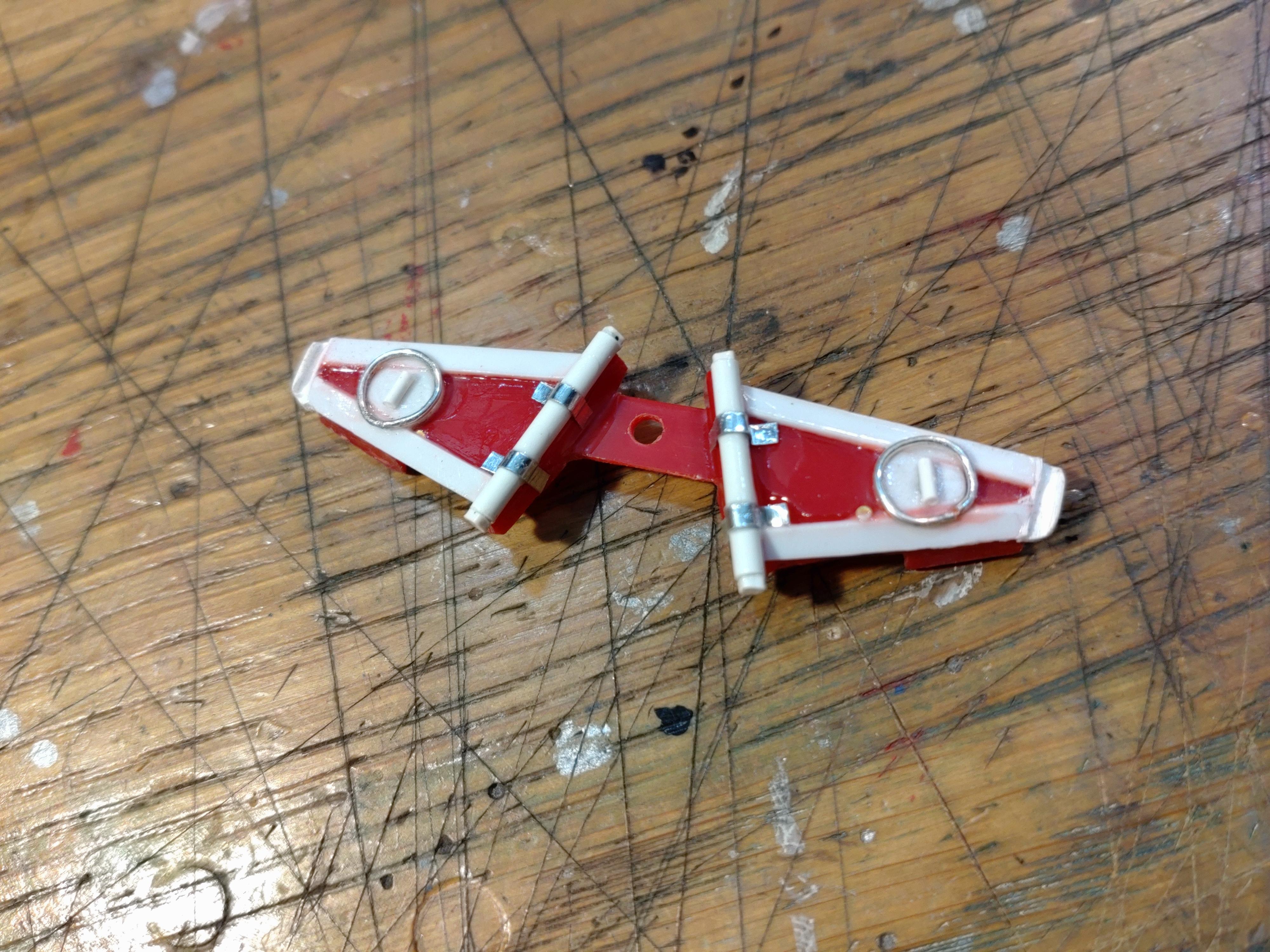

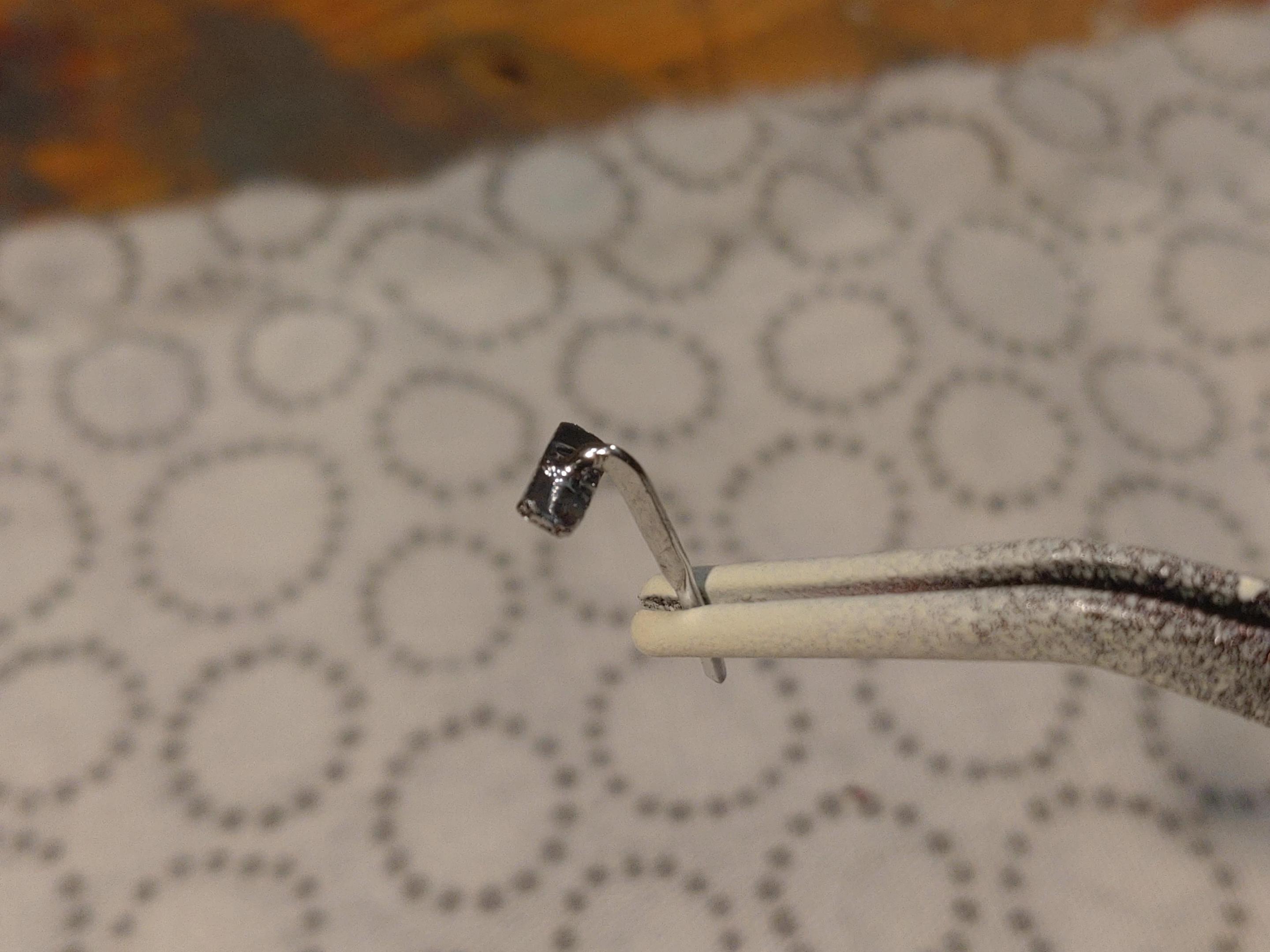

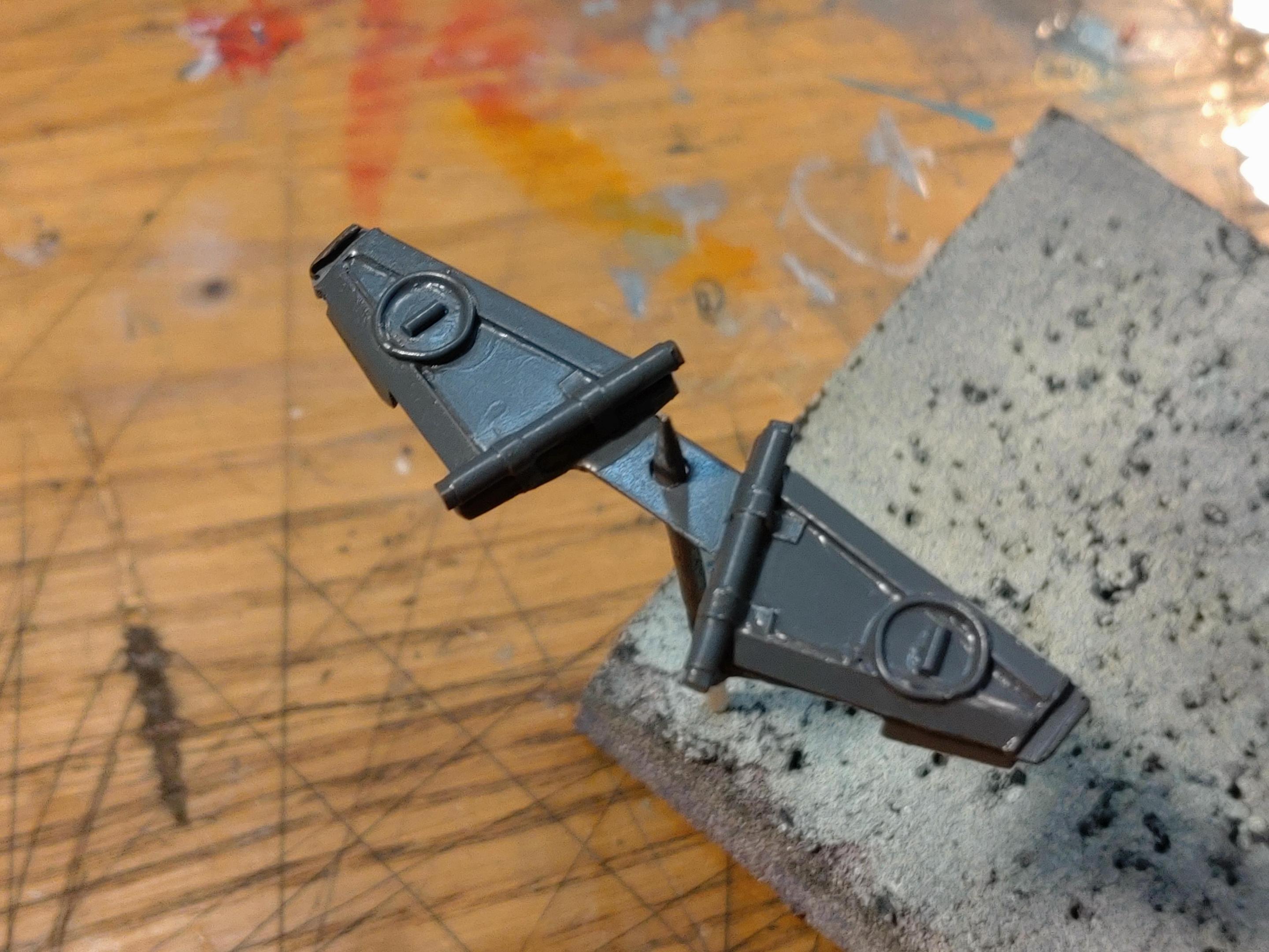

For the interior I want some sun visors and of course the missing rear view mirror. The mirror is 1mm sheet styrene connected to a 1mm aluminum wire, which I flattened after bending the curve. Chrome is again Molotow. The visors are 0.5mm styrene and fixed in different positions for a bit a realness and will be sprayed cream white.
