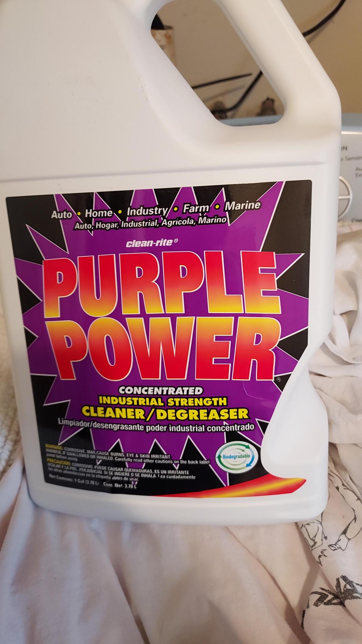

Mike C. Posted March 17, 2022 Posted March 17, 2022 (edited) Did I buy the wrong stuff? Car and some parts have been soaking in this for a solid week and it did nothing at all. Zilch! I could have soaked it in water and got the same results. It was painted with enamel. This was the only stuff at Walmart. Is the right stuff only at the automotive store? Edited March 17, 2022 by Mike C.
Mike C. Posted March 17, 2022 Posted March 17, 2022 On 9/12/2021 at 9:37 AM, Zippi said: The body was painted with acrylic paint and cleared with acrylic lacquer. Just how long does this process take to start seeing results? How does it do on enamel?
Rodent Posted March 17, 2022 Posted March 17, 2022 This is what you want. It used to be available at Wal Mart, but you may have to go to a parts store to find it.
crazyjim Posted March 17, 2022 Posted March 17, 2022 I use brake DOT3 fluid, but that's on House of Color with 2 part urethane clear over it.
Mike C. Posted March 17, 2022 Posted March 17, 2022 I guess not all purple degreaser is created equal. O well, auto parts store it is............
peteski Posted March 18, 2022 Posted March 18, 2022 4 hours ago, Mike C. said: I guess not all purple degreaser is created equal. O well, auto parts store it is............ Make sure not to use the stripper in cold environment. Cold reduces potency of all the strippers. Use them at warm room temperature (80-90 deg. F).

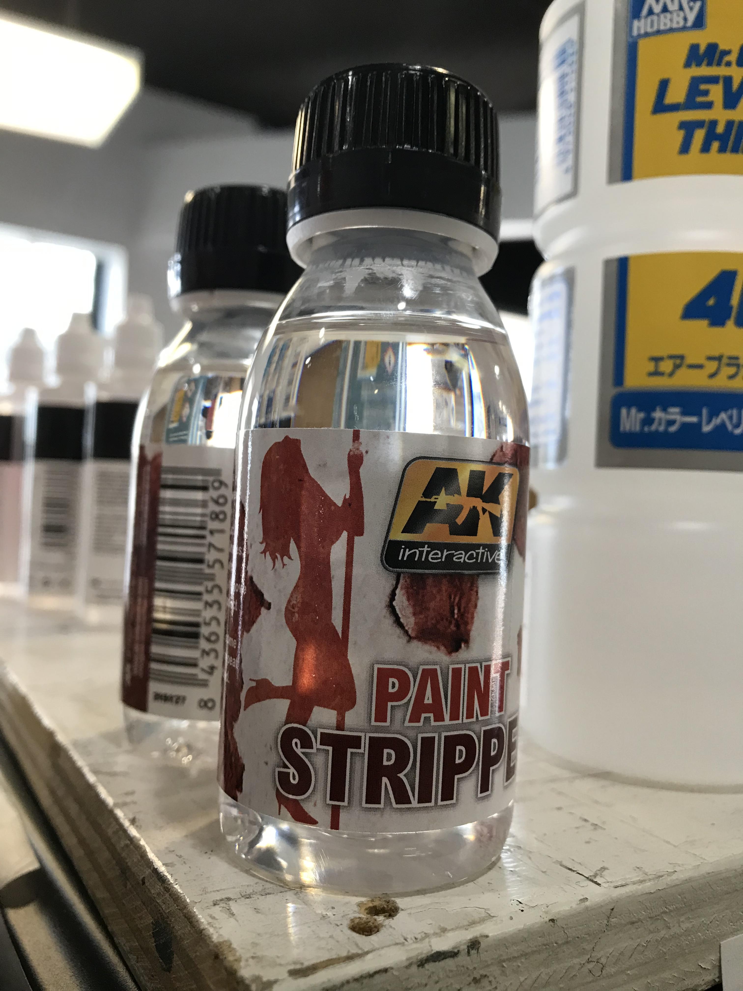

Bainford Posted March 18, 2022 Posted March 18, 2022 9 hours ago, iamsuperdan said: Sorry, I know it's off topic, but my mind went other places after reading your post. Lolz. ? You’re not alone. I saw this at the hobby shop this afternoon. 1 1

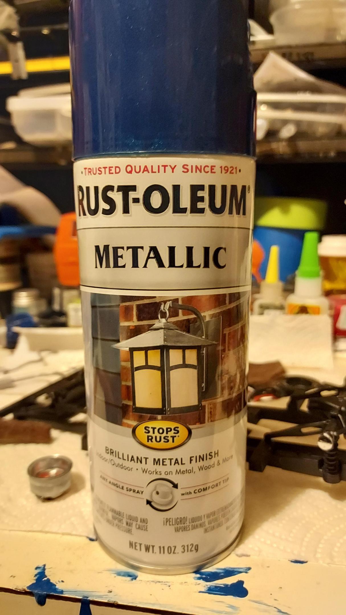

Mike C. Posted March 31, 2022 Posted March 31, 2022 12 hours ago, peteski said: Mike, there are multiple types of paints and multiple types of paint steppers. Certain combinations of paint and strippers work well, others do not. As I said earlier, even the temperature of the stripper can affect its potency. There is no list of which stripper works the best with which paints. At least no list I know of. I don't even have my own list compiled. I have and use about half a dozen of various stripping liquids. it is not an exact science, but more like an experiment. You mentioned "enamel", but no specifics. What brand of paint is it? Maybe someone can offer some specific advice once we know more about the paint. As for the paint age, sure it can be harder to strip decades old paint, but usually there are ways to strip even old paint. However there seem to be some paints or primers out there which are very difficult to strip. This is the enamel I used. I'm relatively sure I used some kind of primer but I can't be certain which. I just got this stuff off the shelf at Home Depot. I'm soaking all the parts cover (to keep evaporation at bay) at room temperature. Maybe I'll move them on top of the heater and see if that helps.
peteski Posted March 31, 2022 Posted March 31, 2022 I don't have any experience stripping that specific paint. If Super Clean doesn't work (even warmed up), then I would move onto other strippers. Next up for me would be Scalecoat Wash Away paint remover, or Testors ELO (used to be called Floquil Easy Lift Off) paint remover. ELO contains an ingredient from the same chemical family as DOT3 brake fluid. Do not immerse your model in those strippers - follow directions on the bottle. Also, have you tried 91% (or even better, 99%) Isopropyl alcohol? Again, it works the best when slightly warm.
Mike C. Posted April 1, 2022 Posted April 1, 2022 14 hours ago, peteski said: I don't have any experience stripping that specific paint. If Super Clean doesn't work (even warmed up), then I would move onto other strippers. Next up for me would be Scalecoat Wash Away paint remover, or Testors ELO (used to be called Floquil Easy Lift Off) paint remover. ELO contains an ingredient from the same chemical family as DOT3 brake fluid. Do not immerse your model in those strippers - follow directions on the bottle. Also, have you tried 91% (or even better, 99%) Isopropyl alcohol? Again, it works the best when slightly warm. I'll have to try the alcohol. After that I might just toss the thing.
