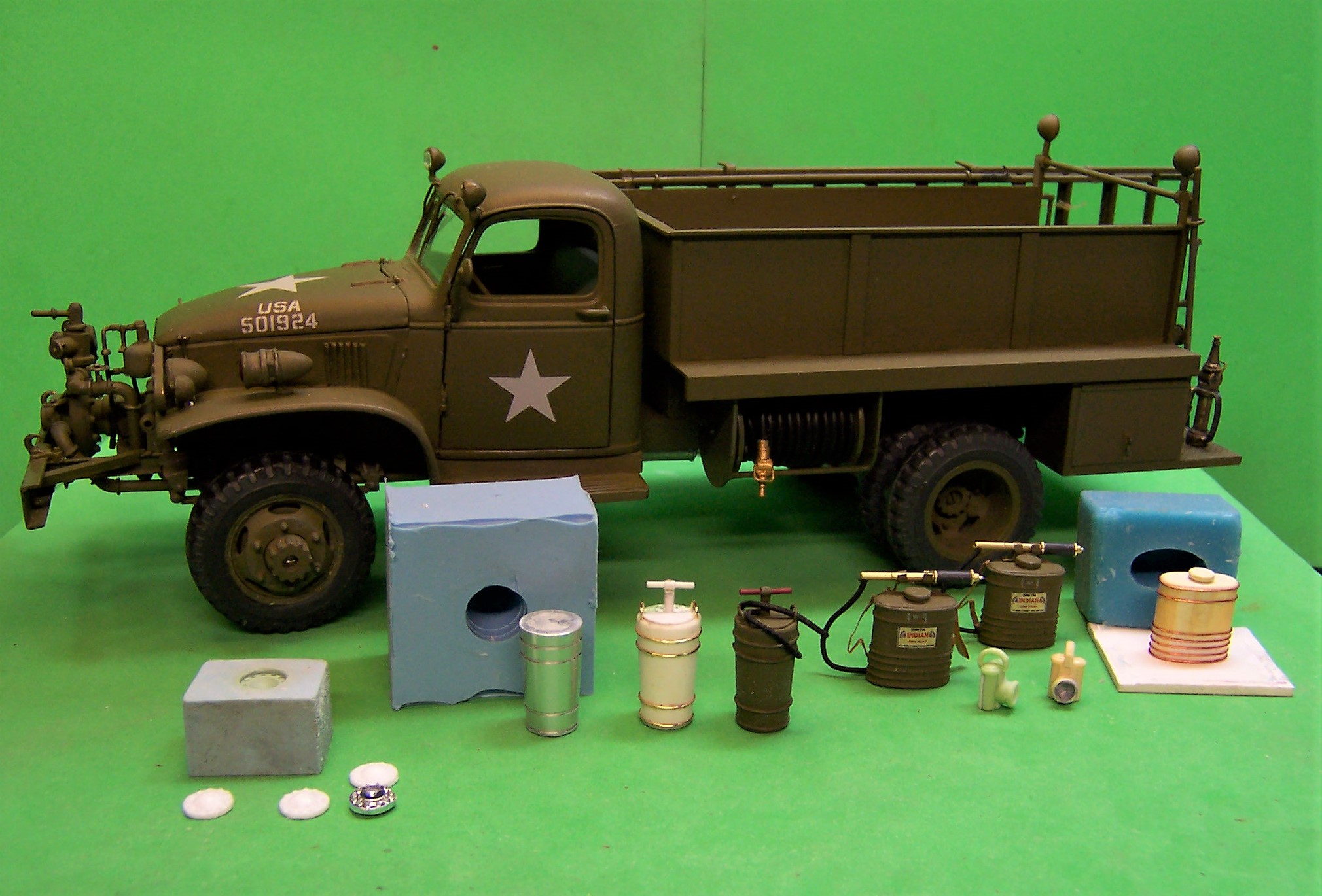

  17. After a couple of feverish work sessions the Class 325 fire fighting rig is finished. The plumbing from tank to pump and from pump to hose reels was finished yesterday and a battery box was installed behind the cab. A little paint touchup here and there and it is now ready to go.
  18. And finally here are the 4 pails that are part of the equipment. I used a photo of the actual truck to determine the size of the pails and then turned out a master of the stacked pails on my lathe. A mold was made with the widest part down so that when the resin copy is pulled out it comes out of the mold easily. Next was to wrap some wire around the top edges of each pail to represent the rolled edges. Then similar wire was bent to form the handles. The whole piece was sprayed with Rustoleum etching primer and then given a swipe with some Tamiya weathering powders. The slightly off OD color adds some contrast and the weathering powders gives them a bit of wear around the edges and on the handles. Just got to get all this stuff permanently mounted now.
  19. Beautiful job on that frame. Great scratch building!!
  20. Zeroing in on details now. The left side of the rig carried hand tools and appliances. So far the 4 gallon pump can and the 5 gallon back packs have been finished. Yet to be done are 4 buckets stacked at the rear above the compartment. An ax is mounted on the vertical panel behind the buckets. The photo shows the masters, the molds and in the case of the 4 gallon pump can the intermediate unpainted version beside the finished can. To the very left are 3 of the 4 hub caps that will cover the screws holding the wheels on the axles. In front of the back packs are two battle lanterns that will also be mounted topside.

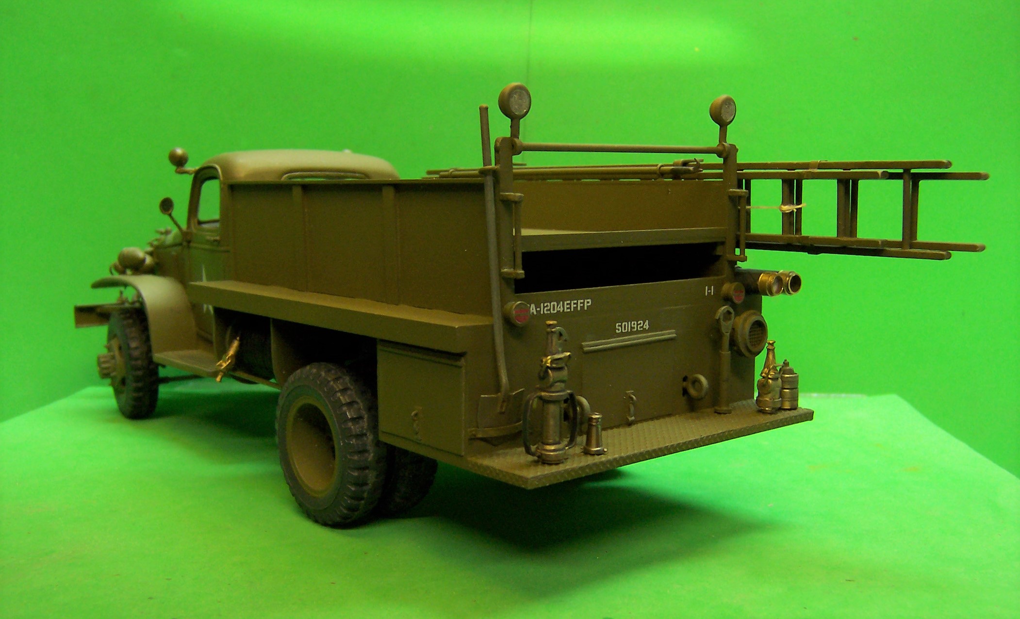

  21. Keep the chrome pieces bright! It will make a great contrast!
