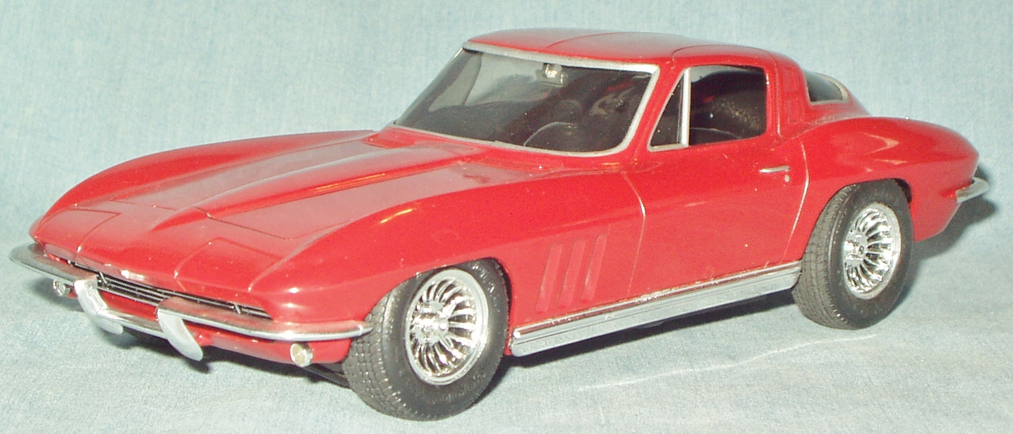

  1. 1500 grit is fairly harsh to start with. I actually prefer not to clear coat solid Tamiya lacquers and will sand and polish the color coats. I start with 2000 grit automotive sandpaper, move to 2500 and finish with 3000 grit before moving to automotive rubbing compound and polish. I follow the traditional 3 mist coats, 3 wet coats rule and usually don't have a lot of orange peel in the finish to start. Below is my 1/12 Tamiya Porsche 934 painted in Tamiya Camel Yellow without clear coat... And my 1/12 Tamiya Fairlady 240ZG in Tamiya Racing Green.

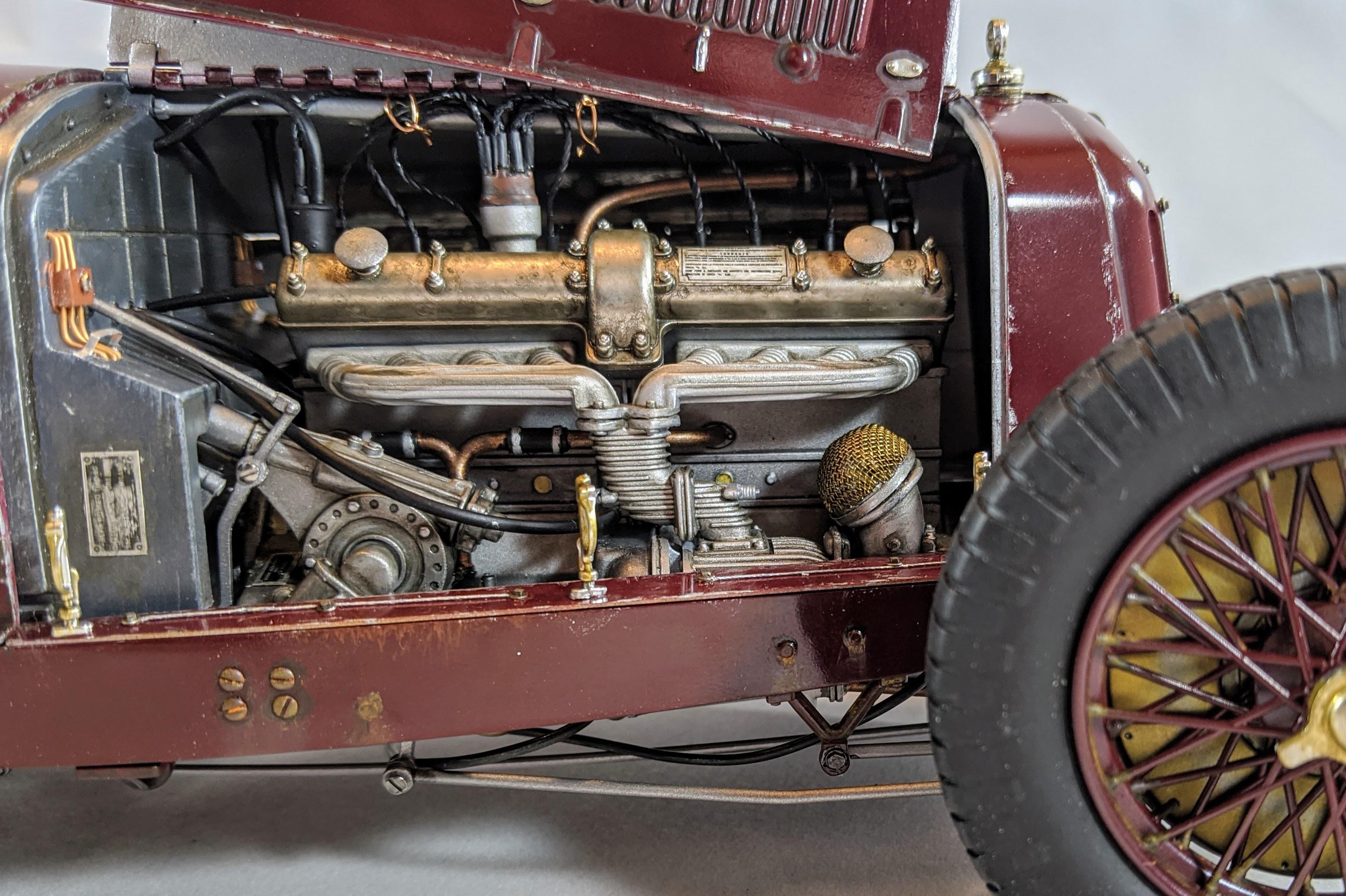

  23. Salt weathering. You apply your base color (on the Bugatti it's dark aluminium, on the Alfa exhaust it was a mix of Model Master acrylic rust and another red brown stippled on for texture). Once the paint is dry lightly moisten the surface with water and a tiny bit of dish soap and then sprinkle with table salt. Once that's dry apply your top color. If airbrushing use as low a pressure as possible to keep from blowing the salt off. Once the top color is dry, brush the salt "masking" off to reveal your rust/bare metal color. You can also use rubber cement or liquid masking but I like the randomness of the salt effect. I also like Tamiya weathering pastels to add rust staining for a final touch.
