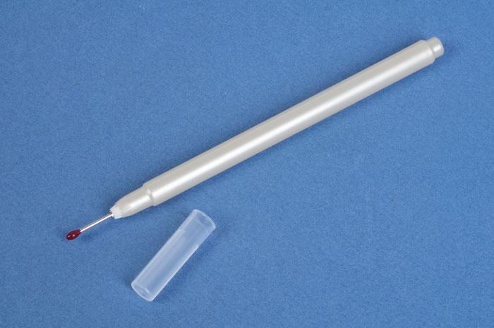

  9. Something like this? I don’t have one, so I don’t know how well it works. http://www.hyperscale.com/2011/reviews/tools/pickandplacereviewbg_1.htm
