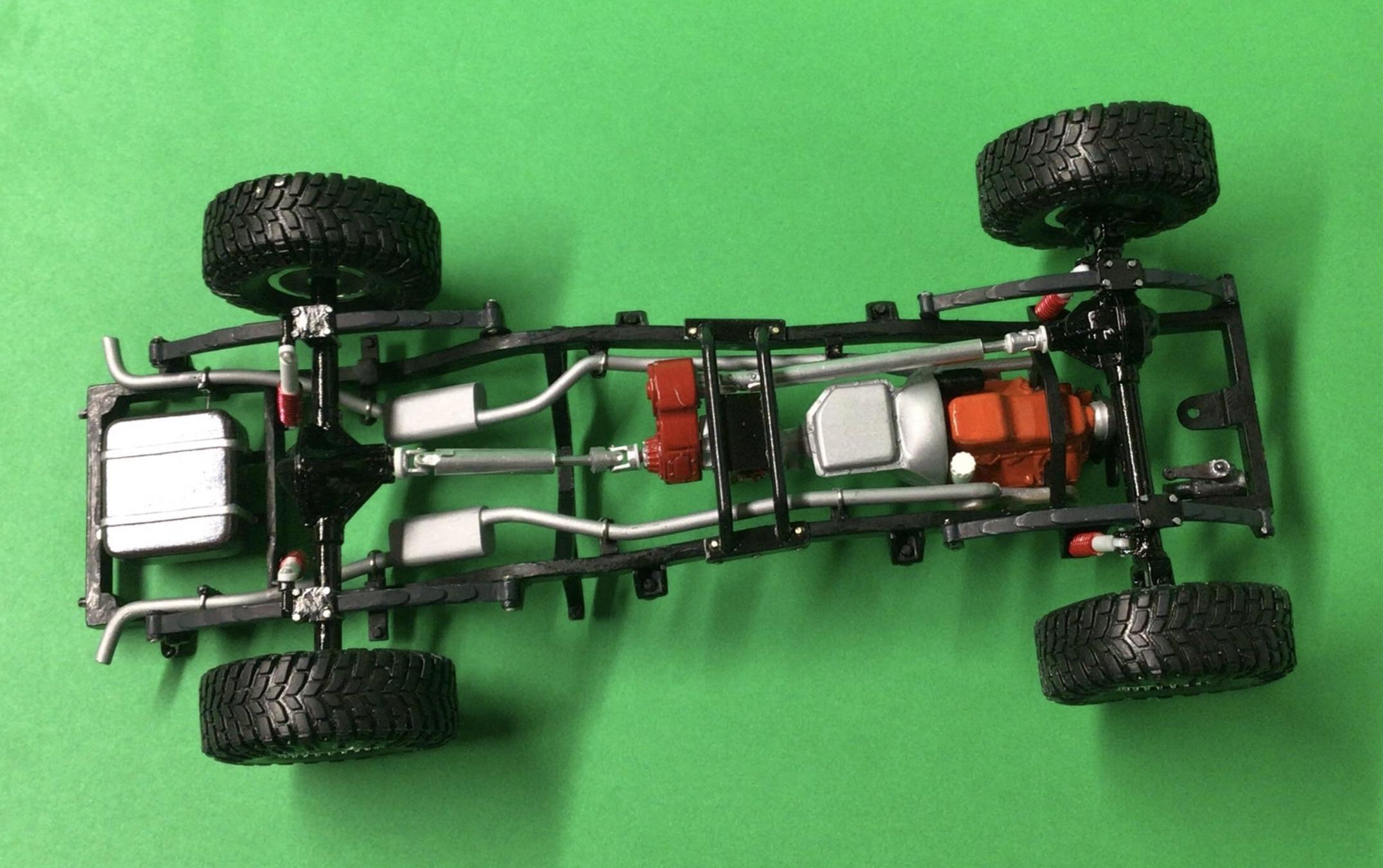

I recently made these mufflers and thought I would share the process. First I glued two pieces of .156” tube together and filled the crotch with some half-round and CA. Then I sanded the ends square and capped them with some thin styrene sheet. Sand the end caps flush and drill the holes for the .100” exhaust pipes....simple!? The tubing allows the exhaust pipes to “float” in and out a bit until everything is in place so it can be glued solid. The exhaust pipe can be solid styrene, solder, or in this case I used .100” tube with some soft wire shoved inside.

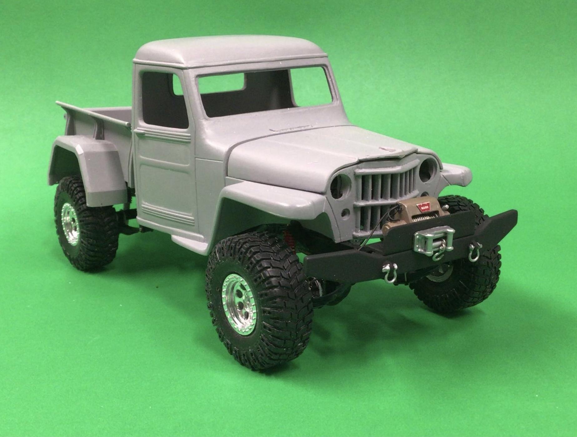

So I redid the rear springs for a third time. When I started making the exhaust, I realized the rear springs were not right. They scaled out to almost six feet long.? The Jeep Honcho springs that I sort of copied are way longer than they should be also. Oh well, it’s all good now! The engine and drivetrain are in place and so is the exhaust system. I scratch built the front and rear bumpers, as well as the winch and roller fairlead. -
