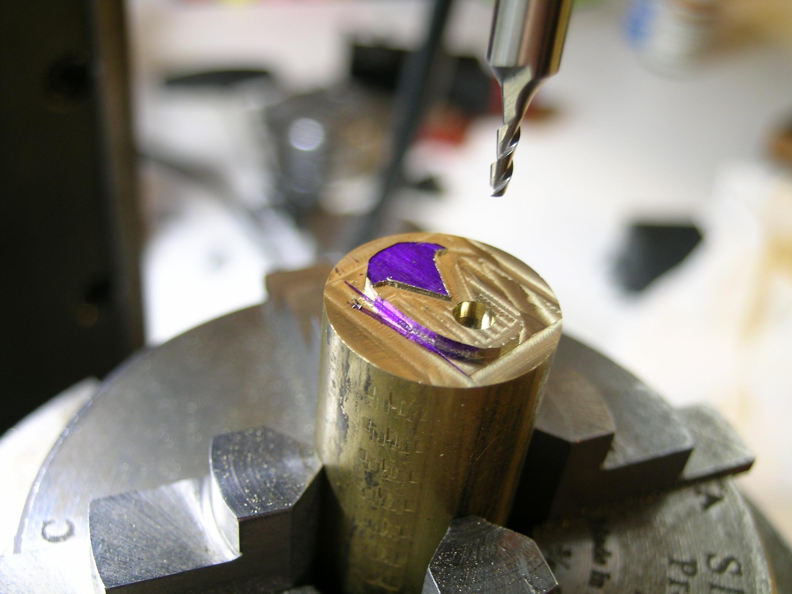

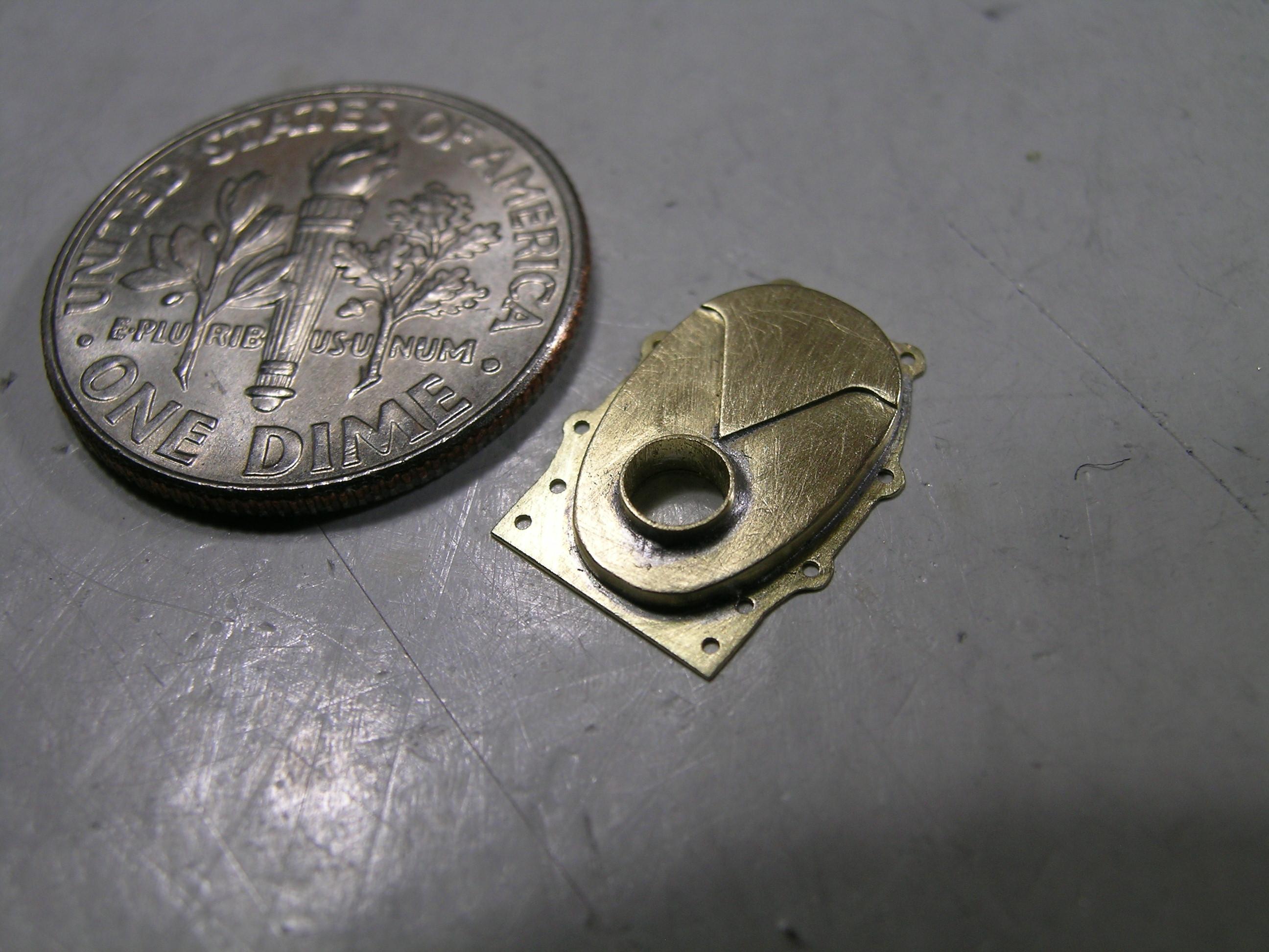

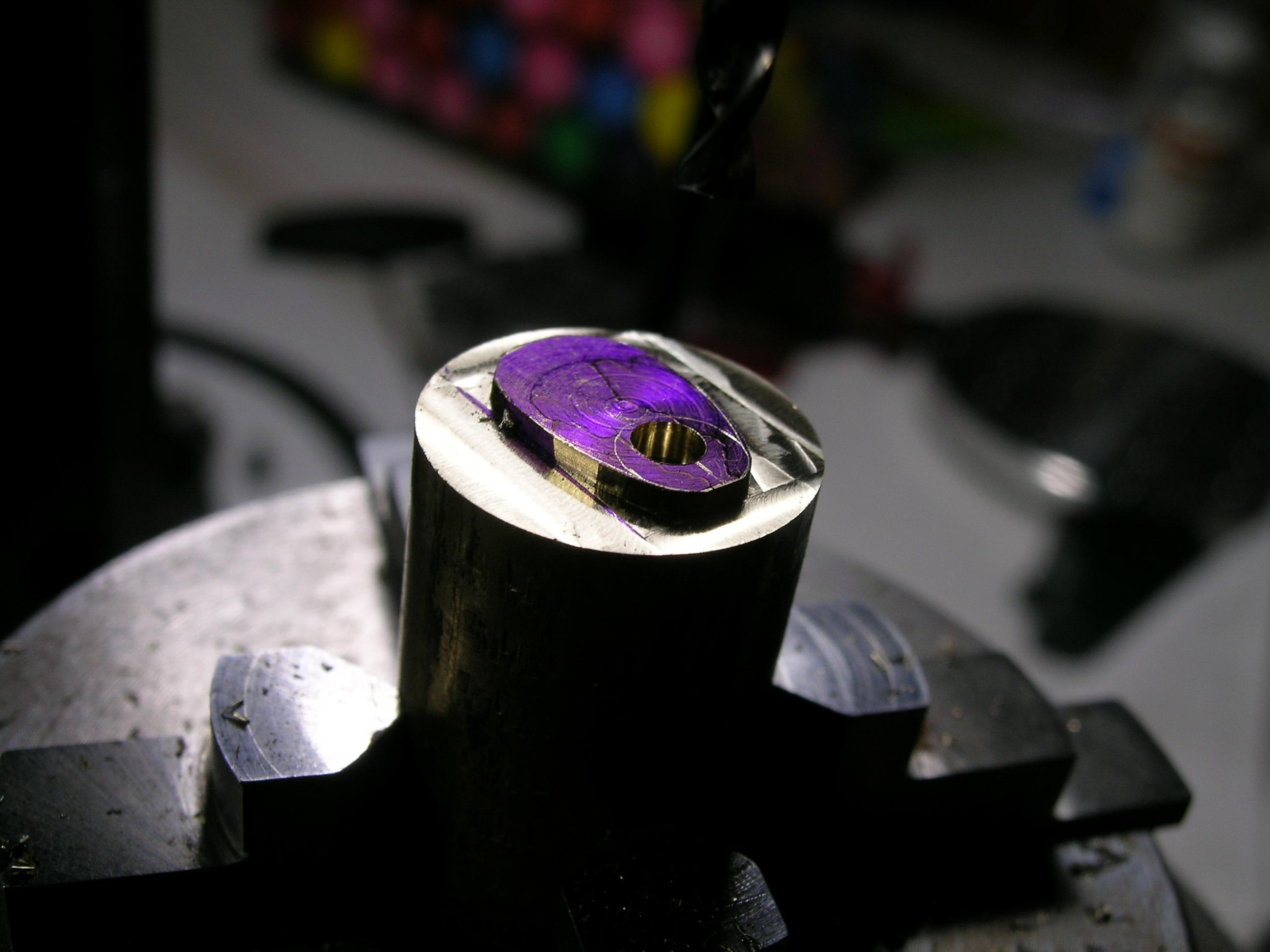

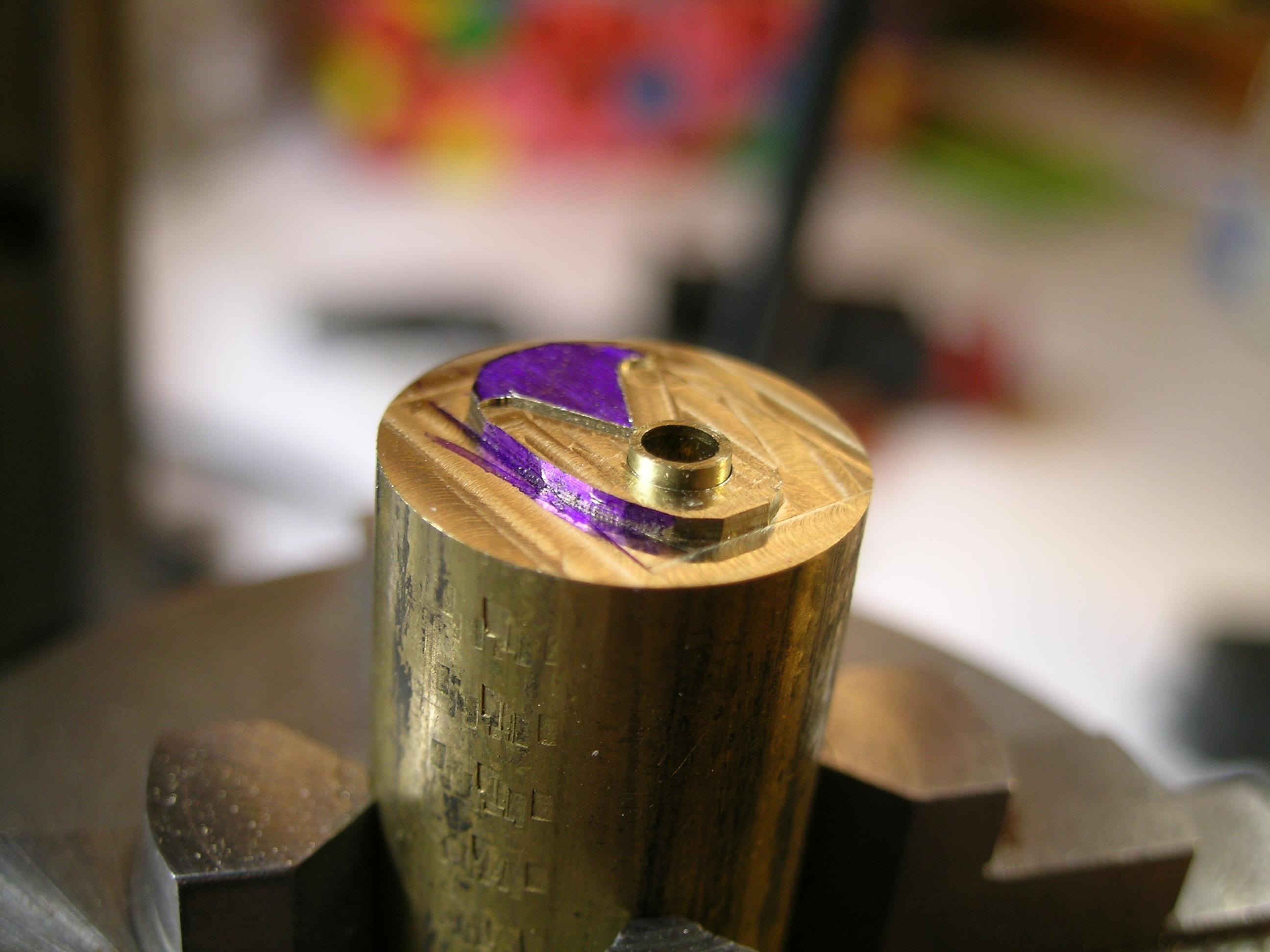

Hello guys, Another small update today, I decided to make the timing chain cover from brass instead of aluminum to add color contrast. The part will be partially hidden behind the water pump housing and the engine damper but it will be still visible from under. I will continue next with the bellhousing and the transmission in order to make the final adjustments of the mechanical aspect of this build. Comments are welcome as usual so feel free to leave some! Take care, Francis Using a 1.000 inch brass rod I started the machining of the timing chain cover. I machined the ’’V’’ shape gutter like the real part even if this section will be hidden behind the water pump. I added a piece of brass tubing to simulate the crankshaft O'Ring housing. Final part made from 3 parts and welded by resistance. The base plate is 0.005" brass sheet that was manually usined. I drilled holes for the bolts as per the ones on the engine block. -
