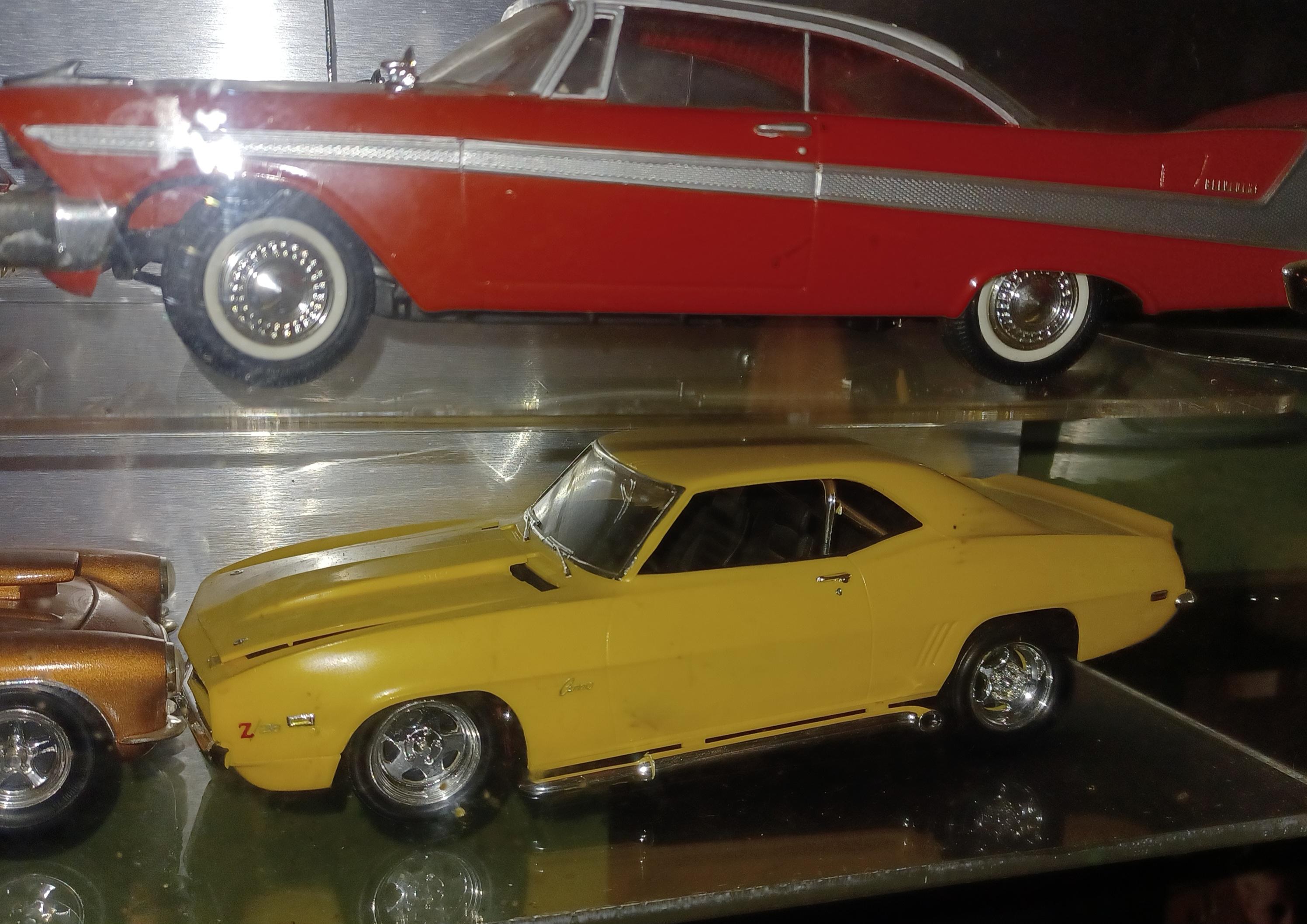

I finally used some of my model paint. Red on the left #1 TDC, silver on the right where the rotor was pointing when I removed the distributor. Unfortunately they weren't much help as this distributor is worn out so I had to use another. -

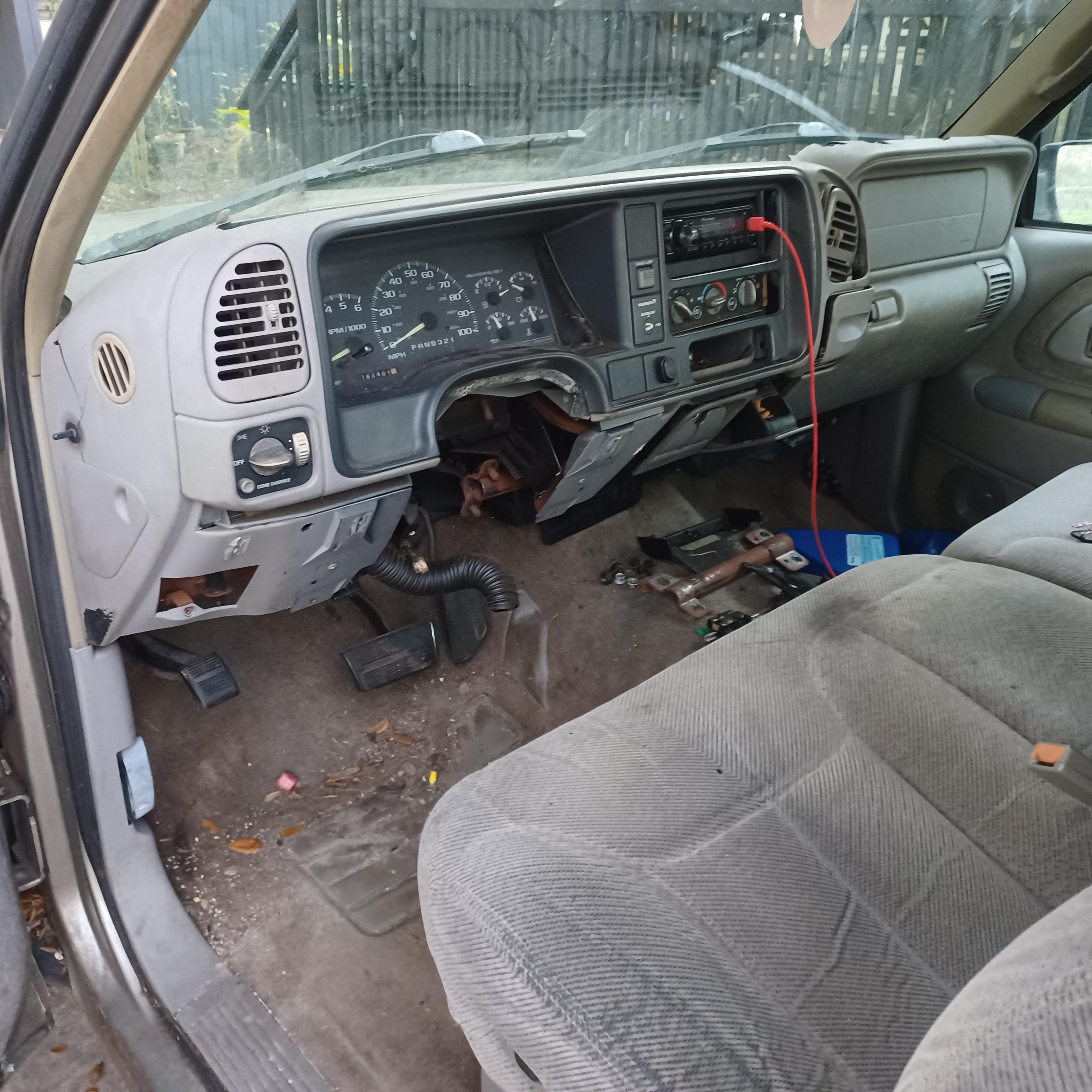

I think I'm ready to do something about this. It's been this way for a while. The lock switch has been busted for a long time, but the window switch just had a wire pull out so I have to jam it in the plug to make the window work. I'm better at putting things back as they were, but I don't want to do that here. I've been trying to kick start my imagination but haven't come up with anything yet. I don't really want to use wood. -
