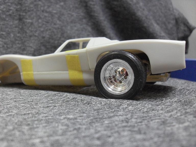

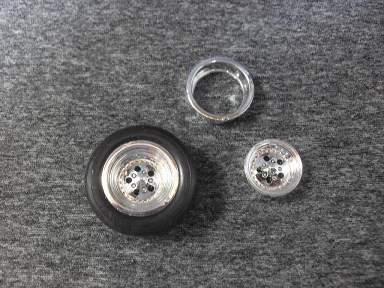

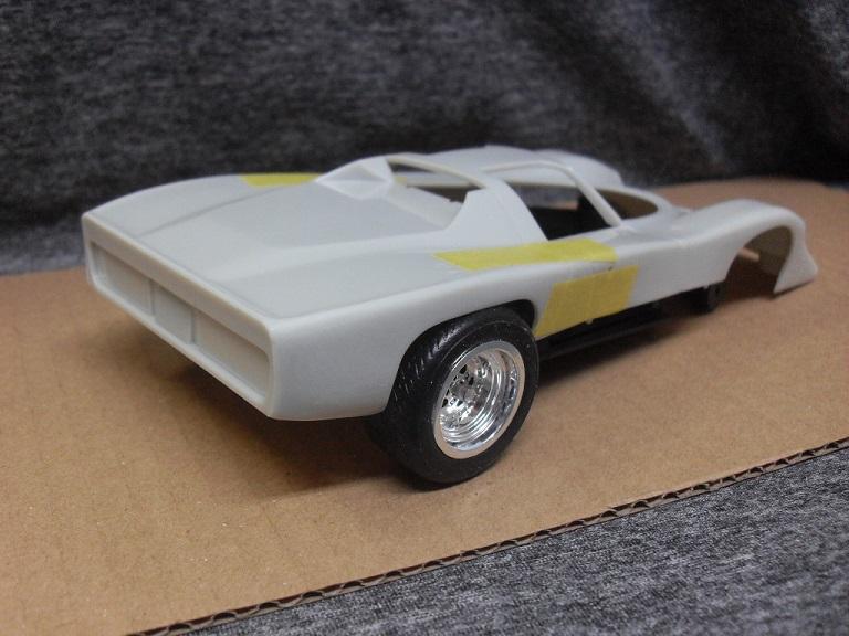

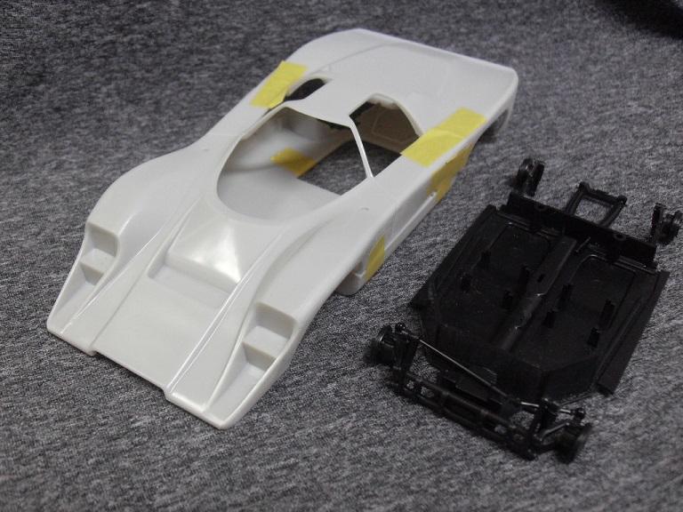

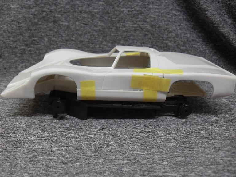

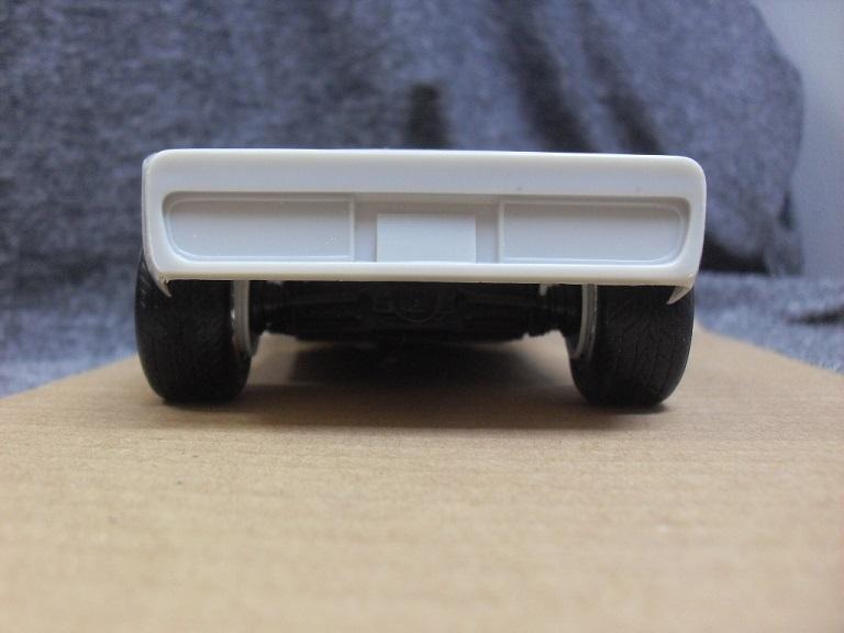

  4. So, this is THE hero car for me! The Coyote X from Hardcastle & McCormick....... The only kit that was made of this car isn't very good. They got the body pretty close, but the rest of the kit was leftovers from another car entirely. My goal with this project is to build this car on a VW bug chassis, like the actual car was...... Today began my adventure when the Beetle kit arrived. First off was to see how close the wheel base would be to lining up between the two kits.... The Coyote wheel base measured out to 9.5cm, where the pan has a wheel base of 10cm..... I just cut the front suspension mount from the front bulkhead, removed .5cm of material, then reattached the front axle...... Here's some pics to show what I have going on.... This pic is just showing the size of the pan. This is after I removed the 1/2 cm from the front...... This pic shows ( though not very clearly, sorry... ) that the wheel bases now match. The one thing that bugged me the most about this kit was the very undersized wheel and tire combo. On the real car, the wheels almost have a presence of their own! I was lucky in having some wheel backs from another kit. I removed the web from the center of the wheel backs and just used them as sleeves. Now the wheels ( these are for the rear ) are both deeper and a larger diameter...... Next thing I guess I need to figure out will be the track width! Then I can start trying to adapt the Coyote parts to the VW pan........ Anyways, here's what is on my bench at the moment! I'm sure I'll be having a bunch of questions as I go, so you all keep an eye on this, maybe you can offer some help!

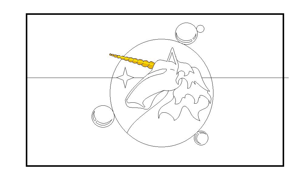

  6. I've been doodling some more...... This time with MS Paint. The first one is done, the unicorn is a WIP........
