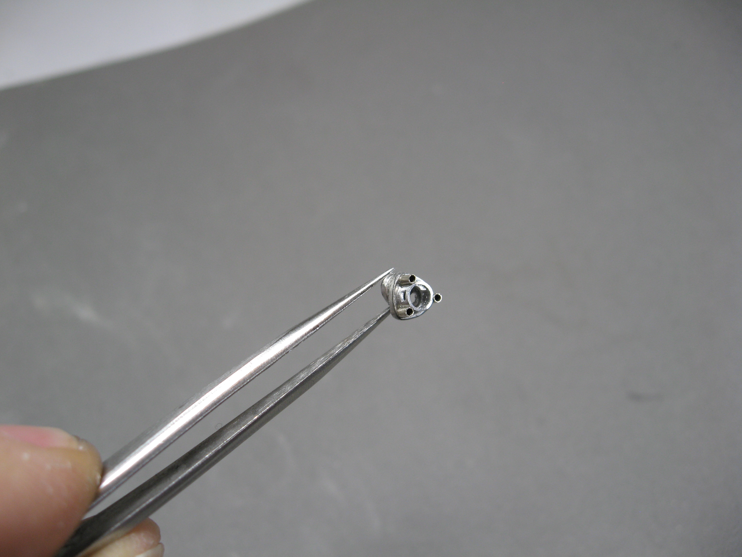

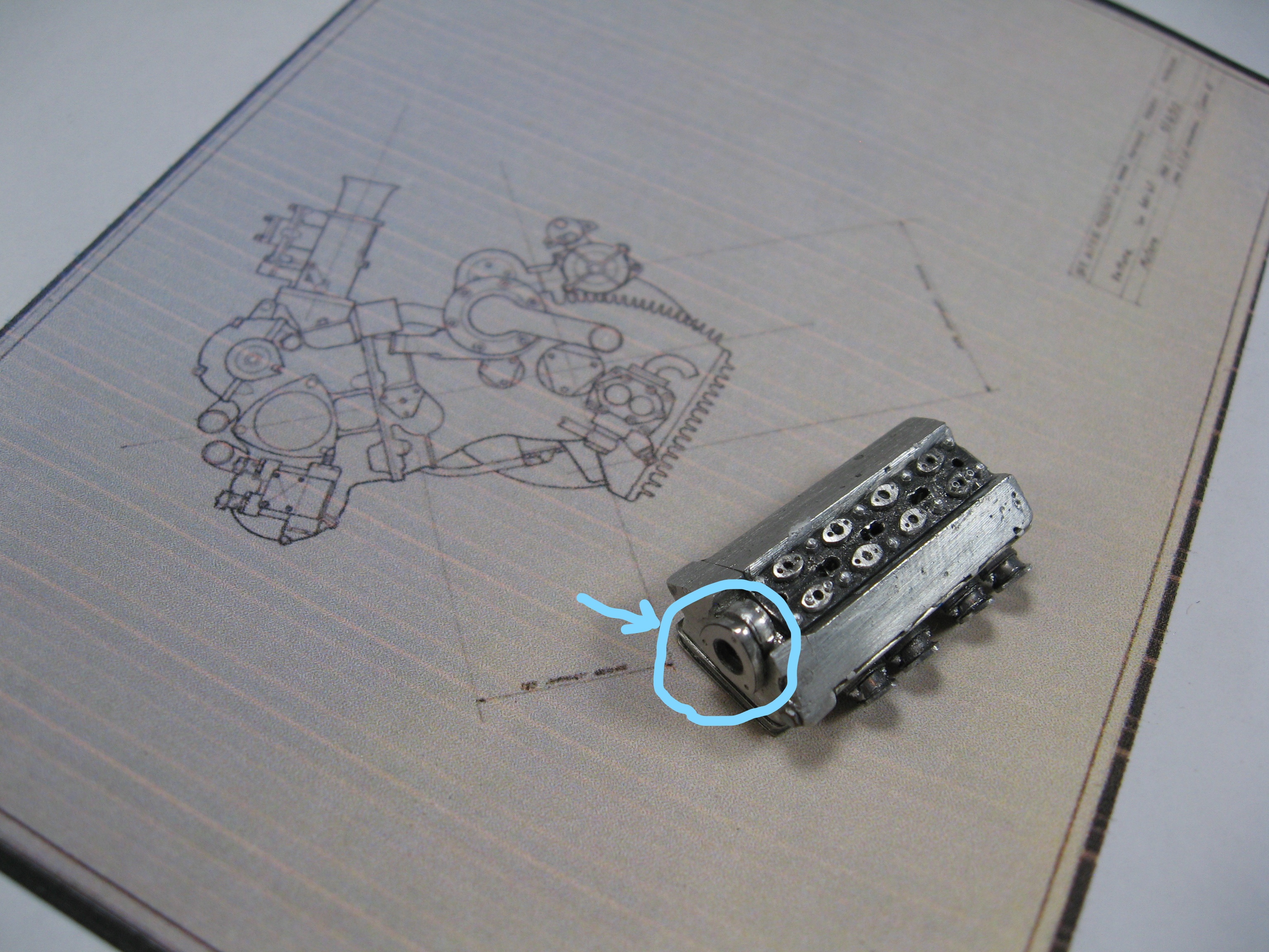

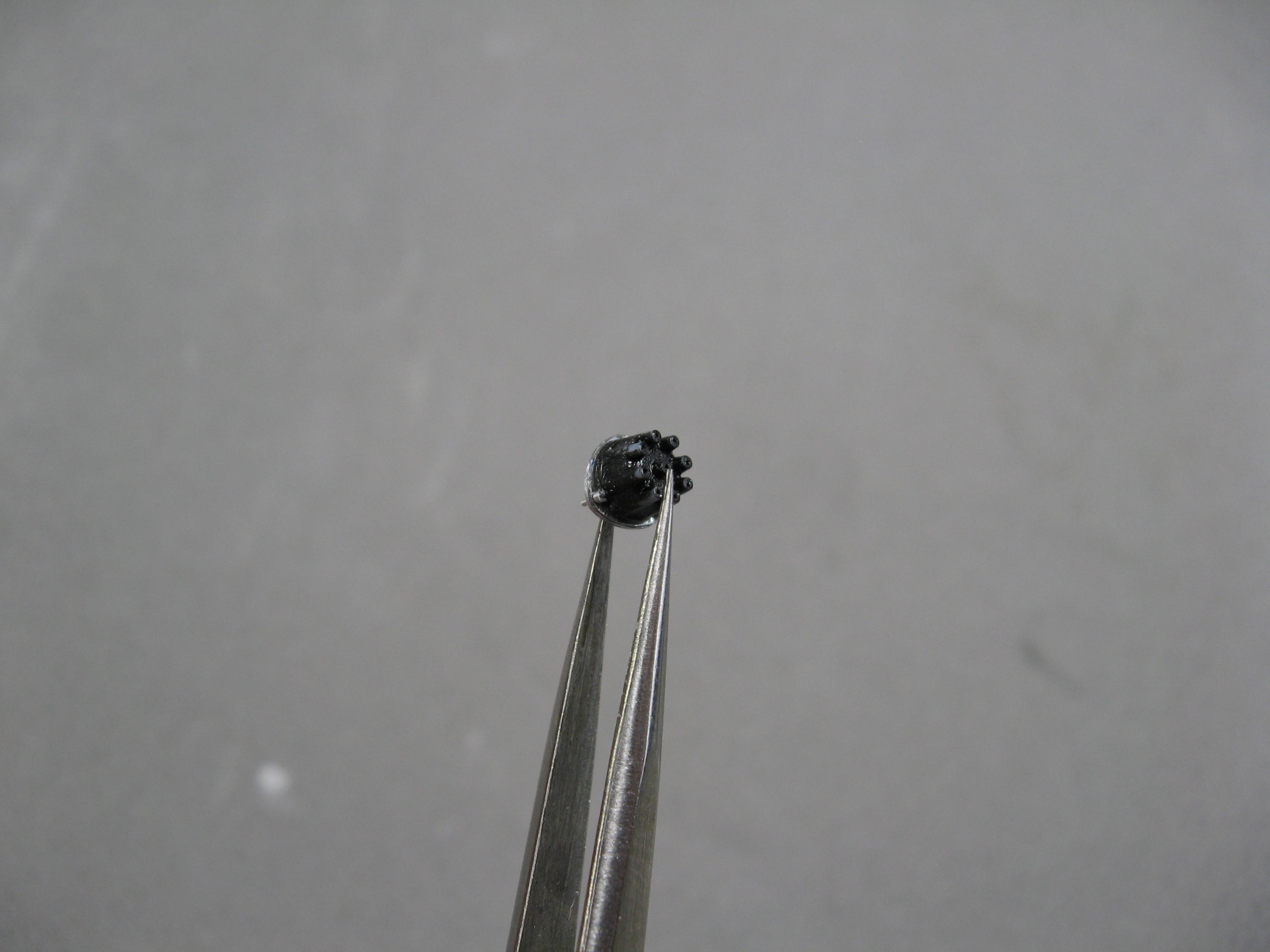

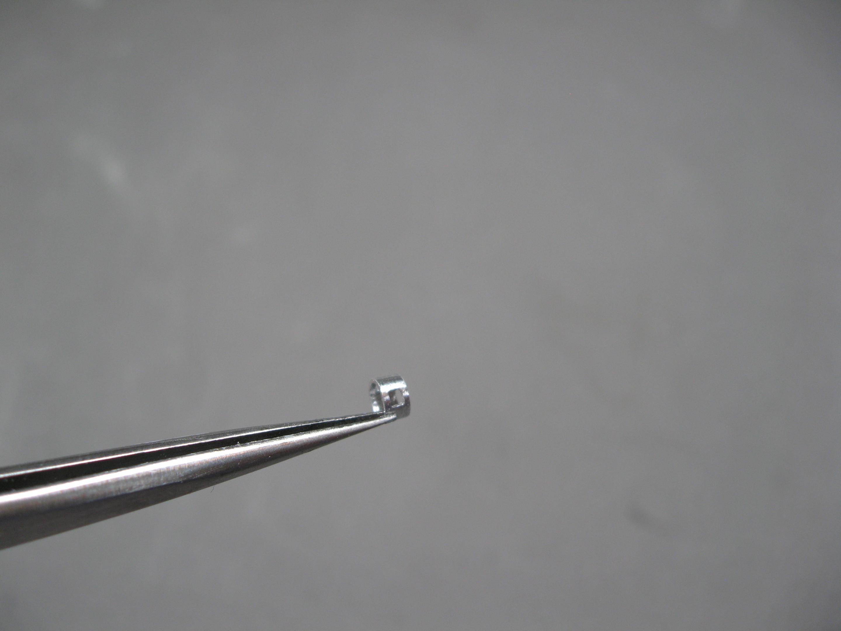

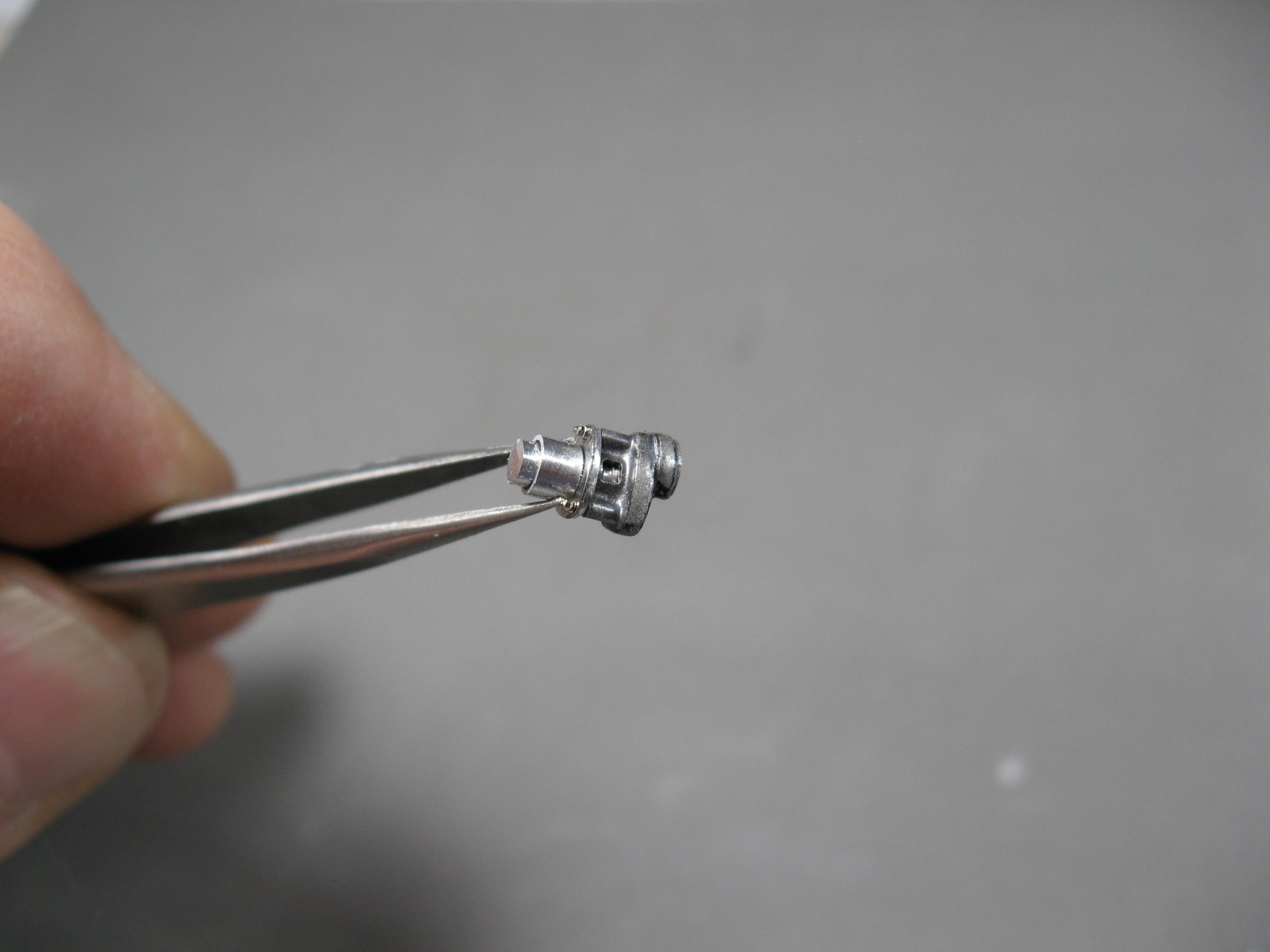

Randy D Posted August 19, 2021 Author Posted August 19, 2021 Hi Folks, Andrew, Just trying to fit in here Hey Josh, Thank you but you should see builds of Francis and Codi over in the Drag section!!! Thank you Bruce !! Appreciate the comments Trevor. Hey Brad, Looking forward to coming down for spring training and the DSC! Tim, I really need to get to work but I keep getting sucked in looking at your build threads:) Okay, Next up for this little motor is the rather loooong distributor that comes off the front of the head casting. It even has it's own V notch in the framework. For a 4 banger there are alot of wires going on here. Twin plugs, twin coils and two outside condensers.... I showed the beginnings last update that were mocked up. The gear tower and the base of the spacer that Maserati used... A ref. pic for the spacer from the site of an 1 : 1 English shop that does some really cool stuff "Crosthwaite & Gardiner". The color engine photo above is their work. More.....

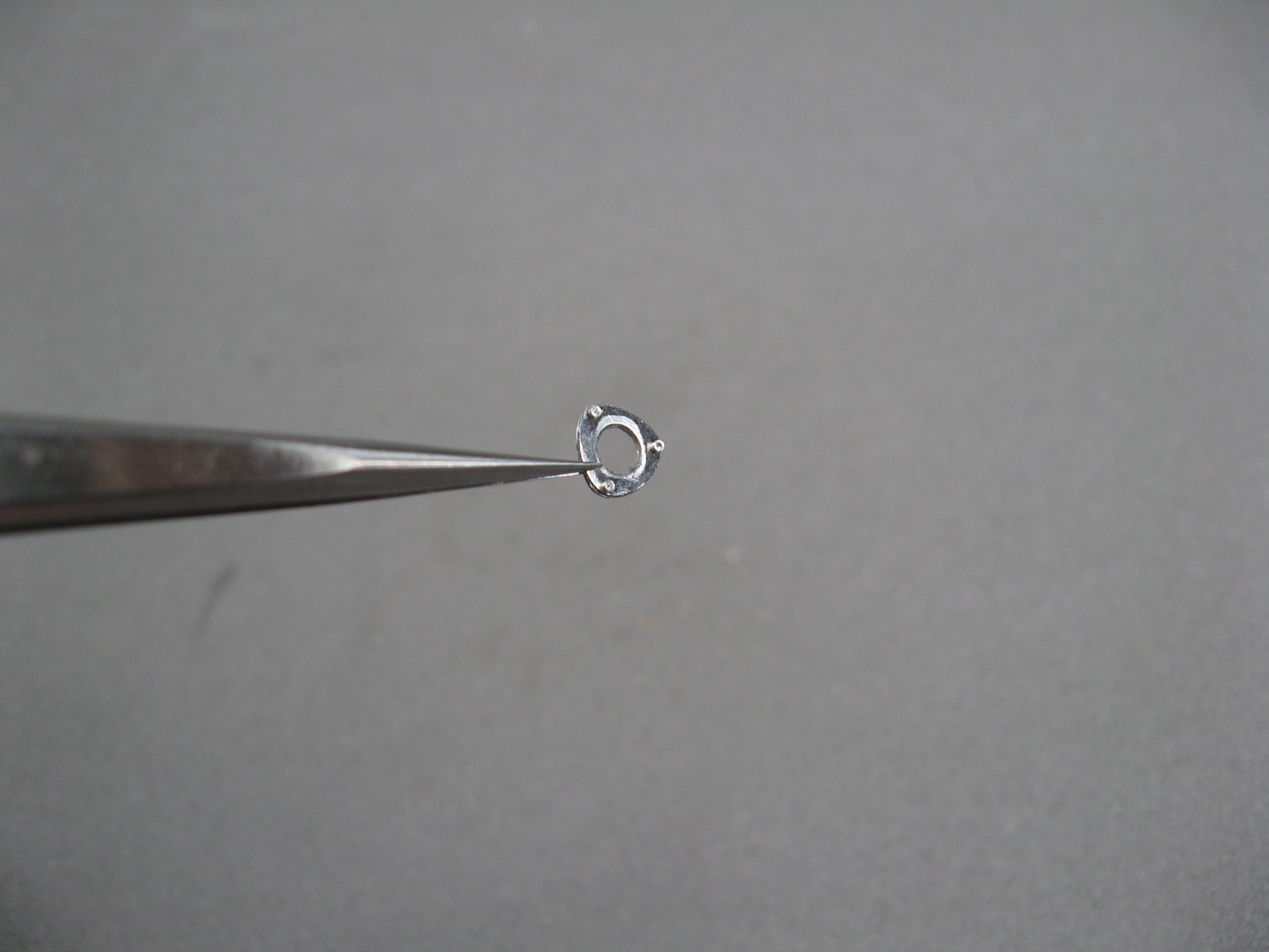

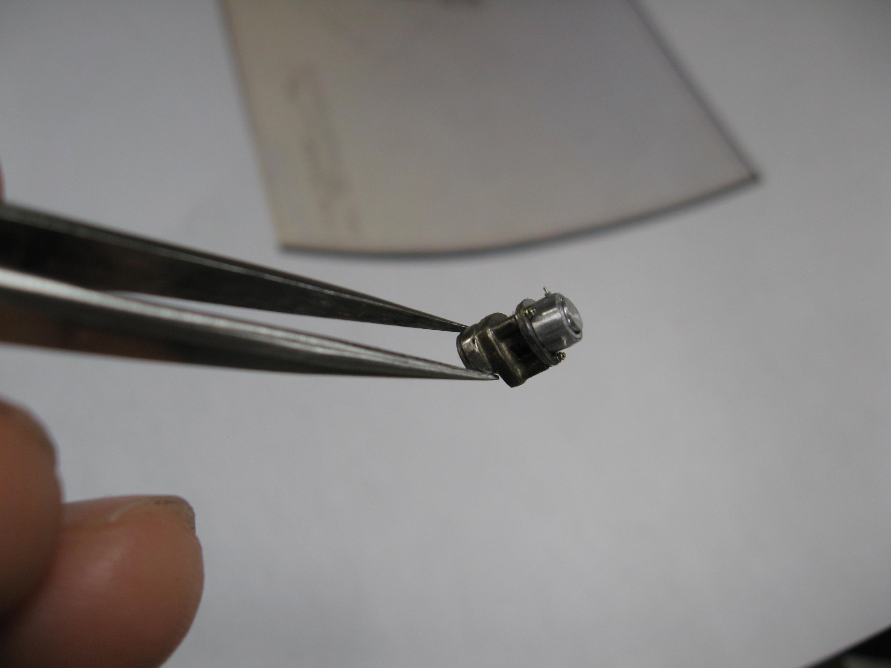

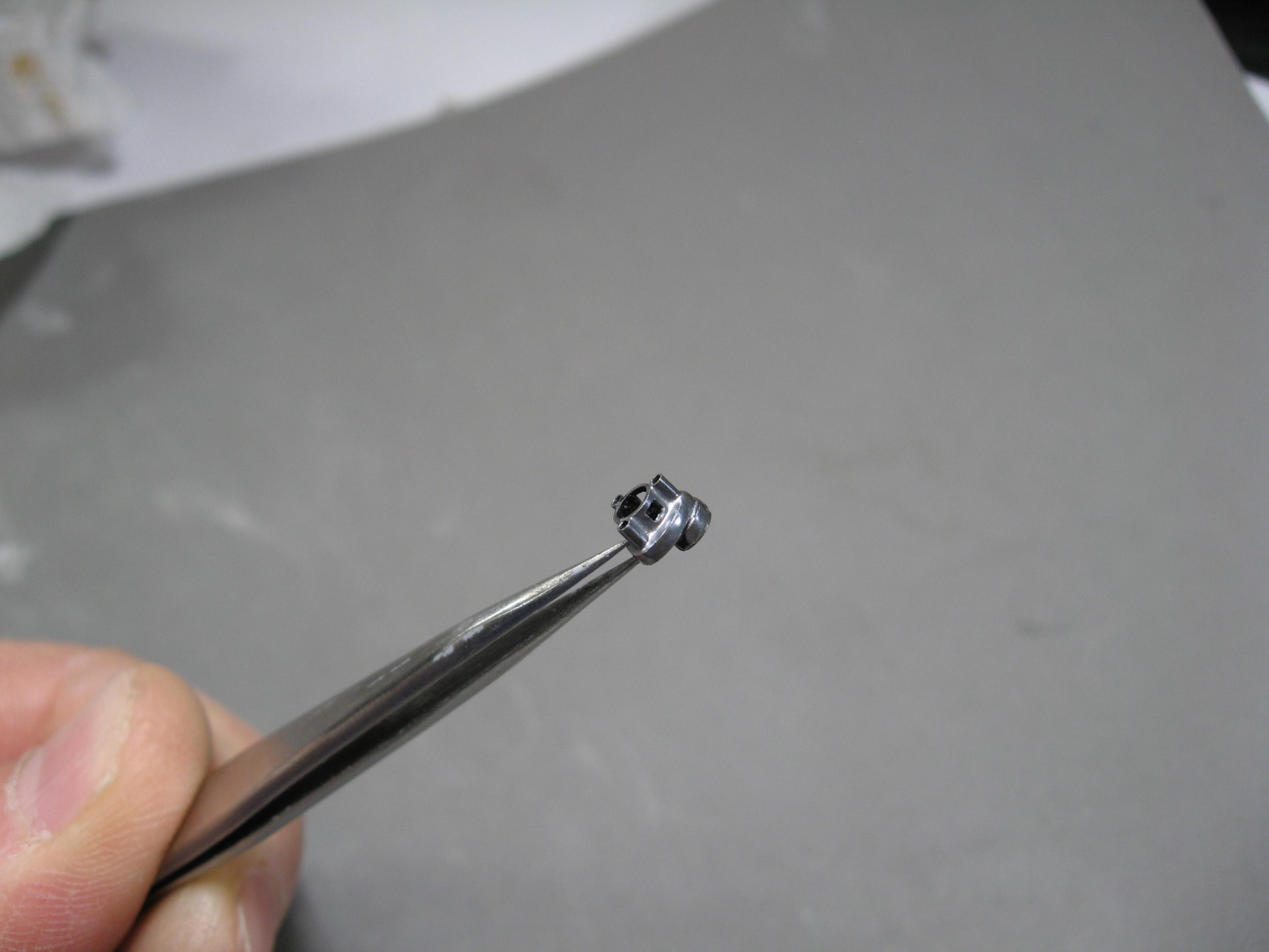

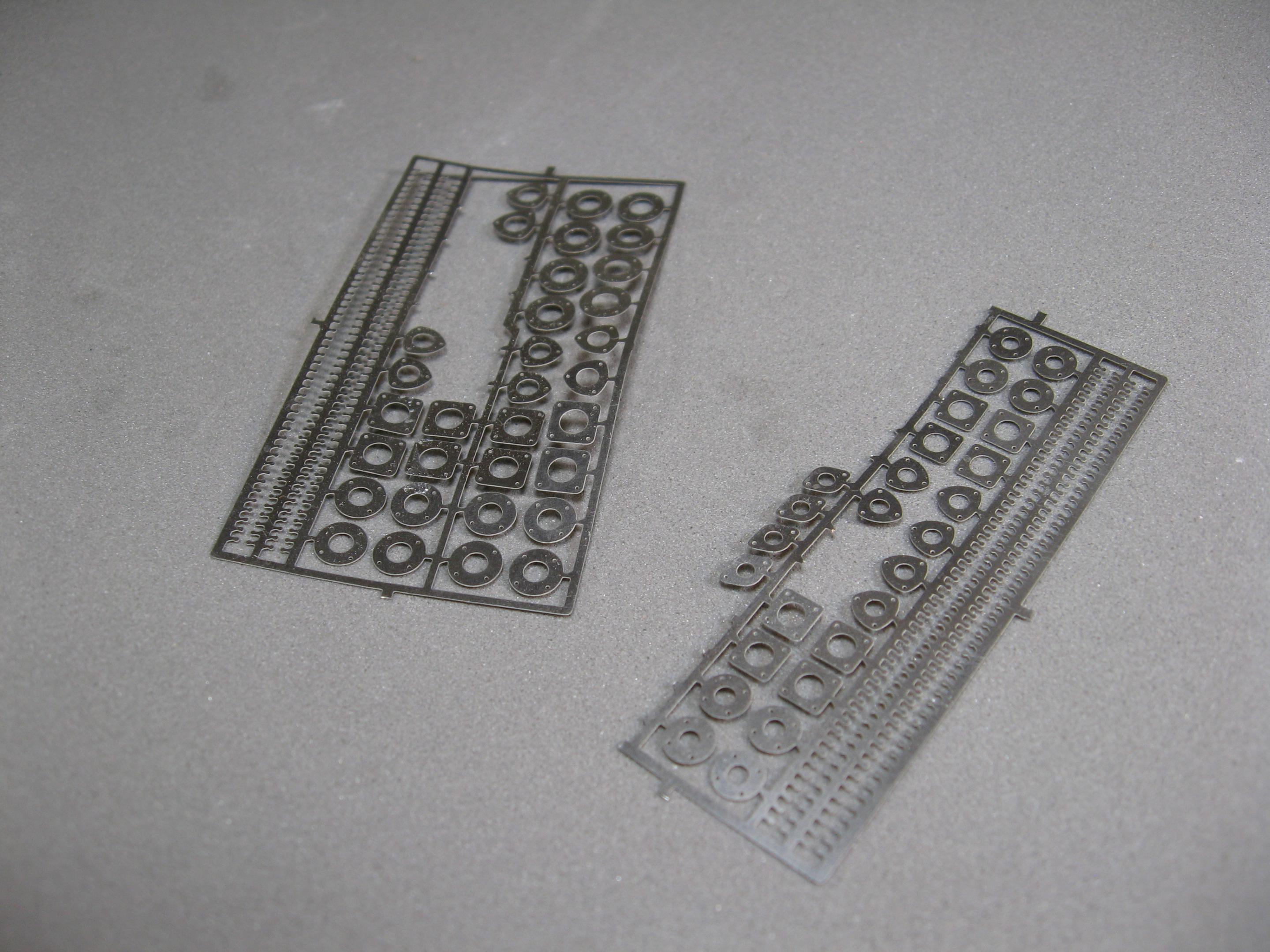

Randy D Posted August 19, 2021 Author Posted August 19, 2021 I use p.e. parts from Detail Masters as guides for scratch building parts. I glue them to white metal or aluminum stock then file to shape.. This has been epoxied together, with some paint it starts to look like a cast part.. more....

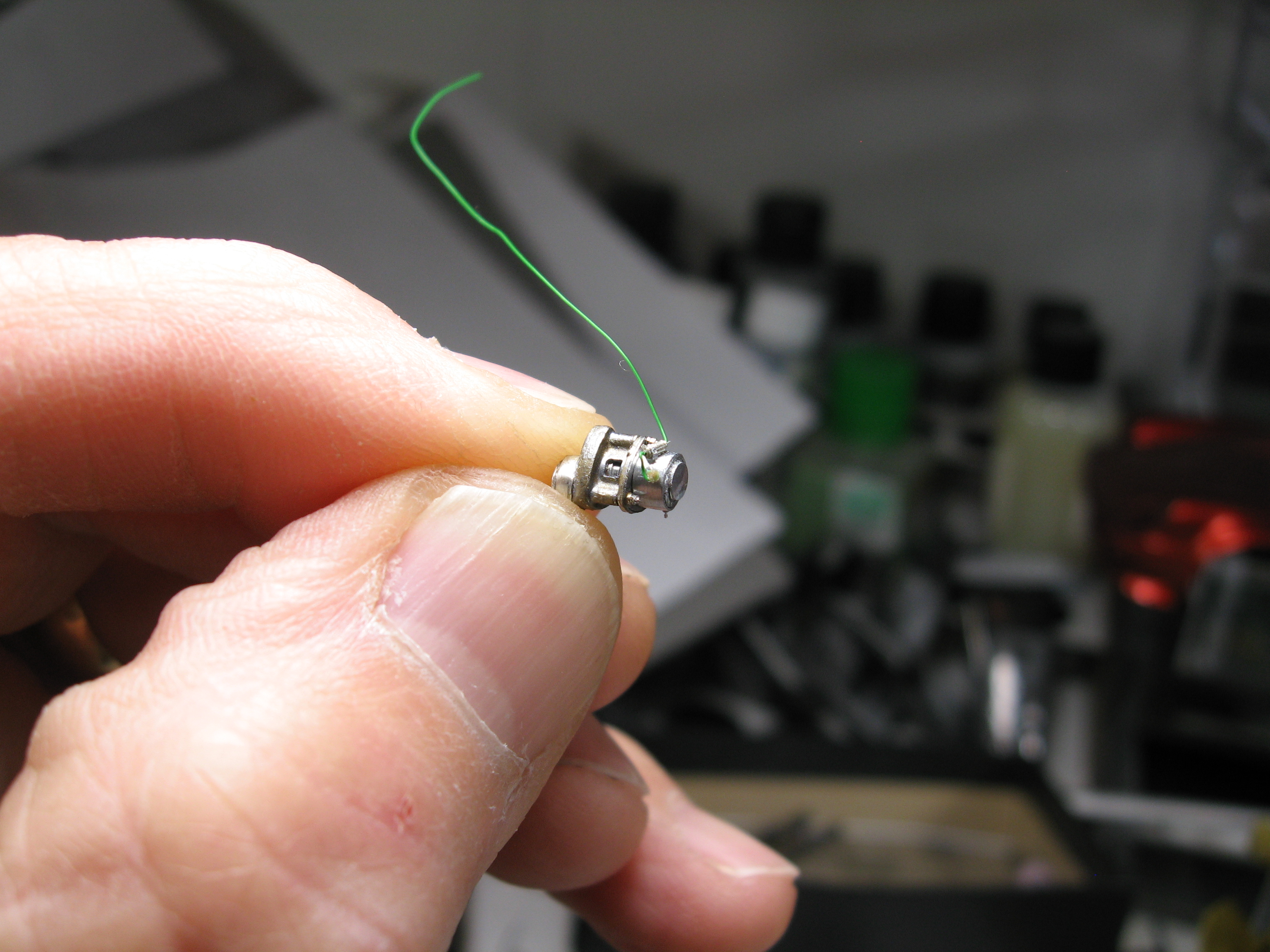

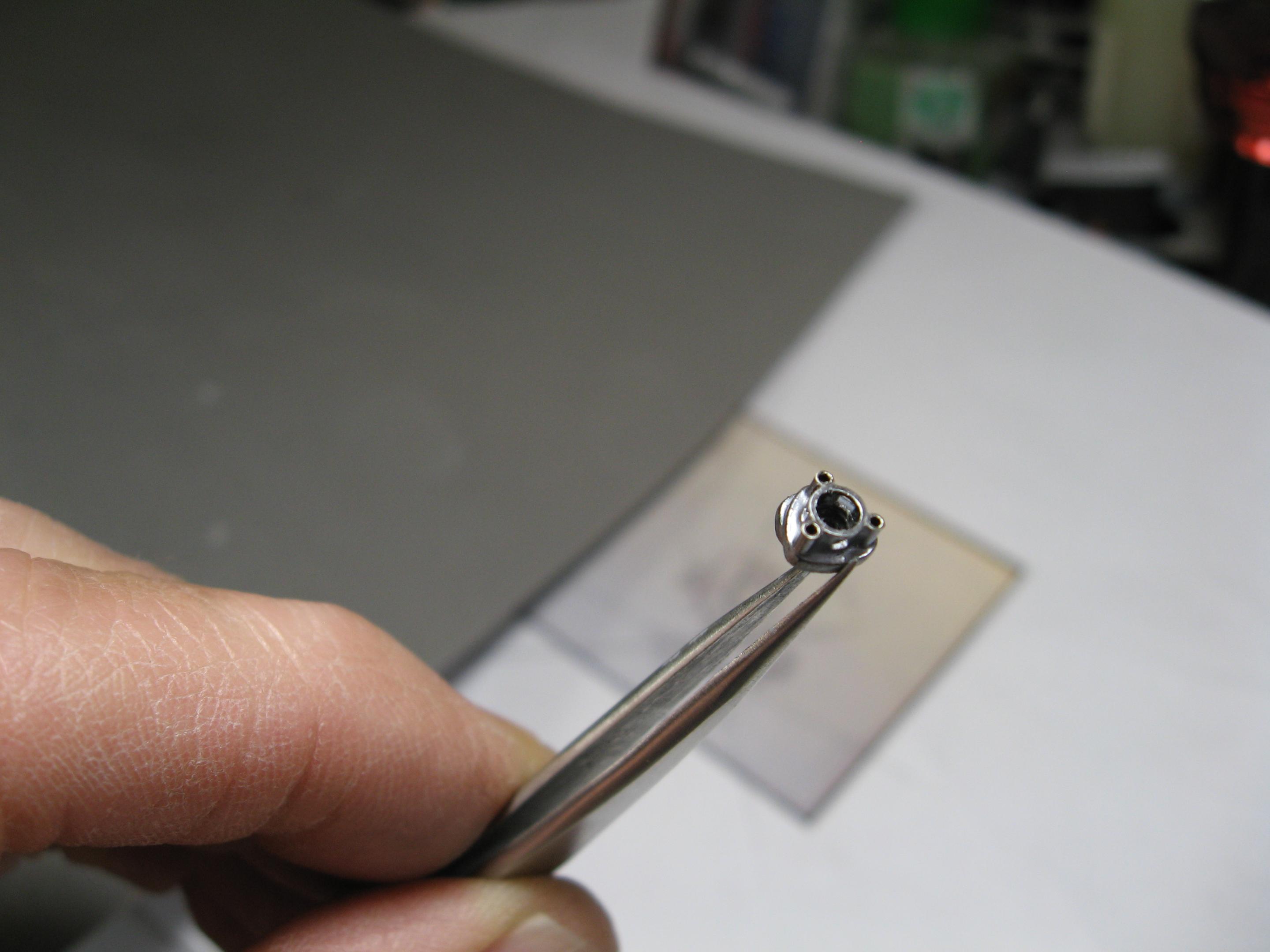

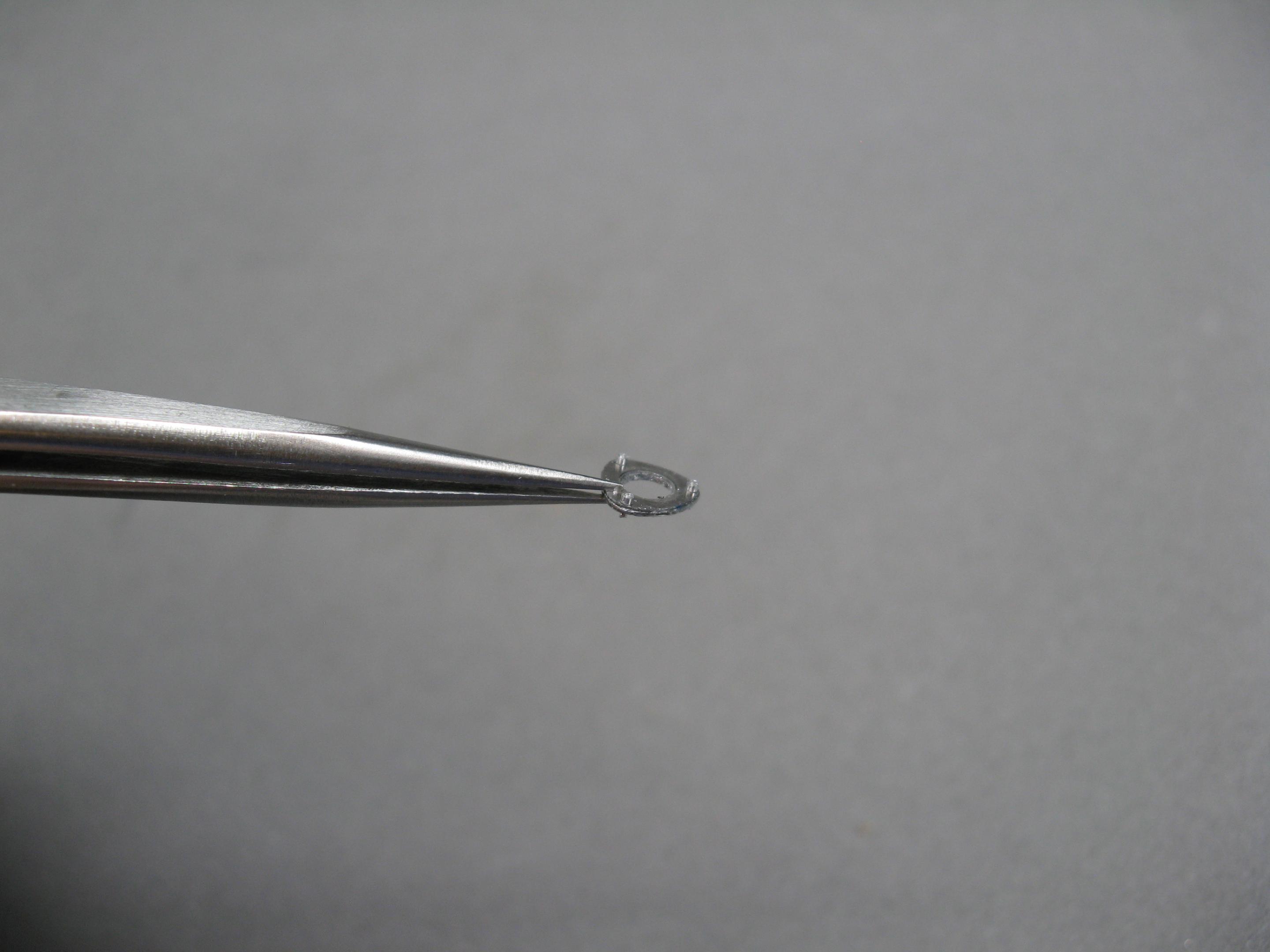

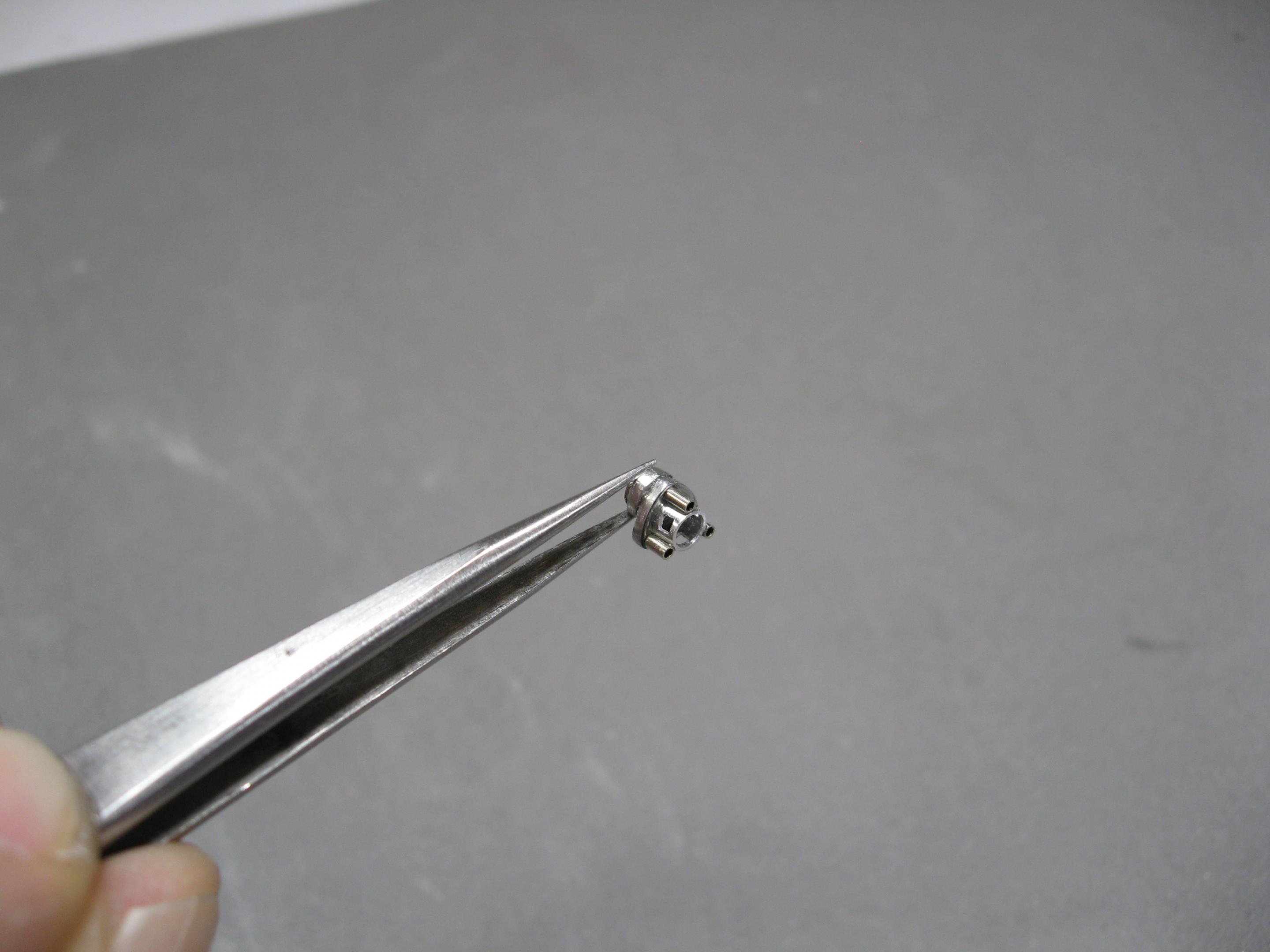

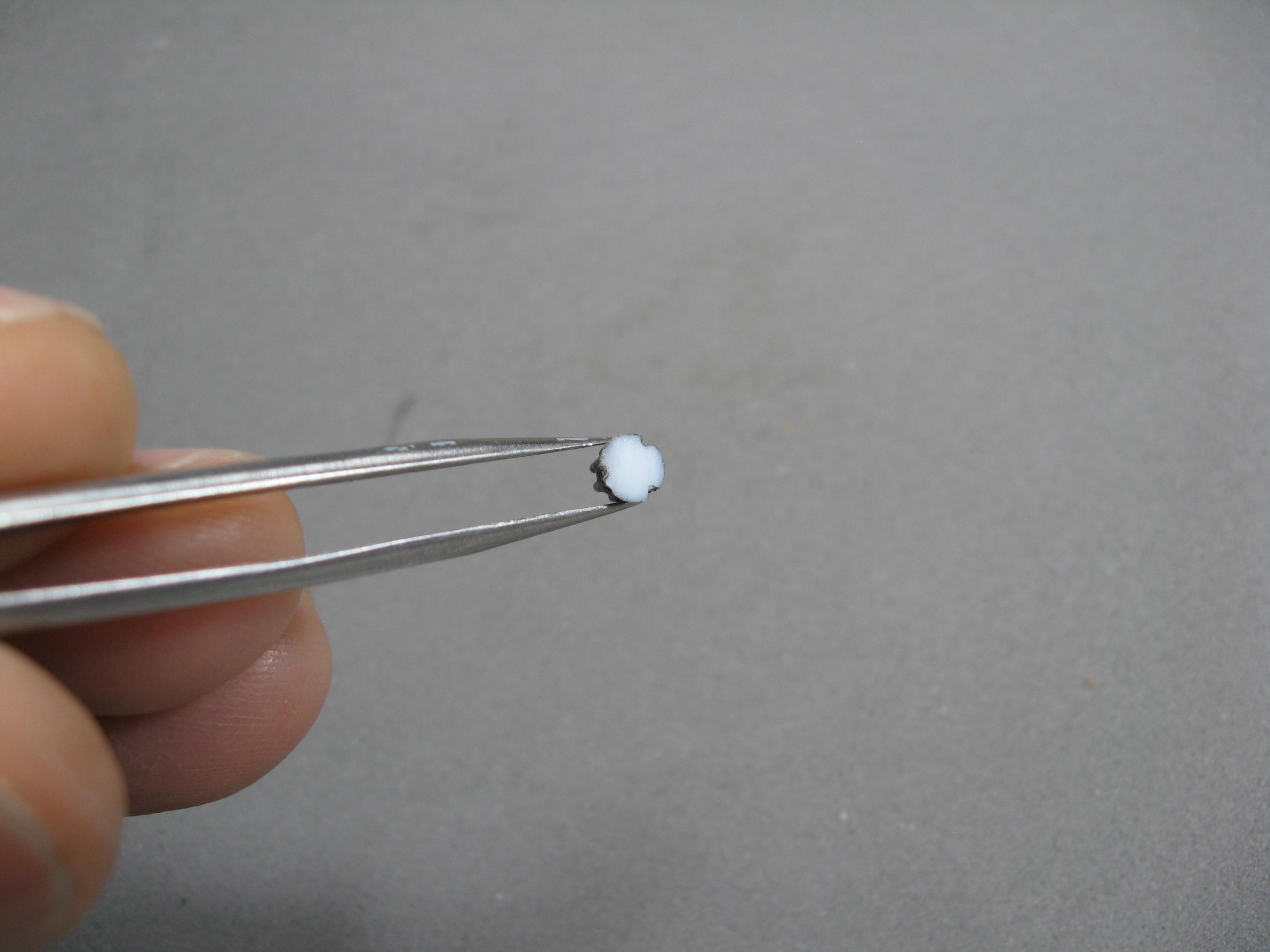

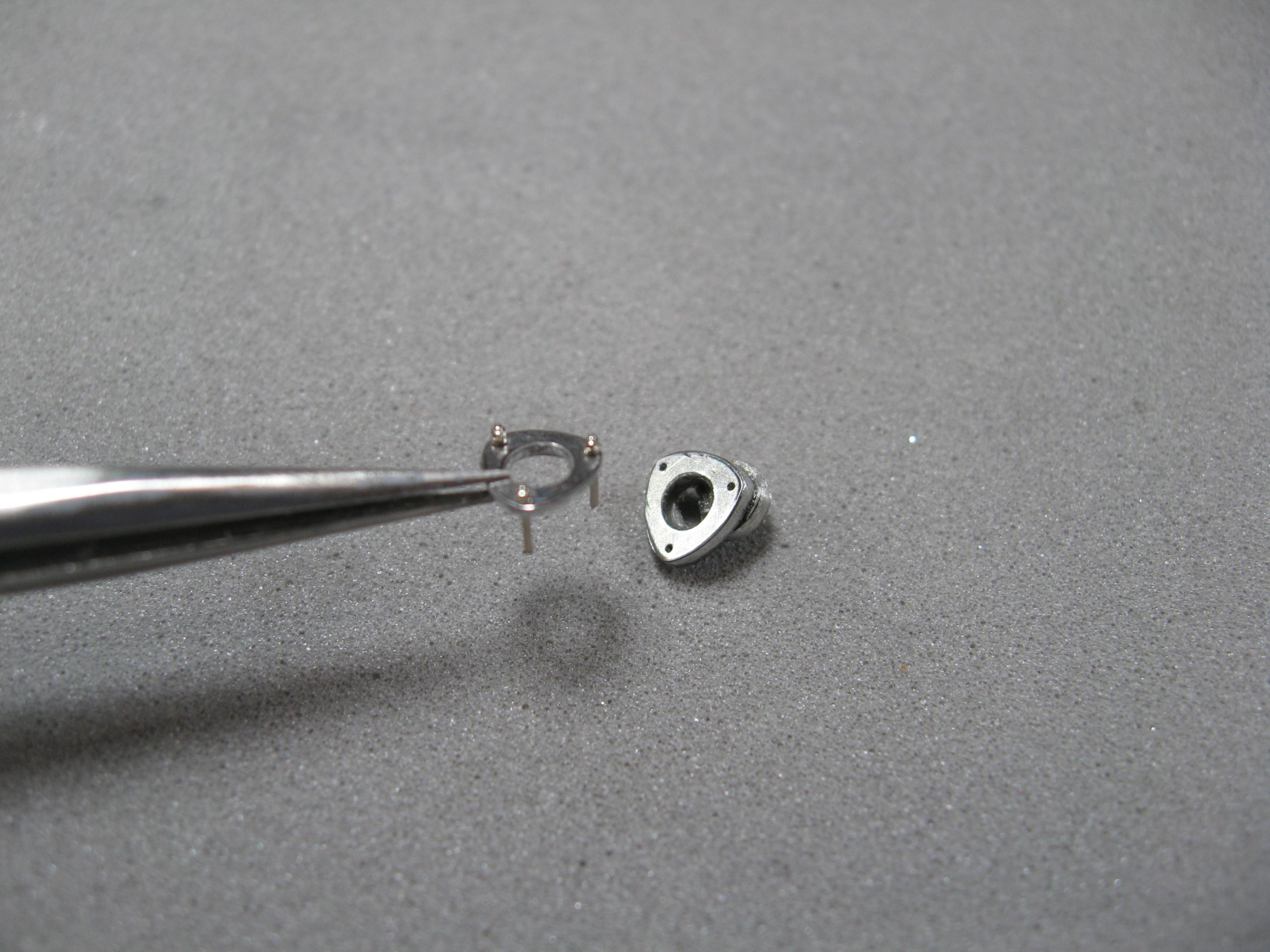

Randy D Posted August 19, 2021 Author Posted August 19, 2021 Building up the body of the dizzy... Base of the cap. A v8 one from the spares bin... more....
