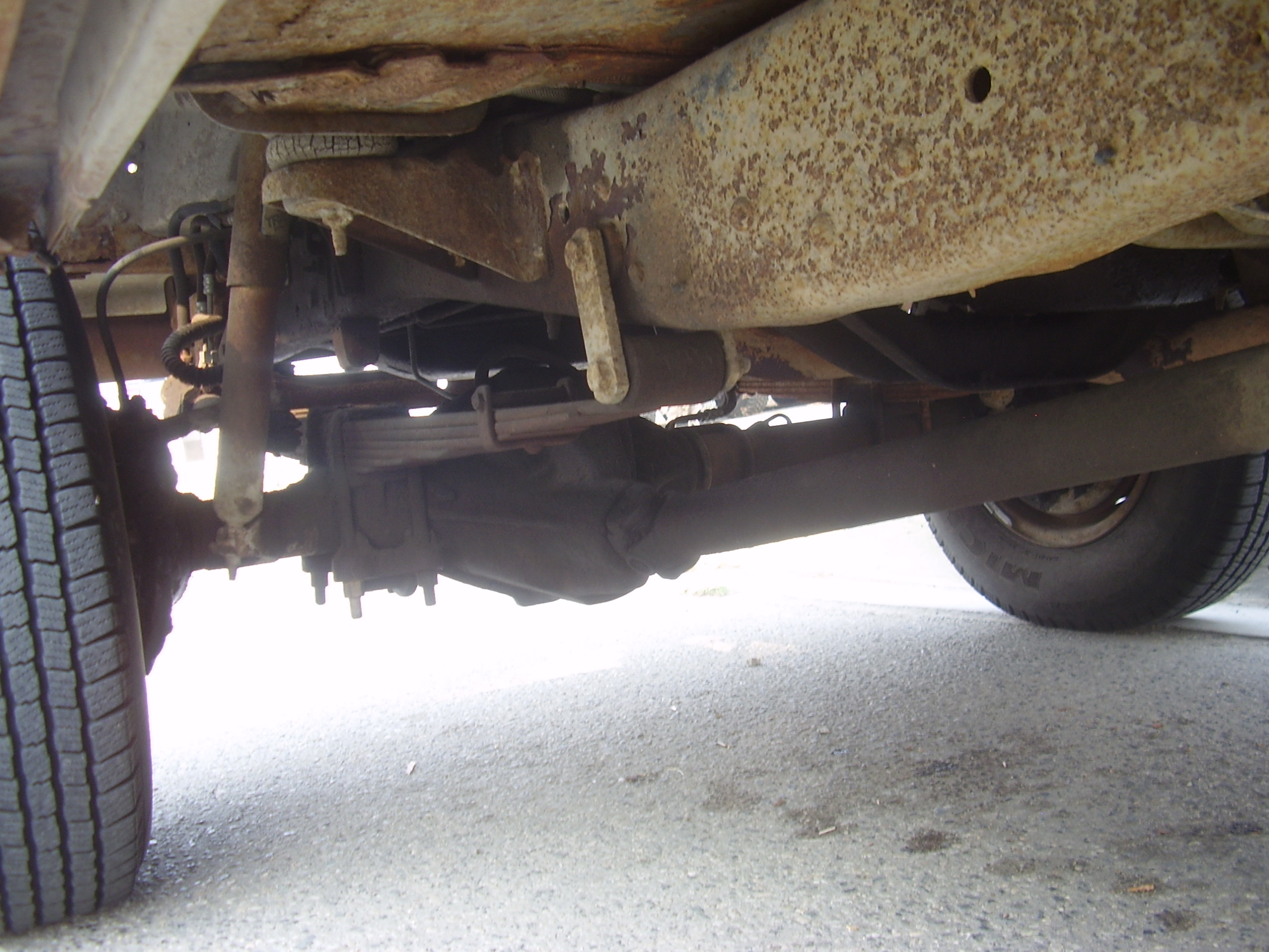

Brutalform Posted August 15, 2018 Share Posted August 15, 2018 Just ordered the 70 F100 4x4. I also ordered 8 lug wheels, tires and hubs from Scenes Unlimited. What else would have to be done to convert this kit into an F250 3/4 ton truck? I never built a p/u before and I ordered this kit before reading this thread not knowing that the kit on the box differs from the actual kit. That pic on that box cover really caught my eye. Maybe just sanding off the emblems, and adding the new wheel set up? Quote Link to comment Share on other sites More sharing options...
Fat Brian Posted August 15, 2018 Share Posted August 15, 2018 4 hours ago, Brutalform said: Just ordered the 70 F100 4x4. I also ordered 8 lug wheels, tires and hubs from Scenes Unlimited. What else would have to be done to convert this kit into an F250 3/4 ton truck? I never built a p/u before and I ordered this kit before reading this thread not knowing that the kit on the box differs from the actual kit. That pic on that box cover really caught my eye. Maybe just sanding off the emblems, and adding the new wheel set up? It looks like the kit has the coil spring F150 front end where the 250 and 350 trucks had leaf spring front ends. Quote Link to comment Share on other sites More sharing options...
mk11 Posted August 16, 2018 Share Posted August 16, 2018 like this.... Quote Link to comment Share on other sites More sharing options...

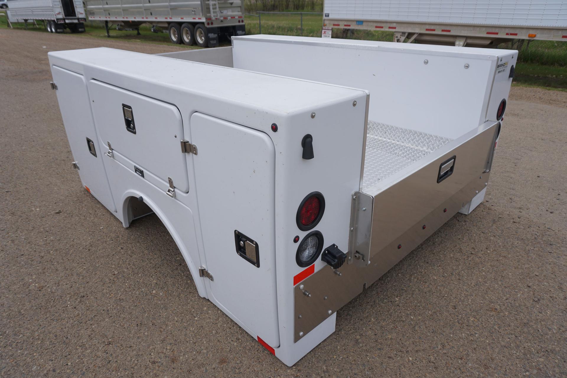

dshue76 Posted August 17, 2018 Share Posted August 17, 2018 (edited) On 3/31/2018 at 7:19 PM, SteveG said: Here's a couple of photos from the DAAM shop display last Sunday. There are no plans for a 8" Flareside bed at this time. Maybe one of the resin caster will step up and fill the gap finally. This is the Utility bed I mentioned. Anyone recognize a brand ? Could be a Reading but I don't know for sure. -Steve 3 I NEED this bed, it will be so simple for me to modify that into a copy of the Northwest (astoria) body on my 1:1 2002 F250. Edited August 17, 2018 by dshue76 Quote Link to comment Share on other sites More sharing options...
Luc Janssens Posted August 17, 2018 Share Posted August 17, 2018 22 minutes ago, dshue76 said: I NEED this bed, it will be so simple for me to modify that into a copy of the Northwest (astoria) body on my 1:1 2002 F250. One needs dual rear wheels for such a utility bed no? Quote Link to comment Share on other sites More sharing options...
Jordan White Posted August 17, 2018 Share Posted August 17, 2018 1 hour ago, Luc Janssens said: One needs dual rear wheels for such a utility bed no? Nope, there are SRW utility bodies. Quote Link to comment Share on other sites More sharing options...
dshue76 Posted August 18, 2018 Share Posted August 18, 2018 5 hours ago, Luc Janssens said: One needs dual rear wheels for such a utility bed no? No sir, there are plenty of single rear wheel trucks with utility beds. The bed in the original post is built to go on an F-100. A bed for a dual rear wheel truck has deeper toolboxes. Quote Link to comment Share on other sites More sharing options...
dshue76 Posted August 18, 2018 Share Posted August 18, 2018 This is what I would use that bed as a base for. Quote Link to comment Share on other sites More sharing options...

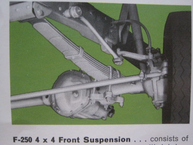

leafsprings Posted September 1, 2018 Share Posted September 1, 2018 On 4/18/2018 at 5:50 PM, leafsprings said: I actually love the truck on the cover, a no nonsense base model "Custom" F 250 4x4 I was planning on converting the new F 100 4x4 to an F 250 4x4 (my personnel preference). Kit is available. Here is another shot of what is involved on the F 250 conversion, the rear end requires a Dana 60 which is available in aftermarket. Quote Link to comment Share on other sites More sharing options...

mk11 Posted September 3, 2018 Share Posted September 3, 2018 12 hours ago, mikemodeler said: First resin supplier to tool up a conversion kit to take the Moebius F-100 4x4 to a F-250 or F-350 4x4 gets my money. I have the 8 lug wheels and tires already from Scenes Unlimited. The extra set of leaf springs in the amt Stones 4x4 could work for the front axle and the dana 60 rear axle from the same kit completes the conversion. mike Quote Link to comment Share on other sites More sharing options...
leafsprings Posted September 8, 2018 Share Posted September 8, 2018 On 9/2/2018 at 10:12 PM, mk11 said: The extra set of leaf springs in the amt Stones 4x4 could work for the front axle and the dana 60 rear axle from the same kit completes the conversion. Great info mk11, we all probably already have one of these amt frankensteins. Quote Link to comment Share on other sites More sharing options...
