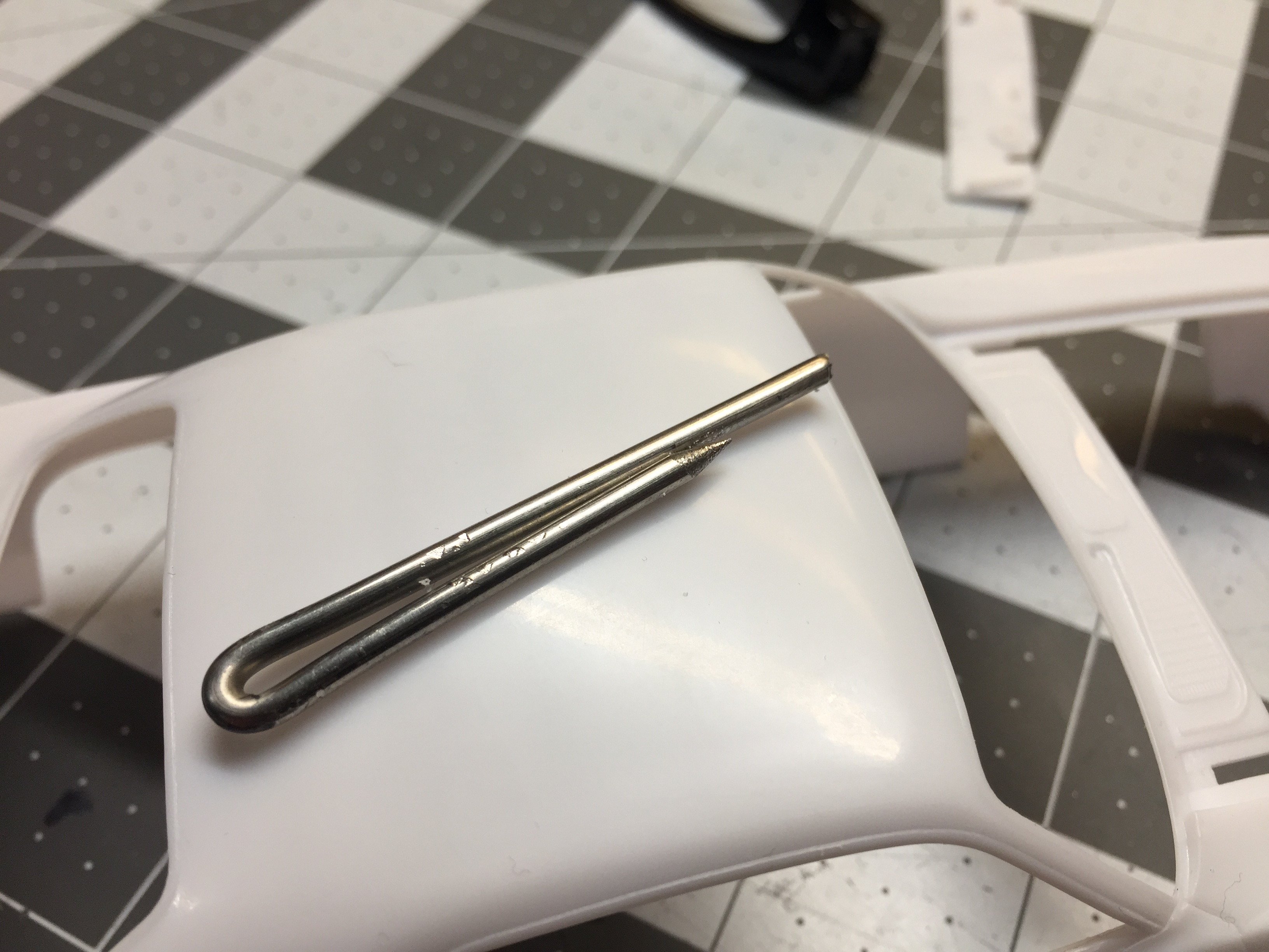

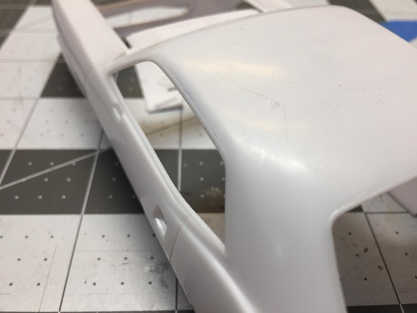

NOBLNG Posted February 28, 2019 Posted February 28, 2019 This Revell Hemi Cuda has extremely un-defined creases where the trim around the windows meets the body. I would like just a little crease to guide my knife later when I try to foil it, (I have seen the tip on using masking tape as a guide) but this trim is almost non existent. I have made this prototype tool to scribe a consistent groove around most of the openings. the rest I will have to freehand. It is a piece of 3/32" tungsten taped to a piece of 1/4" dowel. The test was successful so I will make a better one with a metal dowel. The tungsten (even a piece of coat hanger would work) could be ground to accommodate different trim widths. 3

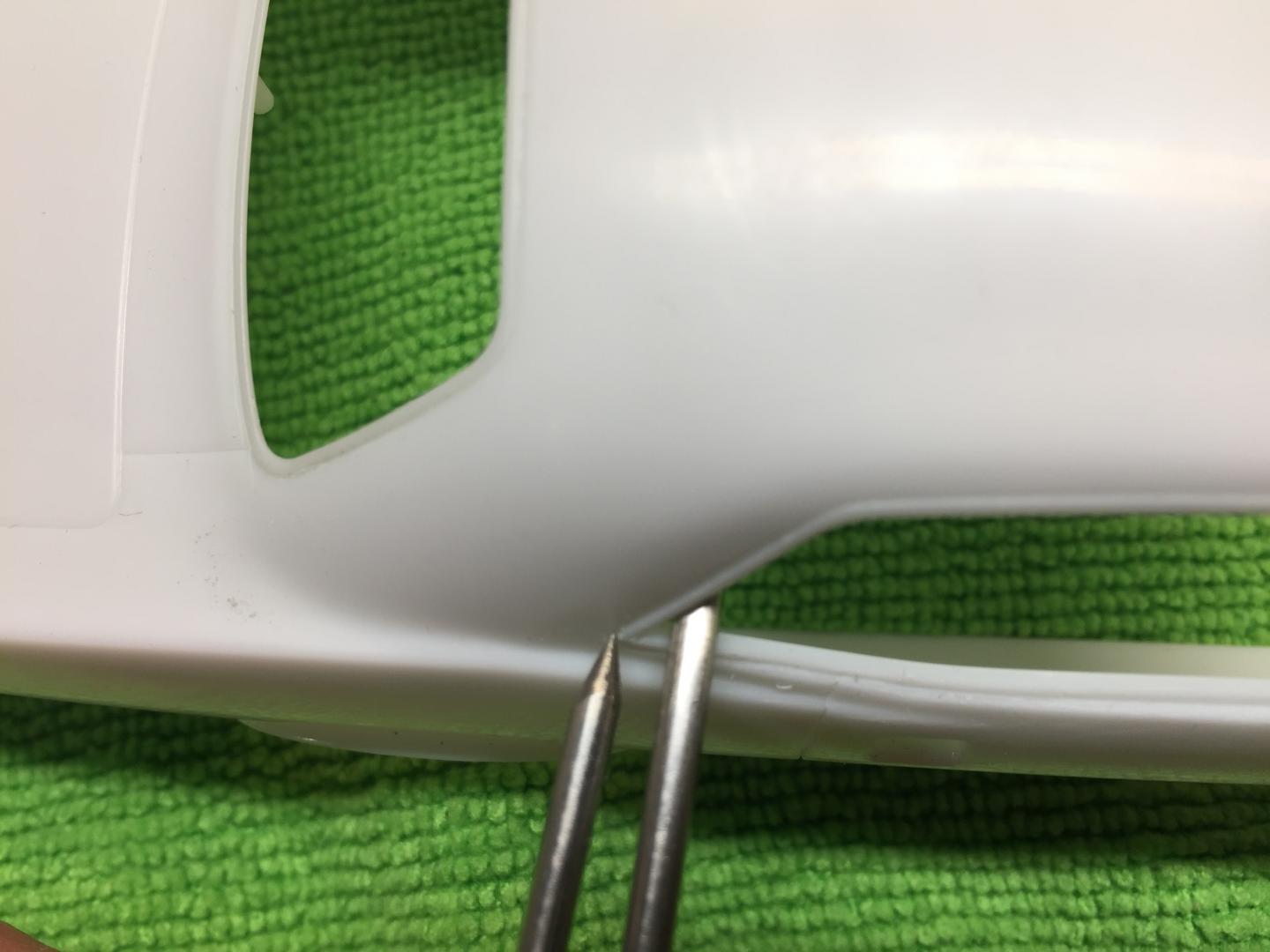

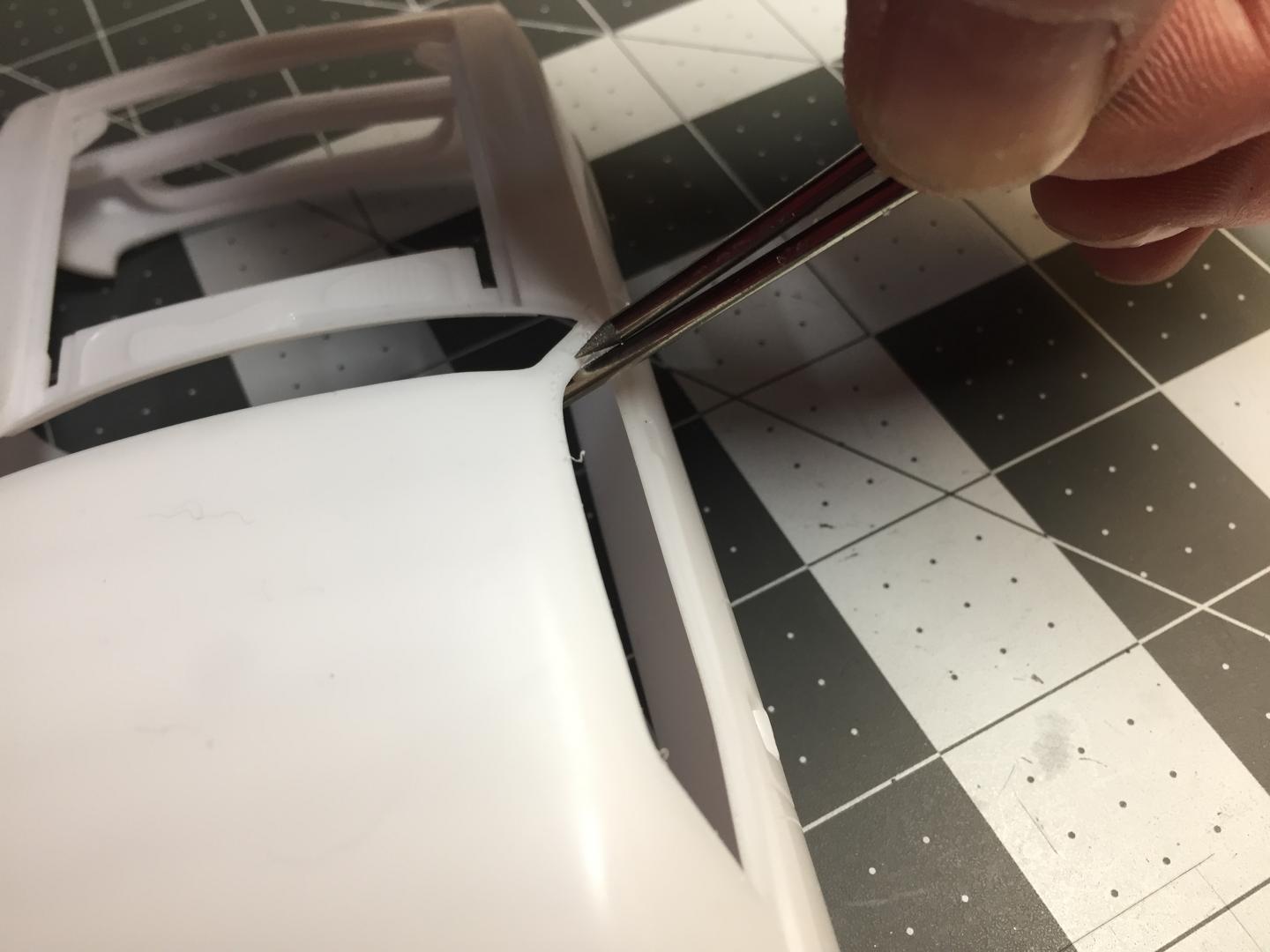

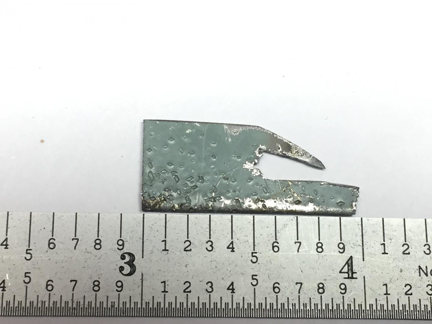

NOBLNG Posted March 1, 2019 Author Posted March 1, 2019 (edited) I've revised this tool. This version is sturdier and gets a lot farther into the corners than the prototype did. It can be easily spread apart to get a wider scribe. Rotating the tool off 90 degrees also changes the width! This is 3/32" stainless welding rod, but I think any stiff wire would work. Edited March 1, 2019 by NOBLNG 2 1

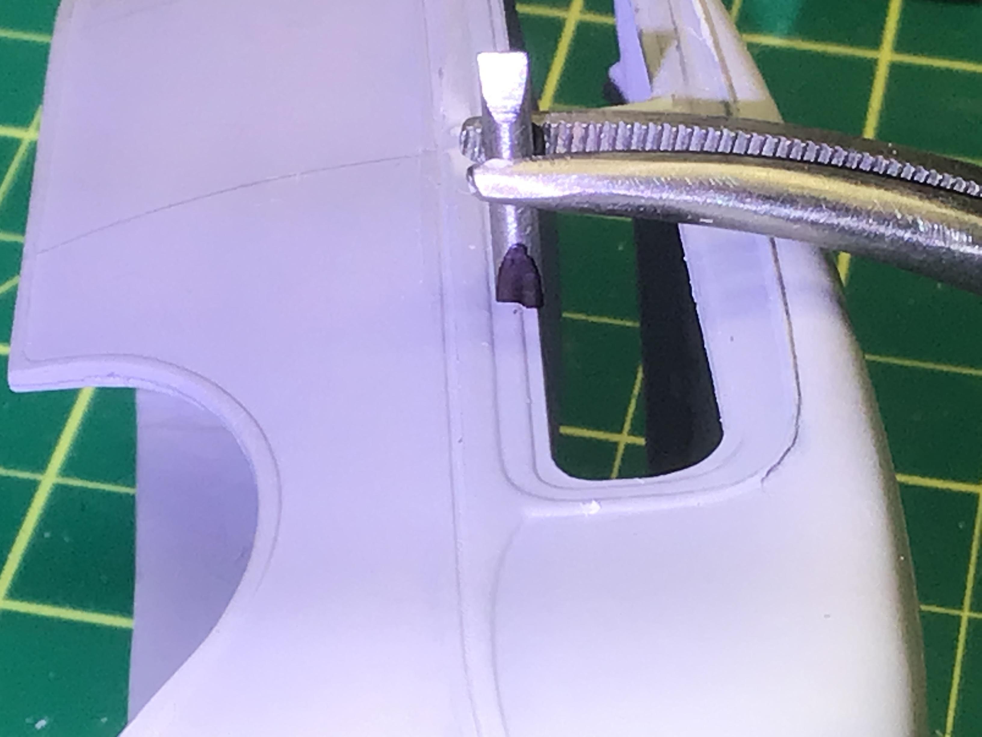

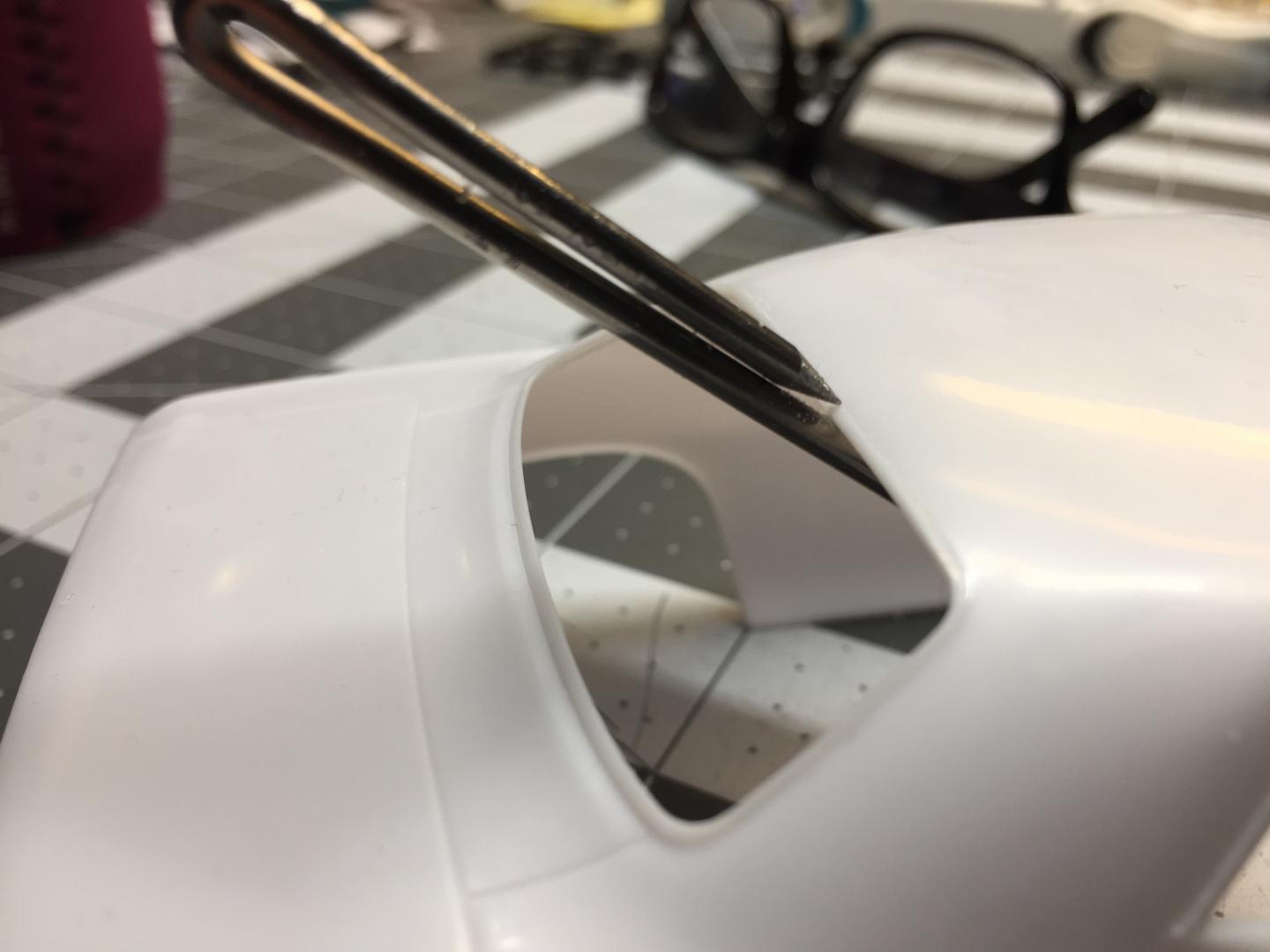

NOBLNG Posted March 1, 2019 Author Posted March 1, 2019 (edited) Spreading the tip a bit lets me get all the way into the sharpest corners! I first sharpened this to a needle point, but it dug in a little too aggressively, so I dulled the point a bit with a file. Edited March 1, 2019 by NOBLNG 3

Tommy124 Posted March 1, 2019 Posted March 1, 2019 (edited) 9 hours ago, NOBLNG said: Rotating the tool off 90 degrees also changes the width! This is 3/32" stainless welding rod, but I think any stiff wire would work. Great idea, thanks for sharing. Am I wrong is assuming that basically a nail in the right size would do aswell? Imho this tool is required only to do the initial scribing, after that the panels can be deepened using the usual tools such as scribers, exacto blade etc.? Edited March 1, 2019 by Tommy124

NOBLNG Posted March 1, 2019 Author Posted March 1, 2019 (edited) 3 hours ago, Tommy124 said: Great idea, thanks for sharing. Am I wrong is assuming that basically a nail in the right size would do aswell? Imho this tool is required only to do the initial scribing, after that the panels can be deepened using the usual tools such as scribers, exacto blade etc.? Yeah, a nail, coat hanger, brass rod... pretty much anything that is harder than plastic. Just chuck it in a drill and sharpen it before bending. Once you get the line established you can use any tool you like. Edited March 1, 2019 by NOBLNG 1

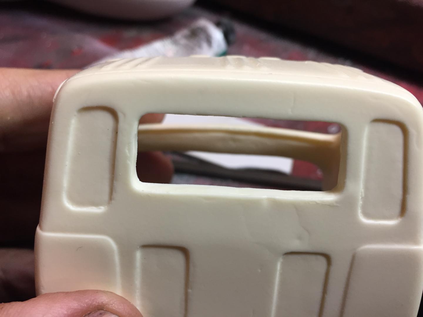

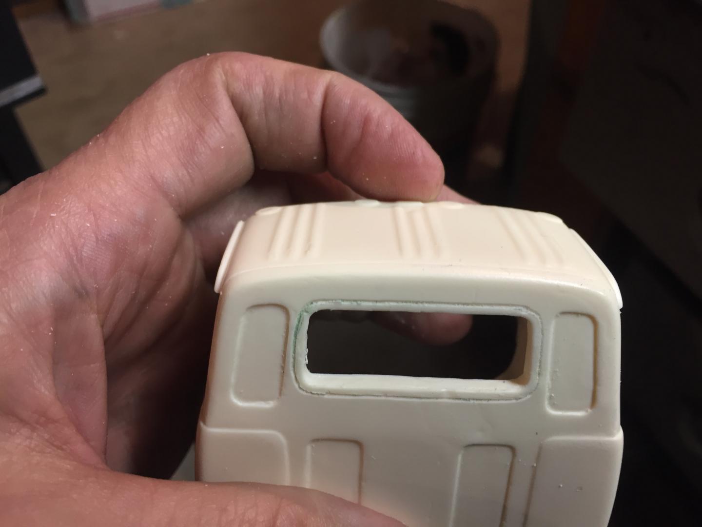

redneckrigger Posted March 2, 2019 Posted March 2, 2019 Had a similar issue recently with a resin truck cab, which had no trim line around the windows to show the rubber gasket. Thought up this tool in the middle of the night and made it the next day. Works superbly. Two completely different people with the same need coming up with an almost identical tool.......awesome! 2

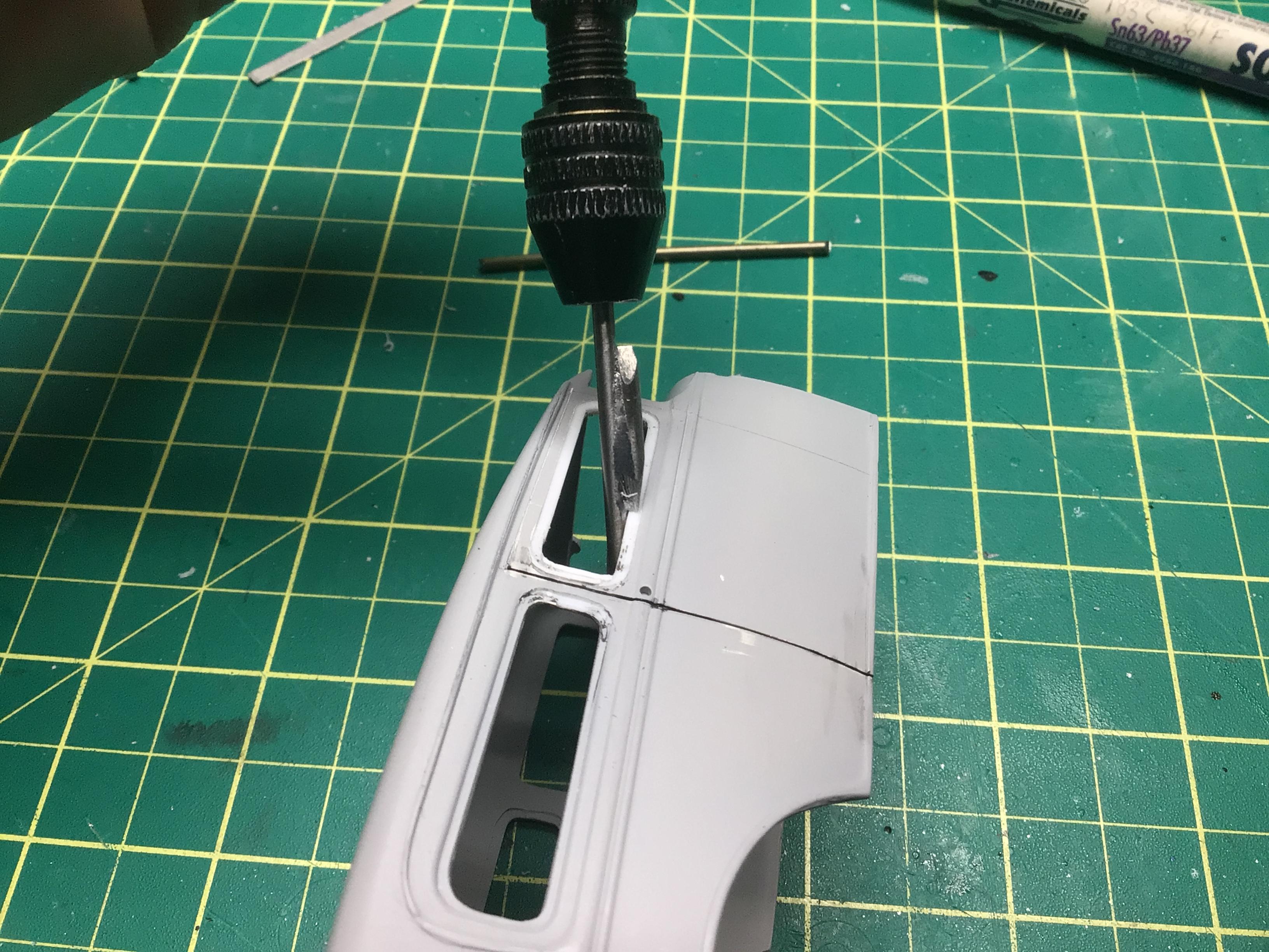

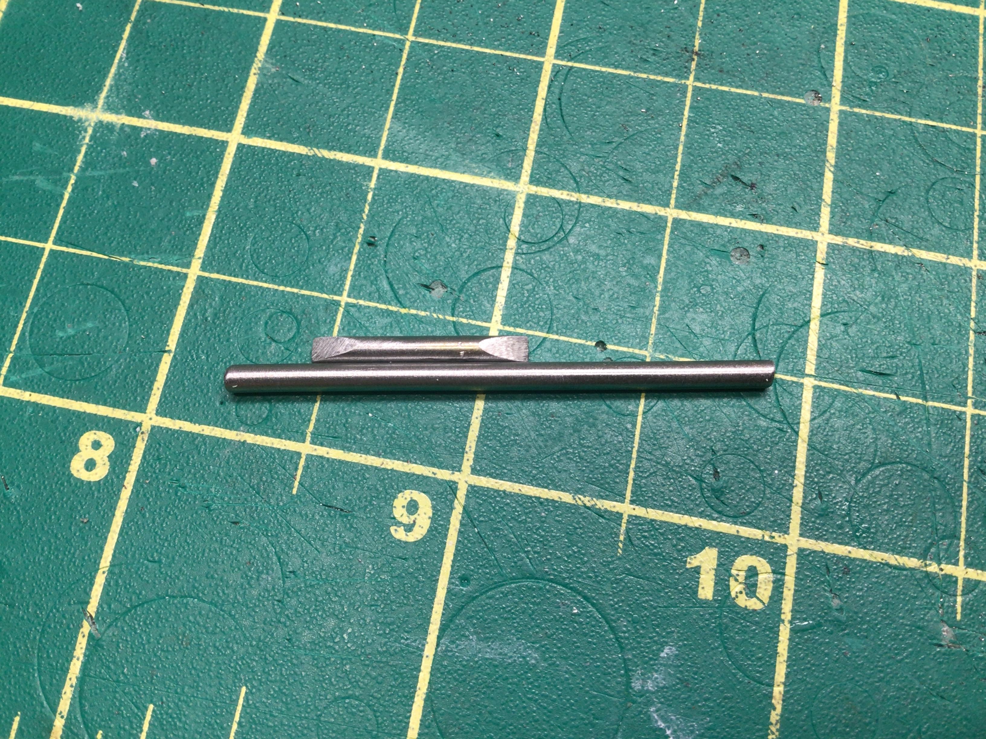

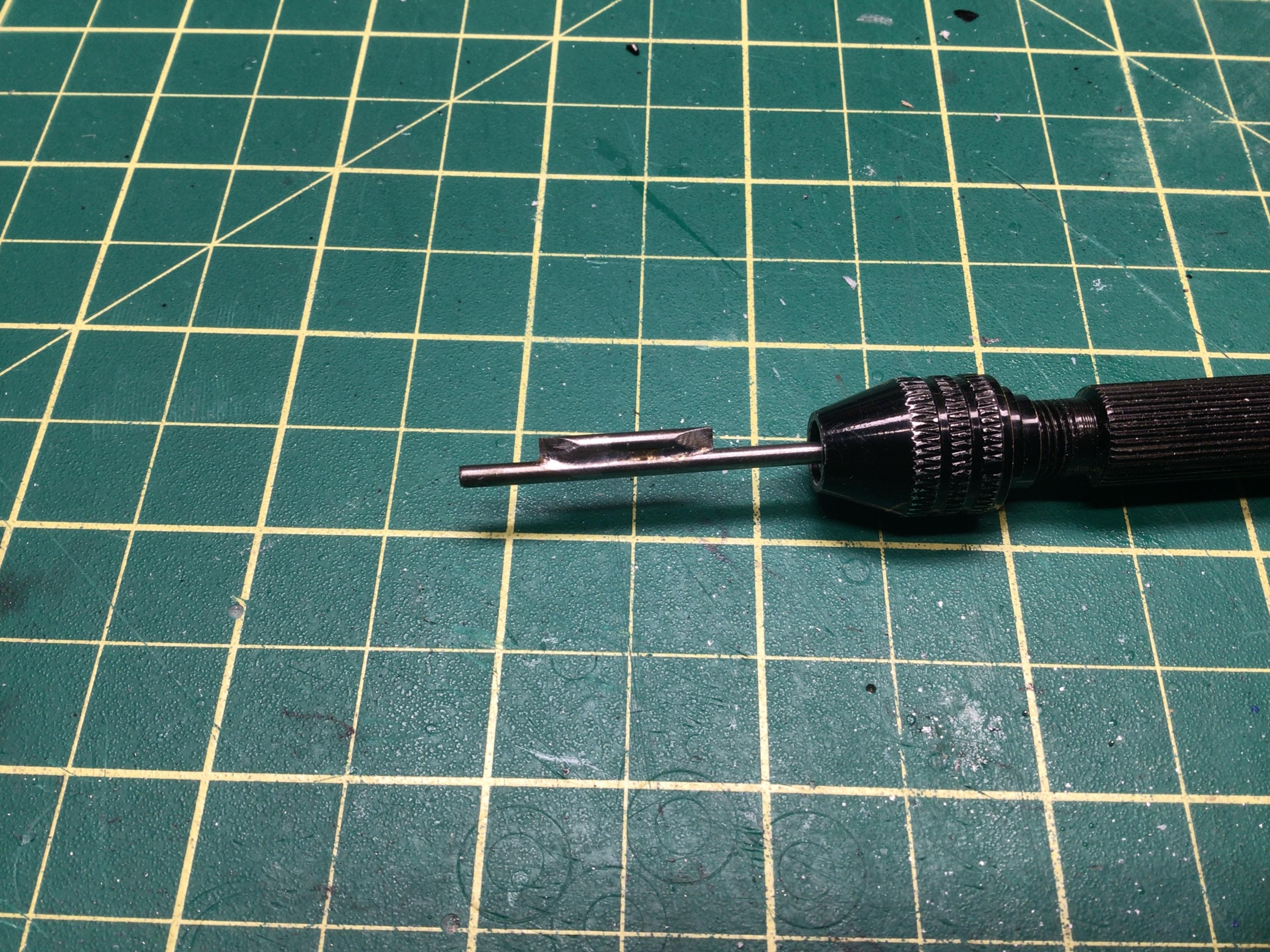

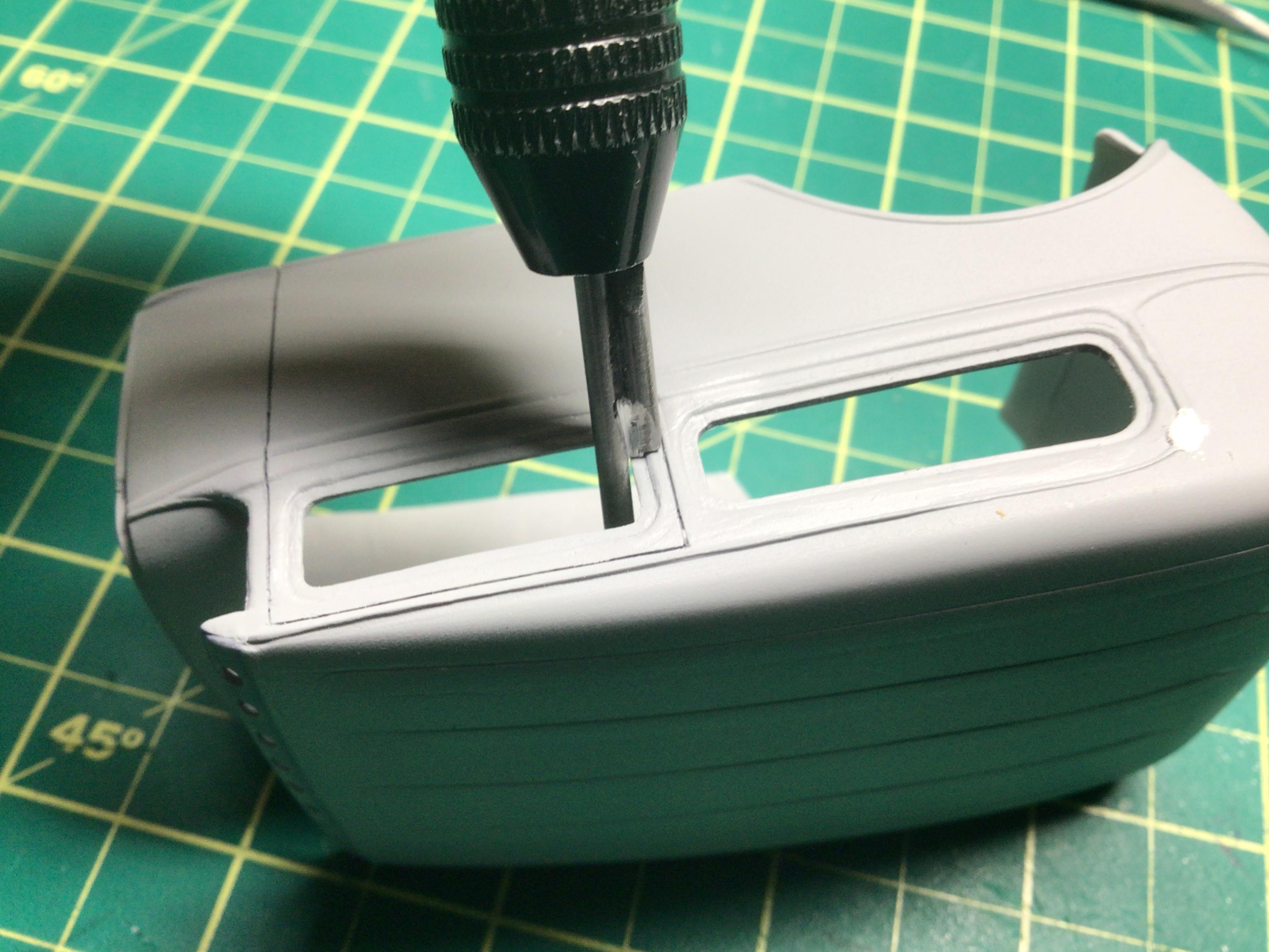

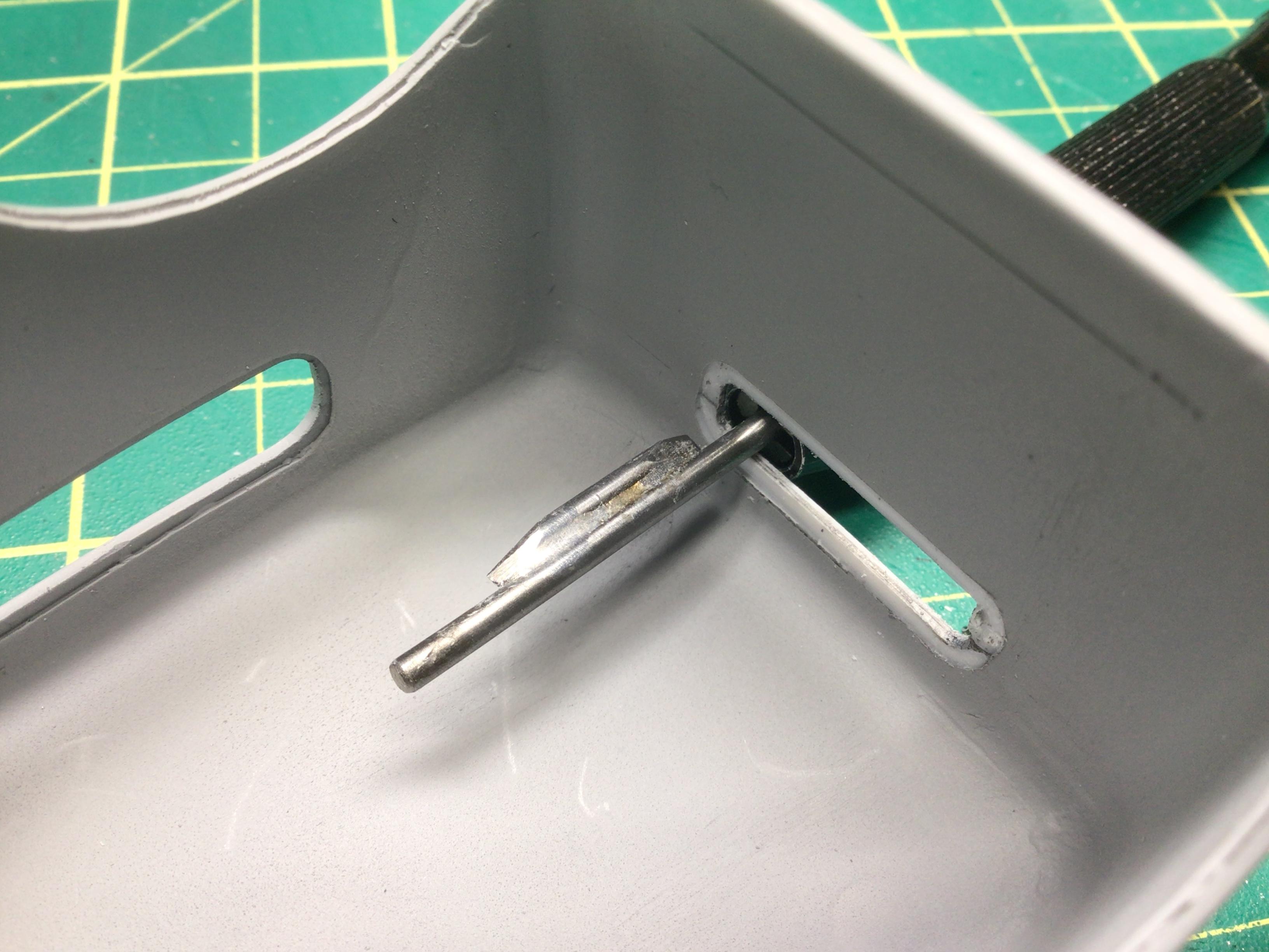

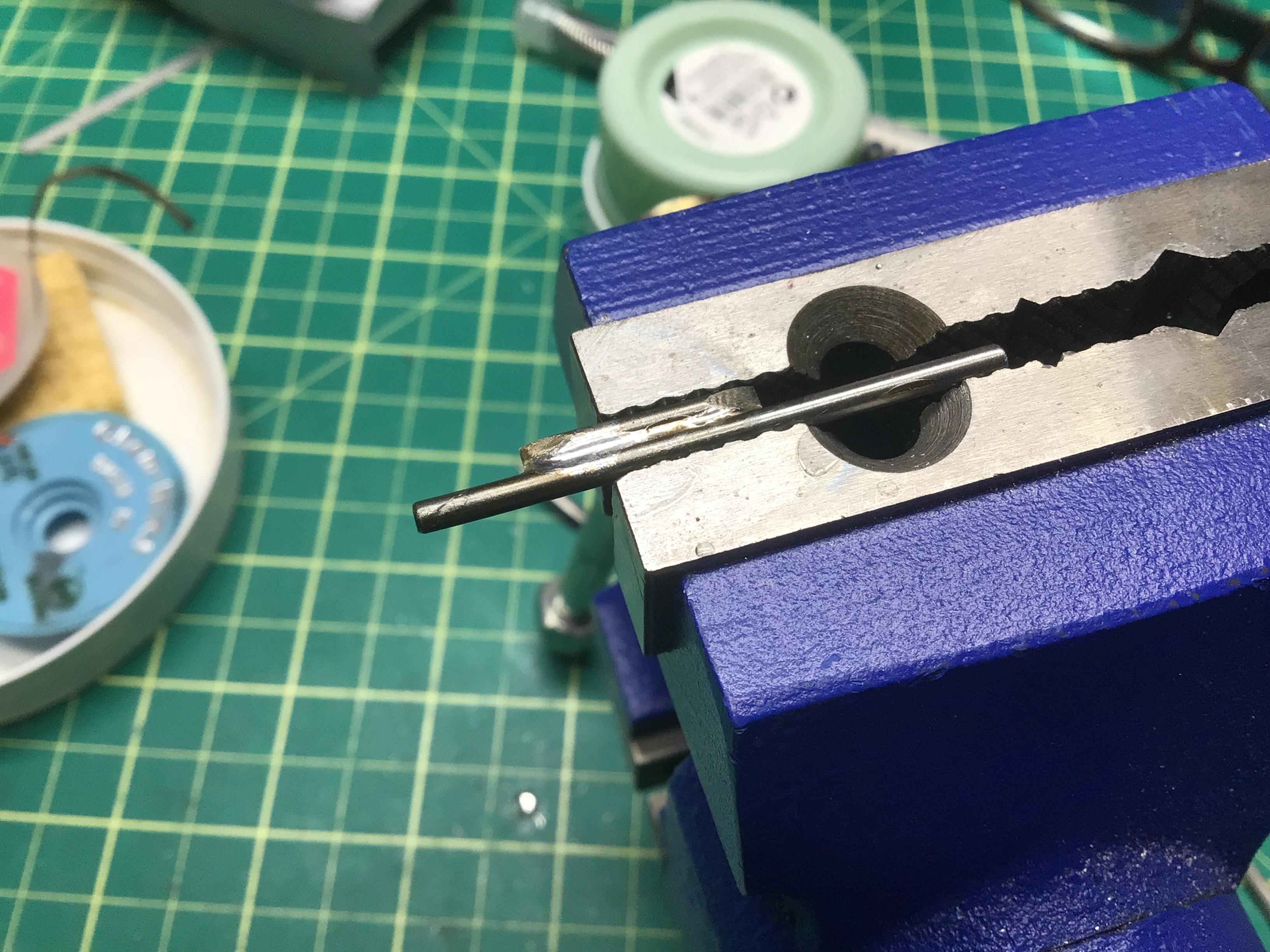

NOBLNG Posted October 27, 2024 Author Posted October 27, 2024 (edited) I have sharpened the trim scriber to a chisel point and used it to scrape a relief for window glass and posted it somewhere on here before I’m sure. But this is an easy upgrade. I took a short piece of coat hanger wire and sharpened it on both ends to a chisel point. Then soldered it to another piece of coat hanger. Now it can be chucked in a pin vise and used as an inside scraper or an outside scraper. Being chucked in a pin vise makes it far easier to handle. The width and profile can be filed to suit your needs.? Edited October 27, 2024 by NOBLNG 6
