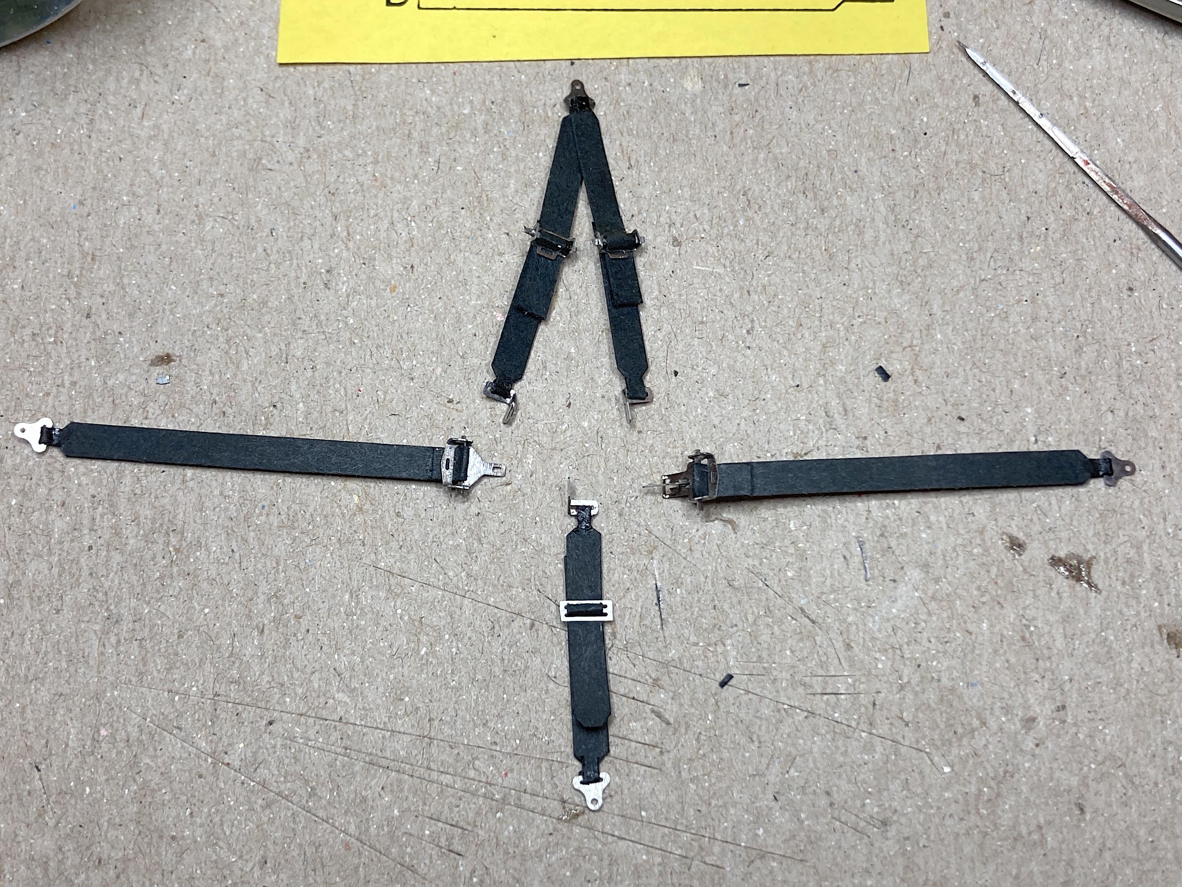

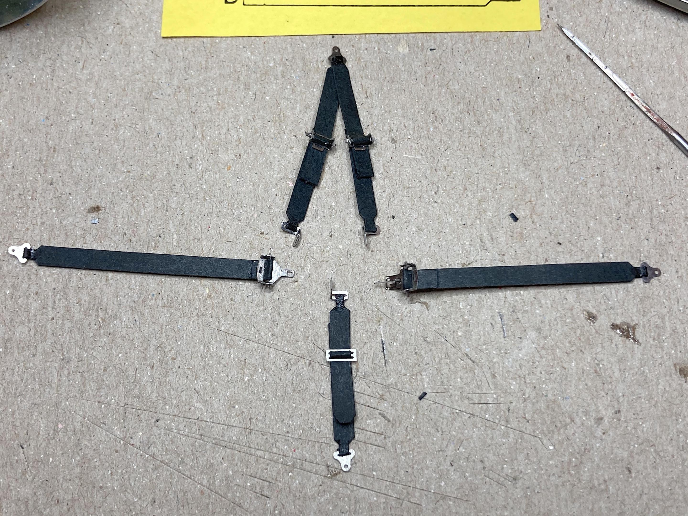

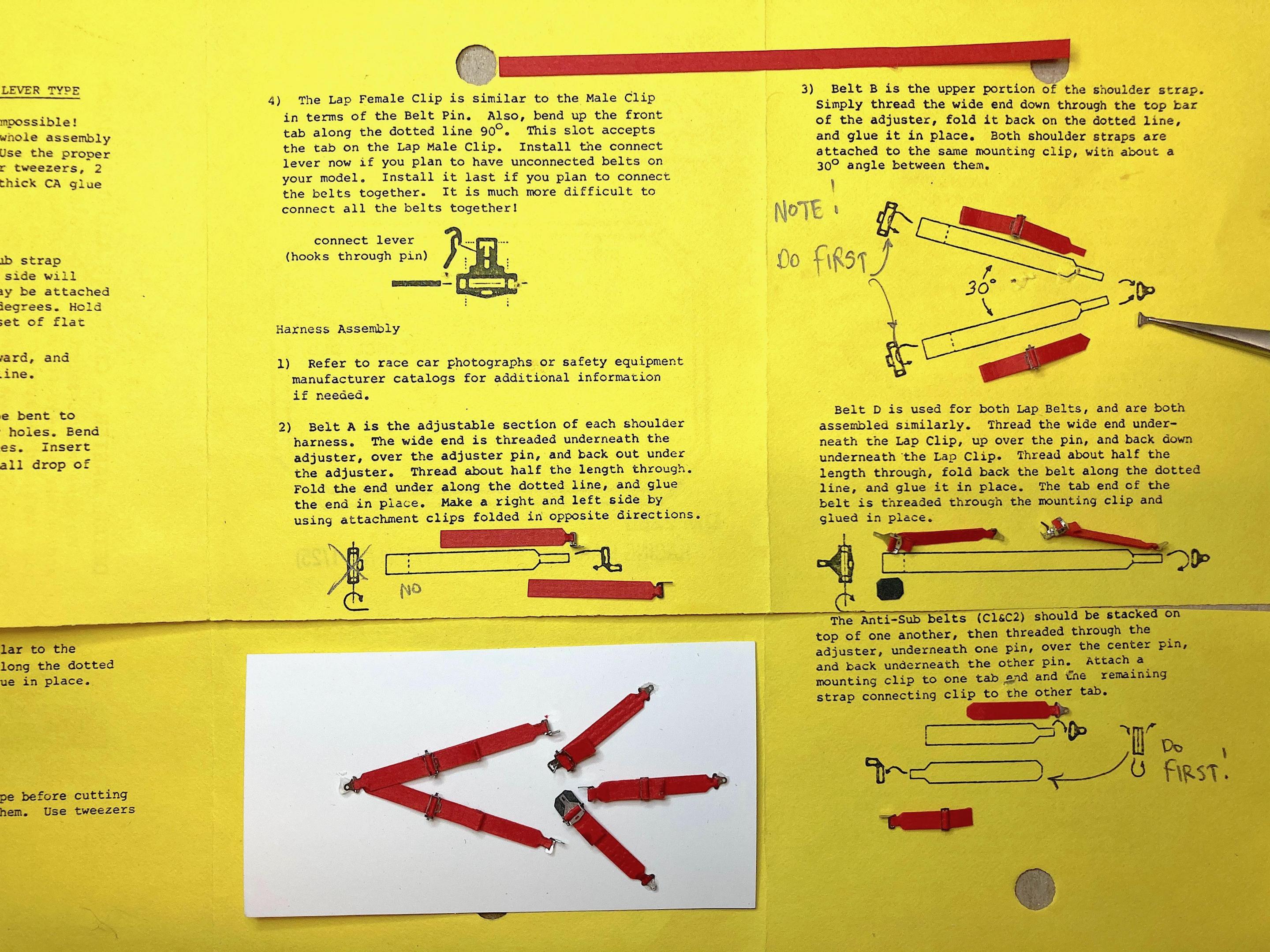

89AKurt Posted March 7, 2021 Posted March 7, 2021 Is there a tutorial on this forum, on how to assemble the Detail Master racing harness? I couldn't find with the search box, also looked from my browser world wide, and on You Tube, no luck. I had to modify from the instructions to get this.

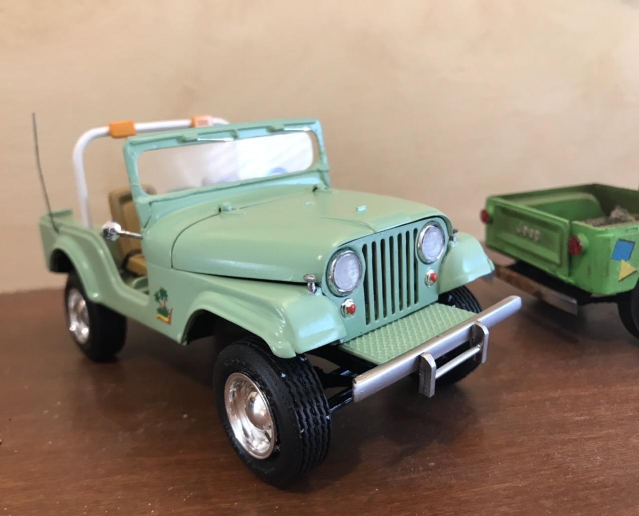

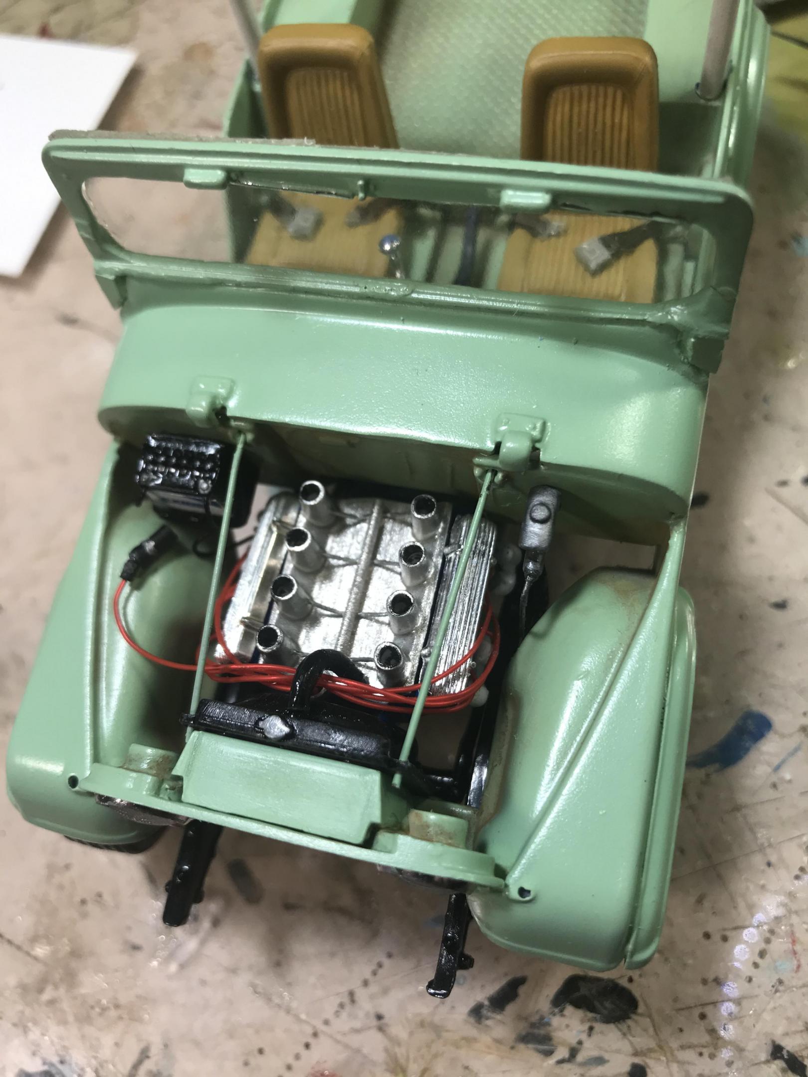

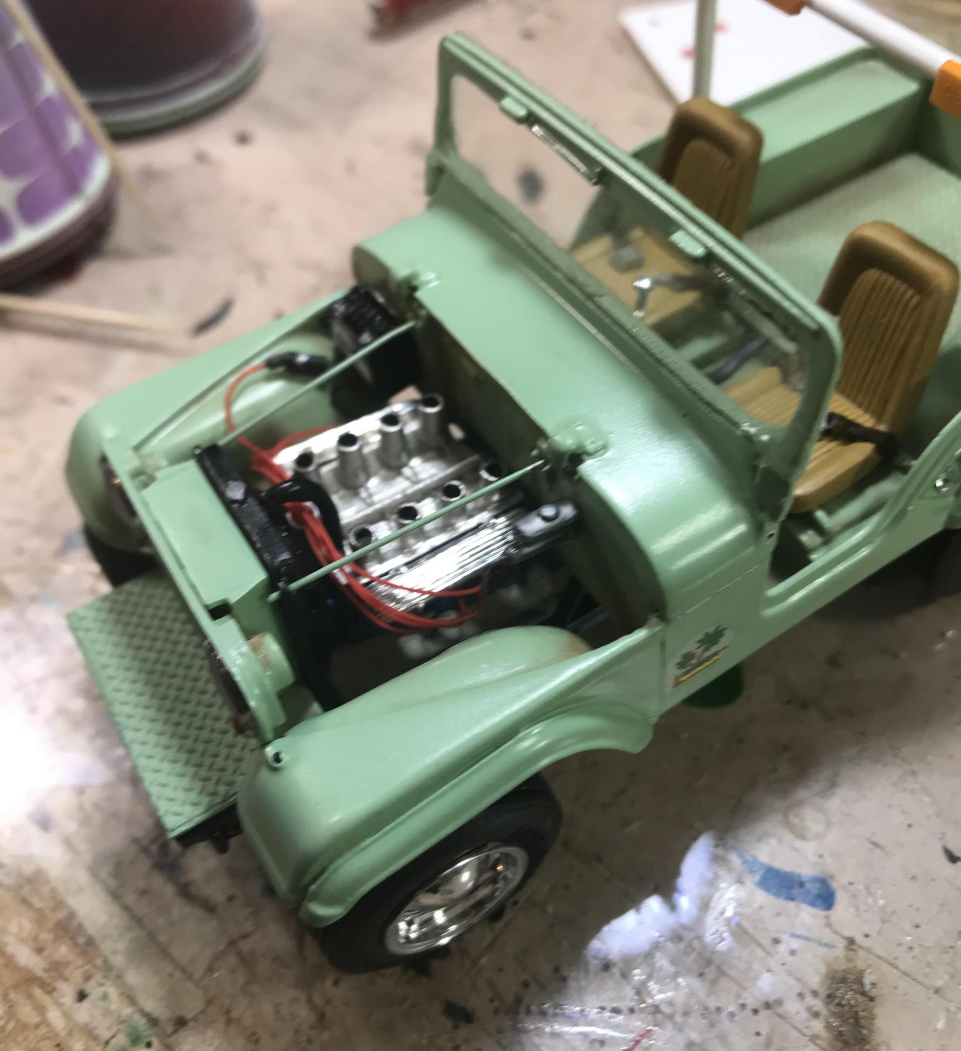

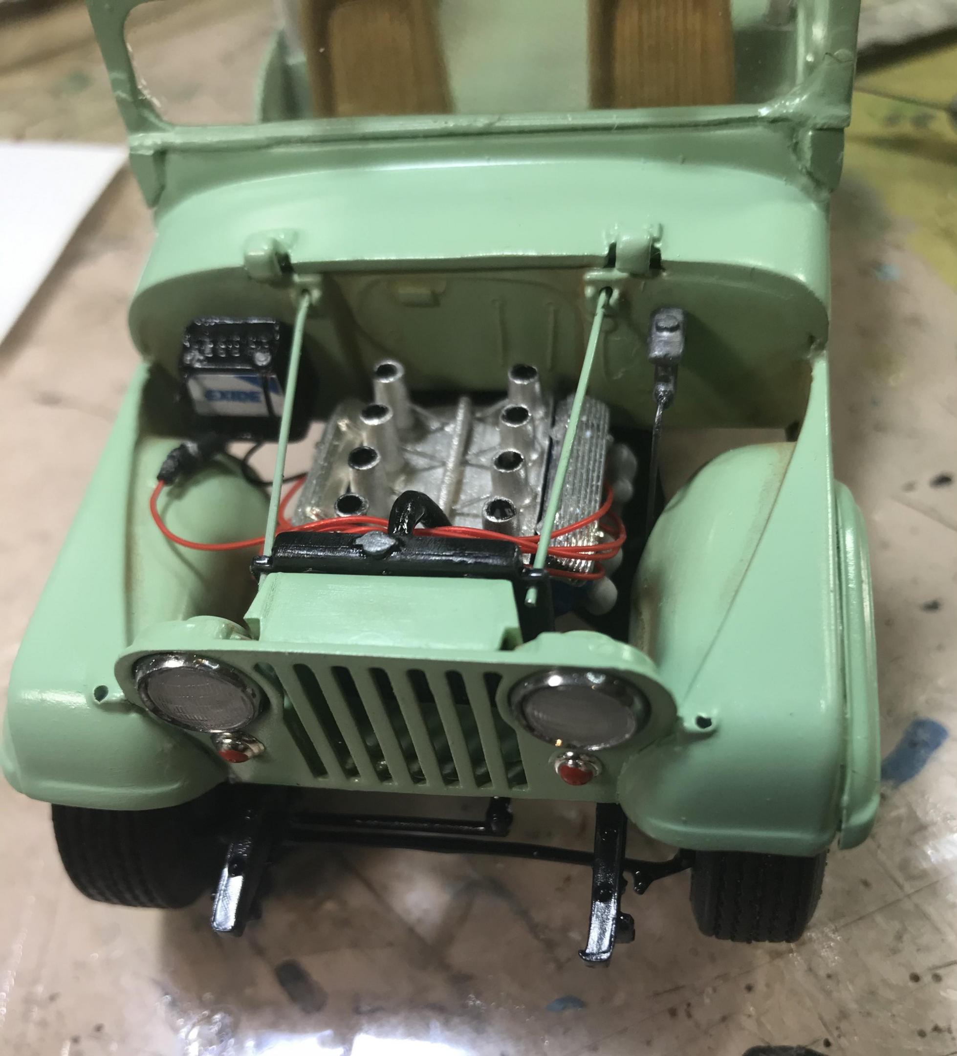

Tom Geiger Posted March 8, 2021 Posted March 8, 2021 More work today.. at that point in the project where every little thing is a final detail, and you have to step away for drying time between each action! Body is permanently mated to chassis. Interior is complete except for steering wheel Take 3! Everything under the hood is plumbed and done. Made and mounted a fun license plate. Ancient MPC chrome came off to the touch on the bumpers so I’m soaking it off in Mr. Clean right now. Not sure if they’ll be chrome or white. Should be done this week for sure.
Scott Colmer Posted March 8, 2021 Posted March 8, 2021 The jeep is looking good. Tom. Clever idea on the wheel stand, Frank. Kurt, the belts came out great. I did a tutorial on the Detail Master PE hardware for MCM a few years back. It had drawings to help show the steps. It might have been posted here in a thread. But it looks as if you figured it out very nicely. I've been cutting styrene for interior panels. Scott
89AKurt Posted March 8, 2021 Posted March 8, 2021 3 hours ago, Scott Colmer said: [...] Kurt, the belts came out great. I did a tutorial on the Detail Master PE hardware for MCM a few years back. It had drawings to help show the steps. It might have been posted here in a thread. But it looks as if you figured it out very nicely. [...] I searched this forum, nothing came up, if there are no tags things don't show up. I don't have a stack of MCM dead tree editions. I took a bunch of photos, practically each step. Considering I used paper instead of ribbon, my technique might vary from yours? I also made up some things to accomplish the look. I'm also digging the way Venom is showing his Shelby build, want to create the same format. Sometime...... you know how that goes. Anyway, got both sets done for the Ferrari.

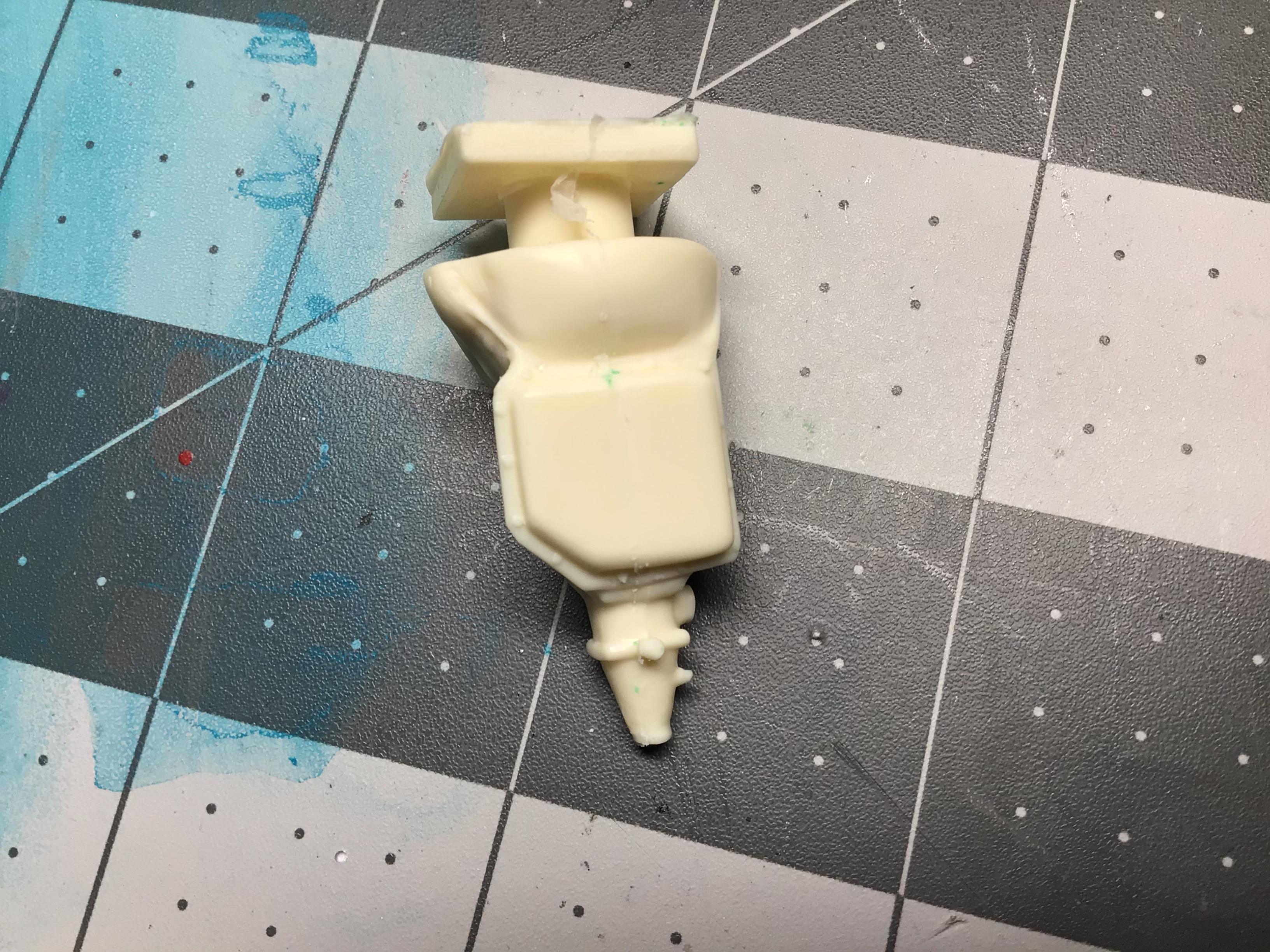

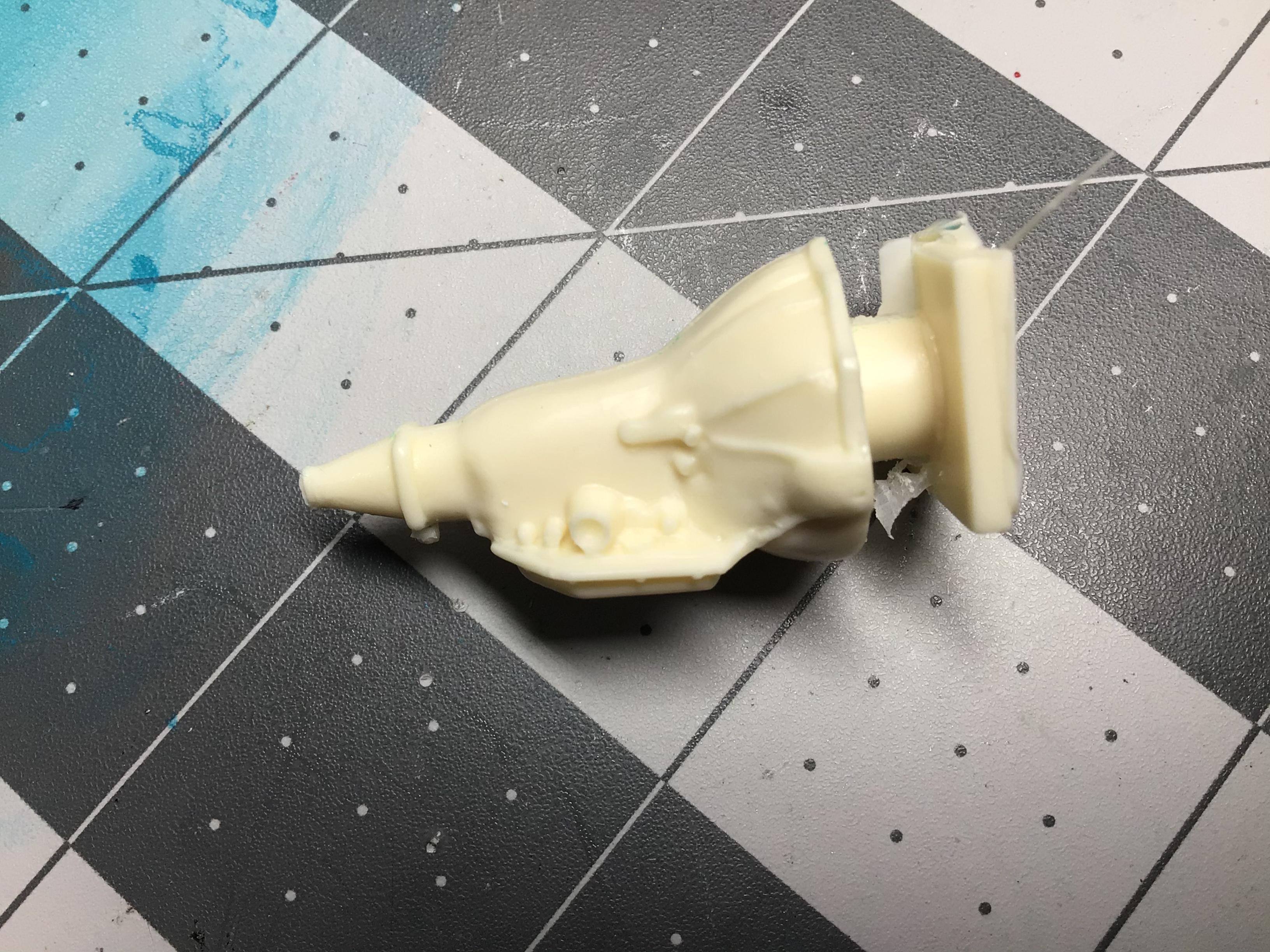

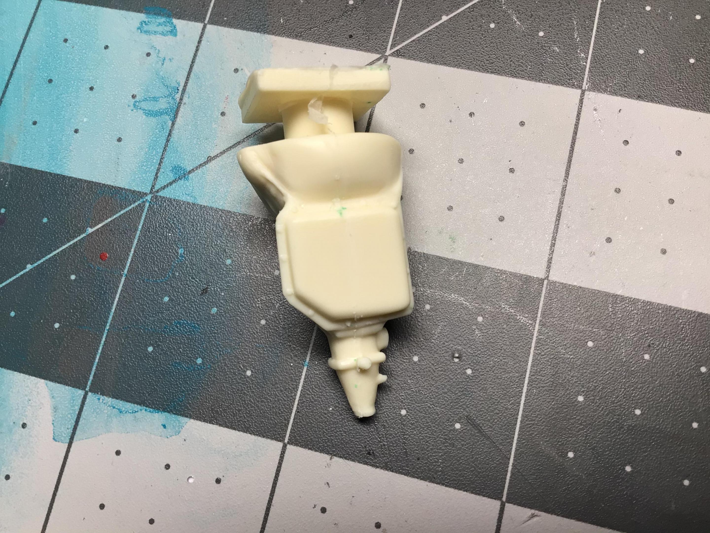

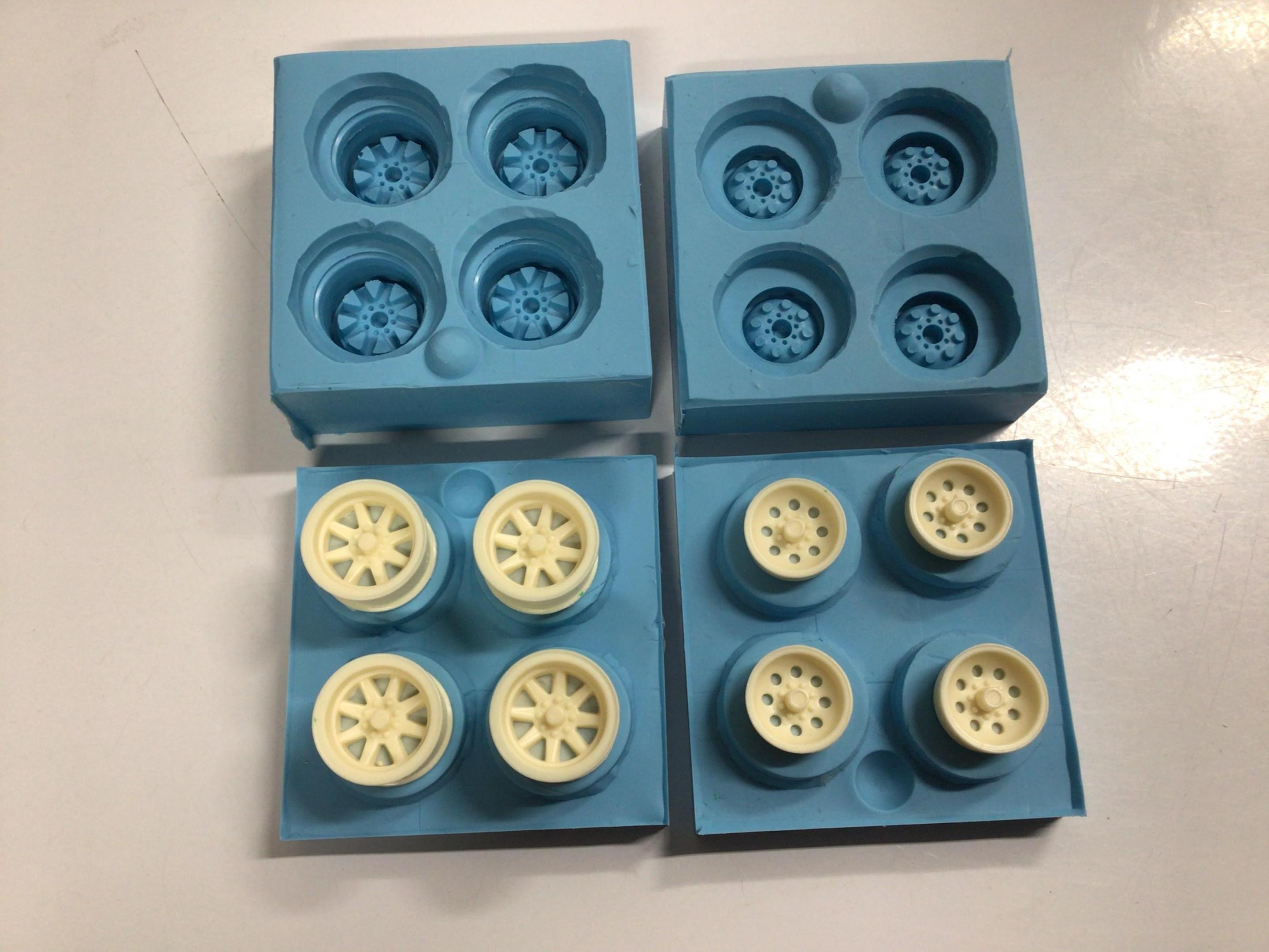

NOBLNG Posted March 8, 2021 Posted March 8, 2021 I made copies of some wheels that I may need for future projects. Also cast my first Turbo 350 from the El Camino kit. I modified it with a re-shaped bottom cover and pan, added pan bolts, cooler line bosses and dipstick grommet.

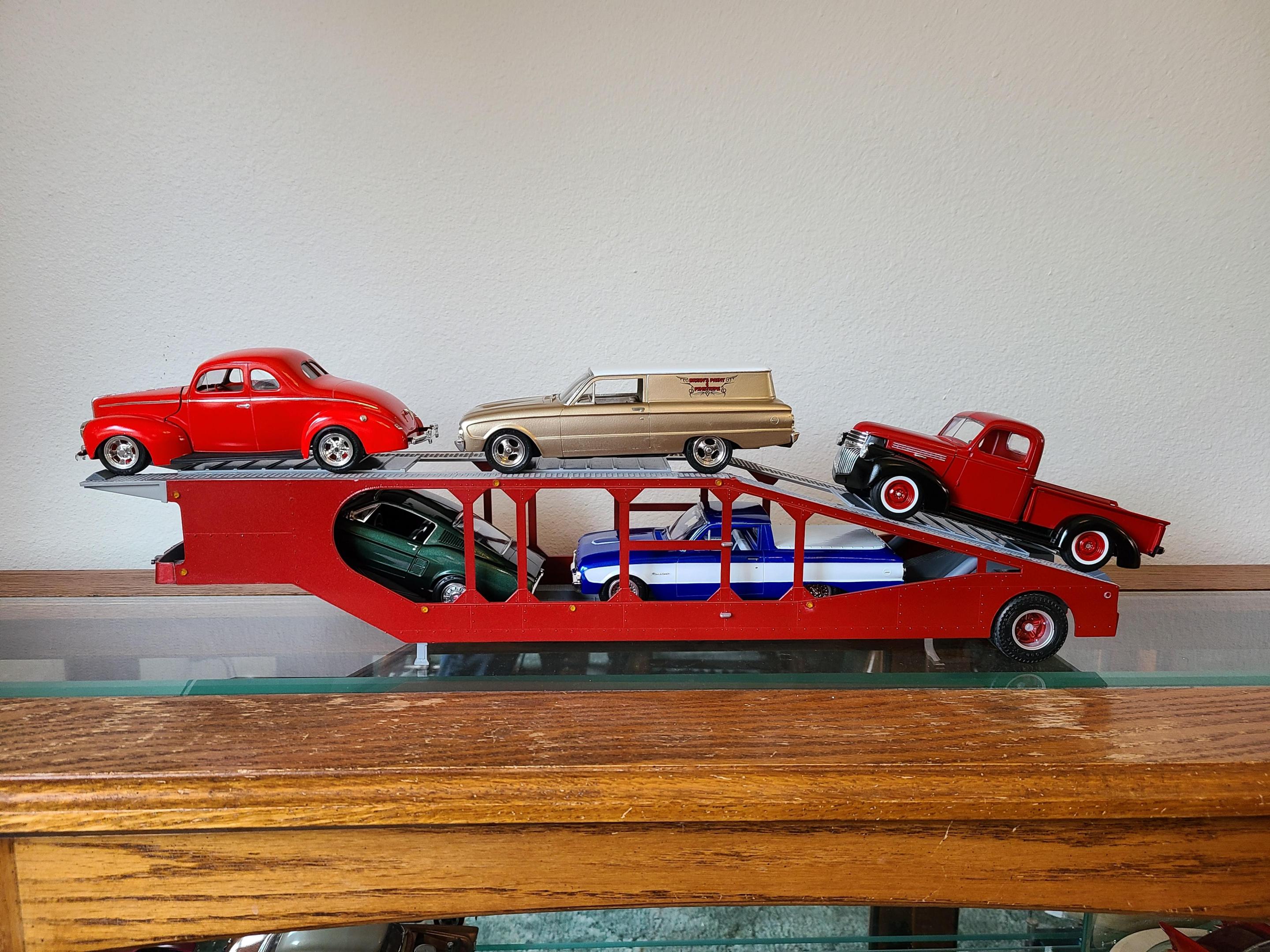

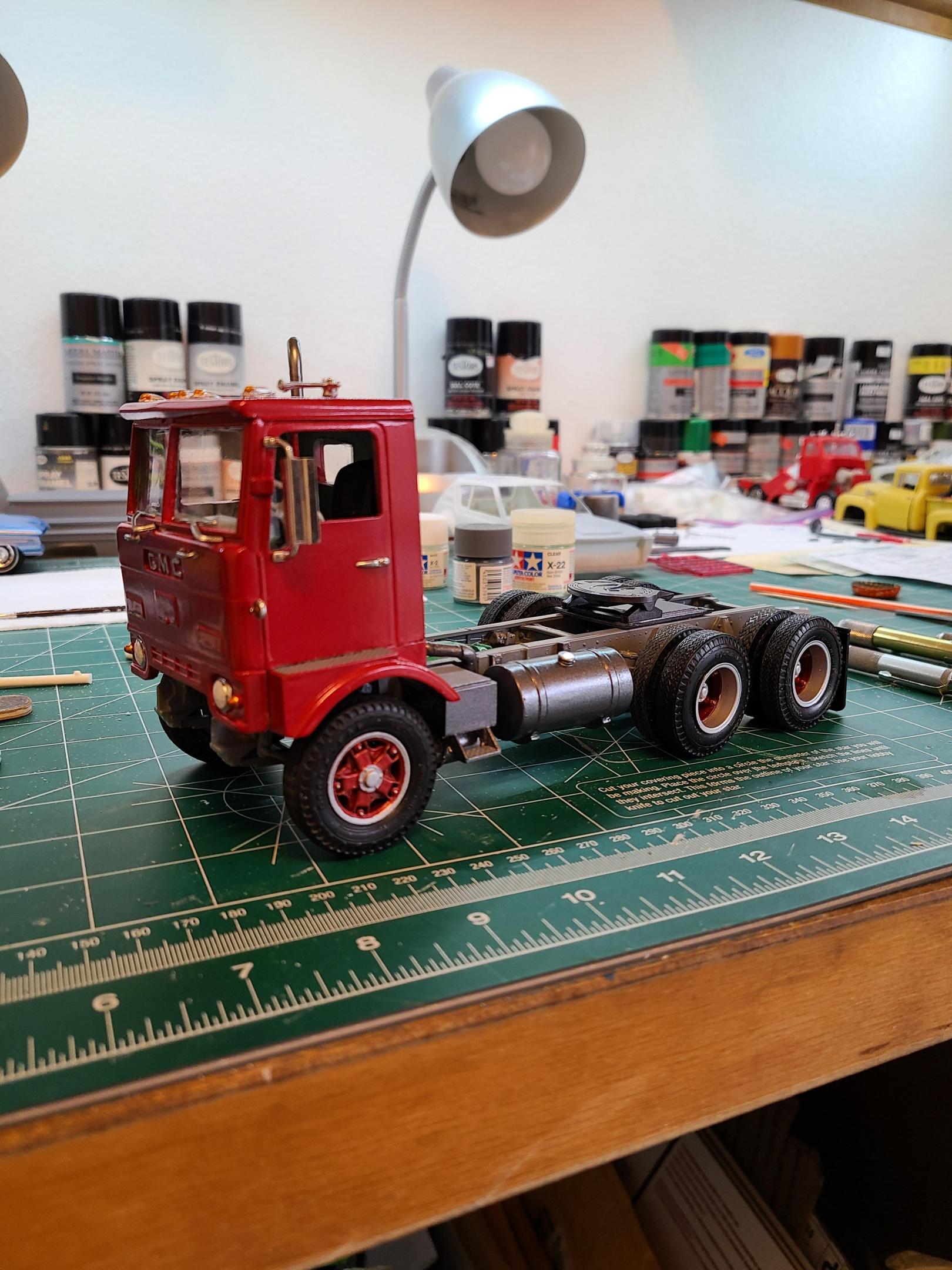

Sam I Am Posted March 9, 2021 Posted March 9, 2021 Just about have my crackerbox car hauler finished up.
Spottedlaurel Posted March 9, 2021 Posted March 9, 2021 5 hours ago, Sam I Am said: Just about have my crackerbox car hauler finished up. Great progress, that's going to look a very impressive set-up once completed. I found time to make more progress on some of mine last night: Three quarters of the Impala's window trims now have BMF. After wet sanding and Micromesh on the Fiat's front and rear glass over the weekend, I attacked it with coarse, medium and fine polishing compounds by Zero Paints. First time I've ever done that on clear parts, amazing to see it finally come clear again. I'll replace the sides with clear sheet, but that one is now a viable restoration project and I've got the colour and wheel choice already in mind for it. Would have been easier if I hadn't randomly squirted it with some yellow paint at some point in the past..... While I had the olishing compound I thought I'd have another go at the Honda. Just about managed to do all three stages without going through the paint, and it is now improved.
Scott Colmer Posted March 10, 2021 Posted March 10, 2021 I made one door panel. 1 more to go. Hey Kurt, your belts are very close to mine. I used medical tape because I like the ribs in it.
89AKurt Posted March 10, 2021 Posted March 10, 2021 33 minutes ago, Scott Colmer said: [...] Hey Kurt, your belts are very close to mine. I used medical tape because I like the ribs in it. [...] It fits through the slots okay?
Scott Colmer Posted March 10, 2021 Posted March 10, 2021 Yes, they threaded through OK. Here is a pic. The patches are just printed paper edged with a red sharpie.

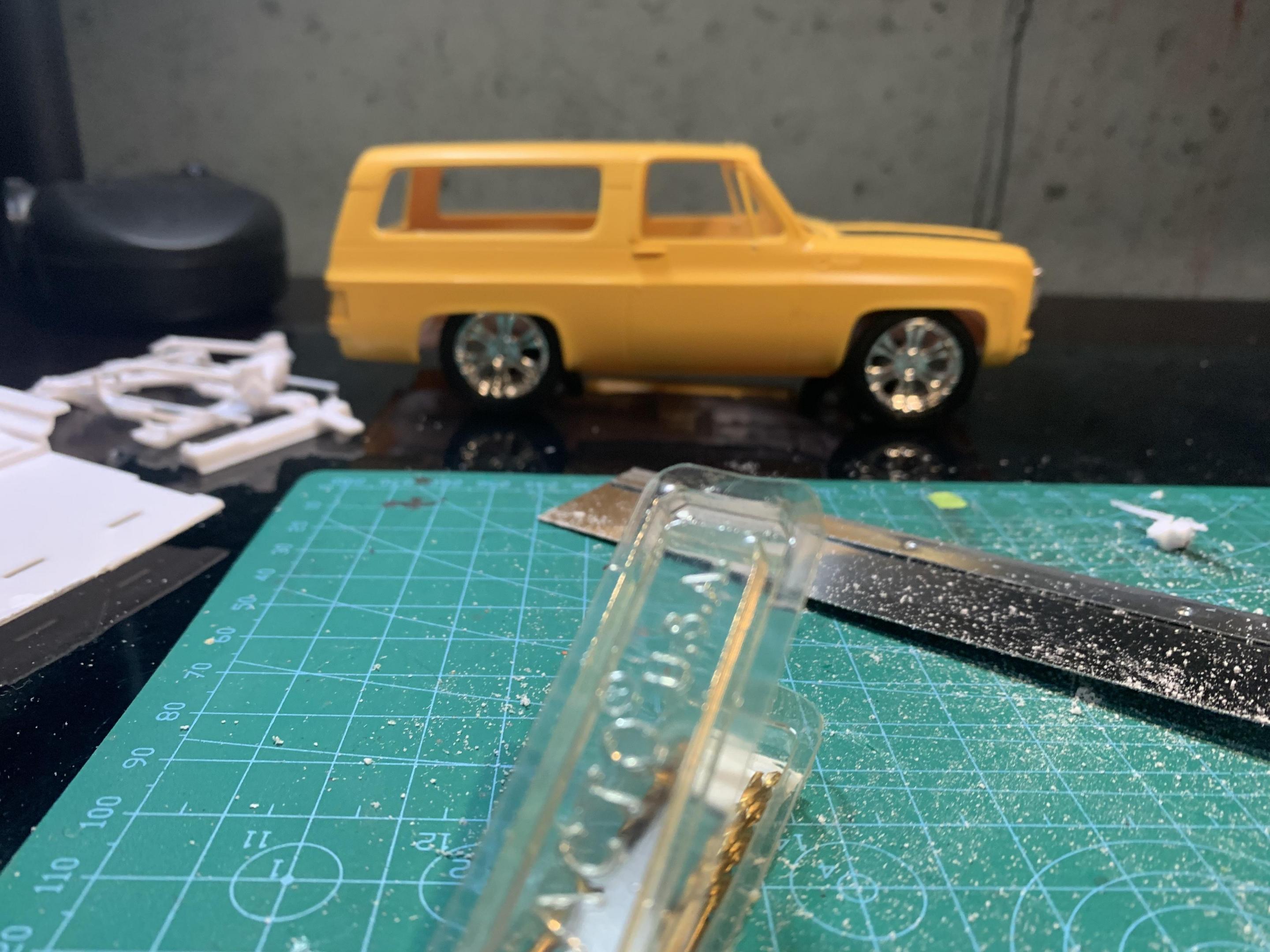

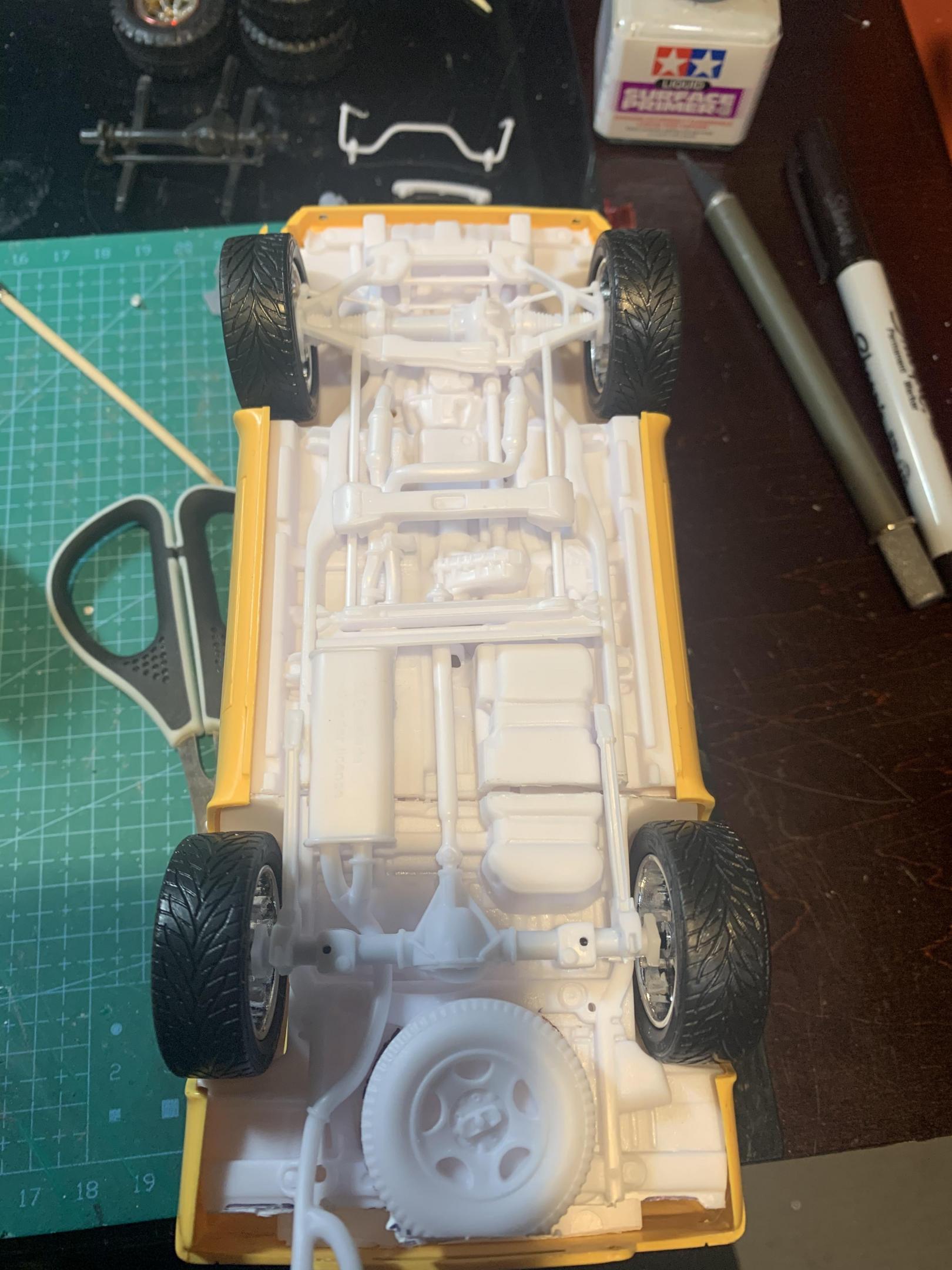

Bullybeef Posted March 10, 2021 Posted March 10, 2021 I successfully stuffed an Escalade chassis under a 1975 blazer, disregard the second picture for the stance, that was at the halfway point, with only the front of the chassis pan fitted

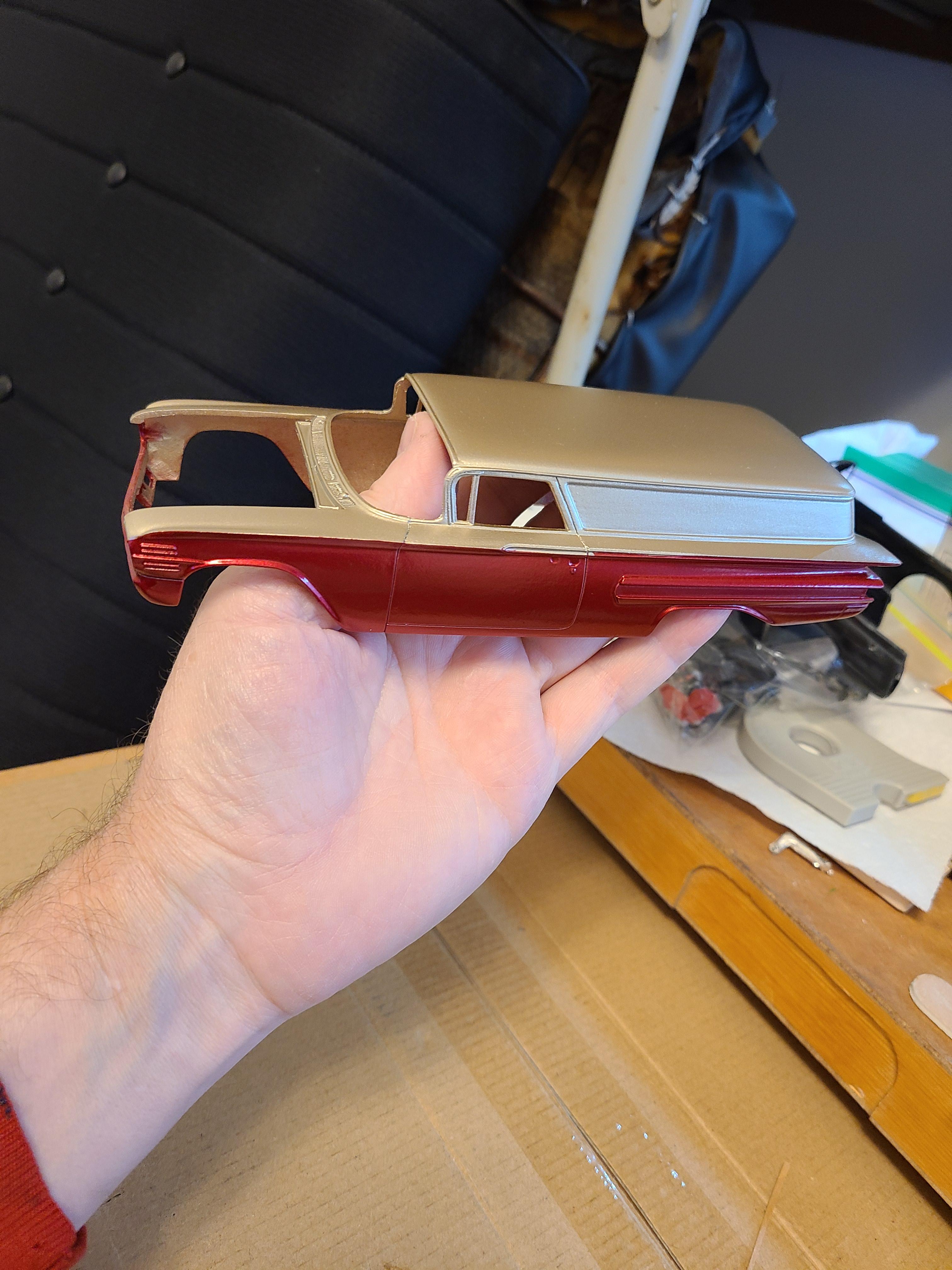

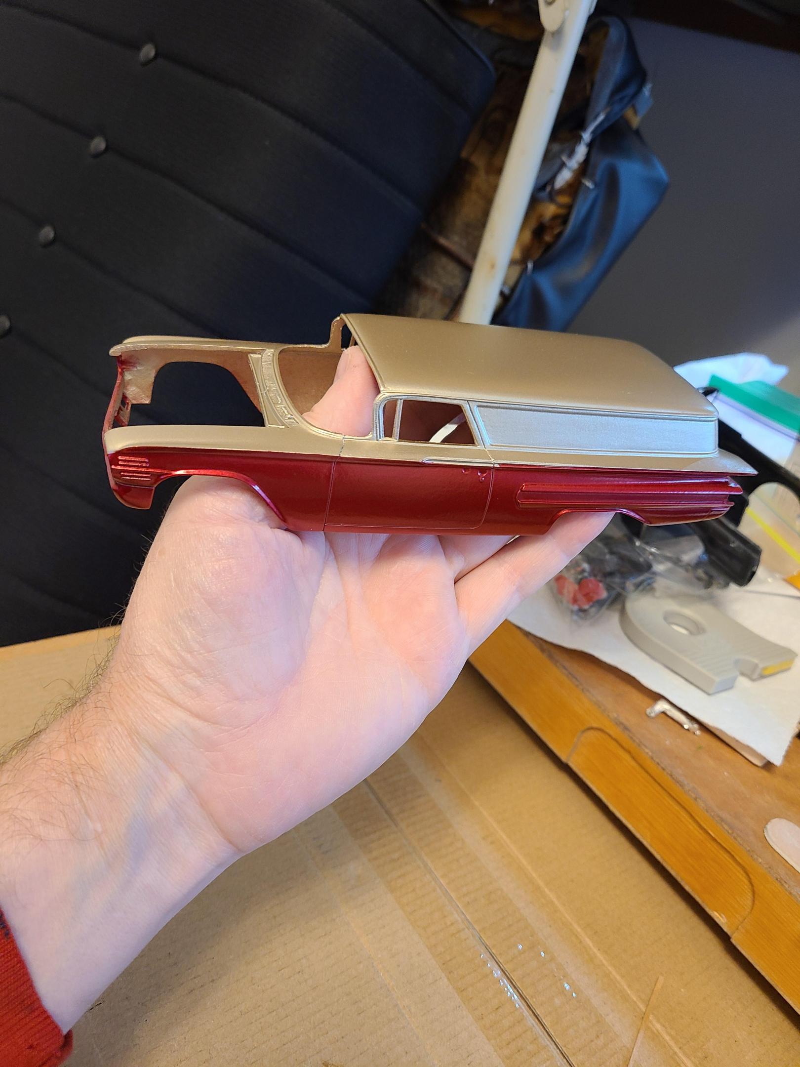

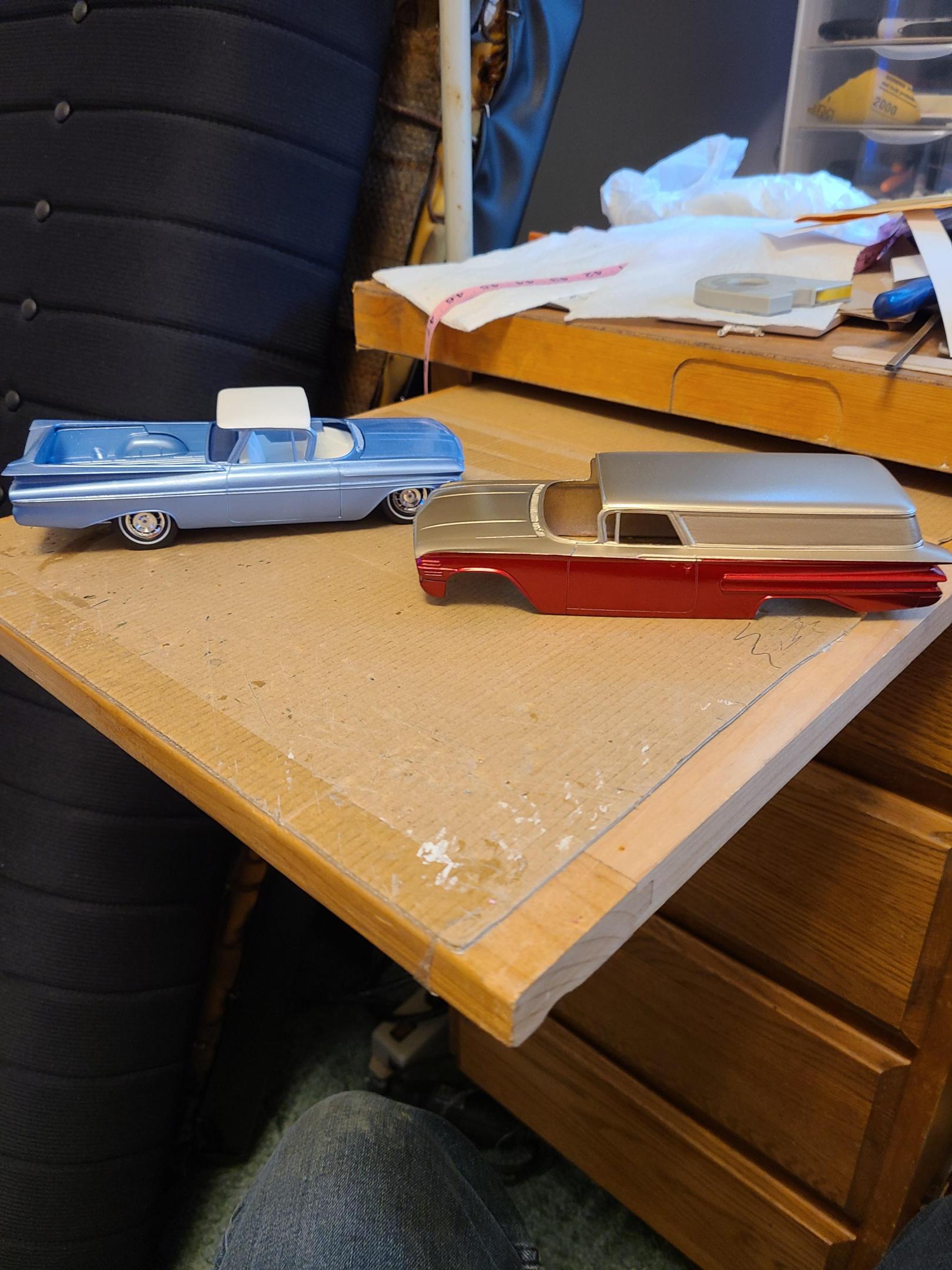

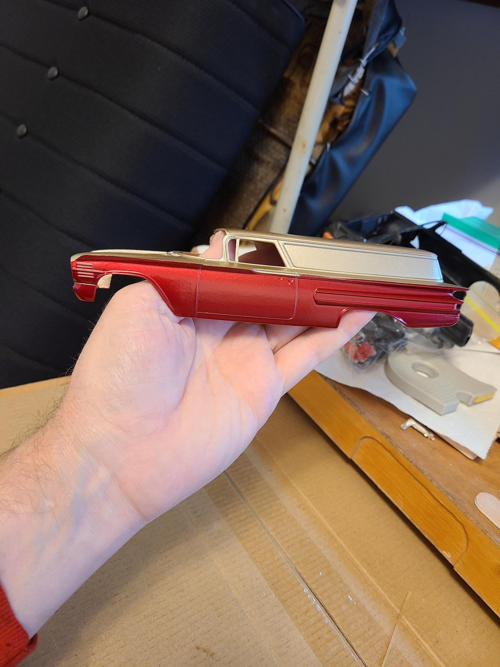

Sam I Am Posted March 11, 2021 Posted March 11, 2021 Been cleaning up this 60 Chev and layed down the color coats yesterday and today.
Tom Geiger Posted March 11, 2021 Posted March 11, 2021 Drove this one off the workbench this morning. Full set of photos when I have the opportunity!
Sam I Am Posted March 11, 2021 Posted March 11, 2021 3 minutes ago, Tom Geiger said: Drove this one off the workbench this morning. Full set of photos when I have the opportunity! Hope you can glue it back together.
TransAmMike Posted March 11, 2021 Posted March 11, 2021 11 hours ago, Sam I Am said: Been cleaning up this 60 Chev and layed down the color coats yesterday and today. The sedan delivery is really cool Sam, I like's it!!?

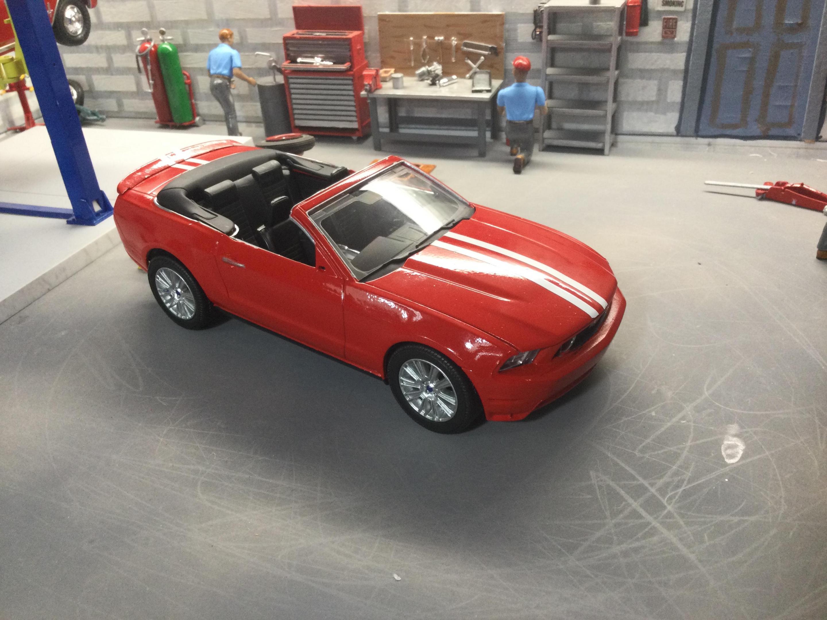

ewetwo Posted March 12, 2021 Posted March 12, 2021 Recreation of a friend’s Shelby. Not done yet. But close.

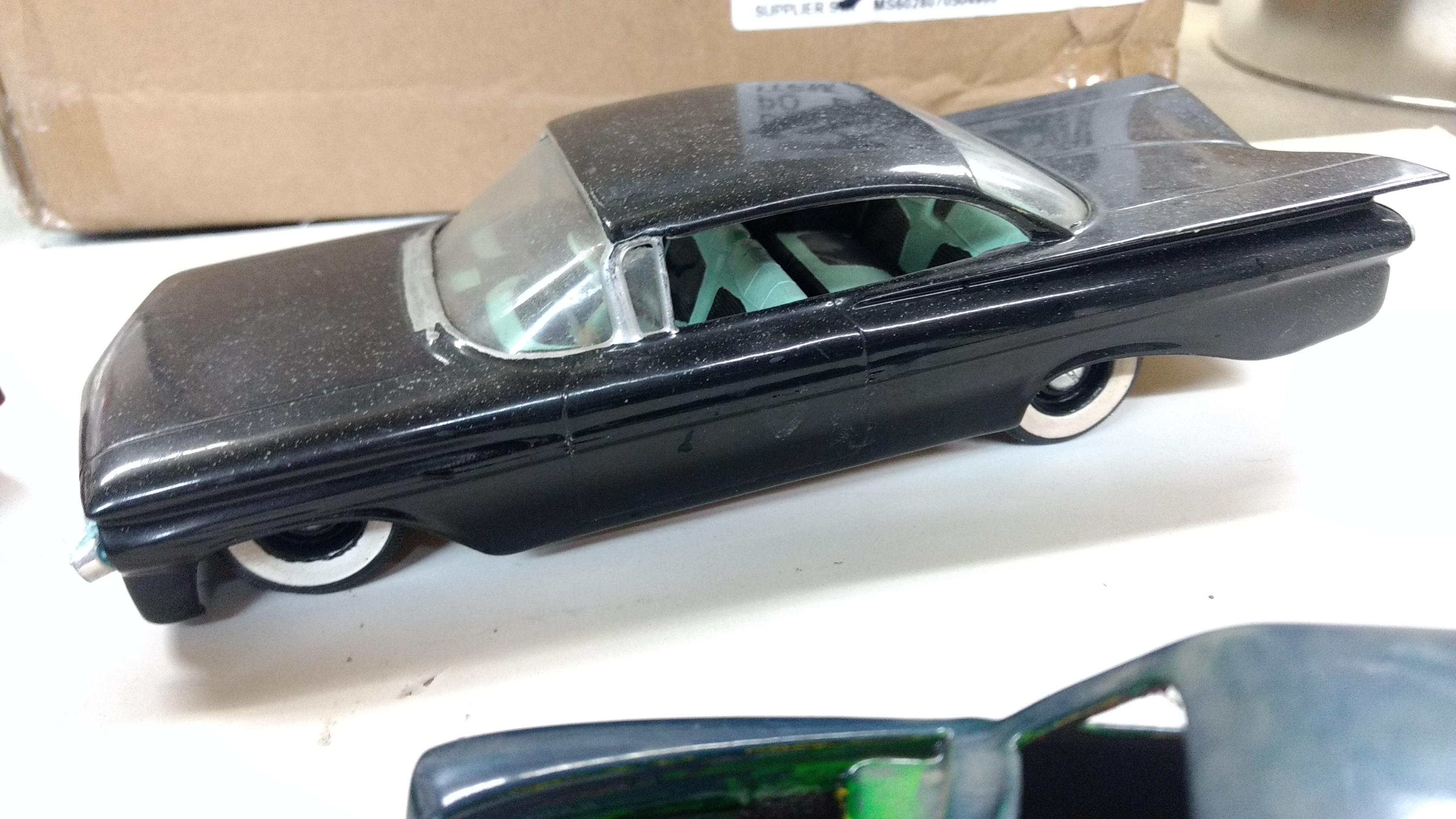

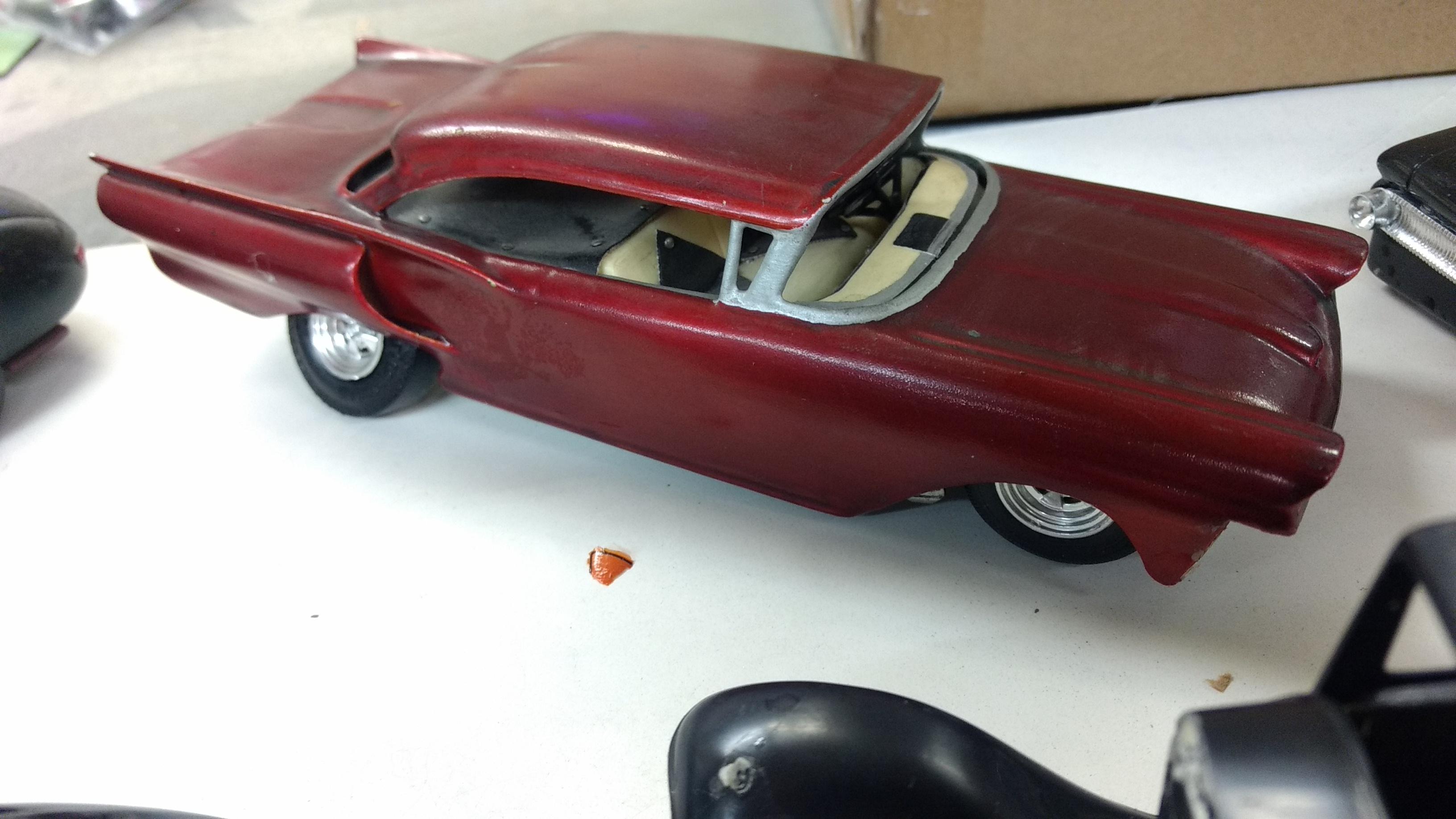

Modlbldr Posted March 13, 2021 Posted March 13, 2021 Spent some time today spraying and stripping paint. Sprayed a bit of color on my 63 Mercury Meteor. Taking a bit to get a smooth coat. Had to do a couple of rounds of wet sanding. Yesterday I started the paint stripping process in the Purple Pond of the rebuilder 59 Impala, 58 Ford and 49 Ford. After 24 hrs of soaking and a couple rounds of scrubbing I got almost all of the black paint off of the 59 Impala, half of the 6!!! coats of paint off of the 58 Ford (black, gold, maroon, green, orange and purple!). The paint on the 49 Ford hasn't really budged at all. I'm letting them soak all weekend and we will try again Monday. Later-
