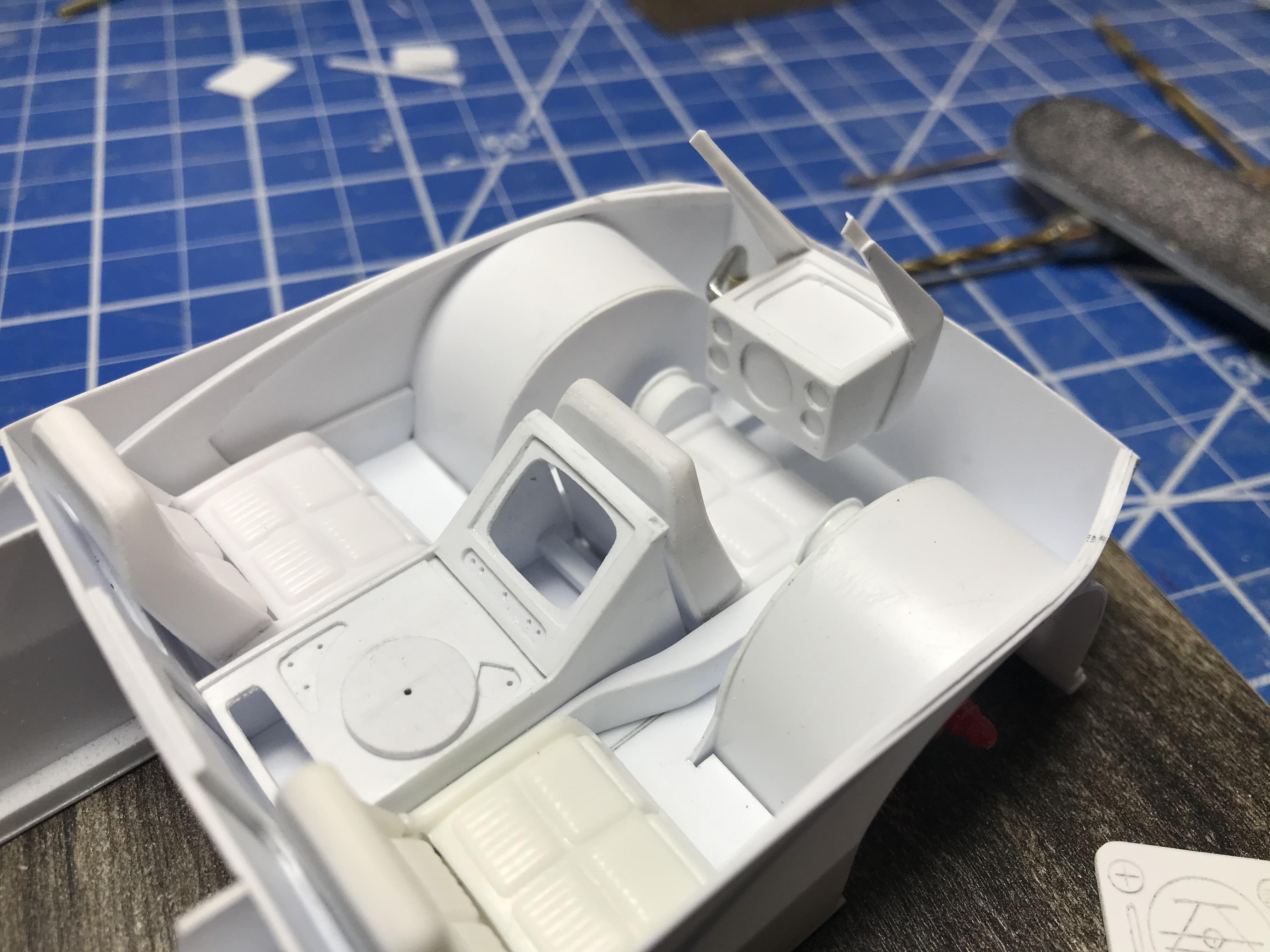

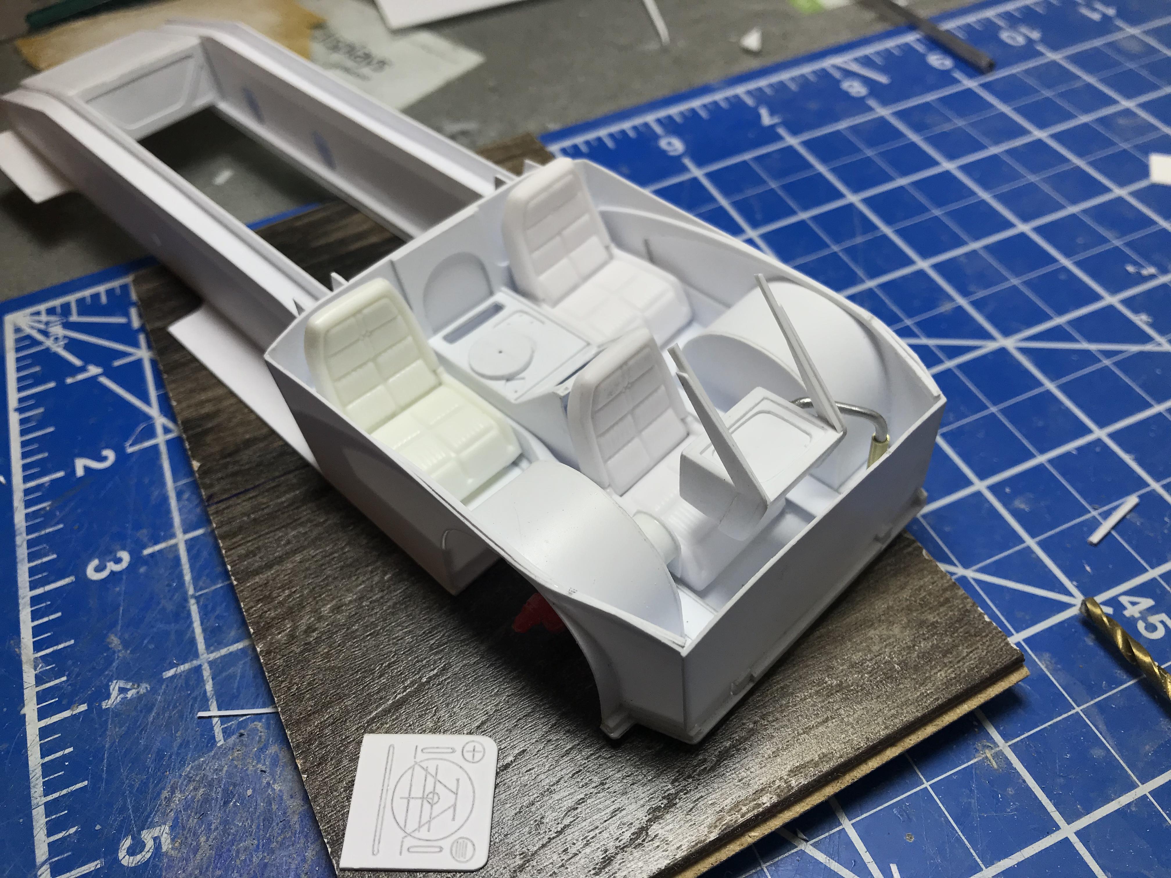

Great looking seats and I like the seating arrangement. I don't know how you would represent this, but maybe a "Heads Up" instrumentation like a Fighter Jet or and old Pontiac Grand Prix or something like that.
Ya know what... that's a fantastic idea...  from some quick research it looks like they were using heads up displays in military and commercial jets in the 1970s..   hmmmm... military surplus HUD... now to try and figure what that looks like..
The HUD is cool. But, here's another option. How about a couple pods or a cluster mounted on an arm that swings out of the way. Possibly mounted on top of one of the wheel tubs?
What made me think of it was a late '90's Grand Prix GTP that we had. The speedo was all that the dash thru up on the windshield. I know Detroit and GM specifically has offered this feature on other cars since then. I always thought it was a great feature since you never had to take your eyes off the road to read your instruments. I have only seen pictures of this technology in fighter aircraft and this could be a good way to solve your instrument issue and it would be in keeping with this build. Some others have forwarded you some places to look to help accomplish this.

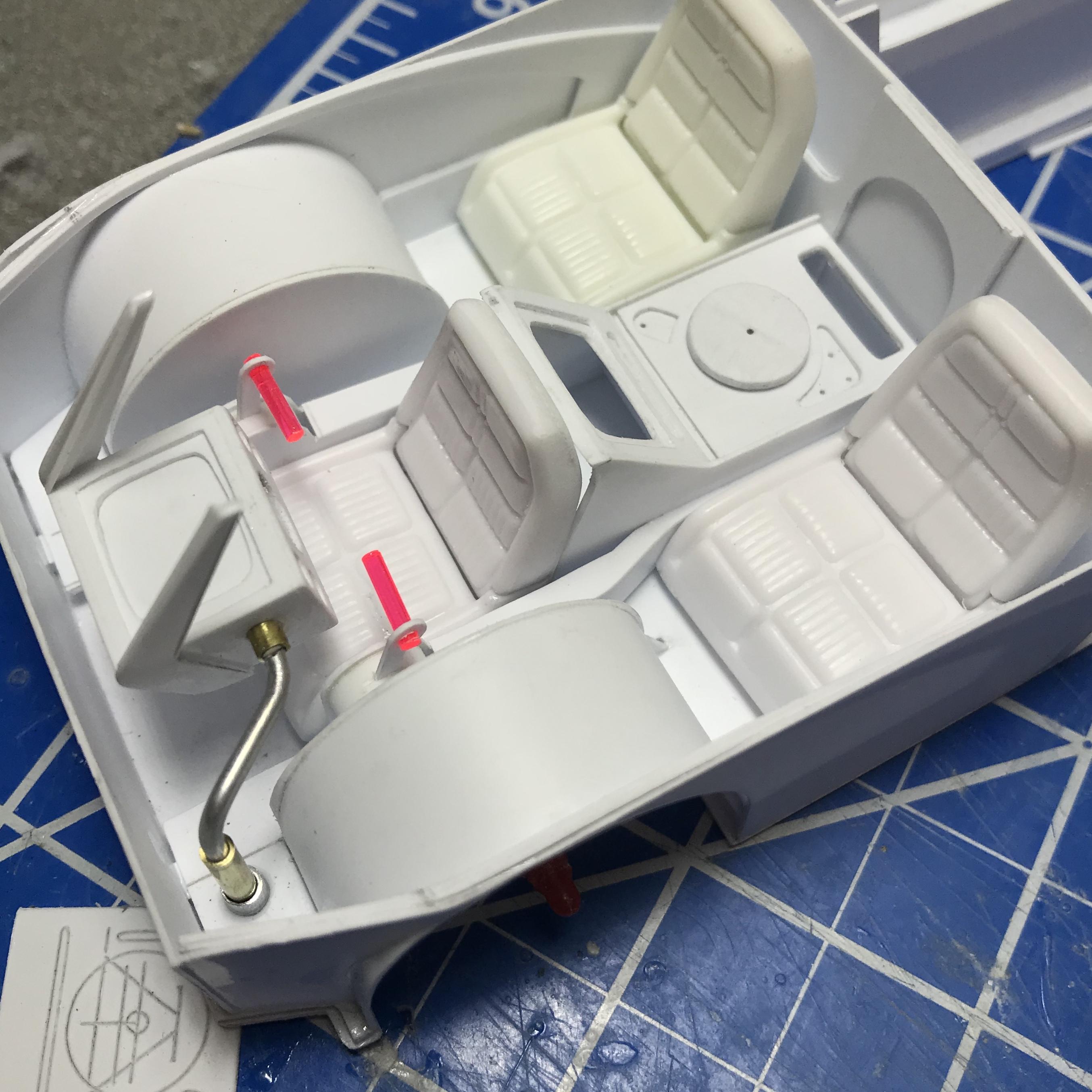

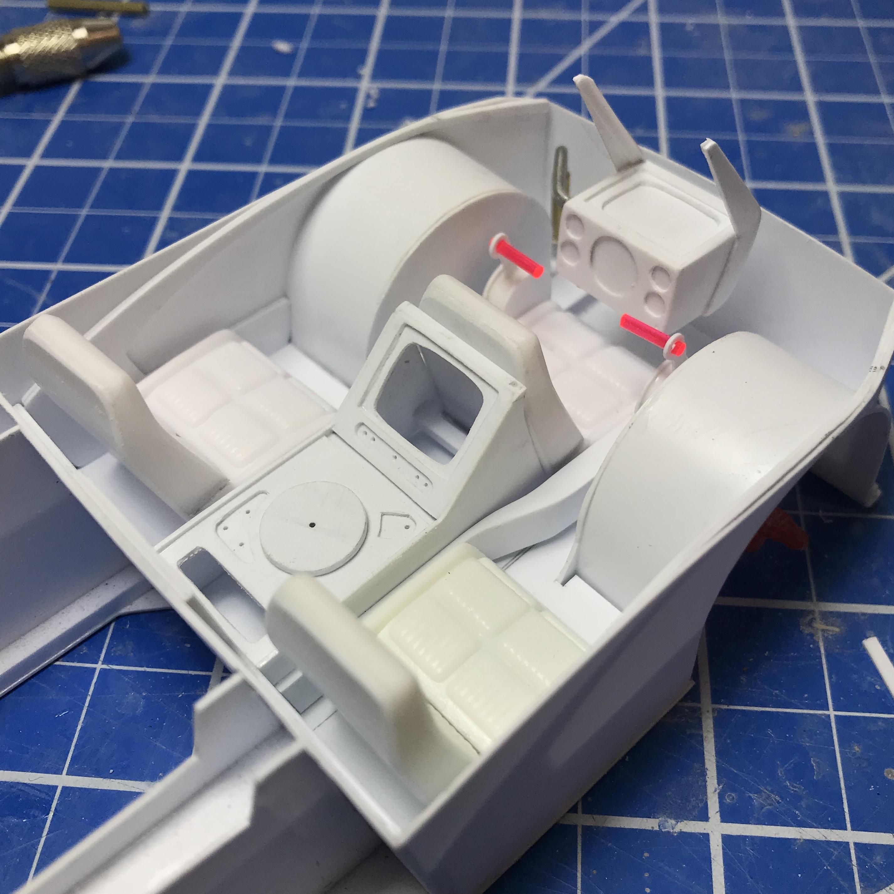

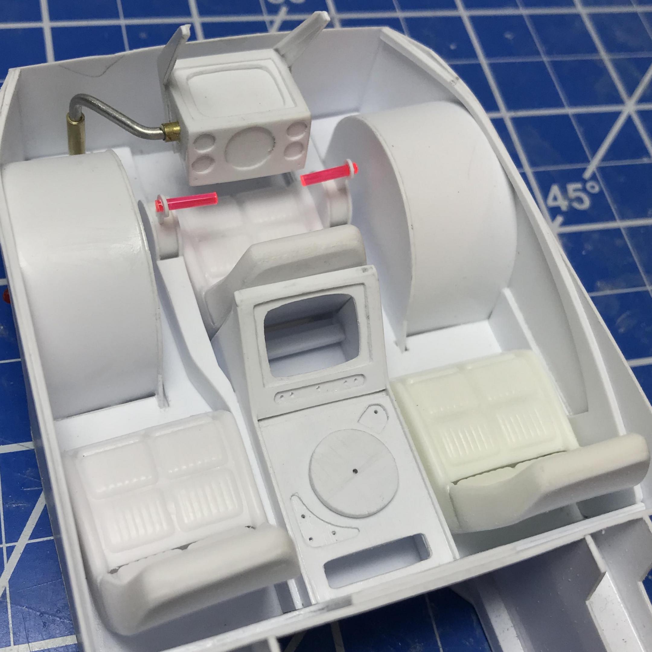

You guys are fantastic!   I actually combined a couple of the ideas here...  since the vehicle needs to stay 70s period correct, i made the “projector” for the HUD into a tube style tv, in a housing with some traditional gauges on the front all mounted on a swing arm... the cutter made the HUD pattern perfect on some .020 styrene, I cant wait to try it on some clear...  all scratchbuilt, still needs some clean up... but I like it!!!
thank you all for the help getting over that little hurdle!!

I did a better mockup and added the control levers... they are made from some edgeglow acrylic rod,  commonly used in gun sites.   Just some trim to add in here and its on to the ramps.

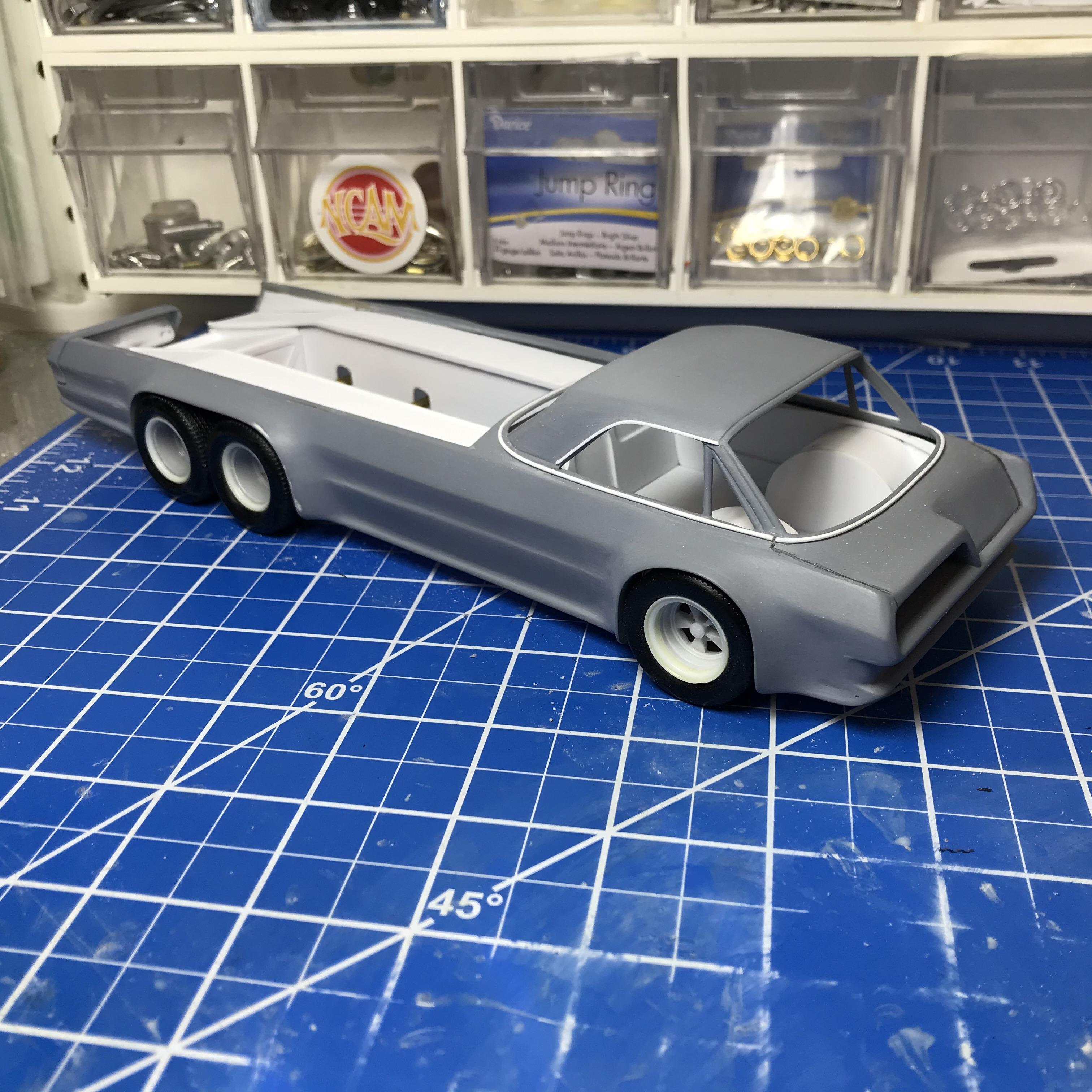

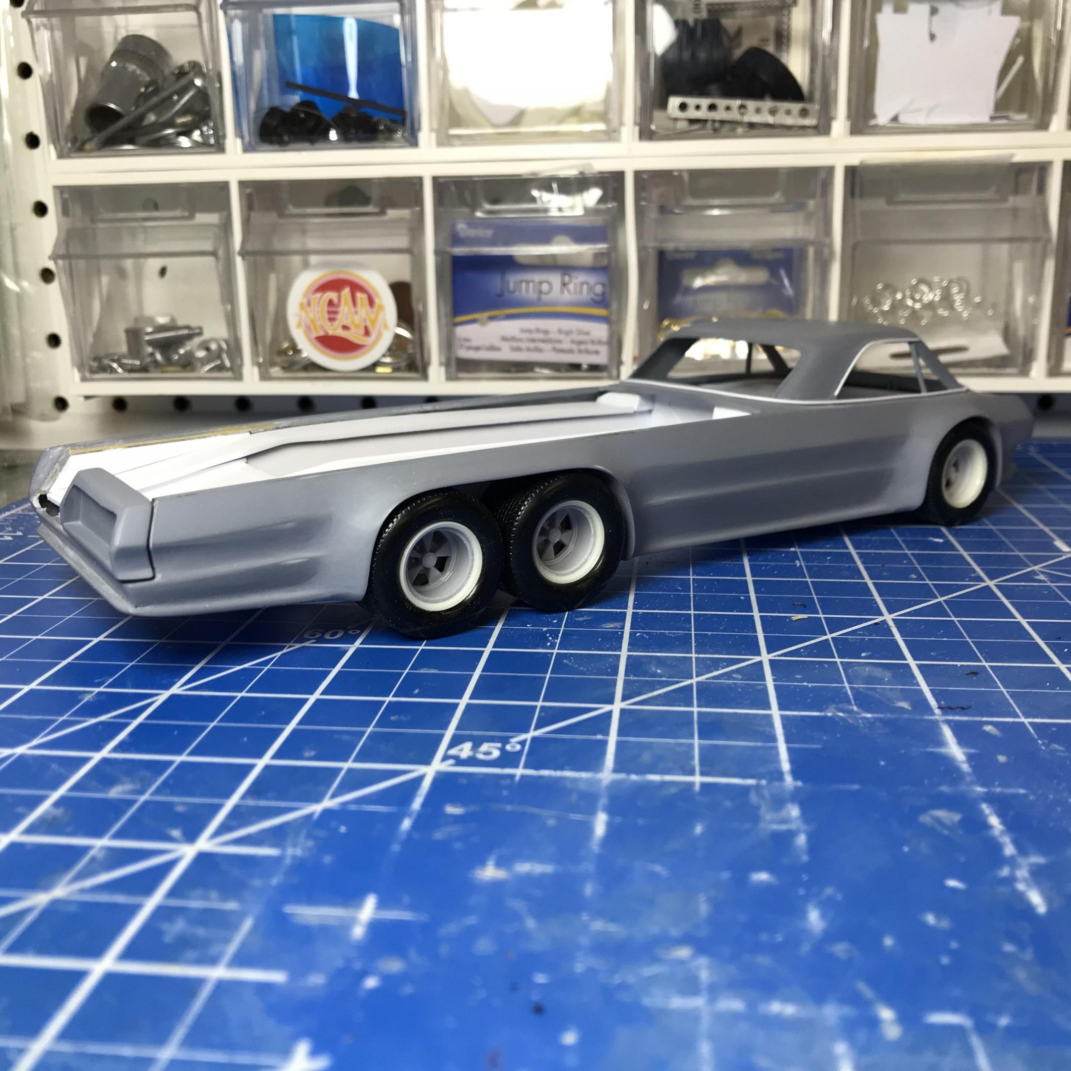

Anyway I have been making slow progress in my spare time.. and its really taken yet another spiral into craziness here are some photo updates from the last couple months.

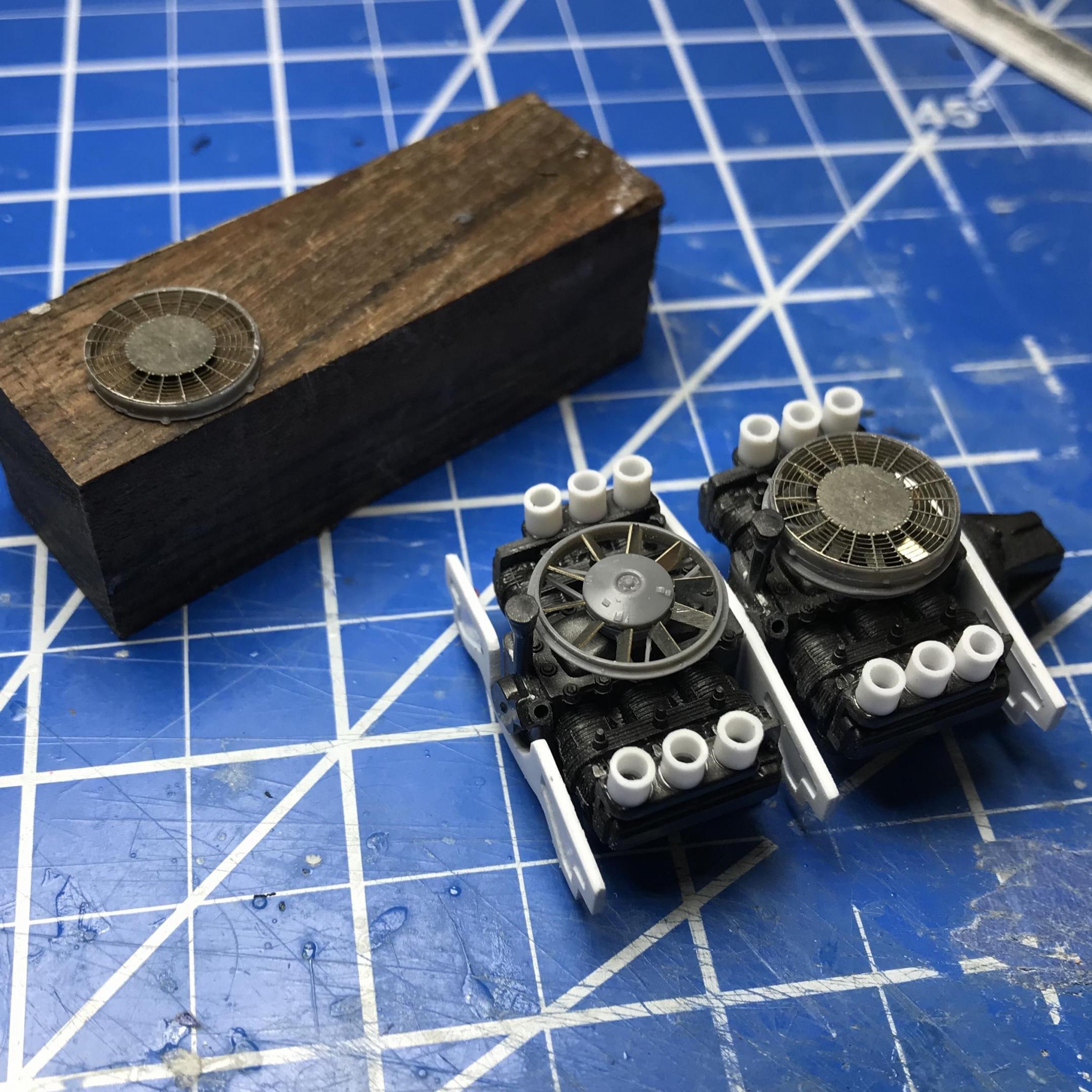

I did some detail work on the engines, I used HO scale train dynamic cooling fans to add some detail to the fans... these are the 48" ones from Cannon & Company and really are spectacular. Then I turned pulleys on the lathe for the belt system, ill make the belt out of some electrical tape.
IMG_E2753.thumb.JPG.bafecdee9a5d5f2d2b24dfc065ab661e.JPGIMG_E2785.JPG.e7d89c23d5c479c964c1dc0c3a106e4e.JPGIMG_E2786.JPG.e450fdda6c4b681065b12937b9cde2f8.JPG

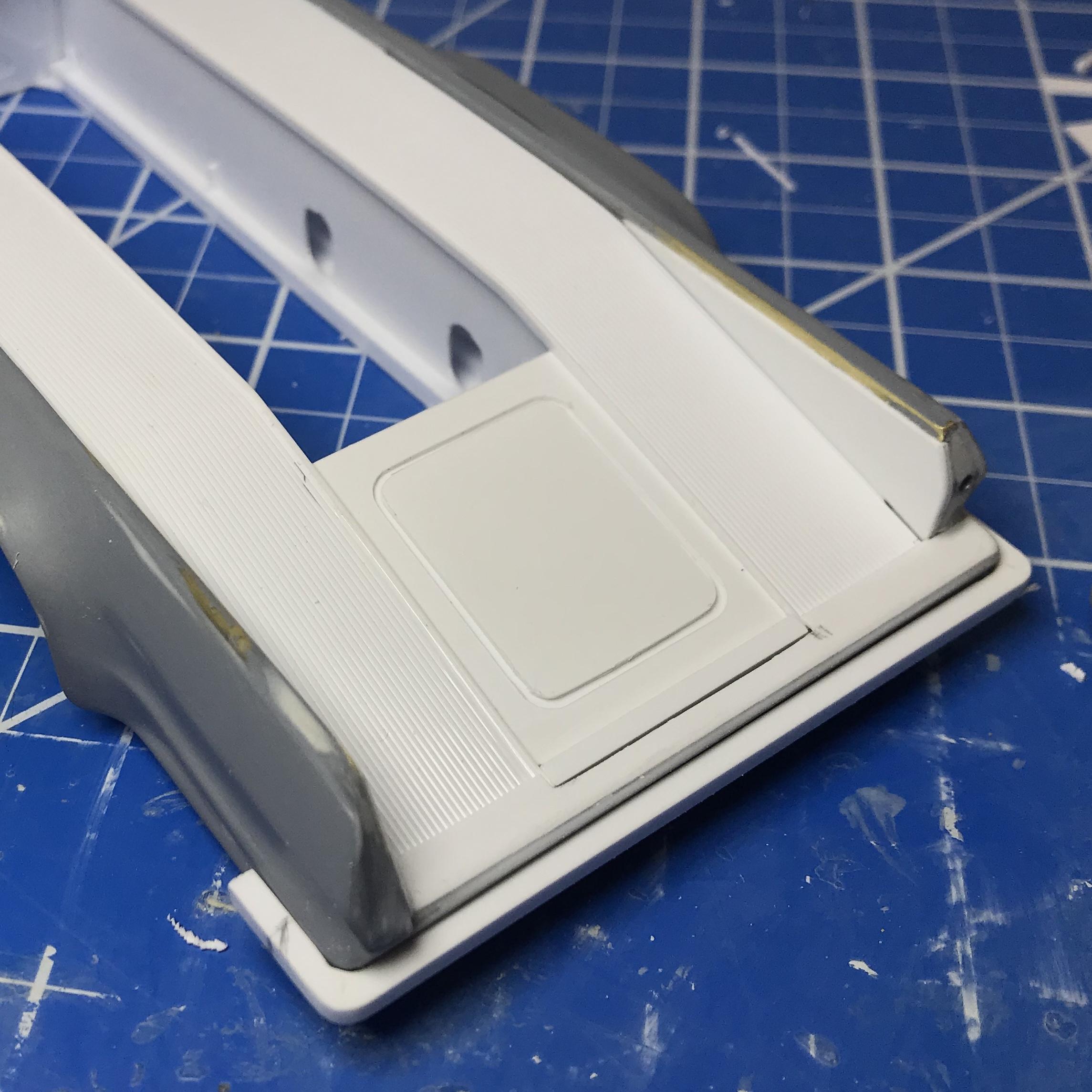

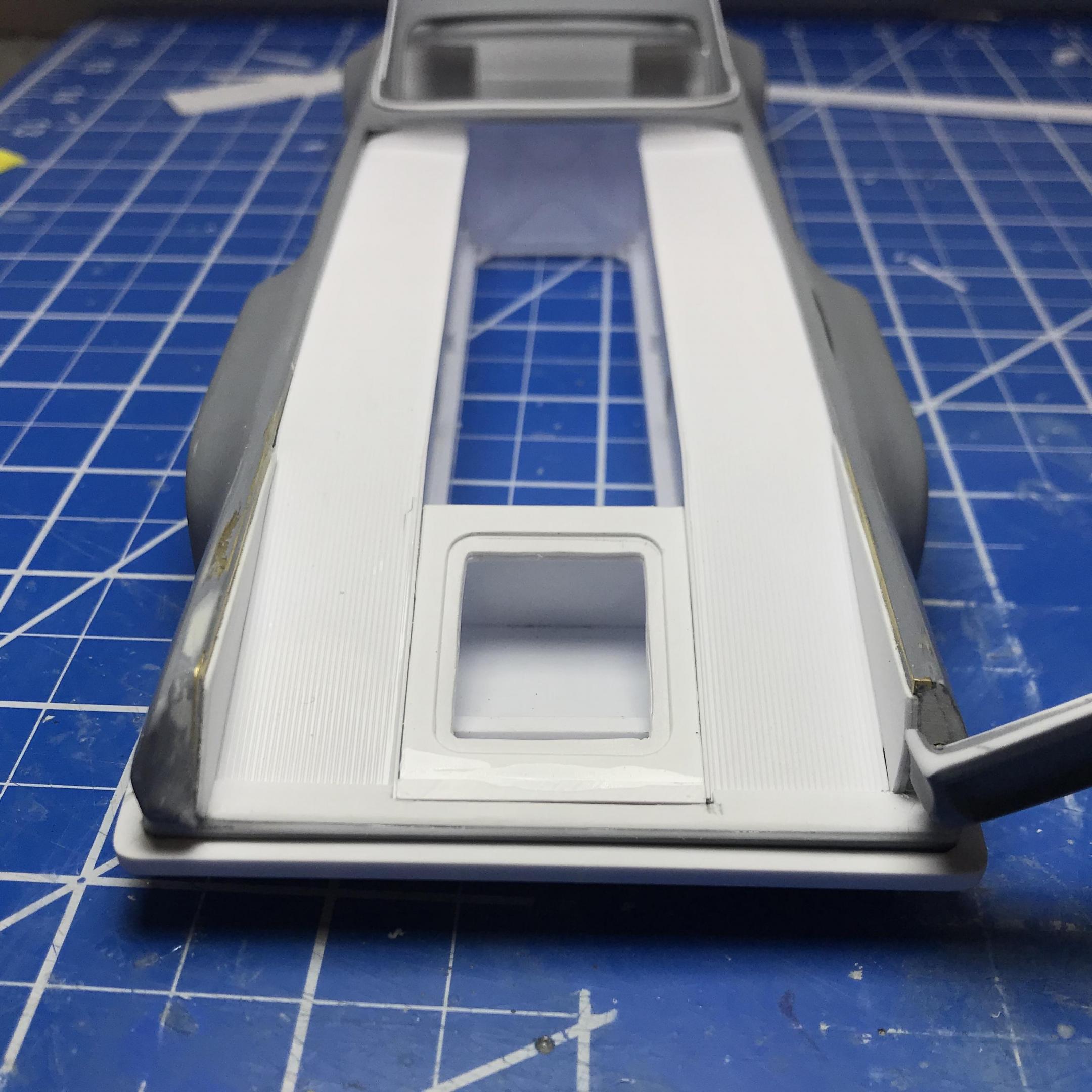

Then I needed to finish up the ramps and filling the open areas of the rear body as well as scratch-building a new rear bumper.

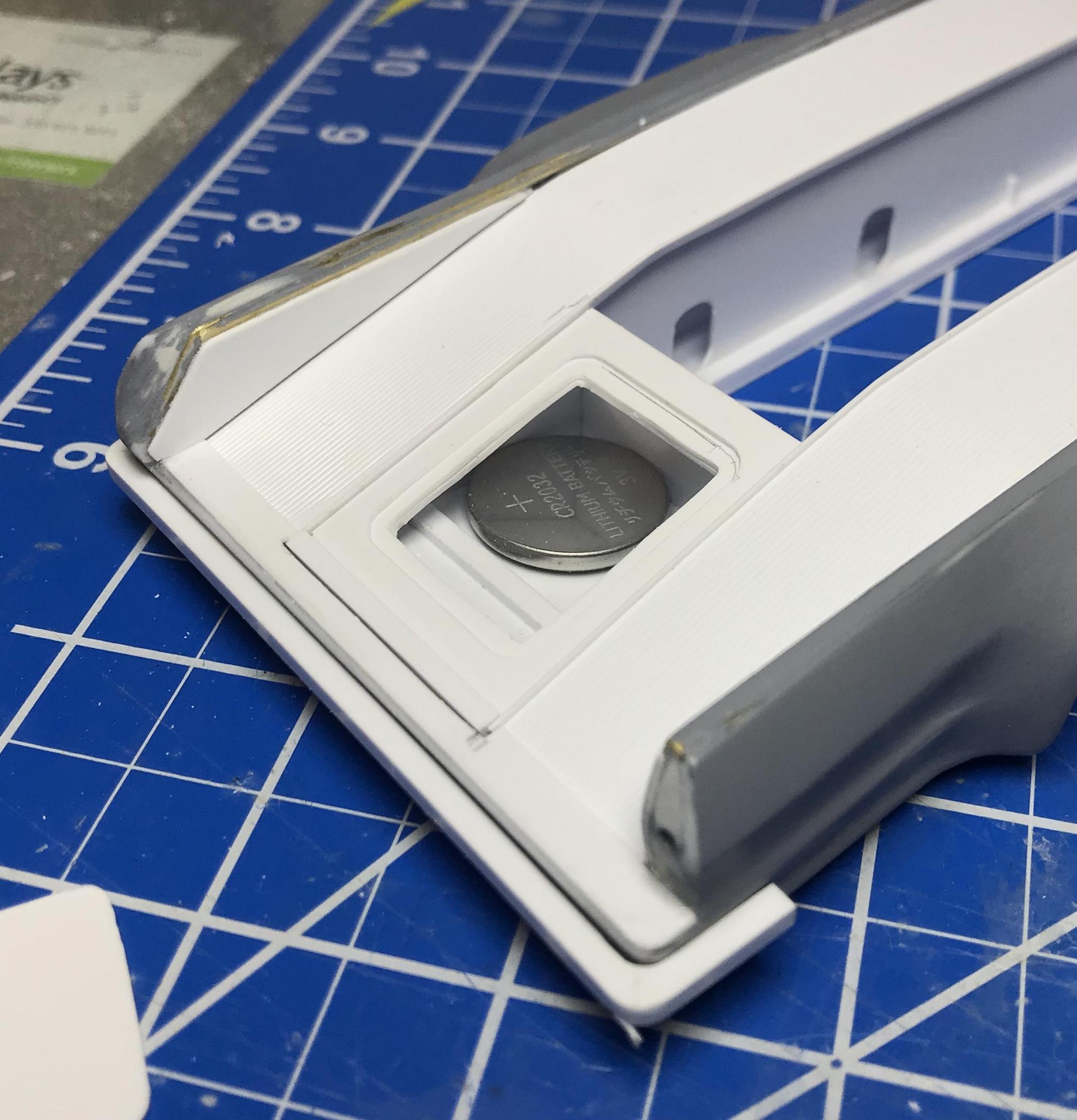

Then I lost it and decided to put a lithium battery compartment into the tool box and add working LED lighting elements.IMG_E2827.thumb.JPG.ab9e1f40f3c396fe0894b84373deee02.JPG
I found evans designs website and ordered up several LEDS, connectors and battery holders.... Ive decided to use 3 color fade 3mm LEDs to have a colorbar style headlight, some cool white random flickering leds behind the TV's and finally some tiny little red leds on the swing up taillight/gate.  Here are some Mockup Videos!
I took a small lathe pass on the inside of the tires to open them up to more of 15" than a 14".... then added some 1/24 scale wheel lips to the Scenes Unlimited Wheels..Subtle change but this helps give it more of the 70's showrod look.
IMG_2795.thumb.JPG.99935b4fdfd12809578bb5fb5a20966d.JPGIMG_2791.thumb.JPG.ab8bf1cc6412c51f41cec561fb22c77c.JPGIMG_2793.thumb.JPG.531fc9895b30351efaa5644e28367158.JPG
Finally I got the chassis in the 2-stage Splash Paints Mazda Soul Red Basecoat.... it looks a lot like a vintage candy apple red but sprays a bit easier... however just a bit easier, there were a lot of nooks and crannies in this chassis and the candy top coat was a challenge... its not perfect but it is just a chassis. ?
