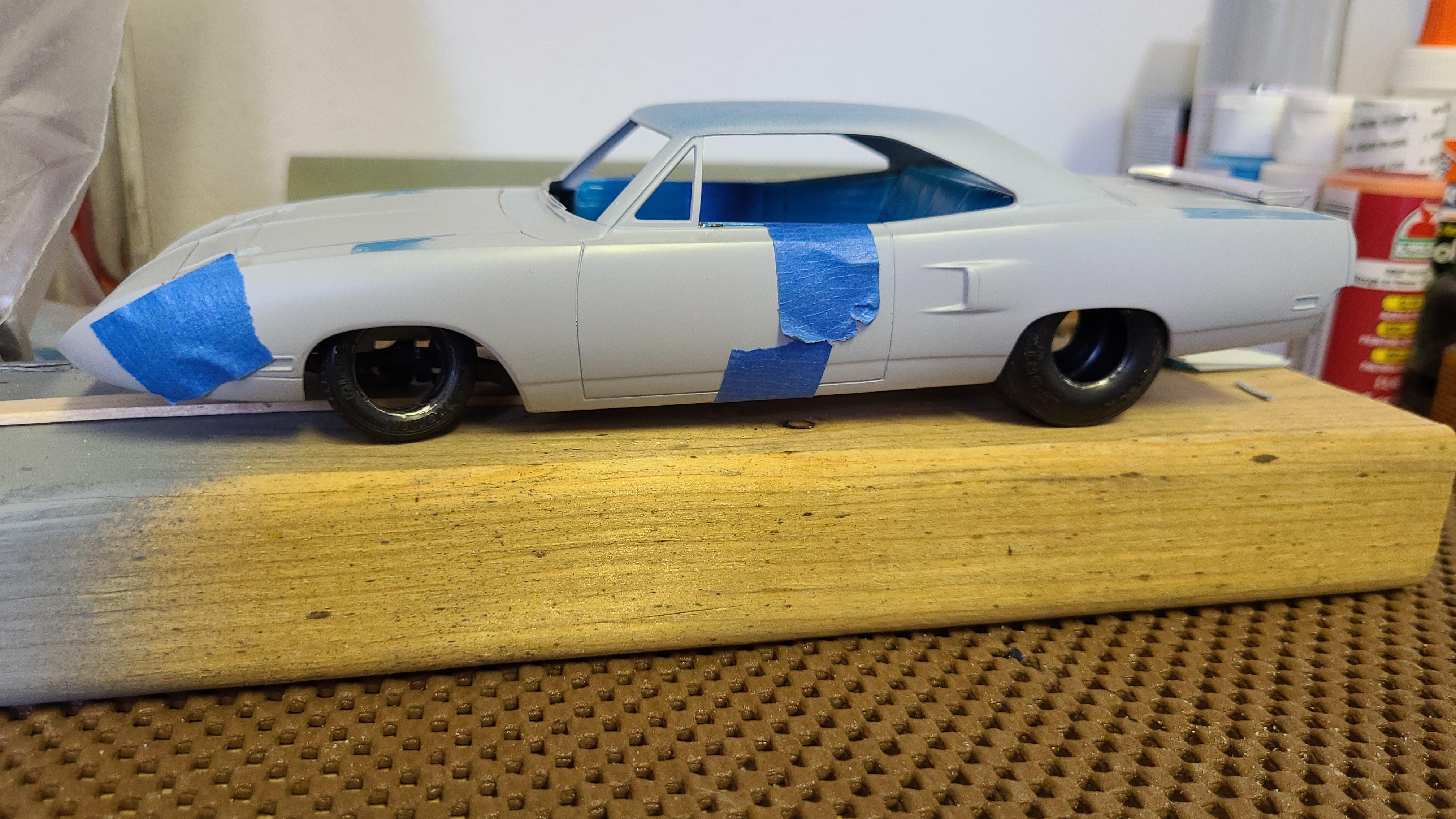

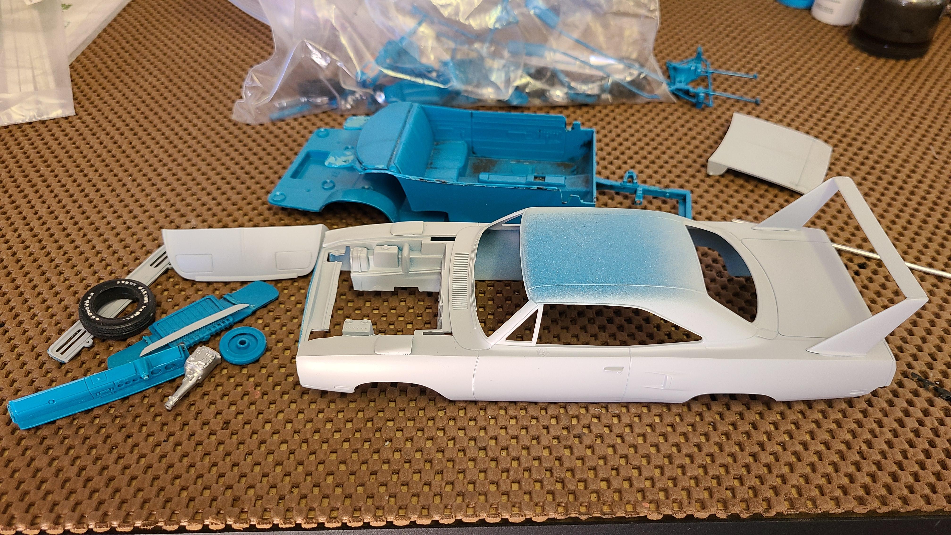

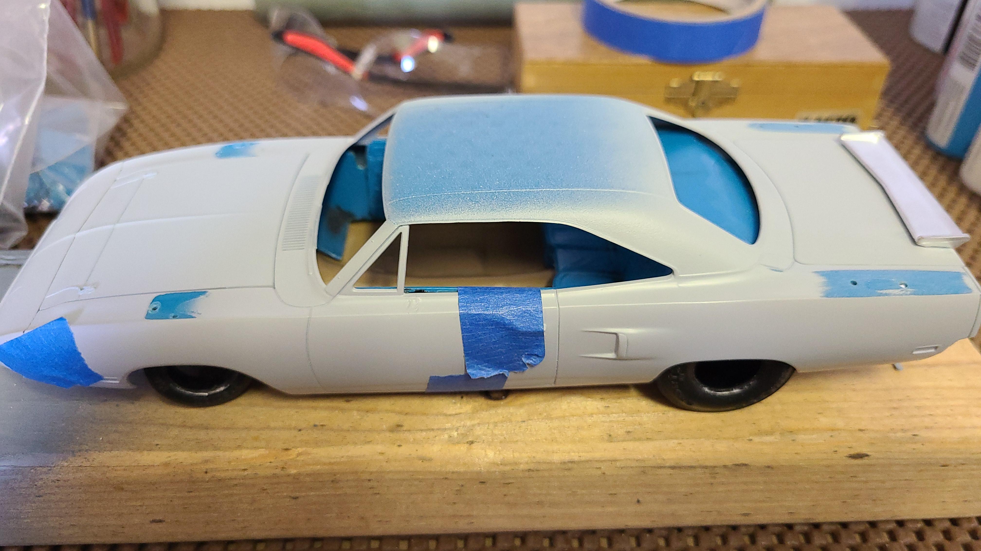

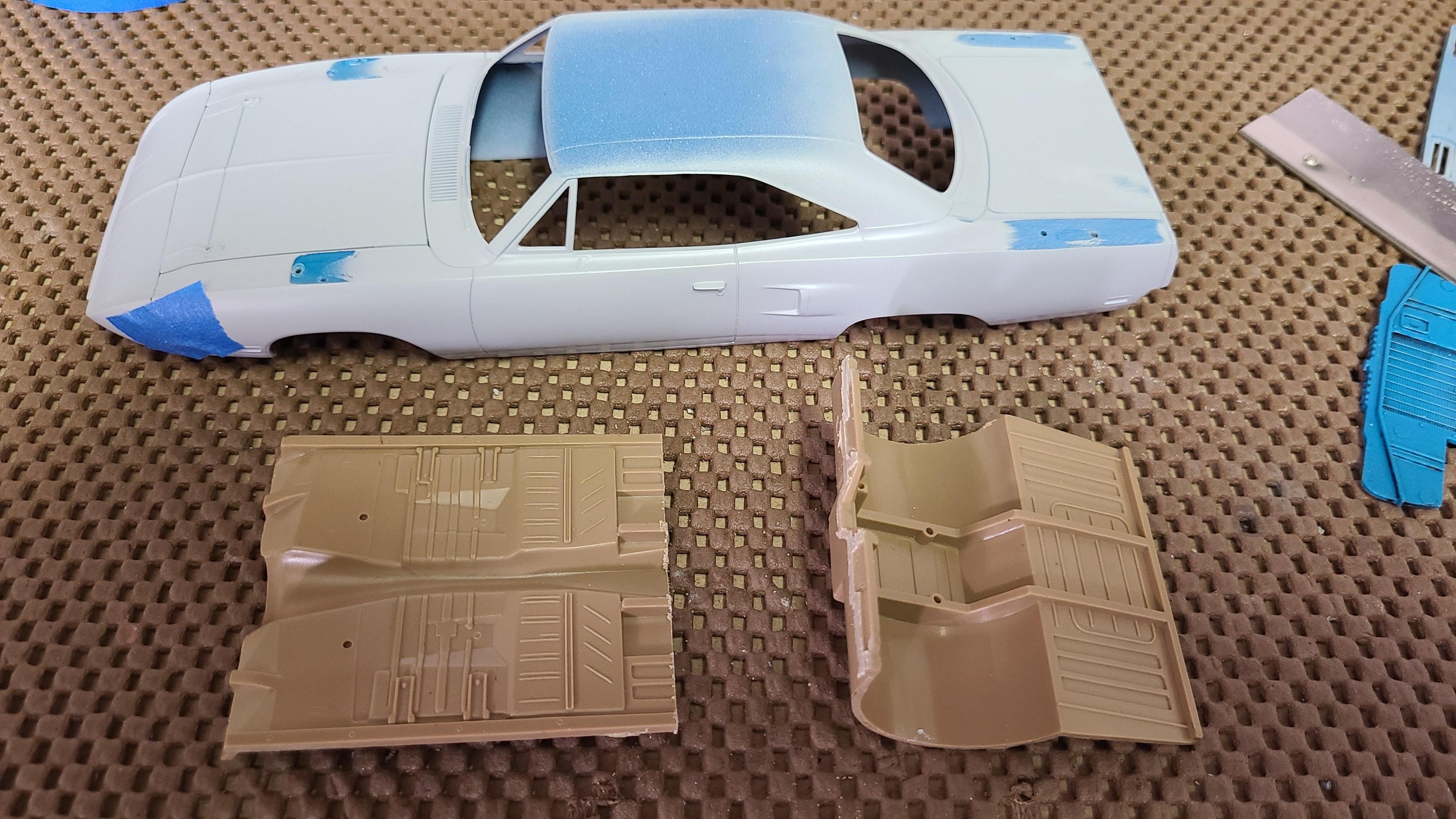

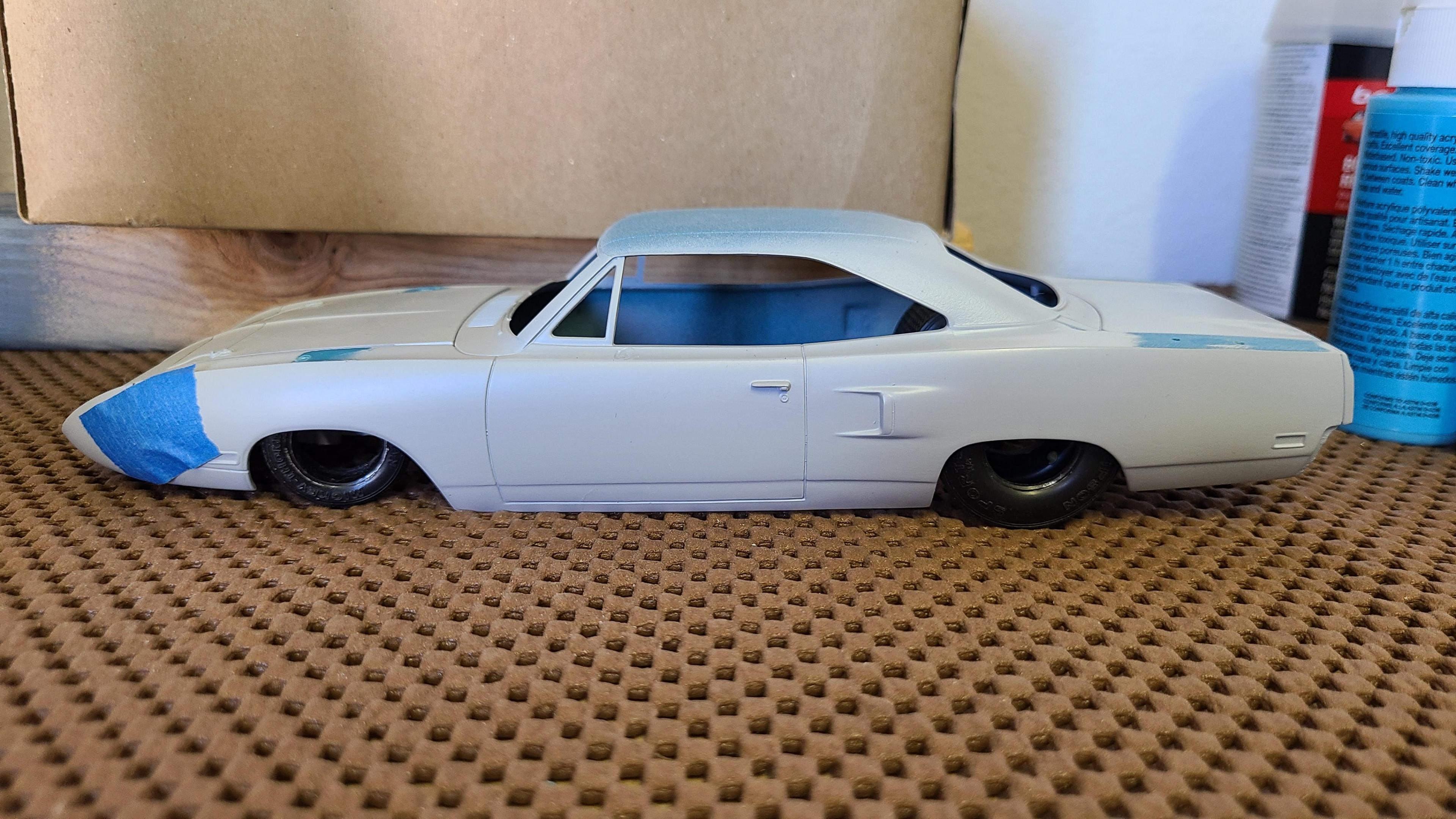

Salvaging this from the scrap yard. One of the few remaining kits I have left from childhood. Built this box stock, originally in '92-'93. Time has not been kind to it. Couldn't trash it though, so what to do? Pro-street, yes? Kitbashing an AMT Coronet Pro Street chassis from the parts box, and possibly a DOHC Hemi. I think it looks neat without the wing, but wouldn't be a Superbird without it. Have to remake one of the wing uprights, as it broke on disassembly. Scratchbuilding has not been my forte, so this should be interesting.
If you think it looks good without the wing, build it that way. It's YOUR model. FWIW, I'm planning to rebuild a JoHan Superbird as a modern road cruiser without the wing. Drive on! B)
Hi Shawn, I am a lover of all things pro street. You are off to a great start, I will be watching. Really like the mock up ride height!
Cheers, Steve
Not that it matters but I would leave off the wing. At most maybe a small lip spoiler on the edge of the trunk lid. Your mock up with out the wing this really looks slick. Great job on the chassis.

My two cents: this car with no wing is thumbing your nose at history... but we live in 2020, right? You may want to borrow from most of the "retro-design" cars of late, like the Mustang, New Beetle, Thunderbird, Camaro and all, improving on the original design cues.. and seriously shorten the pillars of your oem wing. Might get rid of the frayed base section (less scratchbuild to do), and make it more contemporary? Still a wing, but revisited.

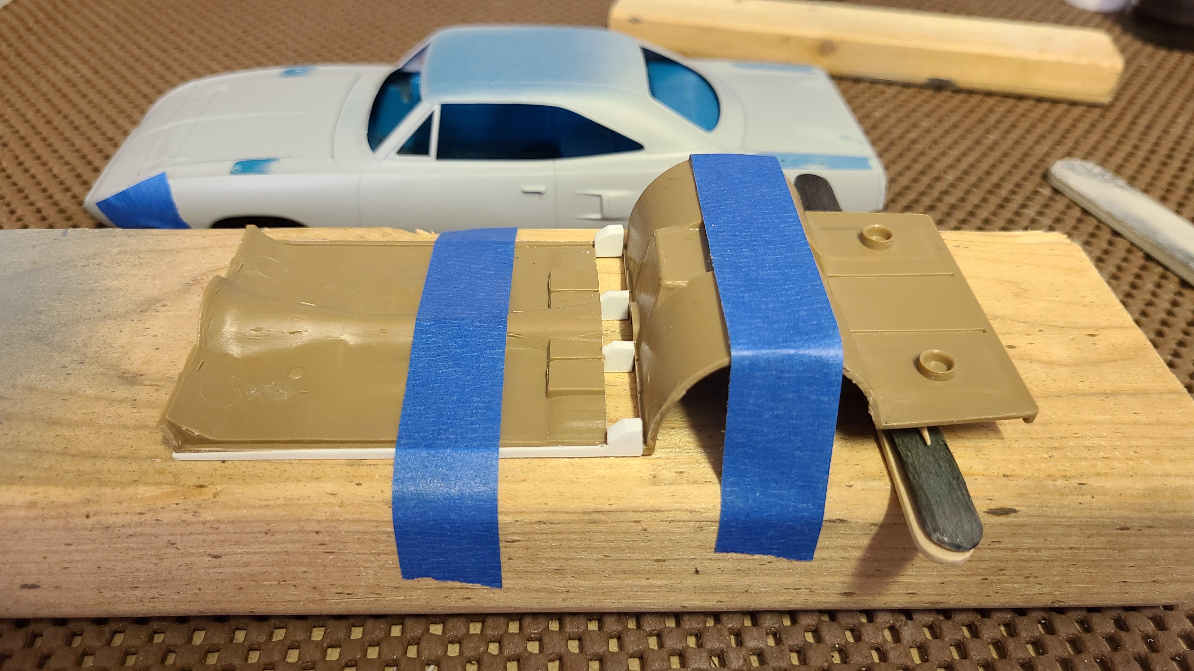

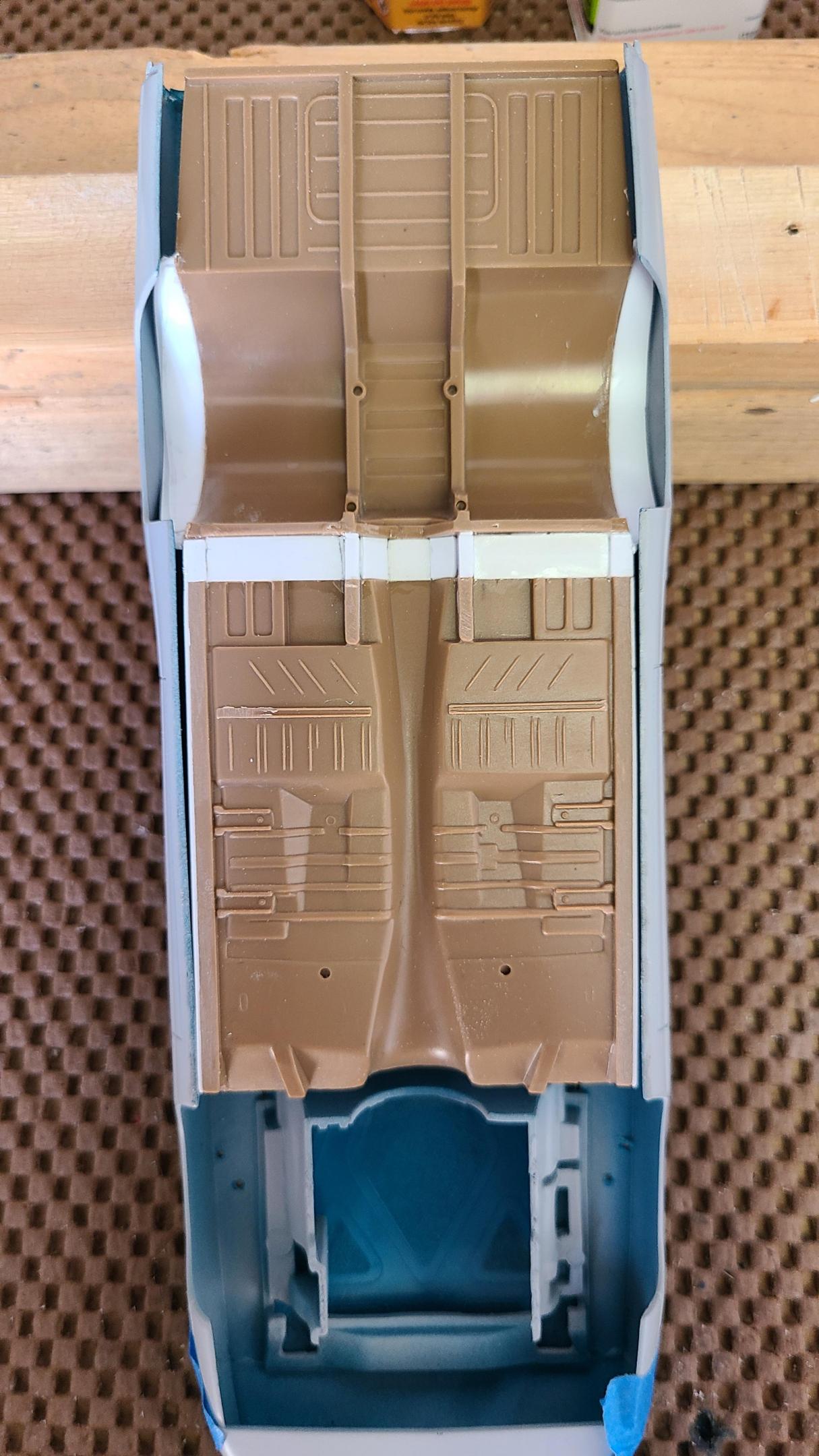

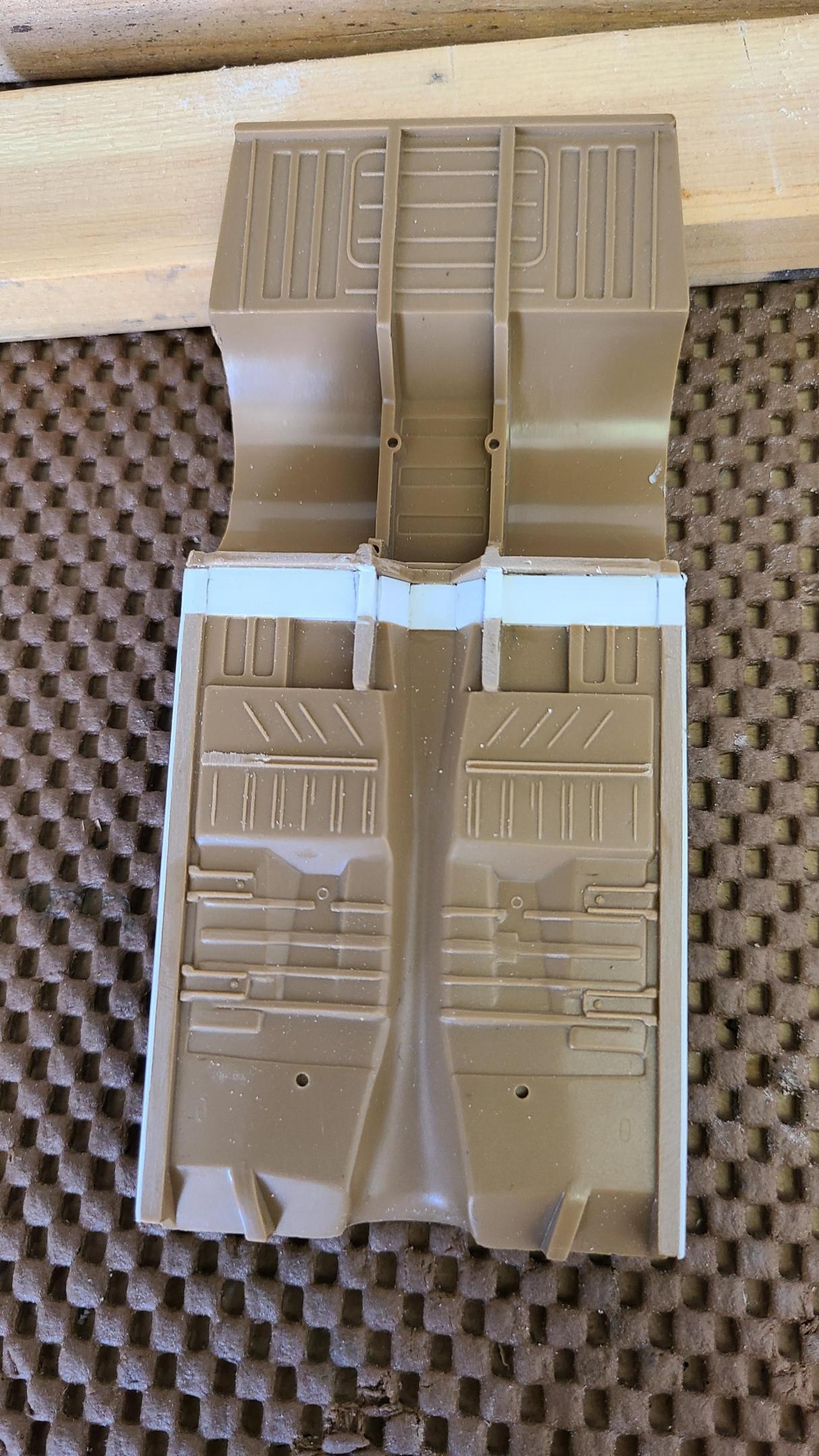

Got to spend a little time at the bench today. Too many other projects. Cut the floor out of the interior bucket to drop the body over the pan a bit more. Might remove a bit more. Think I need to lengthen the front subframe a bit, to center the front wheels. Looks like it'll place them too far back. Also leaning towards modifying this wing for it. Cutting the stock wing down doesn't do it for me. As a "pro-street" car, ideally it would have to be streetable, including a functional trunk lid. A cut down factory spoiler wouldn't allow for that. Plus, I'm digging how sleek it looks without it.
I love it without the rear wing too!  I know the huge rear wing kinda the whole thing with these...but I dig how sleek it looks with it gone too!
