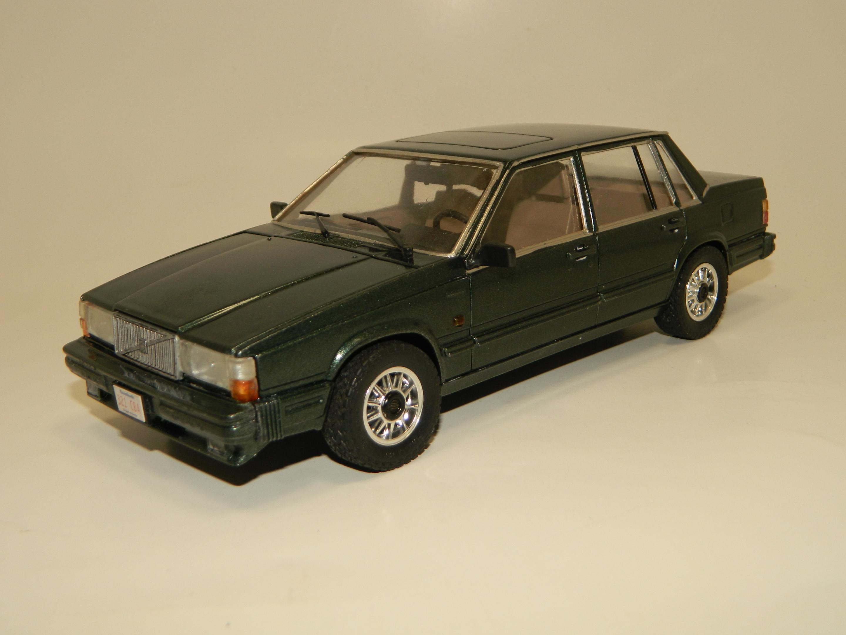

Looks great!  Definitely different from mine.  It took me a while, but I figured a way to lower mine so it didn't look like a 4X4!

After alot of thinking, I lowered it this way. In front, I didn't use kit brakes. Glued styrene piece to the lower suspension arm. Then drilled hole to it, allowing new stud(white part) to be mounted up(thus lowering car).
For the rear, I left out springs and the triangle structure. I drilled the center axle hole little bit bigger, allowing rear axle to be pushed closer to the chassis. I would have liked to have the suspension little bit lower in the rear, but axle interfered with stock exhaust. So that needs to modified too, if you want lower rear even more.
