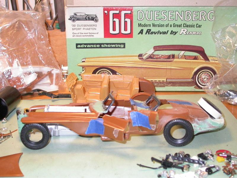

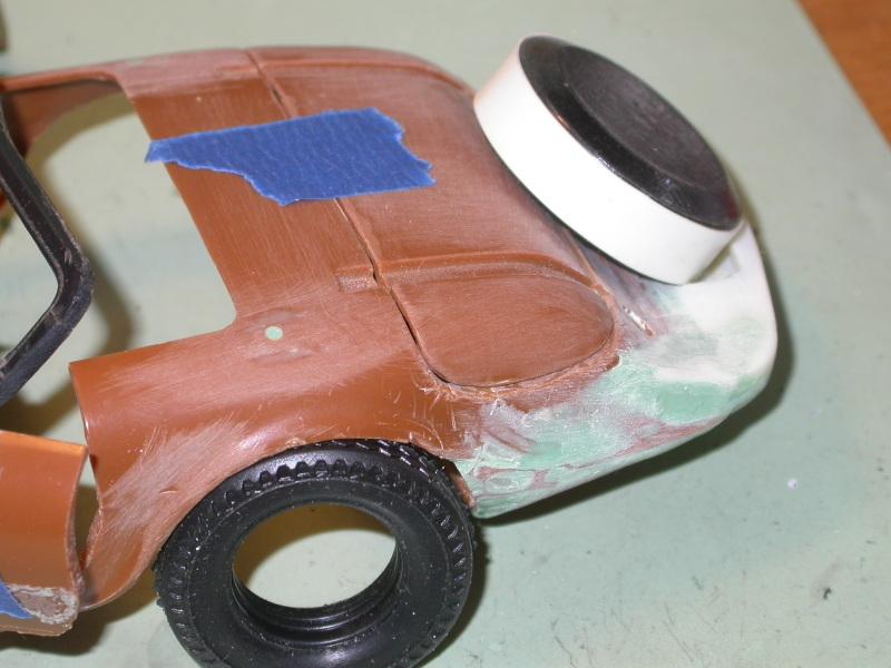

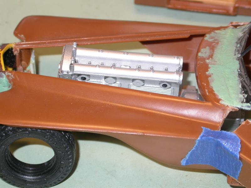

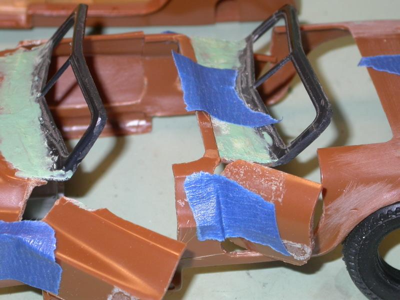

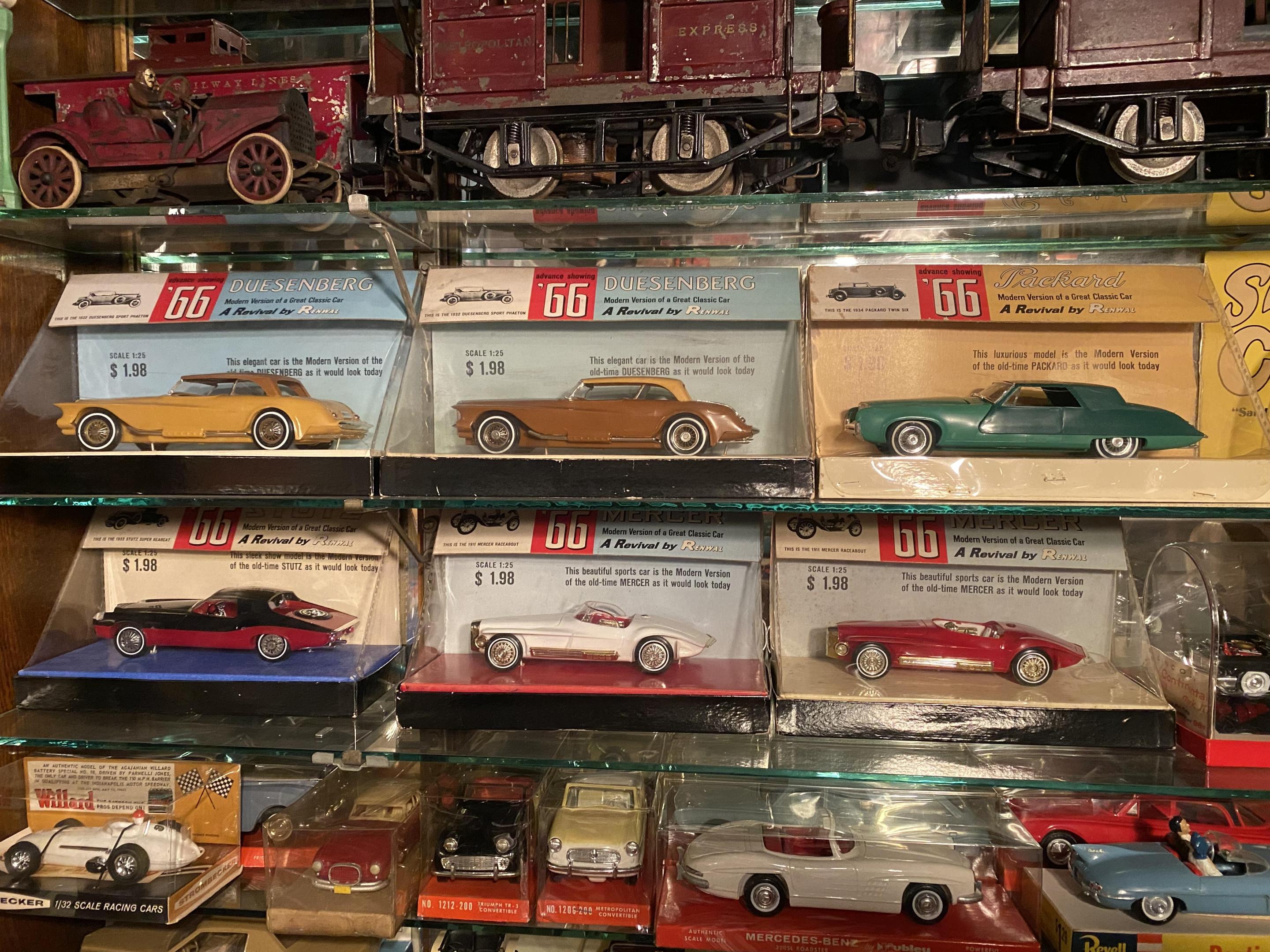

Paul Payne Posted September 24, 2021 Posted September 24, 2021 The Renwal Revivals have had a cult following since they were introduced in 1966- 55 years ago! These 7 kits are unique to our hobby and are eagerly sought after. This thread intends to bring everything about these kits together in one place. I have been fortunate enough to have eventually found at least one of each of these- some built junkers, some clean builds, some unbuilt, and two projects involving restyling. My first restyling, started over 30 years ago, was of the Duesenberg- at that time I was obsessed with opening doors, as well as opening rear cowl and trunk- the kit includes a fanciful V-12 engine which Duesenberg never made, so a Monogram Duesenberg engine was included in the modifications. I also added a sectioned Monogram grill and a continental spare tire. I didn't really care for the Packard front end, so I also started rebuilding it, but admit to never really thinking it through. The roof and rear deck have a fabric texture but unfortunately have some sink marks- have not figured out how to fill them and and restore the texture- maybe sand smooth to make the body all metal. I would love to share thoughts and pix about building, restoring, and modifying these kits, as well as reaching out to resin casters to recreate missing parts and builders who would be willing to loan parts for reproduction. I have heard that some forum members reproduce model boxes, and also photocopy instruction sheets. Let's pool our resources and see what happens! Another exciting possibility is is that maybe- MAYBE- the tooling for all these still exists and could be resurrected! Let us hope- and earnestly request the possible new owners to make this happen! So here are some pix of mine- enjoy! 1

Bucky Posted September 24, 2021 Posted September 24, 2021 I was always intrigued by these Renwal kits. I have one of each, except the Jordan and the Pierce Arrow. I actually have two Mercer kits. One has the body parts molded in white, the other has the body parts molded in red.

pack rat Posted September 24, 2021 Posted September 24, 2021 (edited) I've been able to find the whole set but I passed on buying the Duesenberg and the Packard; to me they just looked too homely to add to the stash, but this mockup looks kinda cool. Edited September 24, 2021 by pack rat
Paul Payne Posted September 24, 2021 Author Posted September 24, 2021 Mike, glad you like it, most of the basics are there, but still need to work out the front suspension and possibly axle skirts under the front fenders- something sort of like 30's Indy and GP cars. I now have a centrifugal supercharger for the engine, at least! NOT looking forward to making, installing, and adjusting all those hinges! BTW, the tires are from a 1/32 scale semi truck. For a project like this, I gather a lot of potential parts, then gradually pare them down to the ones that work best. This project is over 30 years old- when I get to it again, it will not only qualify for a bring out your dead, it may qualify for fossilization! That putty should be dry..................

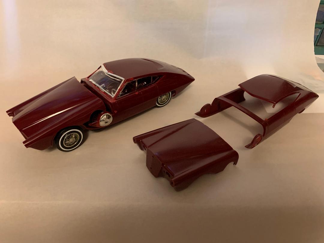

Scott Colmer Posted September 25, 2021 Posted September 25, 2021 Excellent thread, Paul. I am wondering how much massaging it took to get your Pierce Arrow to looks so nice. Chris - The Esquire magazine did not have the Pierce Arrow? I would love to see front and rear styling renderings. When I was reading Larry Greenberg's Atlantis interview in MCM issue 209 there was mention of the Renwal molds. Hmmmm. Scott

Paul Payne Posted September 25, 2021 Author Posted September 25, 2021 The grand classics were grand in part due to their engines- Duesenberg with a dual overhead cam straight eight with 320 hp, Packard with the twin six,, Bugatti Royale with a 775 cubic inch 300 hp straight eight, Marmon and Cadillac with big V-16's, Auburn with a V-12- the modern interpretations never had very impressive engines. Regarding the Pierce Arrow, some careful disassembly, Future, and reassembly was all it really took on an original clean build- the parts cars either have broken windshield posts and the other one has a lot of glue damage around the windows-tube glue seems to bleach that nice maroon plastic.
keyser Posted September 25, 2021 Posted September 25, 2021 Posted in other thread, reposting here for Paul. Cool these are getting interest. A few threads on here. The Pierce, Duesy, and Packard are huge. Monogram Duesenberg length. Need 20-22” wheels to keep them looking normal with more modern tires. The Jordan, Bugatti, Mercer, and Stutz are closer to 64 Impala size. Mercer smallest, real car based on 289 Cobra but bigger than Monogram 1/24 427 Cobra. There are color flips, suspect for non painted variety. Likely molded in single colors and trees separated and mixed in packaging. Stutz was red over black, and also black over red. Duesy was dark tan over light tan, and vice versa. Mercer white over red and red over white. Bugatti was light blue over white and white over blue. Packard same with dark and medium green. Jordan’s were dark and light blue mixes. Only car I’ve not seen a flip is the Pierce. All seem to be maroon. I’ve got color flips of all unbuilt, and builders many one owner in progress. Updating to more modern running gear, fixing some details on a few, Bugatti especially. Fun kits. I’ll see about some pics when I get time.
