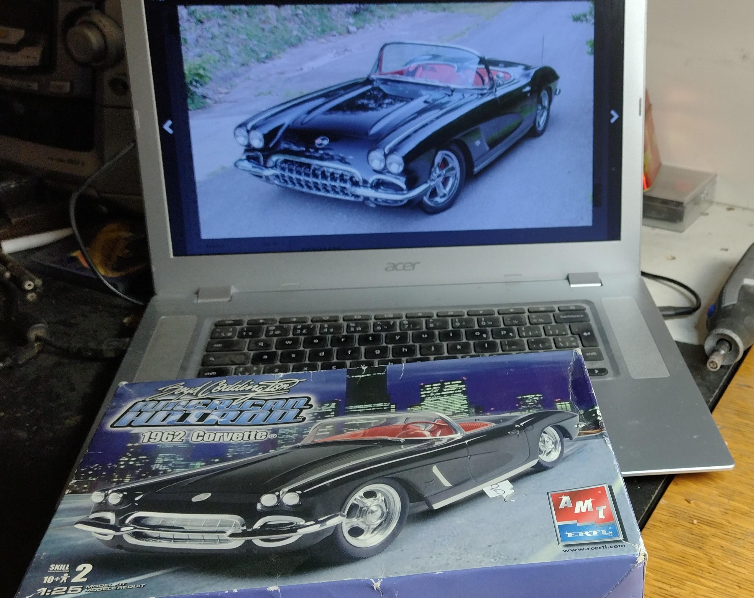

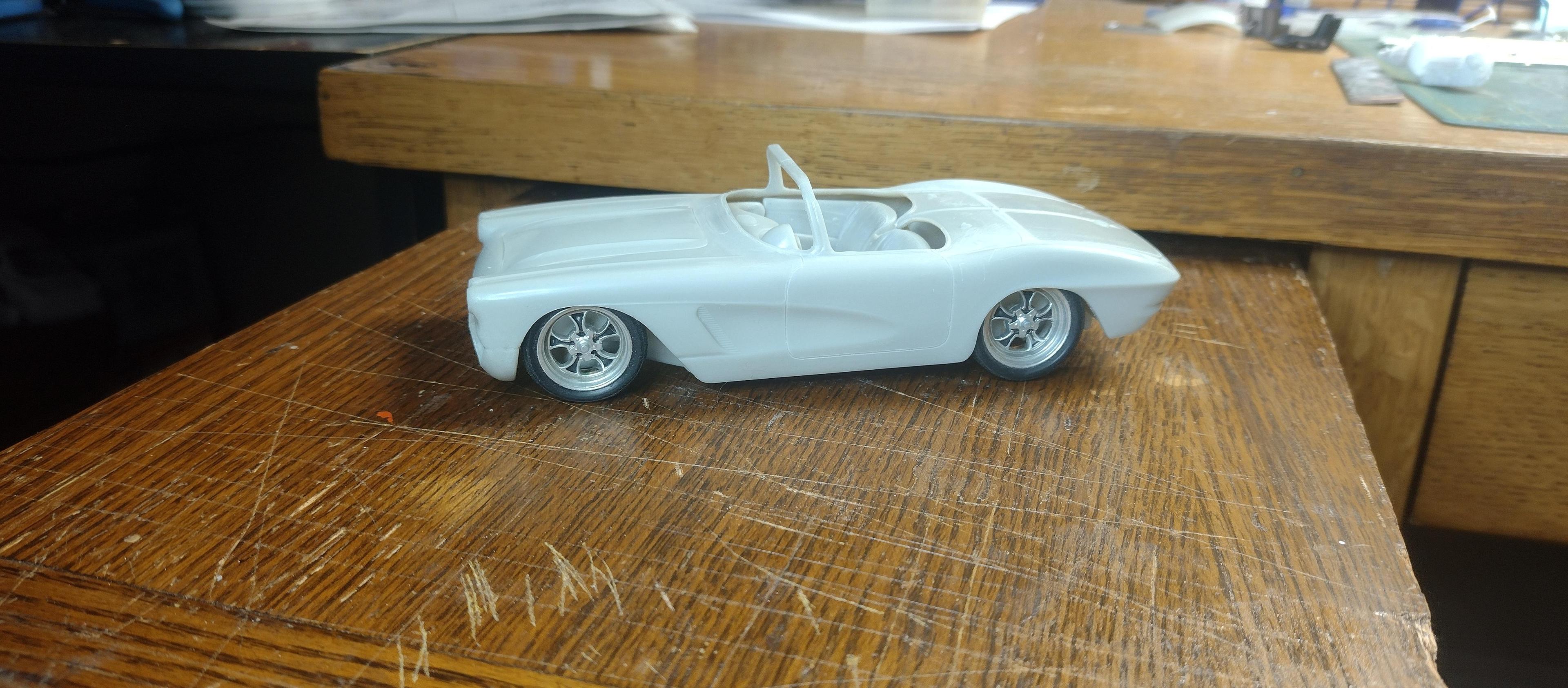

Belugawrx Posted January 16, 2022 Posted January 16, 2022 (edited) I will be in with a '62 Corvette. I won't be using the skinny tires or oversized wheels, and II will be lowering and adding some ground effects.. Try not to 'body work' it too much as this usually ends up not getting finished in time..lol Cheers Cannonballers!! Edited January 16, 2022 by Belugawrx 2

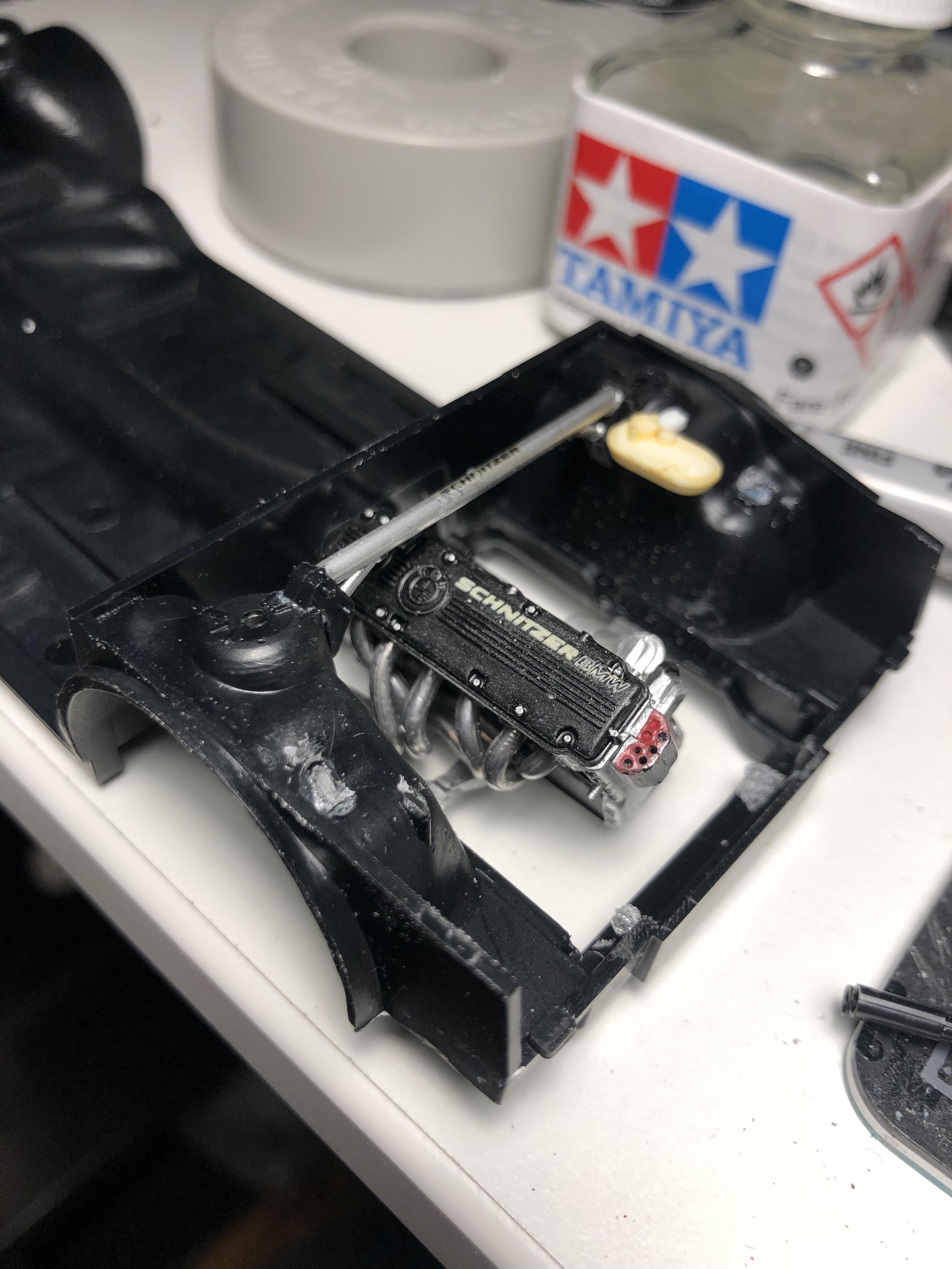

Spottedlaurel Posted January 16, 2022 Posted January 16, 2022 On 1/15/2022 at 11:12 PM, Mattilacken said: #1 1987 BMW 635 CSI made some progress today. Have decided to make a nice NA engine so I started on a new exhaust and I have also drilled the holes for the plug wires both in the distributor and the head. Thinking how I can make the angled plug wire connectors, suggestions? I am also thorn about the intake, “stock” GR.A intake, webbers or separate valve body’s and fuelinjection… Expand Good to see it progressing Anton. I should get those road car parts off to you tomorrow, I've just packed them up. 1

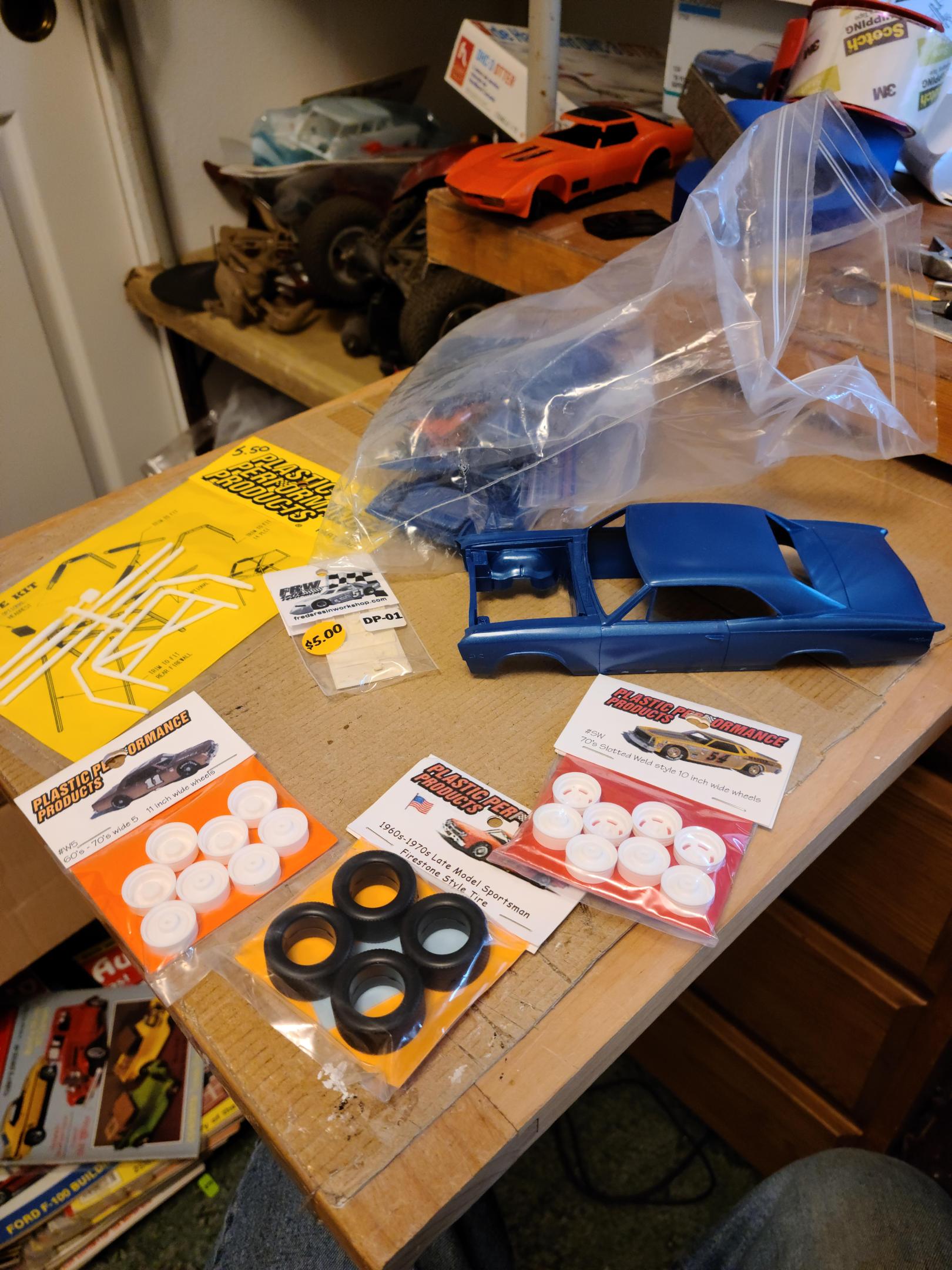

Sam I Am Posted January 17, 2022 Posted January 17, 2022 I really feel bad about throwing my hat in the ring...again, seeing as I have yet to finish one. But here goes. Pile of parts from an old buildup '67 Chevelle, and a few period race car parts. It will have a big block....of some kind. 1

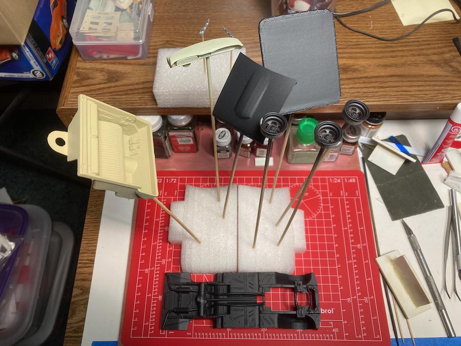

Lunajammer Posted January 17, 2022 Posted January 17, 2022 End of weekend update. Body has been primed and sanded, misc. parts have been sprayed, revealing some color clues here.

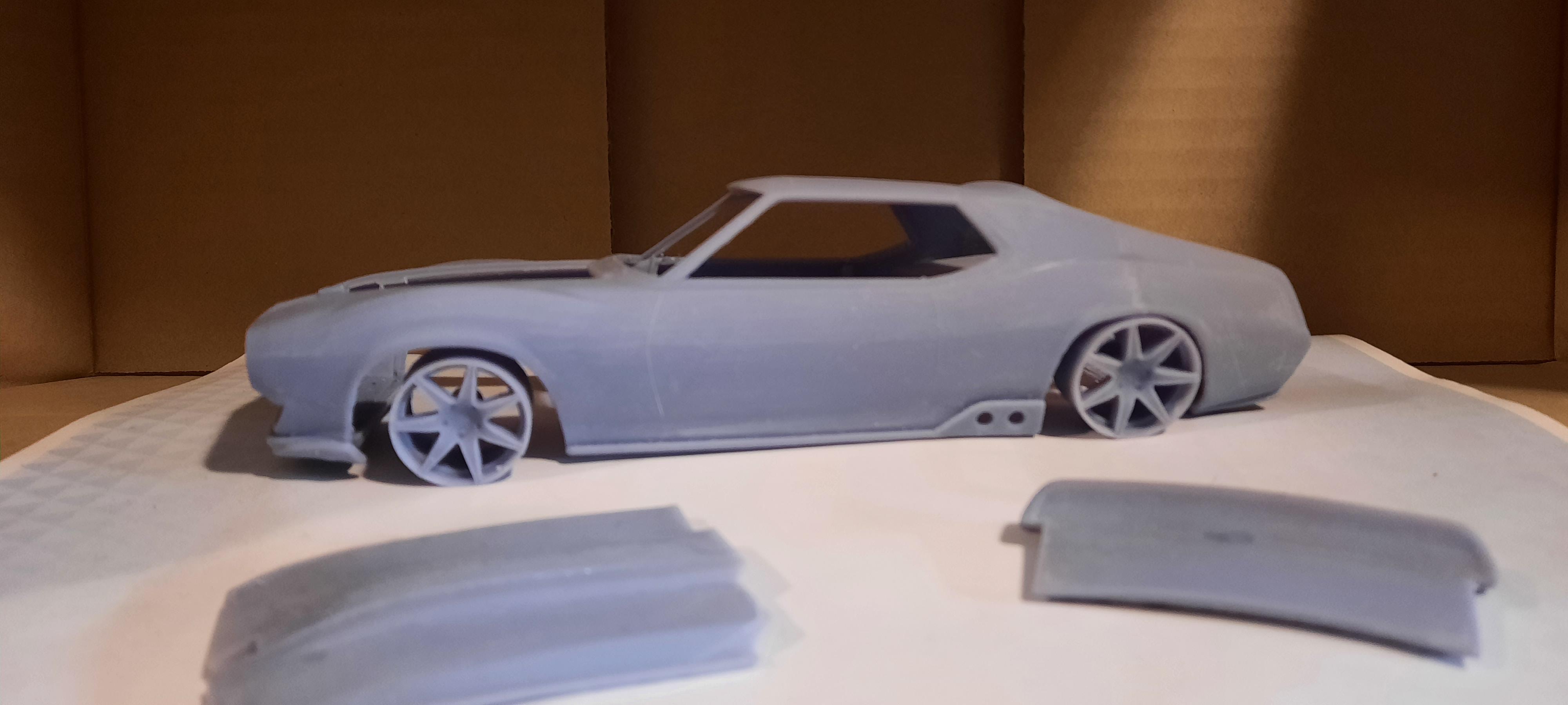

Jhedir6 Posted January 18, 2022 Posted January 18, 2022 (edited) Update on my '71 Javelin...finally.... The body was printed in two pieces and are now "welded" together. Resin welding is a process where you take raw liquid resin and use it as a "glue" to marry two resin halves together. Once you have the liquid resin on the parts you hit it with a UV light source (I have a couple mini pen flashlights) and it bonds the pieces together. It also fills in any gaps, then you just sand the surface. If you look over the rear wheel well you can see a faint line where I put the two halves together. I also went into Meshmixer and removed the rear deck lid and printed it separately so now I have an open trunk as well. Much sanding is going to be required to fit it right. I also printed out an interior pan from a file I have for a Porsche 935. I want a "race inspired" interior so there will be no back seat. I'm still working out what to do for a chassis. Likely this will be a 3D printed item as well with a 4 link rear end and sitting on airbags. I also printed up the Mustang GT500 wheels, and really like the looks of them but I didn't like the tires as much so I'll either reprint them or maybe find some kit ones from a parts box. And lastly.............."Got a Hemi?" I just got this file last night, and just finished setting it up to print...but it's pretty cold here today so I'll wait till a warmer day to print. This pic of the Hemi is from Pixel3D on Cults3D. There's enough space on my build plate for 3 prints at once. I've got a Hellcat for the Javelin, my TRX and another project I have going as well. Edited January 18, 2022 by Jhedir6 3

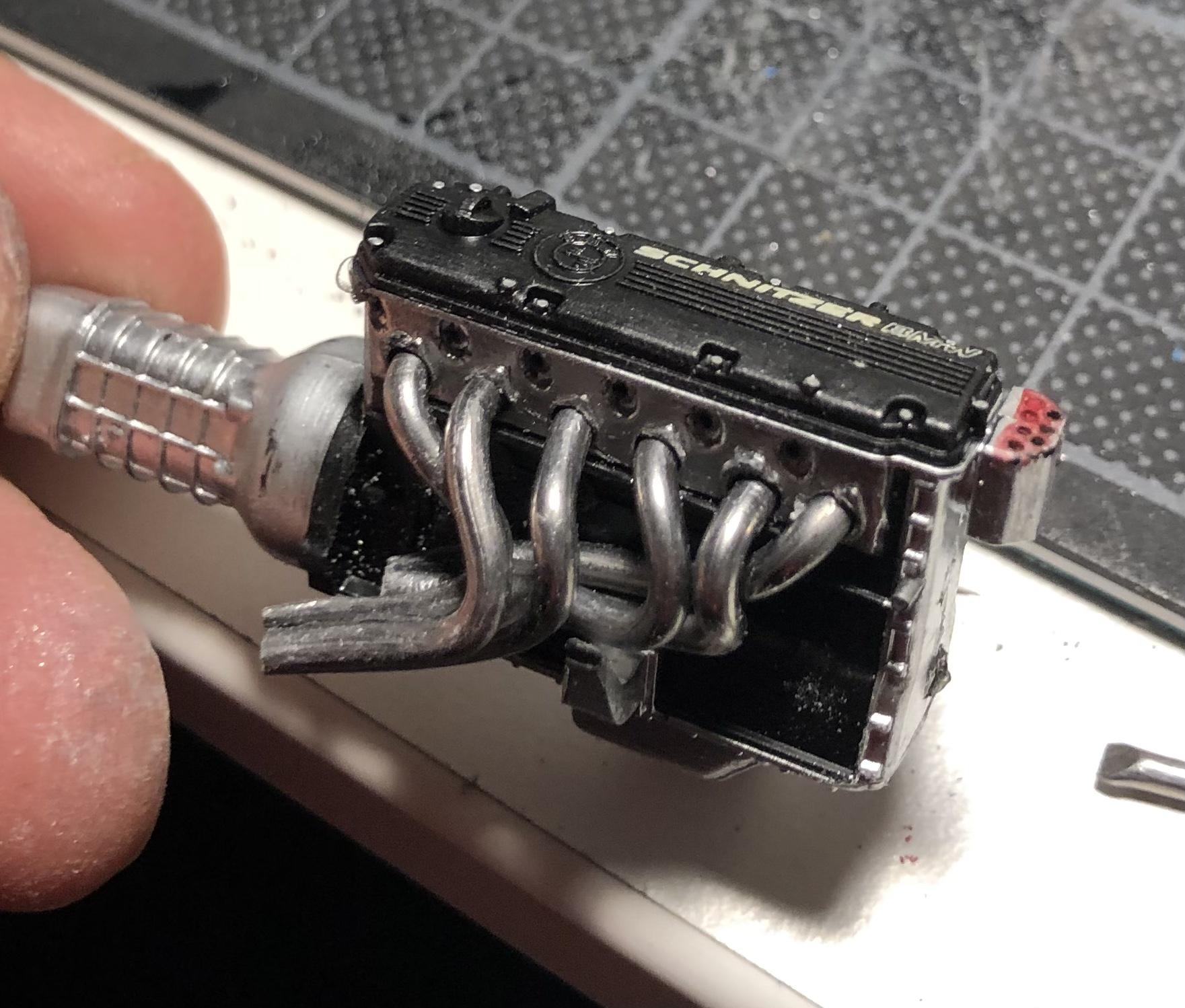

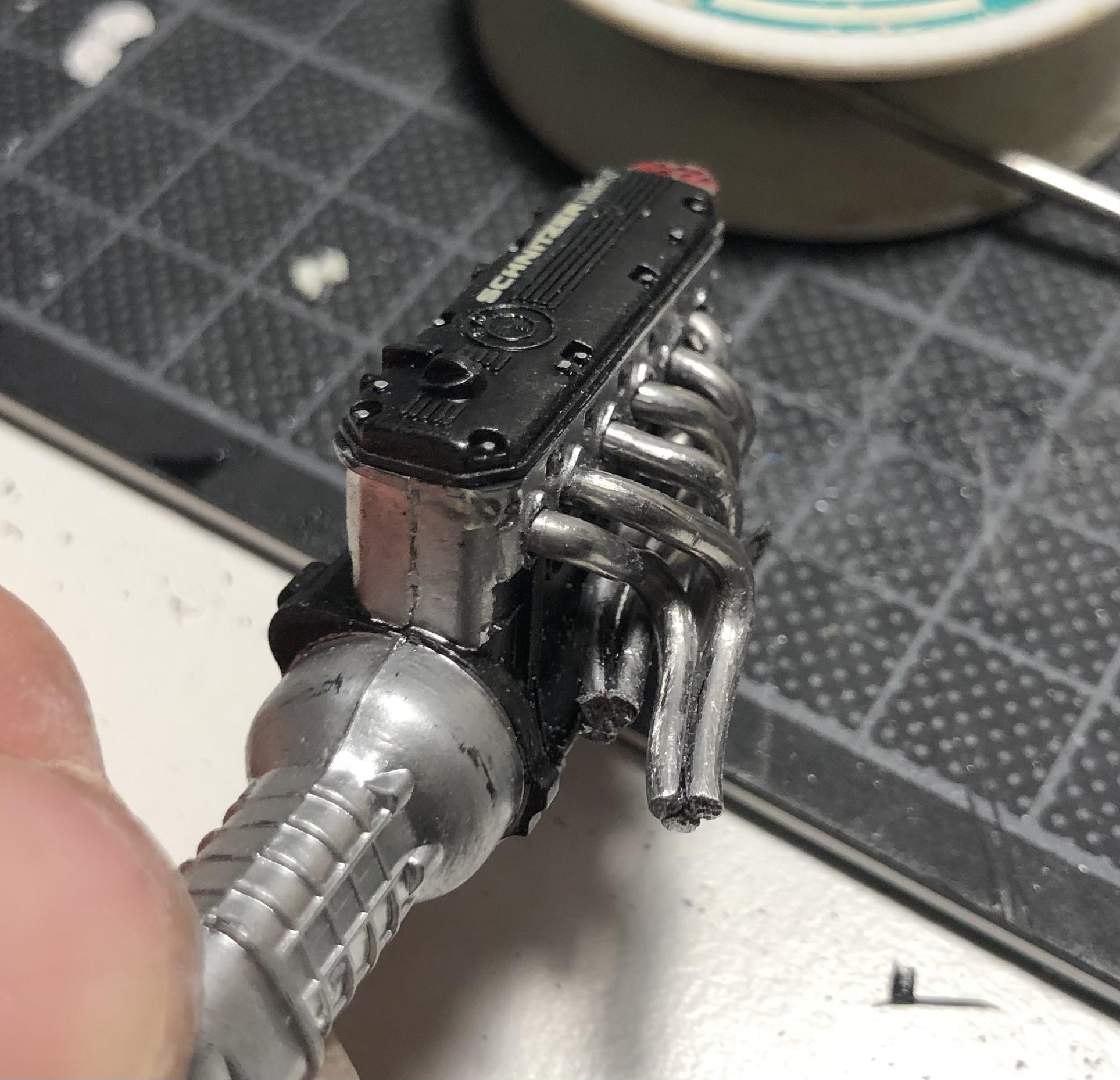

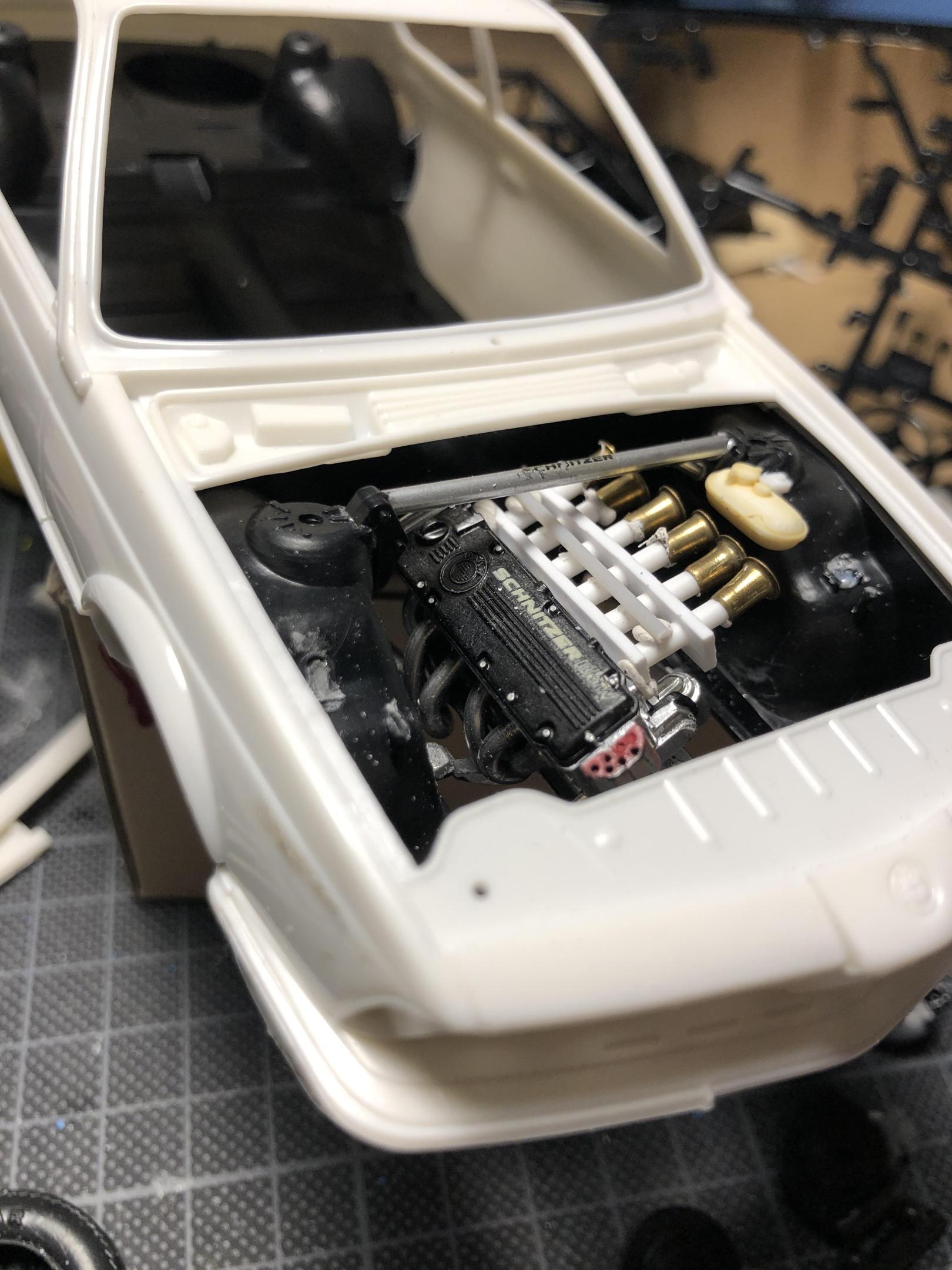

Mattilacken Posted January 18, 2022 Posted January 18, 2022 #1 BMW 635 CSI made some progress on the headers and have also filled the holes in the trunk that the previous owner of the kit had made per instructions in the race kit. Intake is next up.
landman Posted January 18, 2022 Posted January 18, 2022 On 1/18/2022 at 4:57 PM, Mattilacken said: #1 BMW 635 CSI made some progress on the headers and have also filled the holes in the trunk that the previous owner of the kit had made per instructions in the race kit. Intake is next up. Expand Nice job on the headers.

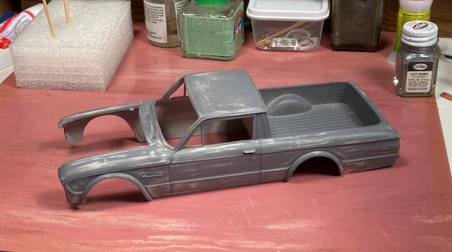

avidinha Posted January 19, 2022 Posted January 19, 2022 #15 Because the van is 1/25 scale and the truck is 1/24 scale, I was worried that the bed would be too wide, so I mocked up the bed and due to pure dumb luck, it lines up perfectly. I also scribes the extra seem I would need to change the sliding door into barn doors. More next time. 3
Jhedir6 Posted January 19, 2022 Posted January 19, 2022 On 1/19/2022 at 12:06 AM, avidinha said: #15 Because the van is 1/25 scale and the truck is 1/24 scale, I was worried that the bed would be too wide, so I mocked up the bed and due to pure dumb luck, it lines up perfectly. I also scribes the extra seem I would need to change the sliding door into barn doors. More next time. Expand Probably won't be the fastest thing on the road but it'll be able to carry enough fuel that it'll never have to stop.....ever.

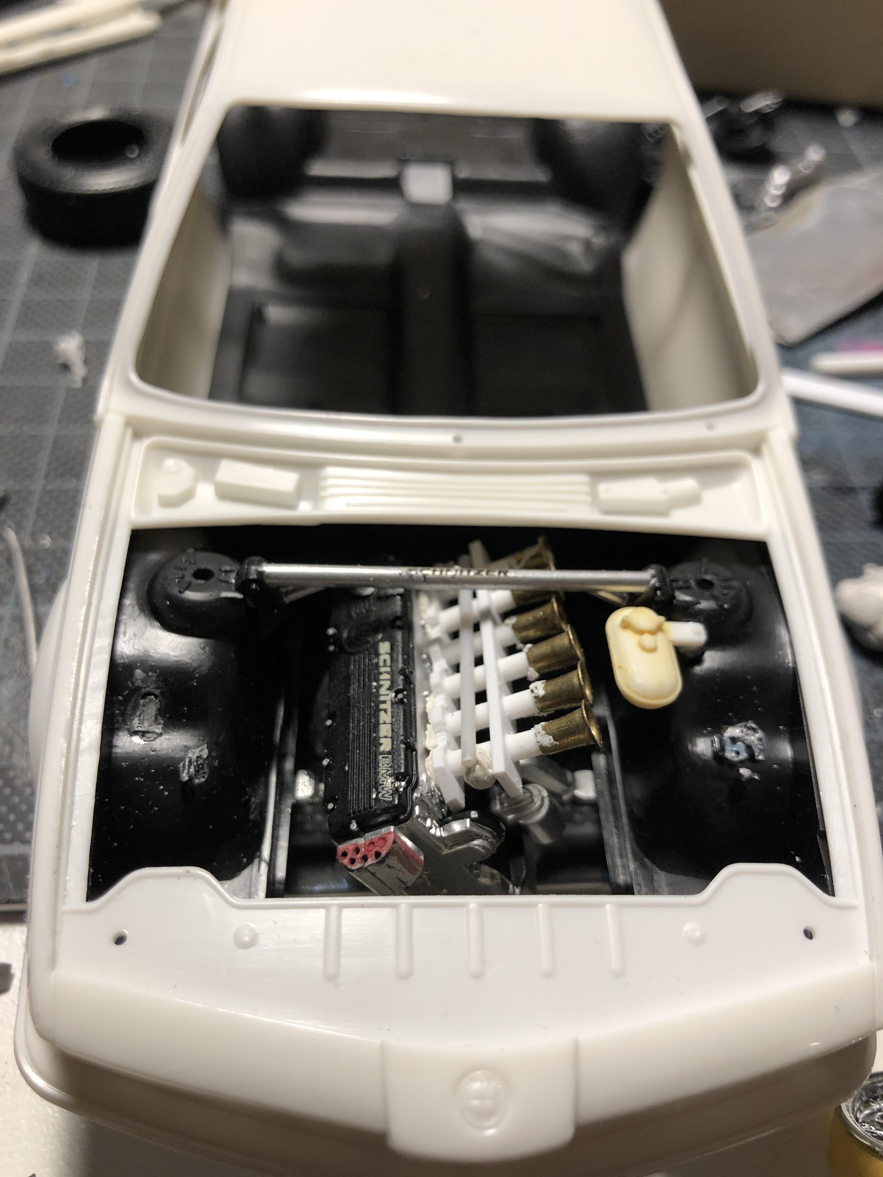

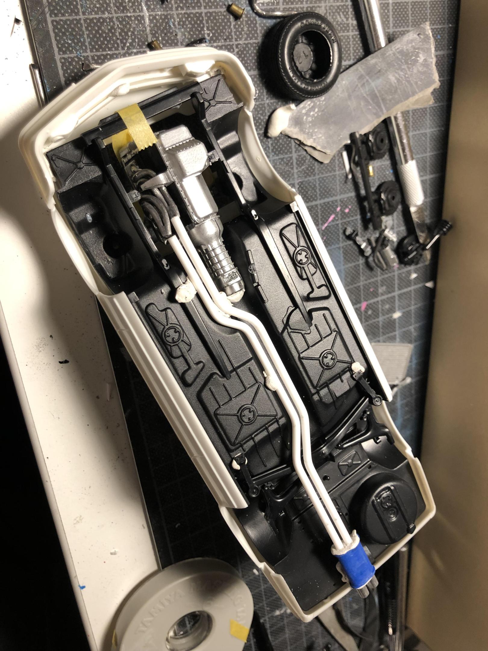

Mattilacken Posted January 19, 2022 Posted January 19, 2022 (edited) #1 BMW 635 CSI 1987 Got started on on the exhaust and the intake. Lots more to ad and modify on the intake but it’s a start. Edited January 19, 2022 by Mattilacken 1
MeatMan Posted January 19, 2022 Posted January 19, 2022 On 1/18/2022 at 4:10 PM, Jhedir6 said: Update on my '71 Javelin...finally.... The body was printed in two pieces and are now "welded" together. Resin welding is a process where you take raw liquid resin and use it as a "glue" to marry two resin halves together. Once you have the liquid resin on the parts you hit it with a UV light source (I have a couple mini pen flashlights) and it bonds the pieces together. It also fills in any gaps, then you just sand the surface. If you look over the rear wheel well you can see a faint line where I put the two halves together. I also went into Meshmixer and removed the rear deck lid and printed it separately so now I have an open trunk as well. Much sanding is going to be required to fit it right. I also printed out an interior pan from a file I have for a Porsche 935. I want a "race inspired" interior so there will be no back seat. I'm still working out what to do for a chassis. Likely this will be a 3D printed item as well with a 4 link rear end and sitting on airbags. I also printed up the Mustang GT500 wheels, and really like the looks of them but I didn't like the tires as much so I'll either reprint them or maybe find some kit ones from a parts box. And lastly.............."Got a Hemi?" I just got this file last night, and just finished setting it up to print...but it's pretty cold here today so I'll wait till a warmer day to print. This pic of the Hemi is from Pixel3D on Cults3D. There's enough space on my build plate for 3 prints at once. I've got a Hellcat for the Javelin, my TRX and another project I have going as well. Expand Good stuff there! Thanks for the info on combining resin body parts, I hadn't thought of that. I plan to print my Karmann-Ghia in resin in two parts the next time and now I know how to combine the front & rear!
MeatMan Posted January 19, 2022 Posted January 19, 2022 On 1/19/2022 at 8:30 PM, Mattilacken said: #1 BMW 635 CSI 1987 Got started on on the exhaust and the intake. Lots more to ad and modify on the intake but it’s a start. Expand Nice upgrades! 1
