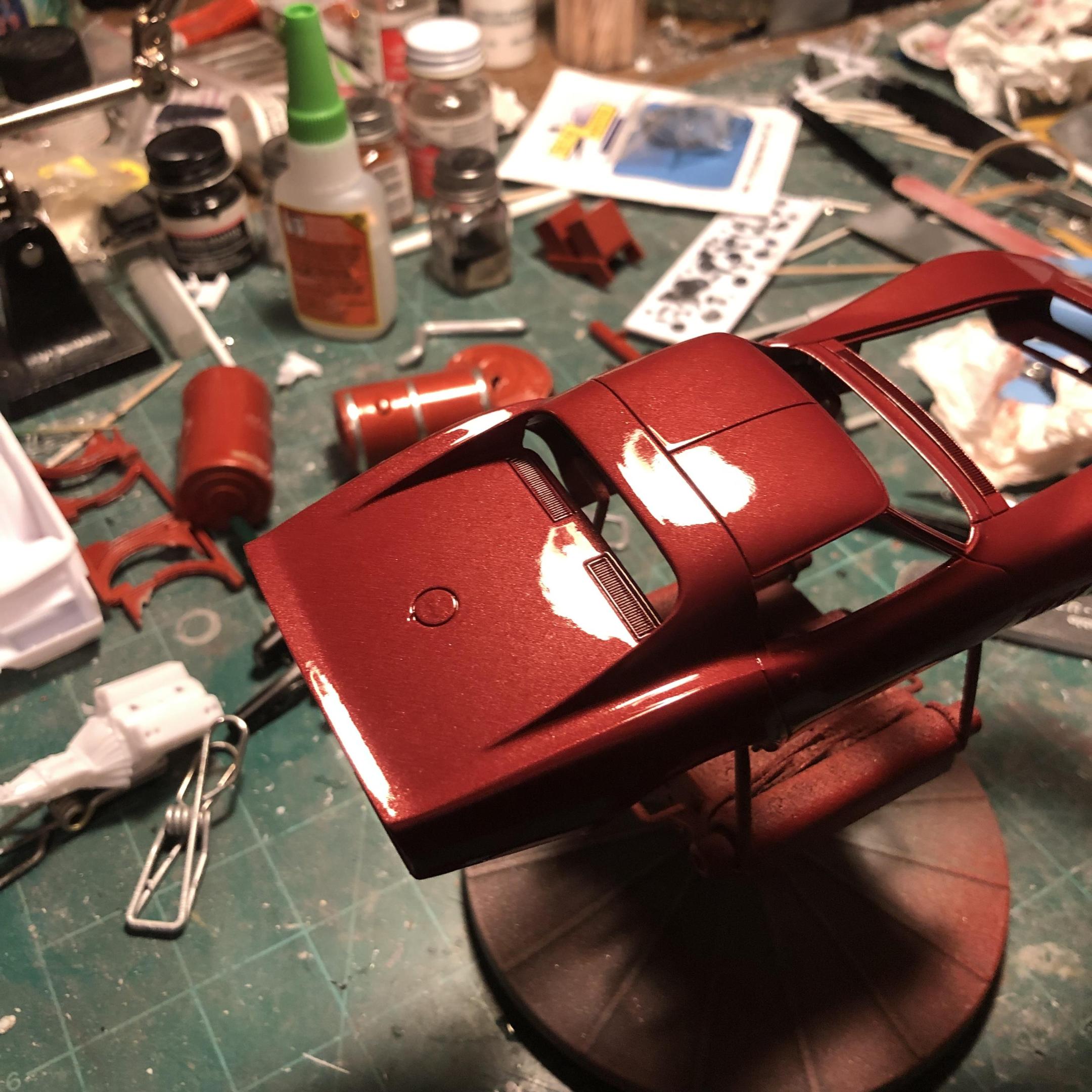

Below is a Corvette promo body wearing its factory paint.  The clear is 3 or so wet coats of Duplicolor Perfect Match Clear from the can.
 I am quite pleased with the results. This is my best clear coat job to date.  I was astounded to see so little orange peel once the clear set up.
