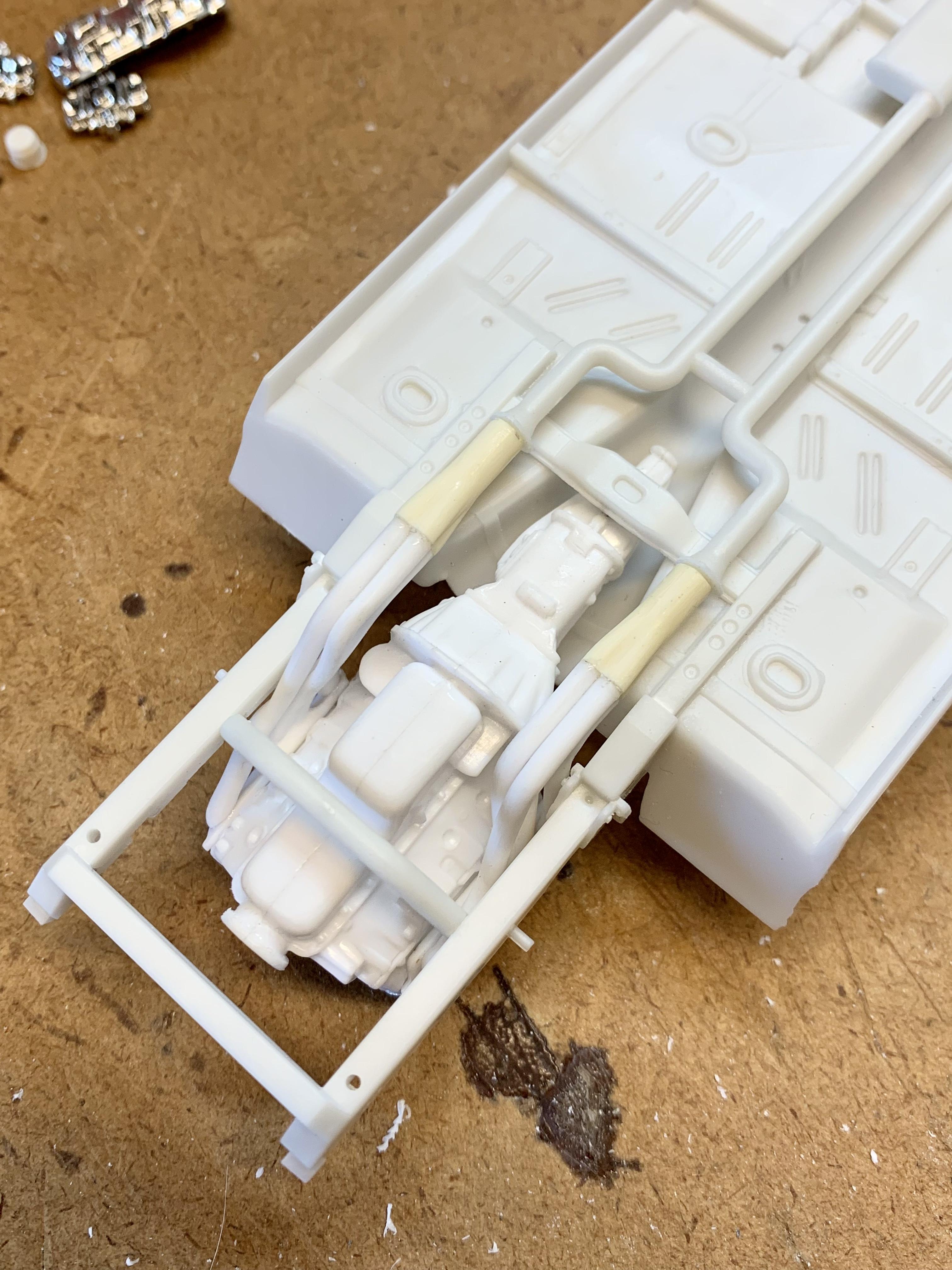

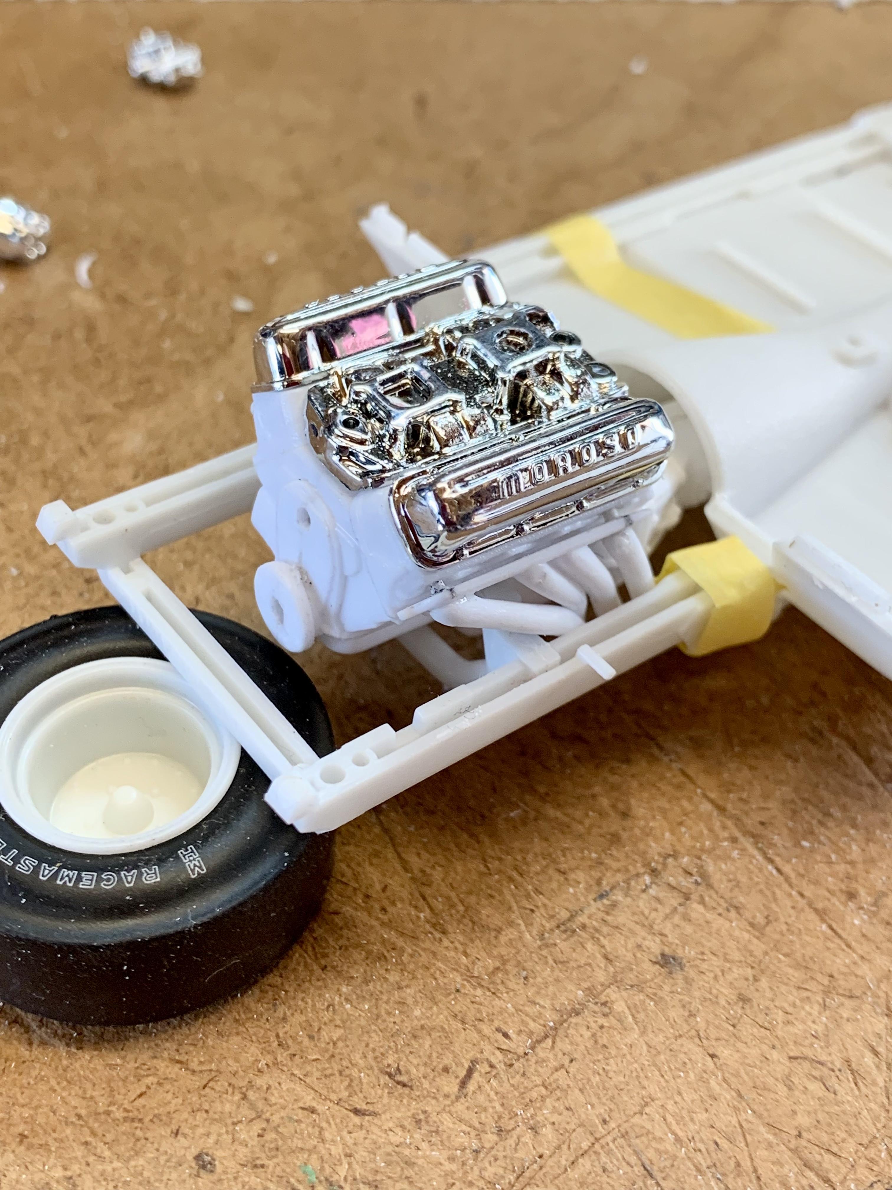

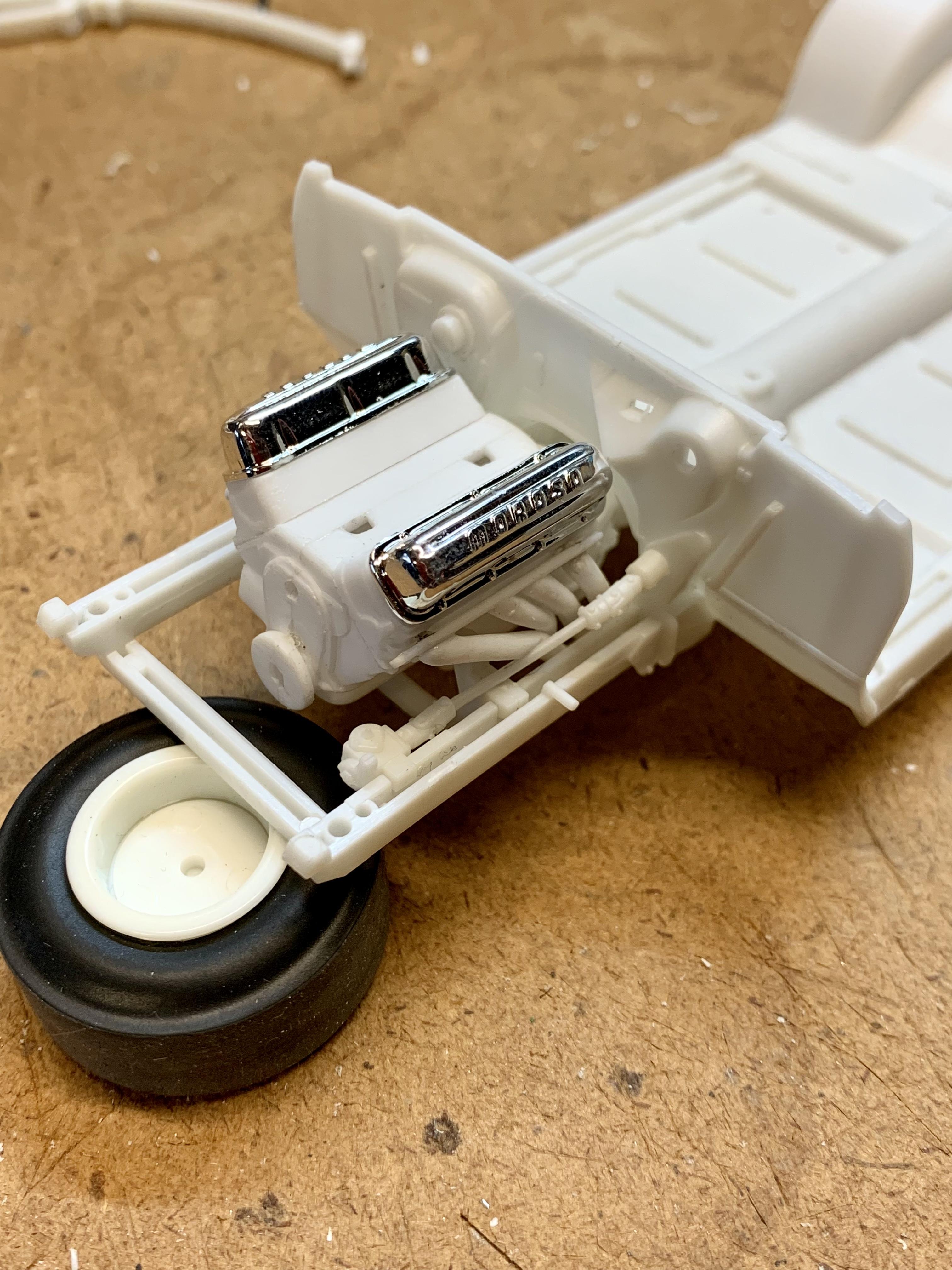

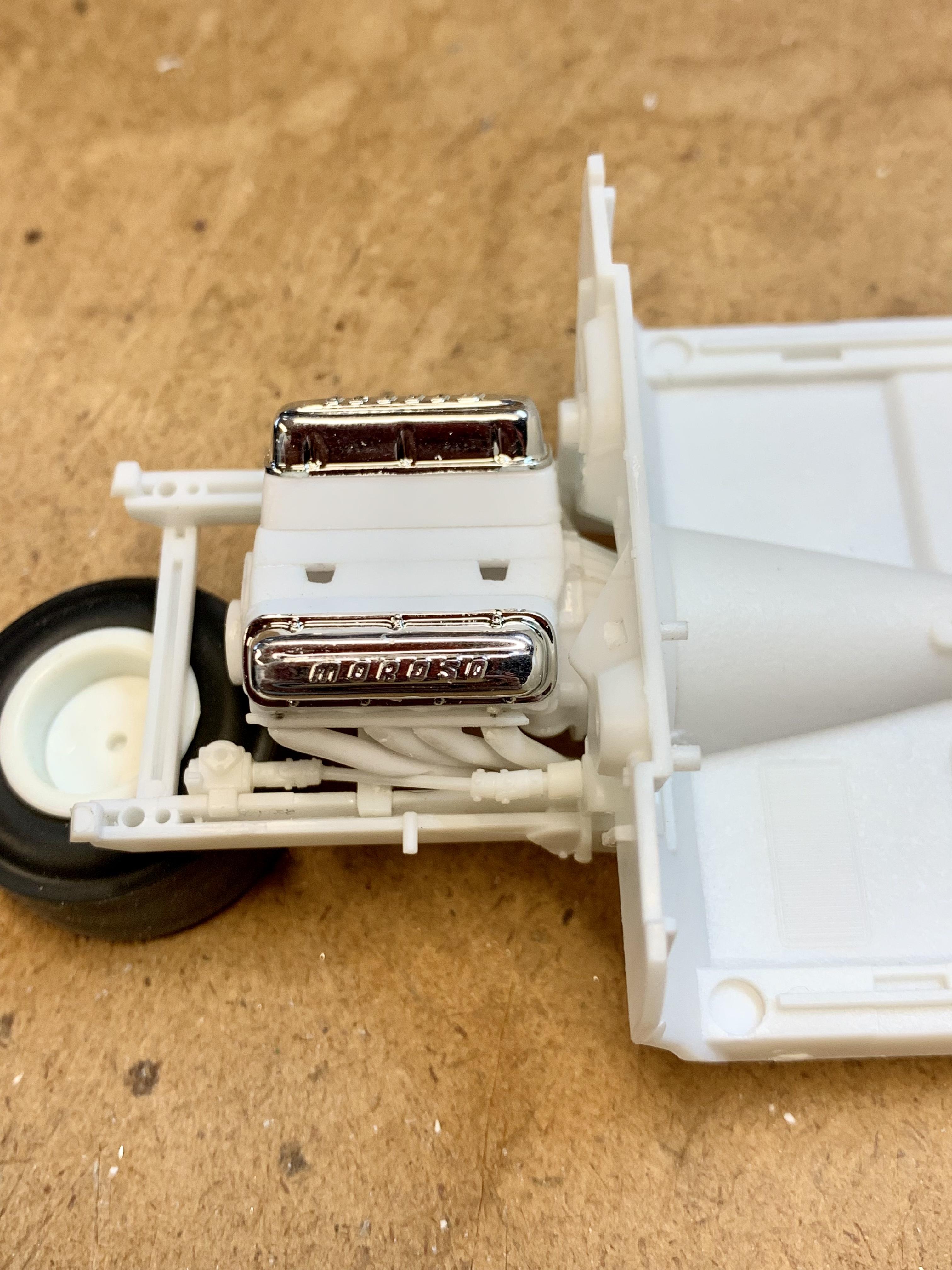

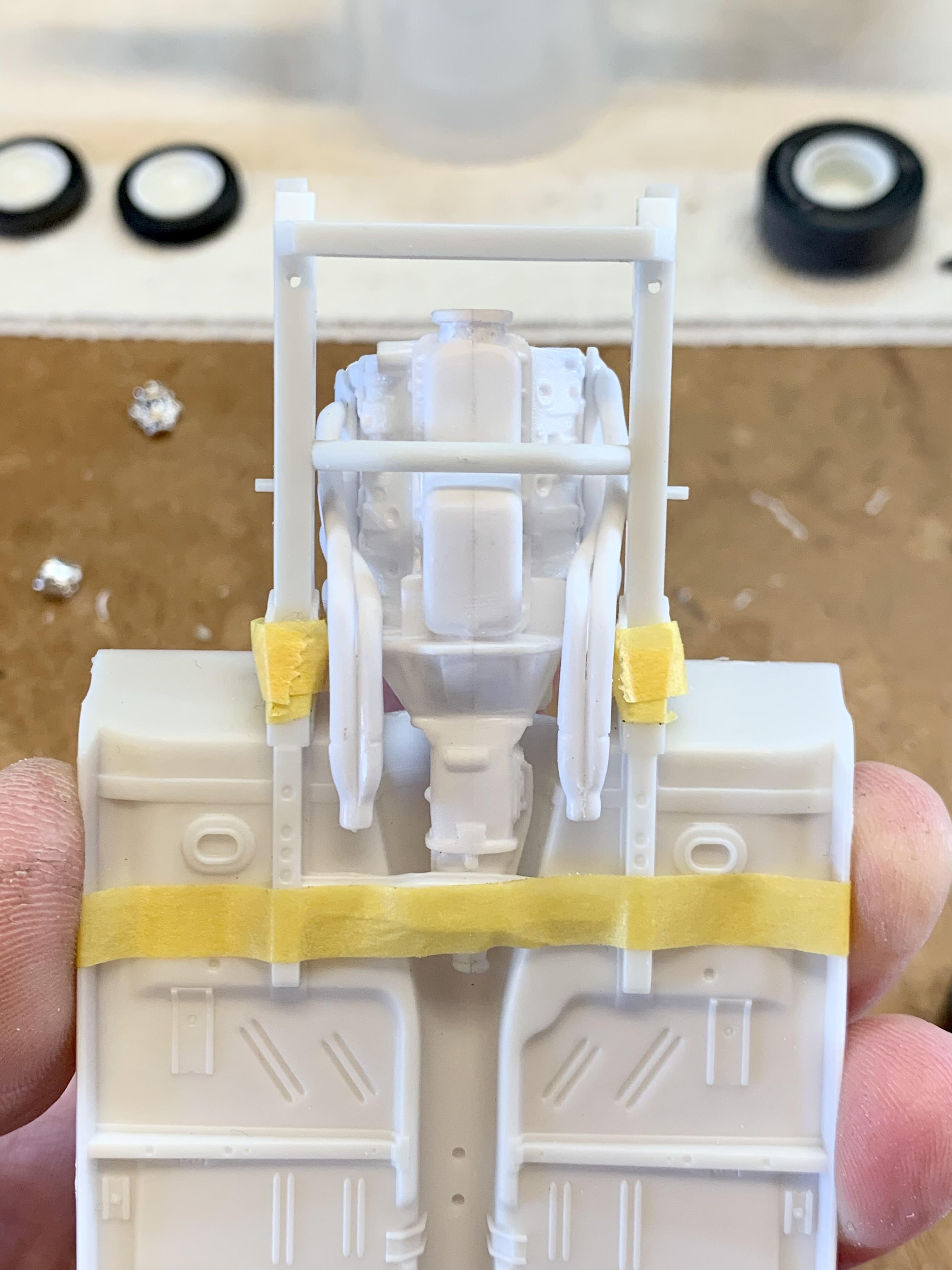

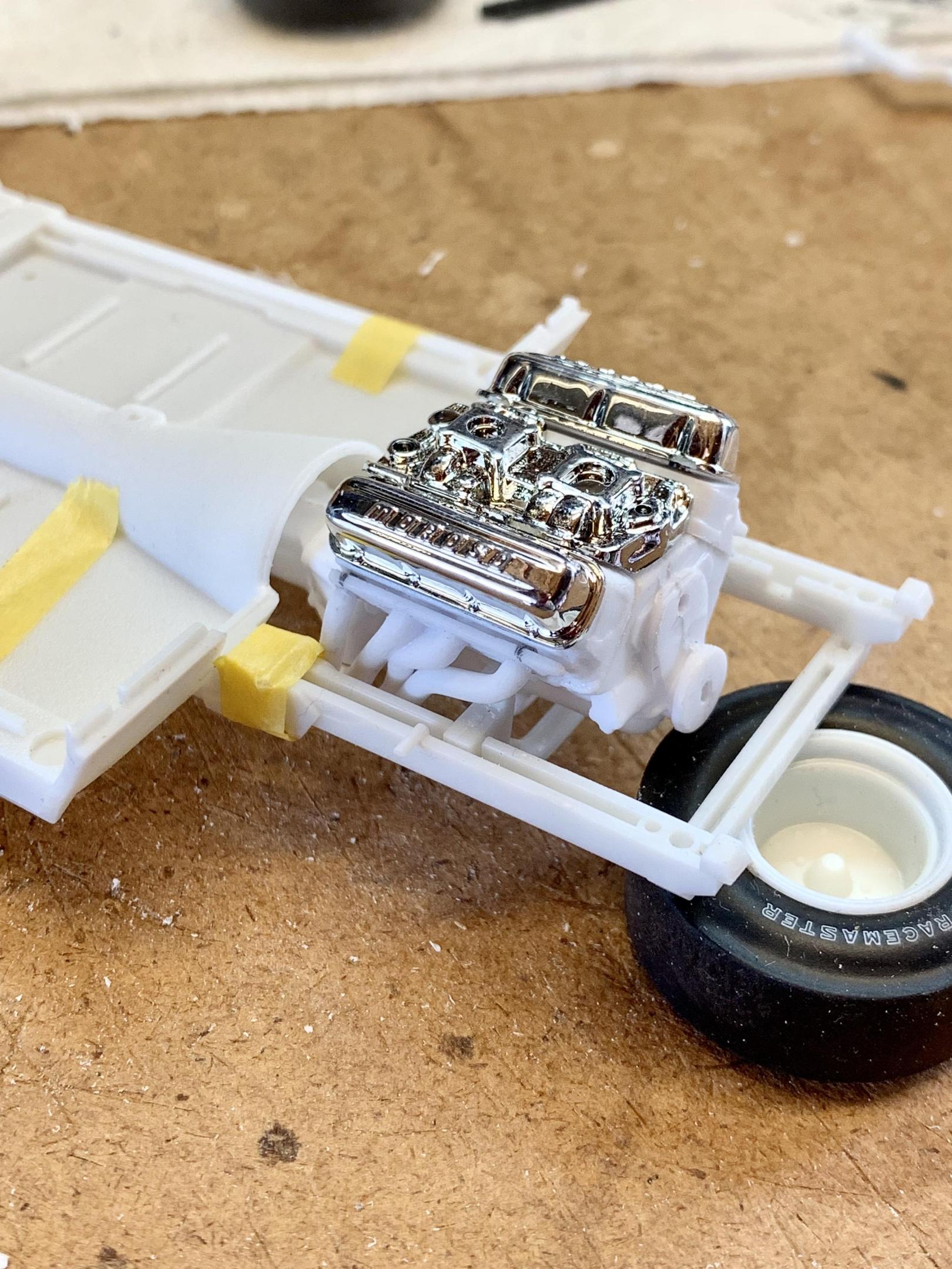

A while back on eBay I bought the complete Chevy Big Block engine out of a Revell 1967 Chevelle Pro Street which comes with a dual quad intake, velocity stacks, tuff looking Moroso valve covers and long tube headers. When it first occurred to me to try the BB I didn’t have any expectation that it would actually fit and to my surprise it did! It’s tight, for sure, but it does fit and the slivers of clearance scaled up would be acceptable. In the first picture is the kits front motor mount cross member and you can see (look close) the minimal areas needing trimmed colored with black marker.  Then following is the basic engine and headers sitting in place.

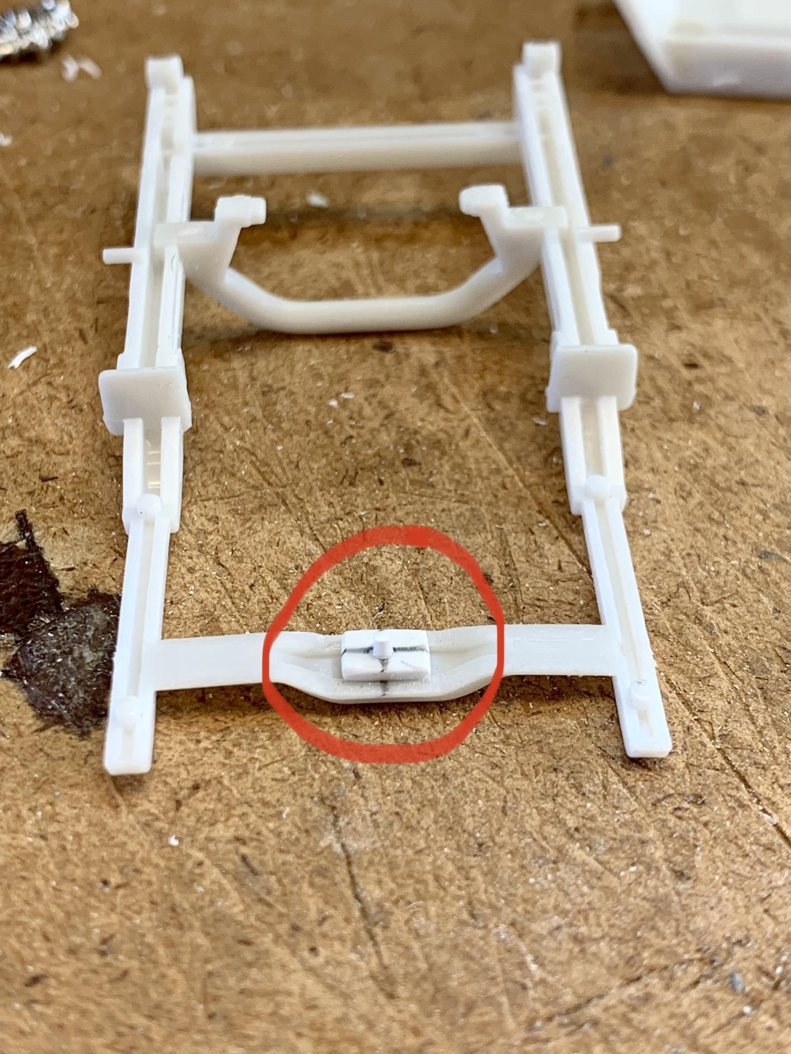

The transmission cross member has a raised half crescent piece sticking up for the kit trans to register on. I removed that and added a .040” thick block then added an alignment pin in the center that registers in a corresponding hole I drilled in the transmission.

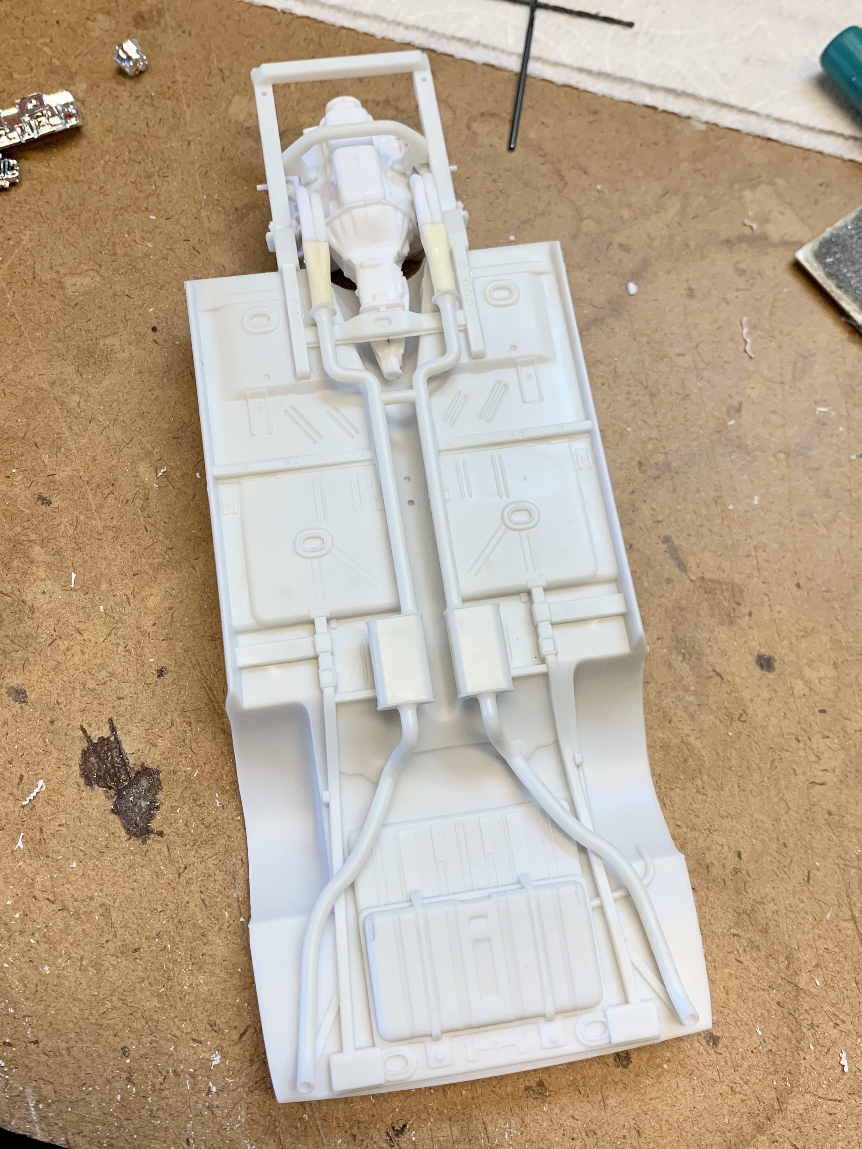

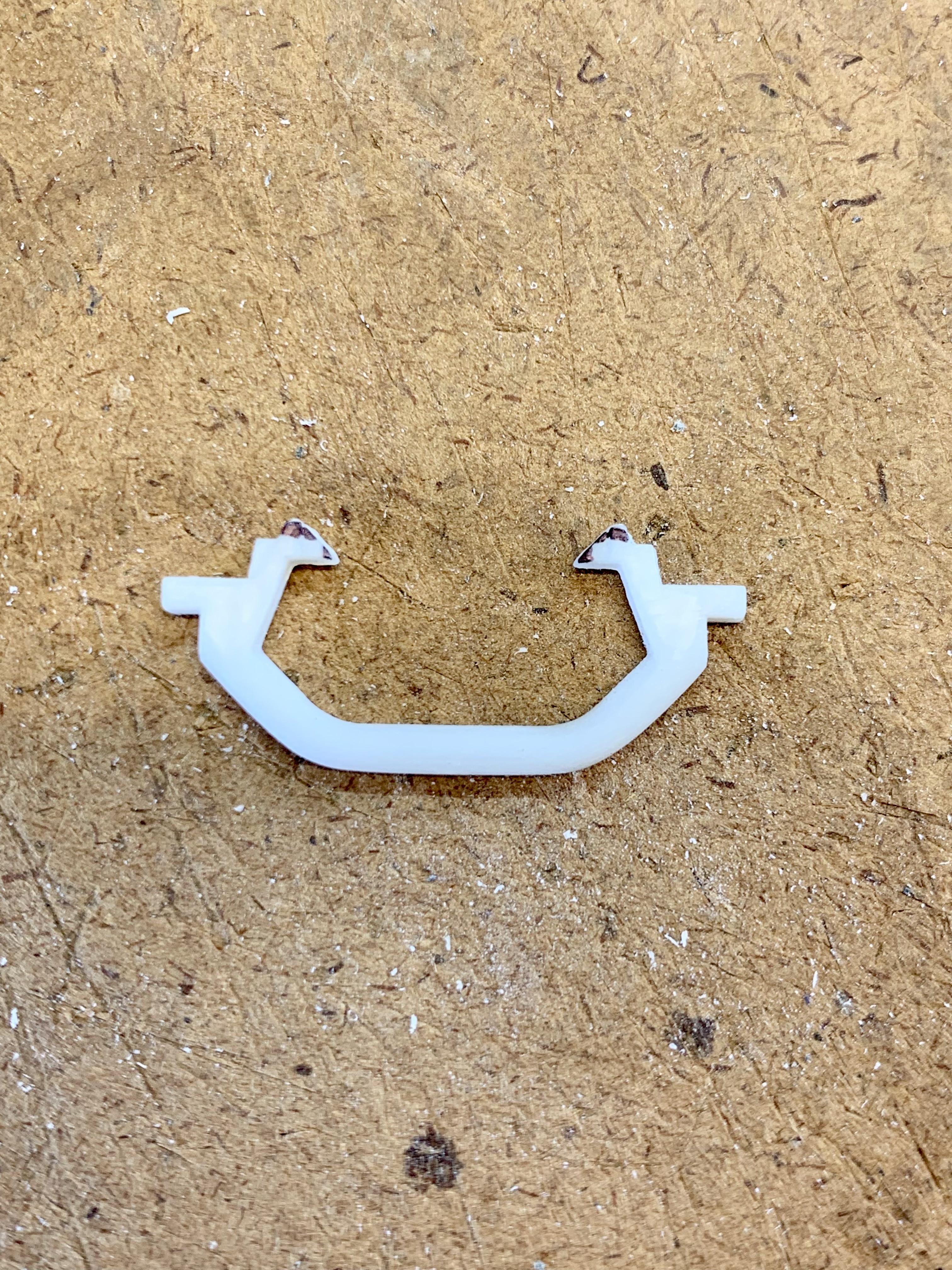

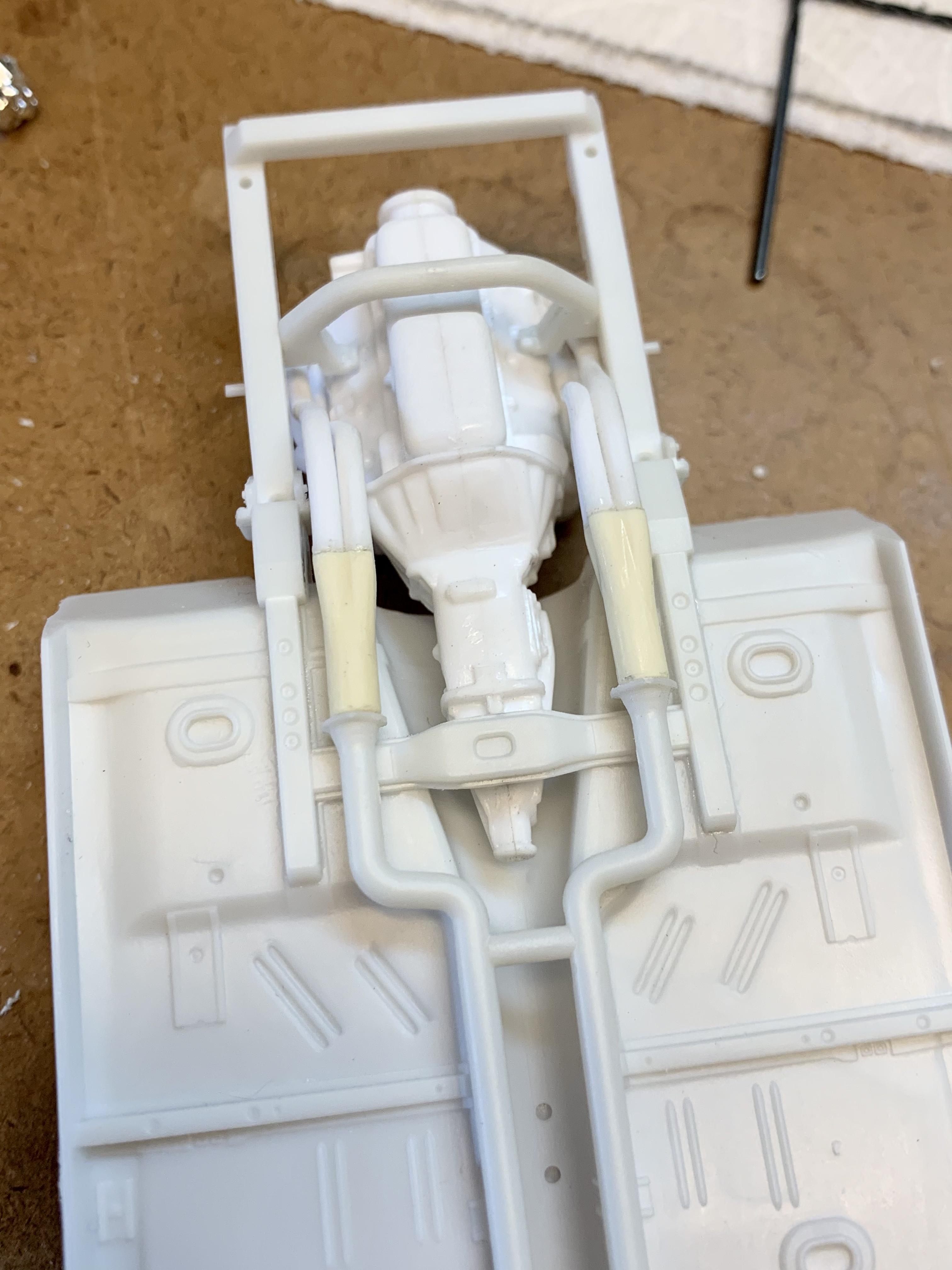

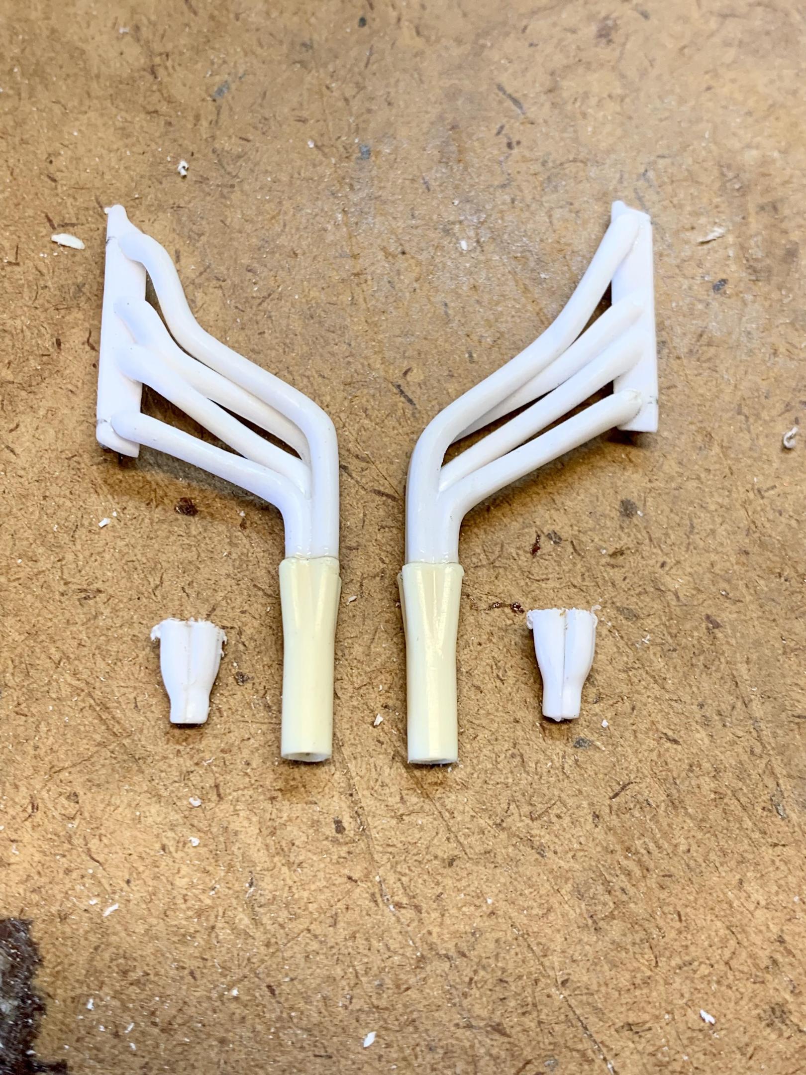

Since this car would be a teenagers local driver it couldn’t stay open headers or he’d be asking for constant harassment from The Law. The new ‘64 Nova SS kit builds factory-stock but as we saw in @tim boyd review there are extra parts in the kit not mentioned in the instructions, one of which being a very nicely rendered larger diameter full aftermarket style exhaust system. The extra exhaust is for a later version of the kit and is clearly designed to mate to a set of long tube headers. As luck would have it, the spacing at the front matched the big block header spacing exactly, the pipes just come up a bit short. I don’t care for the way the header collectors severely neck down so I chopped them off and replaced them with some resin pieces from my friend Ed at Drag City Casting. Then I trimmed them to the appropriate length, drilled and inserted alignment pins. The two Nova kits share the same floor pan and just need to have the exhaust system mounting holes opened up.
Then it occurred to me that I should check the fit of the steering gear/shaft. I did the equivalent of denting a real header for clearance by using a round file to make a slight relief on the front tube. Otherwise, it fits perfectly! Here you can also see that the engine clears the firewall just fine.

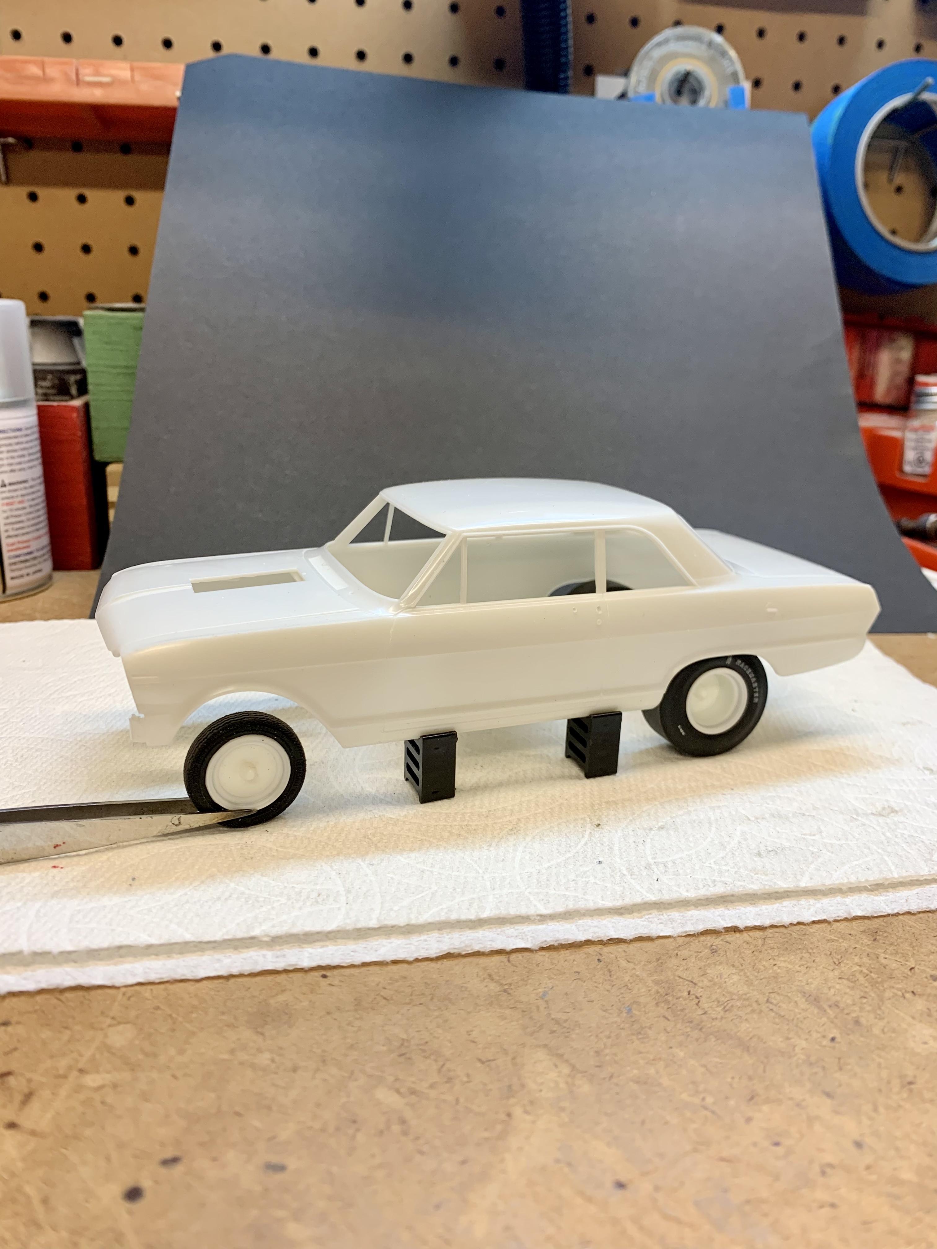

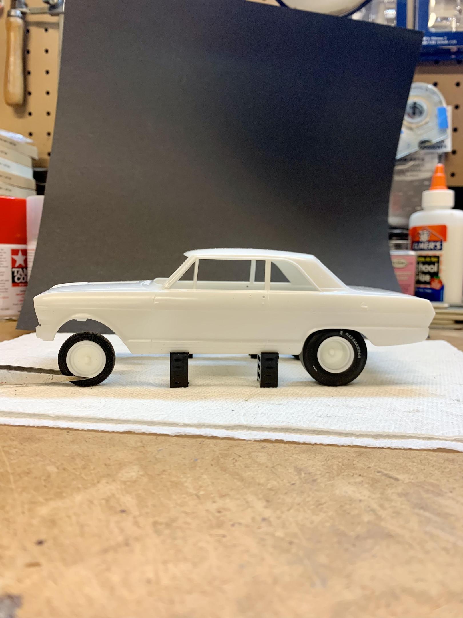

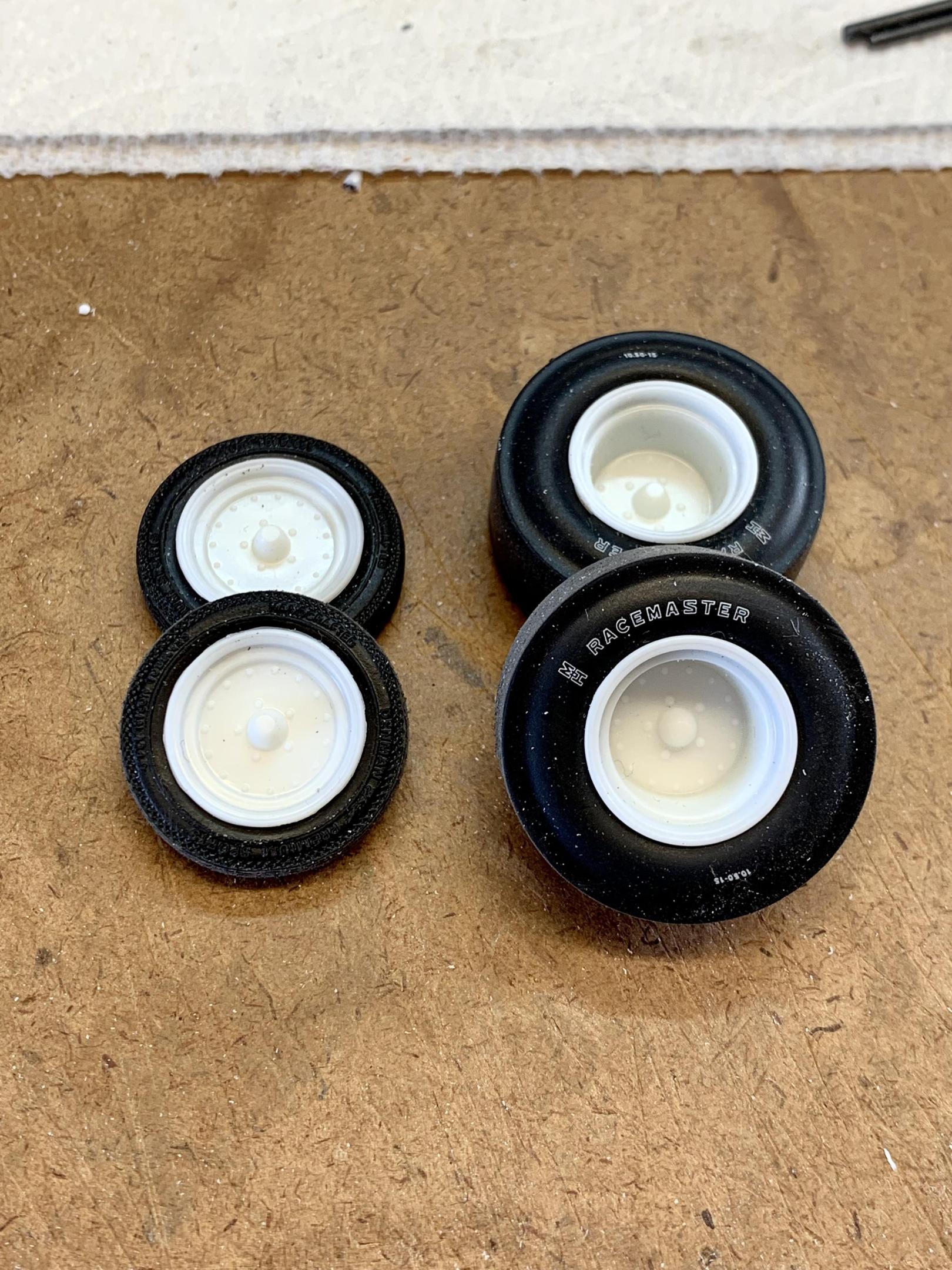

So that’s all of the actual work I did. As you can imagine it took some time of trying this and that before I settled on the plan. Lastly, here’s the wheels and tires I’ve chosen. The wheels are Cragar Super Tricks found in the restored AMT Double Dragster double kit. The little Pirelli front tires and big M&H slicks come from various modern AMT parts packs. Also a couple of super rough mock up pictures. The quarter panels are going to end up getting trimmed and the slicks will poke out a bit so try and picture that.

Great looking build, but being one of those kids who built their own street rod, the straight axle big blocks were way out of our meager income of the day. Mine was a '56 Chevy with a transplanted '57 Corvette long block, but with an Edelbrock C3-B intake, T-10 four speed and swap the ol' 30-30 Duntov cam for a little more radical Isky cam and the addition of Cyclone fenderwell exit headers. For most of us a (almost) new Chevy II was just too much money, never mind the cost of the big block.?
But for one build tip for anyone following along, if you just lengthen the shaft coming out of the column down to where the motor mount is on the frame rail and putting the U-joint back at the end right there then shorten the bottom shaft and adjust the angle between the two U joints the steering angle would work fine, especially with the double type joints used, and I found out the hard way that using a gold or clear yellow on the Moroso valve covers isn't quite the right color, but light coats of clear orange (quitting when you get the right shade) will give you the perfect Gold Anodized Aluminum finish that they used for the original version. My version will be to swap the engine from the Revell '69 Z-28 Camaro and the body from the two door hardtop version to build a replica that belonged to a friend and raced it in C/MP                    (C-Modified Production) class locally and it was seldom beat by anything in its own class and even a lot of supposed "better" cars were even able to best it.
Oh, I almost forgot, since the Revell '67 Pro Street is a 1/24th scale kit, using the engine from the AMT '67 Chevelle Pro Street might not have the slight interference fit., Looking forward to watching this build, keep up the great work and ideas and thanks for letting us watch you do your "magic". Del.

I like the look with the stock rear wheel openings - might be nice to keep it if you can get the tire clearance you need.
The slicks are wider than the pie crust slicks in the kit and the wheels are deeper so I already know they aren’t going to fit. You have think under the circumstances of my back story they wouldn’t hesitate to carve on the car as needed.

Wow, you’re not wasting any time on this one. It looks like that big block fits like a glove.? If that u-joint on the kit steering box was angled better, you may not have needed to dent the header tube as much if at all? Nice work so far!?
I was a car crazy teenager in the 70s - I remember.:)  Cut the wheel opening or jack them up high enough to clear the tire.  I'm sure it will be a great build.
