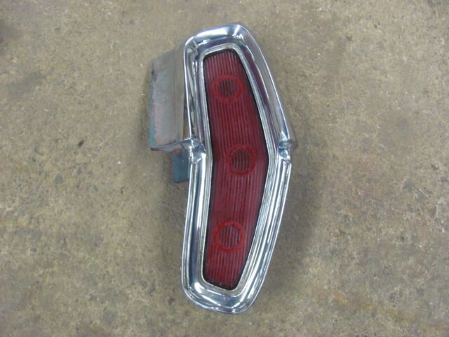

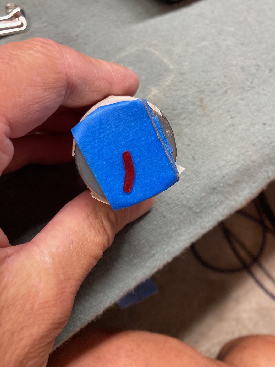

StevenGuthmiller Posted August 30, 2023 Author Posted August 30, 2023 On 8/20/2023 at 12:03 PM, Kah puts said: Outside diameter of the insulation, sofa can strips and plastic rod, this kind of stuff is gold ! Thanks guys ? On 8/20/2023 at 1:27 PM, speedy5963 said: I've been following this for a while, your attention detail and workmanship is amazing, outstanding job! On 8/20/2023 at 6:59 PM, Steve H said: Incredible work as always Steve. The attention to detail in your builds is over the top. So many excellent ideas, thanks for sharing sir! Cheers, Steve Thanks fellas!! Never willing to leave anything alone, I began looking at the provided tail lights from this kit and was not entirely happy. The kit tail lights are just flat clear red plastic, both of which had sink marks in the center from the locator pins. I decided that they would be pretty easy to reproduce in clear plastic to eliminate that sink mark, and in the process, dress them up a little. First, using the originals as a pattern, and the side glass from an old Johan '64 Plymouth Petty kit for the replacement plastic, I traced, cut and sanded the clear plastic to shape, then gave them a coat of Testors "stop light red". Looking at the 1:1 tail lights, it was obvious that there were 3 visible round portions within the backside of the lens, so I thought I'd have a go at it. I then made small rings from thin silver wire, brushed a little clear onto the backside of the lens, and fastened them into position. Once the clear dried, I brushed on another coat to insure that they were secure. Then flipped over the lens and added a coat of clear to the face. They're not going to be greatly visible, but they're not all that evident from a casual inspection on the real car either. Just thought it was something worth trying out, and I'm happy with the outcome. Steve 4

StevenGuthmiller Posted September 4, 2023 Author Posted September 4, 2023 Thanks guys! Finished up the tail light lenses by adding a dab of dark gray paint to the inside of each wire ring for more definition, and then, after concluding that they appeared a little unfinished once installed, I decided to fashion a "retainer" molding around each lens using pieces of thin silver wire. I think it helps add a little more realism to the assembly. Steve 7
