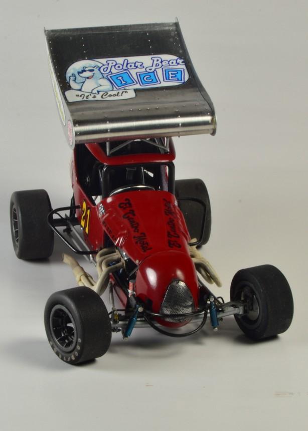

Straightliner59 Posted May 11, 2023 Posted May 11, 2023 (edited) I've used Koala's products with pretty decent results. I will try this, for sure. Their regular white is slightly thicker than the clear, but I haven't had any issues with it. Here are a couple of examples: The graphics on the Vega, and the polar bear logo on the Supermodified are the white. If I would ever take the time to learn to use my Cricut, those could have been cut out much more nicely. The "El Centro" on the Supermod's hood is on the clear... Edited May 11, 2023 by Straightliner59

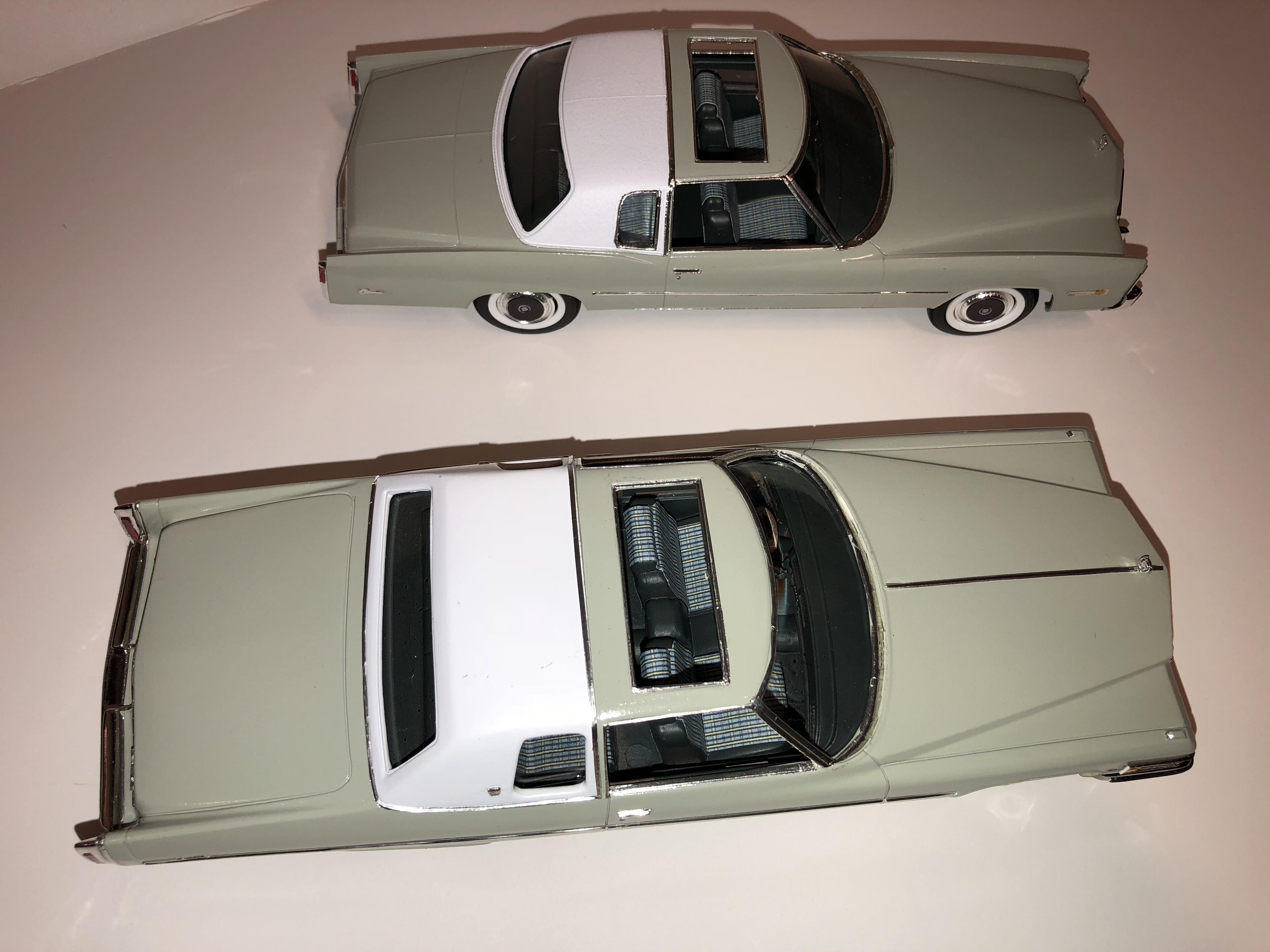

howsthat1959 Posted May 20, 2023 Posted May 20, 2023 For cloth interior seat inserts and such, i design the image in one of many drawing programs, or download a patter and then scale it using Microsoft Word. I print on normal weight copy paper and use Amy's quick drying craft glue to attach the cloth. I've attached a picture of 76 Cadillacs with the absurd green plaid cloth inserts available back then as an example. I done this on dozens of cars requiring complete cloth seat patterns. 1
