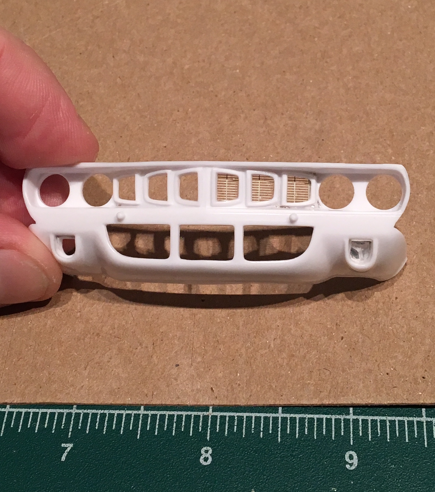

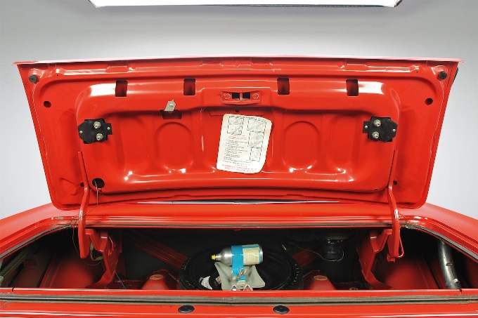

I like the accessories from Detail Master and Model Car Garage. I was able to get the '71 Hemi Cuda Dress Up Kit from MCG and wanted to use the photo-etched grills. This means you have to drill out the holes or grind down the back. I used the Dremel on the back of the grill. The fog lights in this kit are just a chrome plated item that you glue in place with no clear lens to go over top. That's not acceptable, so I had the idea to drill out the hole for the fog lights and mount them from behind the grill. Then I used scrap clear plastic and cut out my own lenses to mount in the front of the grill. When drilling out the whole, I left a very small edge in place for my clear lens to settle down on. The photo doesn't pick it up, but there is definitely that depth perception of theses "sunken" fog lights. A little too aggressive with the Dremel drill and you can see I came through the grill in a few spots. No to worry, I will fill it in from behind with a little putty and all will be fine. I plan to have a functional hood pin set up with the wire coming through the grill as in the reference photo below. TCB, Adam

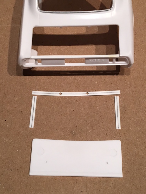

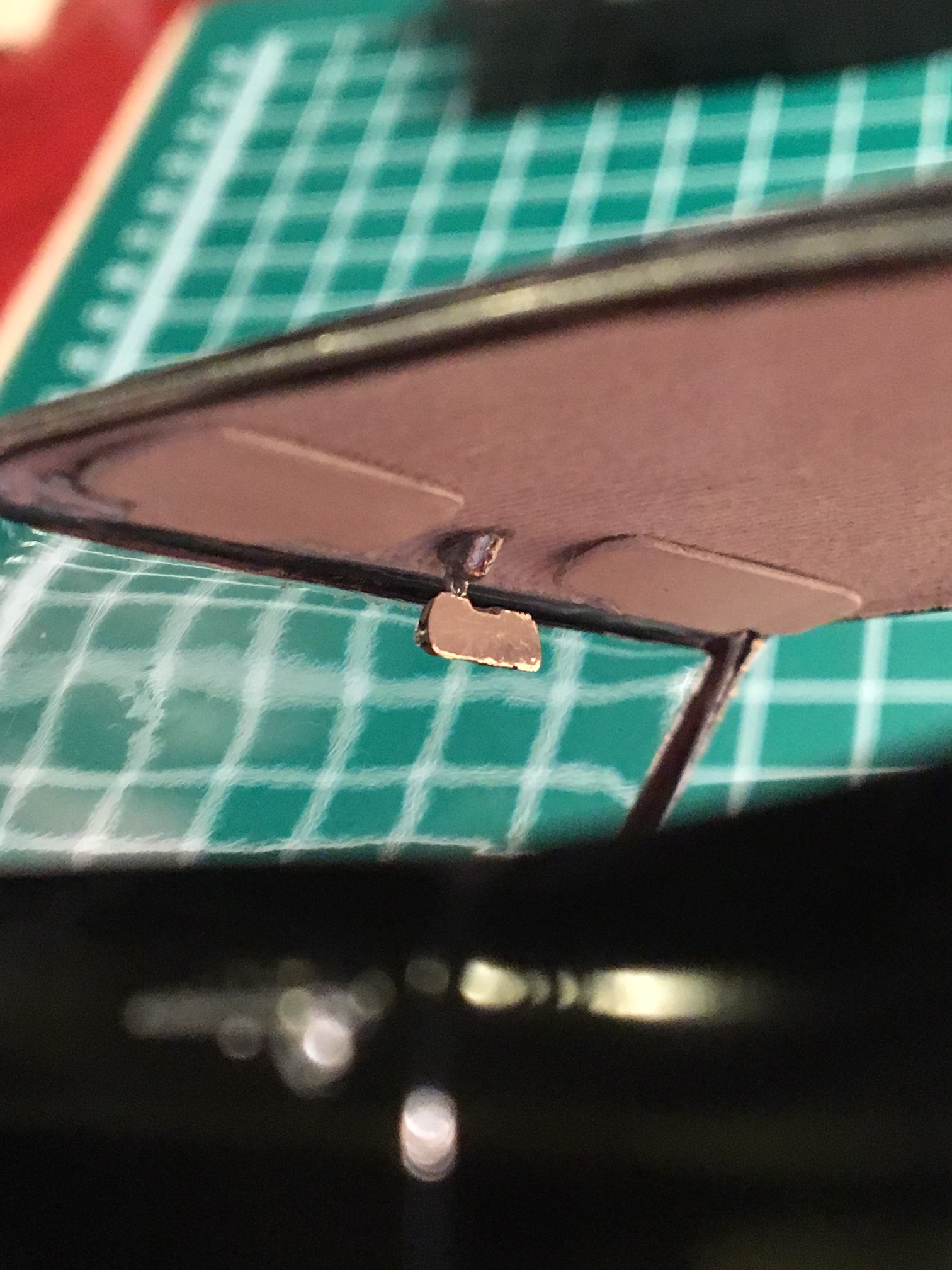

Trunk work. Never hinged a trunk before. Seen lots of pictures and videos, so I'm hoping it works out ok. Now I have to add details inside like a trunk mat and possibly a spare tire & jack !

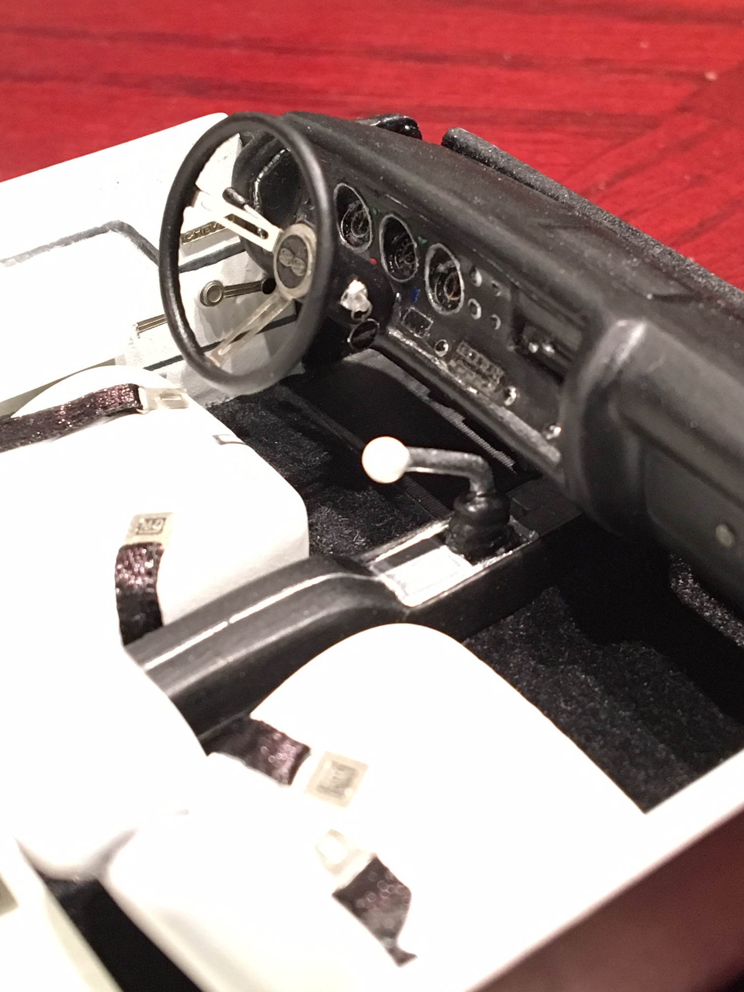

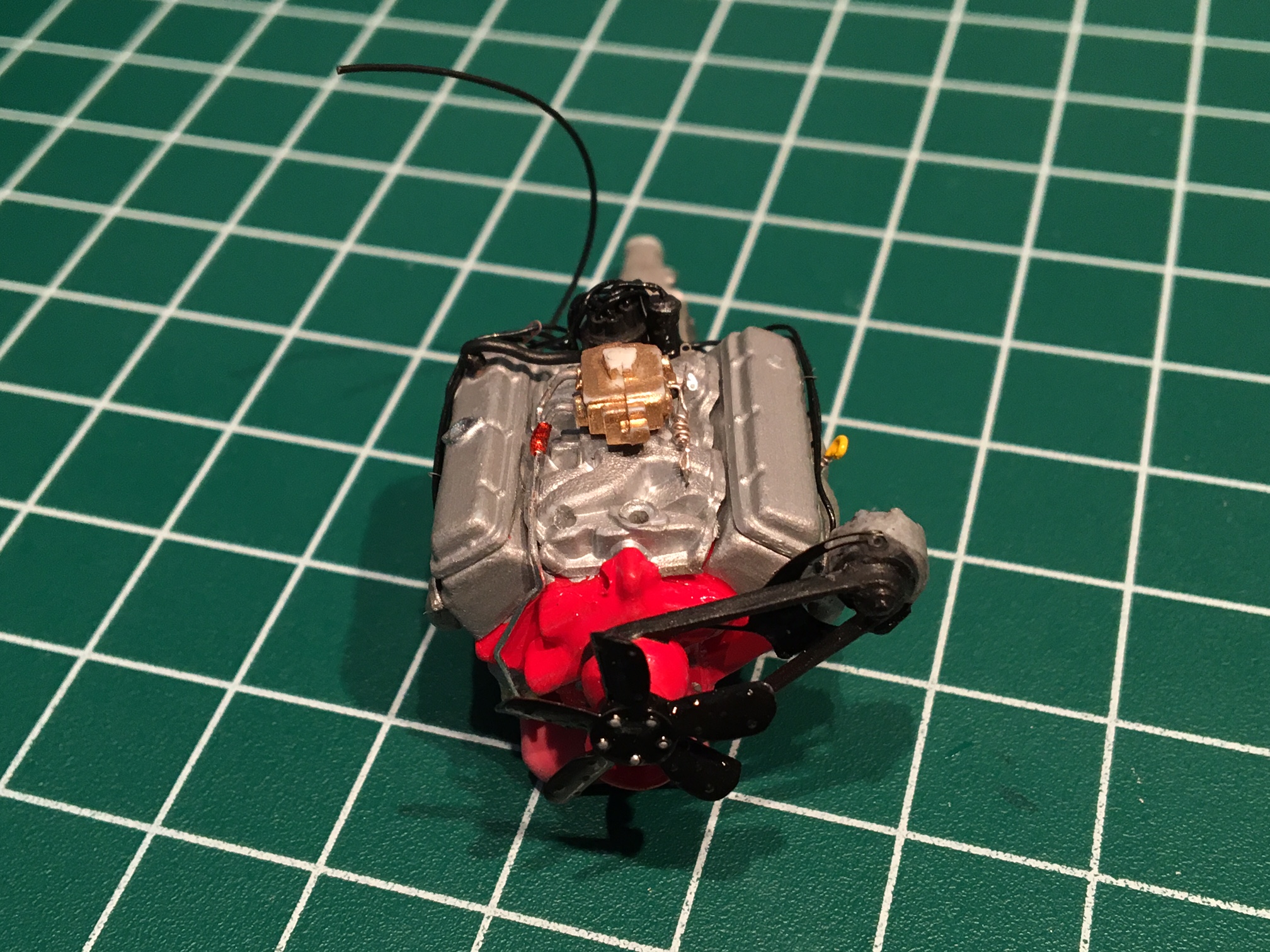

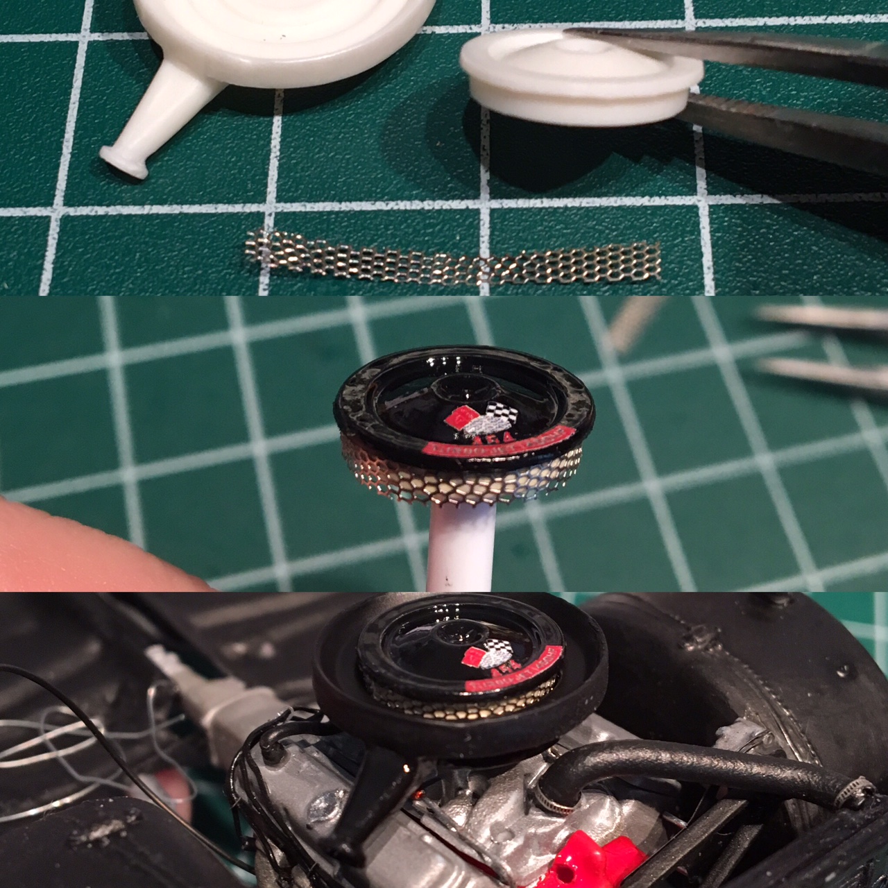

Engine work. I had originally planned on adding a 572 Chevrolet crate motor with a big billet aluminum air cleaner, but then the hood would not close..... The problems we face with big motors... LOL !! So, I went with the original 454 engine. Ran the fuel lines, added throttle linkage and return spring. Scratch built oil dipstick with leftover spark plug wiring. Also, added the alternator support bracket. The photo-etched hose clamps were a bugger to glue on, as you have to put a curl in them, so they wrap around your radiator hose nicely. The detail is great, but it's so darn small to see. Below is a really good tip, for all those men who use electric shavers. When you replace the old shaver screen & blades, keep the screen and you can use it for things like a air filter screen, or a/c vents under the hood, etc. Upgraded the steering wheel to the SS option and added speaker grills in the back. Gotta have tunes !! Interior details include flocking, adding the turn signal lever, GM seat belts, window cranks, Chevelle badging and keys in the ignition. I've been adding interior roof liners into my builds lately. This is a real easy thing to do and I am surprised of how many great modelers forget this detail. Firstly, I cut out the excess plastic around the window molds (usually that big chunk that keeps the front & rear windows together as one piece) then I simply use clear masking tape and tape it into place. Next, I use Post-It notes as my template and figure out my measurements. Then cut the template out from a twill patch (Walmart $5) and glue it down with fabric glue. Sometime, I end up trimming off the clear plastic that has the mounting hole for the rear view mirror. In the pic below, you can see that I had to make my own base for the mirror to mount to. I used small tube styrene, cut it on a angle, sanded the edges and used the chrome pen. A dot of glue and in place it goes. Sun visors are another easy scratch built item for the interior. Primed in black. Next up .... exterior and final body assembly. TCB, Adam- 15 replies
