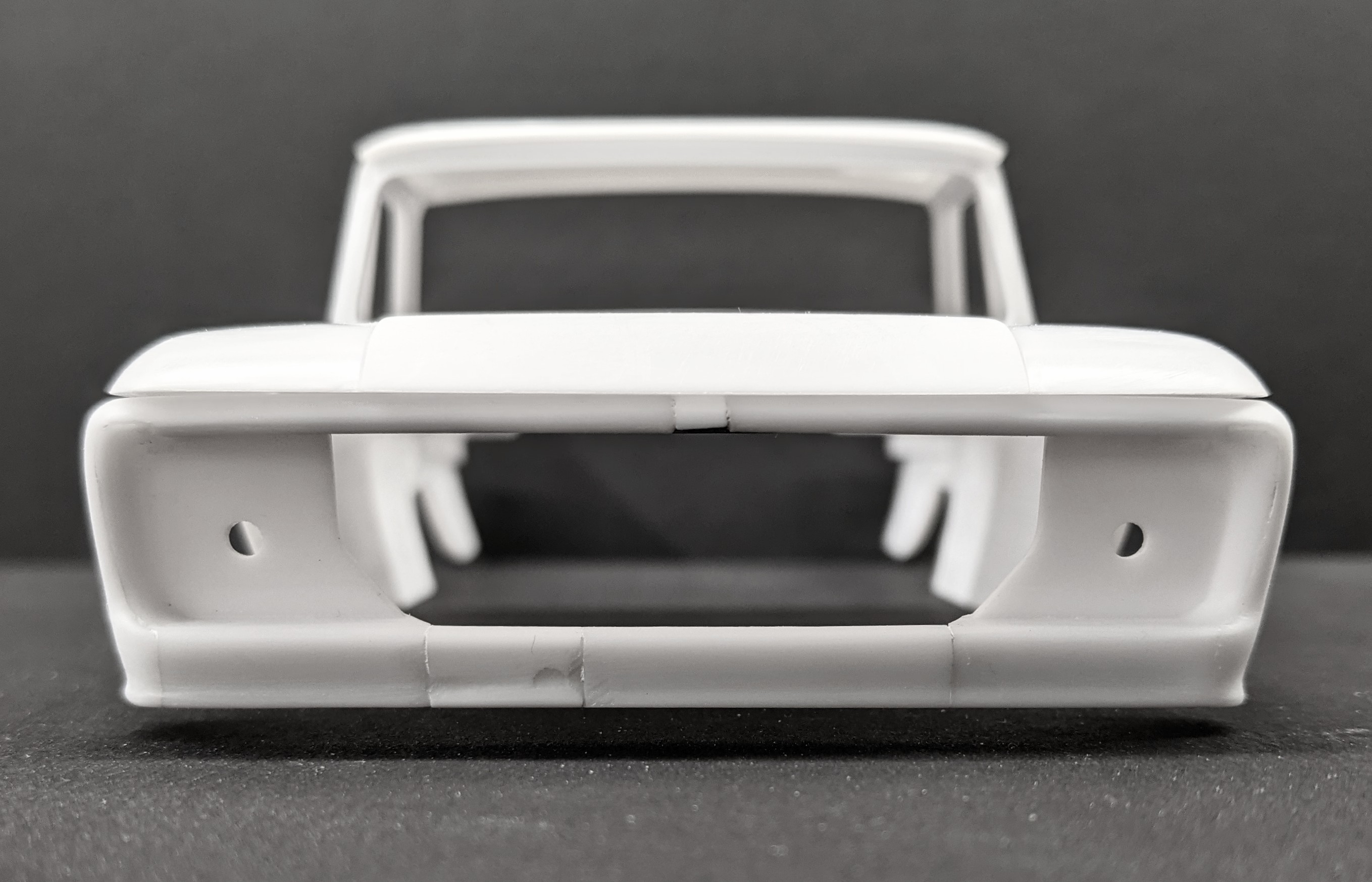

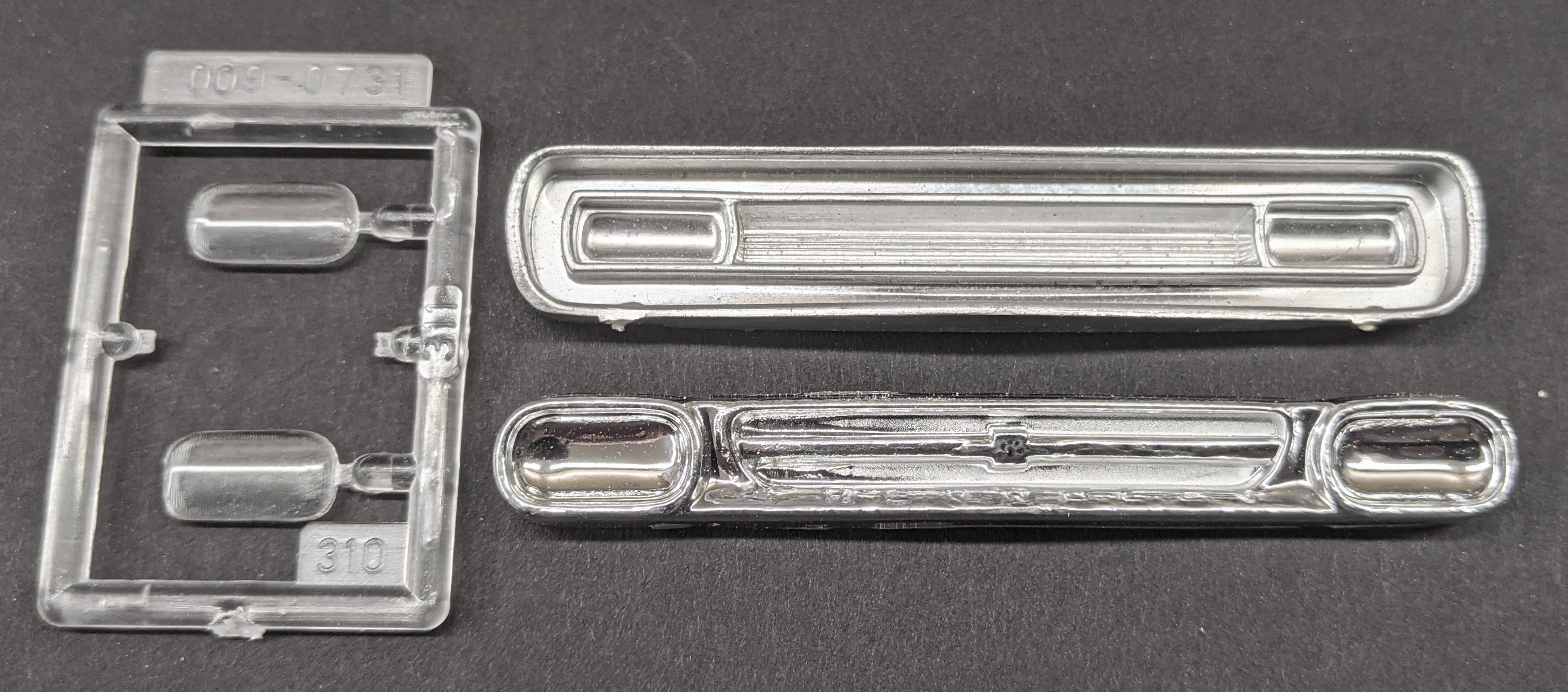

Yeah, unless the starting point is something highly sculpted and visually overly busy (looking at you '58 GM cars), you can only take the smoothing so far. Knowing when to stop isn't always easy, though. The front valence is back in place and roughly blended...and mostly straight. The pickup and Suburban panels are not quite identical, but there's enough material present to make everything even in the end. The two grilles I am (was?) considering below, but I think I want headlight lenses which are slightly more rectangular than these from the AMT '60 Chevy Street Machine kit. They are very close to what I am looking for, though, so I may end up using the lenses and buckets, and ditching the center area. Not sure where the other grille is from...Chrysler Imperial custom, maybe? ?? It kind of has the right look, but is a bit too narrow once the surround is removed.

Thanks. The reveal/shadow line was chosen for the very reason you mentioned, but it also necessitated widening the body by 3 mm. Doing so will allow me the use the box stock windshield, roof cap, and hood width. Speaking of the hood, I got the rear edge nearly parallel to the cowl, then realized I will likely need to remove a millimeter or two to allow the front edge of the hood to sit further back. ? Still undecided how I am going to finish the leading edge of the hood and what the grille area will look like, but that will fall into place soon enough. I did get the Fleetside pickup bed's wheel arches in place on both sides, and am pleased with how they look. The plastic from the pickup is significantly thinner than the same area on the Suburban, but a bit of plastic strip added to the backside should remedy that.

I'm sure that was a major influence on my thinking, both times. It just seemed to make too much sense not to try it. I'll share after I've decided upon anything further. Nothing too wild, really. I think European style rectangular headlights would work well on this truck, but I haven't even thought much about the front end yet.
I tried something similar to this a few years ago, prior to Revell releasing the '66 Chevy Suburban, but nothing ever came of it. Now, with the aforementioned '66 Suburban, a '64 and two '66 Chevy Fleetsides on hand, things are starting to take shape. The tail end needs plenty of work, and the rear wheel arches will be replaced with those from a pickup bed, but so far, so good.
