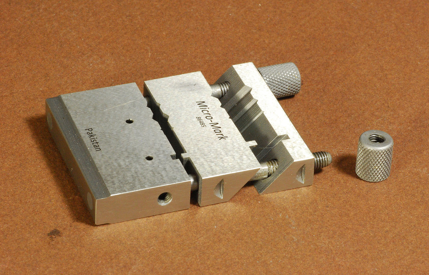

This is a new item from Micro-Mark to square up 90 and 45 cuts and I'm wondering how I ever did without it. just clamp rounds and flats in and use a file to square it off. This is the small which could handle most of the small tubes I use. There is a larger one also.

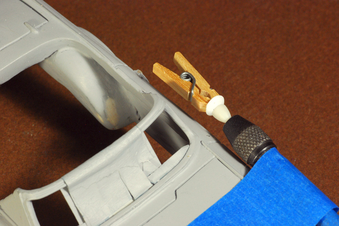

I'm getting an itch to get back to my TR4A as the weather slowly comes out of Winter. I needed a outside rear view mirror and, after polling the forum on where to find one, I just went down as recommended and made one. Here's a shot of the mirror in question ... I used a chunk of sprew in the drill and shaped the main body. The large sprew even had a center void to allow drilling a hole down the middle for a brass pin! I found an old beadlight bucket in to Old Parts box and flattened the end after drilling a center hole. This is it at this stage and I believe it will look close to the 1:1. It's going to be tricky sawing the bucket to a small sliver, but a lot of filing may be in store near the end. I'll cut a disk to insert for the mirror in the end. The hole in the main cone will get a pin with a slot like the original. Then. a brass pin where the arm is and trapped between a couple .02" flats which will be sanded to shape. Where's my Molotow Pen? This was to last missing piece. I worked on refining the clear red taillights that will be trimmed with Molotow Chrome. Did a little paint pickout on the chassis and got the wheel metal axle mounts fixed in place. I ordered interior door handles from R&M so it will be a bit before they are placed ... maybe right at the end I hope.

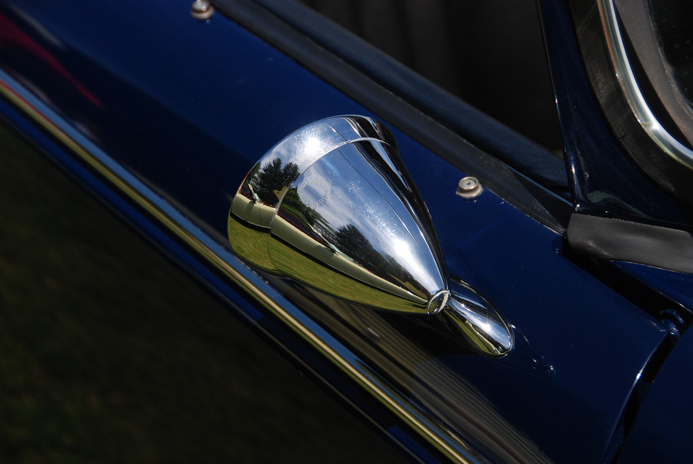

Need a specific TR4A Rear View mirror

I appreciate all the help coming up with a way to make this mirror. After all the hem and hawing I just went down to the shop and stuck a chunk of sprew in the drill and shaped the main body. The large sprew even has a center void to allow drilling a hole down the middle for a brass pin! I found an old beadlight bucket in to Old Parts box and flattened the end after drilling a center hole. This is it at this stage and I believe it will look close to the 1:1. It's going to be tricky sawing the bucket to a small sliver, but a lot of filing may be in store near the end. I'll cut a disk to insert for the mirror in the end. The hole in the main cone will get a pin with a slot like the original. Then. a brass pin where the arm is and trapped between a couple .02" flats which will be sanded to shape. Where's my Molotow Pen? -

wow ... that is my mirror. Finding a copy would probably take 10 years, though. -
