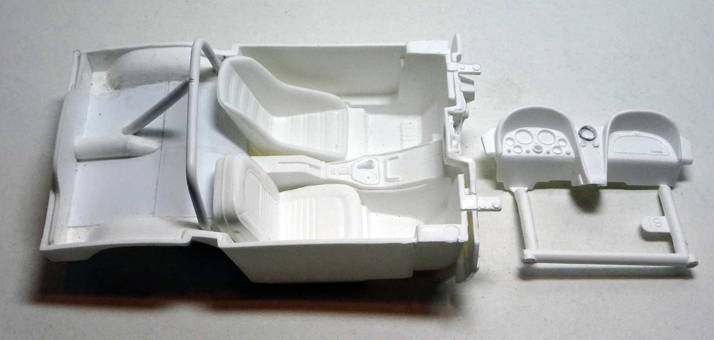

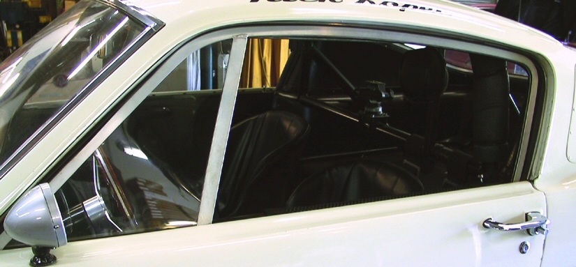

  8. I did not find that much time since my original post to work on this project but when I did I concentrated on the interior and chassis which are pretty much finished. I am fortunate to have an acquaintance who owns a ’65 Corvette in pretty much as delivered condition, which I was able to have a close look at in his garage. INTERIOR – At first I thought all I had to do was fabricate a big tank cover and a roll bar but I discovered that the interior of a ’63 was different in many ways than a ’67. - Cut in the longitudinal seat pleats from the AMT ’63 and extended them on the bottom of the seat. - Completely redid the door panels with vertical pleats and chrome trim - Eliminated the radio detail on the dash and added a grab slot to dash top on the passenger side - Cut down the arm rest between seats and added a pad - Added pull style hand brake under the dash - Used the excellent Model Car Garage Photo-Etch set for extra details - I had problems with the gauge decals and went through two sets. I had to supplement them with after-market gauge faces printed on clear styrene so ended up with a speedometer where a clock should be but it will be hard to detect once the body in place. - SEAT BELTS – Apparently all Corvettes from 1958 had aircraft style seat belts. I first used the old style kit supplied plastic seat belts but they stood out like a sore thumb. I did not have any appropriate hardware so I had to fab up something in combination with a photo-etched piece to represent the aircraft style buckles. CHASSIS – I wanted to make the chassis as close as I could to the way the car originally was but it is very difficult to find photos of the underneath of C2 Corvettes. I did learn that the exposed fiberglass was left unpainted except for the wheelwells. It was very helpful looking under my friend’s Corvette. Something I spotted when my camera flashed was a lime green cross member. My friend told me this was the brace for the seats. It took some looking on-line but I finally discovered that this bracket was painted with green zinc chromate, which I replicated with some green added to Testor’s Zinc Chromate enamel. The chassis is box-stock except for slight lowering and some grinding to gain clearance for the wide tires. TIRES – The tires I used are wider than what would have been on the car when originally raced but they are Goodyear Bluestreaks and nothing I had access to looked as good. Next on the agenda will be the construction, painting and detailing of the Harold Bradford Historic Racing Miniatures resin 327 fuel injected engine which will be a model unto itself.

  16. Thanks Chris. It was great to talk to Tom Gloy and have a close examination of his car and be able to point out the similarities I was able to incorporate in the model Thanks Steve
