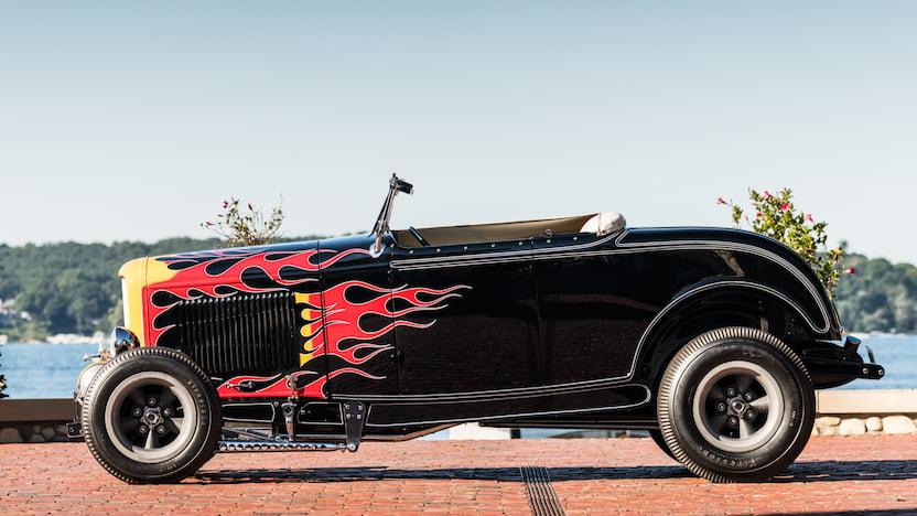

  3. Thanks Adam Thanks Trevor - The pinstripe along the bottom of the frame is as narrow as I could cut the self adhesive vinyl. I am going to try to do the body reveals with similar width vinyl and see how it looks. For the trunk pinstripe I have made a decal. Thanks Graig. I am pretty satisfied with the stance and as you say it is now locked down Thanks Greg Thanks Dennis - I am kind of considering each sub-assembly of this project as separate and completed models in their own right. I am now moving onto the interior.

  22. Absolutely excellent model and photography. I have an unbuilt kit but also the Tamiya 1/12 assembled diecast. Yours is equally nice.
