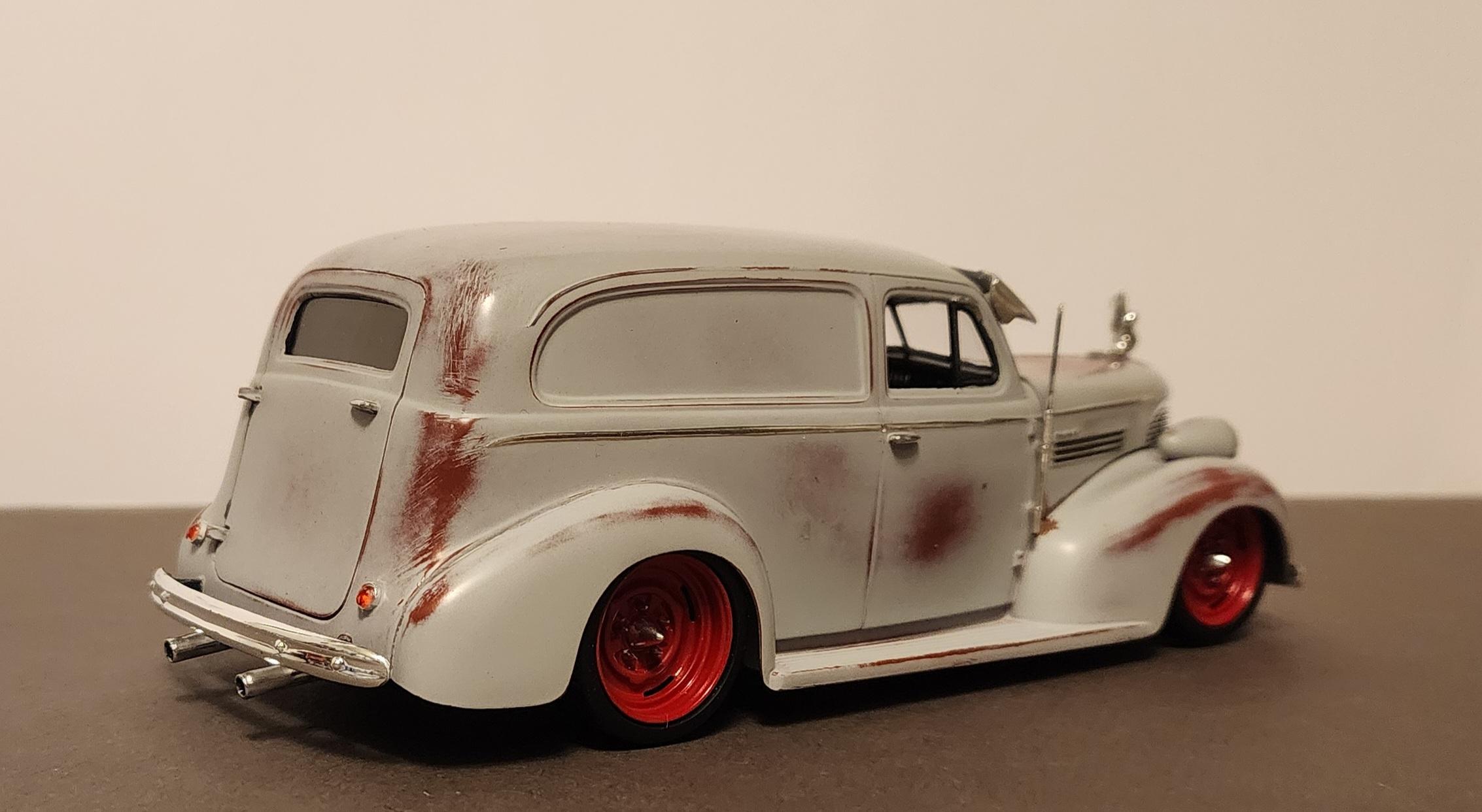

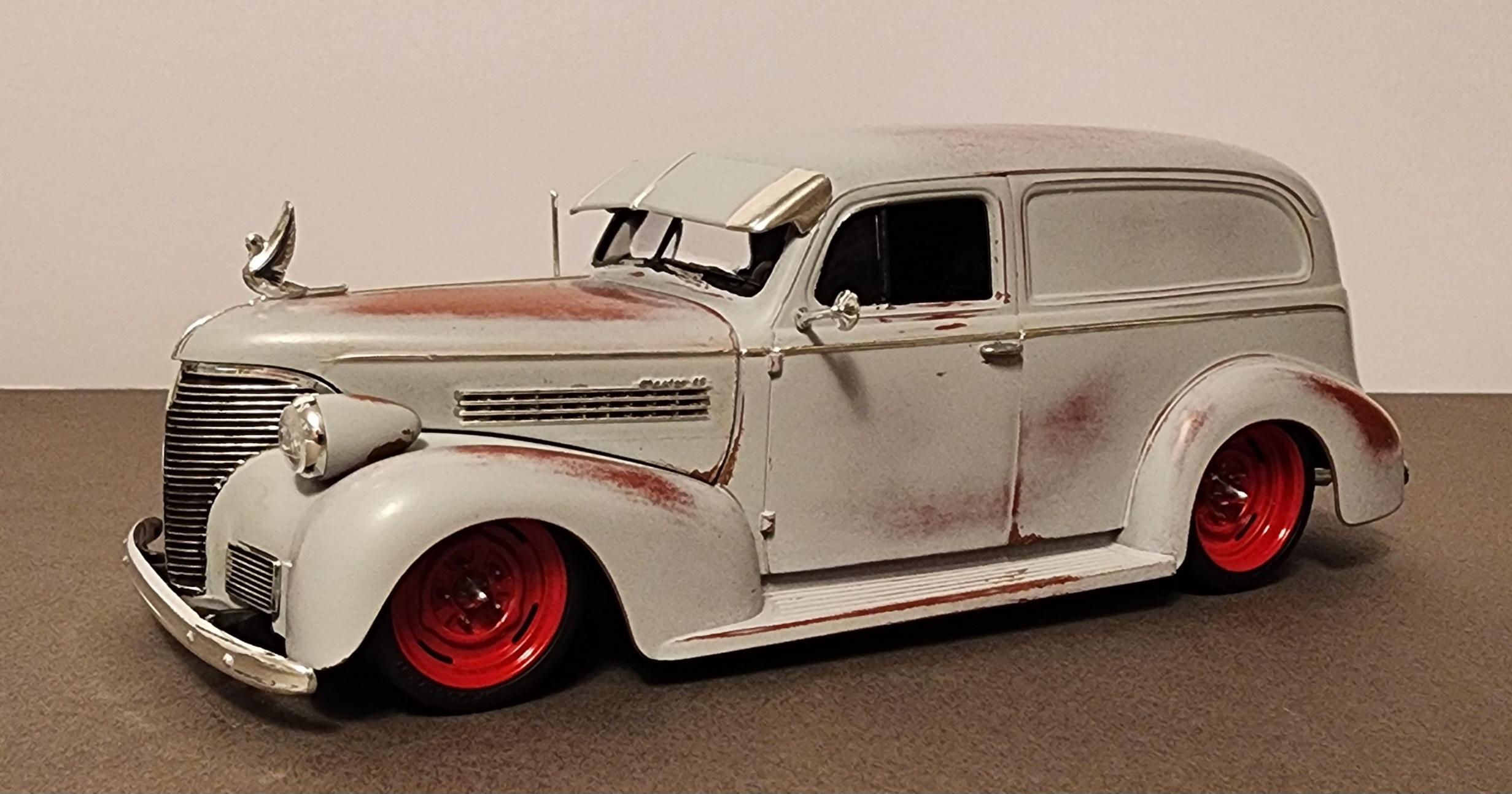

Revell '39 Chevy hood fitment
Fat Brian replied to dragstk's topic in Model Building Questions and Answers
Your body does need to sit a little lower on the fenders, it should rest on the notch on the front of the rear fenders. I also had to sand the front of the body to fit between the front fenders fully. What I ended up doing was cutting the floor pan out so I could attach the fenders to the body and still get the interior in. Once I had the body in the fenders correctly I had to bend the sides of the hood out so it would go over the cowl fully then trim the back edges of the hood until it laid on the fenders right. -
