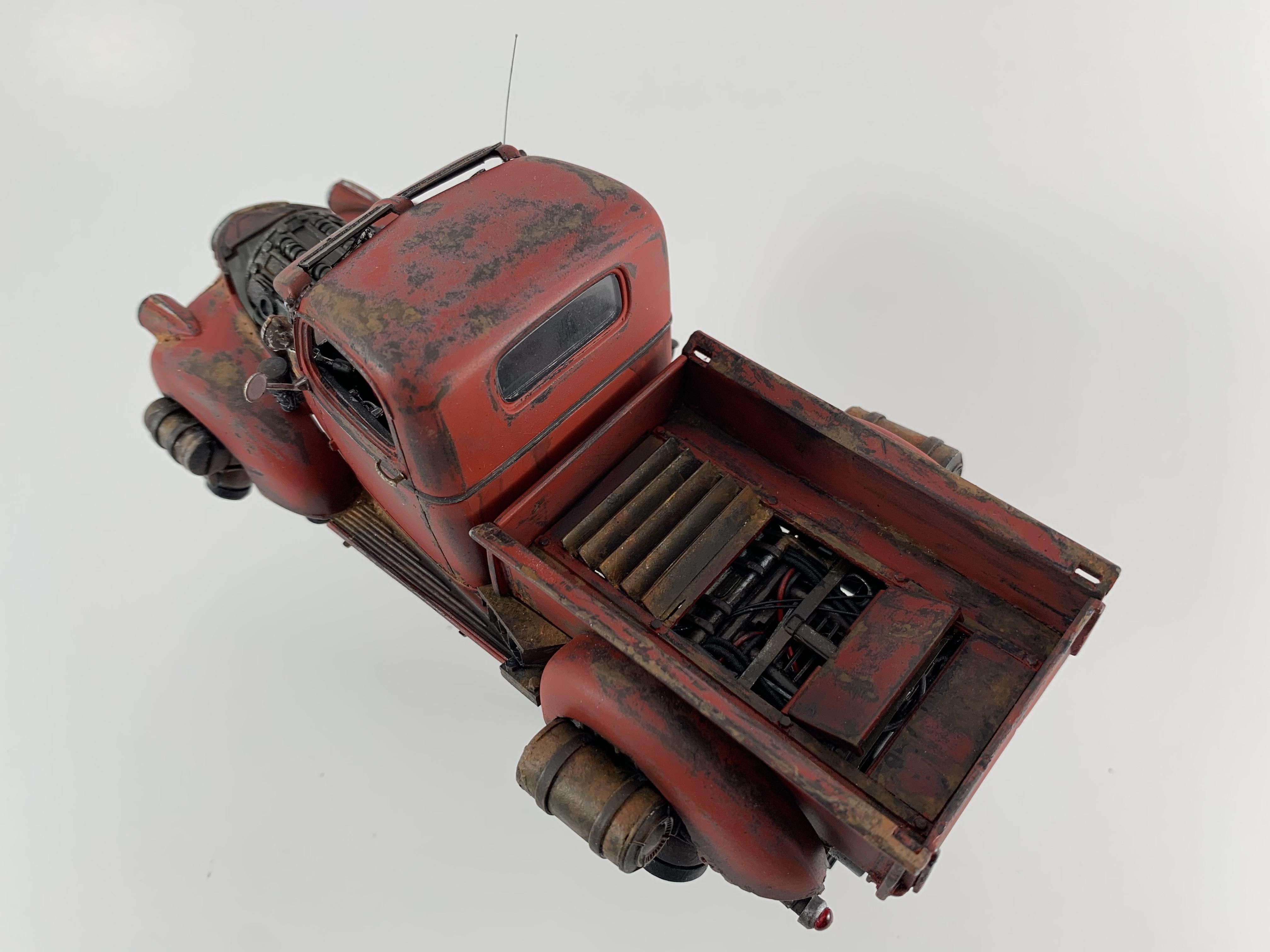

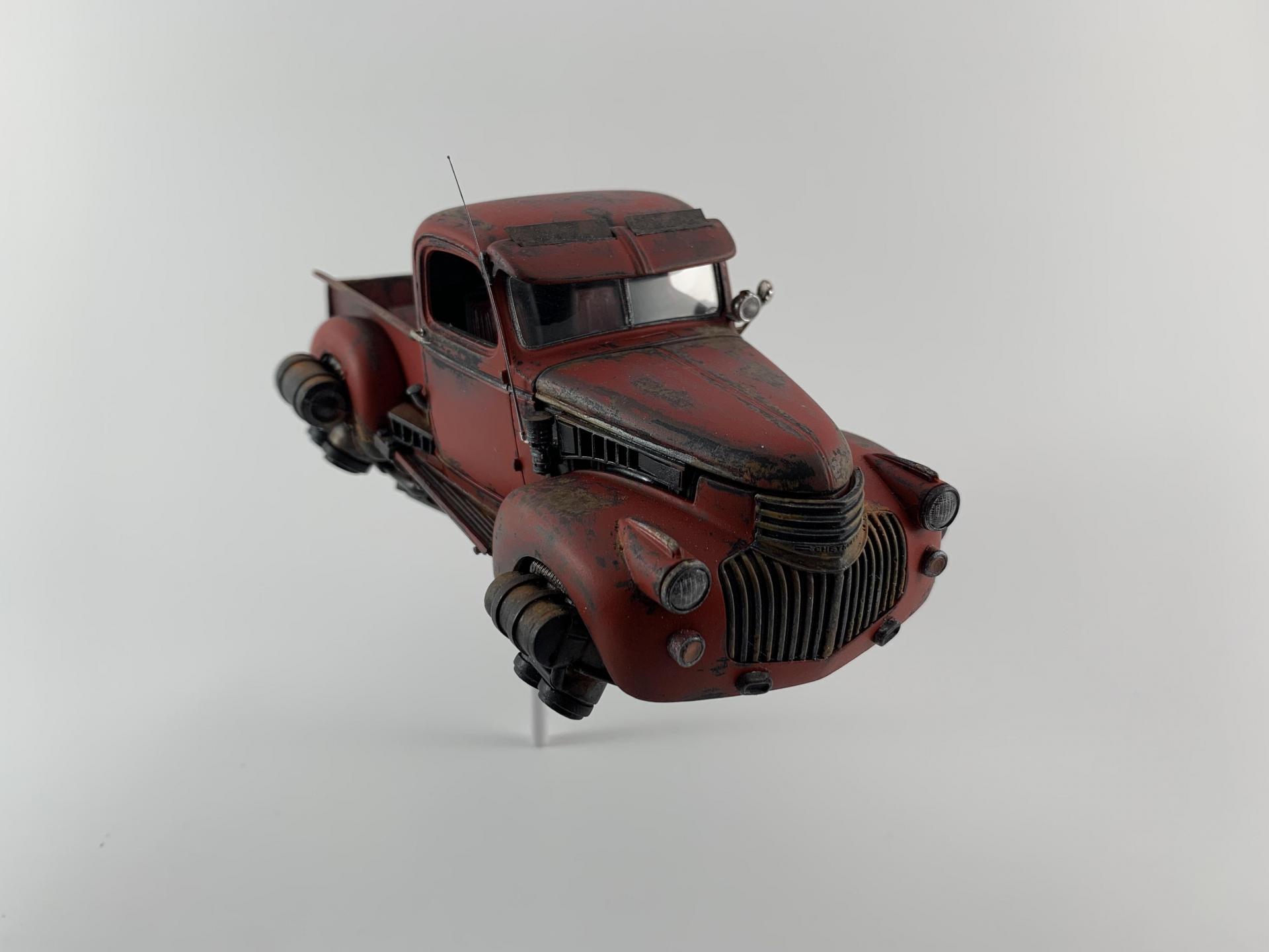

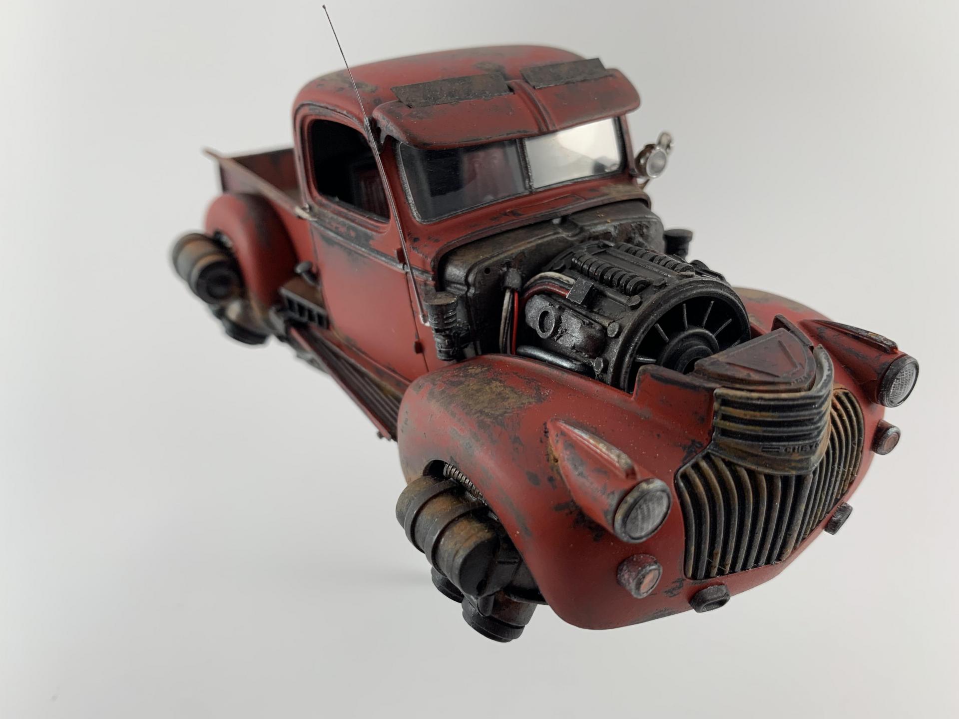

It's a great feeling when you finish a model that you really enjoyed working on. This is a 41 Chevy pickup 1/25 kit from Revell. I made a few modifications....
I have been making these hover themed cars for a few years now. This pickup truck is number 6 of my fleet.
I really enjoy the DieselPunk, retro style. Lots of heavy steel, grime and mechanical gadgets that appear to serve a purpose. I typically use older cars with large protruding fenders. This way I can add lots of hardware under the wheel wells.

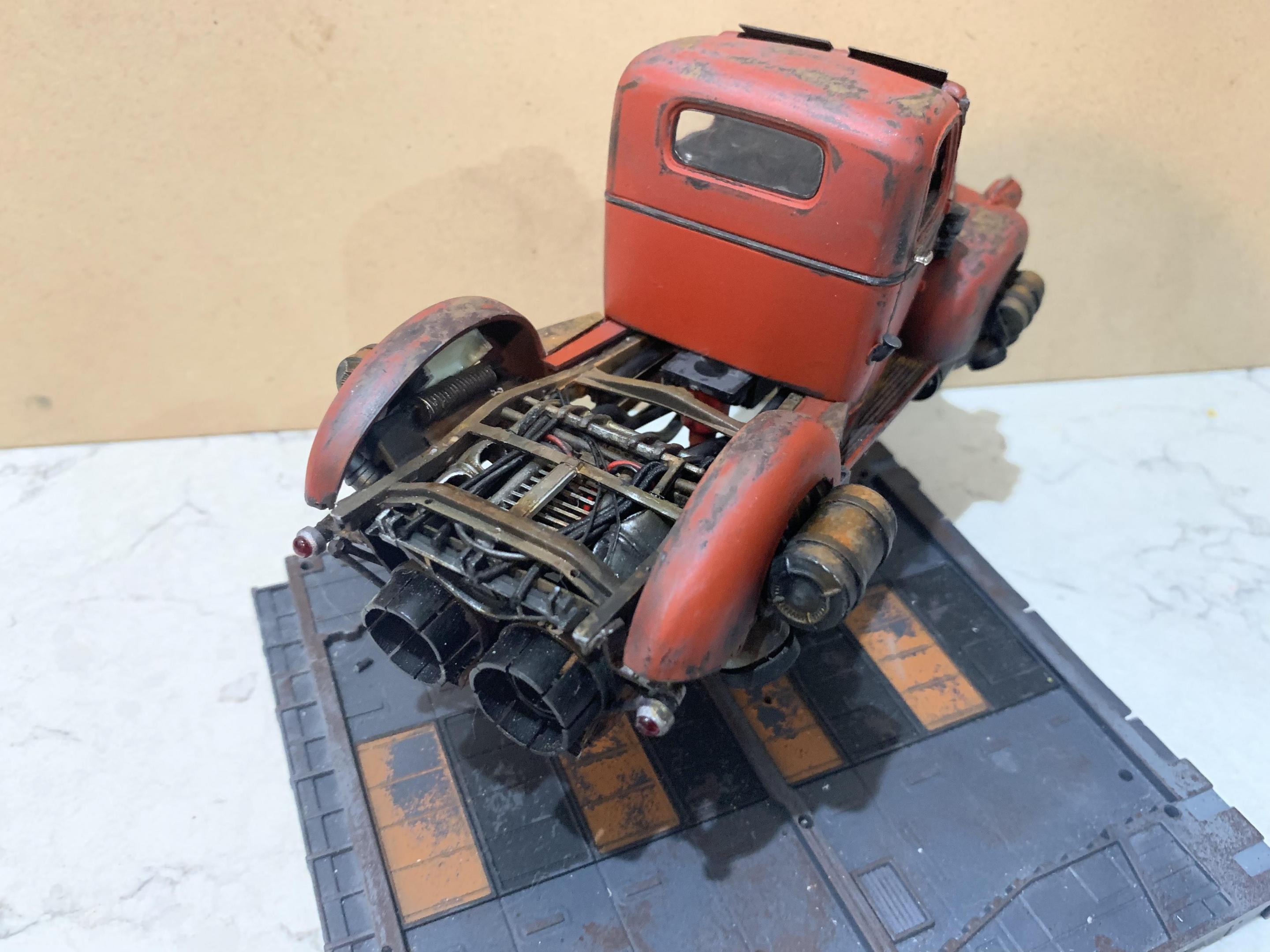

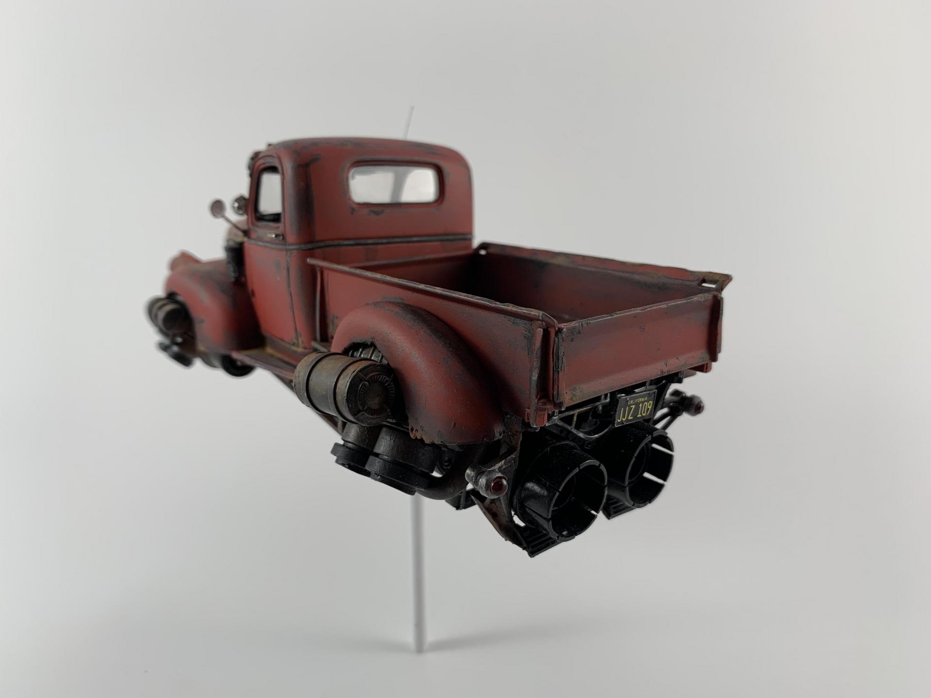

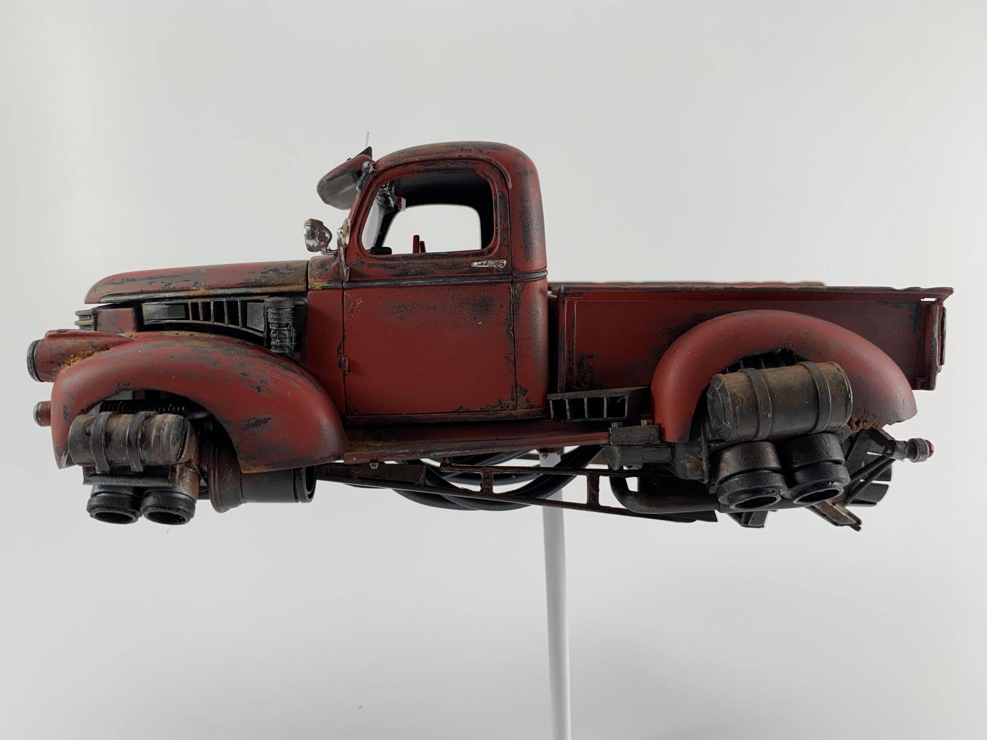

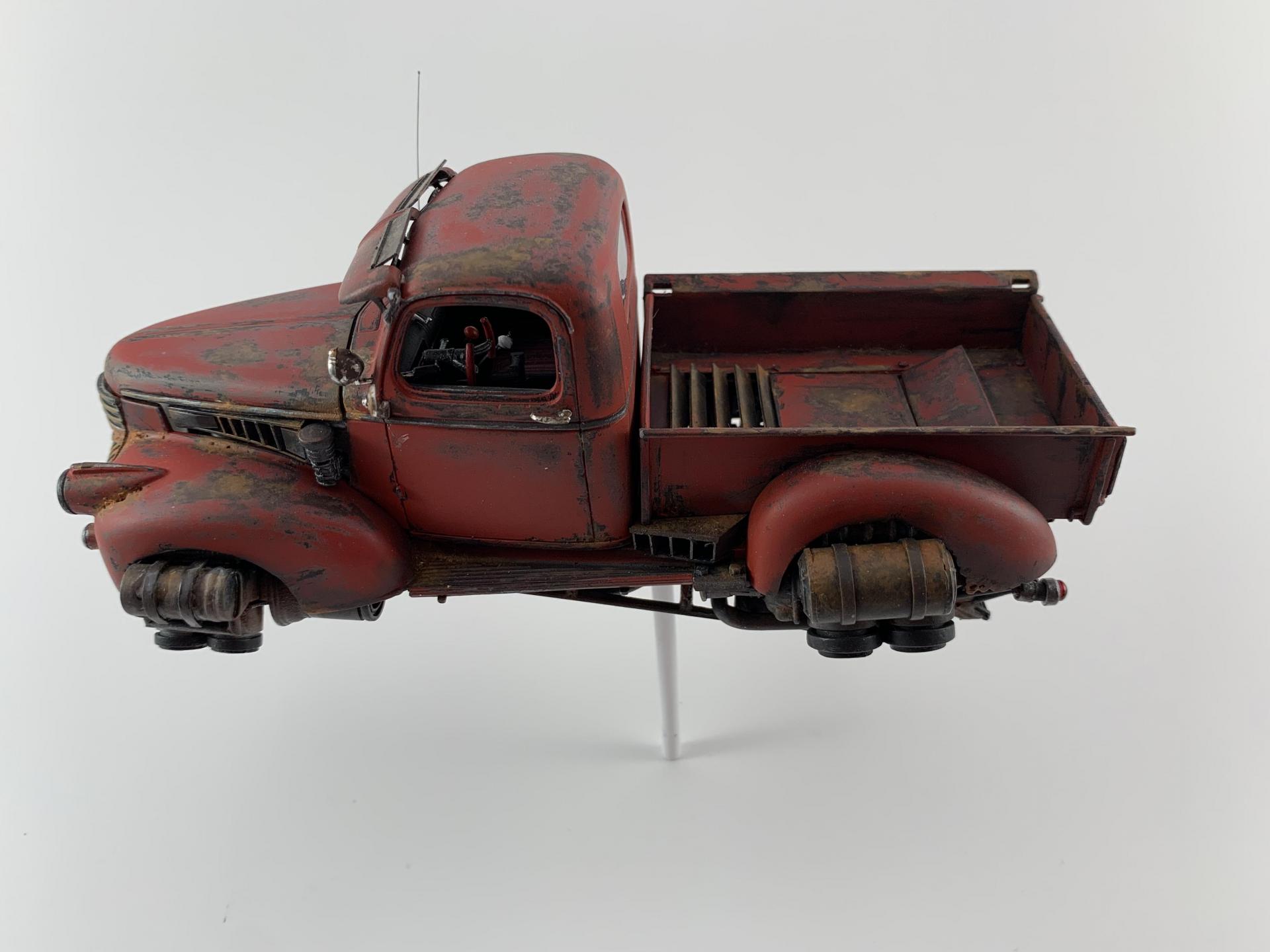

The truck has two large turbines that are attached to the frame, under the bed. These would be for forward propulsion. The turbines at the corners of the truck would be for take-off, landing and turning.

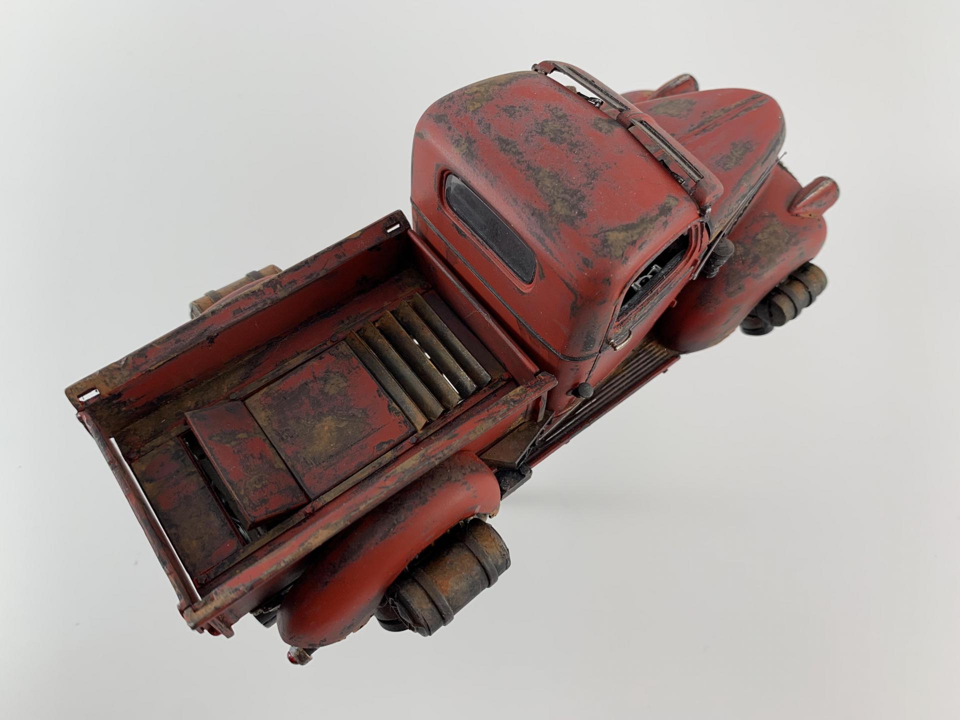

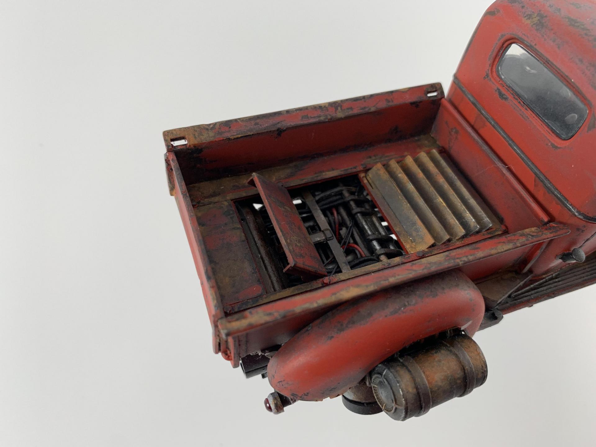

Since the two large turbines under the truck would need plenty of air, I made the large intake vents in the truck bed. One intake on each the side of the truck bed as well.

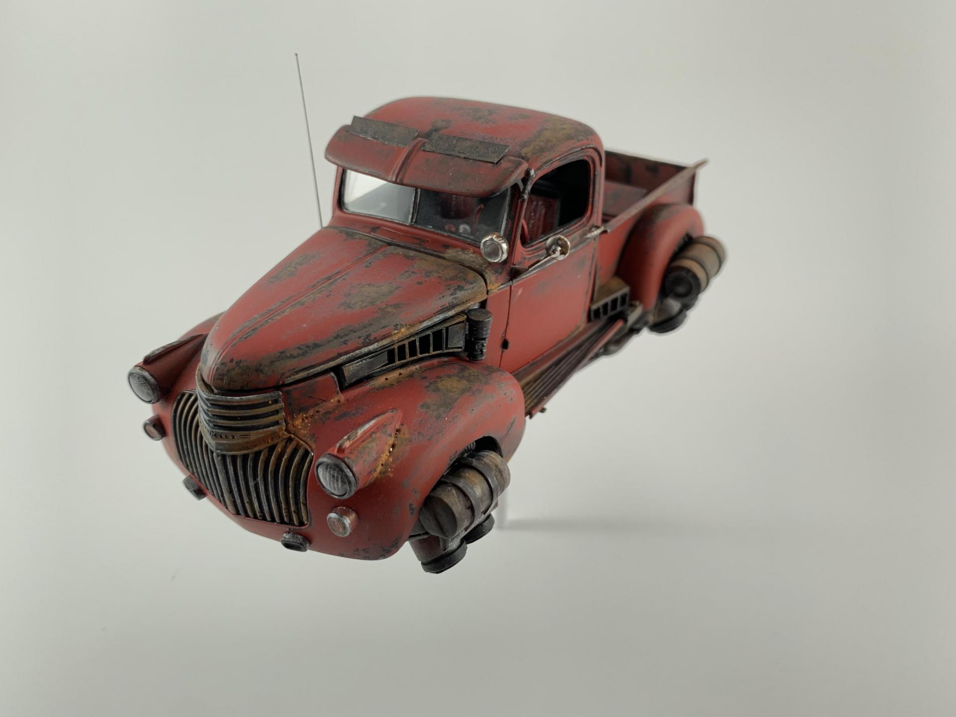

I love the grill of this truck. It has a very menacing feel. The turn signals were made from styrene tube. I melted some clear amber sprue for the lenses.

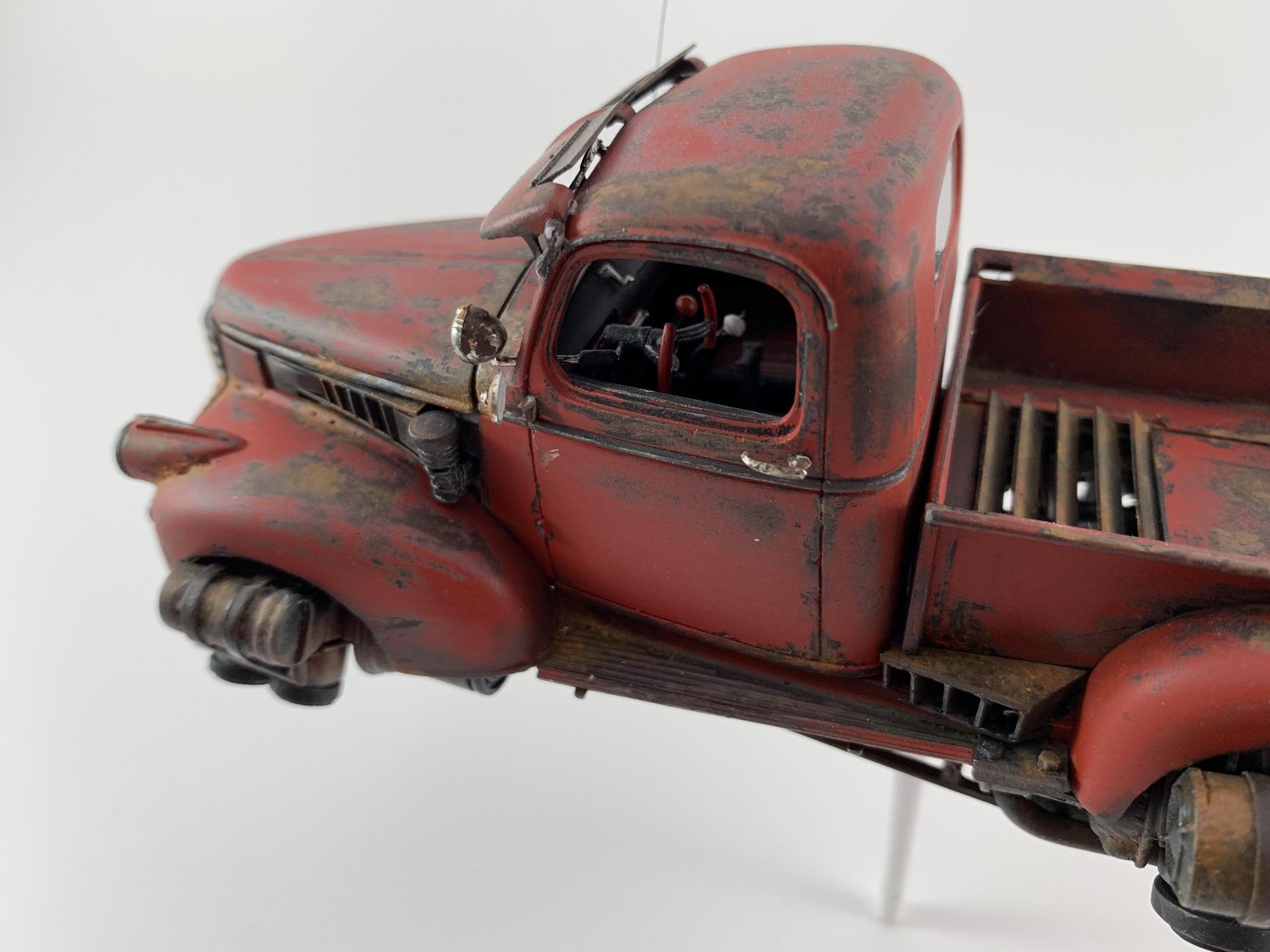

I had a second identical kit, that I borrowed a few other pieces from. The kit comes with 1 windshield wiper that goes on the driver's side roof. I used the wiper from the second kit on the passenger side. This unfortunately made it so that I had to mount the visor at a much higher angle. I really wasn't happy with it sitting up high on the roof, so I cut two reliefs for the wiper blades to go under. Now the visor sits at a proper, cool looking height, and it got some neat little air flaps.

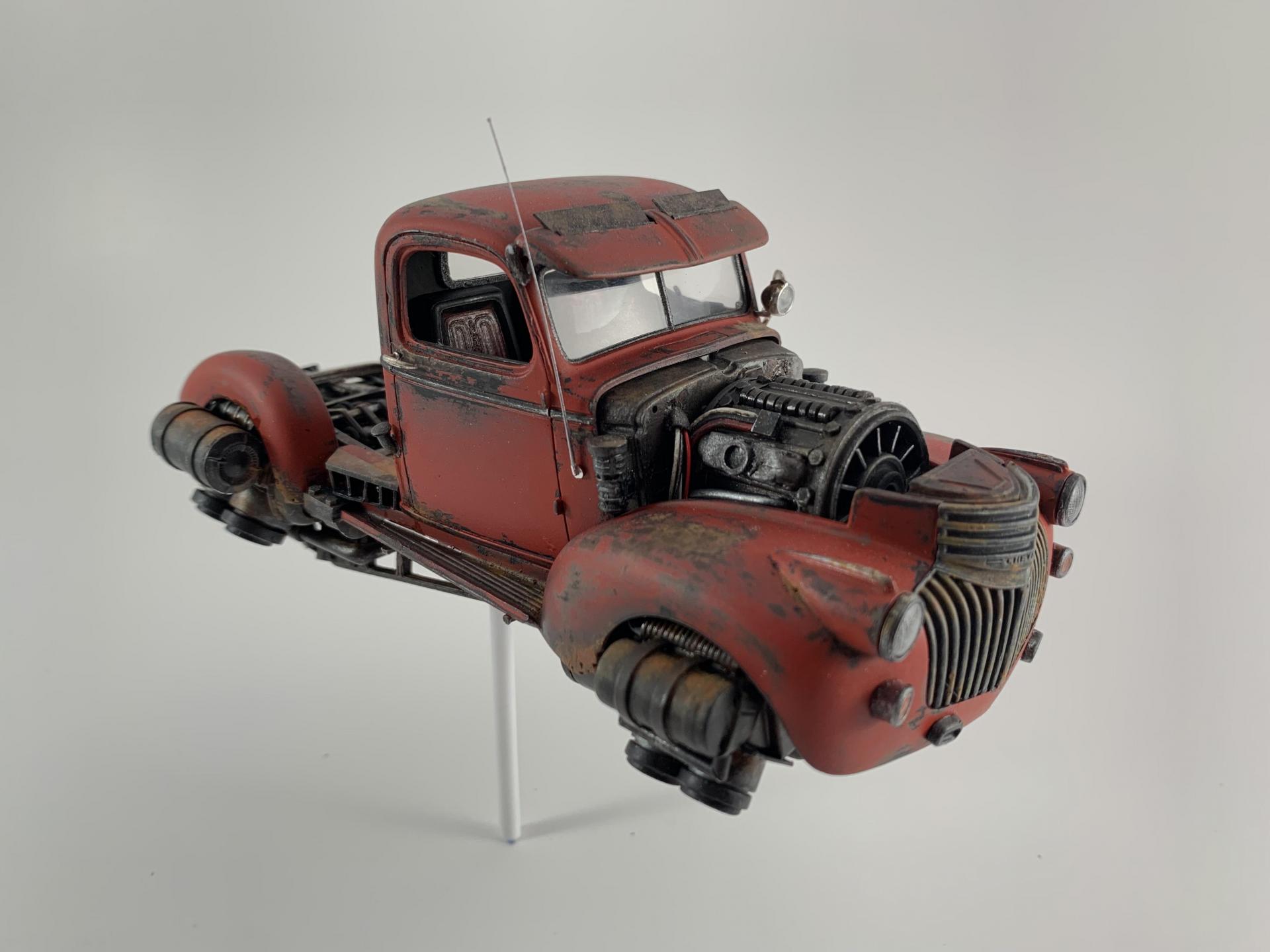

I wanted something interesting under the hood. I made this generator looking thing and it fit the look of the truck. I kept adding bits to it until I ran out of room.

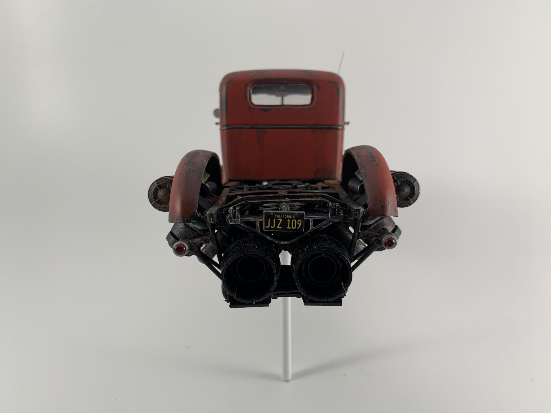

I mentioned big turbines. This is where the monster began. I made these twin turbines for a 71 Hemi Cuda that I was going to make into a hover car. I tried them under this truck and I instantly switched full time to this model.
The interior was good fun. I made a floor center console and added 2 long manual shifters. One red handled and one white. I added a few more flight controls and a throttle lever to the right of the driver's seat.  The steering wheel resembles a flight yoke.

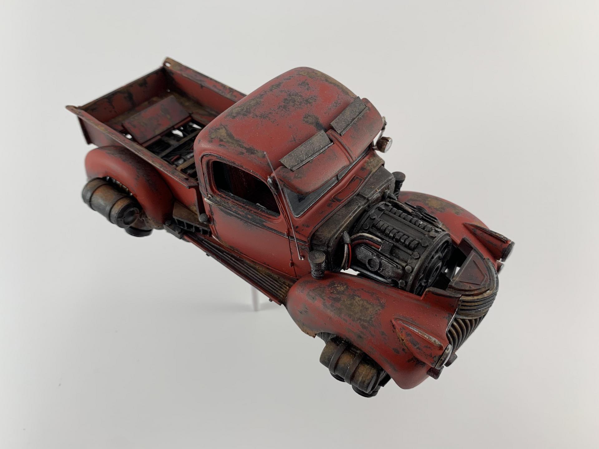

I made a access plate that could be removed to work on the large turbines.The second plate is hinged and lifts for cooling. Most of the wires and hoses are styrene rod.

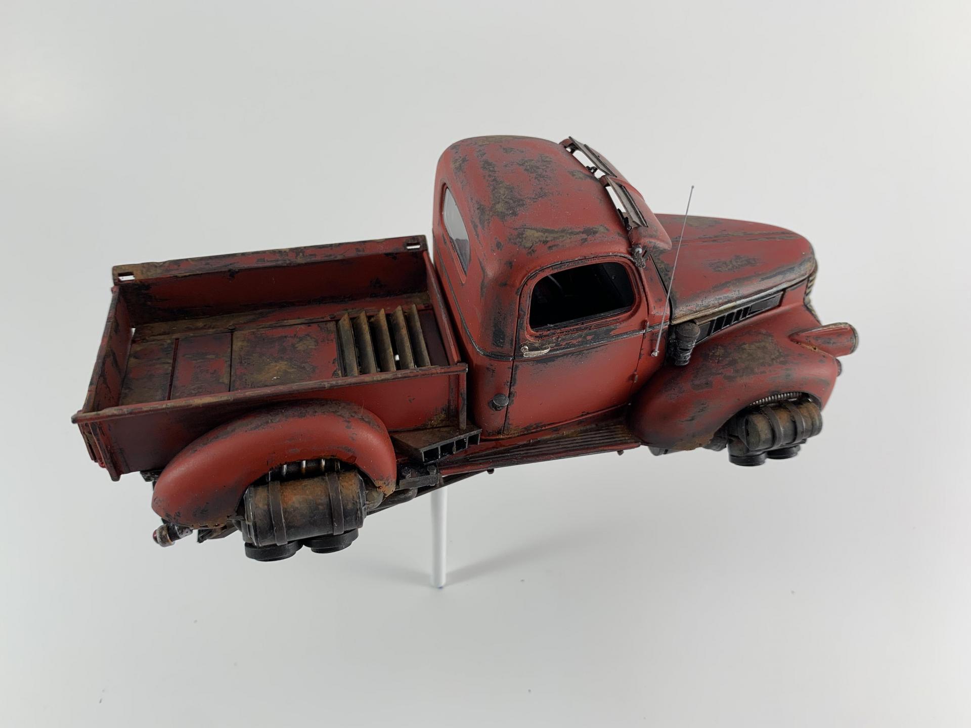

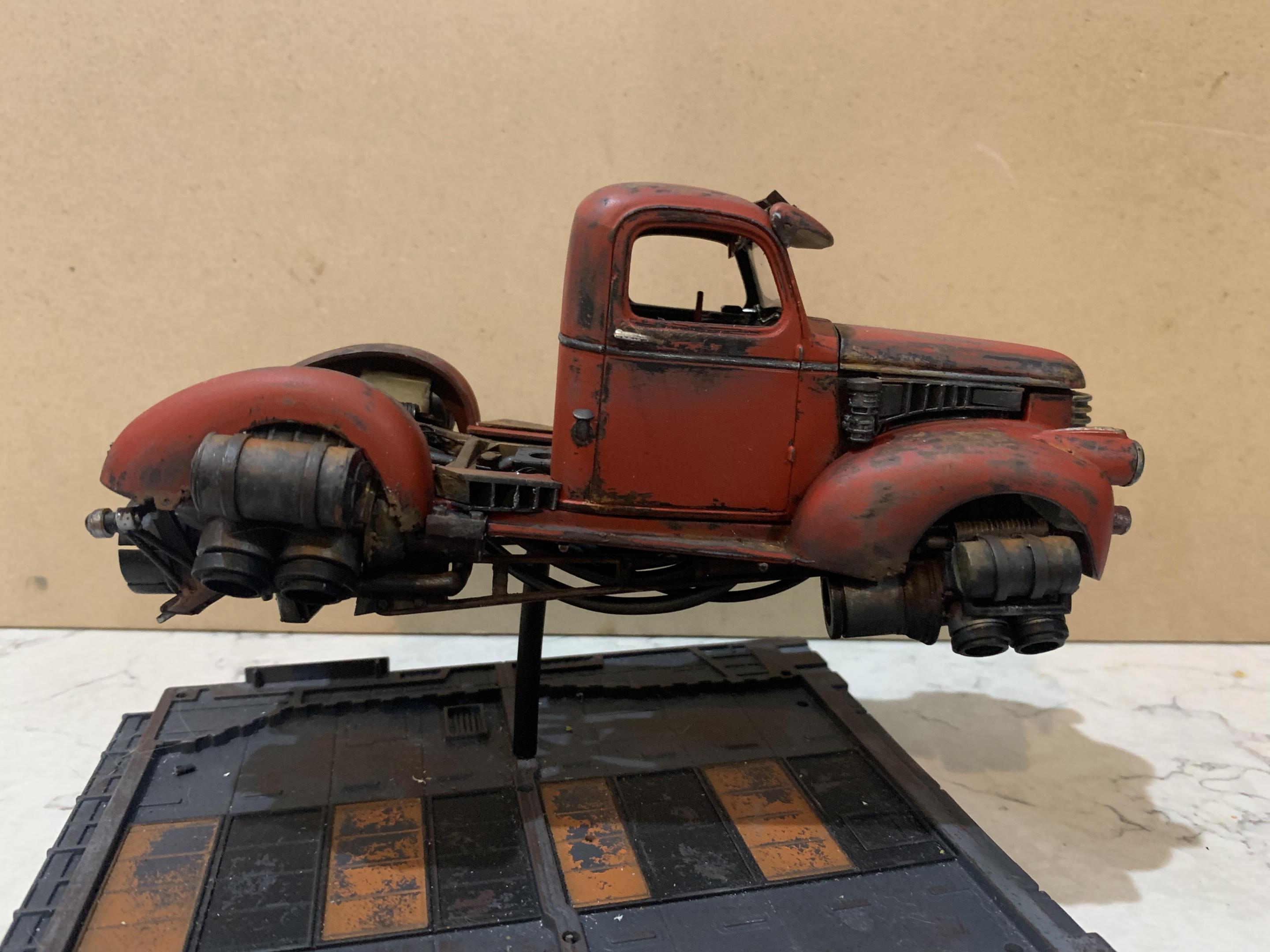

Here's a few more of the truck.
This view shows a little more of the undercarriage.
IMG_2314.thumb.JPG.a92e17e807c1d4659c0f69f4835f64ad.JPGIMG_2321.thumb.JPG.1e65f245e15b57863f49fe398c5e5428.JPGIMG_2327.thumb.JPG.ab16d1d5d6cb5e341a9a8e0172de3255.JPG

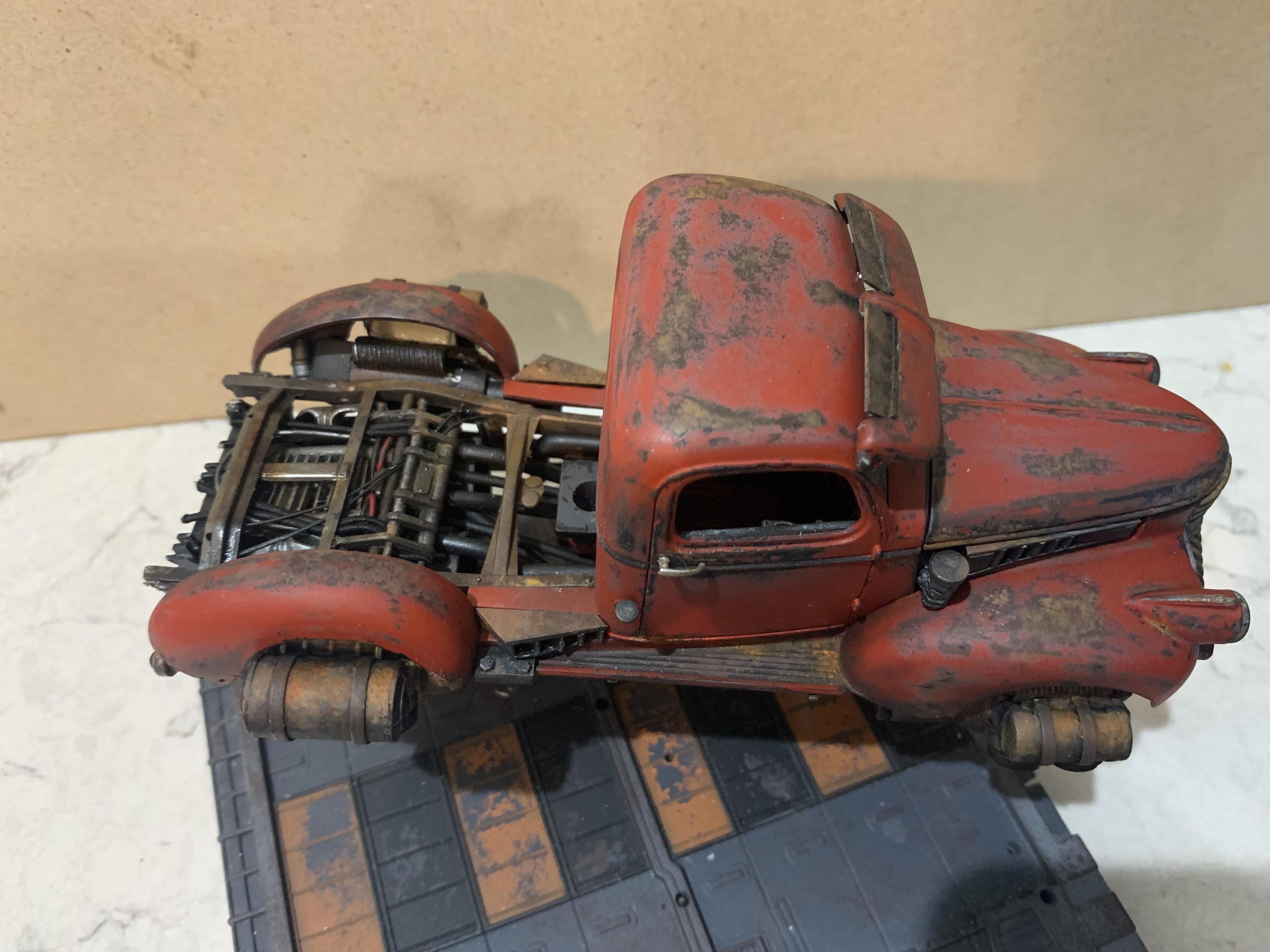

I haven't glued the truck bed on. I like the look of it without as well.

The Kansas City scale model show is in June I believe. This kit has been 95% done since November. I've known that I have a few spots left to weather and get the final details done before the show.
Gotta say, I do love how it looks with the bed removed. I like your idea. I'm going to seriously think about this.
IMG_2133.thumb.JPG.08c5d0c571c3734bf8b3849df18608f5.JPGIMG_2132.thumb.JPG.7ce7b3d2eaa6827f2343dff49aa8cc41.JPGIMG_2131.thumb.JPG.19cbbca9d96d9d5db507edb17524f335.JPG
It would give me an excuse to build the hover chopper that I've been wanting to make for years now.
