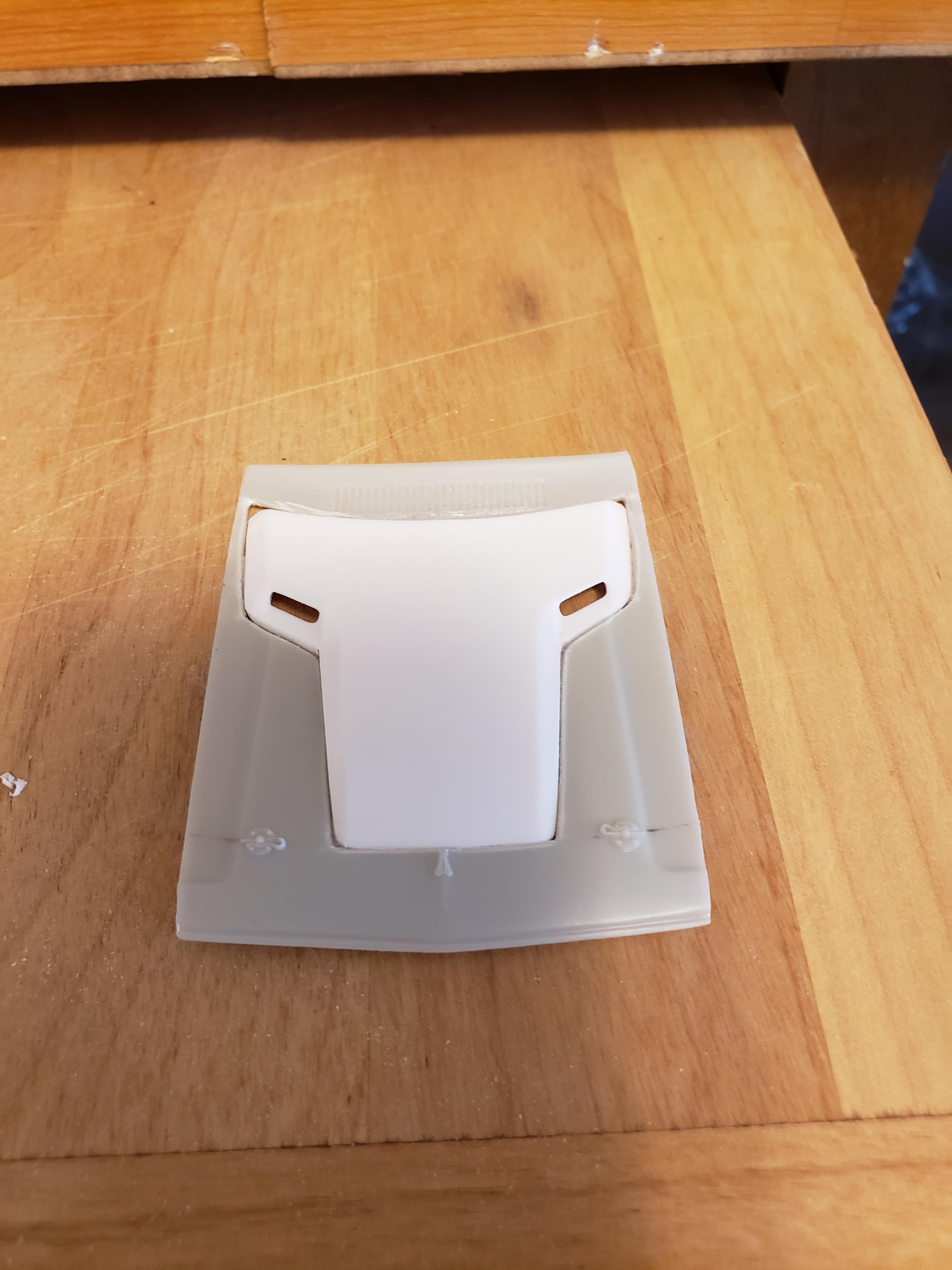

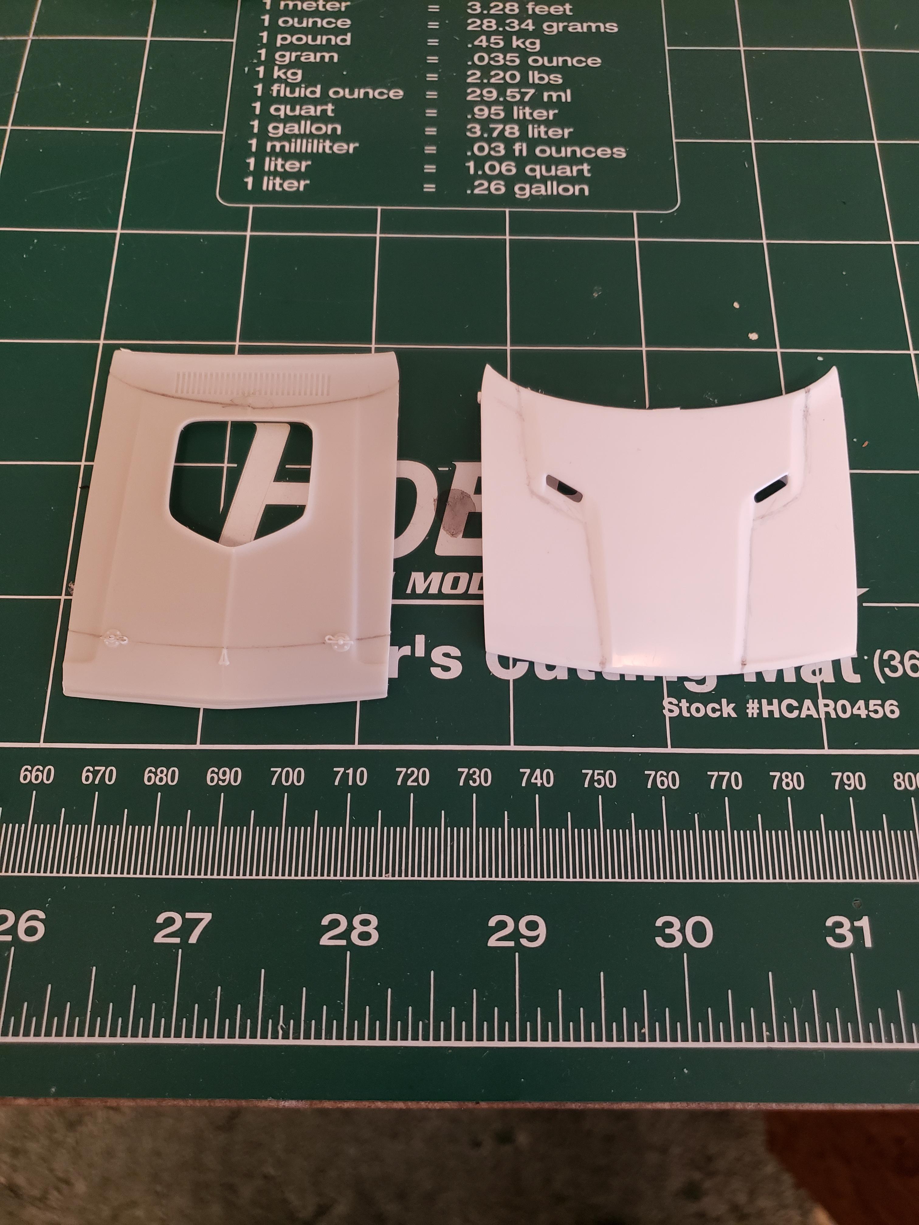

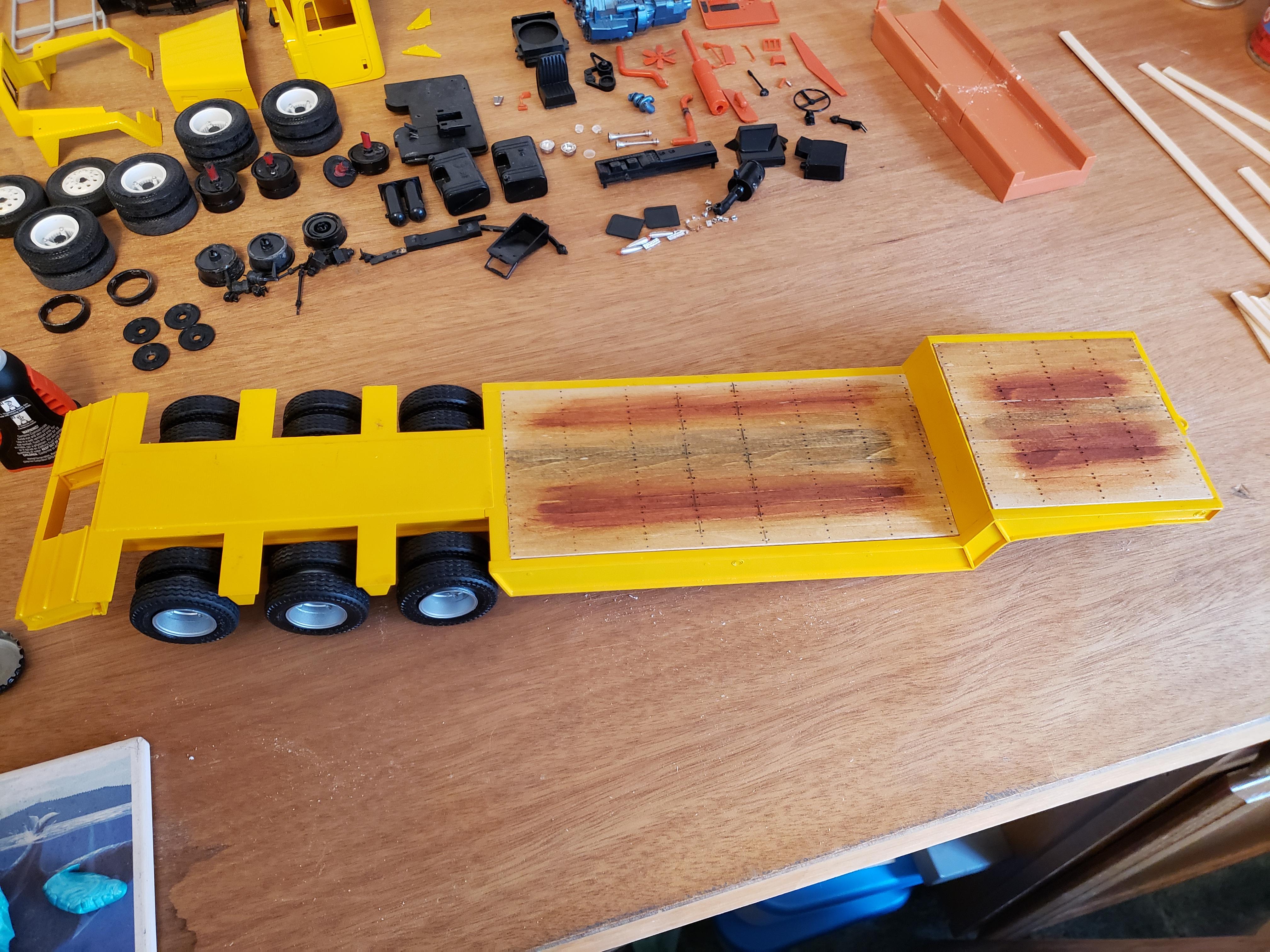

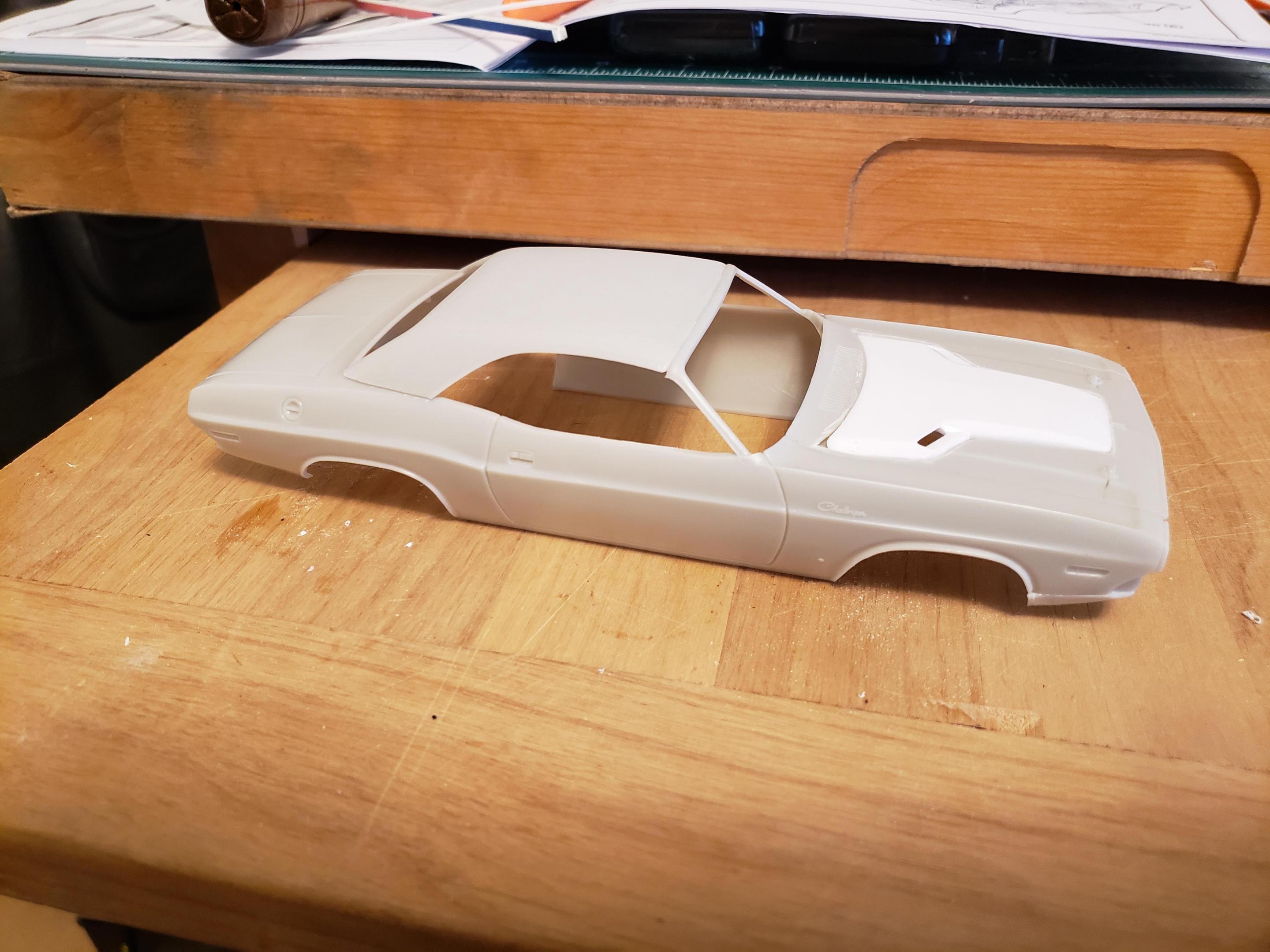

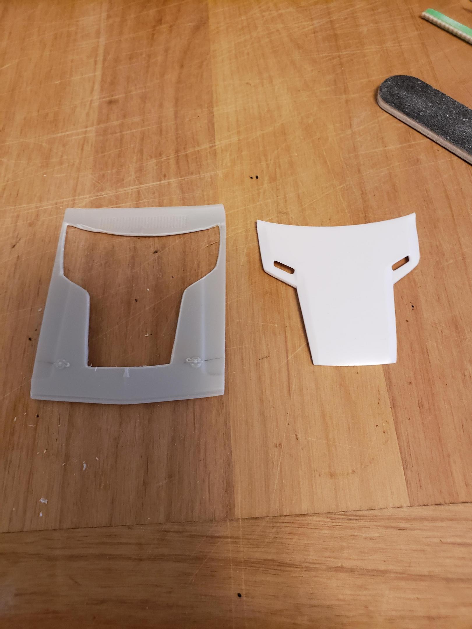

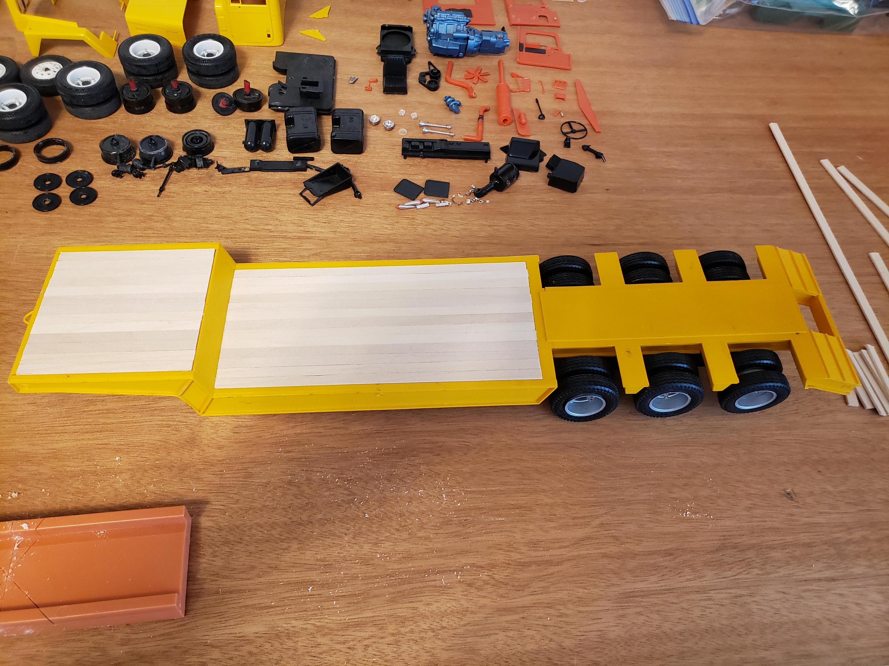

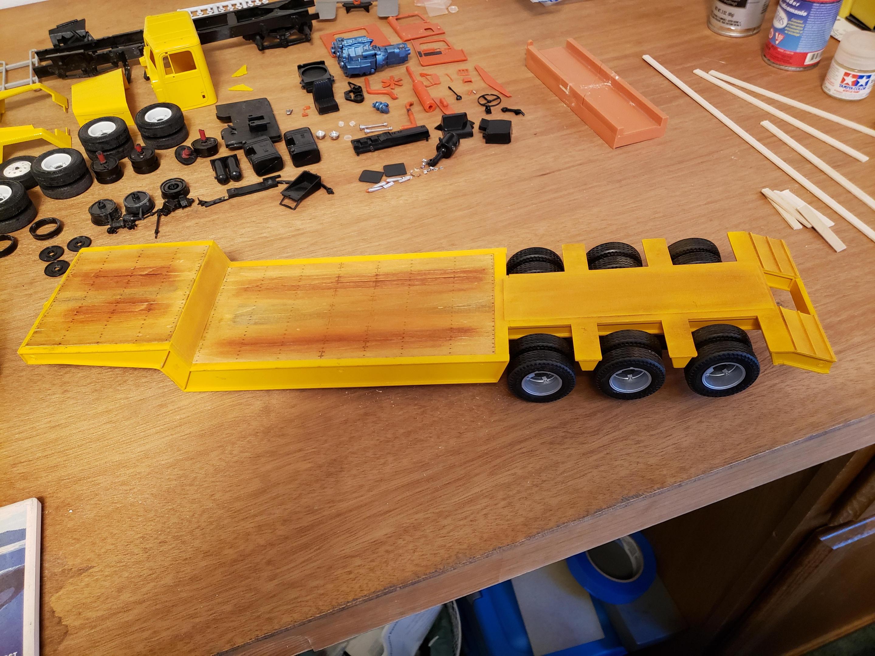

Sam I Am Posted April 11, 2020 Posted April 11, 2020 After dealing with a bunch of squirrels, I was able to get a bit done on both my group builds. I was able to get all the vinyl grain sanded off the top of my Challenger and glued in place. I also cut out the center of a modern Challenger hood and grafted it into the old hood. It is all roughed in and now for filler... I also replaced the plastic wood on my lowboy with basswood strips. I marked out all the bolt heads, washed with various thinned oil paints, and topped everything off with different chalk powders. Here is where I am on that.

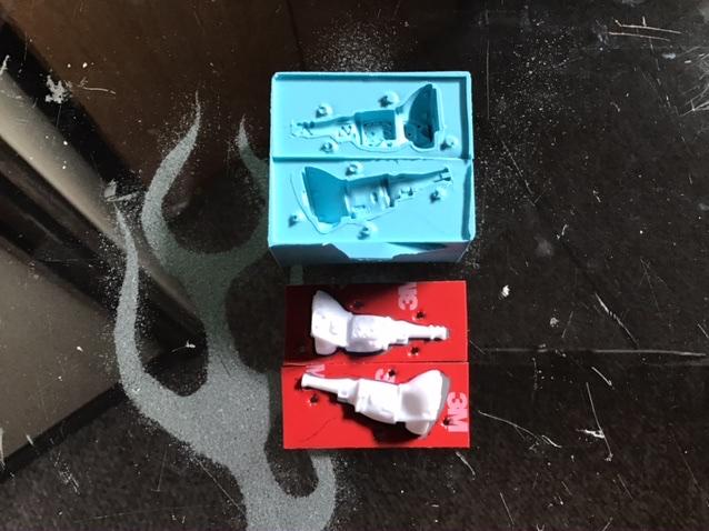

NOBLNG Posted April 11, 2020 Posted April 11, 2020 (edited) 4 hours ago, ChrisBcritter said: Poured '63 Riviera standard wheelcover #2 and pressure potted it, along with some extra singles: two styles of '57 Plymouth, '57 DeSoto, '59 Continental and '60 Ford pickup, plus another '36 Ford wheel center and ''63 Nova taillight bezel to use up the extra resin. Nice! I recently took a class on resin casting. I did this mold for the transmission in the Revell ‘68 Charger kit from the left over silicone. I want to steal one engine/trans for a project which leaves me 1 transmission short.? You would think Revell could afford to give you two gearboxes? Especially since these are separate... an auto and a manual would be nice. That said, it is a rewarding feeling when you pull off a nice casting! Edited April 11, 2020 by NOBLNG

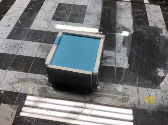

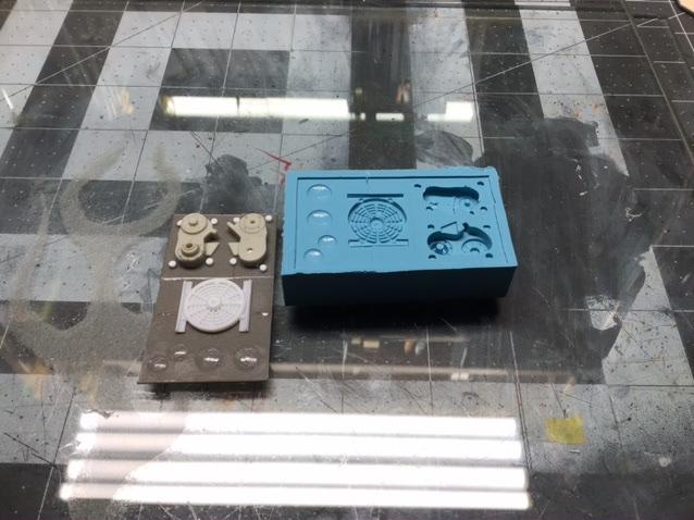

NOBLNG Posted April 12, 2020 Posted April 12, 2020 Made a mold to duplicate a NP205 transfer case. While I was at it I figured I would also do a cooling fan and some headlight lenses.

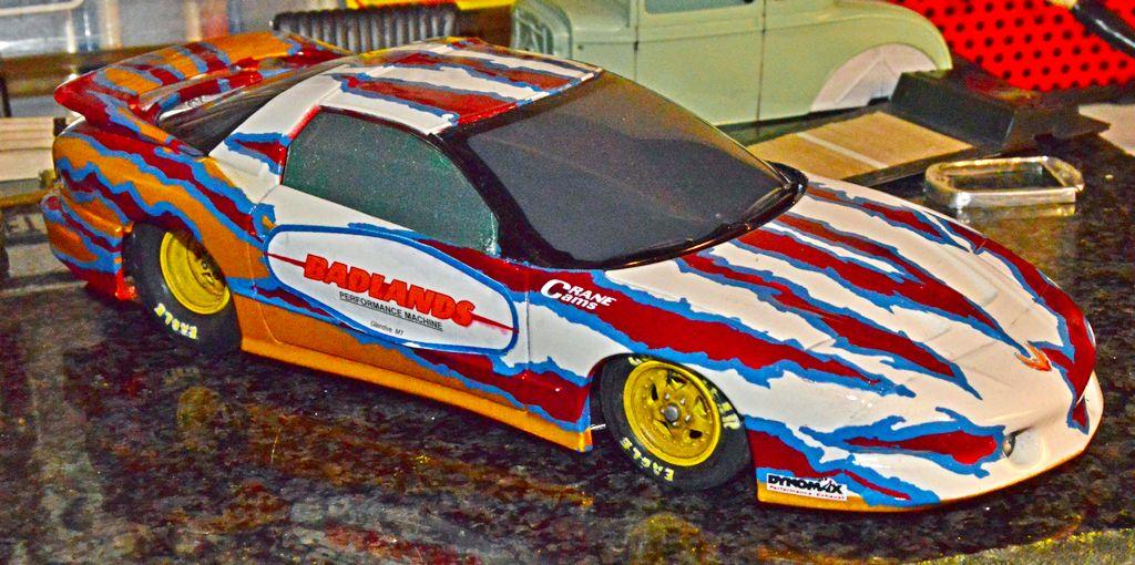

Straightliner59 Posted April 12, 2020 Posted April 12, 2020 I got some fictitious livery created for the Firebird.

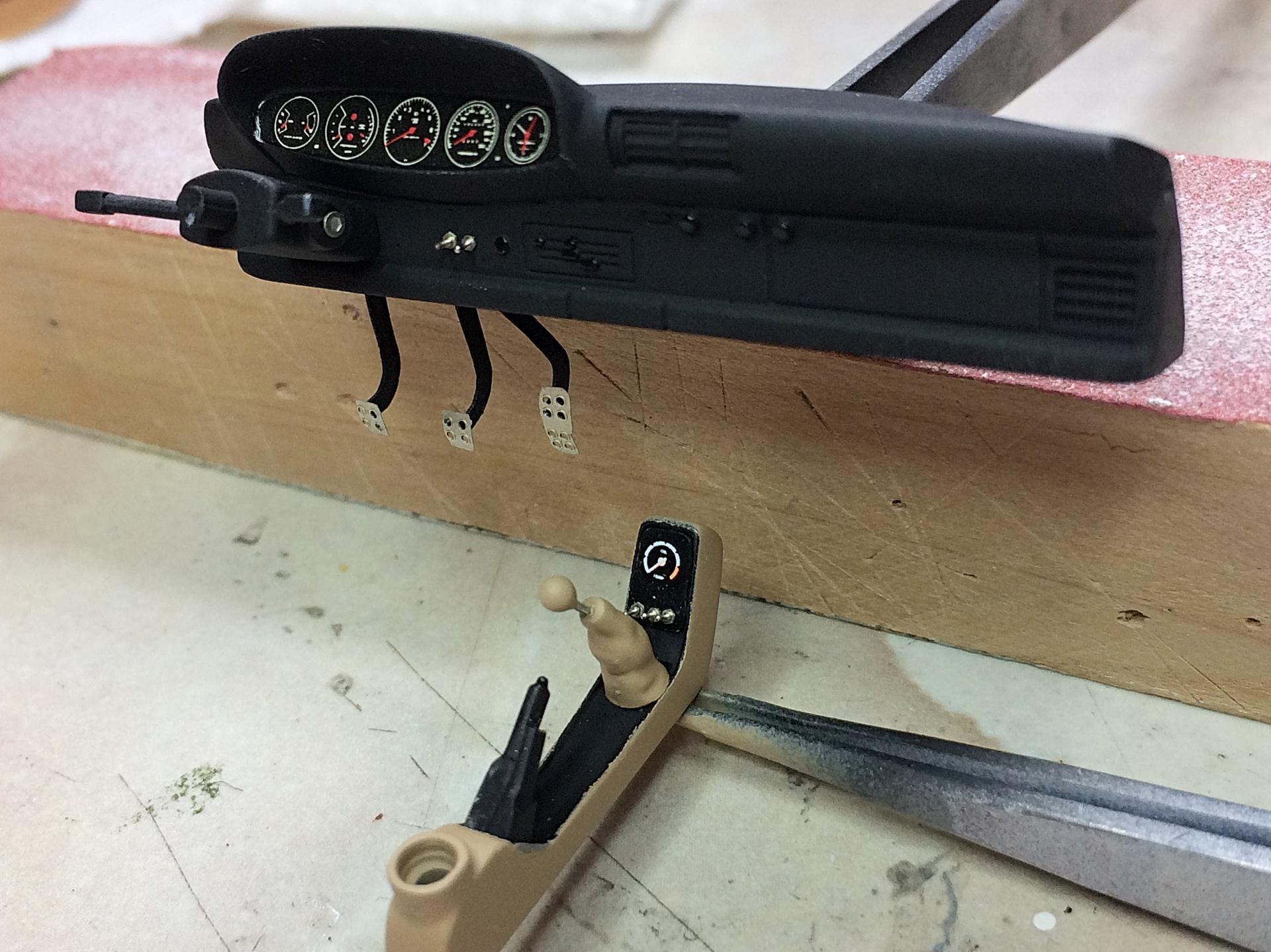

OldNYJim Posted April 14, 2020 Posted April 14, 2020 On 4/11/2020 at 9:55 PM, 89AKurt said: Huh, I'm amazed any kit has hood hinges. I made metal hinges, wish I could do pins that wouldn't shear or break. I'm sure antique watch makers have the knowledge for such things. I had also recently ordered magnets, they sure can be useful! Tested my vision, finesse, and patience with these microscopic toggle switches. Stunning!

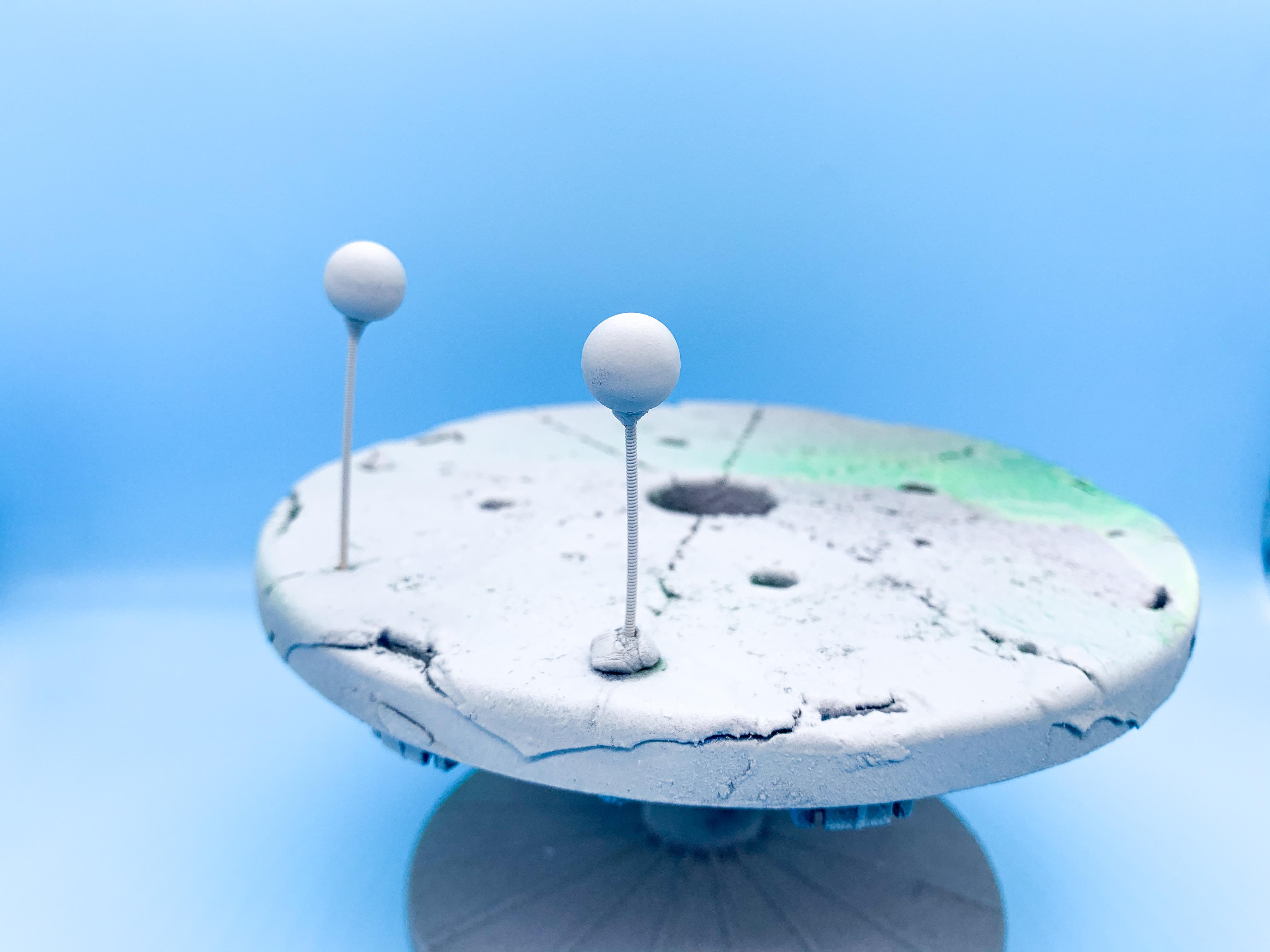

OldNYJim Posted April 14, 2020 Posted April 14, 2020 Spent the day polishing these balls: They’re the light globes from a Paddy Wagon - but they’re not quite round and they have a seam that runs around them so I’ve been trying to resolve both issues. Not sure if I’m any closer after three rounds of filling/priming/sanding than I was when I started ??. It’s surprisingly difficult to sand something into a perfect sphere! ?
