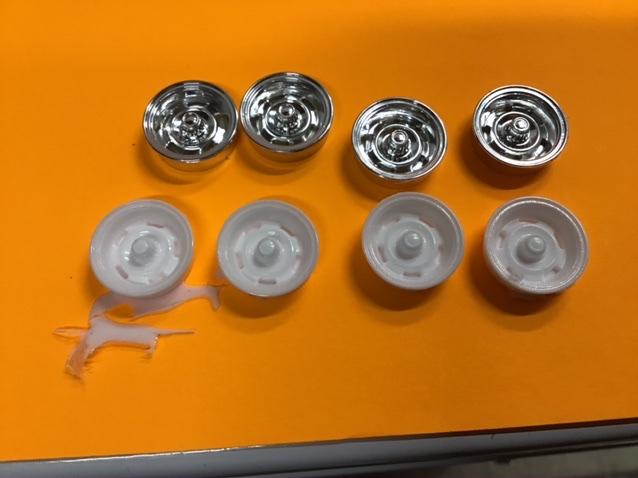

NOBLNG Posted April 24, 2020 Posted April 24, 2020 Did my first castings at home. They turned out pretty good I think.
ChrisBcritter Posted April 24, 2020 Posted April 24, 2020 ^^^ Nice going! What brand of resin did you use?
NOBLNG Posted April 25, 2020 Posted April 25, 2020 (edited) 14 hours ago, ChrisBcritter said: ^^^ Nice going! What brand of resin did you use? Smooth-On, Smooth Cast 305. Seven minute pot life and 30 min. cure time. I am pleased with the results since I don’t have a vacuum chamber or pressure pot!? There were a few bubbles, but I stirred most of them out with a toothpick after pouring it in the mold. It is clear until it starts to set. I did about 10 rims plus all that with 2 oz. of resin and still had some leftover. The rally rims came out beautiful!? Edited April 25, 2020 by NOBLNG
stinkybritches Posted April 25, 2020 Posted April 25, 2020 9 hours ago, NOBLNG said: Smooth-On, Smooth Cast 305. Seven minute pot life and 30 min. cure time. I am pleased with the results since I don’t have a vacuum chamber or pressure pot!? There were a few bubbles, but I stirred most of them out with a toothpick after pouring it in the mold. It is clear until it starts to set. I did about 10 rims plus all that with 2 oz. of resin and still had some leftover. The rally rims came out beautiful!? Did you also use a Smooth-on material for your mold?
NOBLNG Posted April 25, 2020 Posted April 25, 2020 1 hour ago, stinkybritches said: Did you also use a Smooth-on material for your mold? Yes, OoMoo 25. Very easy stuff to work with.
stinkybritches Posted April 25, 2020 Posted April 25, 2020 3 hours ago, NOBLNG said: Yes, OoMoo 25. Very easy stuff to work with. Thanks for the information.

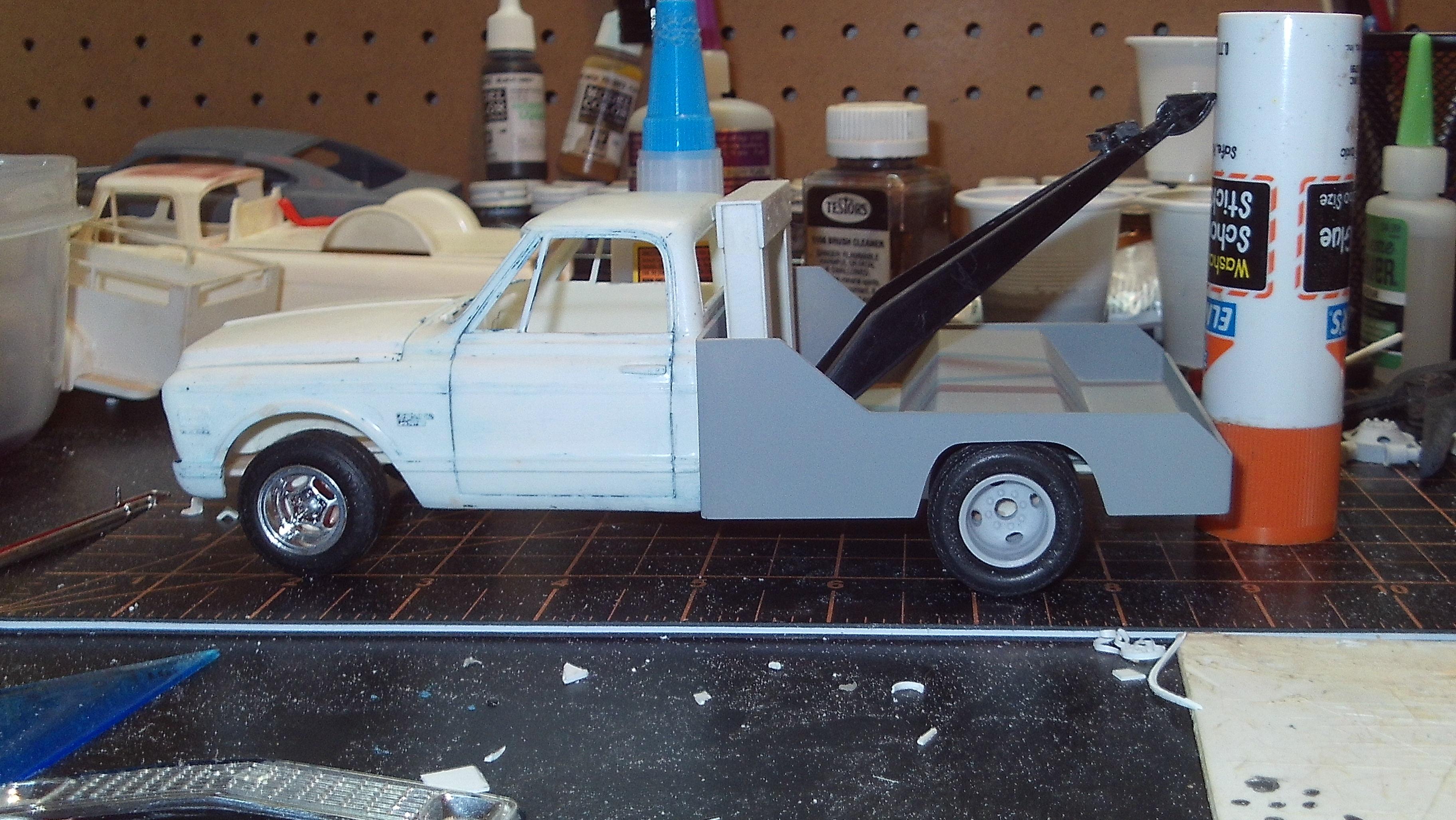

mchook Posted April 25, 2020 Posted April 25, 2020 I got the old paint stripped off the cab & finished the big parts of the wrecker body today.

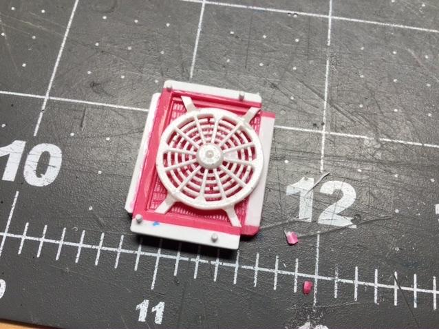

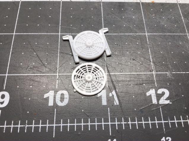

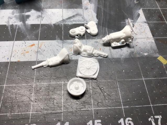

NOBLNG Posted April 26, 2020 Posted April 26, 2020 (edited) I made a resin copy of an electric fan the other day and today I sanded it down and opened up the slots. Then I mounted it to a custom built aluminum, err...plaluminum radiator.? Edited April 26, 2020 by NOBLNG

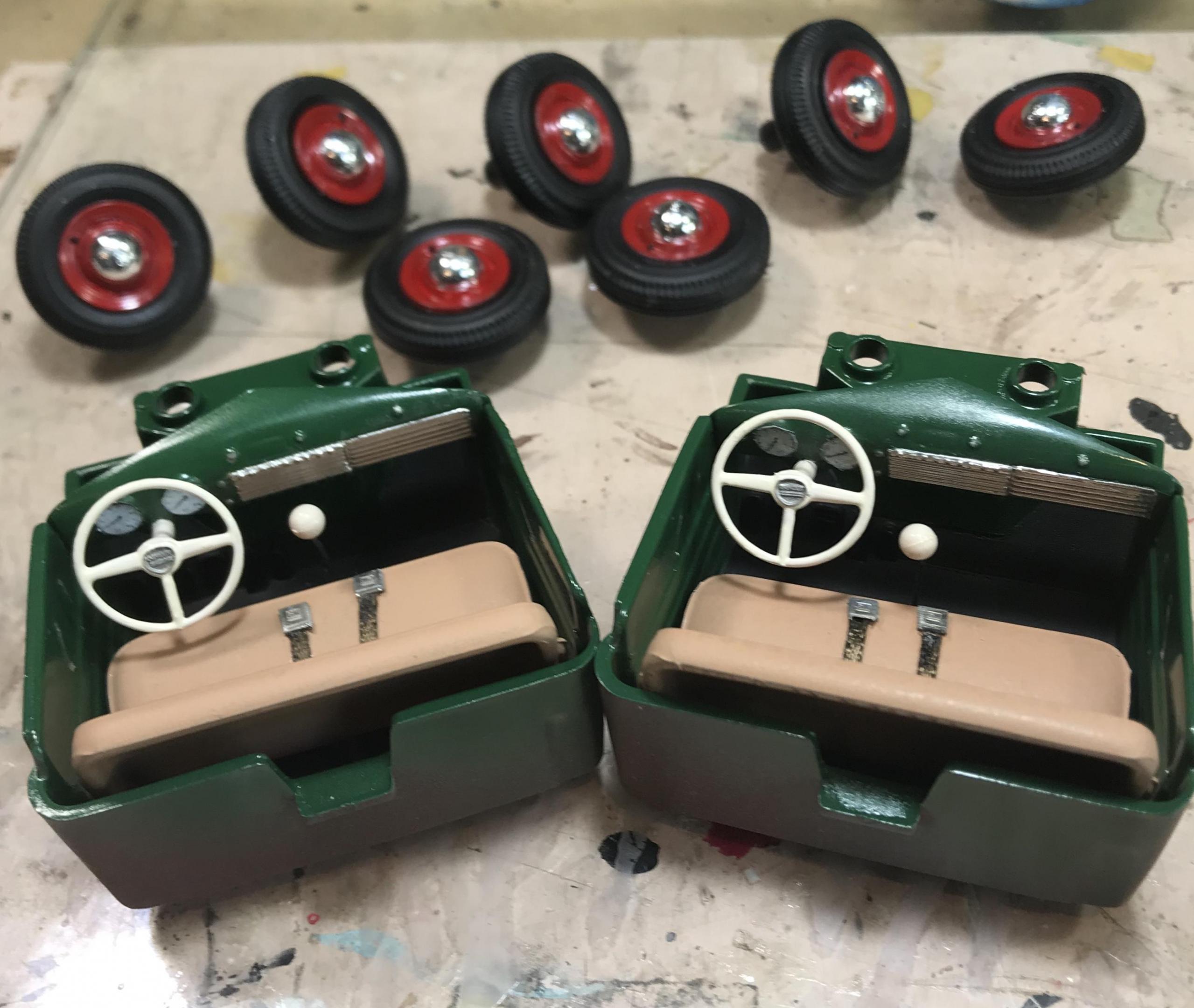

Tom Geiger Posted April 27, 2020 Posted April 27, 2020 My work here is done! Finished up the pair this afternoon. Time to find another house to flip!

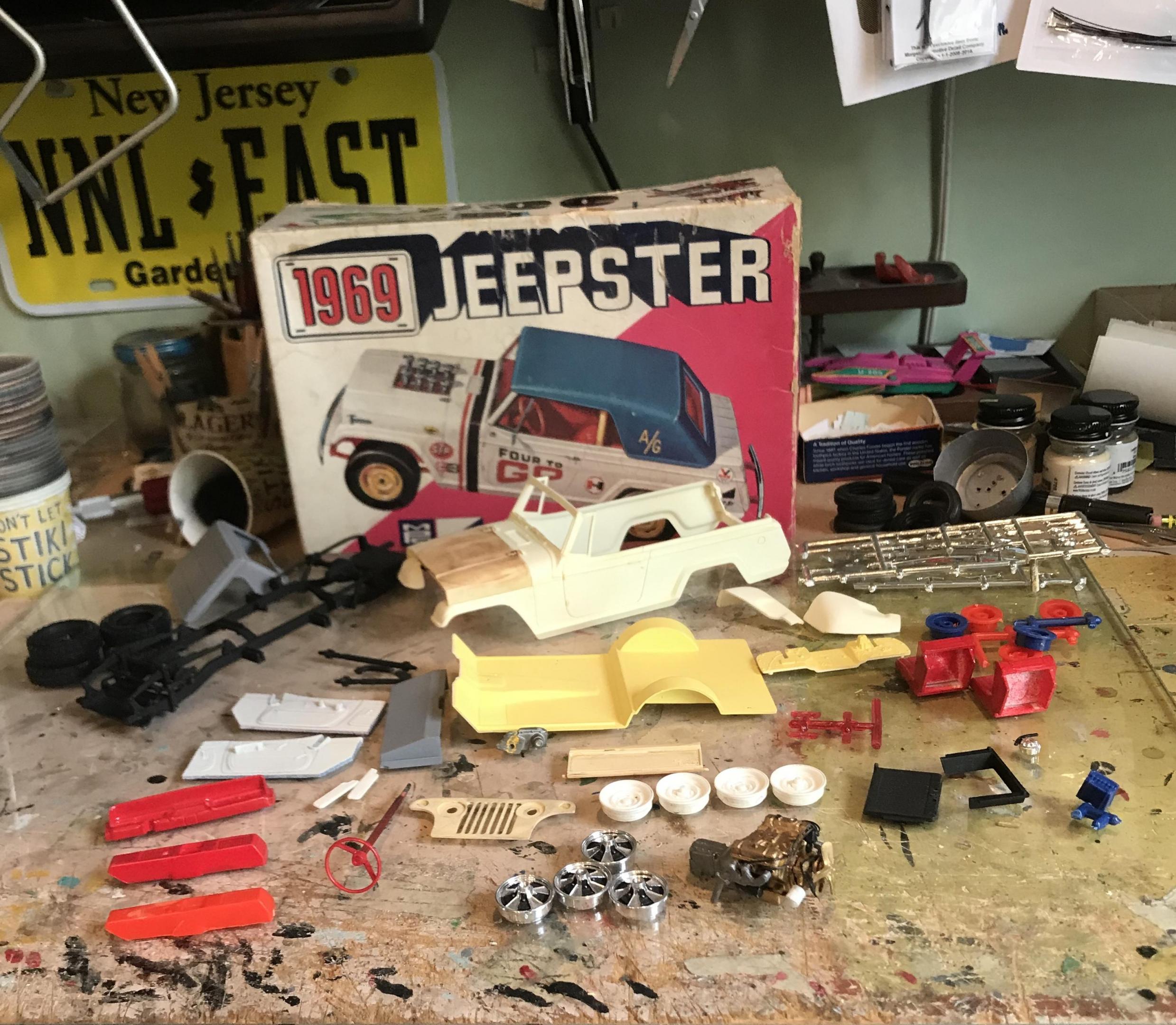

Tom Geiger Posted April 28, 2020 Posted April 28, 2020 (edited) Started a pair of Jeepsters today. One will be a pickup and the other will be a convertible with a backseat. Working with what I have on hand, and because i already have an interior In this color, the pickup will be red. Not sure about Jeepster two just yet. So far I pieced together two vehicles from boxes of parts including a couple of the later Commandos. I have cleaned up two bodies this afternoon. The hoods have a scoop cut out that’s exceptionally deep and can be seen as a distortion from the top of the hood. These are sitting filled with thick CA drying. We are on our way! Edited April 28, 2020 by Tom Geiger
