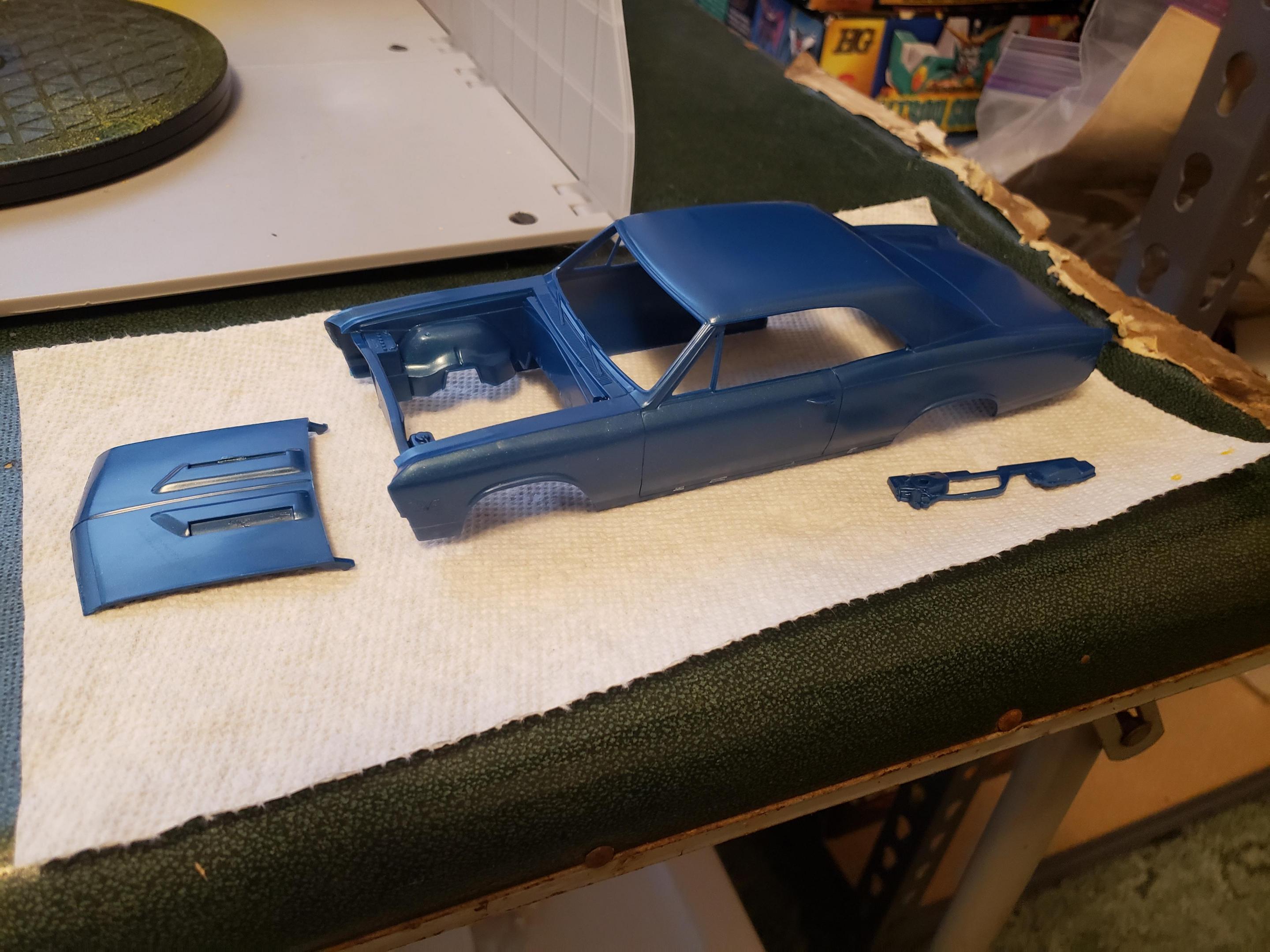

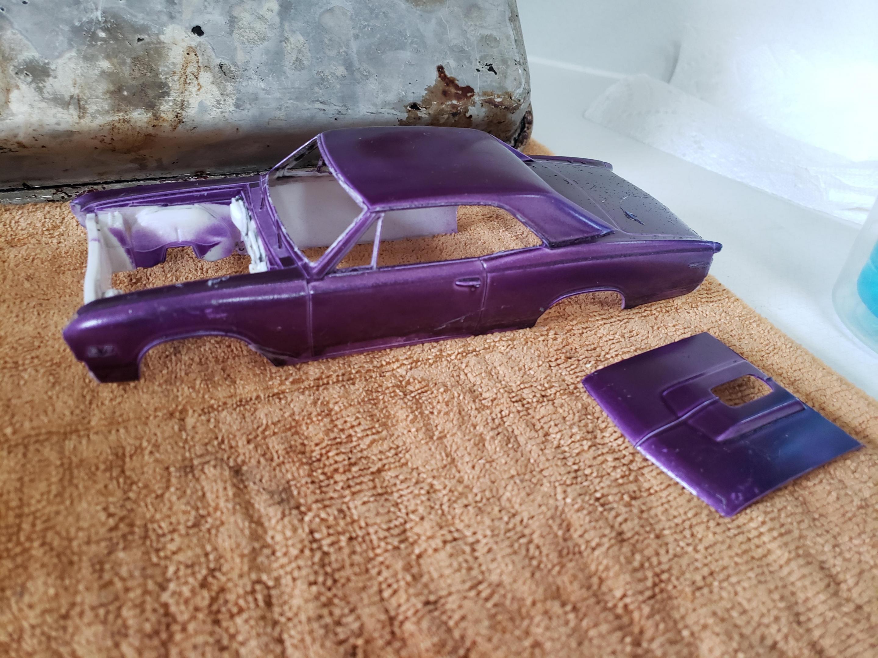

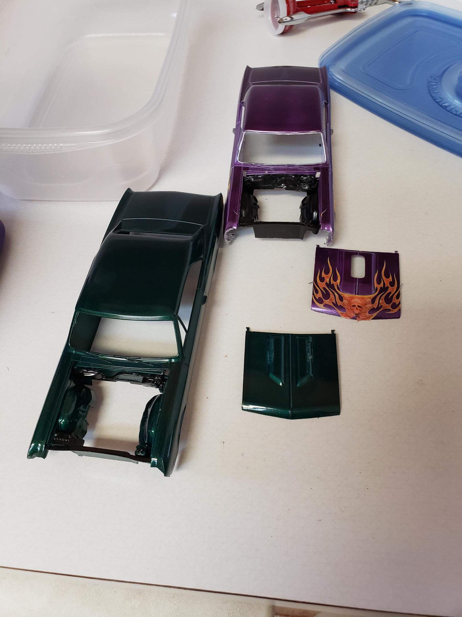

Sam I Am Posted January 8, 2020 Posted January 8, 2020 Yesterday I put a pair of 67 Chevelle bodies in the purple pond. This morning the one that was painted green was completely stripped. The purple one was hardly touched. I put the interior and chassis of the green car in the pond this morning and as of this post it is almost clean.

StevenGuthmiller Posted January 8, 2020 Posted January 8, 2020 1 hour ago, Sam I Am said: Yesterday I put a pair of 67 Chevelle bodies in the purple pond. This morning the one that was painted green was completely stripped. The purple one was hardly touched. I put the interior and chassis of the green car in the pond this morning and as of this post it is almost clean. You might have to try another approach with the purple Chevelle. Obviously the body was never primed from looking at the photo, and depending on the sort of paint used, the purple stuff may not be able to penetrate. Which "purple stuff" did you use? I can tell you from experience that Purple Power works no where near as well as Super Clean. If you don't have Super Clean, try some Easy Off oven cleaner or alcohol. The paint looks very thin. It should not be difficult to remove. Also, in some circumstances, Super Clean may take longer to work than one day. Drop it in and walk away for a week. Chances are good that it will work with a little time. Steve
Snake45 Posted January 8, 2020 Author Posted January 8, 2020 Try rubbing alcohol on the purple one. If that's Testor lacquer, which it might well be, it will come right off.
magicmustang Posted January 8, 2020 Posted January 8, 2020 3 minutes ago, Snake45 said: Try rubbing alcohol on the purple one. If that's Testor lacquer, which it might well be, it will come right off. Be sure and use 90% alcohol as 70% may not do it either.
DPNM Posted January 8, 2020 Posted January 8, 2020 (edited) I recently tried to strip unprimed paint from a part and I let it soak in Super Clean for 5 days. It had no affect. I dripped some 91% alcohol on it and it will come off. When I need to strip that part I know I can put it in the alcohol. Edited January 8, 2020 by DPNM
Sam I Am Posted January 9, 2020 Posted January 9, 2020 Thanks guys. I am guessing that the green car was all testors enamels with how quickly the paint came off. If you notice the black paint in the engine compartment of the purple one came off quickly as well. I am using Super Clean here. While I have used dot3 brake fluid in the past, I have yet to try the 90% alcohol.
StevenGuthmiller Posted January 9, 2020 Posted January 9, 2020 48 minutes ago, Sam I Am said: Thanks guys. I am guessing that the green car was all testors enamels with how quickly the paint came off. If you notice the black paint in the engine compartment of the purple one came off quickly as well. I am using Super Clean here. While I have used dot3 brake fluid in the past, I have yet to try the 90% alcohol. Degreasers like Super Clean have little affect on lacquer paint itself. It works well with lacquer if the body has been primed first. It will get under the paint and dissolve the primer making the lacquer slough off in sheets. With no primer underneath, it loses it's effectiveness. The guys above are correct. Isopropyl alcohol should take it right off. I use 91%. Steve
