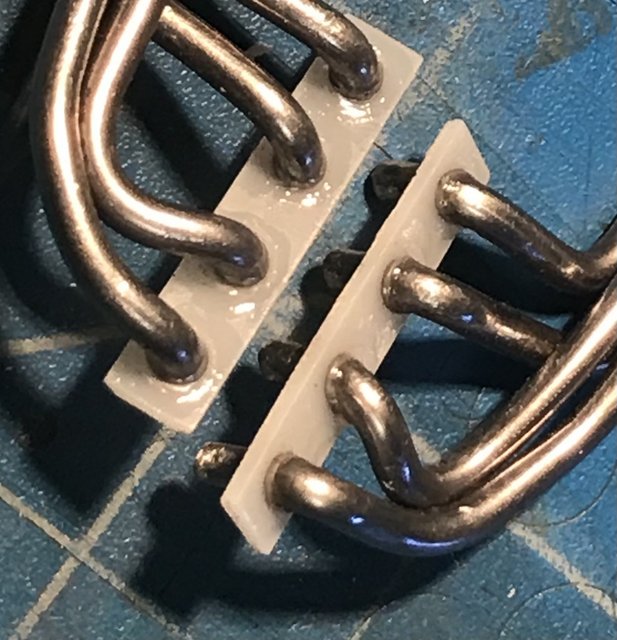

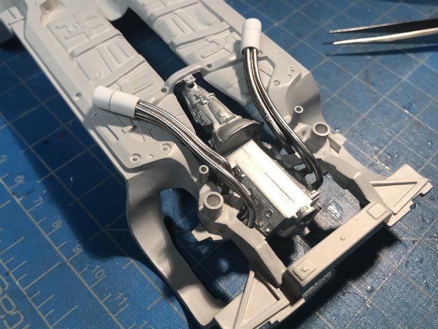

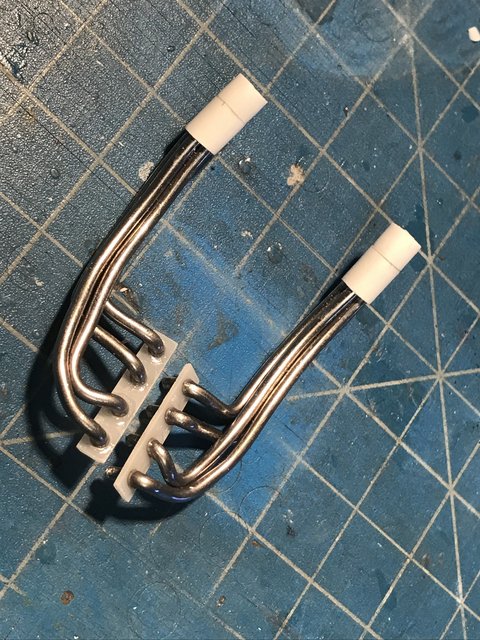

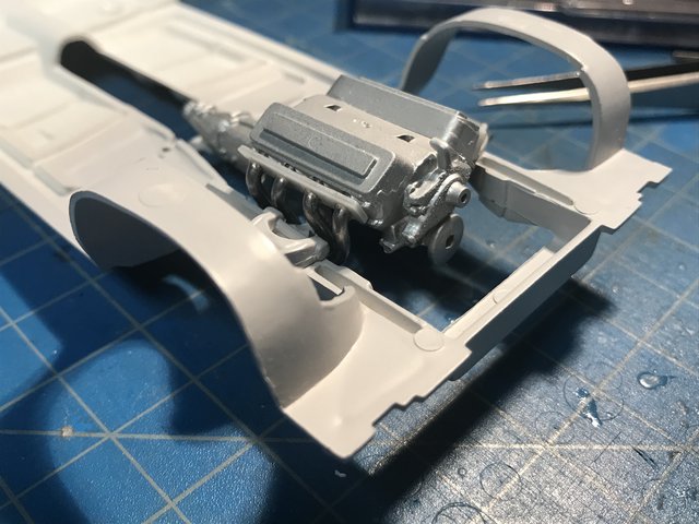

papajohn97 Posted March 28, 2021 Posted March 28, 2021 Lately scratch-building exhaust headers using 2mm solder. I’ve been obsessed lately building early/mid-60’s SS and A/FX drag cars using stock kits that don’t include drag parts. Seems like I’ve spent the last two man-cave sessions trying to make both headers perfectly symmetrical and clearing chassis/engine mounts. Hoping this gets easier as I do more....

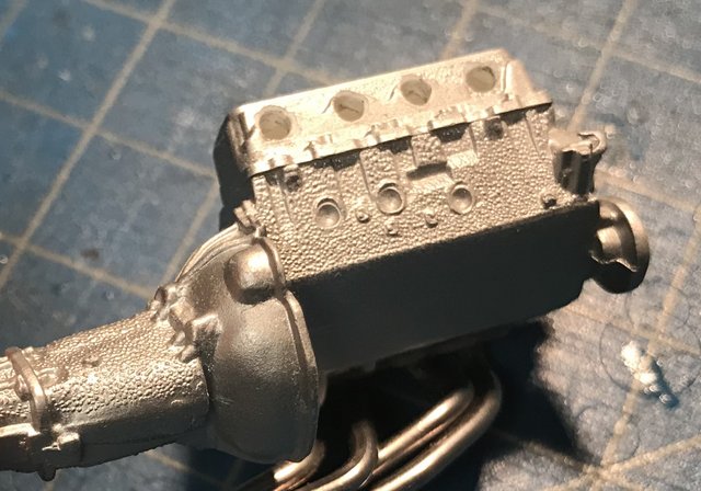

TransAmMike Posted March 28, 2021 Posted March 28, 2021 On 3/28/2021 at 5:24 PM, papajohn97 said: Lately scratch-building exhaust headers using 2mm solder. I’ve been obsessed lately building early/mid-60’s SS and A/FX drag cars using stock kits that don’t include drag parts. Seems like I’ve spent the last two man-cave sessions trying to make both headers perfectly symmetrical and clearing chassis/engine mounts. Hoping this gets easier as I do more.... Expand I'd sure like some tips on doing this. I made a set recently using 2mm aluminum "wire". I need to make a set for my '55 Chevy build and not looking forward to it.
Snake45 Posted March 28, 2021 Posted March 28, 2021 On 3/28/2021 at 5:24 PM, papajohn97 said: ....headers....Seems like I’ve spent the last two man-cave sessions trying to make both headers perfectly symmetrical and clearing chassis/engine mounts. Expand Concentrate on making them fit, DON'T worry about making them symmetrical, much less "perfectly" so. Many--maybe even most?--real-word headers of the day weren't perfectly symmetrical. They were interested in function and fit, not form, and besides, you can't even see both sides at the same time once they're installed. Hope this helps!

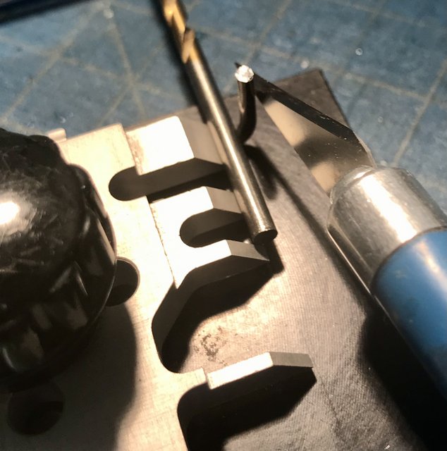

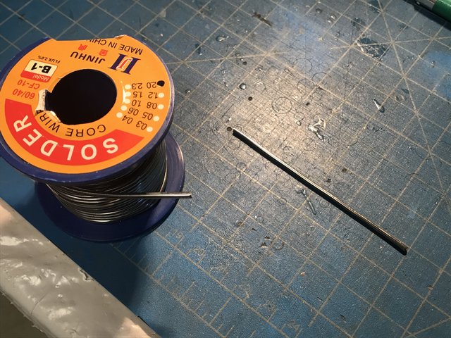

papajohn97 Posted March 28, 2021 Posted March 28, 2021 Hey TransAmMike, Here’s a quick header build description I’m using, hope it helps: I use 2 mm rosin core solder, cut 3” long pieces, straighten by rolling it between the palm of your hand and table top. I’ve never. Tried aluminum but I would think it would be much more difficult to bend unless it is close to pure aluminum with minimal alloying. The rosin core also makes it really easy to drill out the ends if you don’t use a collector. I drill out holes in the engine same diameter as solder: I use a four hole “header” for the header, the one shown here is from Speedcityresin but you can also make your own using sheet styrene (photo below shown with solder installed, I didn’t photograph the plastic part with the four holes but you get the idea): I bend the solder by clamping it in a PE fixture (you can probably just use a small board and a weight or clamp) and place a drill bit shank of the diameter you want the bend to be, then pull the outer leg of the solder upward using a blunt tool (back of a knife?) to make the bend: I then take the solder pieces, insert them into the plastic header (don’t glue them yet!) and dry-fit it with the engine block and chassis until I get the rough form I need. You can tape the exit end of the solder pieces together to keep it together temporarily. At this point, I’m done making a “rough draft” of one side header and go back and re-cut and bend four new pieces for which I have a better idea of where to make the bends. The nice thing about solder is you can recycle the dry-run pieces by restraightening them using the rolling technique. Here’s a shot of a dry-run fitting of the headers to the chassis and engine block: I used a 1/4” diameter styrene tubing for the exit collector in this header. Once I’m happy with it, I bond the entry header strip and the exit collector to the four solder pieces using CA: Here’s a shot of the headers and BBC dry-fit installed into the chassis of the Revell ‘65 Chevelle I’m building: I suspect there are other/ better ways of doing this but I wanted to pass on my current method. Hope this helps! John

TransAmMike Posted March 28, 2021 Posted March 28, 2021 On 3/28/2021 at 7:29 PM, papajohn97 said: Hey TransAmMike, Here’s a quick header build description I’m using, hope it helps: I use 2 mm rosin core solder, cut 3” long pieces, straighten by rolling it between the palm of your hand and table top. I’ve never. Tried aluminum but I would think it would be much more difficult to bend unless it is close to pure aluminum with minimal alloying. The rosin core also makes it really easy to drill out the ends if you don’t use a collector. I drill out holes in the engine same diameter as solder: I use a four hole “header” for the header, the one shown here is from Speedcityresin but you can also make your own using sheet styrene (photo below shown with solder installed, I didn’t photograph the plastic part with the four holes but you get the idea): I bend the solder by clamping it in a PE fixture (you can probably just use a small board and a weight or clamp) and place a drill bit shank of the diameter you want the bend to be, then pull the outer leg of the solder upward using a blunt tool (back of a knife?) to make the bend: I then take the solder pieces, insert them into the plastic header (don’t glue them yet!) and dry-fit it with the engine block and chassis until I get the rough form I need. You can tape the exit end of the solder pieces together to keep it together temporarily. At this point, I’m done making a “rough draft” of one side header and go back and re-cut and bend four new pieces for which I have a better idea of where to make the bends. The nice thing about solder is you can recycle the dry-run pieces by restraightening them using the rolling technique. Here’s a shot of a dry-run fitting of the headers to the chassis and engine block: I used a 1/4” diameter styrene tubing for the exit collector in this header. Once I’m happy with it, I bond the entry header strip and the exit collector to the four solder pieces using CA: Here’s a shot of the headers and BBC dry-fit installed into the chassis of the Revell ‘65 Chevelle I’m building: I suspect there are other/ better ways of doing this but I wanted to pass on my current method. Hope this helps! John Expand Thats a great tutorial John. The aluminum wire bends pretty easily but I'm am sure the solder is more pliable and better suited. Thanks, gotta try that.

Bills72sj Posted March 29, 2021 Posted March 29, 2021 On 3/28/2021 at 7:29 PM, papajohn97 said: Hey TransAmMike, Here’s a quick header build description I’m using, hope it helps: I use 2 mm rosin core solder, cut 3” long pieces, straighten by rolling it between the palm of your hand and table top. I’ve never. Tried aluminum but I would think it would be much more difficult to bend unless it is close to pure aluminum with minimal alloying. The rosin core also makes it really easy to drill out the ends if you don’t use a collector. I drill out holes in the engine same diameter as solder: I use a four hole “header” for the header, the one shown here is from Speedcityresin but you can also make your own using sheet styrene (photo below shown with solder installed, I didn’t photograph the plastic part with the four holes but you get the idea): I bend the solder by clamping it in a PE fixture (you can probably just use a small board and a weight or clamp) and place a drill bit shank of the diameter you want the bend to be, then pull the outer leg of the solder upward using a blunt tool (back of a knife?) to make the bend: I then take the solder pieces, insert them into the plastic header (don’t glue them yet!) and dry-fit it with the engine block and chassis until I get the rough form I need. You can tape the exit end of the solder pieces together to keep it together temporarily. At this point, I’m done making a “rough draft” of one side header and go back and re-cut and bend four new pieces for which I have a better idea of where to make the bends. The nice thing about solder is you can recycle the dry-run pieces by restraightening them using the rolling technique. Here’s a shot of a dry-run fitting of the headers to the chassis and engine block: I used a 1/4” diameter styrene tubing for the exit collector in this header. Once I’m happy with it, I bond the entry header strip and the exit collector to the four solder pieces using CA: Here’s a shot of the headers and BBC dry-fit installed into the chassis of the Revell ‘65 Chevelle I’m building: I suspect there are other/ better ways of doing this but I wanted to pass on my current method. Hope this helps! John Expand John, Thank you for the tutorial. I am currently working on some engine swapped Mustangs. None of the supplied exhausts are going to work. Especially the 427 SOHC in an AMT 67 Mustang GT or the Boss 429 in an AMT 69 Mach 1.
