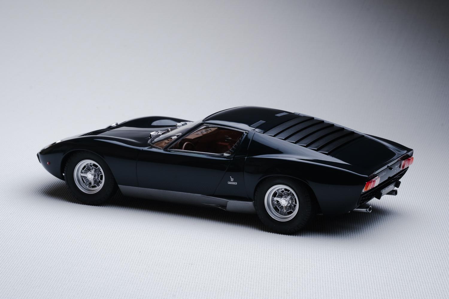

Hey all, here’s my 5th build of 2021: Hasegawa Lamborghini Miura 400SV. I want this to be a simple box straight build even though there are a few details such as door vents that really could use detail up PE pieces. Overall it was a great kit with perfect stance and proportions - it sucks that there’s no way to access the engine bay once it’s assembled.
Since almost every Miura produced had unique color combo, I wanted to replicate very dark blue with tri-tone (brown/tan/caramel) interior that some Miura came with - and here’s my build detail:
  • Prepped body with Tamiya grey surfacer and wet sanded with 2000 grit
  • Used mix of Tamiya acrylics (mix of red, yellow, black, tan) and masked different parts of the interior
  • Applied 2 based coats using Mr color’s C2 black and small amount of C76 metallic blue
  • Applied 2 clear coats (Mr color's super clear) with 2000 grit wets anding in between
  • Polished body with 3000 grit sponge and Tamiya three stage compounds
  • Masked the body and applied Mr Color’s aluminum for window trims and used BMF for inner door cards
Thank you for reading and enjoy!

Thank you! It's not quite the right color I was going for, and next time I'll maybe try out overcoating with clear blue to achieve what I want!

Beautiful paint!  Super clean and crisp.  I did one in metallic red, personally, the Miura is my favorite Lambo since it has the cleanest and most flowing lines.  Todays Lambo's are amazing, but I find the angular lines rather "off putting" compared to the smooth lines of the Miura.
That is an excellent model Chang! Beautiful colors and so realistic looking! And your photography is so well done! I usually prefer outside photos. But, your studio photos are even better! Excellent work!
Great pics!!!!. Looks like you shot these outside on a “cloudy-bright” day that was ideal for illuminating shadows and avoiding hot spots/ glare. The reflected sky and beaches on the high gloss hid/roof really makes these pics pop. I also like the stepping stones you placed the car on and the out-of-focus branches in the background, very arty. As others have said, this Lambo model is pretty close to perfection but IMO it’s your photography skills that knock it out of the park! Thanks for posting!
