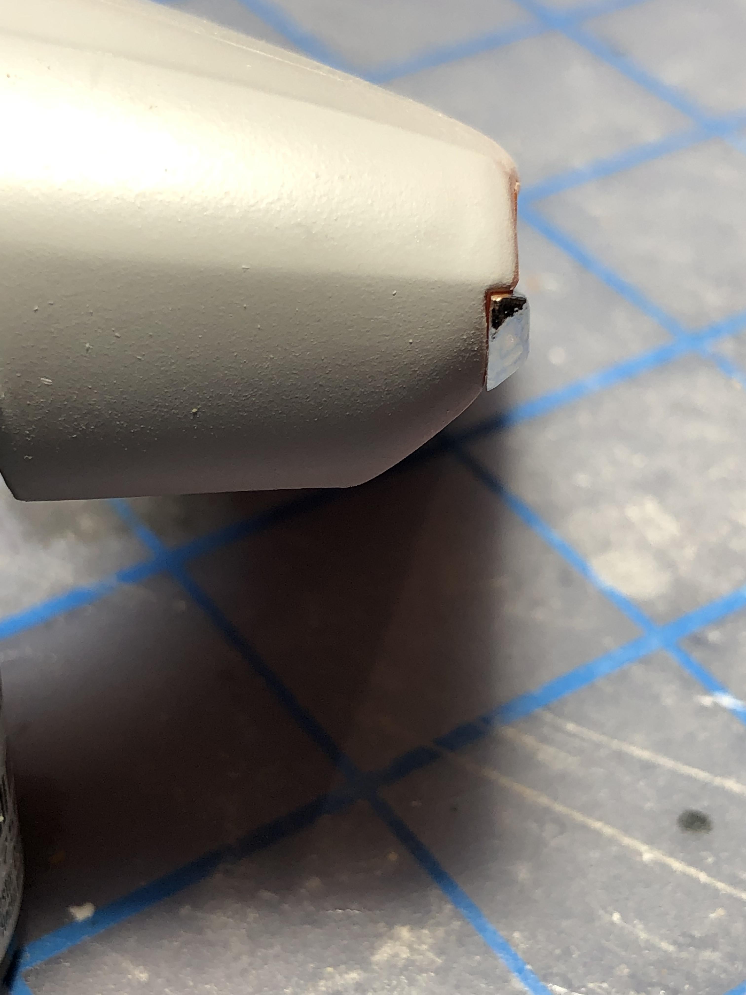

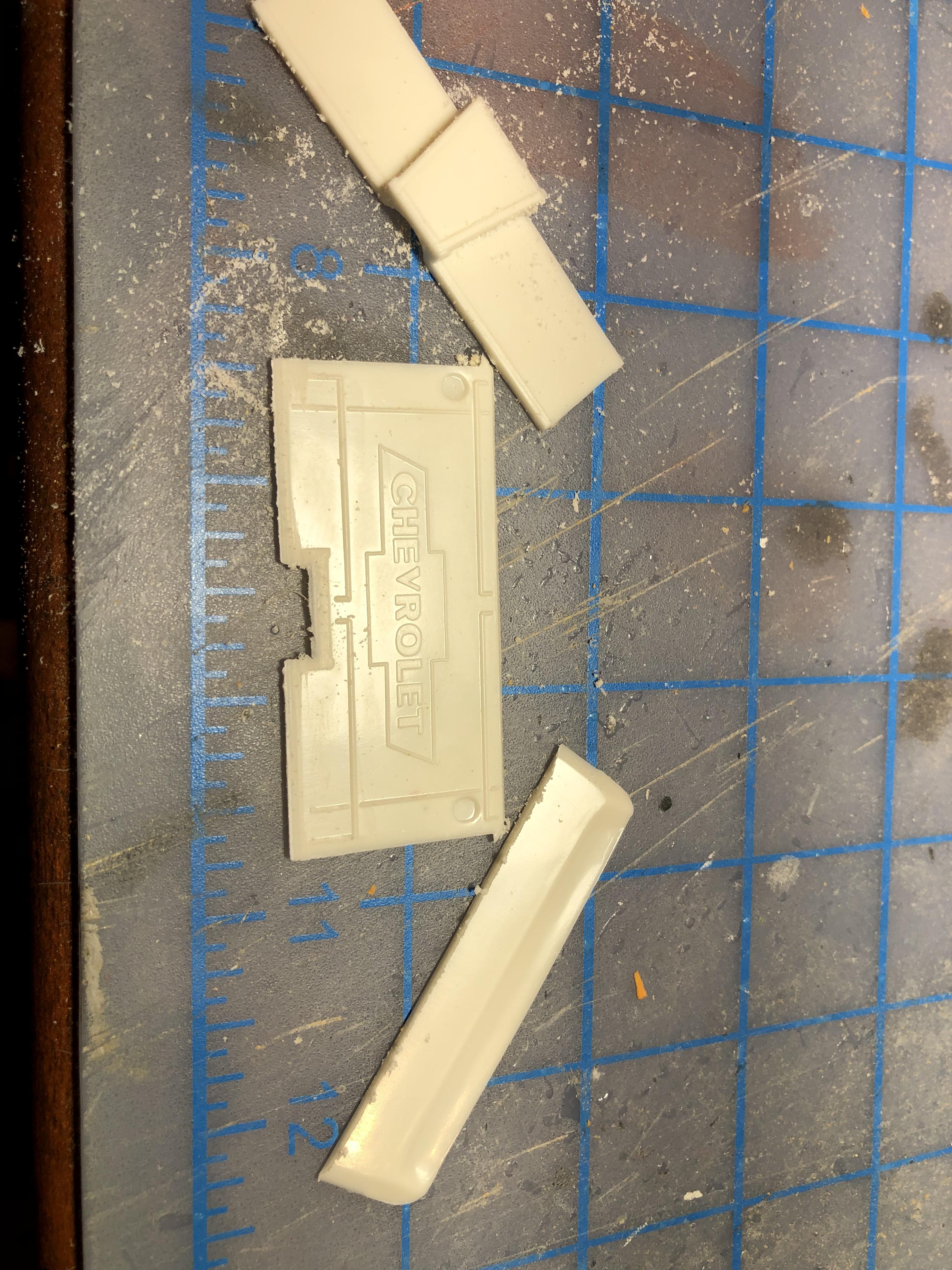

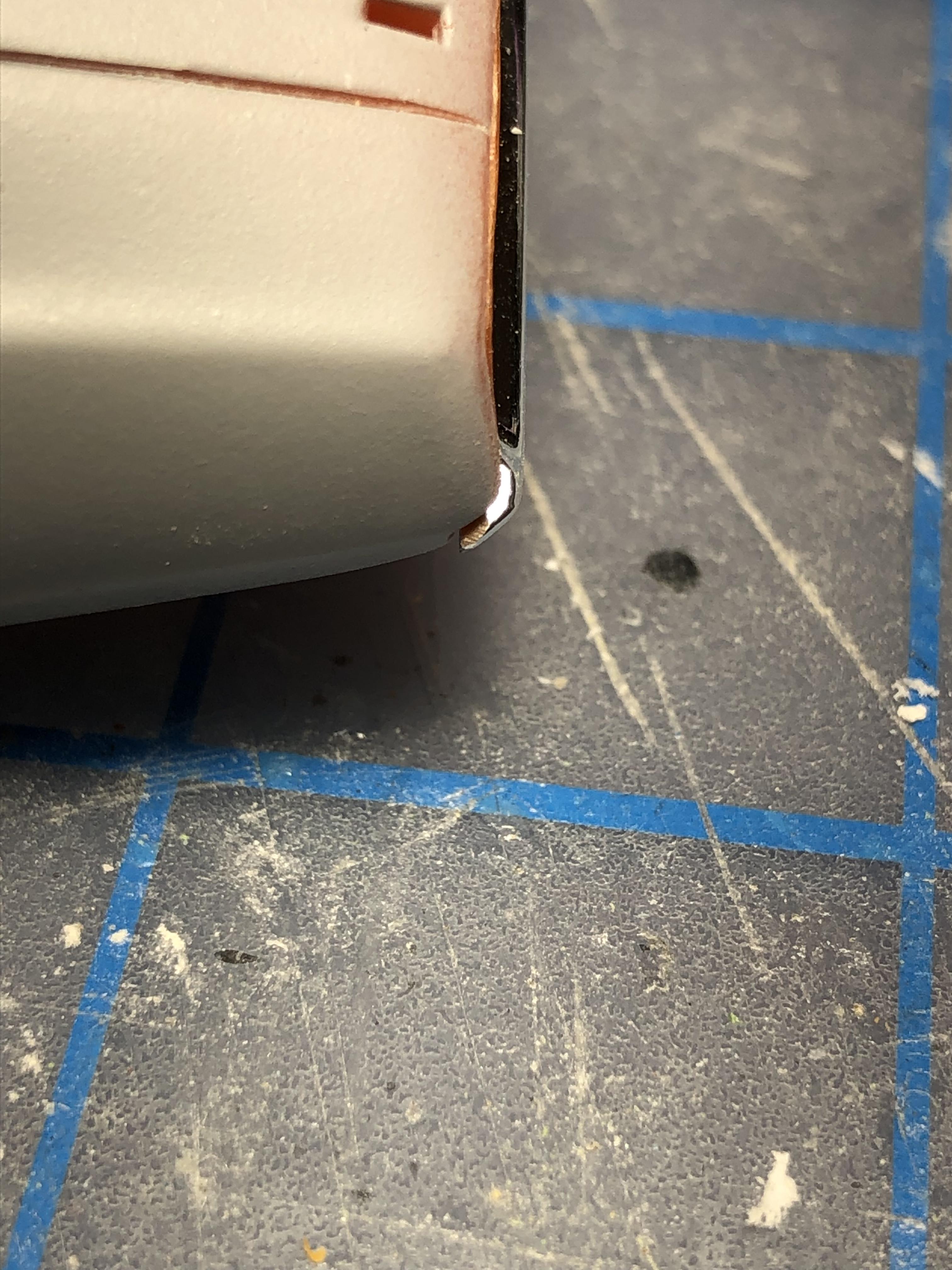

The rear bumper needs to be “tucked in” a bit. On the  real car, the bumper is flush with surrounding body. 3EEC5DF4-8AC8-46D9-9C25-884FF019E678.png.a337d7638b7cdeeaa280df02e722f361.png
I will thin the bumper achieve this look. Photos before…
And after…9336FC82-A96E-4F3E-8026-05D69C23E52D.thumb.jpeg.37a80e839ea259a87edc7e53b06b3aa3.jpegB0C45B81-D4E3-4FD4-857A-86CFF3D7C669.thumb.jpeg.45640e49660b372d3bed0b34d91c43bf.jpeg
I will do a final cleanup after bumper is stripped, but it’s real close now.

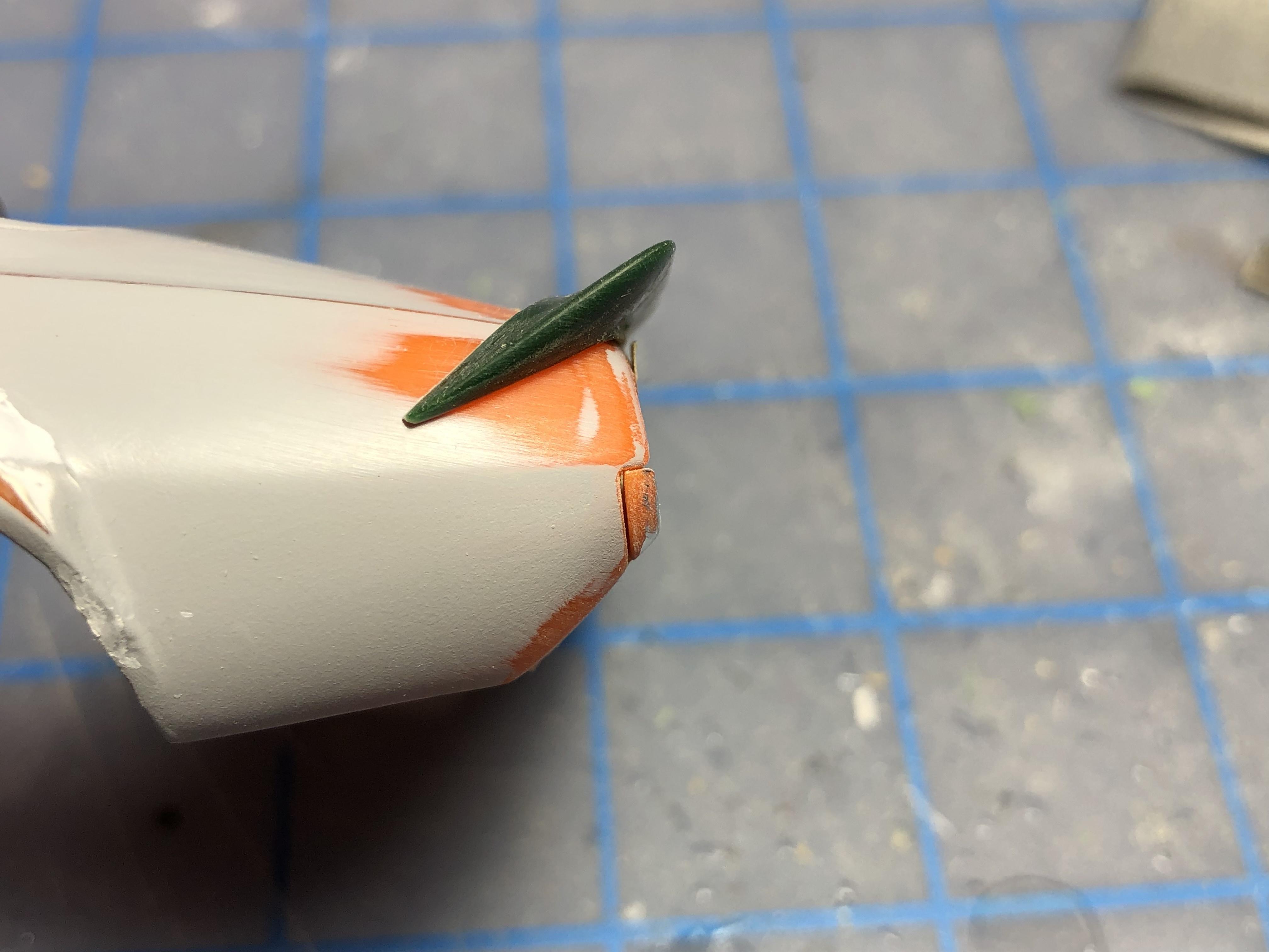

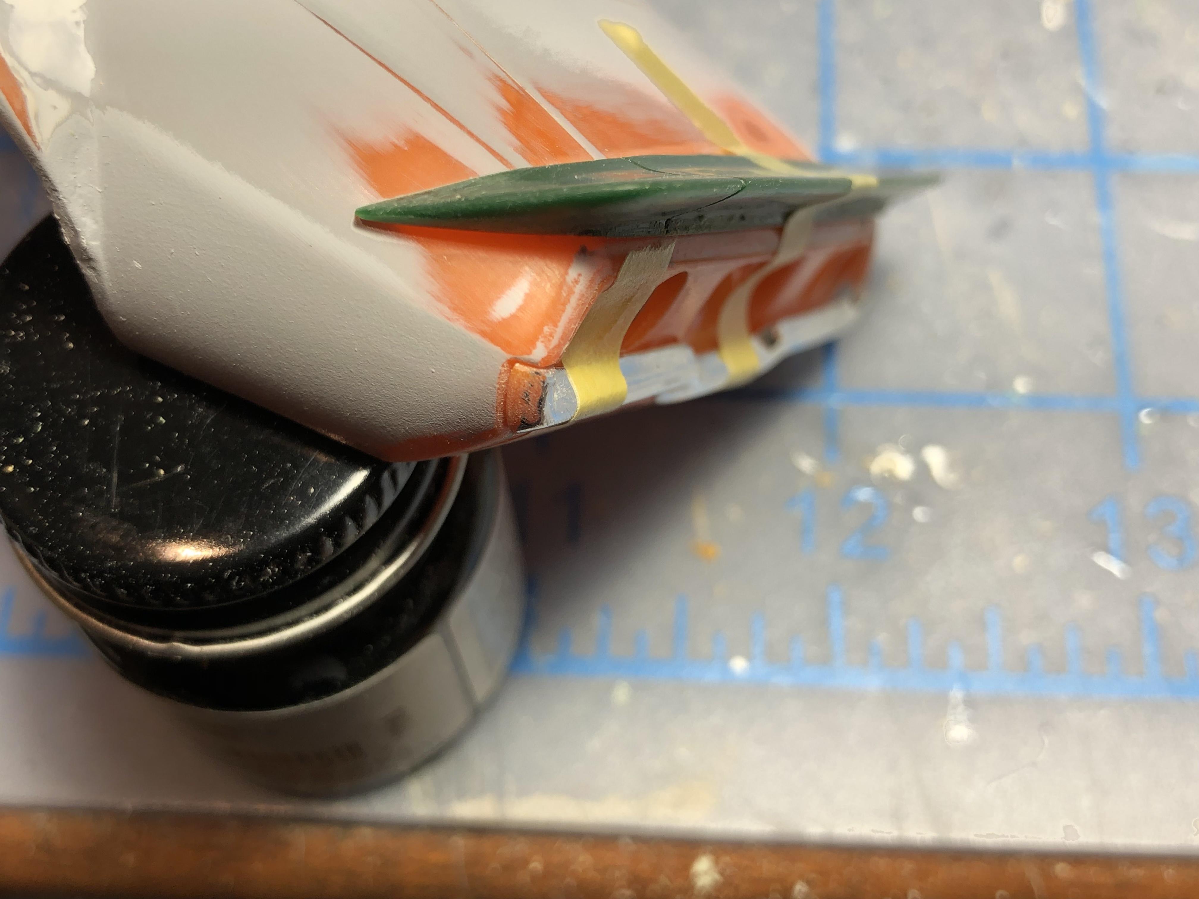

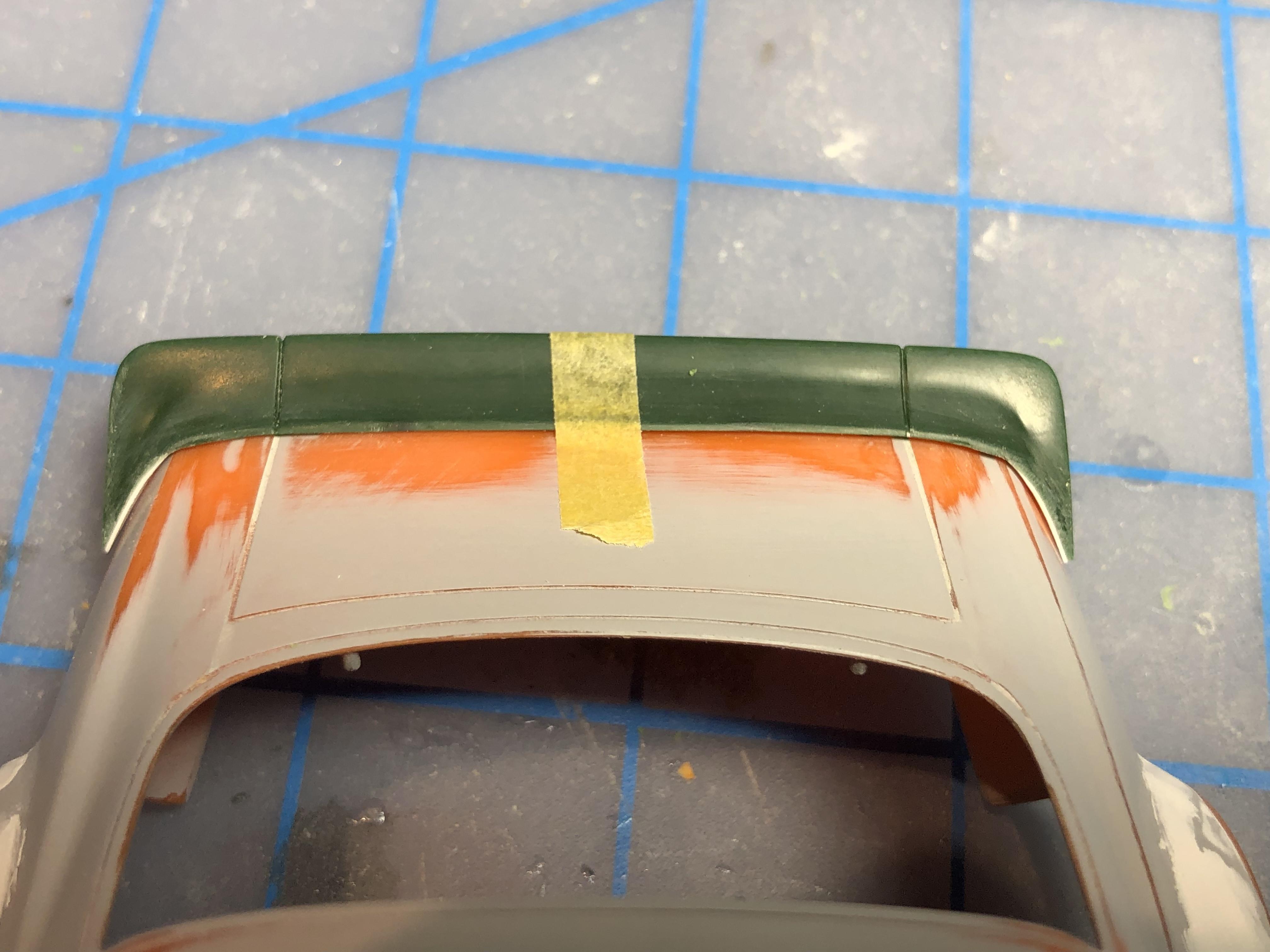

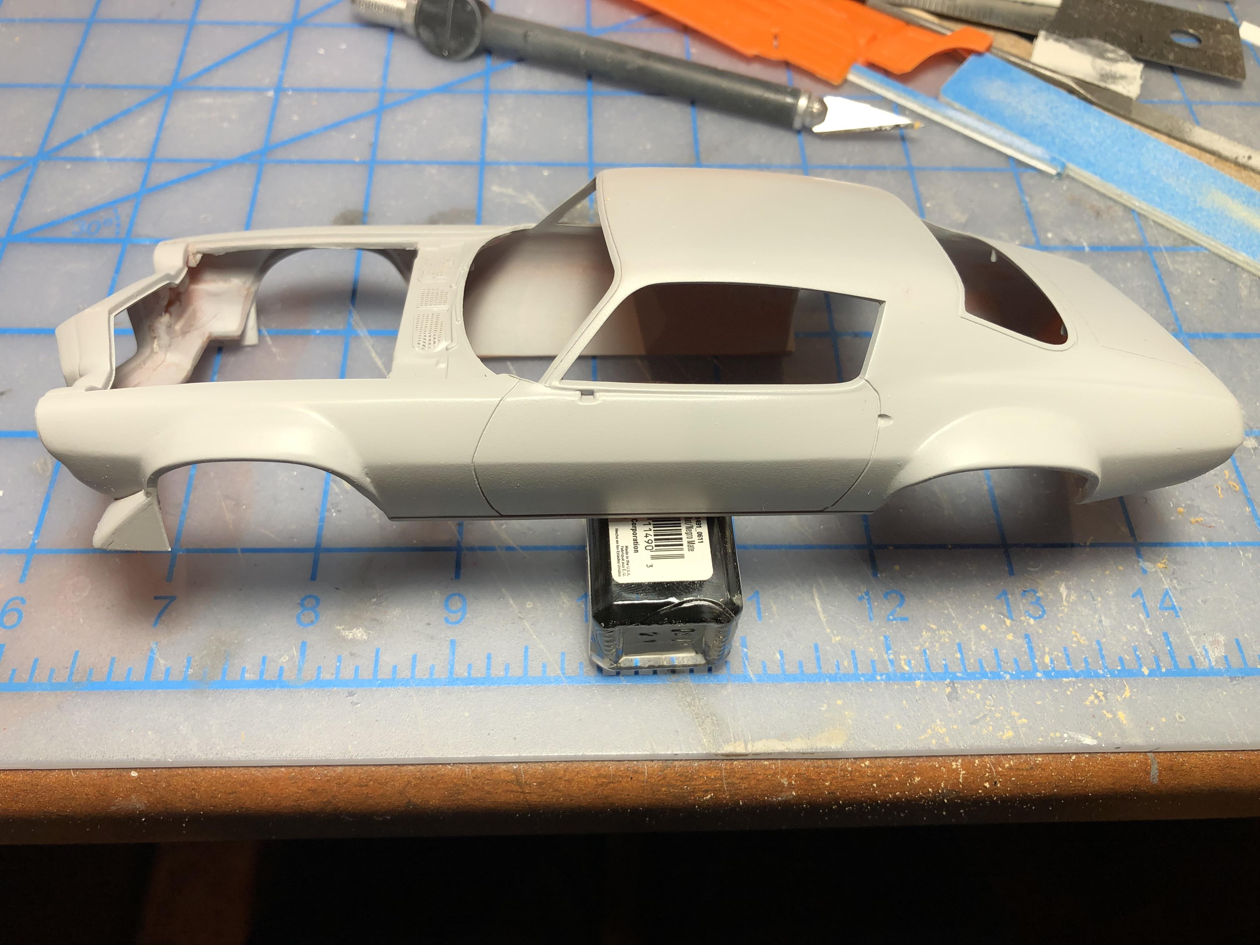

I did a bit more work on the spoiler. Added some thin styrene to the lower portion where it joins to the rear quarter. There was a bit too much of a gap for my liking. Still needs a bit more work but getting closer.

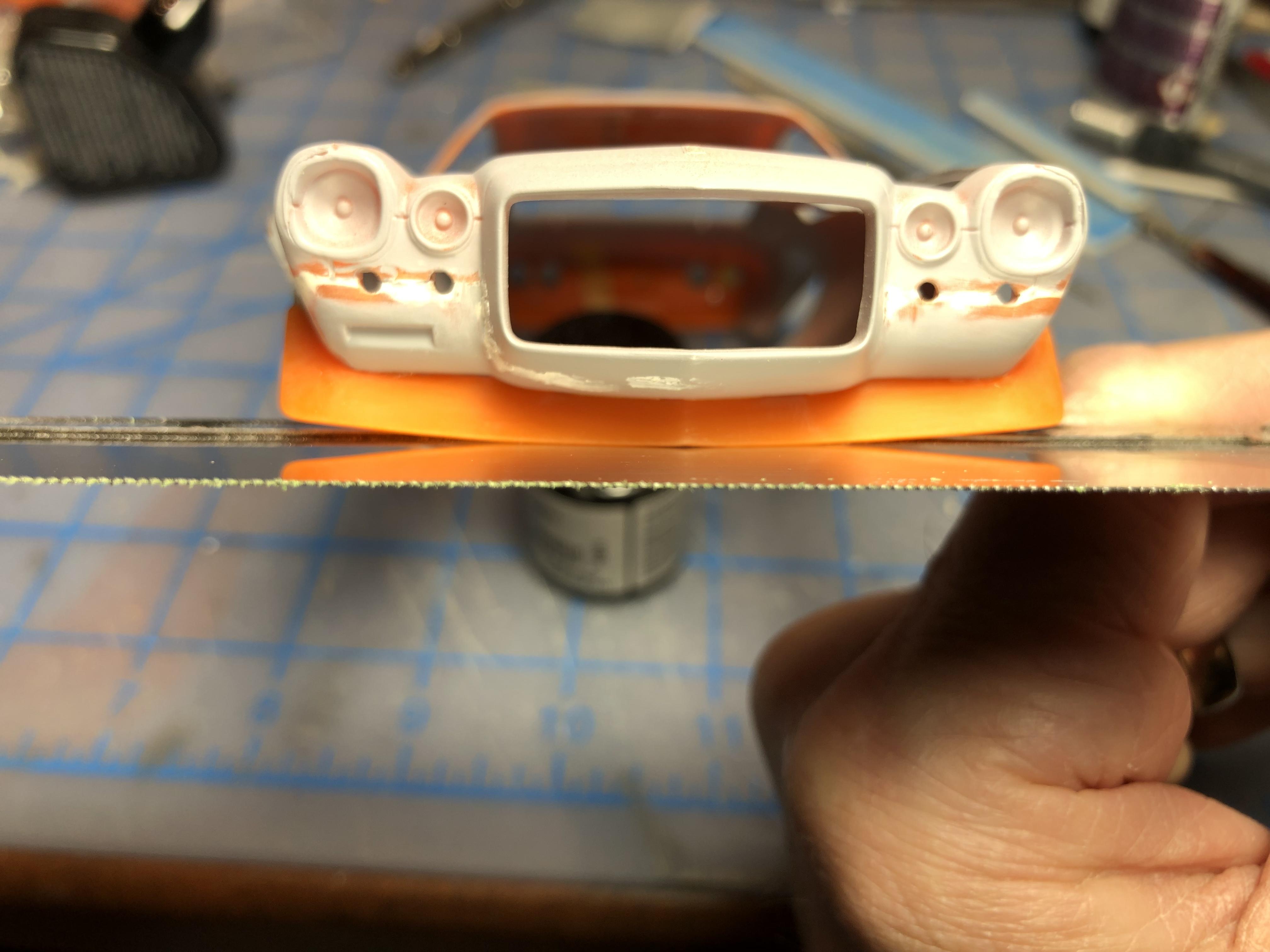

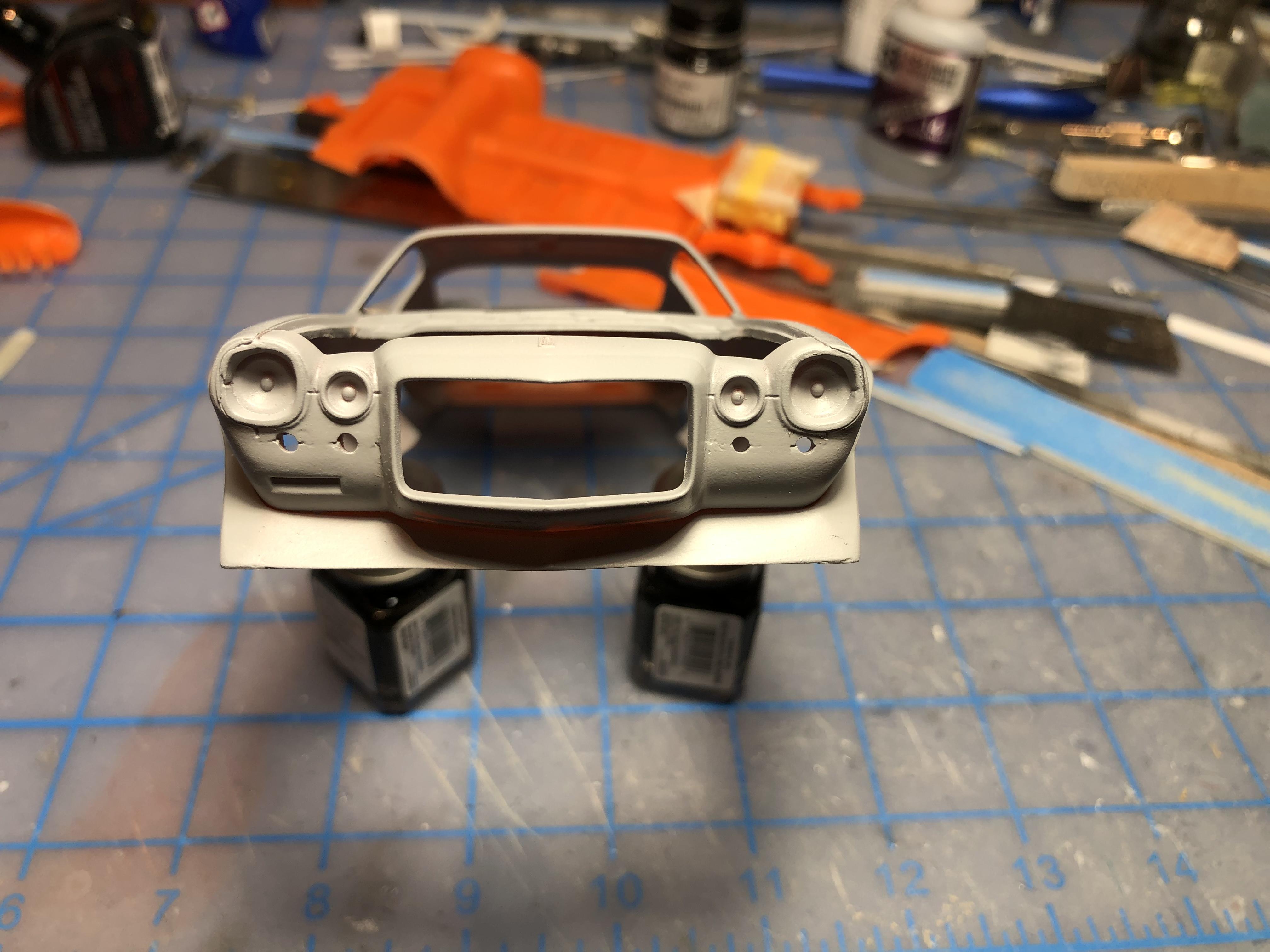

Front spoiler glued on, but needs some re-shaping to allow attaching a splitter.
As you can see, the spoiler is not flat across the bottom. I hope to tackle that tomorrow, more soon.

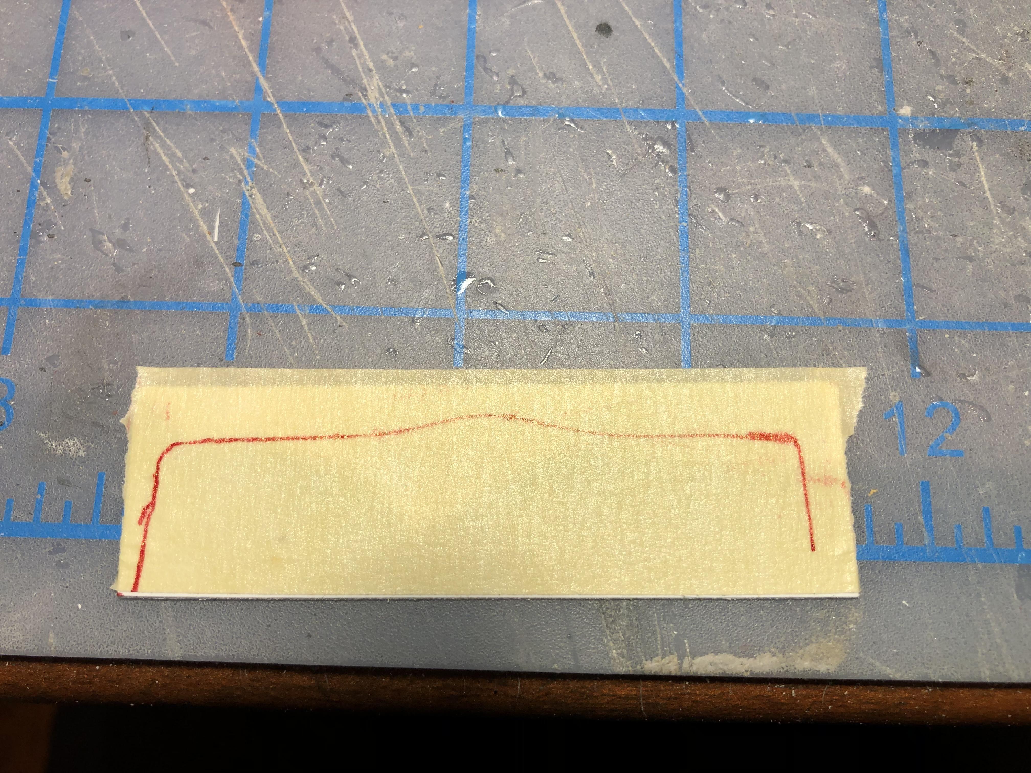

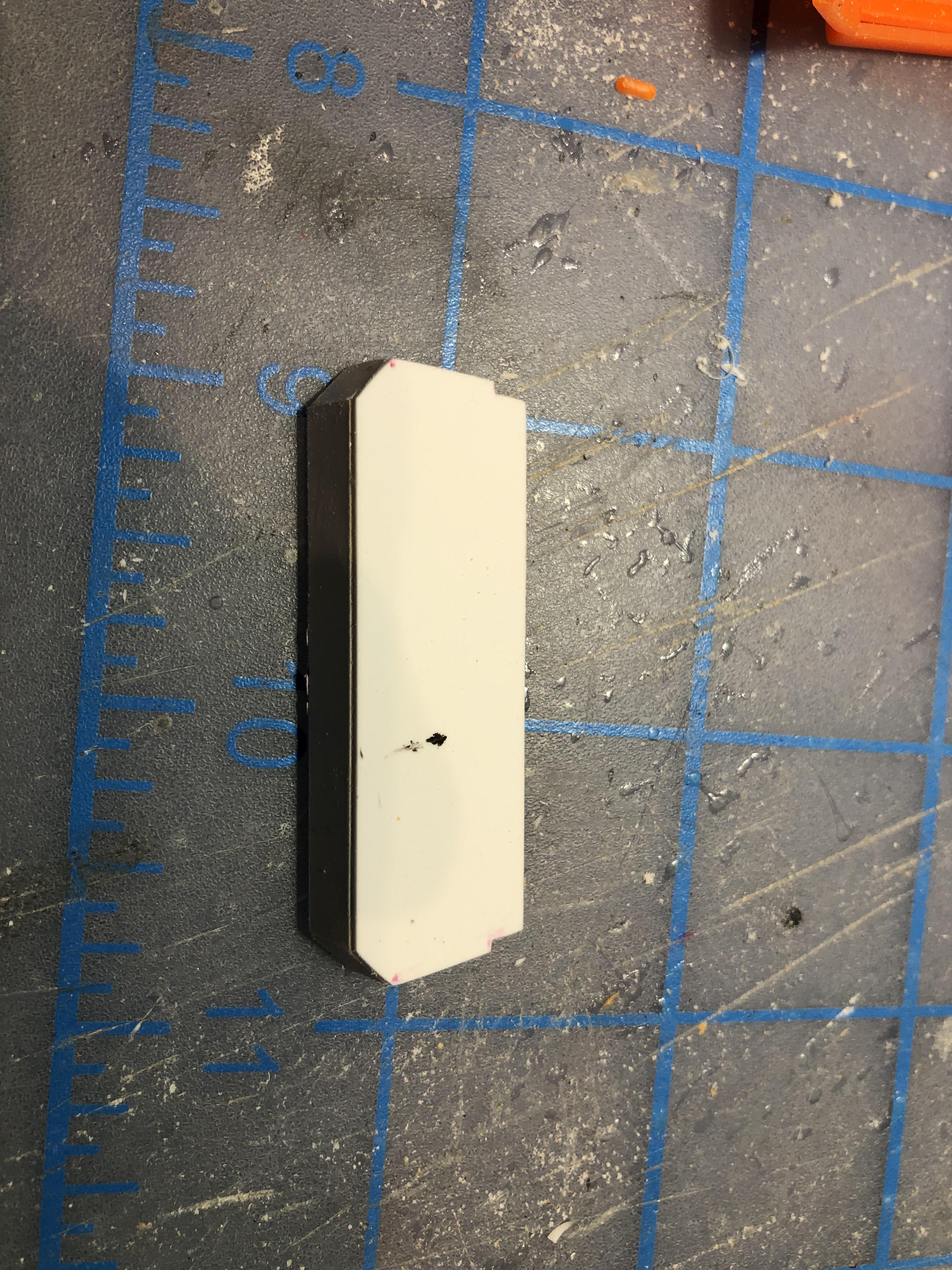

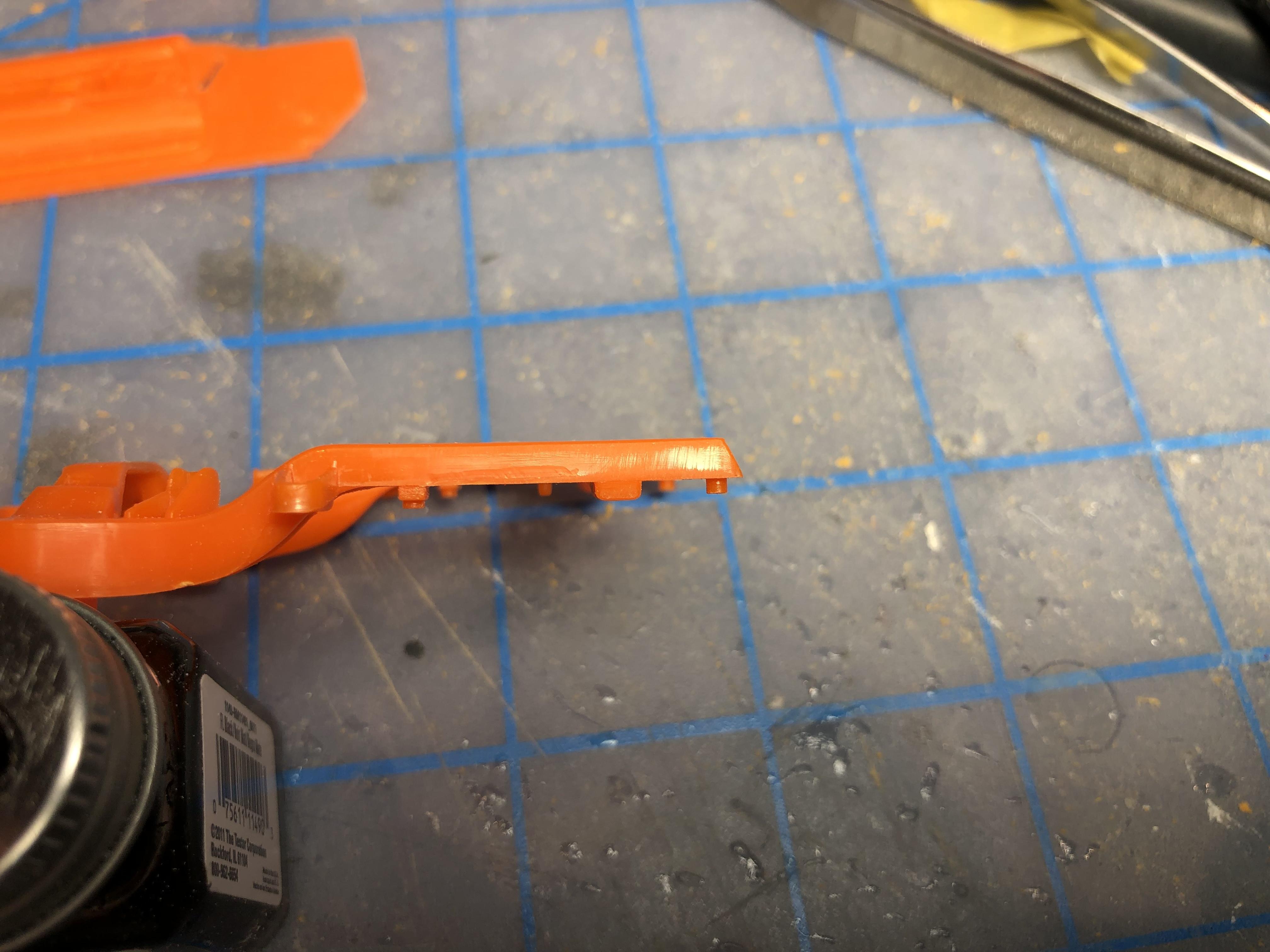

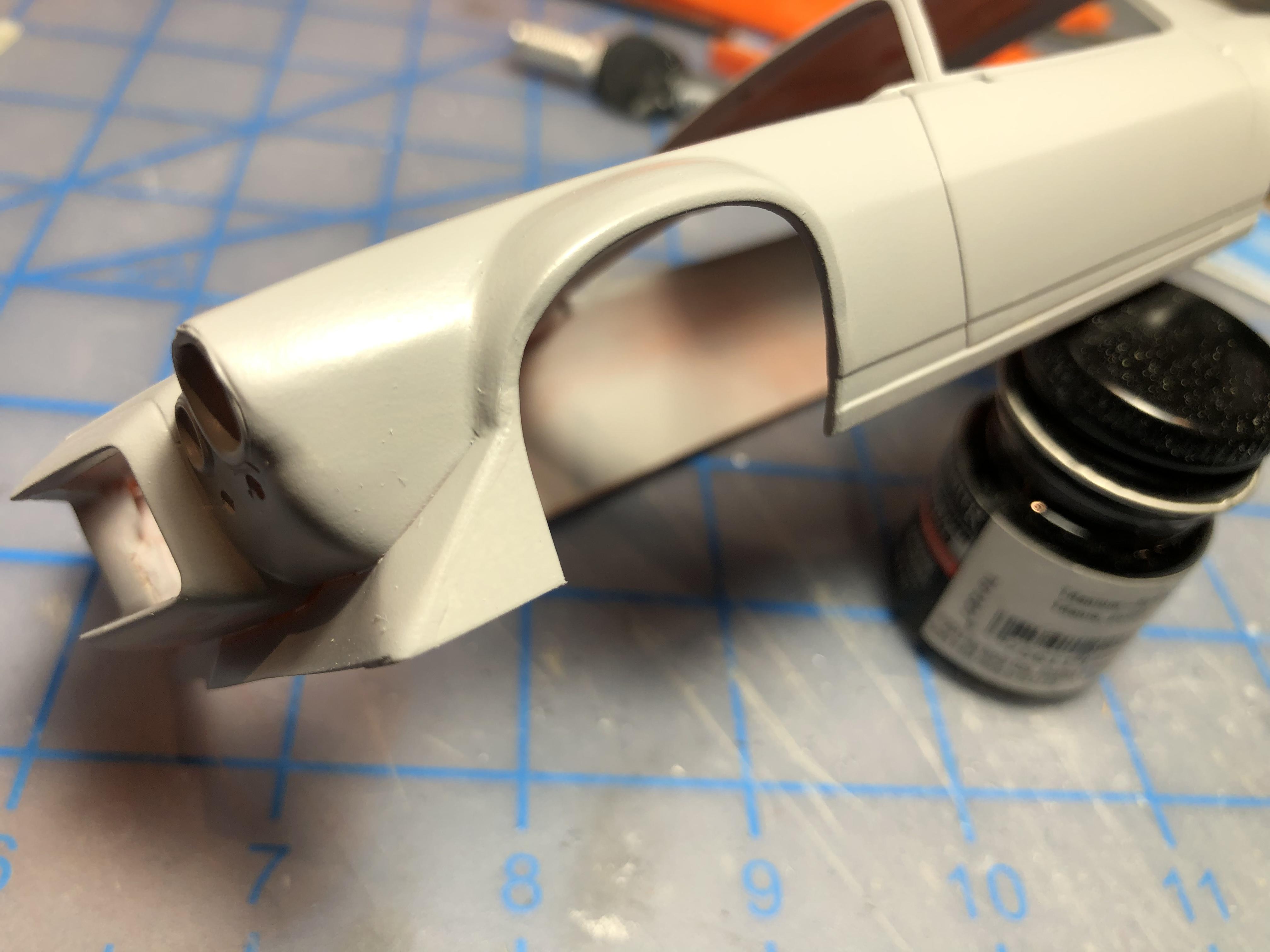

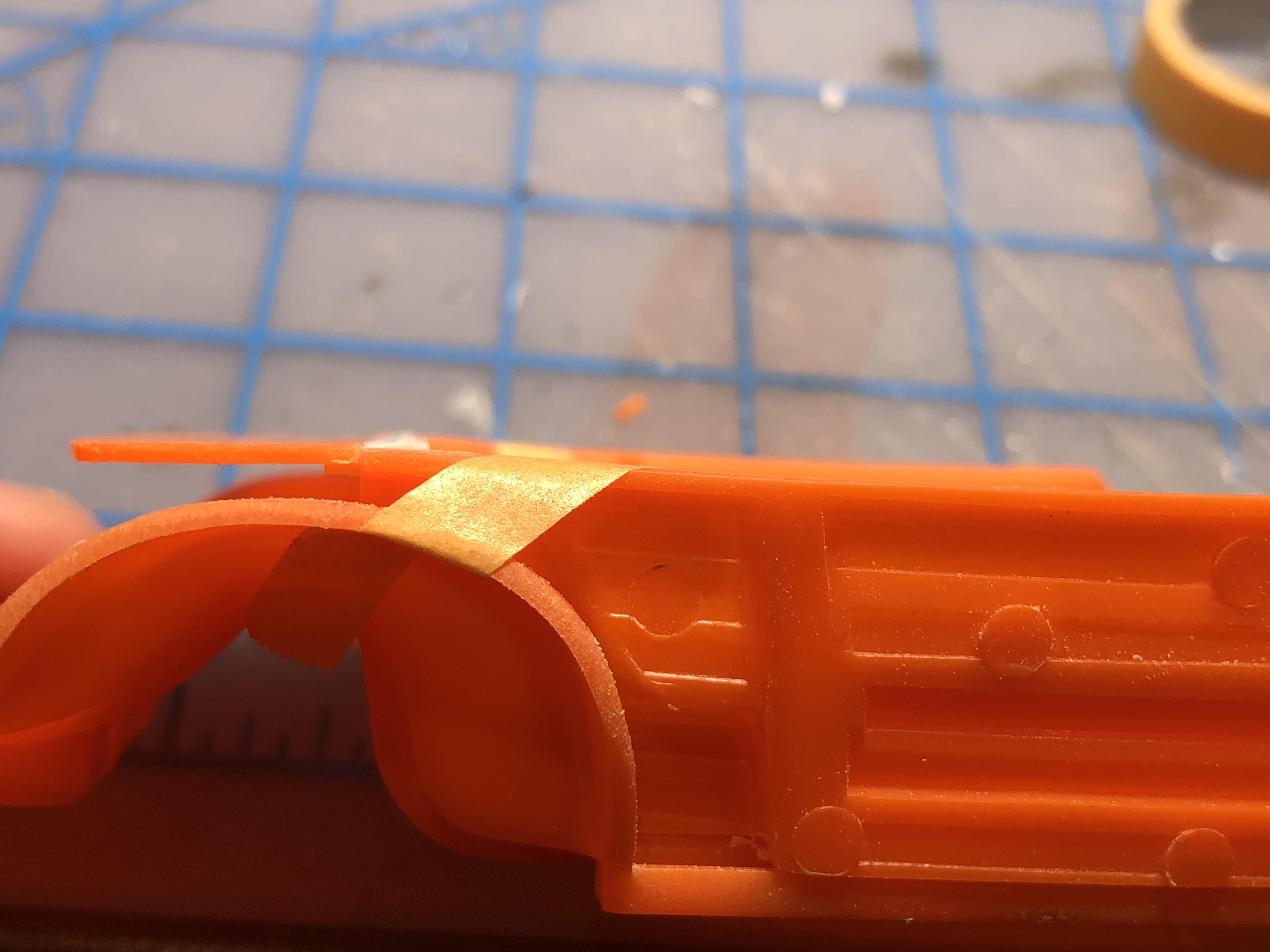

So, with the bodywork getting “close”, I’m bouncing around a bit with various other parts. One of the last pieces of bodywork is the splitter. I haven’t built the splitter yet, but here’s where I’m at. Traced the spoiler outline on tape and transferred that to styrene. I have since cut and shaped the leading edge.
On the real car, they added returns the the corners of the spoiler
First I added material to flatten the bottom of the spoiler, then added similar returns at the corners. I will still round the corners a bit, and do a bit more fine tuning on the shape at wheel wells, then add the splitter. As you can see, I managed to put off the work on the headlights, not looking forward to that.E73FDF1A-6A49-4304-BAFF-C7EA59806147.thumb.jpeg.e58bb0378e3901220959e731a0a2a84e.jpeg

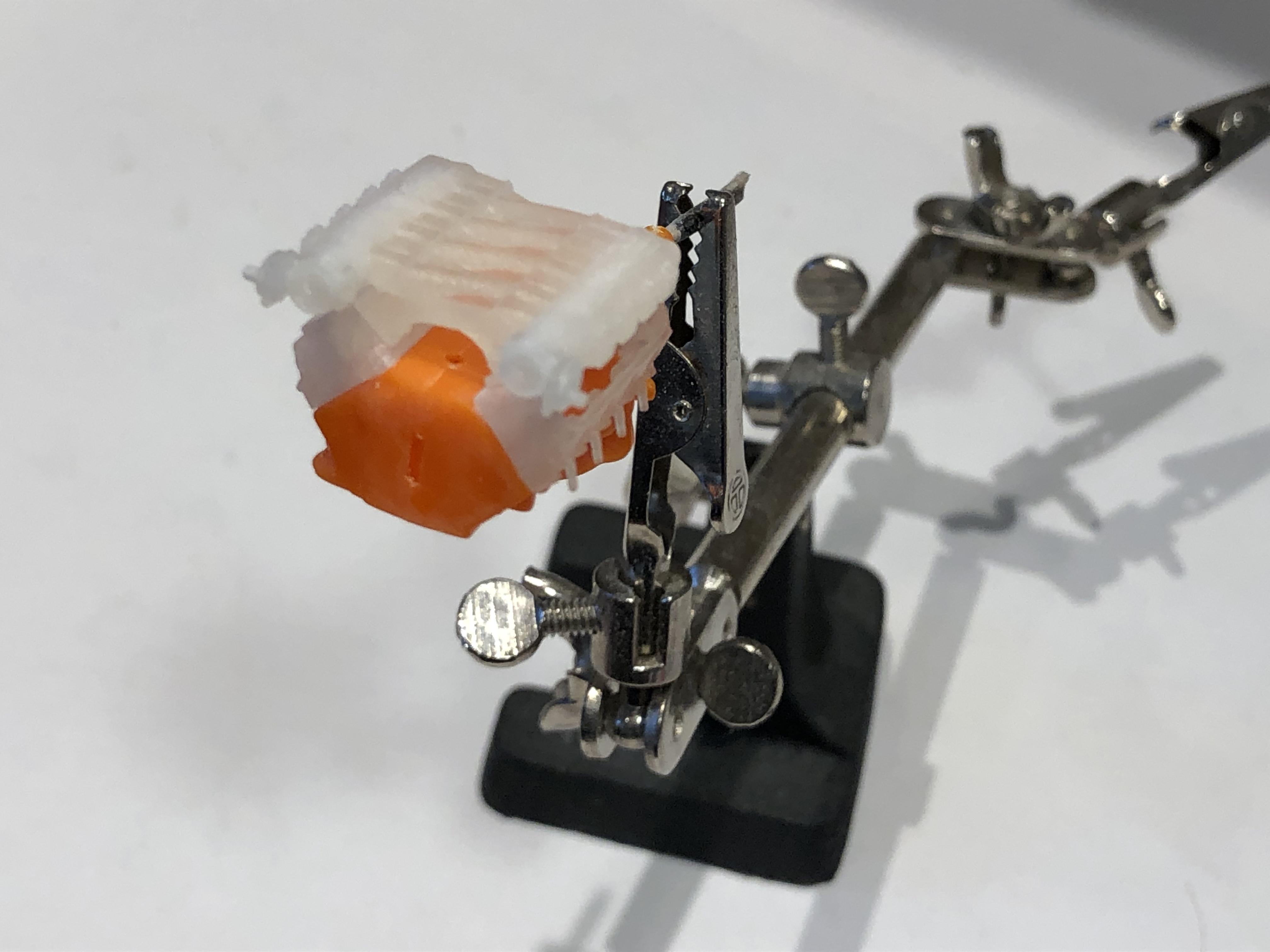

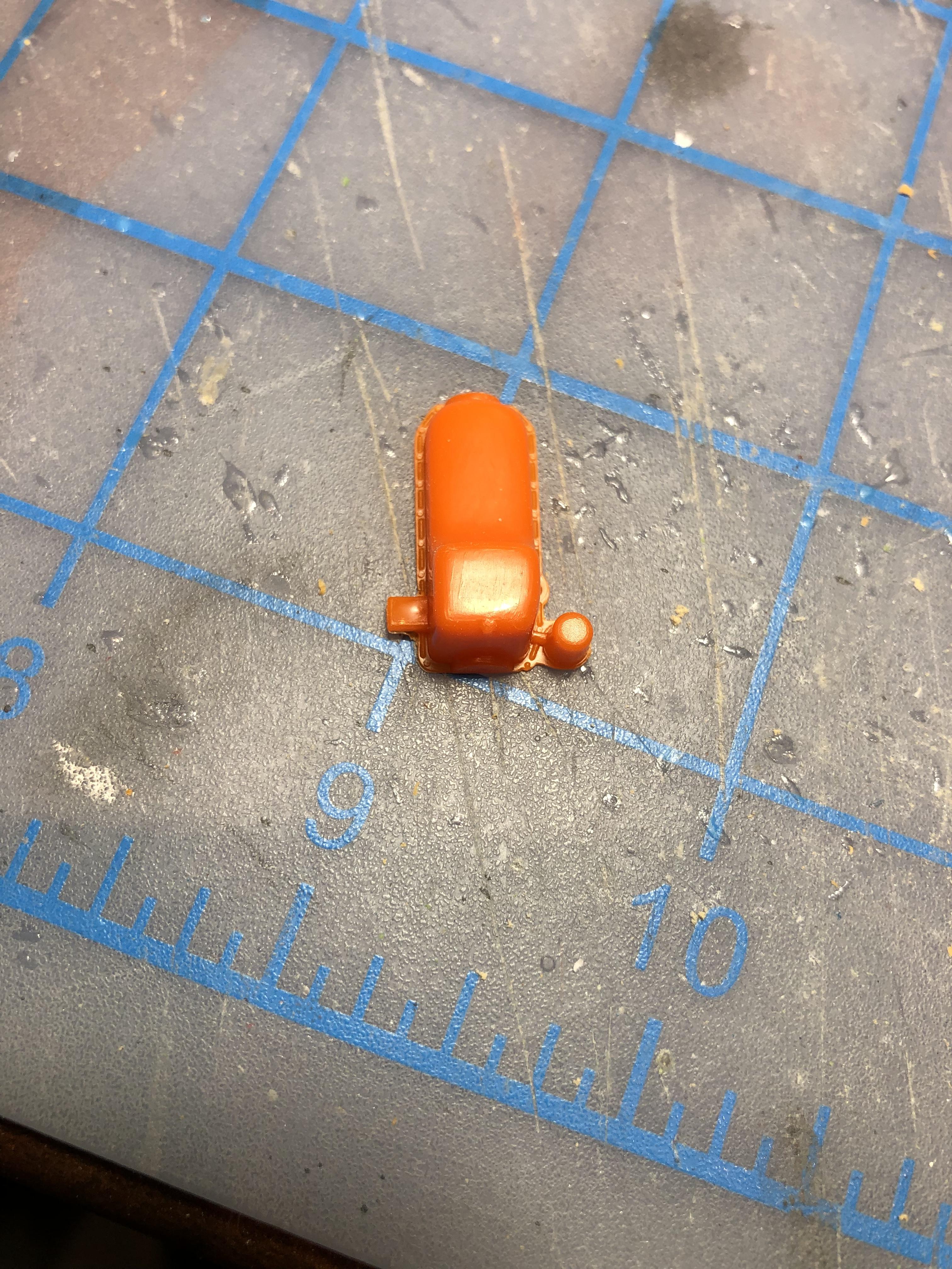

Started tinkering with the engine… I’m not a fan of molded in oil filters, so that has been cut free.
I have a complete 3d printed LS3 with Edelbrock cross ram intake. However, to simplify one part of the build, I am going to use the block/trans from the kit, and the printed heads and intake. I’m sure it won’t be “technically” correct, but it saves some messing around. Besides, they fit like a glove!

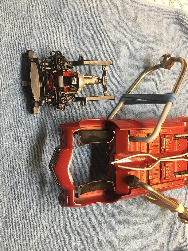

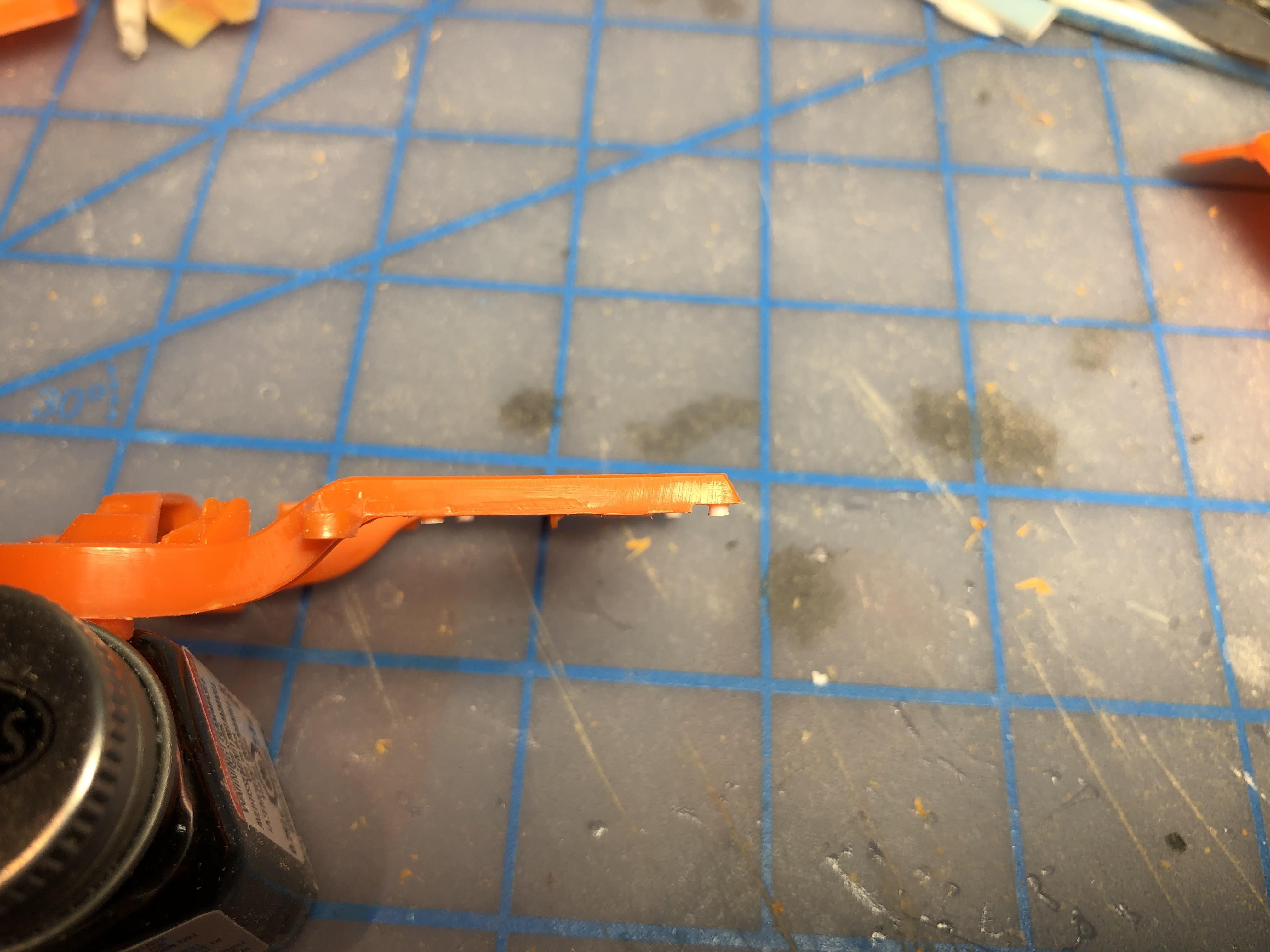

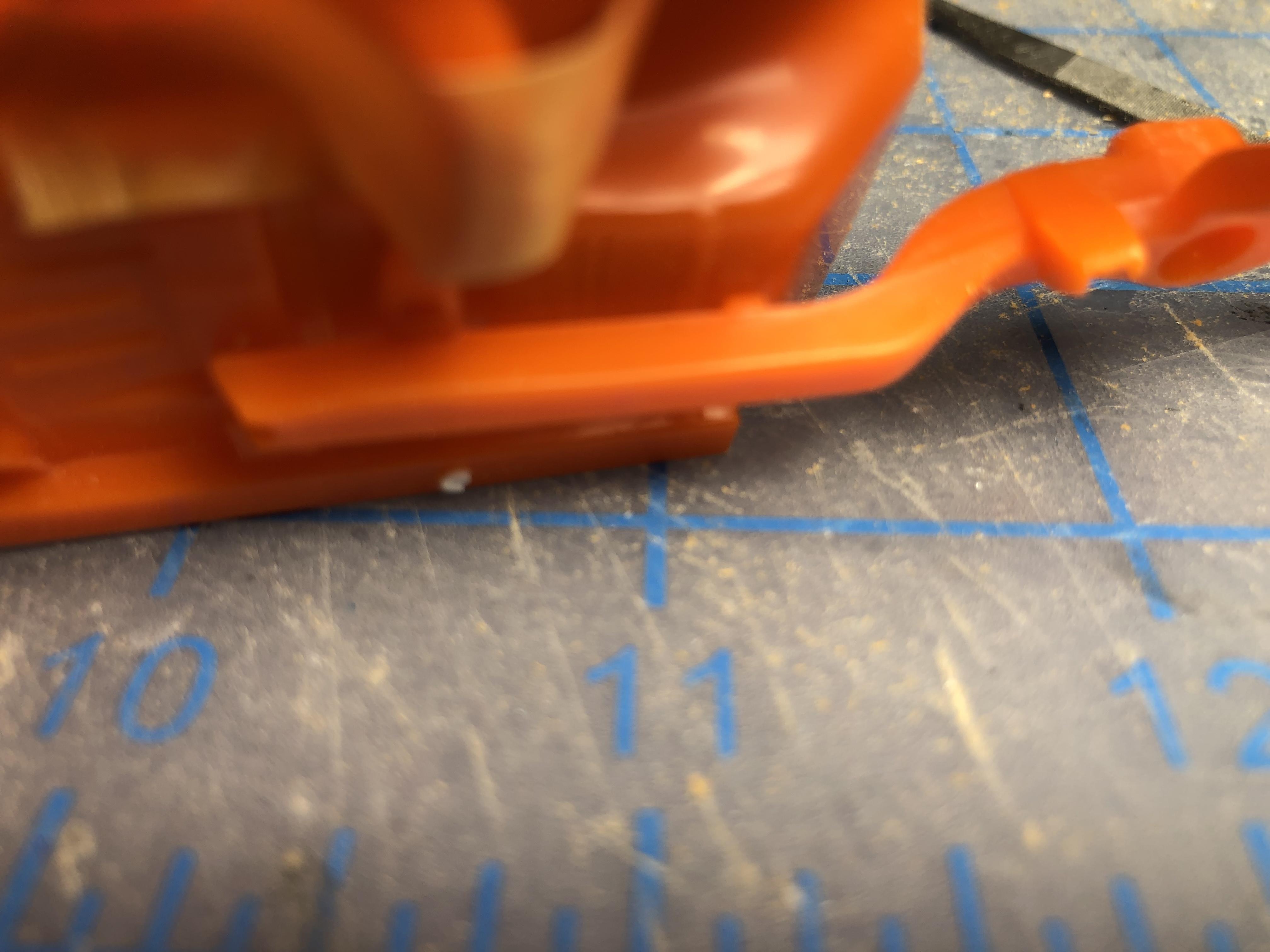

If you have seen my builds, you already know I like LOW. So… started planning the ride height. To achieve 1” of drop at the front I modified the front sub frame. Cut off the two blocks at the mounting point, thinned the trans crossmember, and notched the rear part of the frame. To keep things lined up, I added mounting pins in the existing locations. I pre-drilled small pilot holes in the old pins before removing so I had an accurate location for new ones. I will also lower it more at the spindles, haven’t got there yet. Sorry  for the blurry photos
before…1C452C8B-11E5-4A1E-BD1A-DBD6FBF7F0DA.thumb.jpeg.f9b3d4949dab6f61e1363ff280daee20.jpeg
after…05EF5E0E-7AB3-4CB8-98A8-7C46E6D56F62.thumb.jpeg.359c5fffd0eb938df8d4f4bf0b31f1ab.jpeg

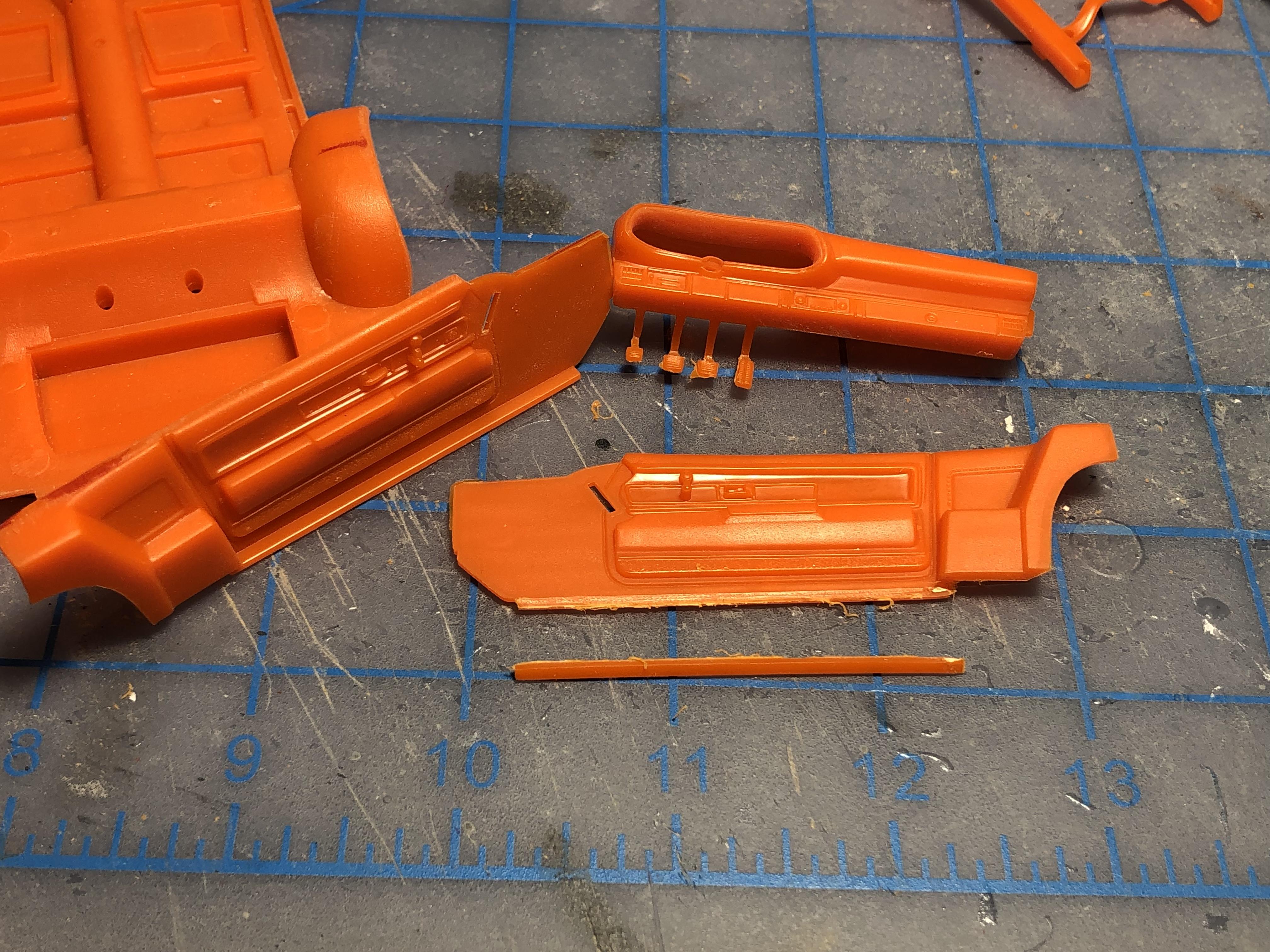

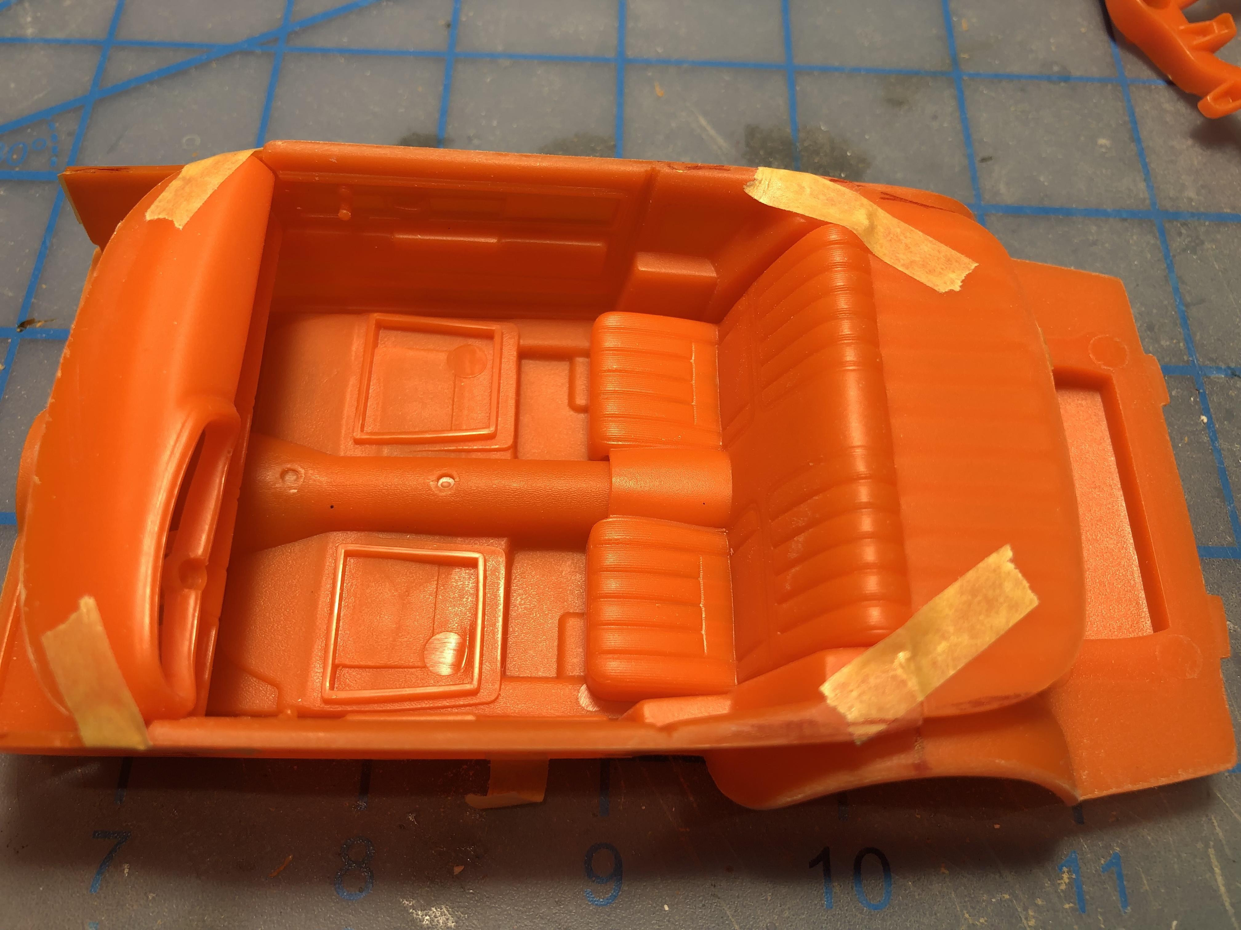

To channel the body over the frame the inner door panels need about 2” removed from the bottom. First I cut off the “L” shape where they mount.
Then cut off and reshaped the lower edge of the door card. Quite a bit of grinding and sanding needed to be done where the panel meets the rear inner fender. The end result, you can see the amount removed compared to the rear package shelf.
The next job will be fitting this where the rear seats are/were. No back seat drivers in this one!

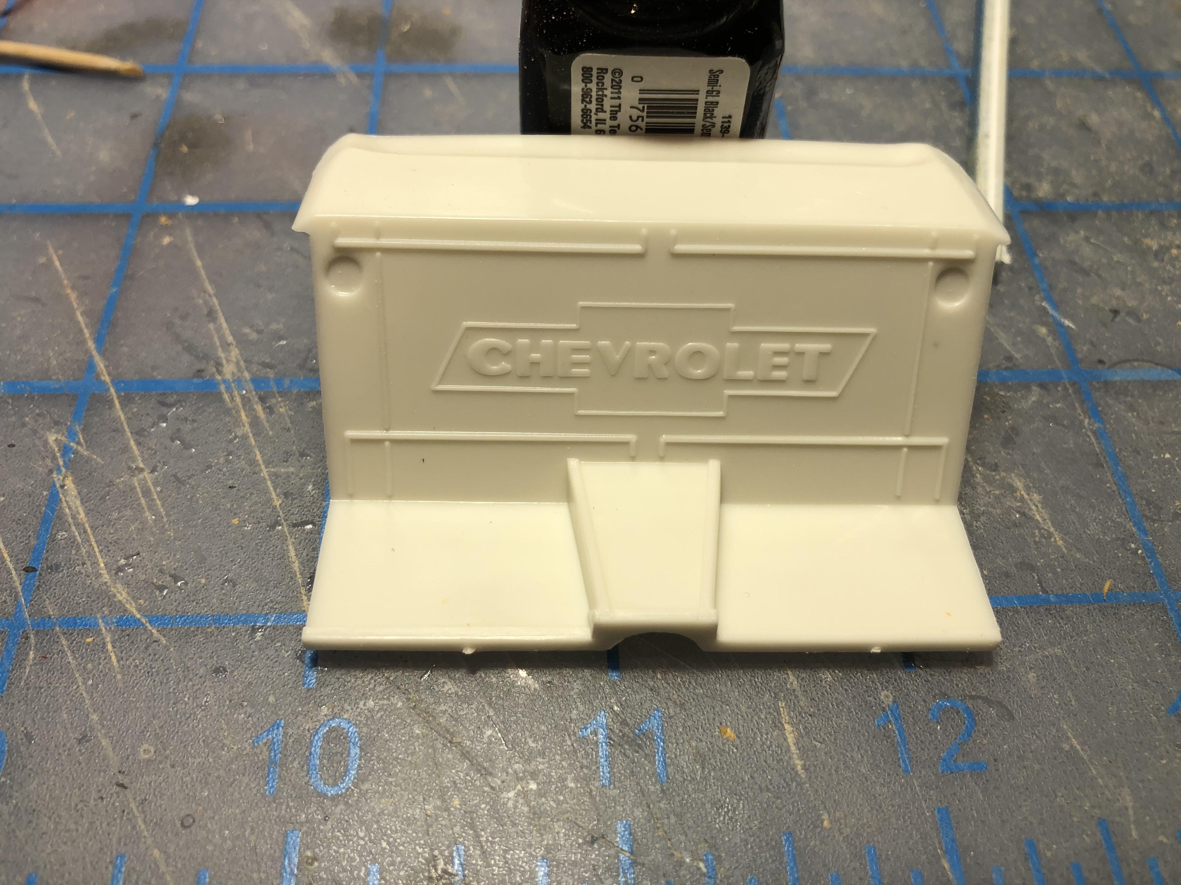

On to the rear of the interior, here’s the rabbit hole I went down…

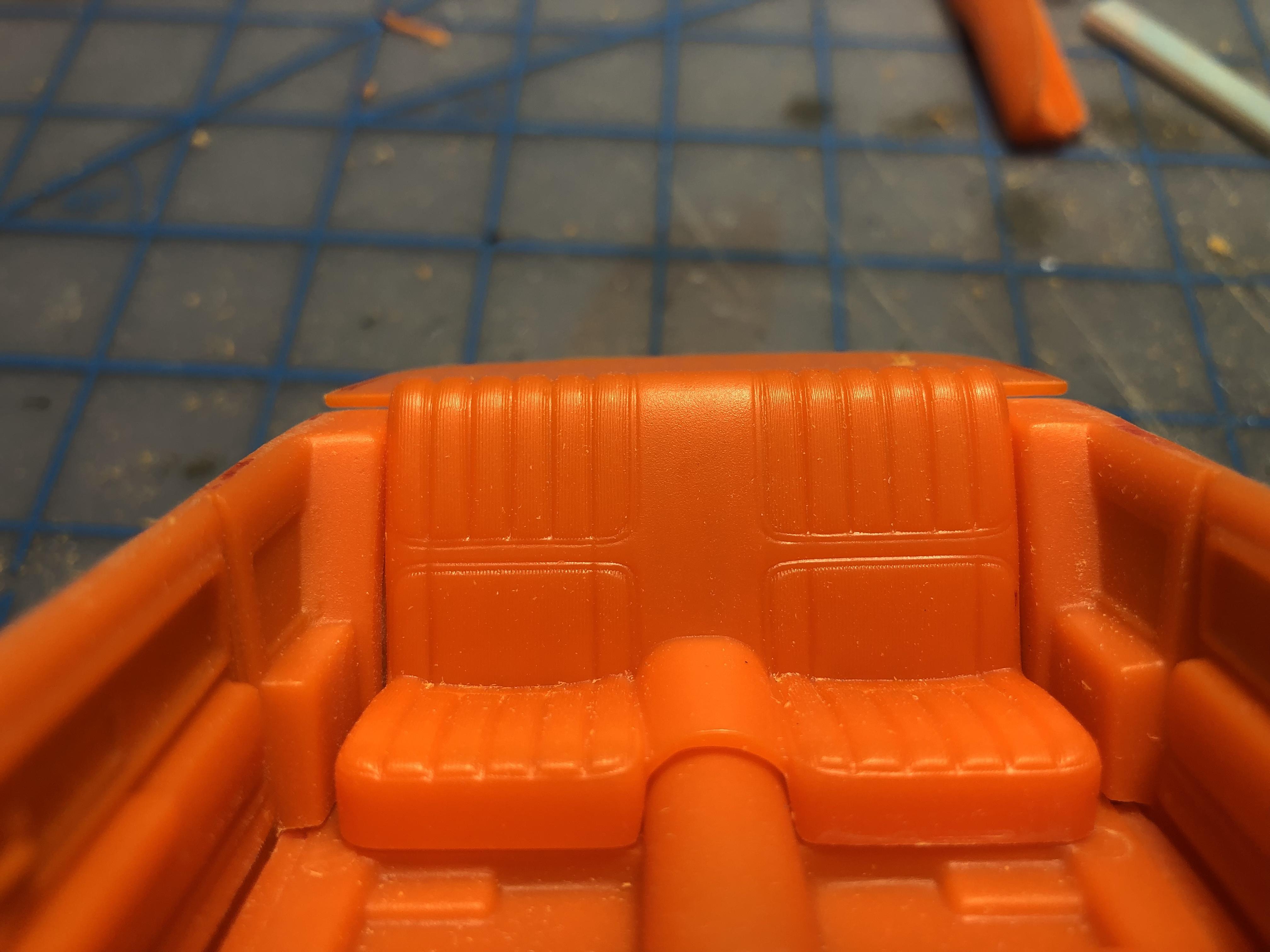

Here’s how I got there. First I cut apart the New replacement piece, and made a raised “bench” to replace the seat bottom.
2488DECC-1A9B-4710-8997-F79E6681A1F9.thumb.jpeg.6283b070b8b04cecb2d3caa1b188773a.jpegE4894AE0-12A9-4797-B11C-AEADC392F5BF.thumb.jpeg.2153003ae97b7ea1a932e60844a556b2.jpeg41BE4593-487D-4A44-AF8F-4CDB611E25D1.thumb.jpeg.ddedc9ef267b929d4ca82e3ffdbd75ef.jpeg

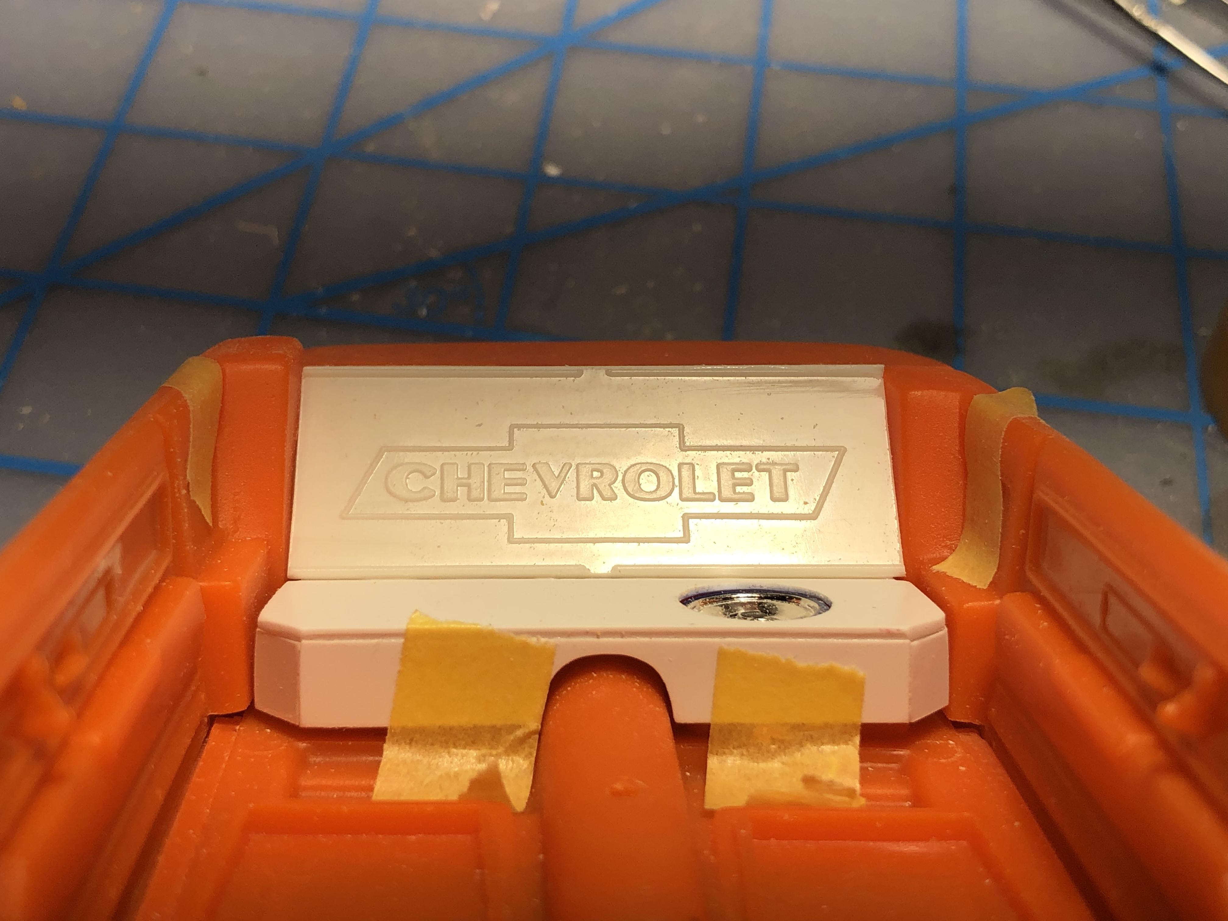

Next up, a hole for a subwoofer, add the back and re-attach the kit package tray.
C5F1145C-7915-448B-A1AD-F81C66000613.thumb.jpeg.561810aad32ec2d64aec71c7d189b513.jpeg63B37C41-7DE1-4D74-AEC1-10C1C318EA93.thumb.jpeg.e6f540ef44693de2e2e2c0e43368a4d9.jpeg
The sub is from a diecast car, it will get stripped and painted. Next photo shows that package shelf is now at the correct height.
