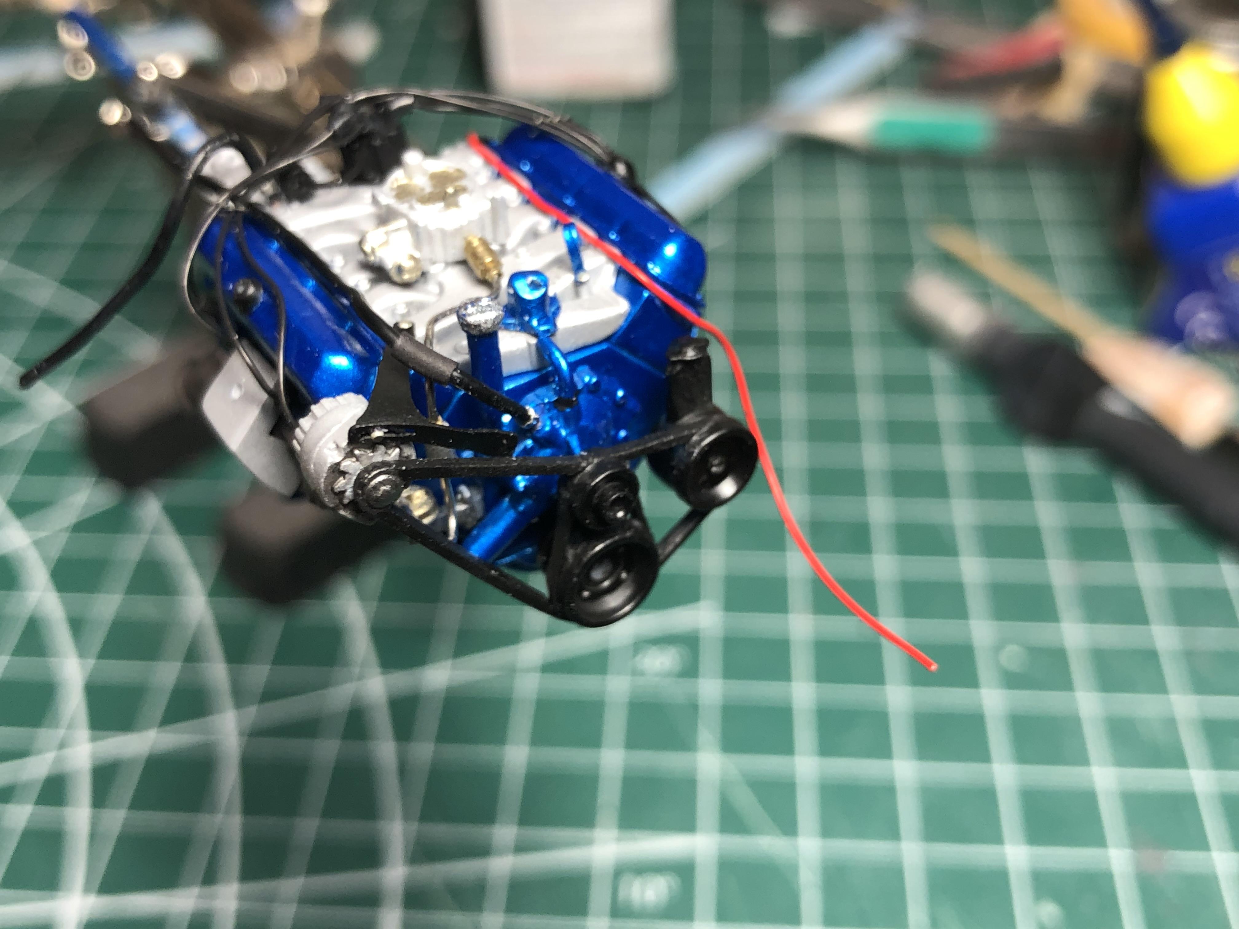

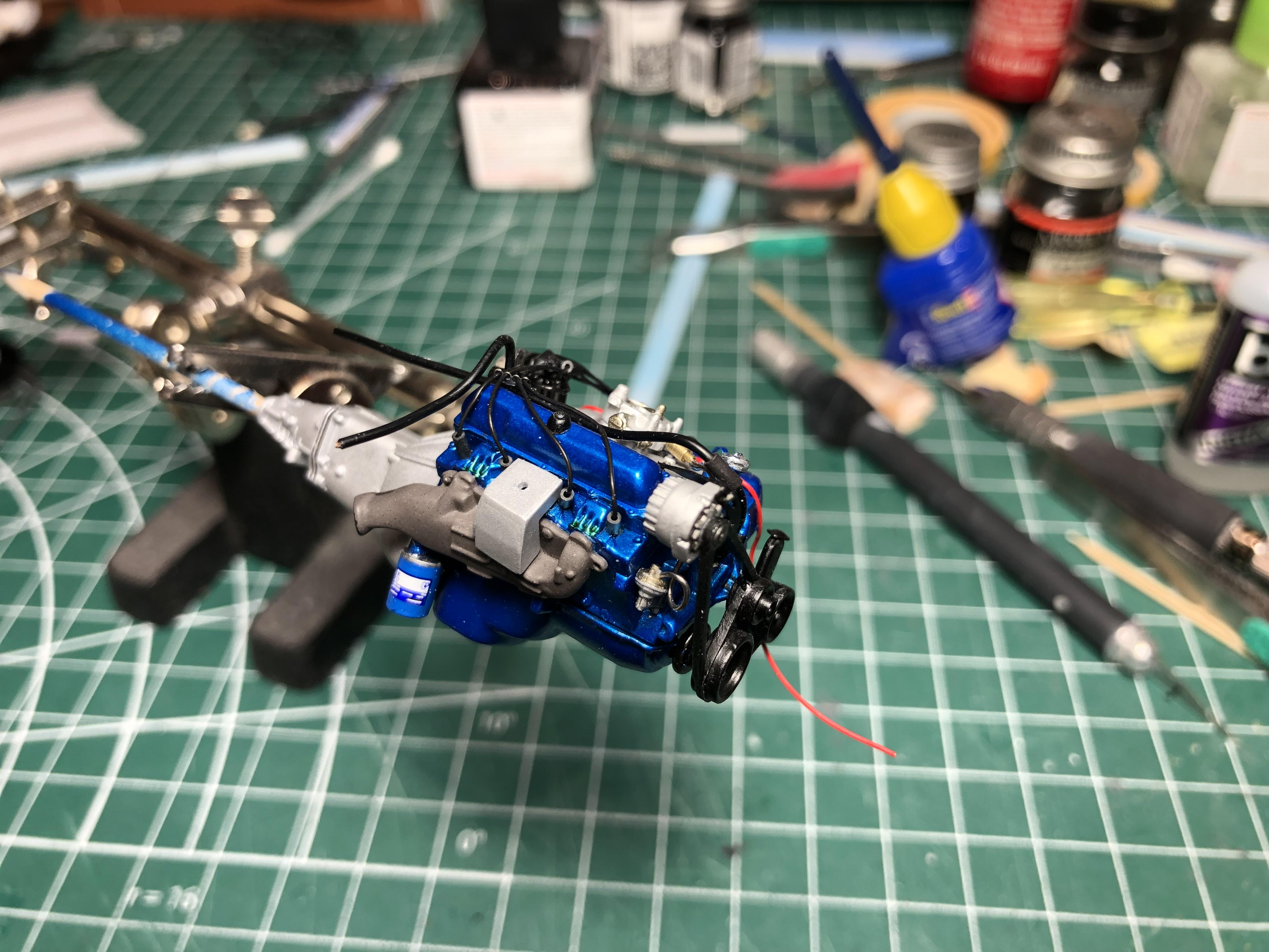

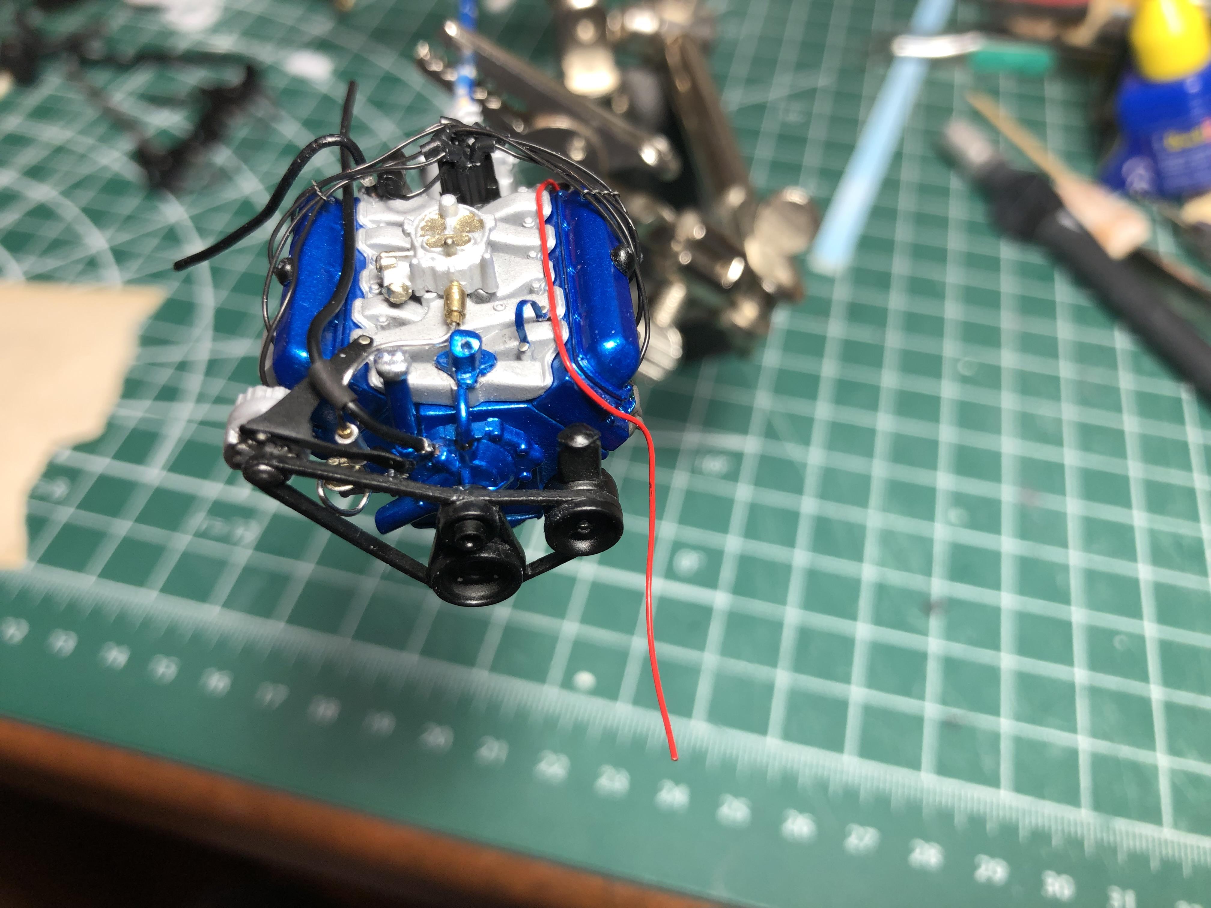

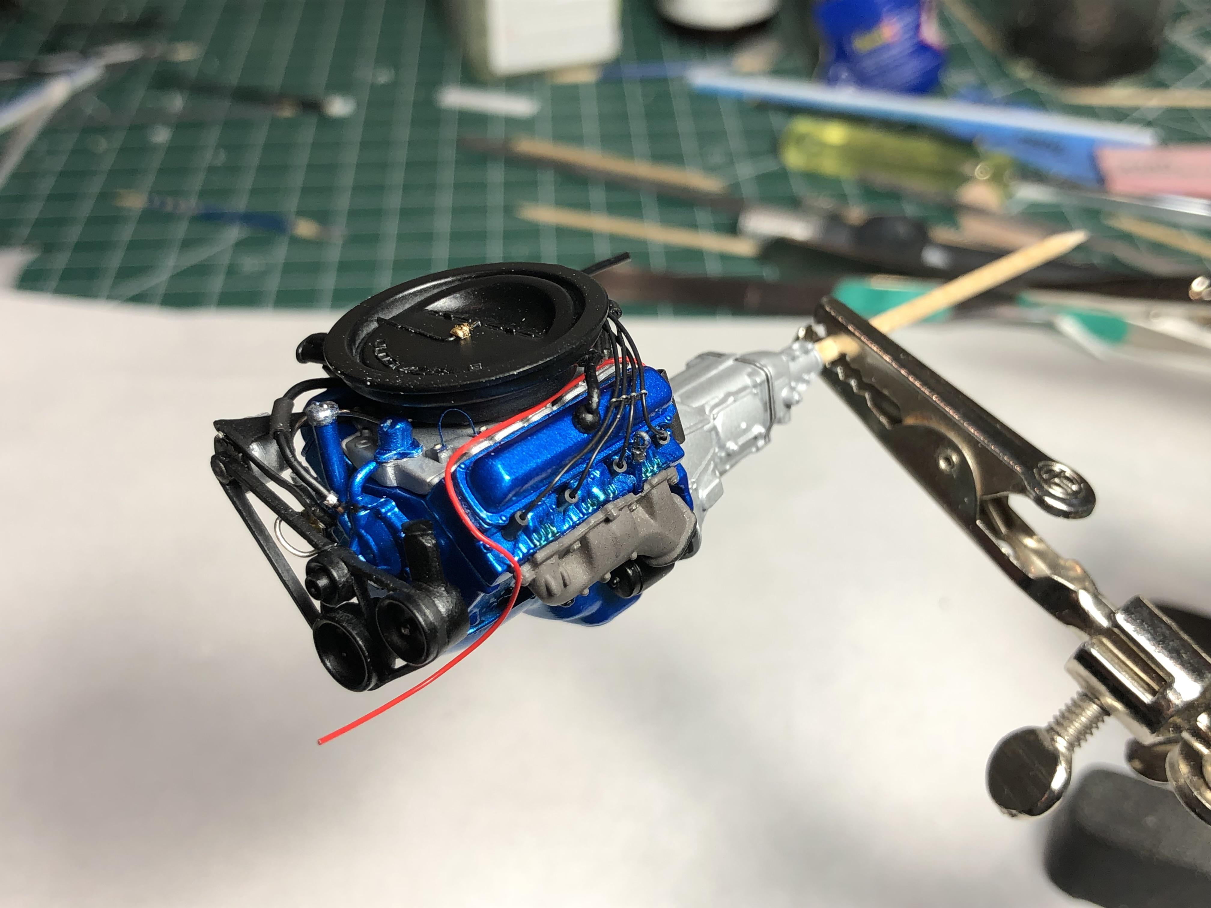

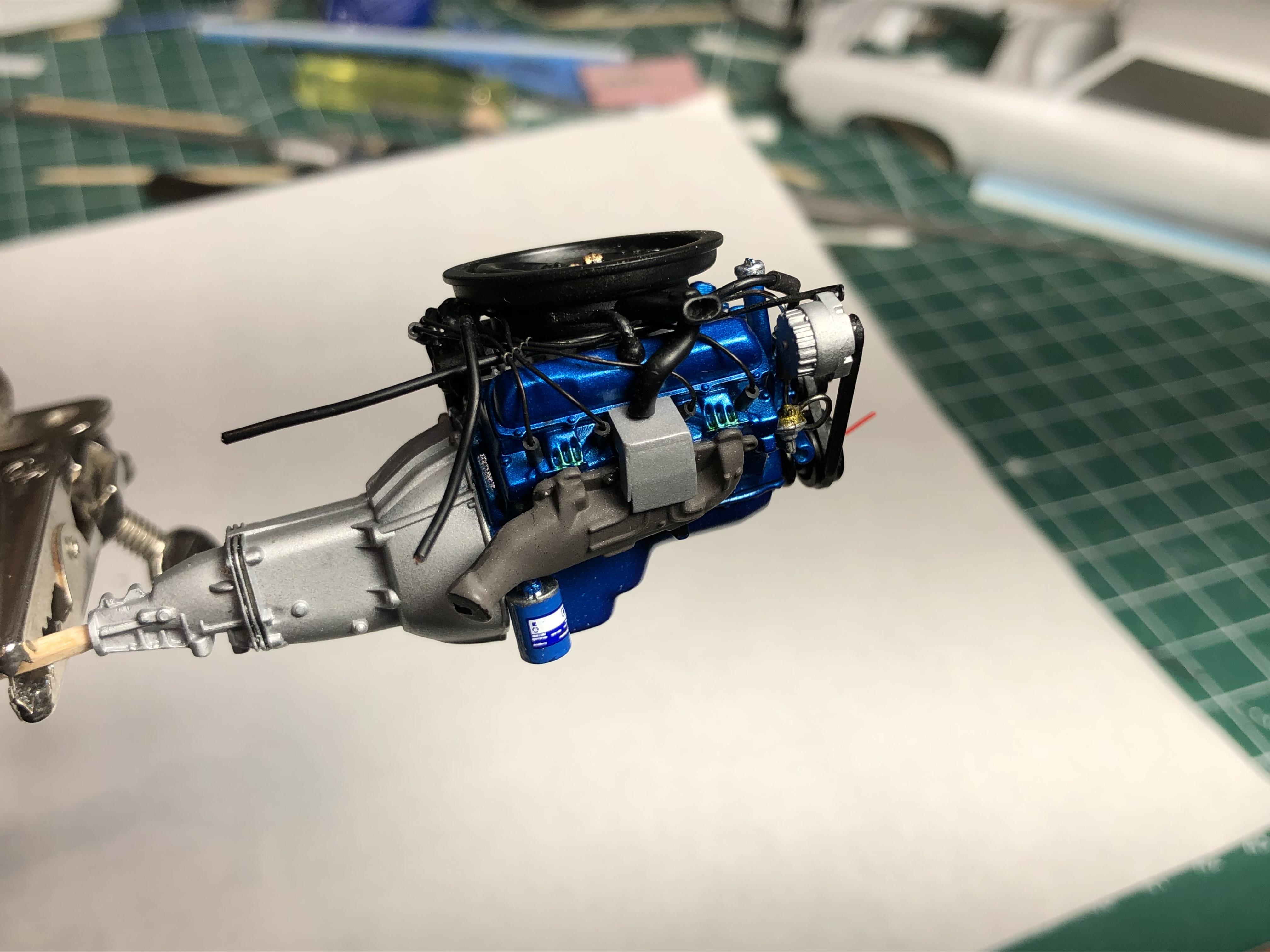

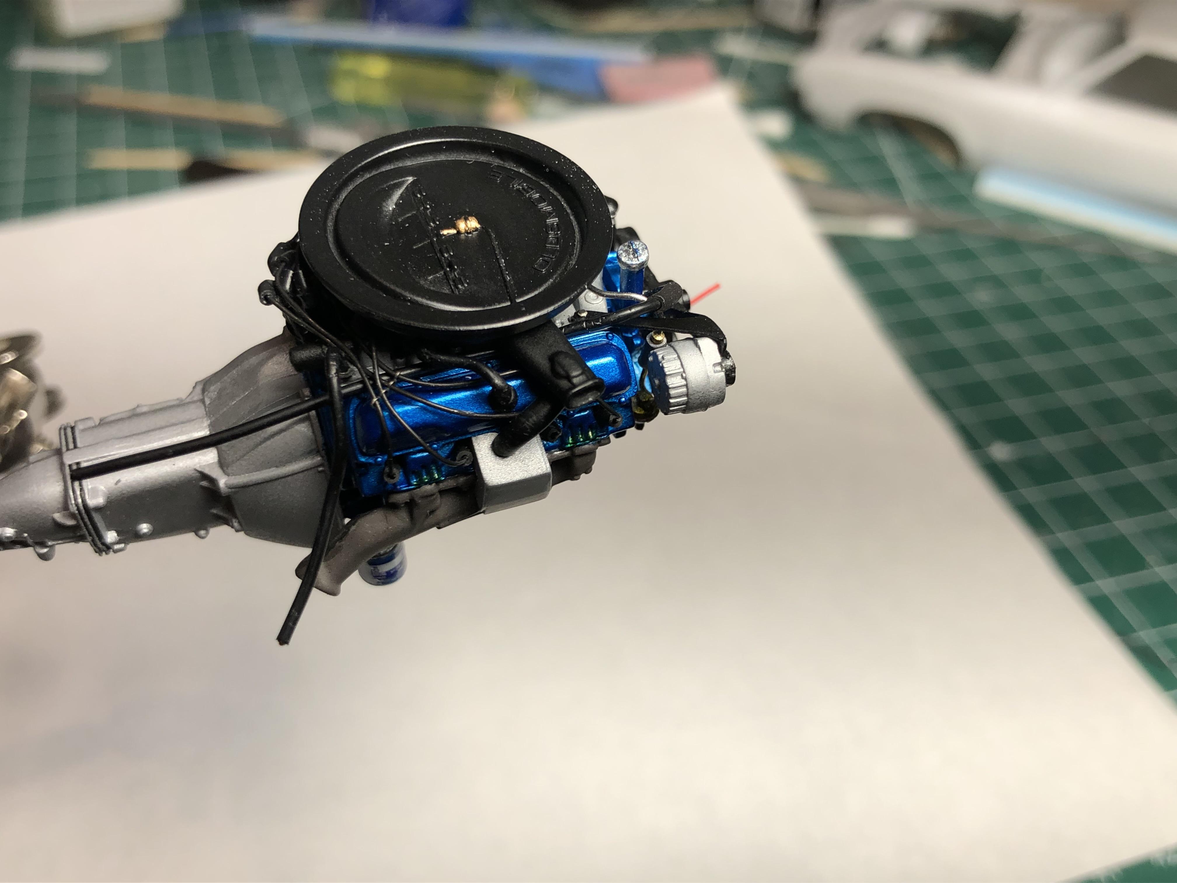

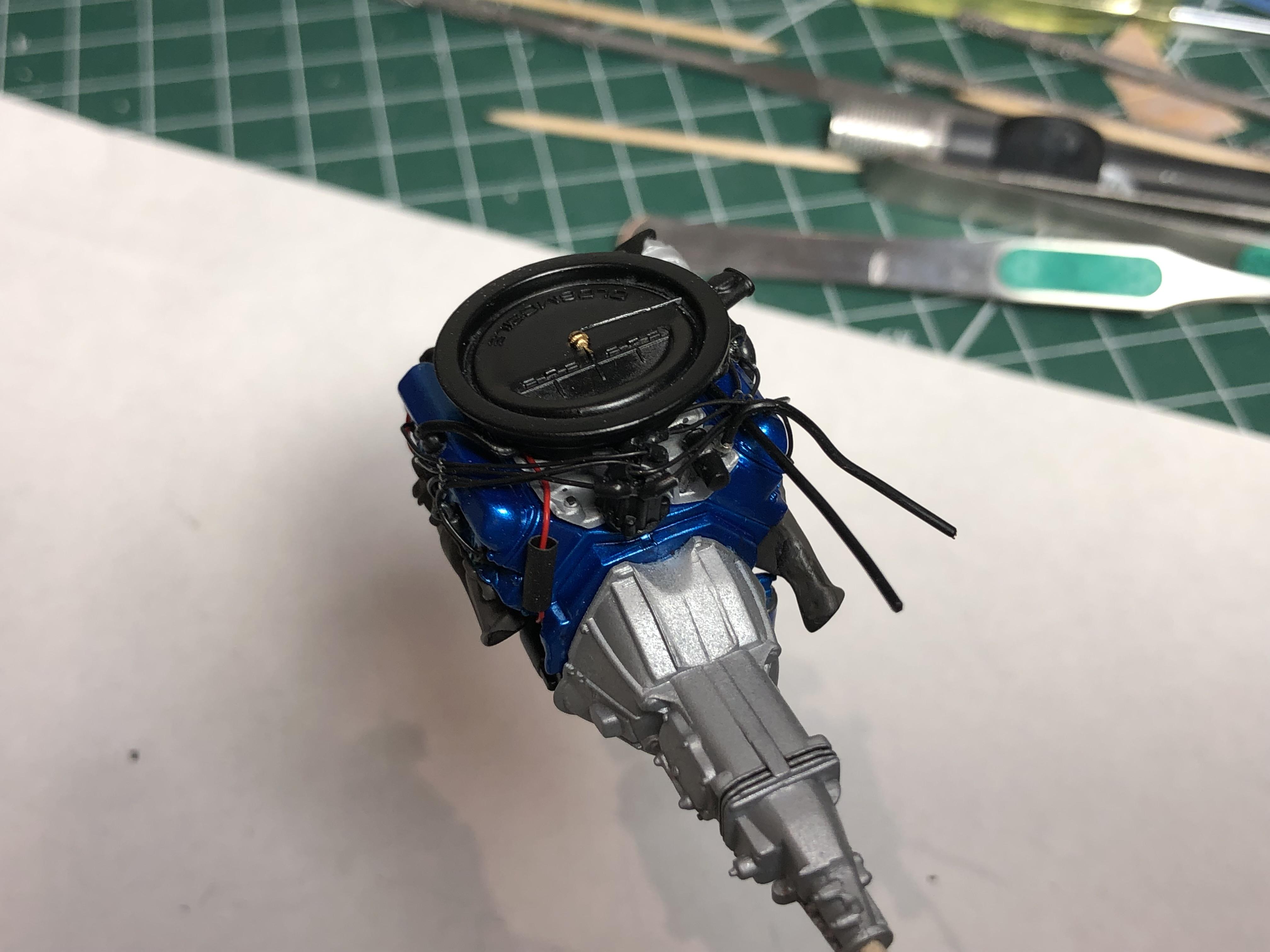

Added a few more details to the engine. Scratch built the box that fits over the passenger side exhaust manifold. I will add the hose from that to the air cleaner later.
Scratch built a bracket for the alternator. I have some photo etch ones but I wanted to try my best to replicate what is on the car. I’m trying to get away from alternators floating in mid air as they often do in 1:25 scale… Added the other heater hose which has a clamp made from a thin strip of BMF, and a piece of heat shrink tubing to replicate the protective sleeve on the car.
I also added the little metal hoop on the manifold. It’s a piece of photo-etch fret painted in the same blue as the engine. This is the first time I’ve used photo-etch bolt heads. I just got some and thought this is a good opportunity to try them out. I used them on the metal hoop, the alternator bracket, and I will likely use a few more before I’m done. I have decided not to do throttle linkage as it will be lost under the air cleaner. So, now the engine is getting really close to complete, and chassis is ready for assembly.
Thanks for looking and I truly appreciate the comments guys.

Thanks Greg! Yes, having photos has been super helpful. I’m trying to push myself a bit with added detail, hopefully it pays off. I’ll be doing a replica of my Beaumont some day so this is good practice ?

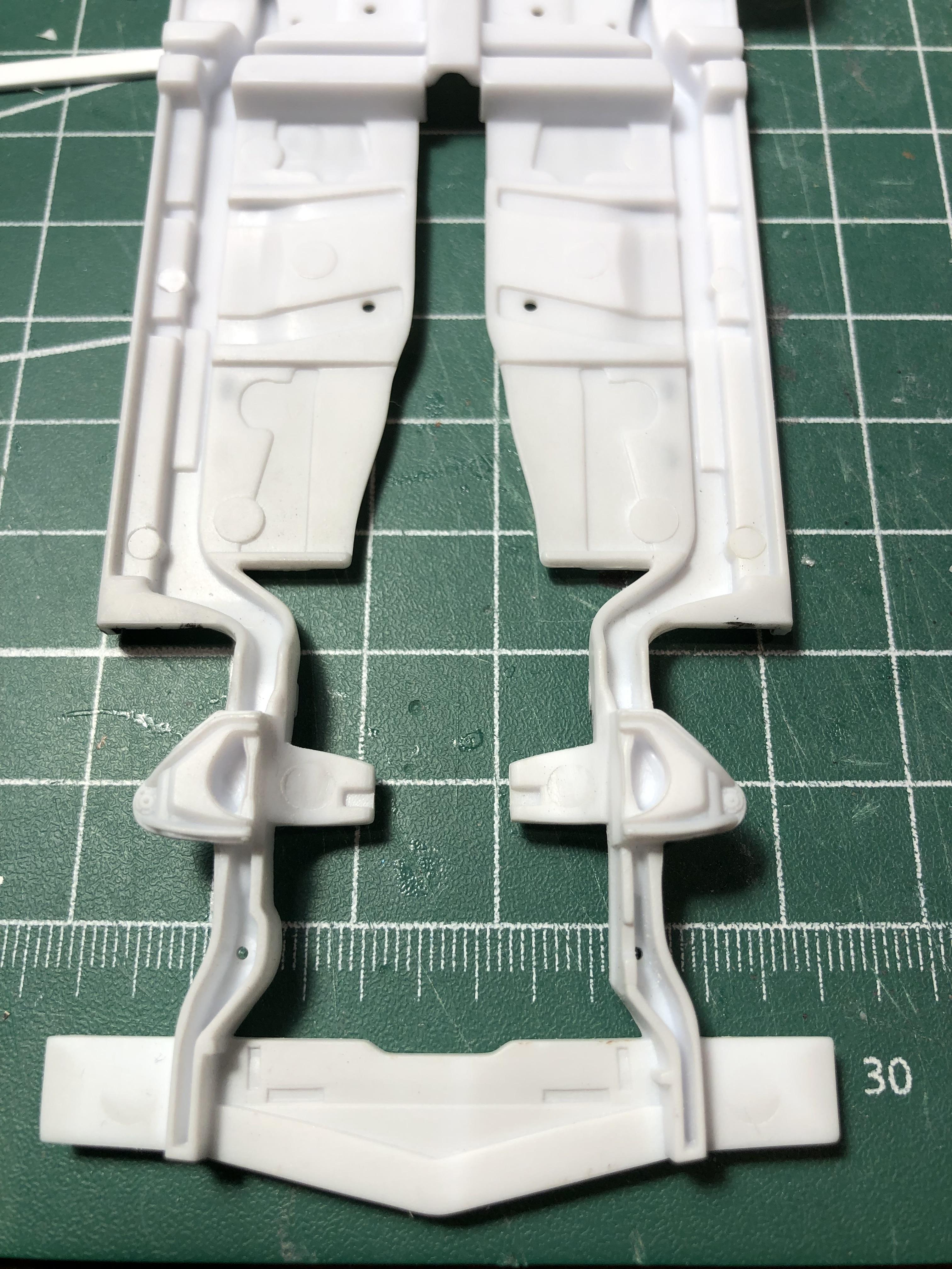

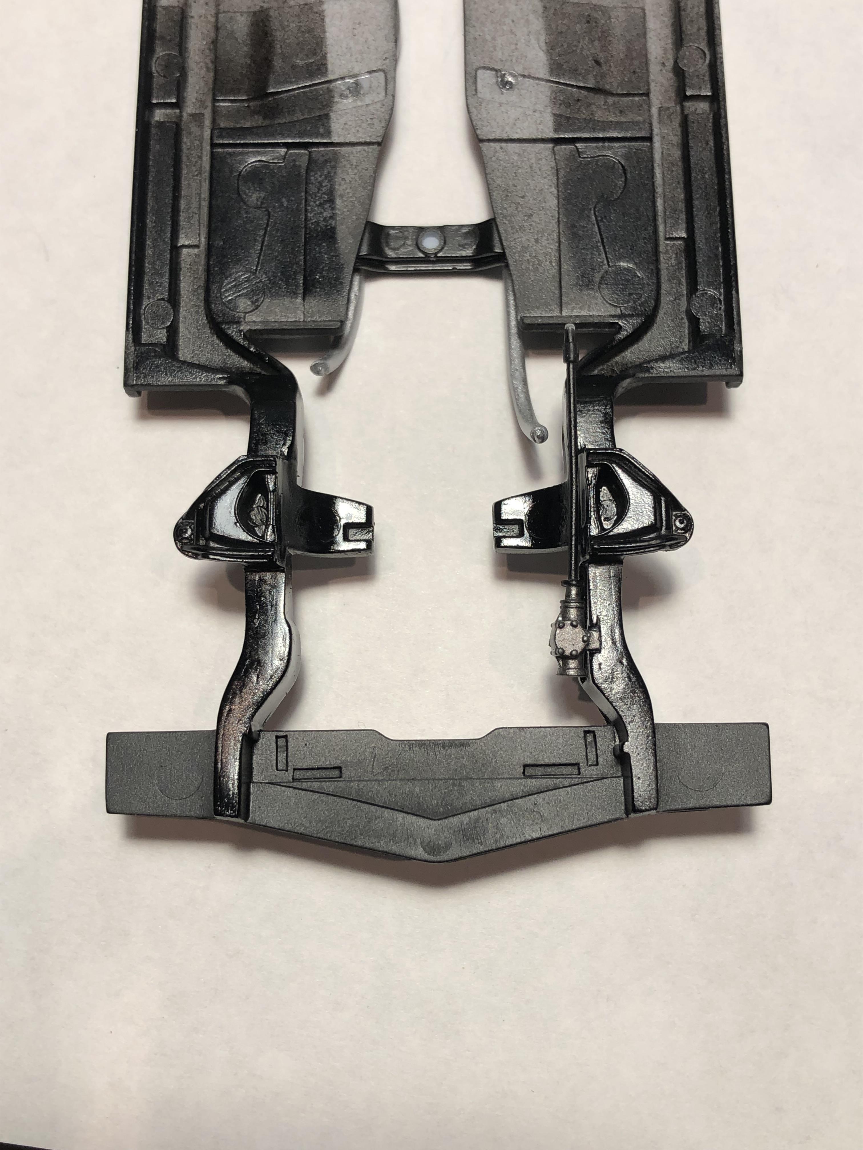

So, one of the things I have tried to improve on recently, is hollow front frames. So I boxed in the frame, it’s not perfect, but much better than hollow, and once the engine bay is detailed, the flaws won’t be noticeable.

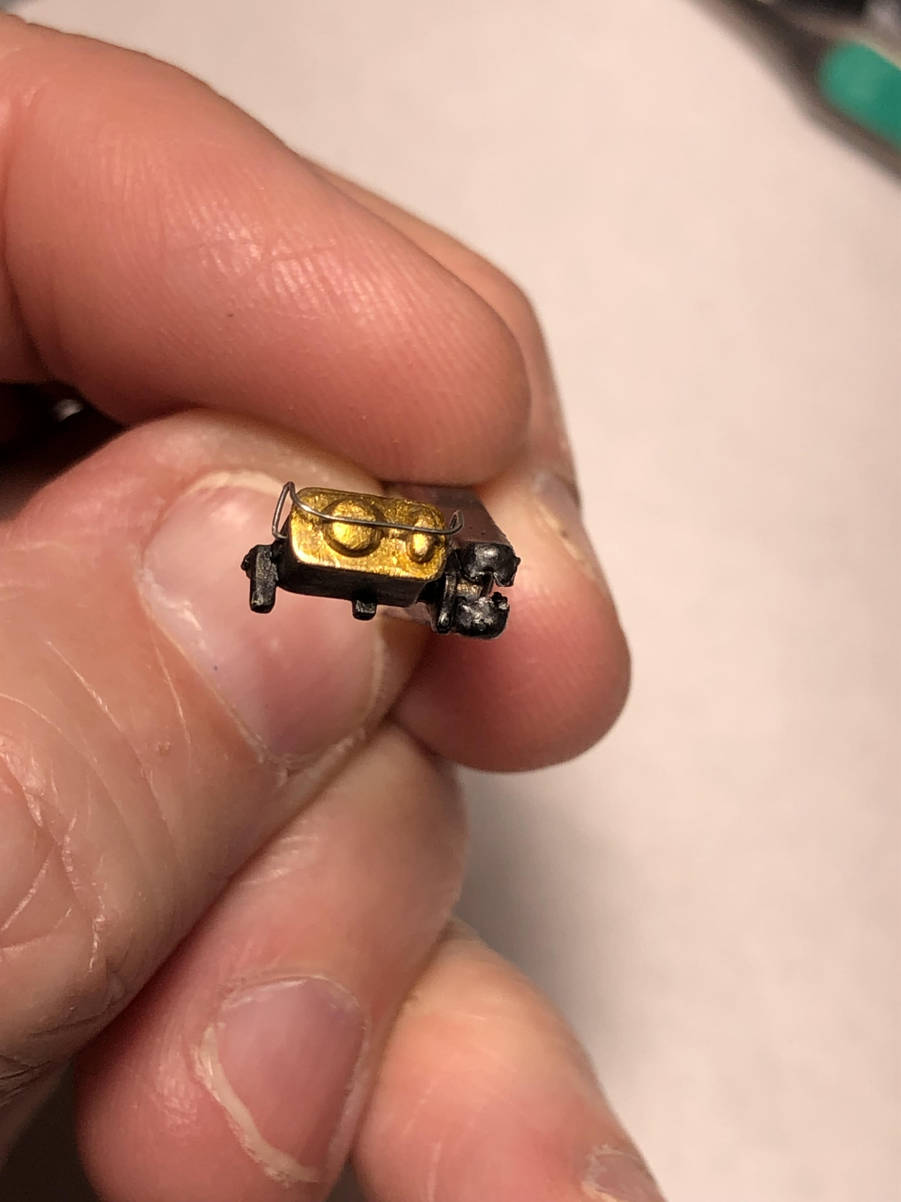

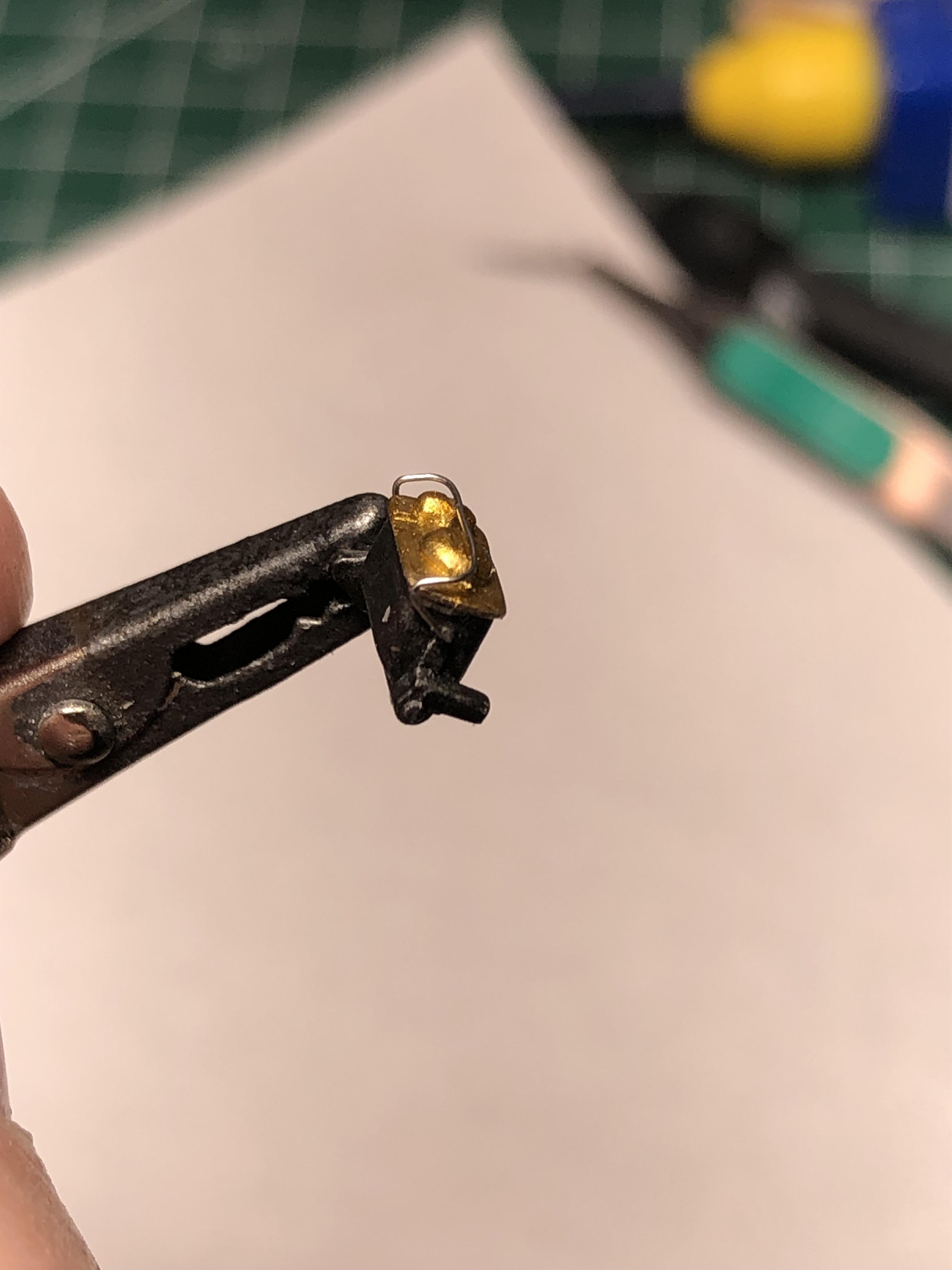

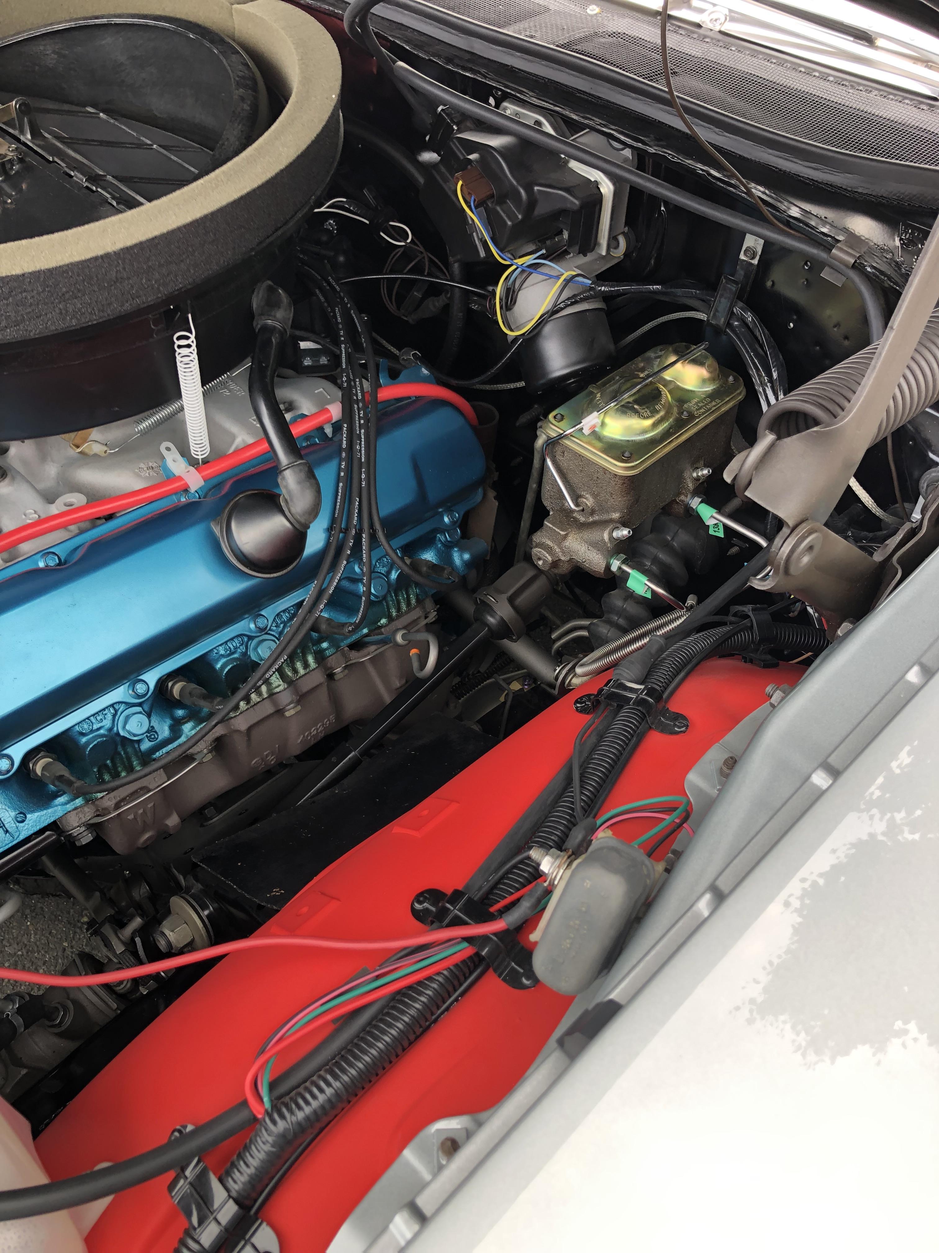

I thought it would be fun to add a little detail to the master cylinder. First time trying this, but it turned out ok I think.
The real car…
kit piece before…
After…
I will add some brake lines later. The cap was painted gold, then I brushed on some clear yellow.

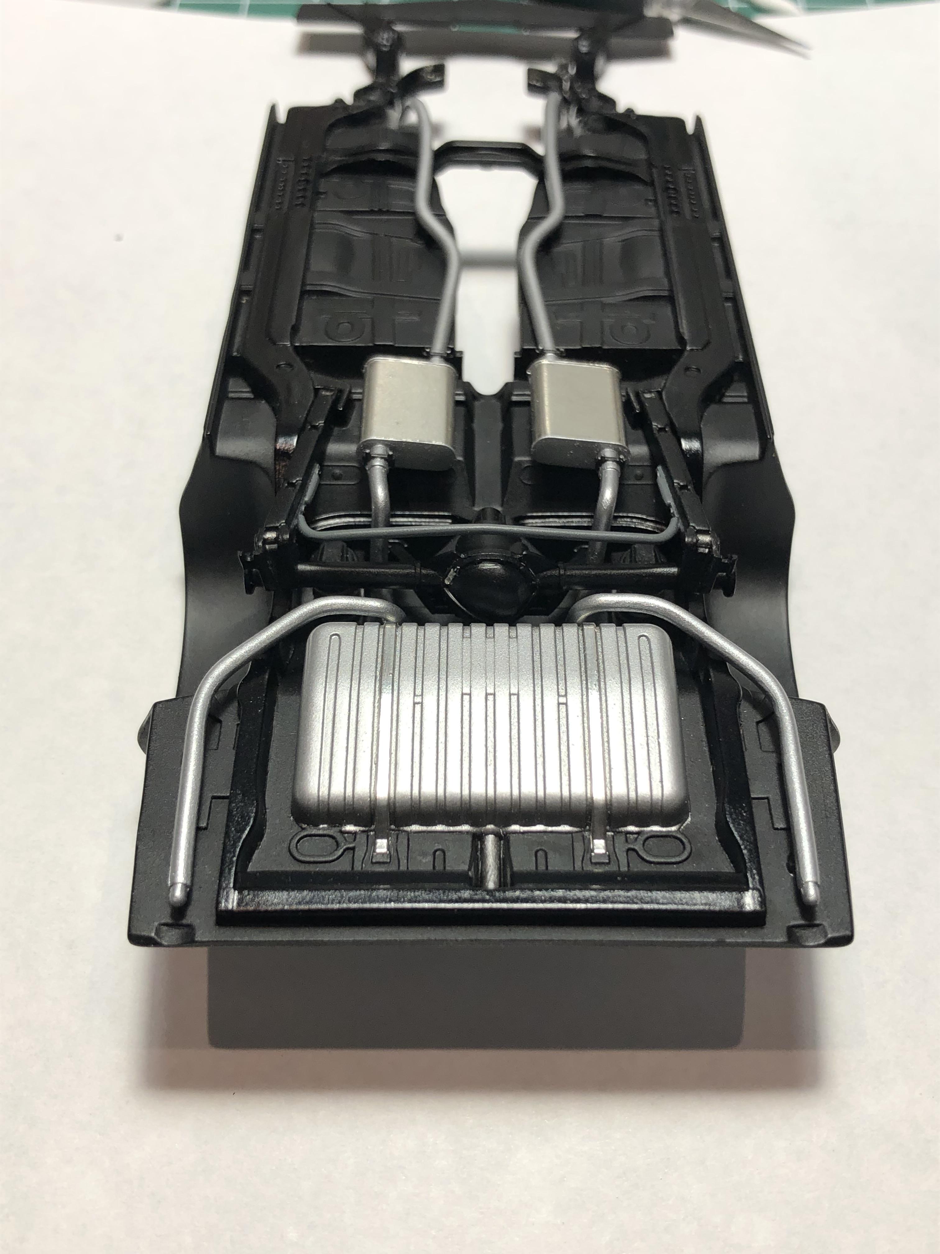

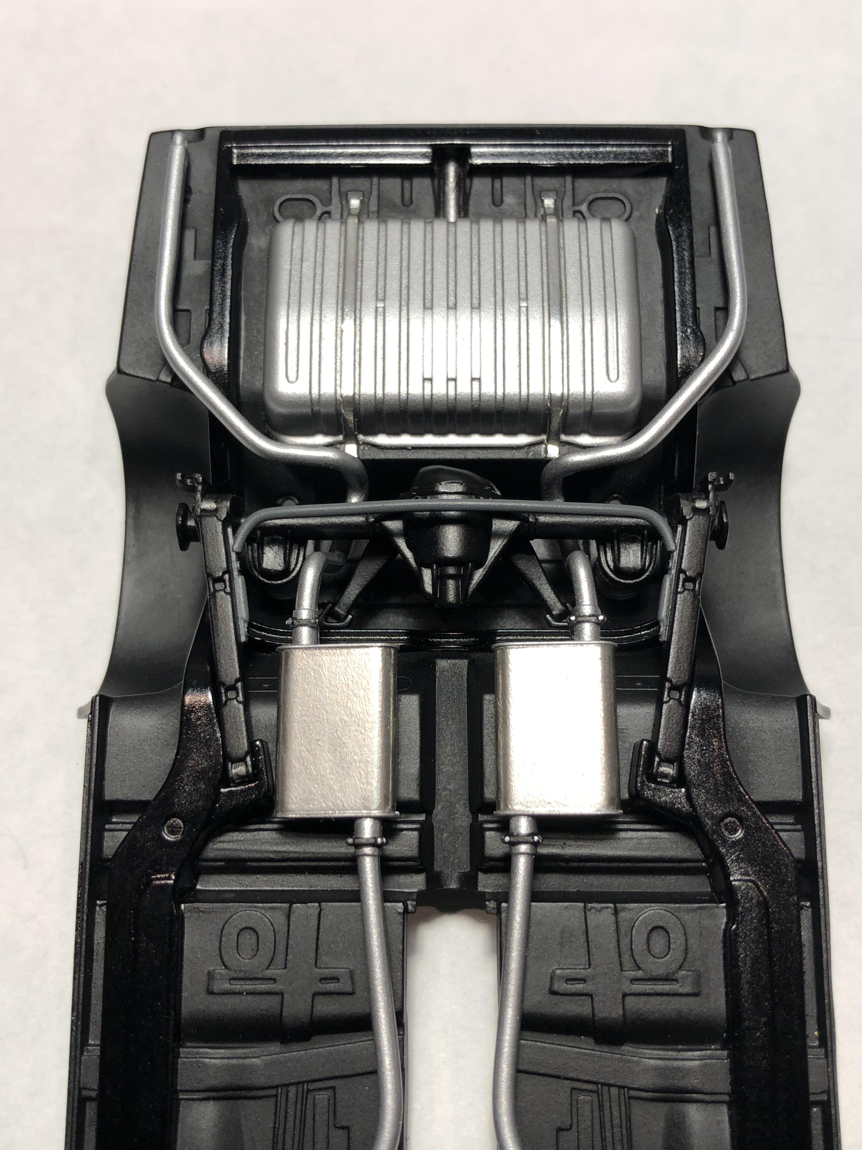

The chassis assembly has begun. Exhaust pipes are mica silver, mufflers are wrapped with matte aluminium BMF. Chrome BMF straps for the fuel tank. I still need to add the shocks. I’ve included a photo of Wayne’s car for reference. If you look close, you will see I added the small aluminum tag on the rear differential cover, just for fun. Smallest piece of BMF I have ever applied…
That’s it for now, thanks for having a look.

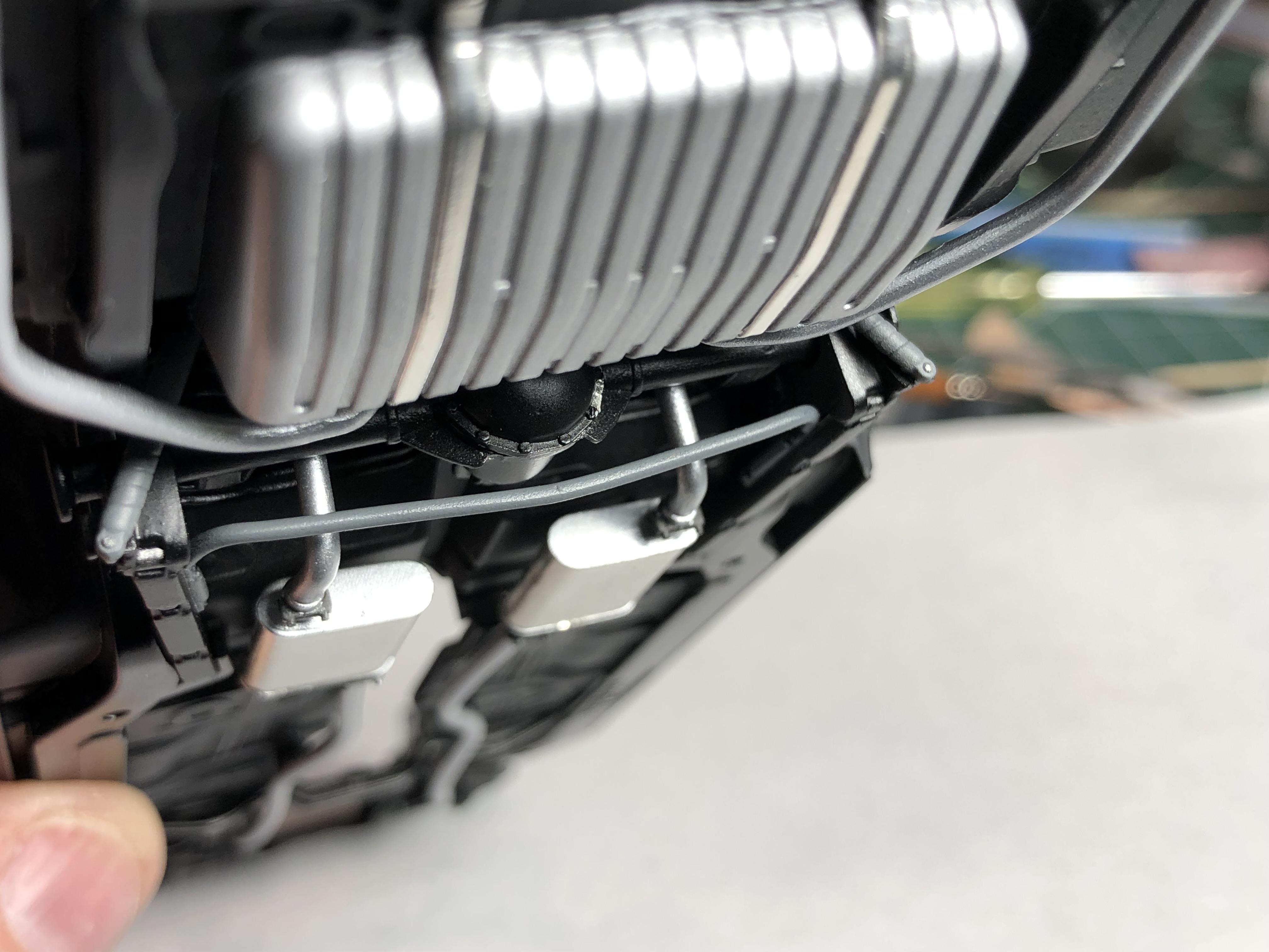

Shocks are now installed, along with the front suspension. I included the photo I have of the rear end and tried to copy the photo with my model…
In this photo you can see how I tried to mimic the aluminum tag on the diff cover.

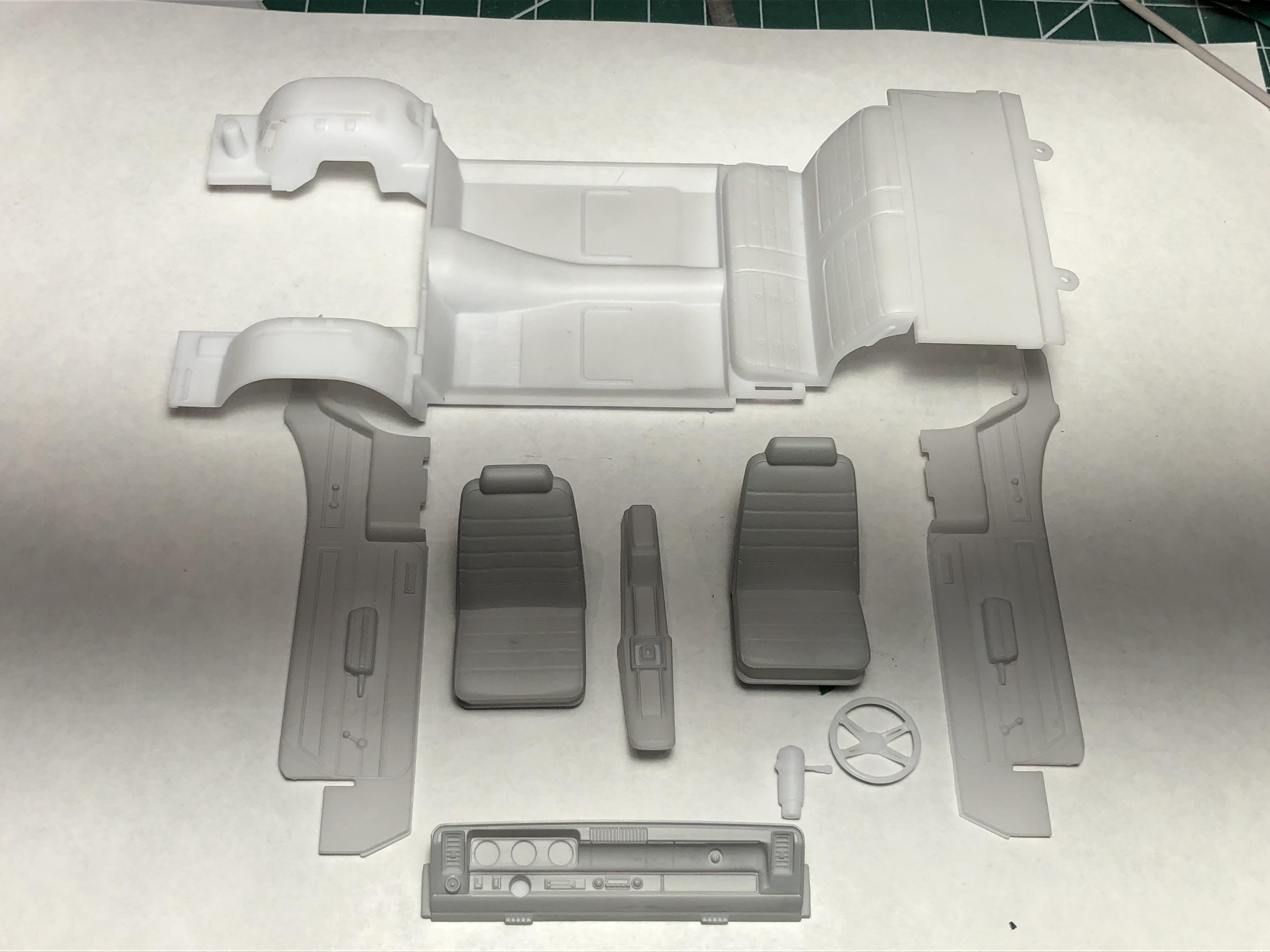

Today I started working on the interior. I initially thought that other than the 8 track player it would be straight out of the box… Nah
Not much to show yet, here’s the main parts before meddling…

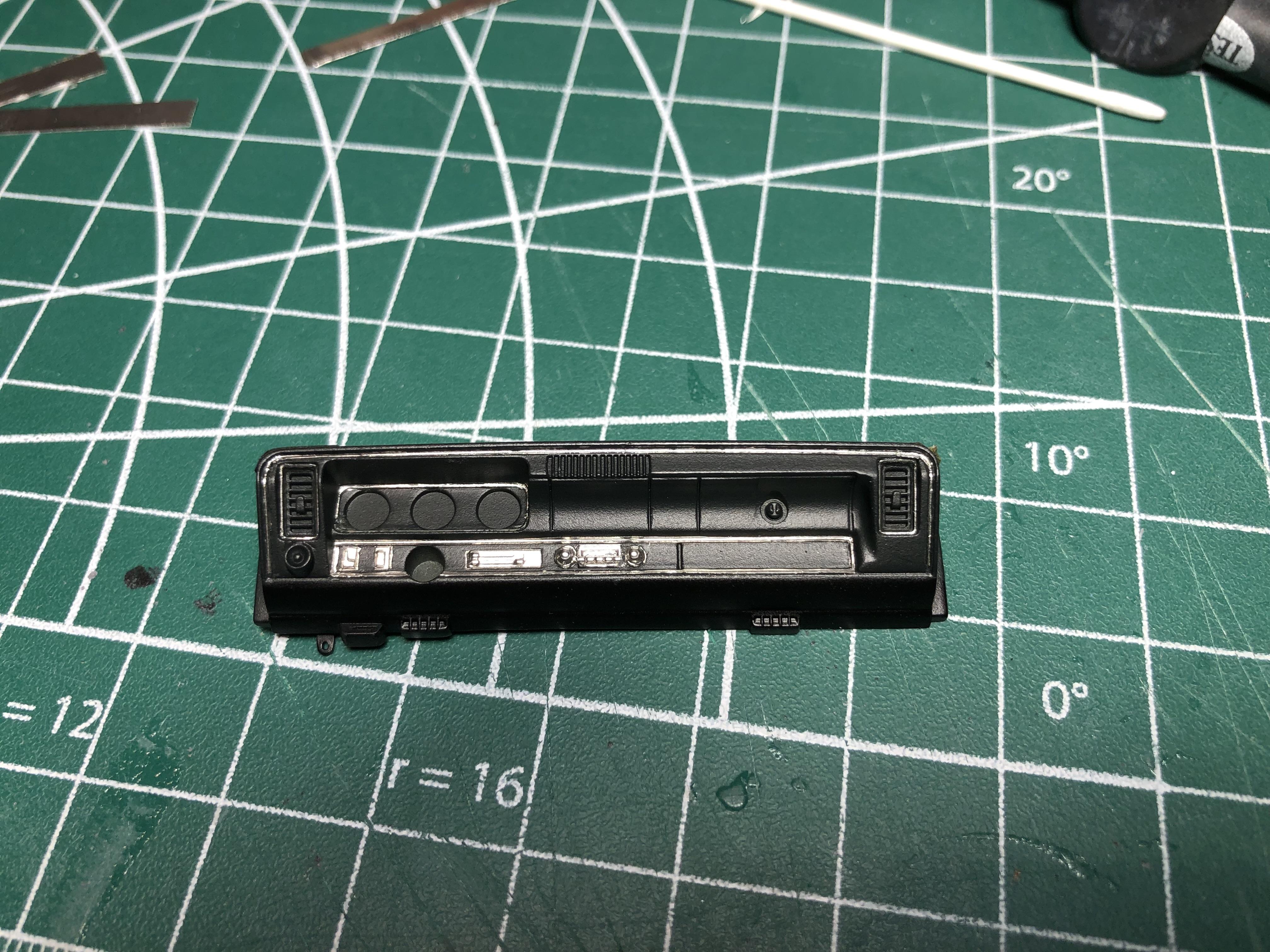

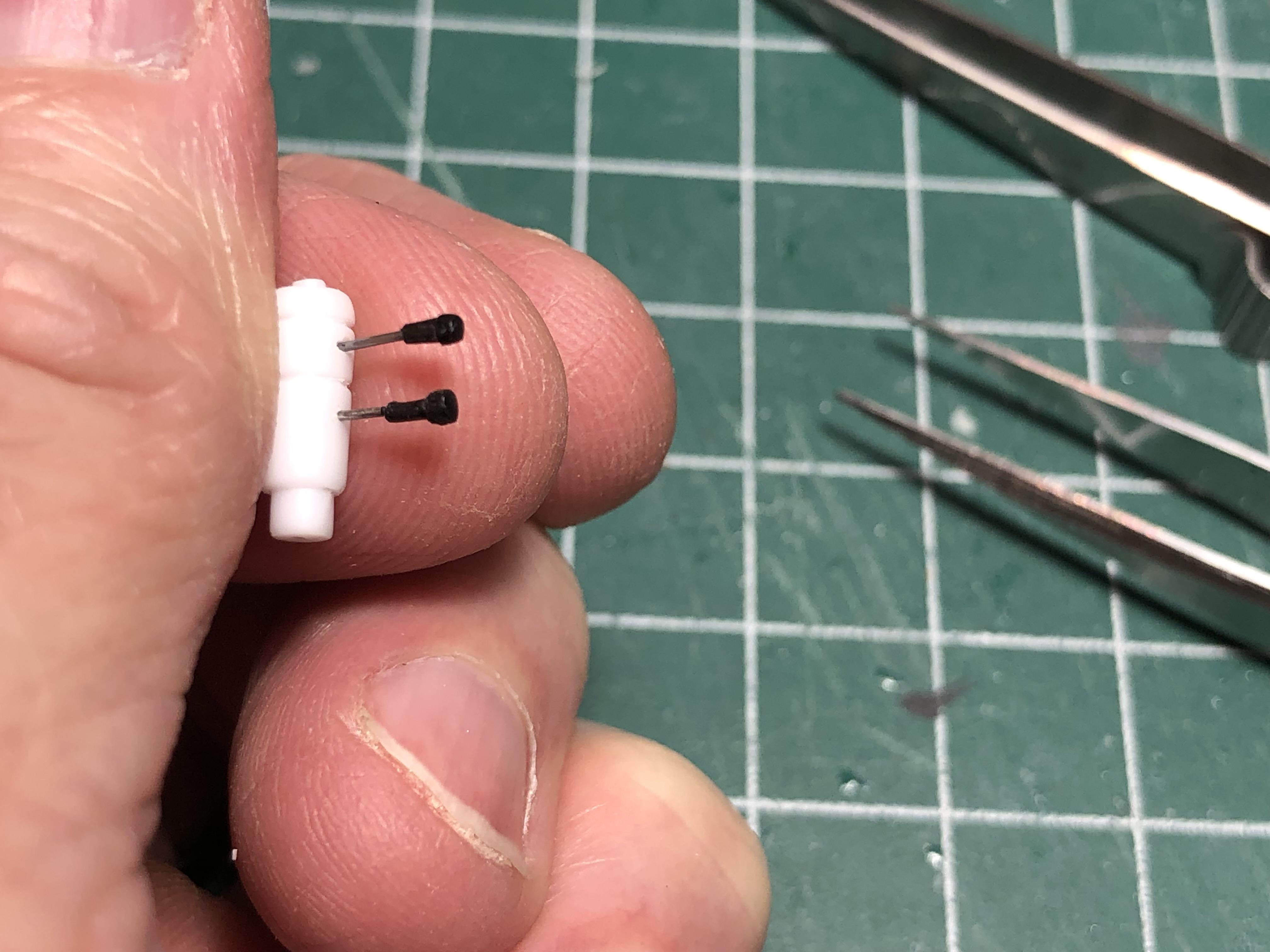

I decided I should add the vent knobs below the dash.
reshaping some styrene should work to get the shape.
Looks a mess now, but I’ll blend those in, then drill some hole to receive pins which should look the part once complete. In the last picture you can also see I accidentally included a shot of the emergency brake release that will also be added. Hoping for another update soon.

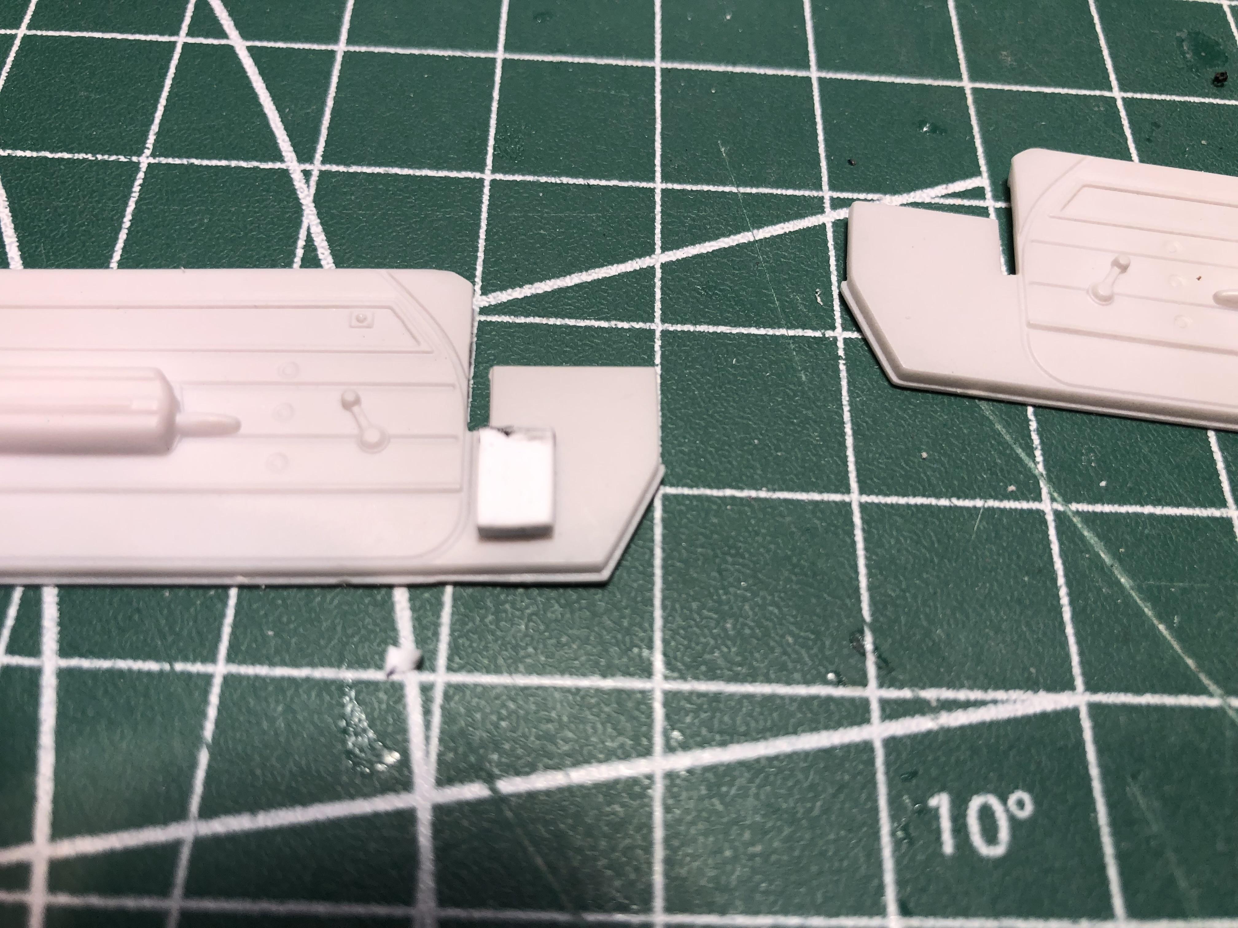

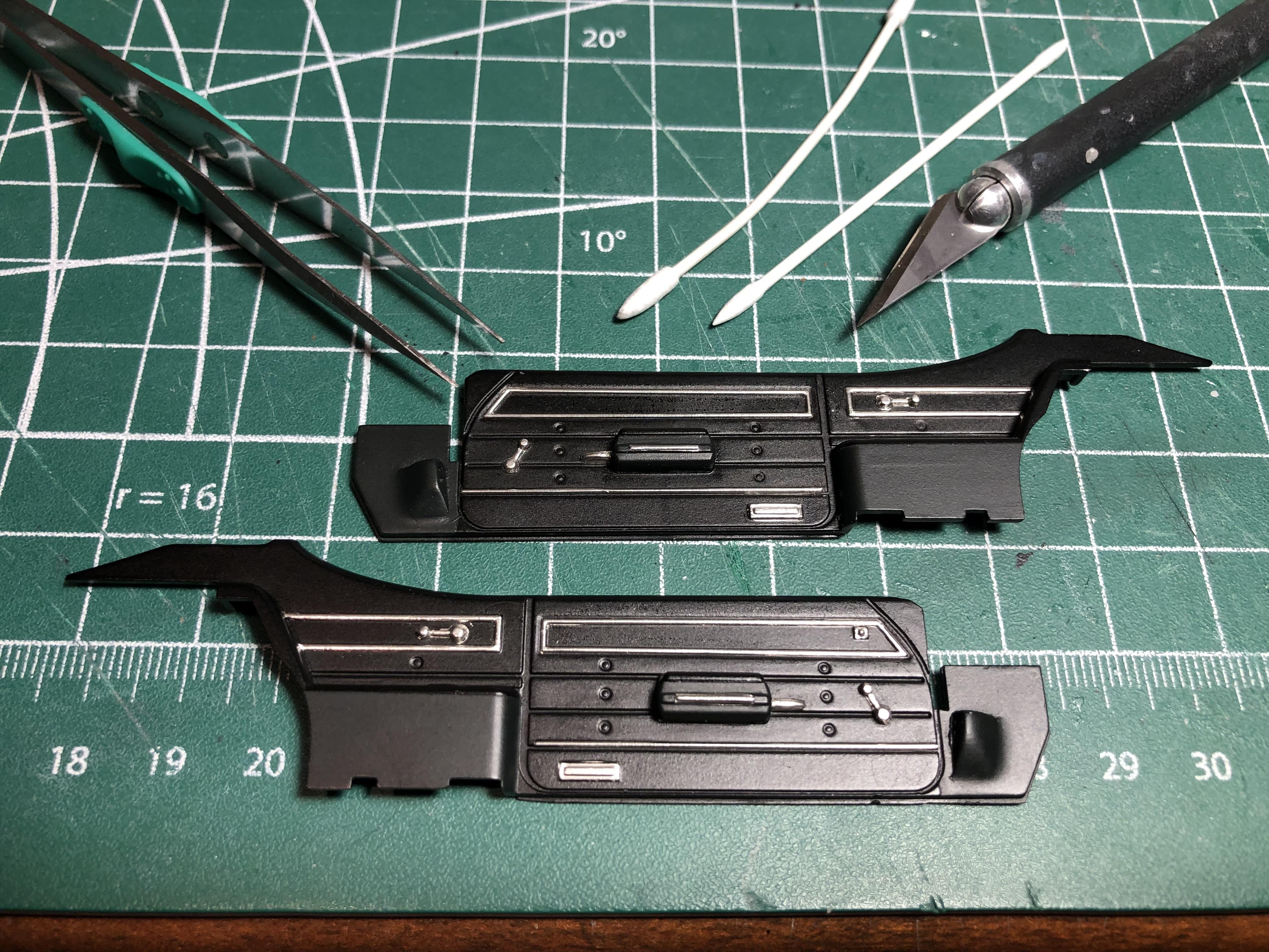

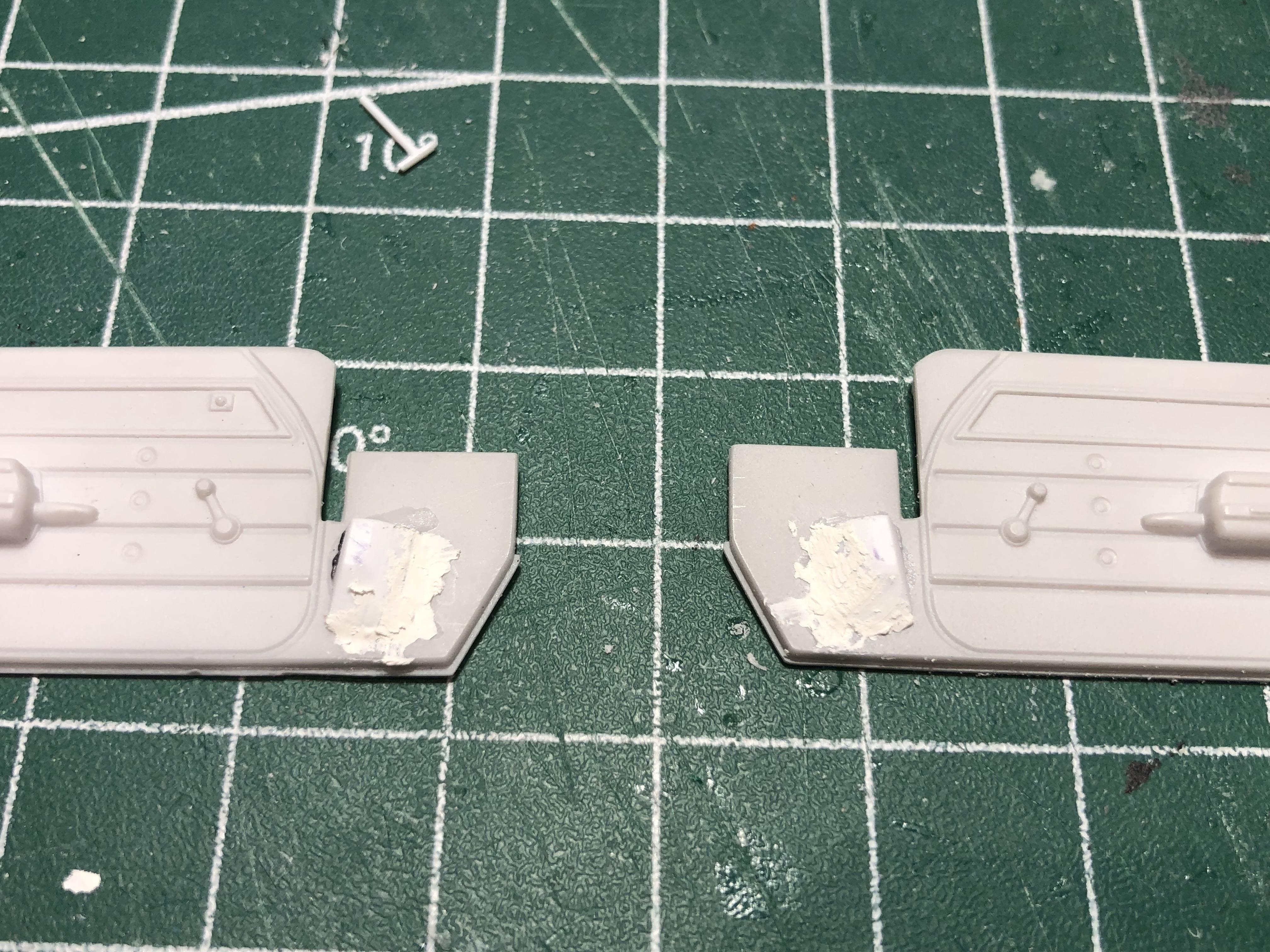

Thought I’d share some of the small detail bits I’m working on. The door cards are cleaned up, still need a bit of fine tuning but close, and I cut some pins for the vent knobs. I will probably file the heads a touch smaller, and dial back the chrome finish with semi gloss clear. They won’t be all that visible once the car is assembled, but I will still refine them some. Here’s what I have now…

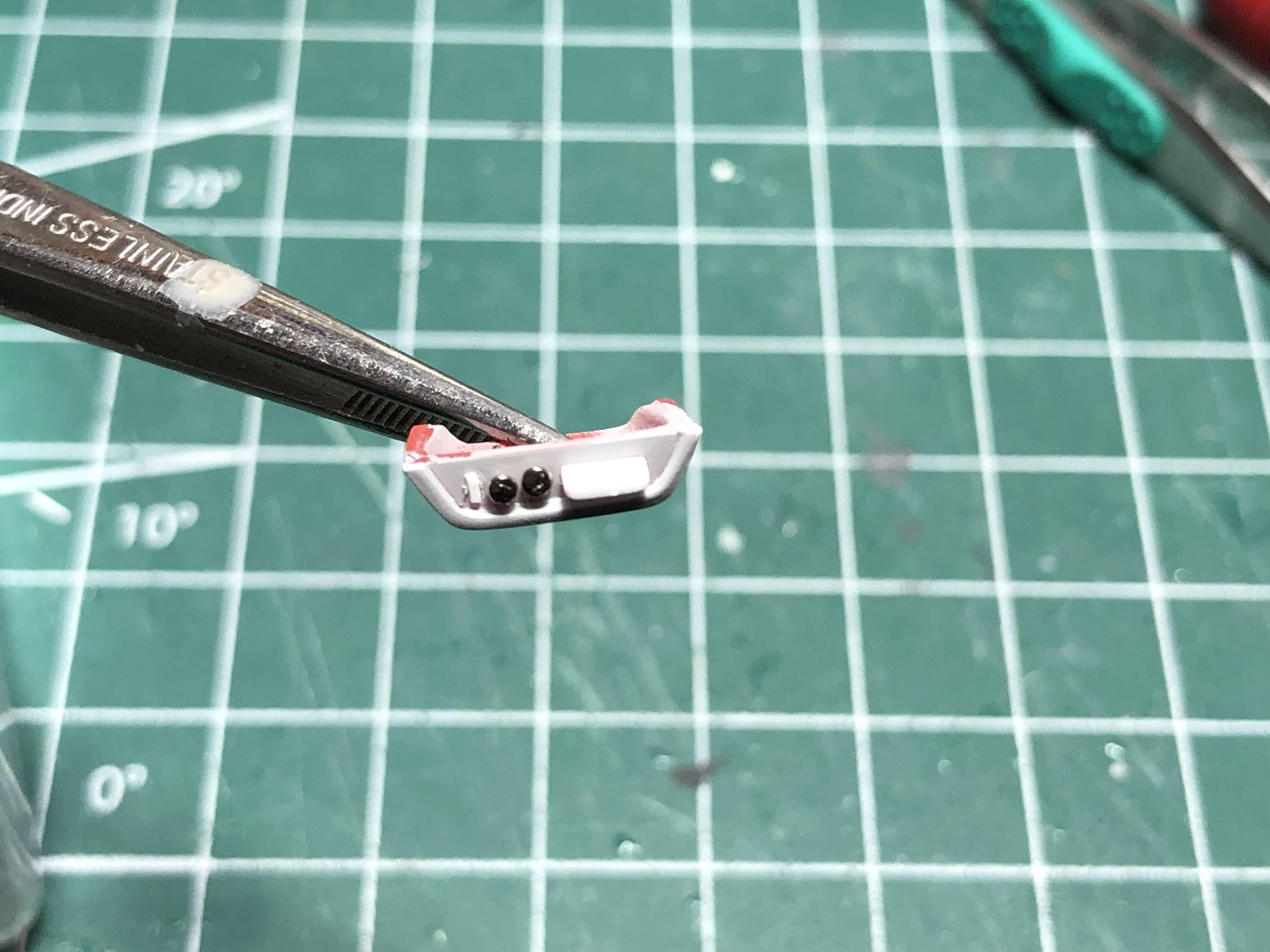

The 8 track player is getting close. I actually needed to take a picture so I could see what I have! So I can see I need to clean things up, and even out the knobs a bit.

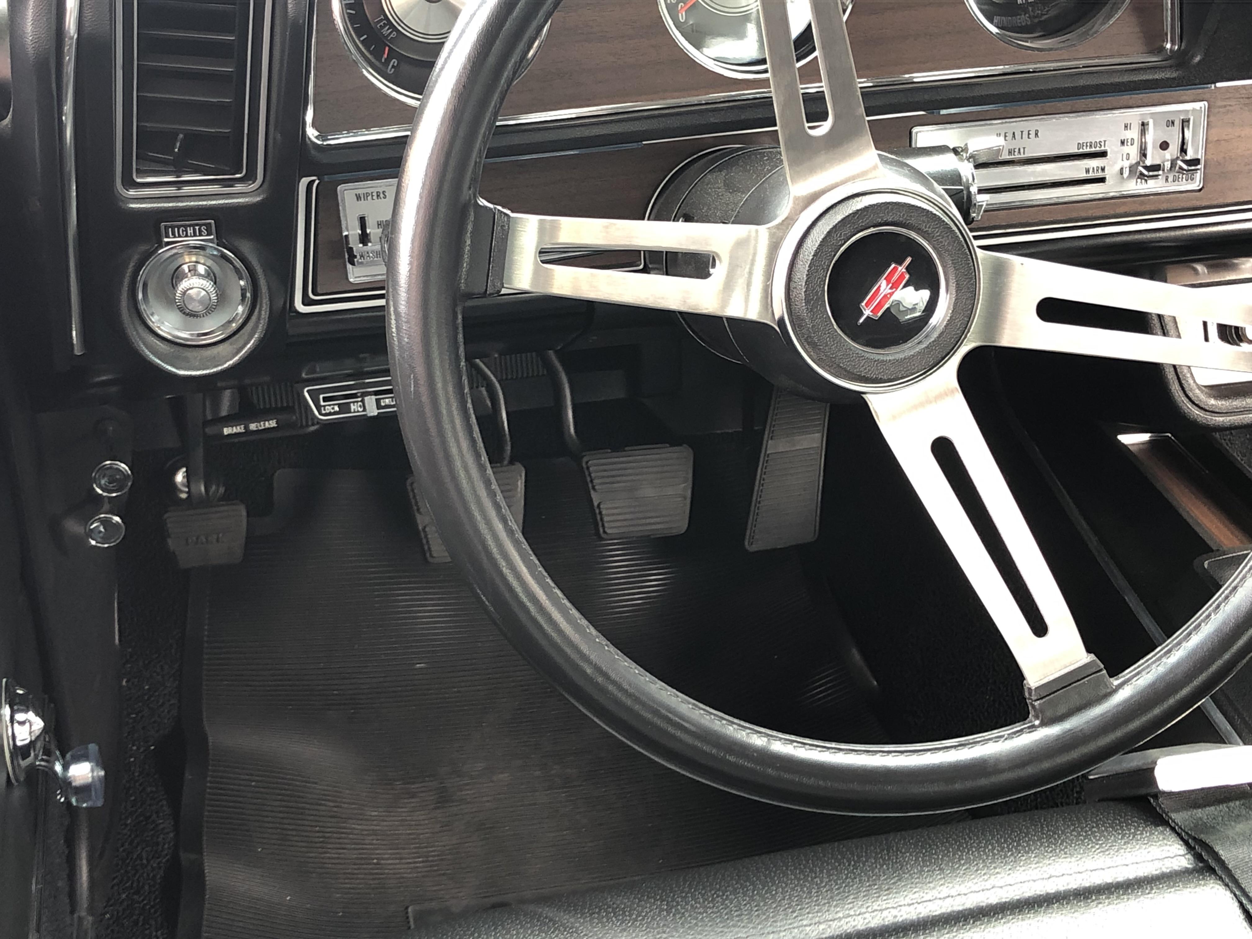

 Ext pic is what I’m trying to replicate…
And what I have so far…
yes, I am absolutely putting an 8 track tape in it!! Maybe a couple on the seats too, we’ll see.

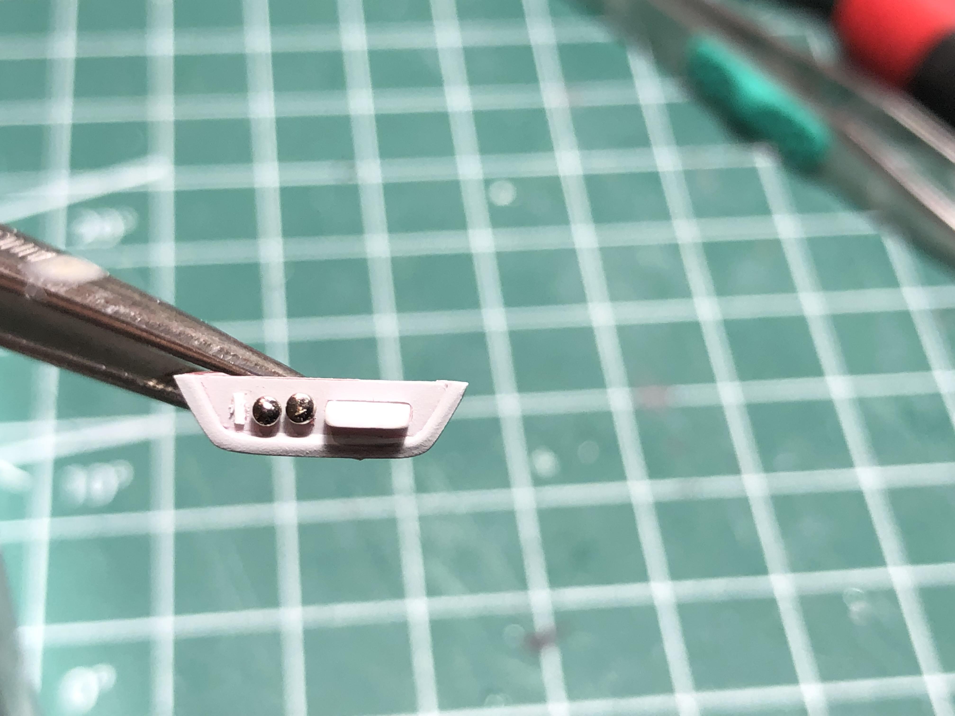

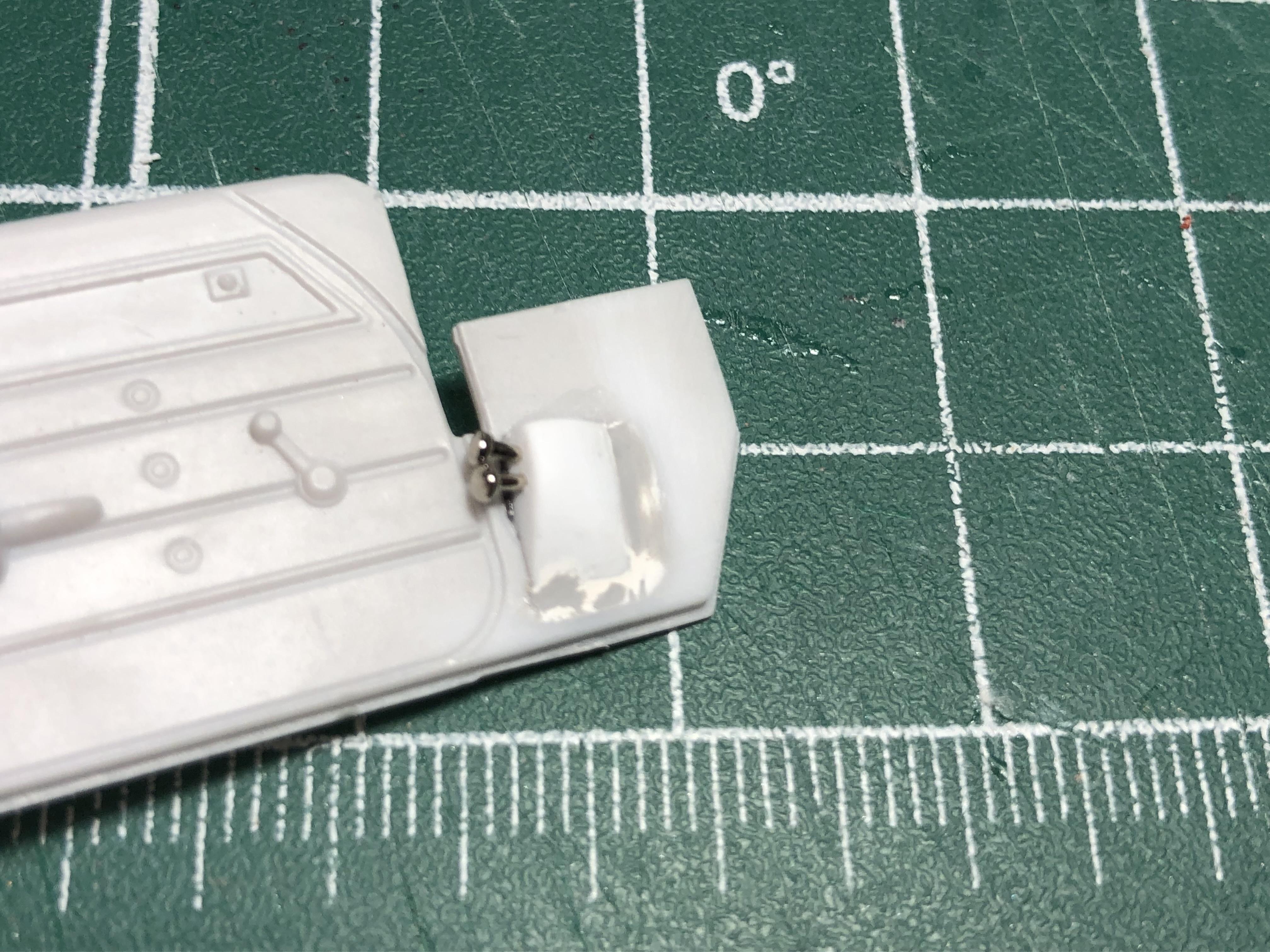

Made some door lock knobs…
I often use pins for turn signal levers and such. Wayne’s car also has a tilt wheel so, I removed the molded turn signal. Drilled for pins, then made a knob for the tilt lever.
Now that I see it this big, I can see it needs a little refining too. That’s where these big photos are good, (and sometimes not so good) as they show flaws that look good to the naked eye. I started working on the seat belt retractors, but that will be part of the next update.

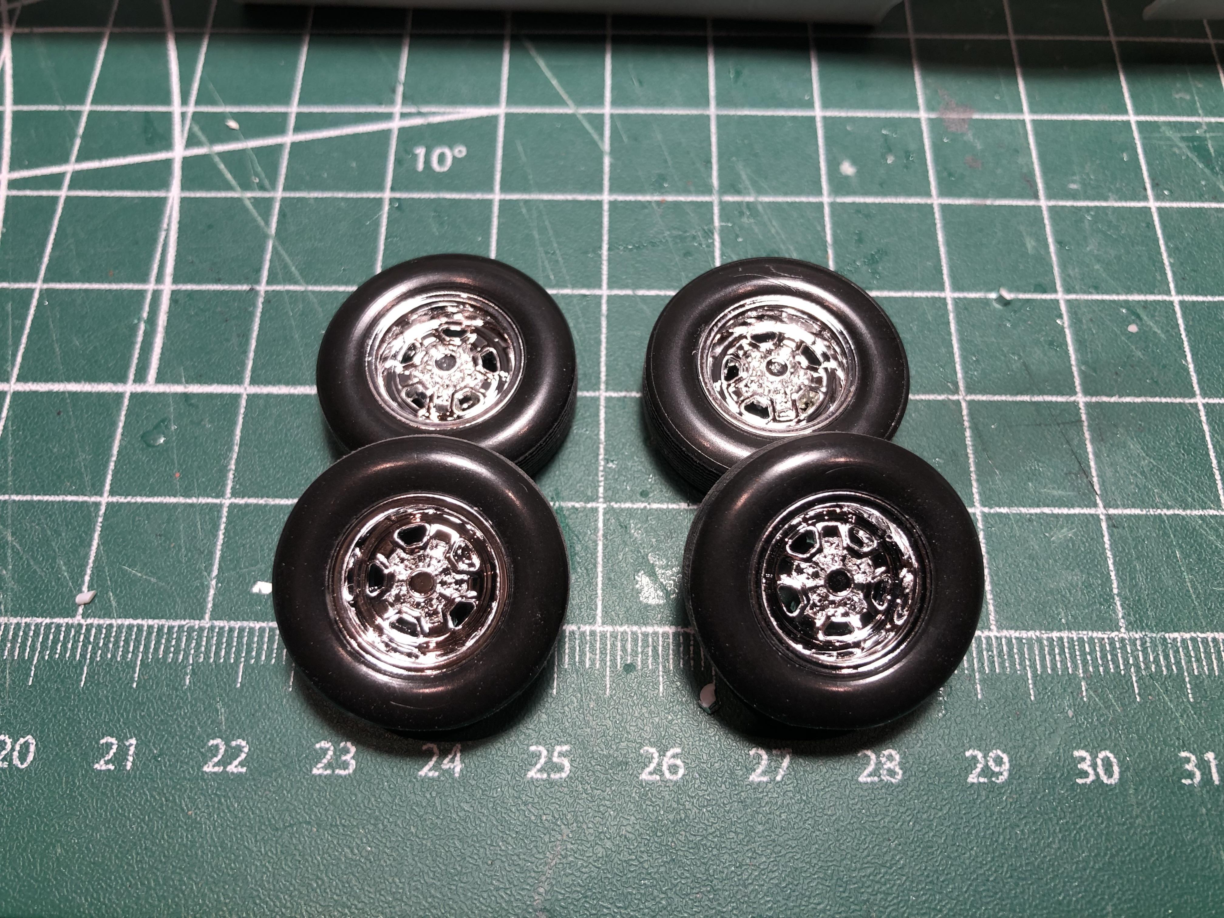

Also started detailing the wheels. Centres are painted, and added valve stems. Still need centre cap, and tire decals. Not noticeable in the photos, but the tires are “flat spotted” to represent weight of the vehicle.
After
