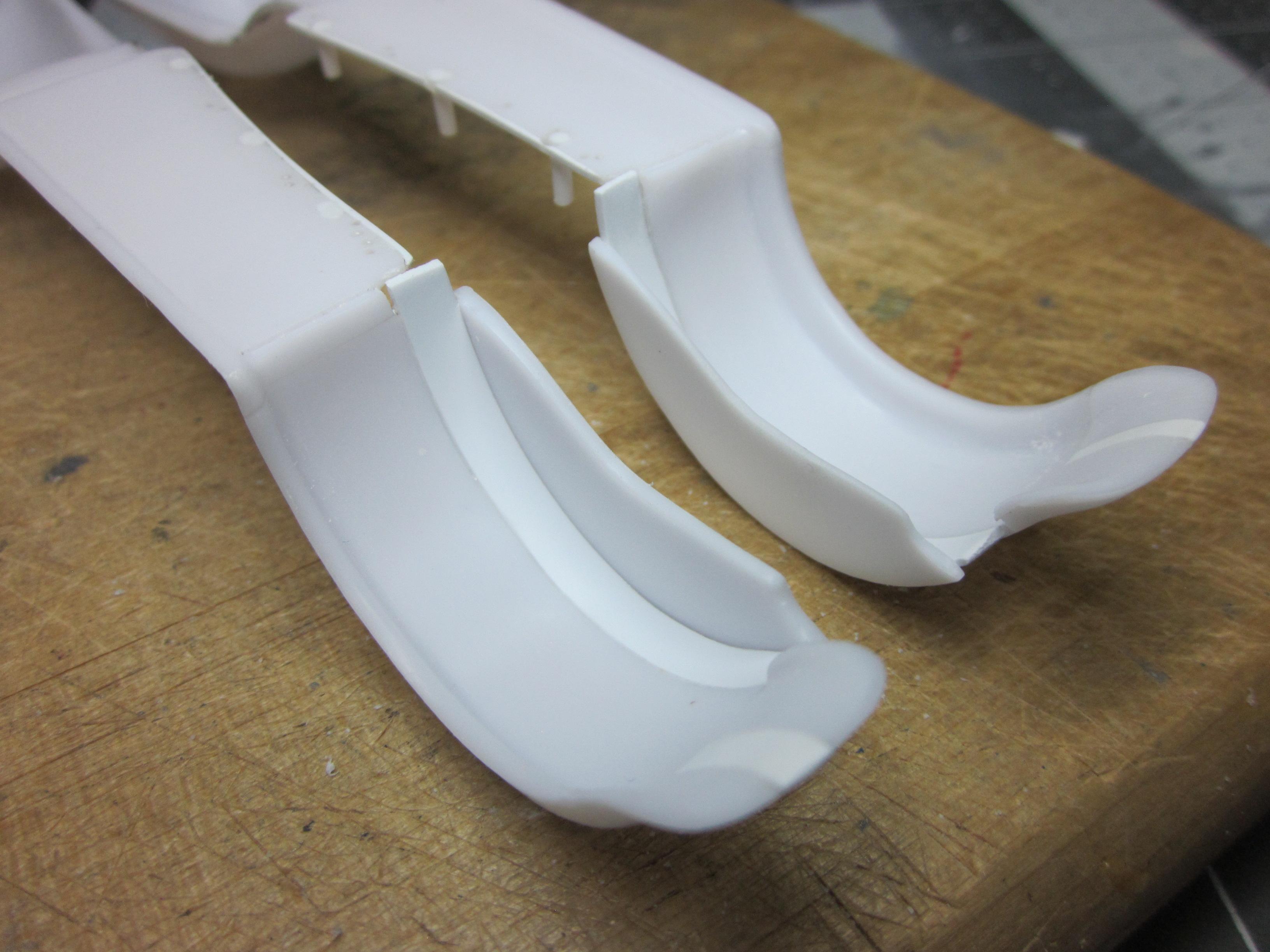

I'v been wanting to make a way of being able to attach the floor to the frame repeatedly during the build process. Especially on this '30 as there is quite a bit going on. There are only 4 body mounts. Two holes at the rear and two with a little nub that fits into a recess on the floor at the trans crossmember. The plan is to redesign the mounts at the crossmember. My main goal is to have something that will hold the floor and frame together while I'm working on it. First things first, things are a little tight around the shock mount and exhaust route since the floor is closer now. A couple of recesses were added built with some evergreen sheet scraps. The body mounts at the trans crossmember are the next area I would like to change. Figure if I was to put round rod in the floor were the recesses are for the old mounts, then I could make a tube to slide over the rod. Using this rod/tube method, should be able to install and remove the floor to the chassis as many times as needed. A round tube support frame was built using a old tamiya engine stand from the parts box. For now, everything fits and performs the way I had hoped. After all said and done, This thing just clicks together. The frame will always be in the same spot now also. Good stopping point. And now there are a few more things to ponder and figure out. Next time the body gets another mod.

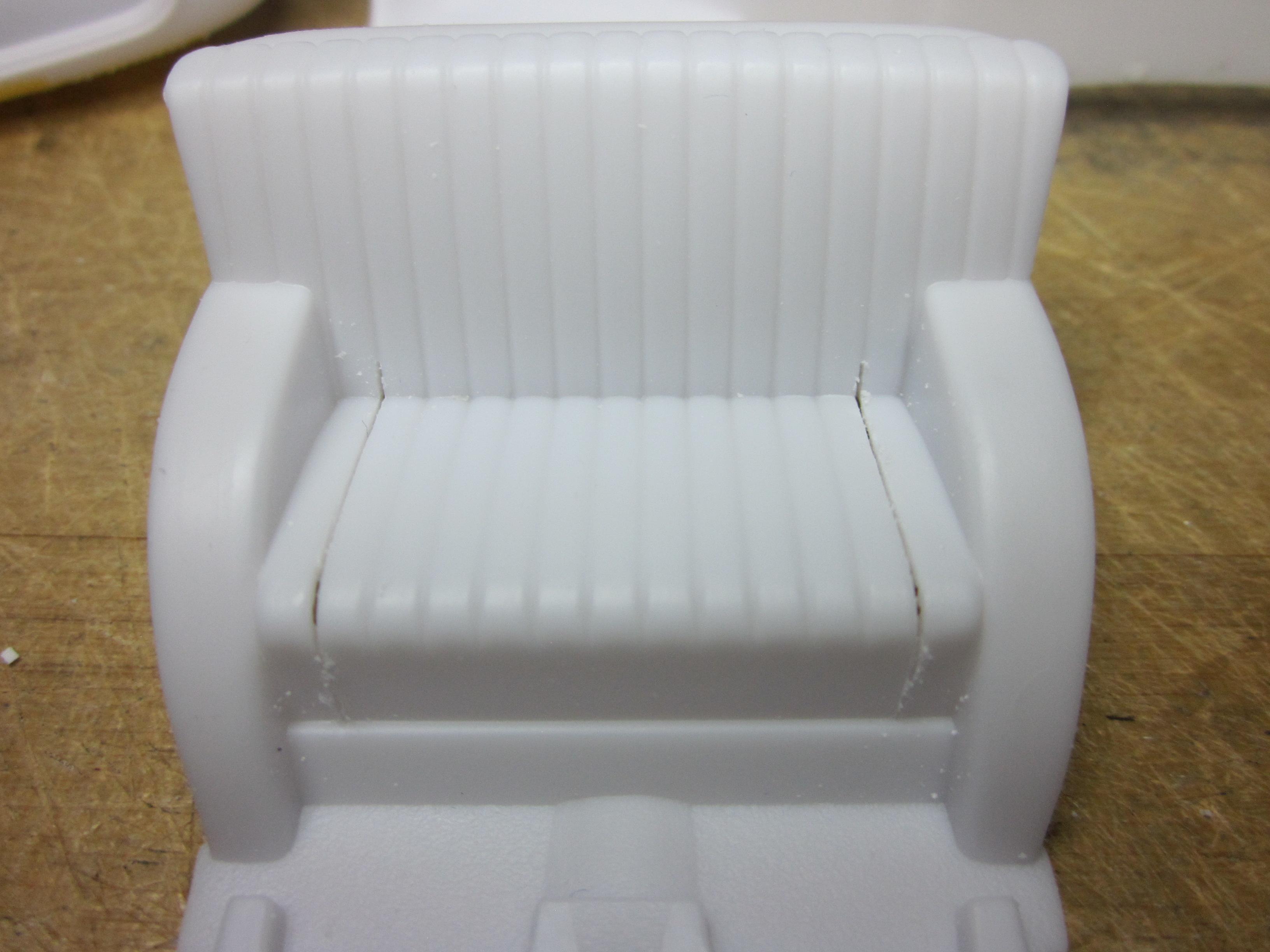

This is one of my side builds that gets a little work every now and then. My thoughts when I started it were to take each part and modify it in some way. In this case it turned out to be "Take 2-3 scale inches out of the part in some way" and see what comes out of it. I'v got a few things done and some pics to share. The first thing I did when the build started was chop the top 2 inches. Unfortunately, no pictures were taken during this modification. Wasn't looking for a huge change, just enough to make a small change. So the next mod was for the body. Plan is to take 2-3 inch wedge cut out of the body. The interior side panel's and fire wall were taped to the body. The side panel will be used for locating the first cut. If you look at the second picture you can see the blade cutting through both the body and door panel at the same time. It was important that the cut is perfect separating the top of the door panel from the bottom part of it that has the pleats. The next cut took out 2-3 scale inches tappering from front to back. Things were cleaned up and the body was glued back together. No putty here, just ca glues to fill all gaps. You can see by the cut line, It was a challenge at times. The top is not attached yet. Next time we will fill the top............. Thanks for looking.
